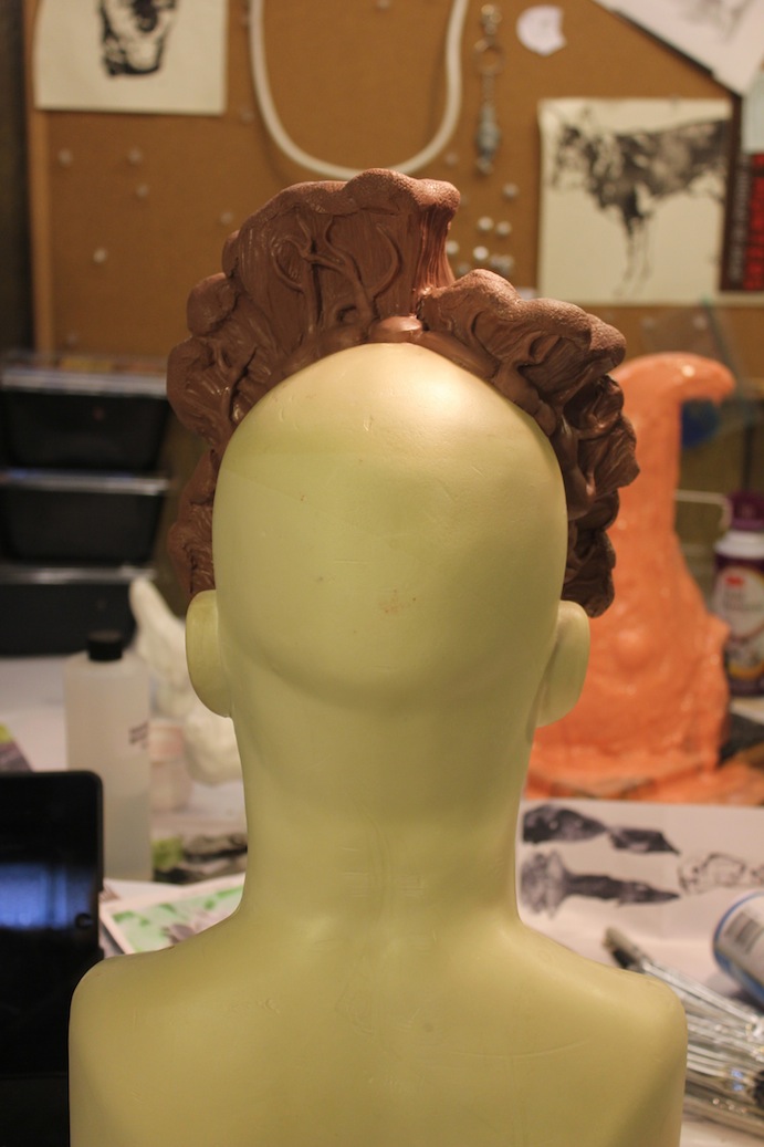

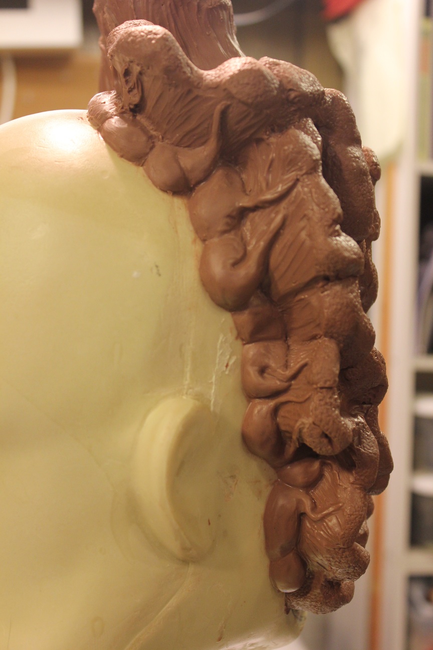

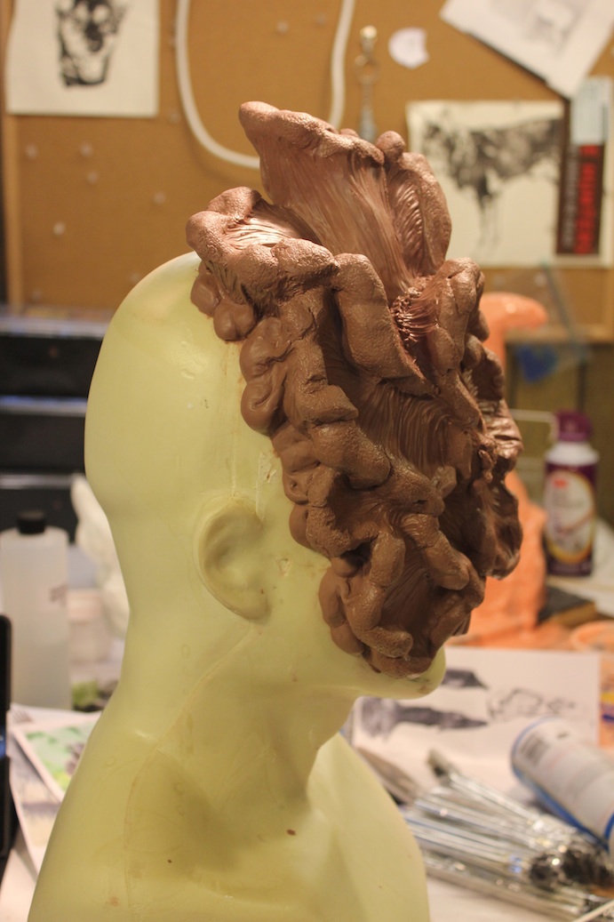

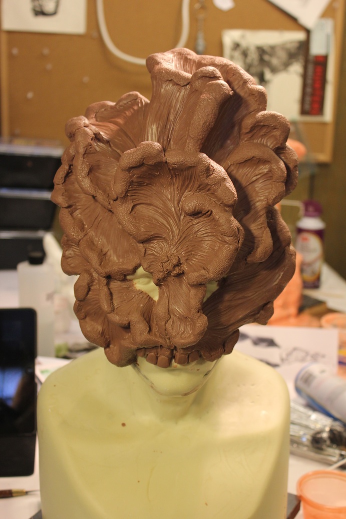

In other news, life (specifically my 2.75 year-old son) have preoccupying a lot of my time, so I haven't been able to put in the finishing work that I'd hoped to. I did get in a couple of hours of sculpting last night and finished laying in the tendrils on the back and started smoothing them:

sculpt looks fantastic!
Thanks! BrazenBell- Both of the eyes are uncovered. Vision will be a little obstructed, but hopefully not too bad. Depending on how it looks after it's done, I may cover the eye holes with a dark mesh.

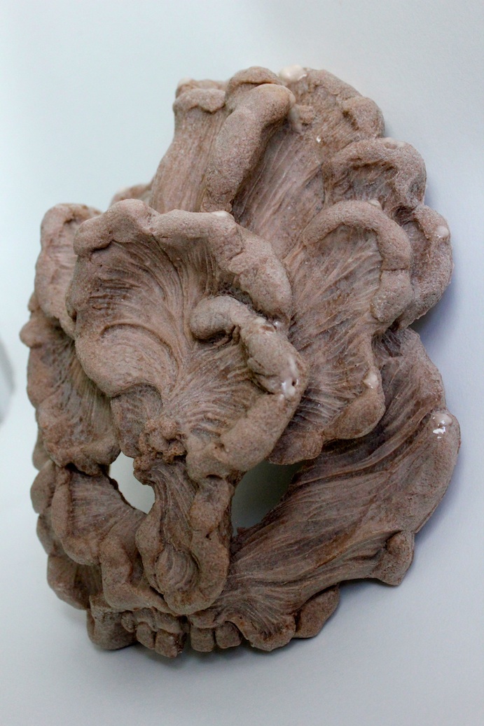

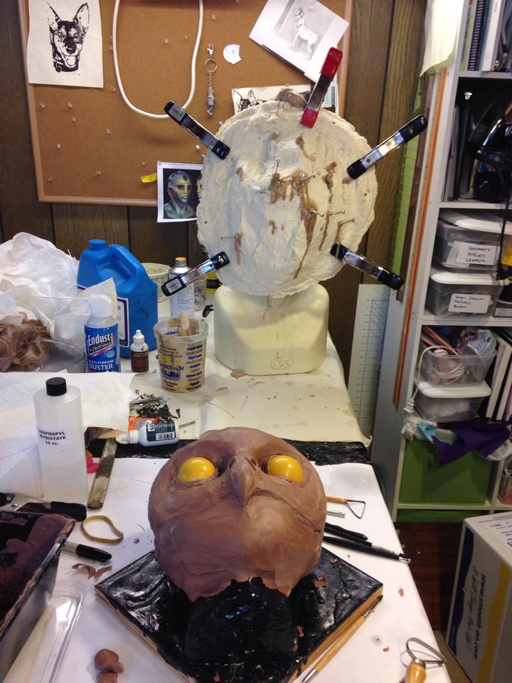

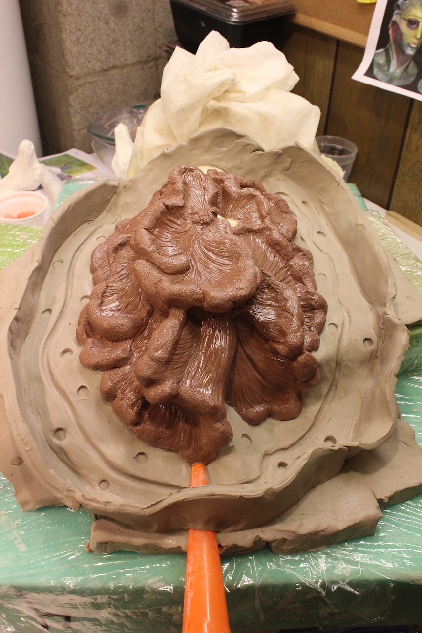

Started molding the mask. It's going to be a 2-part mold with inner silicone pieces and a plasti-paste outer mold, plus the head core. The straws are to allow the expanding form which I am using to cast it a place to expand to and (hopefully!) prevent air pockets.
First time doing a mold this complicated and I'm kinda winging it! *fingers crossed*

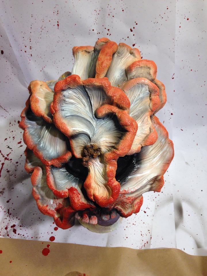

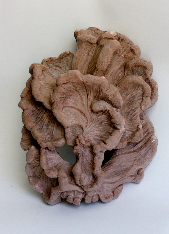

INcredible! Damnit makes me wanna play it again.

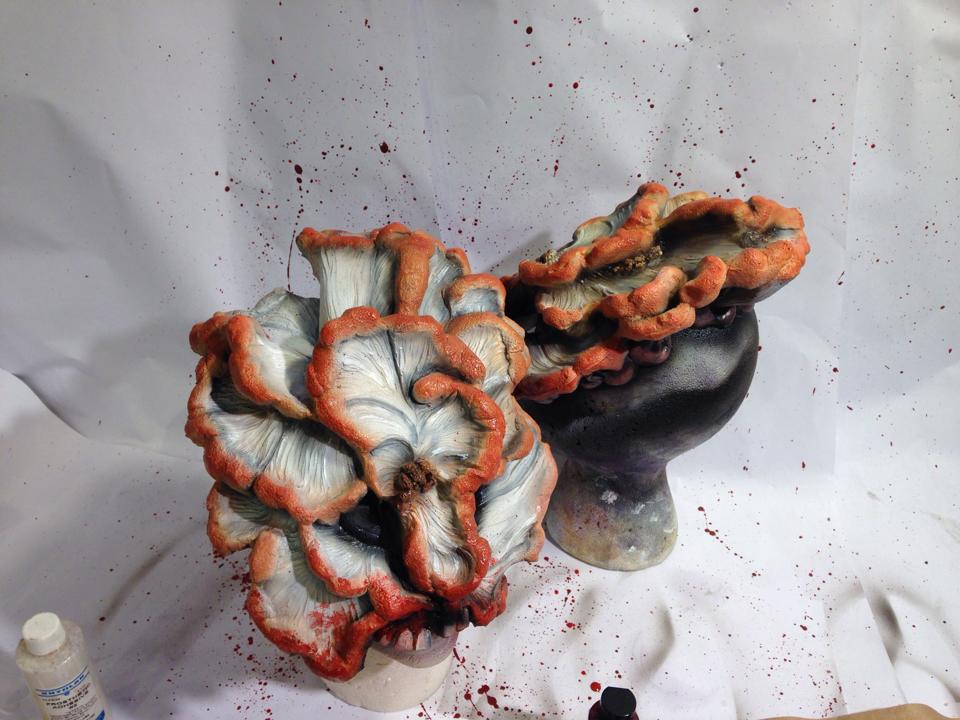

Rens this turned out amazing. The paint job really makes it pop. Now lets see it on someone. :D
Thanks guys!
Hopefully the person I made the mask for will send me pictures of it being worn. Otherwise I suppose I'll have to break out the makeup and do a mini photoshoot :)
