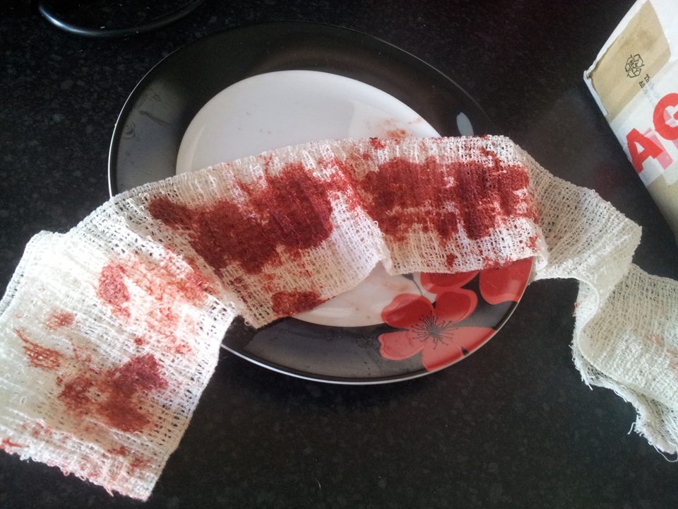

Today, I have prepped the bandages he will have on, as if he as pulled them down from his eyes.
