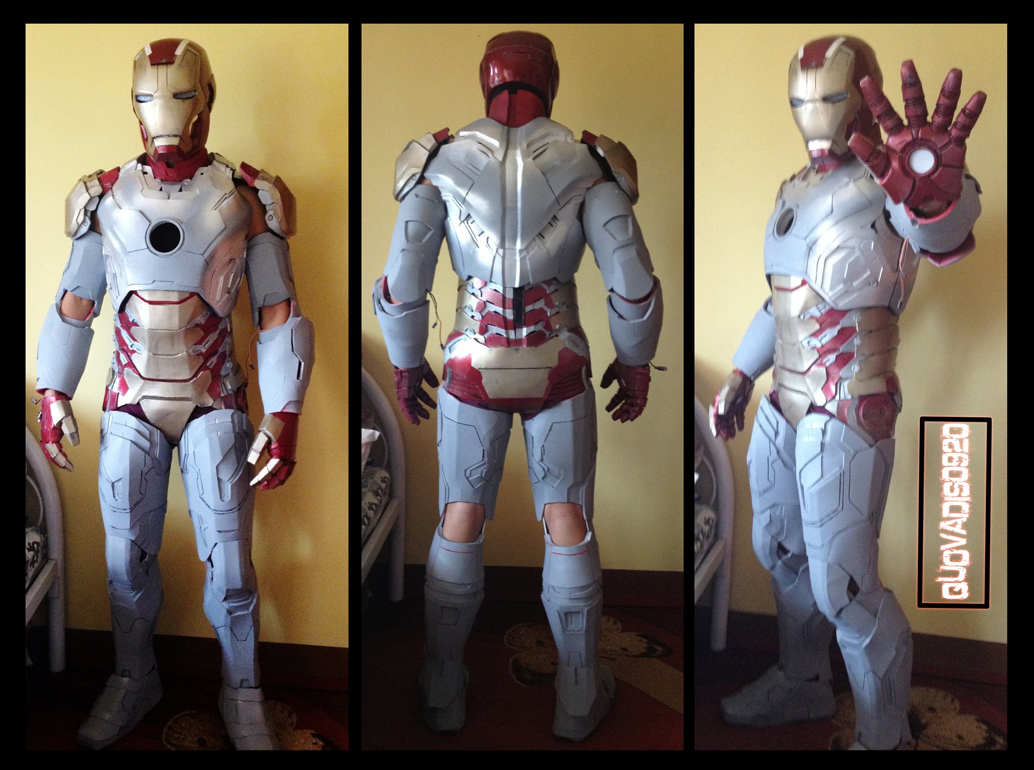

Current status of the suit fully suited up [except the handplates]
Just need to finish painting and the electronics shouldn't take long to install. Yay!

Hello there. Top-quality work! The best foam Mark 42 I've ever seen.
I have a question that I know has been asked, but I've been over this thread 3 times and I still don't think you've mentioned the exact foam you're using. I've never heard of rubber or "rubberfoam..." is it the same thing as EVA foam? That is, the same type of foam used in "Foamies?" or "craft foam?" I can't imagine using only epoxy primer directly on to EVA foam surface without having severe cracking and chipping problems, but I'd love to try! To be clear, it sounds like all you're doing is epoxy primer -> paint -> clear coat (basically)?
I built an entire suit out of EVA (foamies type material) and went the pva glue plus smooth-on plastic coating method. I also used the plastidip process but both ultimately let to cracking problems. My next attempt will be docholiday's method, but your coating method sounds even more simple. They key may be the type of material you're using. In the first two videos (page 1) the foam already looks more rigid (before you even sand) than the craft foam most of us use.
I ask because I feel like I've been through most types of foam and have yet to find anything that will take a simple coating process. Whenever you get time, please let us know the exact type, maybe even brand name, or manufacturer who you're using PLEASE :) I'd love to try your coating/painting process, it looks phenomenal! Thanks for sharing your process!! :thumbsup

Thanks kurtis! Yes the rubber I am using is a lot different to what you guys have been. Nowadays I use 6mm thick rubber foam, or rubber sheet. It doesn't have any brand name since I buy it from a local hardware store here, but it is pretty rigid and doesn't have any patterns both sides.
Here's a vid showing how strong the rubber is : Video
The glue is different as well that's why I'm able to do it very clean, and the rubber is sandable too. With the sealing, I just run a heatgun through the pieces to seal small holes, wash them with water and soap, let it dry. Then spray it with epoxy primer the next day, at least 3-4 coats, sand, final coat of primer, paint, clear, buff, clear and wax.

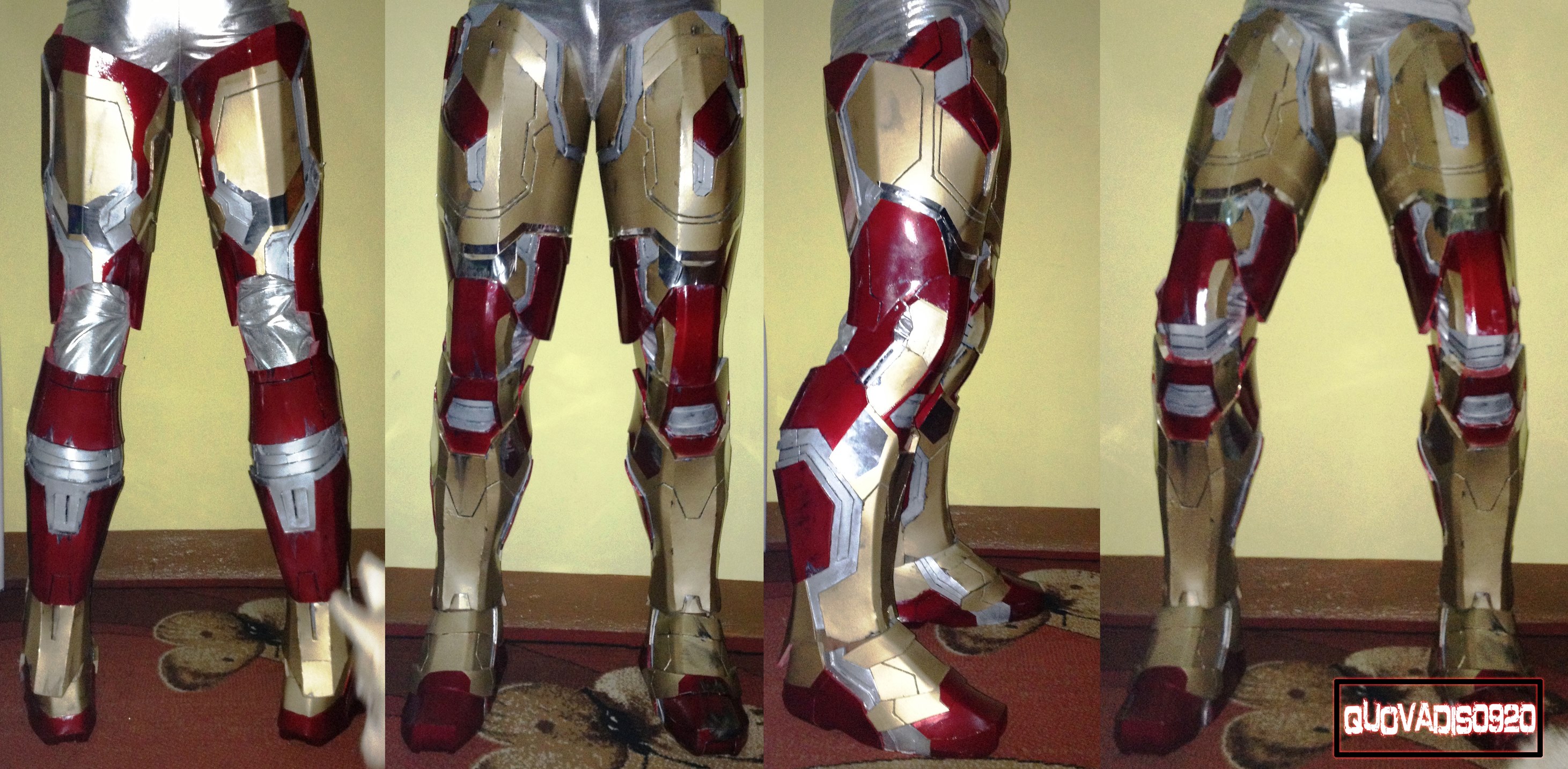

Nearly there. Well, almost.
Did the same damage-y effect to the legs, so it would match up with the rest.
Other boot hasn't received it yet though.
Come saturday this baby should be done. So yay!
