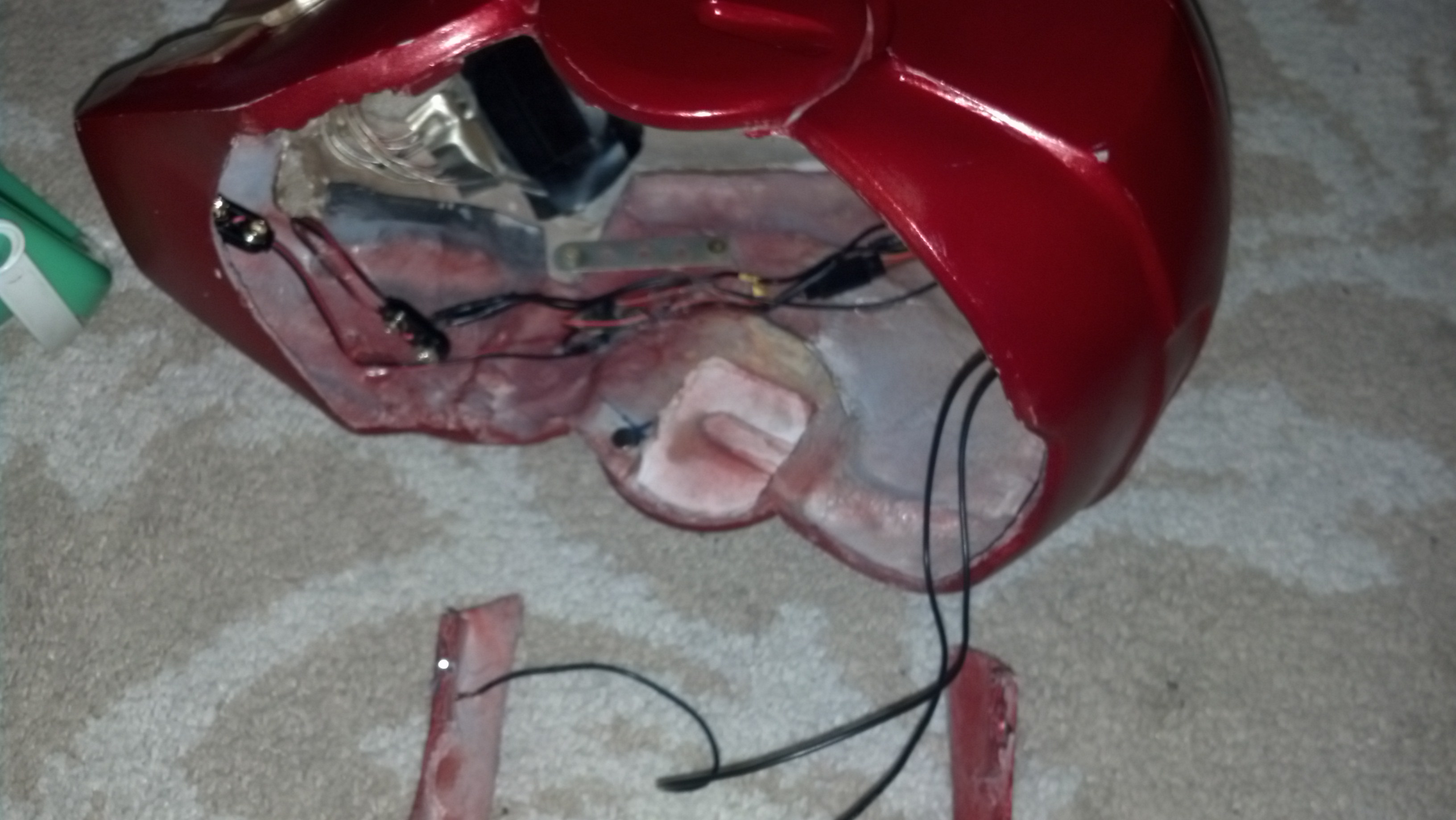

Looks amazing, Im curious how you did your motorized voice activated helm. I would be really interested in doing something like that. I have a couple of ideas but wanted to know how you went about doing that.

I used a Arduino board with an Easy VR for the voice commands. Im not a programer but i found someone on another forum that help me do it. The only issue was, it had to be super quite for the voice commands to work. Any back ground noise would mess up the Easy VR and nothing would happen. The is why I gave up on the voice commands and just put it on a switch. I have the code for the voice commands of you want it? just let me know and ill send it your way. The person that helped me is more then happy for me to share his work, I asked him already =)
