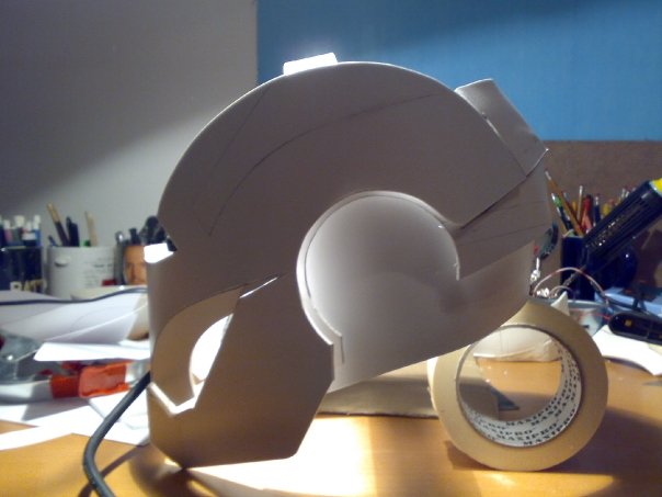

Dude :D, you need to make the back yourself, it's not that hard. Actually, you can see here the way I did the two layers that connect the template part with the first back panel:
http://www.jkfc.eu/mm/ironman/template9.jpg
It works like this:
Cut the template, shape it with the heat gun, slow and gently, you don't want the forex to bend too much otherwise you'll lose its smothness.
Once you have bent it, create on cardboard the first back panel. Try it, if it works, place it on sintra and cut it. Once you've done that, you need to do two more layers in order to obtain this:
http://www.jkfc.eu/mm/ironman/template13.jpg
If you look closely, you'll see what I'm talking about.
The Chin on the template is not completely accurate. You'll need to make a new one eventually.
If you have any doubts let me know! I'll try to help.
