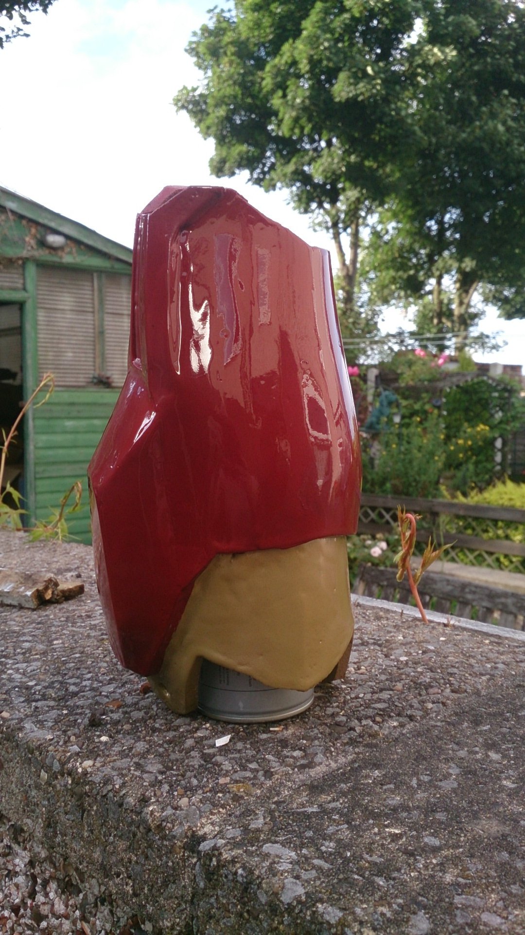

Recently inspired to give plastic coating another go on some small pieces after seeing this thread and drooling. Came out a bit better than last effort and I found that using extremely small amounts at a time as well as using a fresh brush and cup each time really prevented some of the issues I was having previously but still not perfect.
My issue comes with small bubbles, after I whip together A and B of smooth on 65d it can be a bit frothy and between that and brushing it on there's a tendency for little bubbles to form. I tried to sand lightly but due to the piece being flexible still and also not wanting to sand through the thin layer of rather expensive product I just put on its not coming out super smooth. I noticed you listed a product of plastic filler is that like a plastic spot filler or is it a typical spot putty that you put on with your primer layers? You also said you use auto paint so I'm assuming not typical rattle cans in which case how do you apply that? Basically how do I get that baby bottom, mirror/glass, James Bond shaken not stirred smooth result you do?
Could you list a in depth list of products and procedures or even a video? Your result is amazing and I think everyone would appreciate some visual points from an apparent master of the technique.
The plastic filler is bumper filler you just add a activator rubs down really easy I'm doing same process as on this thread after seeing it done I was inspired :) and it's hard and takes time but finish is worth it :) image.jpg. I use spray paint get it from halfords in the uk it's car paint hope that helps a little
