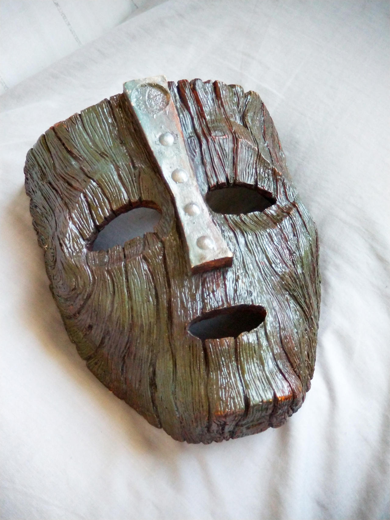

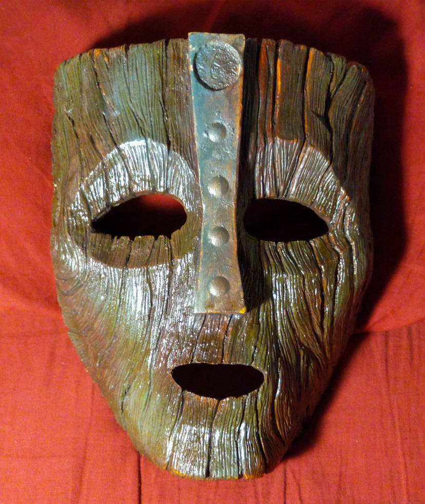

Hi guys, this is the mask I would like to repaint. It has brown paint (almost reddish in some areas) and a good amount of varnish. I have very limited resources (and budget), so I'm trying to figure out the best way I could repaint my replica from scratch. What would happen if I start painting a green base coat over this mask without using a primer?
