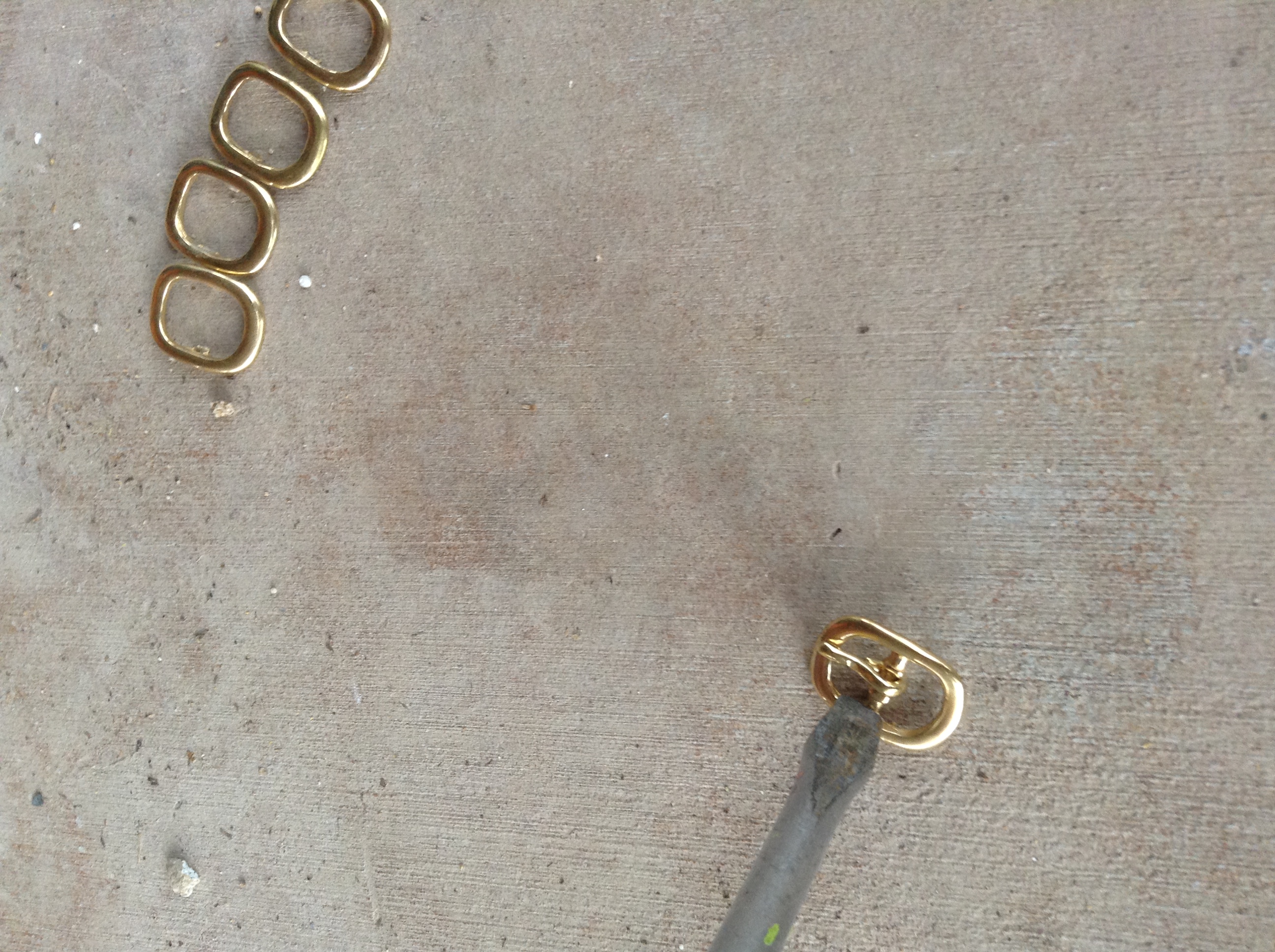

So, the hooks and loops. I didn't want to cast 'em, or paint 'em, just find something more... real, I suppose. No risk of cracking, flaking, or anything besides historical aging next to the leather.
Tandy Solid Brass Sandal Buckle:
Chiseled out the center bar, and cleaned up the nubs with a dremel:
A similarly caveman solution for the hooks, solid brass links from Ace, given a half-twist with a pair of wrenches and cut to size with the dremel.

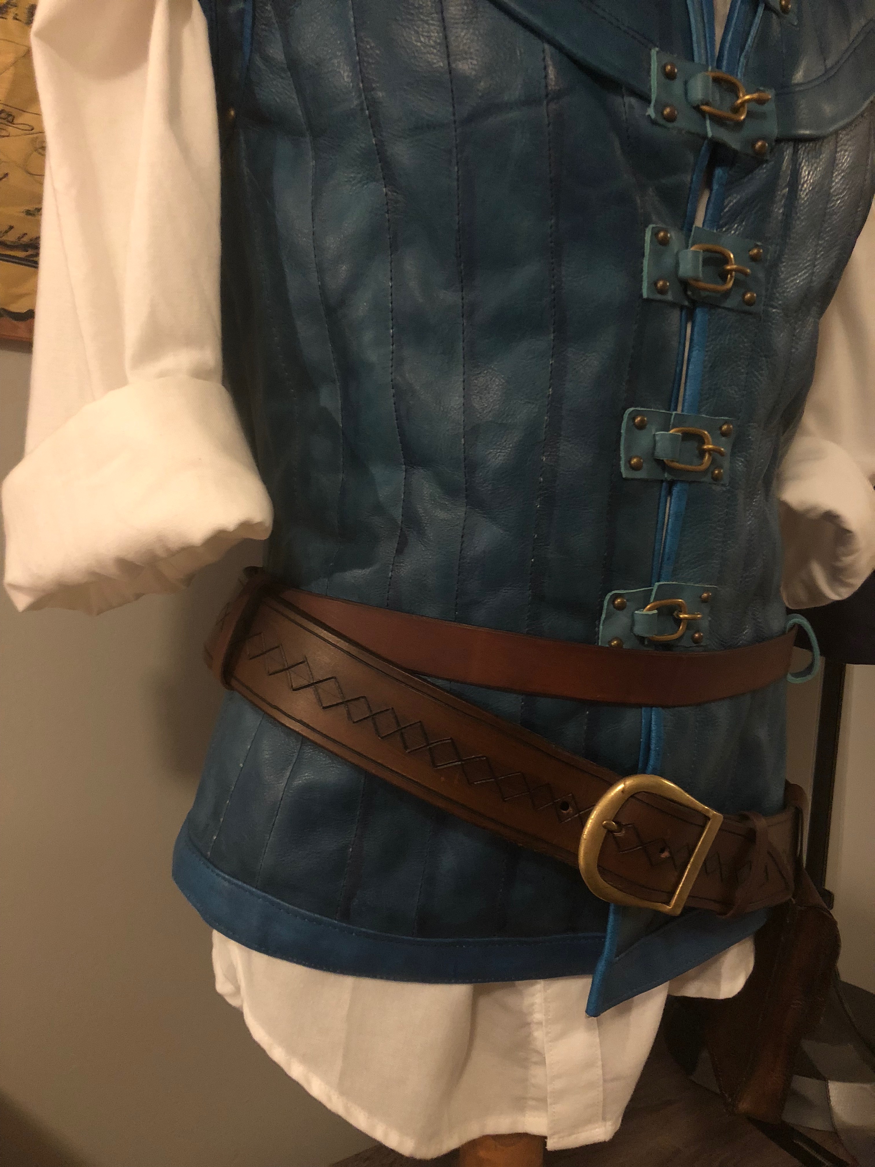

After a long break, here's the idea behind a screen-accurate belt.
Seeing as it's animated and doesn't need to open, Flynn's first belt is simply a seamless leather band around his waist:
My solution was to hide the closure behind the only point along the belt where it's obscured: the loop of the second belt.
First, to make the second belt: a 1.75" curved strip of veg-tan leather. This is important; if it's not curved, it won't hug your body. I wanted it to look handmade, so I cut all the diamonds with a swivel knife and used a groover along the edge.
The pouch is just a hasty veg-tan project, not much better than a placeholder. The buckle is solid brass. Disney animators appear to have committed the same mistake that Assassin's Creed animators have: buckle tongues that face the wrong way. I'm not sure if any of them have seen a real belt before.
Anyway, here's the trick. Simple loop and snaps on the first belt, like so:
First snap the belt into place (taking care to also slide it through the blue loop on the doublet), then buckle the curved belt over it. Viola, a truce between accuracy and reality.
