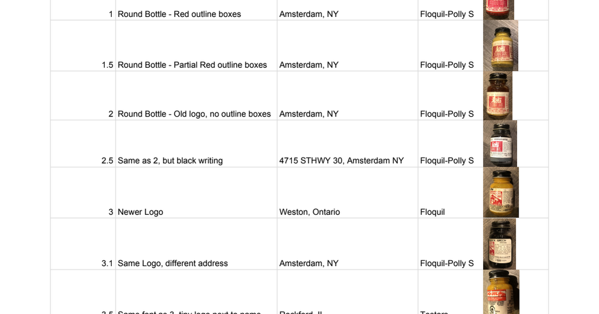

So I have been recently experimenting with some vintage (and not so vintage) Floquil I've been collecting. I decided to do a survey of the bottle types and colors that I have to see if I can start a database. I've cataloged my results so far in a Google Sheet at:

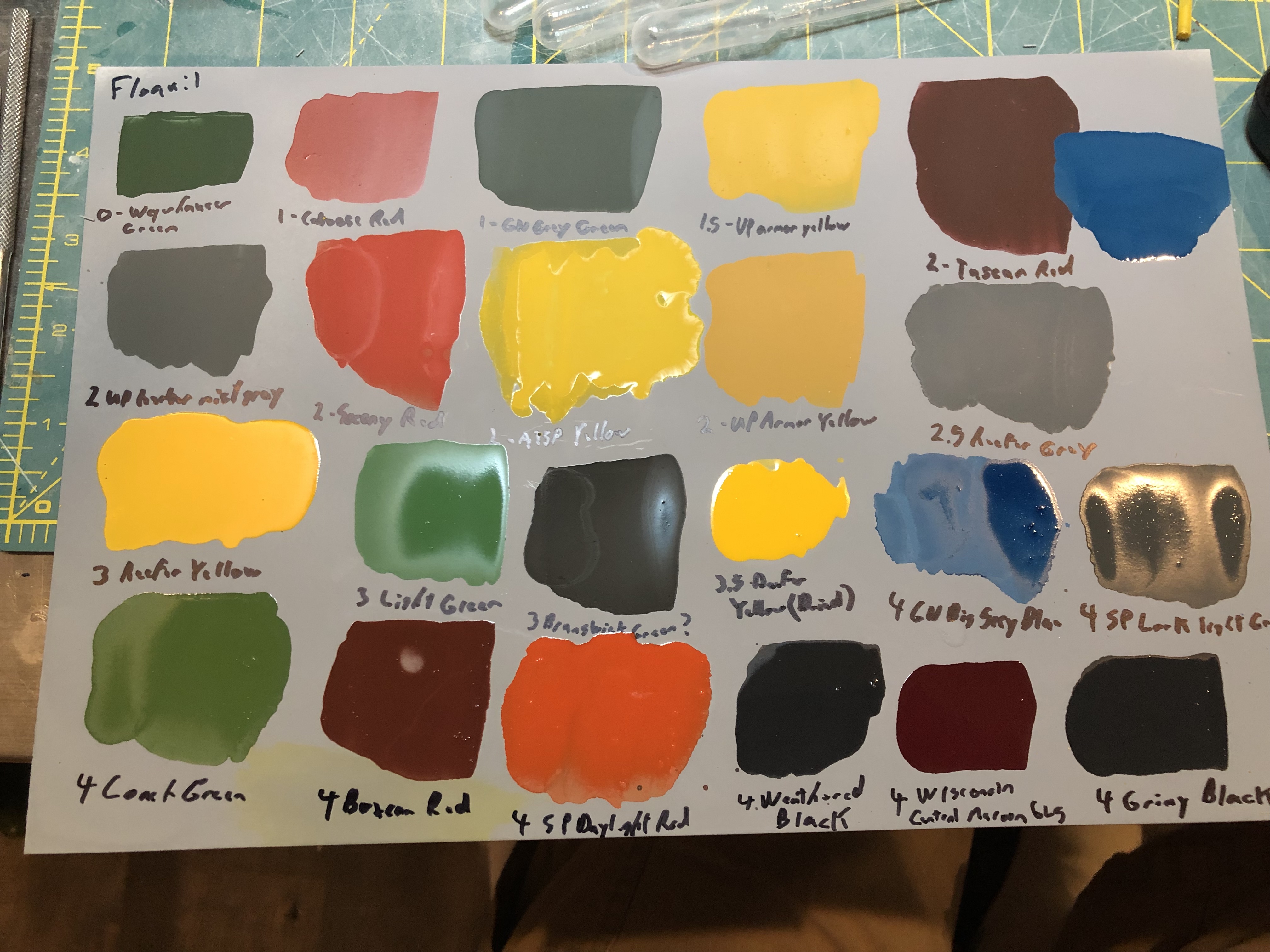

I know there has been a great deal of research like this here in the past but most of the original research seems to have been pulled, so I decided to start from scratch. Below you can see the first color samplings I've done. I then scanned these colors with my Spectro 1. The results are in the above spreadsheet. Both the CIELab and RGB colors are there including what bottle type they were sampled from.
Lots of different bottle types - It would be very helpful to find out which the actual SW/ILM era - I'm guessing somewhere between 1 and 2 in my chart, but thats only a guess. Input is definitely welcome!
I managed to have some success using my Paint Decoder App in matching quite a few of these colors. For example, I got a very good match to Caboose Red with Tamiya:

Bottle Types Type Number,Description,Address,Manufacturer,Bottle 0,Square Bottle - Probably oldest,Cobleskill, NY,Floquil 1,Round Bottle - Red outline boxes,Amsterdam, NY,Floquil-Polly S 1.5,Round Bottle - Partial Red outline boxes,Amsterdam, NY,Floquil-Polly S 2,Round Bottle - Old logo, no outl...
