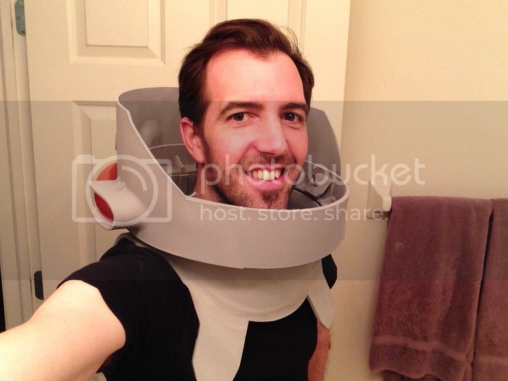

Next, going back to the upper part of the helmet. This is on the inside where the latching ring fits poorly with the main cylinder. This is going to be very rarely seen, but it was just so bad, I had to fill it in. On the right is the little "snake" of Apoxie, on the left is where I've mashed it down into the seam.
Something I've been procrastinating on, is the hole where the vent tube curves and enters the helmet. The hole is way too big and the elbow in the tube is ugly. Thought about filling it with hotglue and Apoxie sculpt, but I want to be able to disassemble the thing without destroying it, if I ever need to repaint it or make an update.
I sketched out a couple of possible designs, wasn't really happy with either one of them; the bottom one would be easier to make but not flow with the rest of the design; the top one would work with the design but be very difficult to make out of Sintra due to the compound curve shape.
Then my wife suggested mimicking the shape that I built for the battery pack housing, I slap my own forehead and say "why didn't I think of that?" So here we go.
Sketched it out a couple times in cardboard and paper to get the shape and fitment right and refined. Tape the paper into place, make notes on the paper as to what needs to be adjusted.
On the right is my original template for the battery pack housing, on the left is my first draft for the vent elbow cover.
Some up with a final layout , transfer it to Sintra, gently heat-form it to shape.
Glue it into place, add some little triangular buttresses similar to the ones on the battery pack housing.
Cut and shape a top cover that's similar to the battery door, but I ultimately decided that I like the look of this piece without the top cover, so it's not part of the final design.

Everything's coming together. Moment of truth #2: gray primer over the whole thing. (the pink and red tubes were not in place for the painting, of course)
Look at this. I'm SUPER HAPPY with this part.
It fits. It sits. Starting to look good, and although my con deadline is rapidly approaching, I'm feeling very confident about this build.
