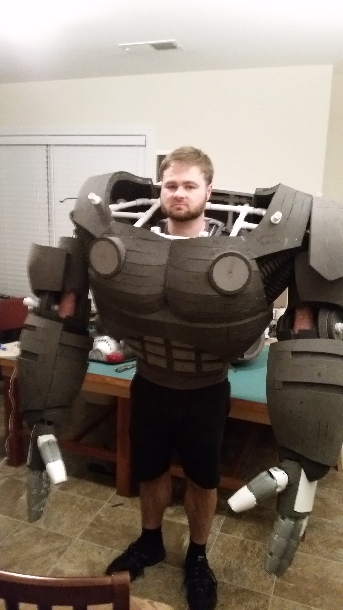

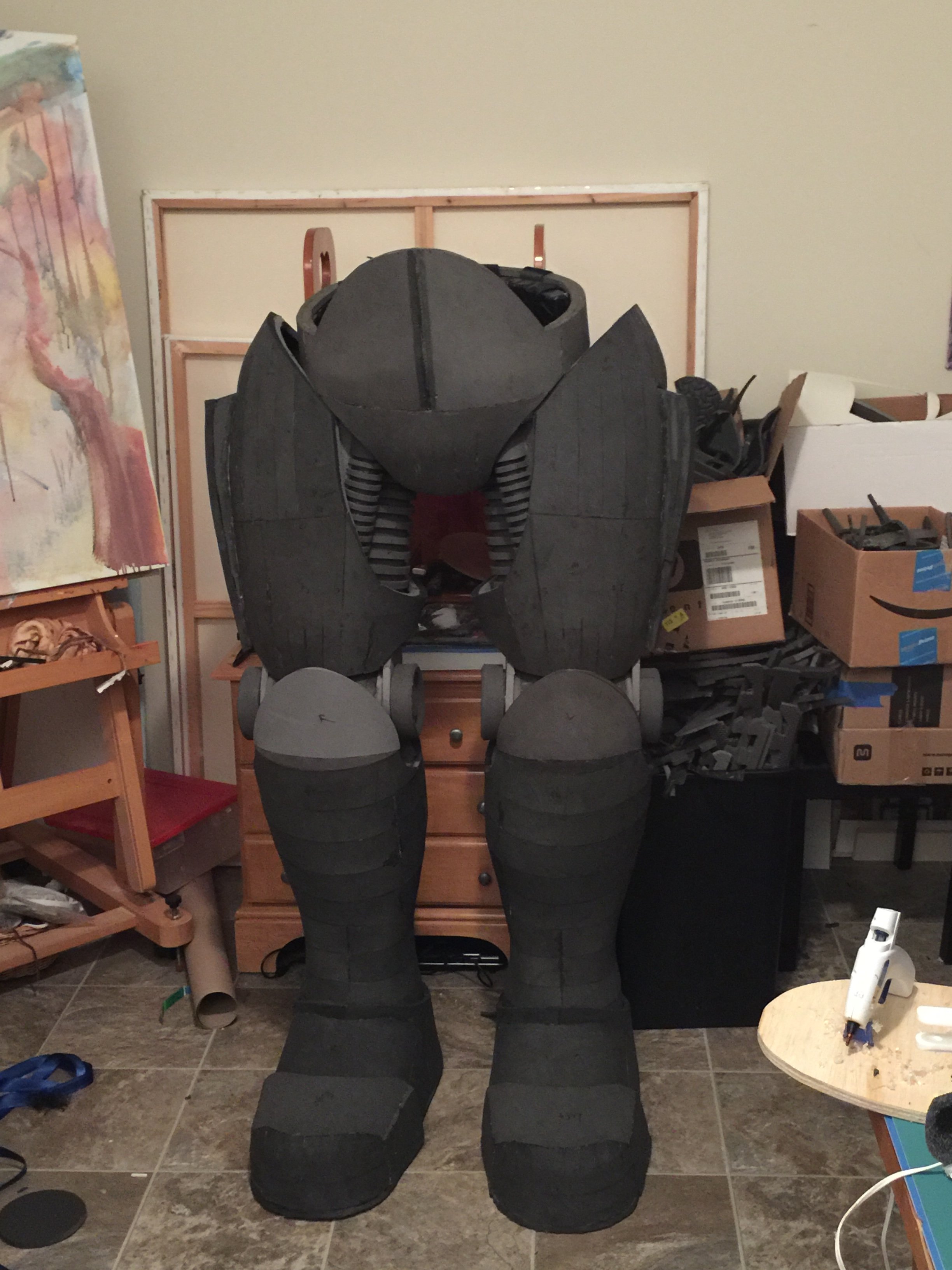

Time to start testing and fitting stuff! We used a few straps inside the chest to make sure it sat at the right height. We did have issues with the chest trying to fall backwards and smack me in the face. We resolved this with a hook and a strap to a harness that I wore. The harness was basically just a camelpak that I had on and the strap attached to the loop in the back. It keep it from falling backwards. Also, strapping my arms in using straps was another way we kept it steady, but this caused some issues. I'm still not entirely happy with the comfort of the arms. I lose feeling way too quick, but more on that later.
See how my arms are sticking out. This is similar to the wide body thing that MWiggs has going on.
Putting one arm on with the large shoulder. It looks pretty cool I think.
I look like a megaman boss.
Tiny legs!
Another angle.
And here are the legs standing up on their own later on with the cod off.

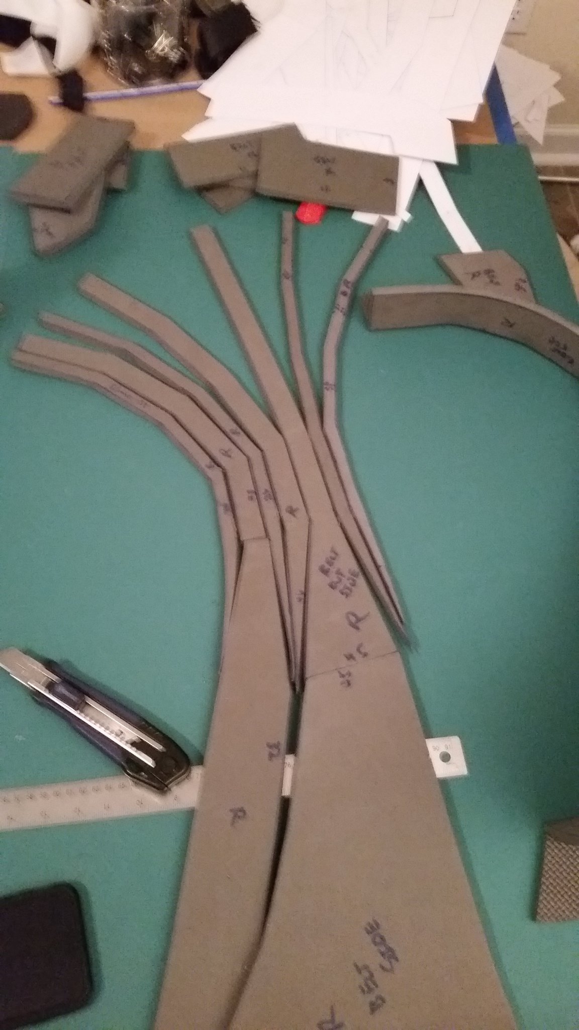

So most everything is done build wise at this point, though there was the matter of finishing the belt and jetpack. Unfortunately, the time crunch was starting to hit now and I don't have many pics of these two being built. Dave finished building both in Maya and the unfolding in pep looked kinda ridiculous. The belt in particular was a huge pain to build out of foam but we decided to give it a try:
Look at this thing...and we had to do it mirrored as well. That was the least fun part of this other than the finishing stage...

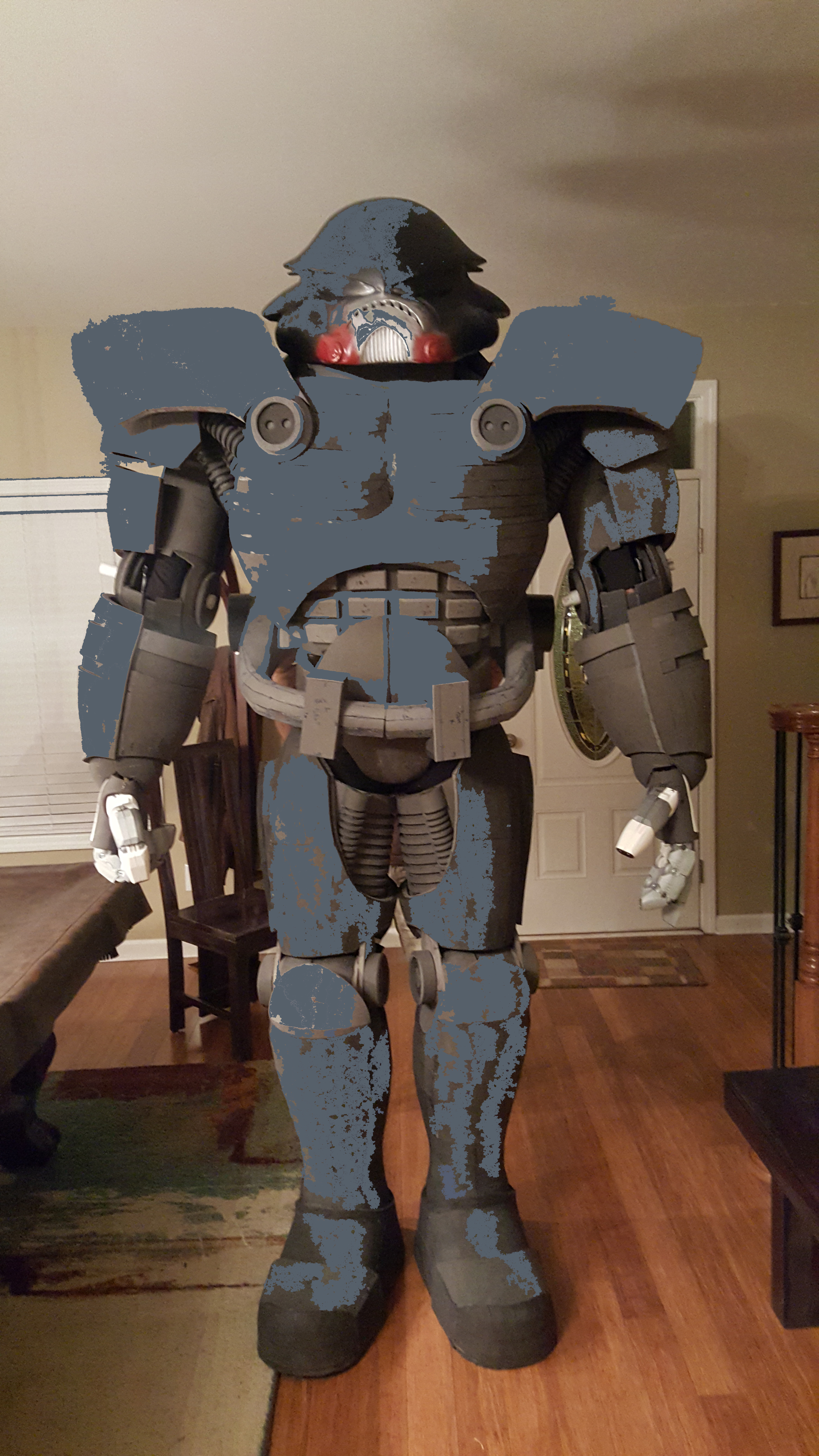

Here's a pic of the color matching we attempted with photoshop...or maybe paint. I can't remember which program he used but it was just to see how it looked.
We had no issue finding a good silver and gloss black, but finding a spray paint for the major body armor pieces was next to impossible. So Paul found an online site that will color match and we found a paint chip at lowes and sent it to them. We ended up with a somewhat pricey but accurate crate of about 10 cans of "blue grey slate". So we had tested our filling process and epsiloned one of the earlier attempts at the shoulder bell. I decided to test this paint on the shoulder bell to see if it looked right.
Painted and it looks sort of grey inside.
And sort of blue outside. It's pretty much exactly what we wanted. We did decide it needed to be shined up a bit. We got some gloss clear coat for that. So paint is decided on! And our test piece looked pretty good using our filler and epsilon method. It was pretty strong but it seems like our method of filling might be an issue. I'll get to that though.

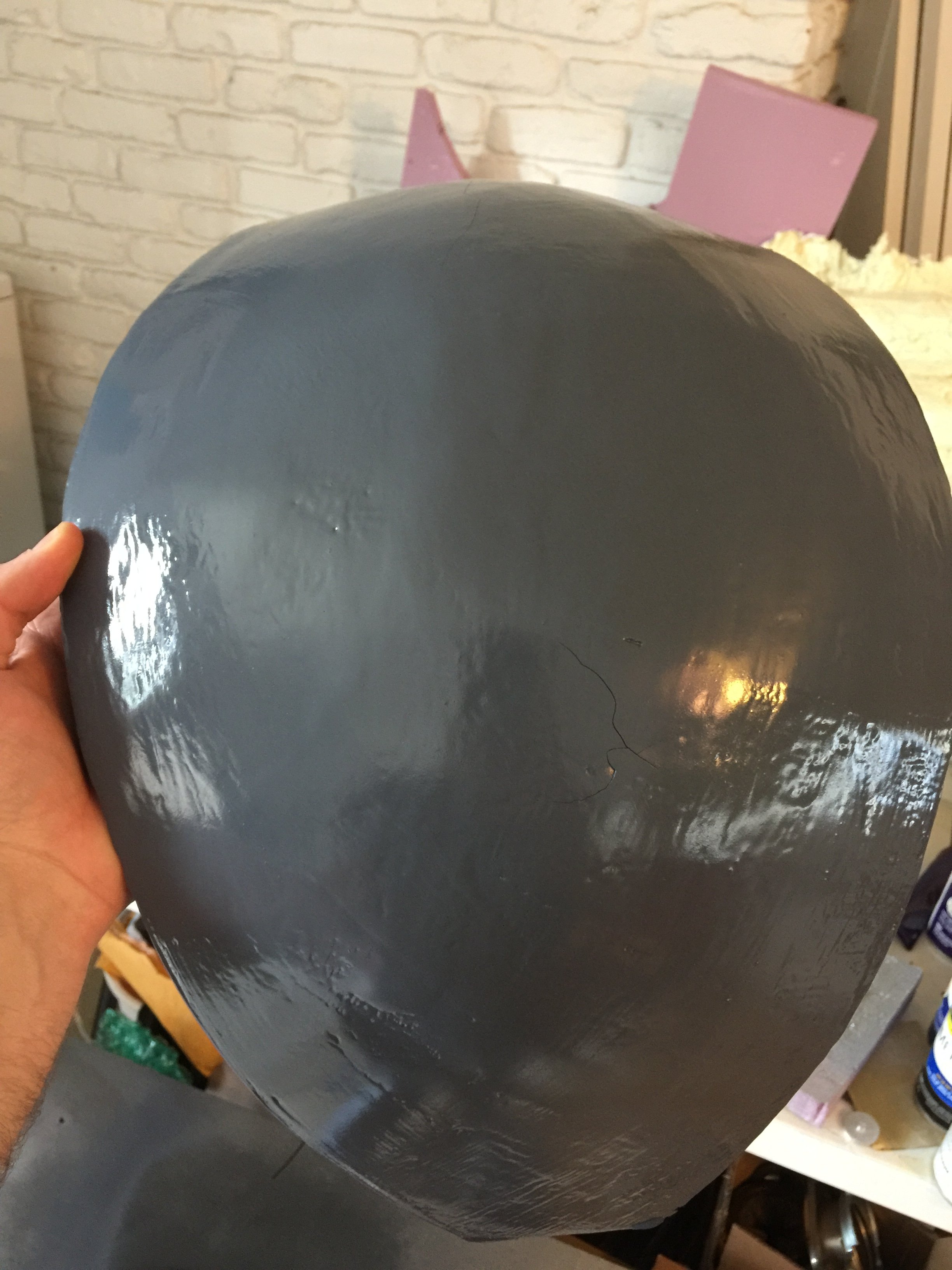

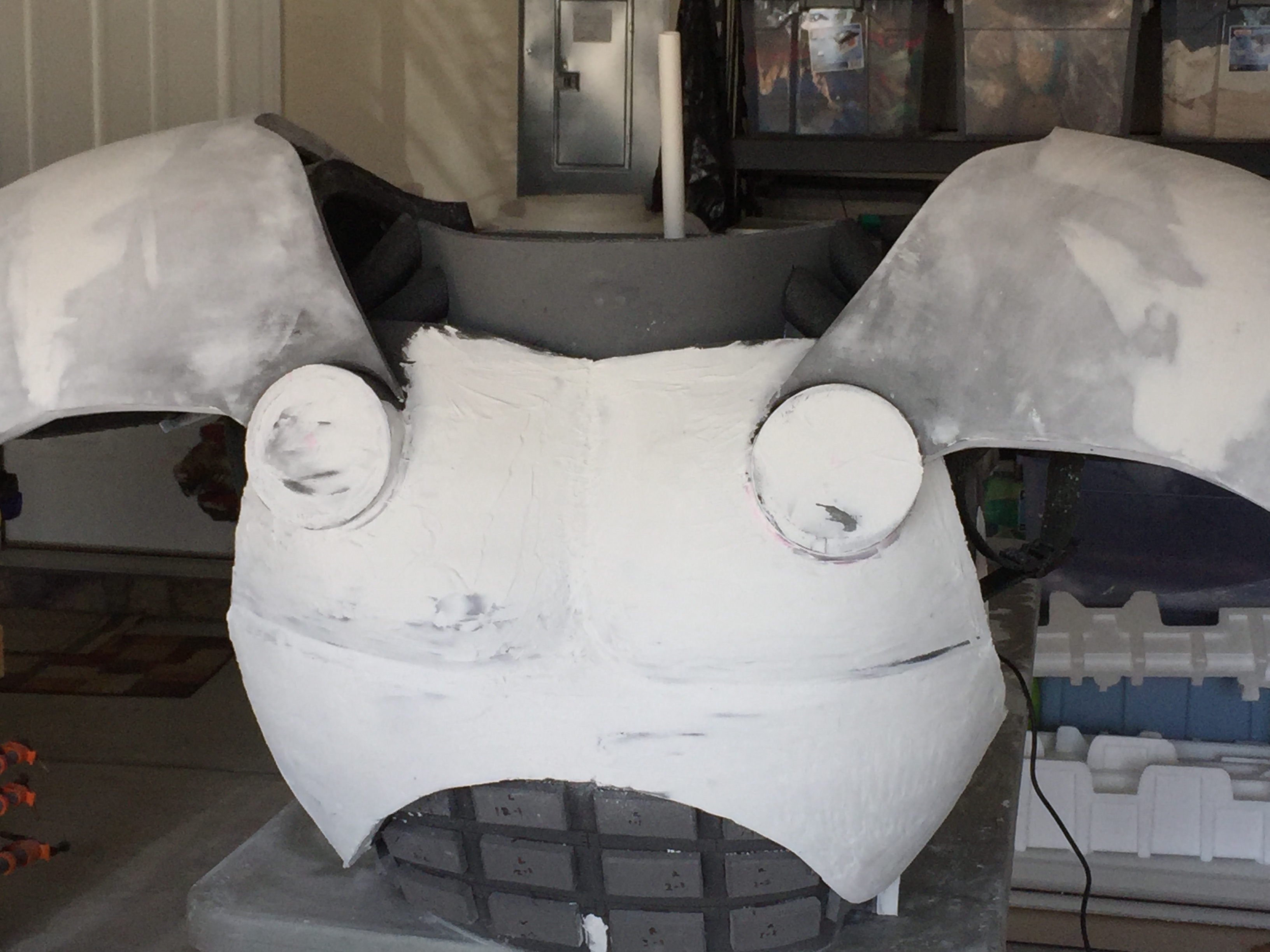

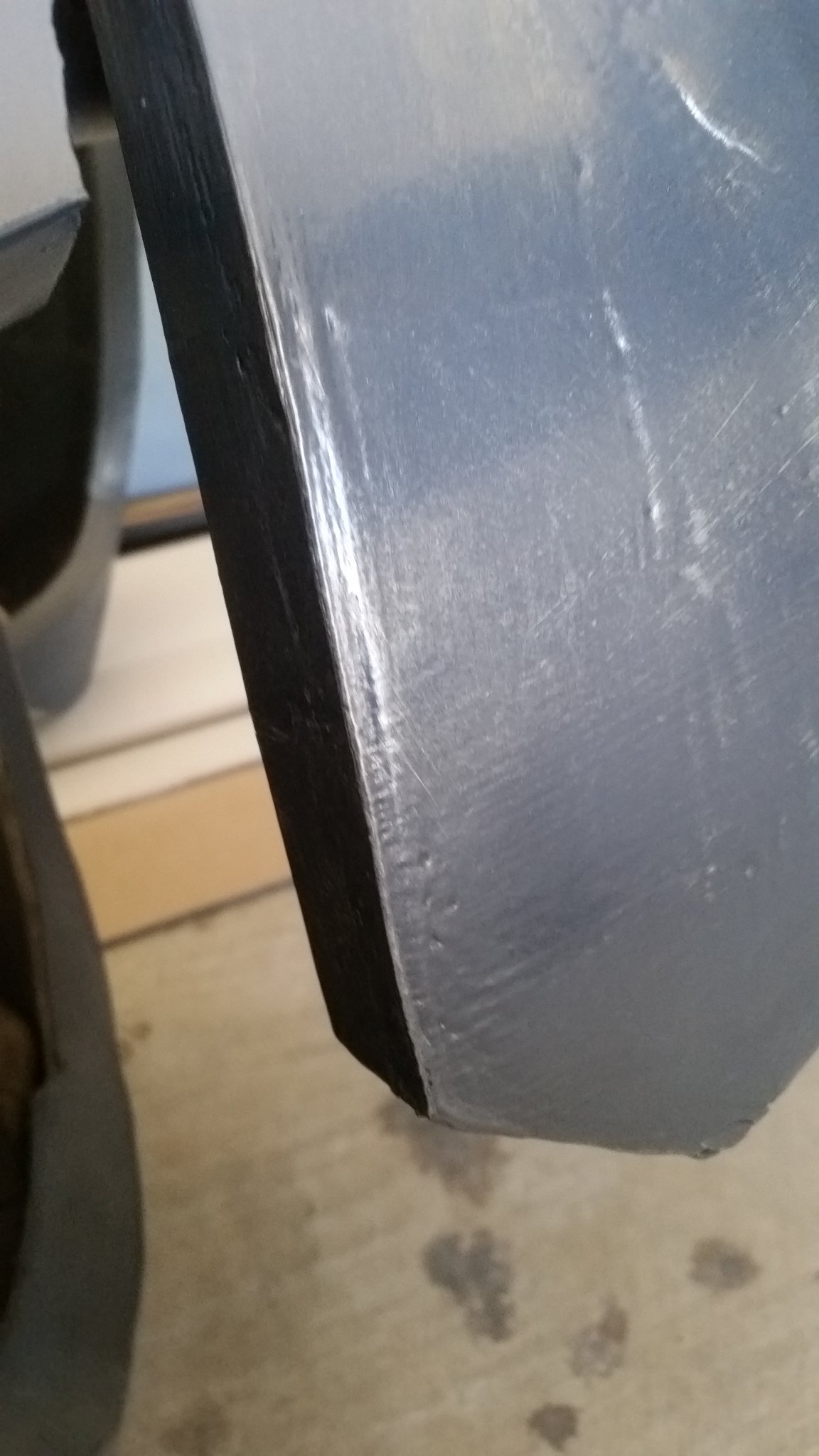

Ok, so I showed you all the test piece with the finish on it, but I don't think I ever fully explained our finishing technique for the foam pieces. As you can see, we had many many seams on each piece and some of them are horrible. Dave came up with the method of using a dremel to flatten out the sharp edges where the foam didn't necessary form a nice curve. He called this process "grinding". I'm not sure if I have any pictures of it, but the idea was to grind down the seam so it could be rebuilt into a flat or nice curved surface. We had thought to fill in the seams with latex caulk but we weren't sure how it would work with the epsilon. So Dave had some drywall mud lying around that created nice lovely flat surfaces and sanded really easy. It filled in the foam seams really well. But we were really nervous about it's fragility and if it would just crack to hell once the epsilon was on it. So we tested that one shoulder bell you saw and it worked out pretty great! The epsilon could have mild flex without snapping and I even punched it once and it barely did anything.
We epsiloned using a Urethane filler called URE-FIL11 to make it thicker however. This created a solid piece of armor that felt great and was sturdy. WE DID NOT DO THIS ON THE FINAL ARMOR. This is one place were I feel like our biggest lesson learned was. We were so concerned with the texture of how the thickened epsiloned set (it was really rough and would need a lot of sanding) that we decided to just use straight epsilon on the final product so that the surface would be smoother. It turned out, it was our brush and layering technique that needed work, not the thickness of the epsilon. So we applied the dry wall mud and thin epsilon coat to the whole armor. And it looked beautiful! I'll show the pictures in a sec. However, because we didn't use the thickener on the epsilon, we probably needed to do like 3 or 4 more coats to get it to the "safe" thickness for the drywall to not be an issue. So due to the time crunch, there are a few pieces of the armor that are in high flex zones on the suit that cracked after the contest. The belt and the calves and parts of the thighs and some of the collar. I tried fixing it with e6000 and that seems like a nice temporary fix, but I would not recommend using the drywall mud anymore. The process was a nightmare for how fragile some parts ended up. However, the armor did still hold up rather nicely, I'm just a little worried about it's long term durability.
So onto the pics. I don't have a lot of this process because we were pretty much out of time now. We had like two weeks to do this:
There's the chest with the nice flat surface now.
You can get an idea of how it worked though.
Another shot. Sanding this stuff took way too long.

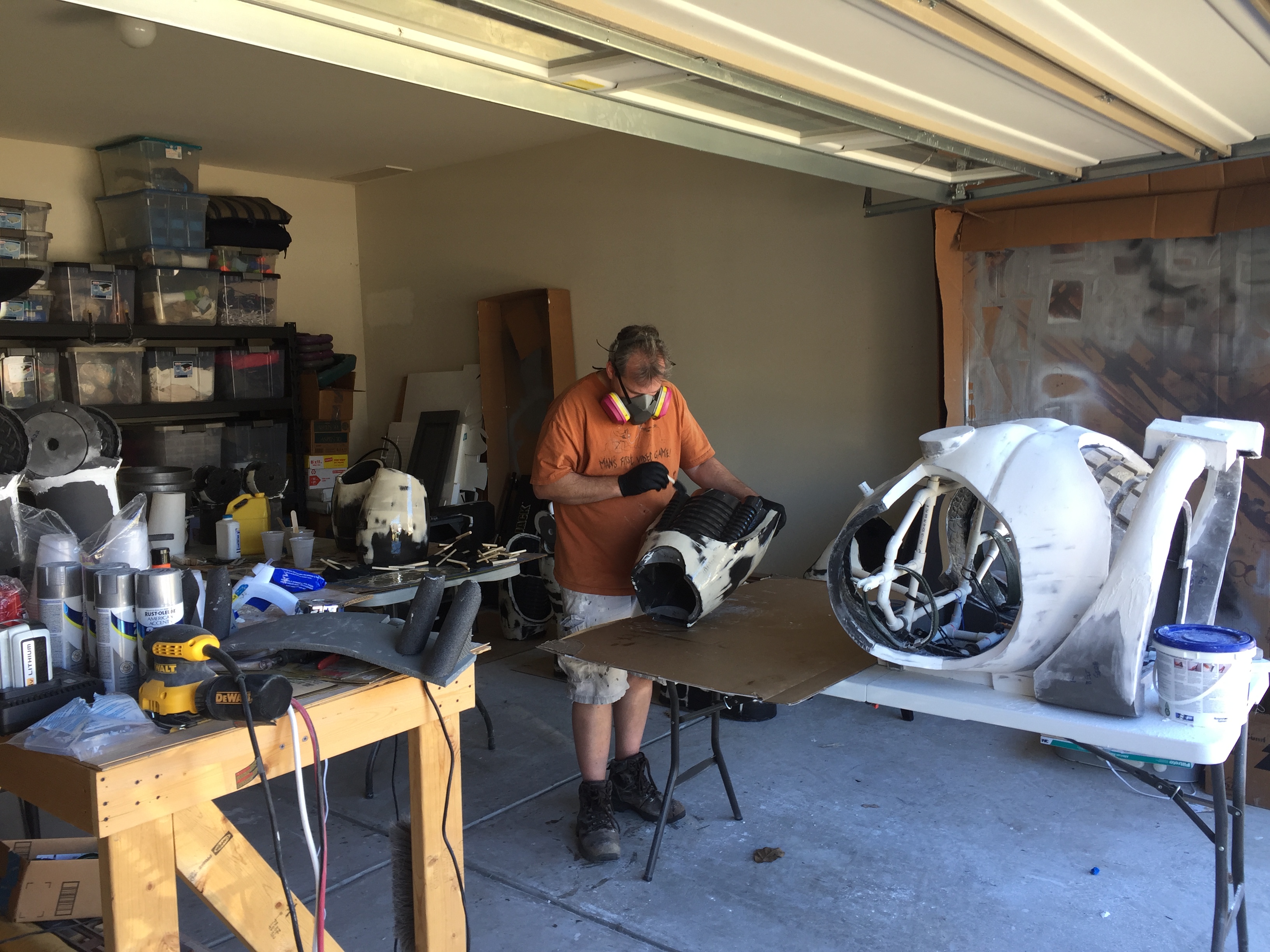

Jetpack with the seams filled in. You can also see the canning funnels I was talking about being fitted as the jets.
Another shot of the jetpack
And Dave sanding!

Anyways, the next steps were to epsilon the armor pieces and hope we bought enough of the stuff. Turns out a little bit of that stuff goes a long way, we only used one of the gallon units we bought for the whole armor. Though like I said in the earlier post we probably needed to do some more coats so I'm not sure if I can be that happy about it. It's much too thin in some places and the drywall coating we did is too brittle for it not to be rock solid. I'm definitely worried about the longevity of some of the higher flex pieces, but it is what it is. The armor survived being worn three or four times, a trip across the stage at SWCO and two trips in the back of a uhaul trailer from South Carolina to FL with just a few minor cracks on the belt and calves. We definitely need some way to patch the cracks though, as I'm worried it will start to chip off otherwise.
So, I don't have any pictures of the epsiloning process because it requires gloves and masks and lots of stickiness. If you are interested in the process, definitely look up how to do it with the URE-FIL filler, as it makes it much more sturdy. I really really wish we used it in the final armor, but you live and you learn. Though, epsilon definitely is cool stuff, it makes a nice glassy hard surface on the foam.
The process itself was rather easy. Get a few plastic cups and mark them A and B. Measure out the parts of A and B of the product that it instructs you to. Mix it for as long as it instructs you to. Then we applied it very thinly with foam brushes, which you'll want to have a TON of, because you won't really be able to reuse them. Wait for the coating to get "tacky hard" and apply another until you're happy with the overall result. The instructions say one reapply is enough, but I can't imagine how. It might have been fine on just the foam, but we were also trying to seal in the filler, which might be why our situation was different. Again, find something else to fill yours with if you decide to do this process, the effort is not worth it for the long term durability. It sure does look nice though...

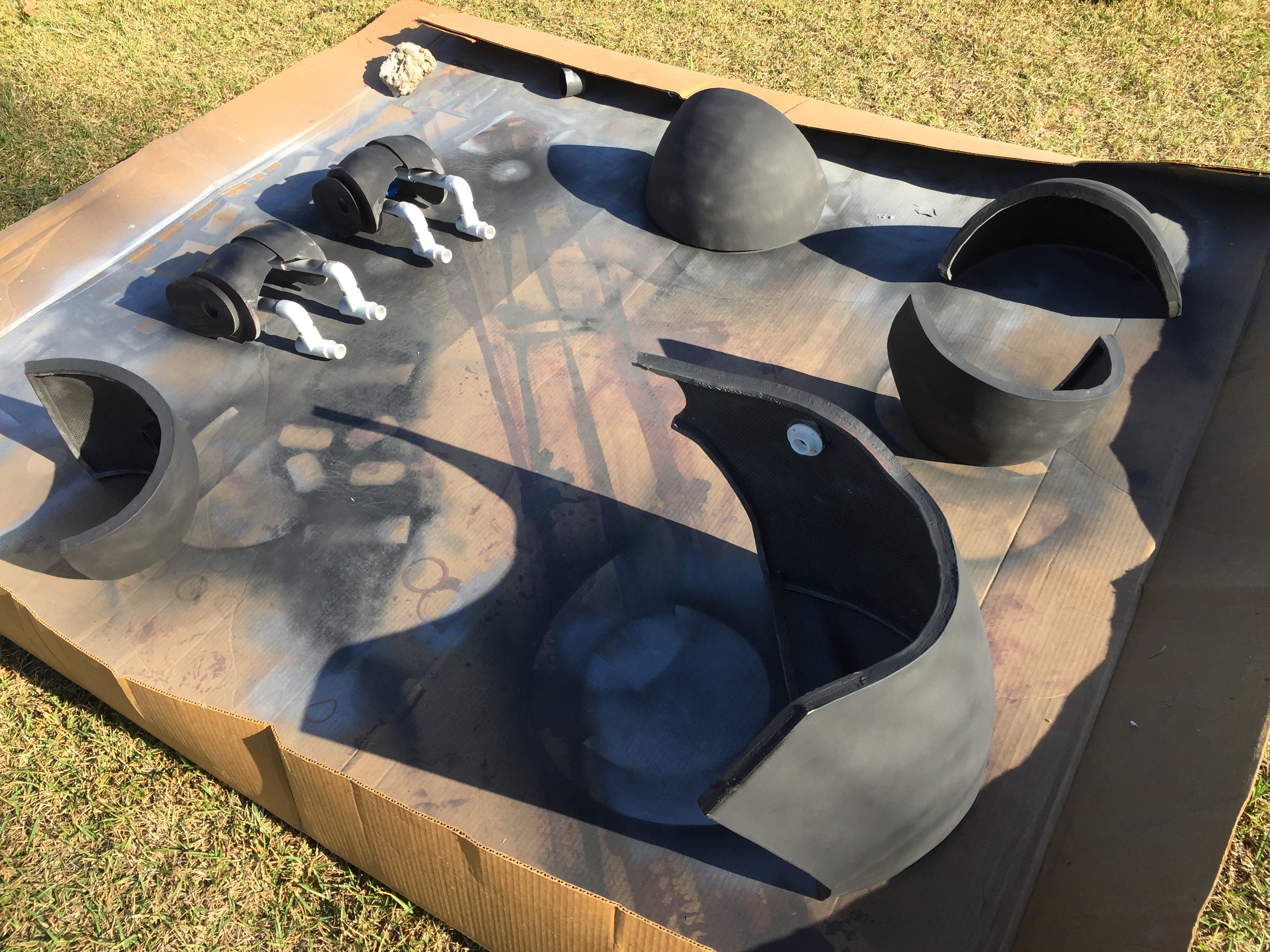

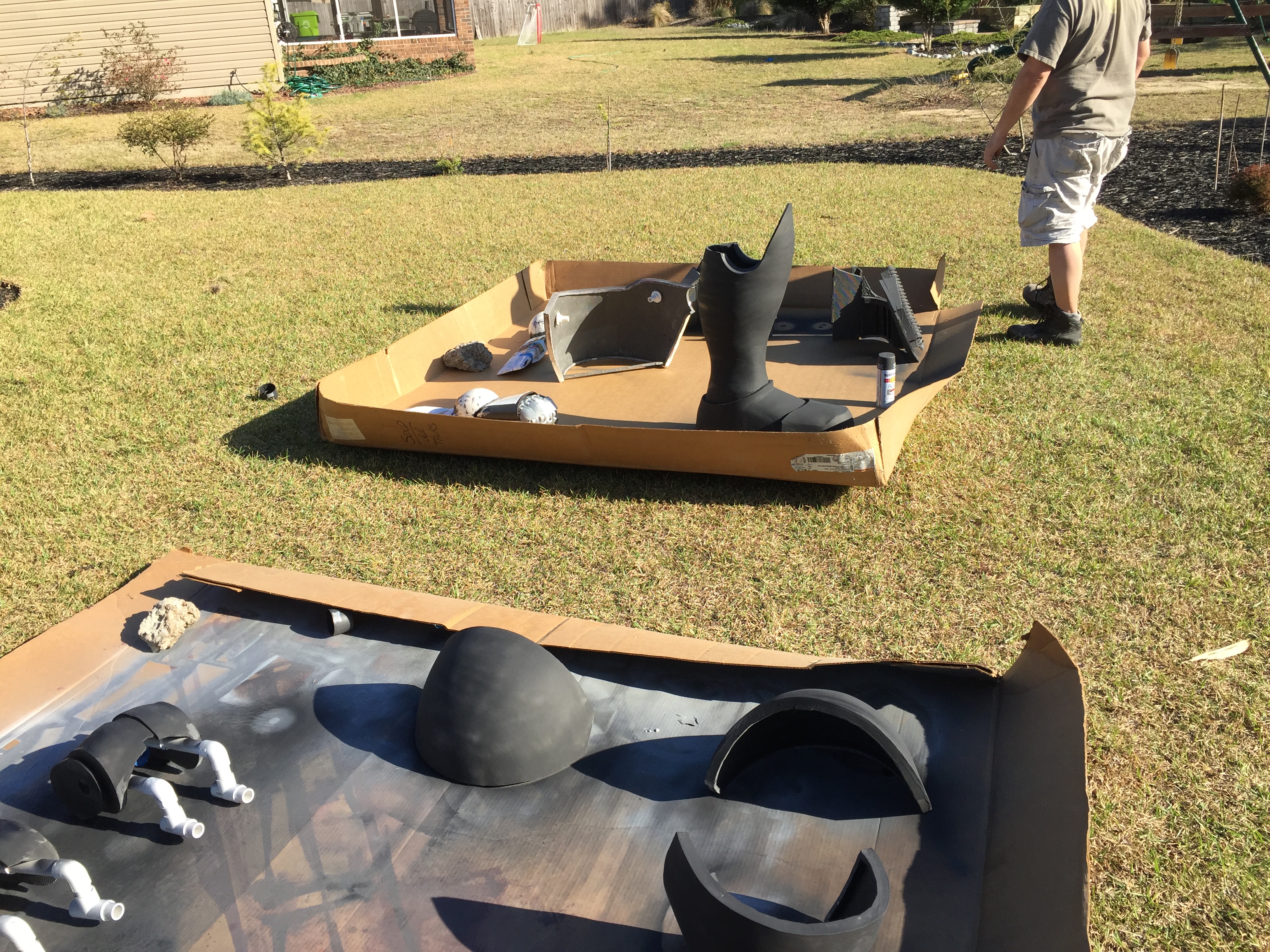

So, here's some pics of the painting process.
Primed everything with a flat black primer.
Silver parts got their own palette.

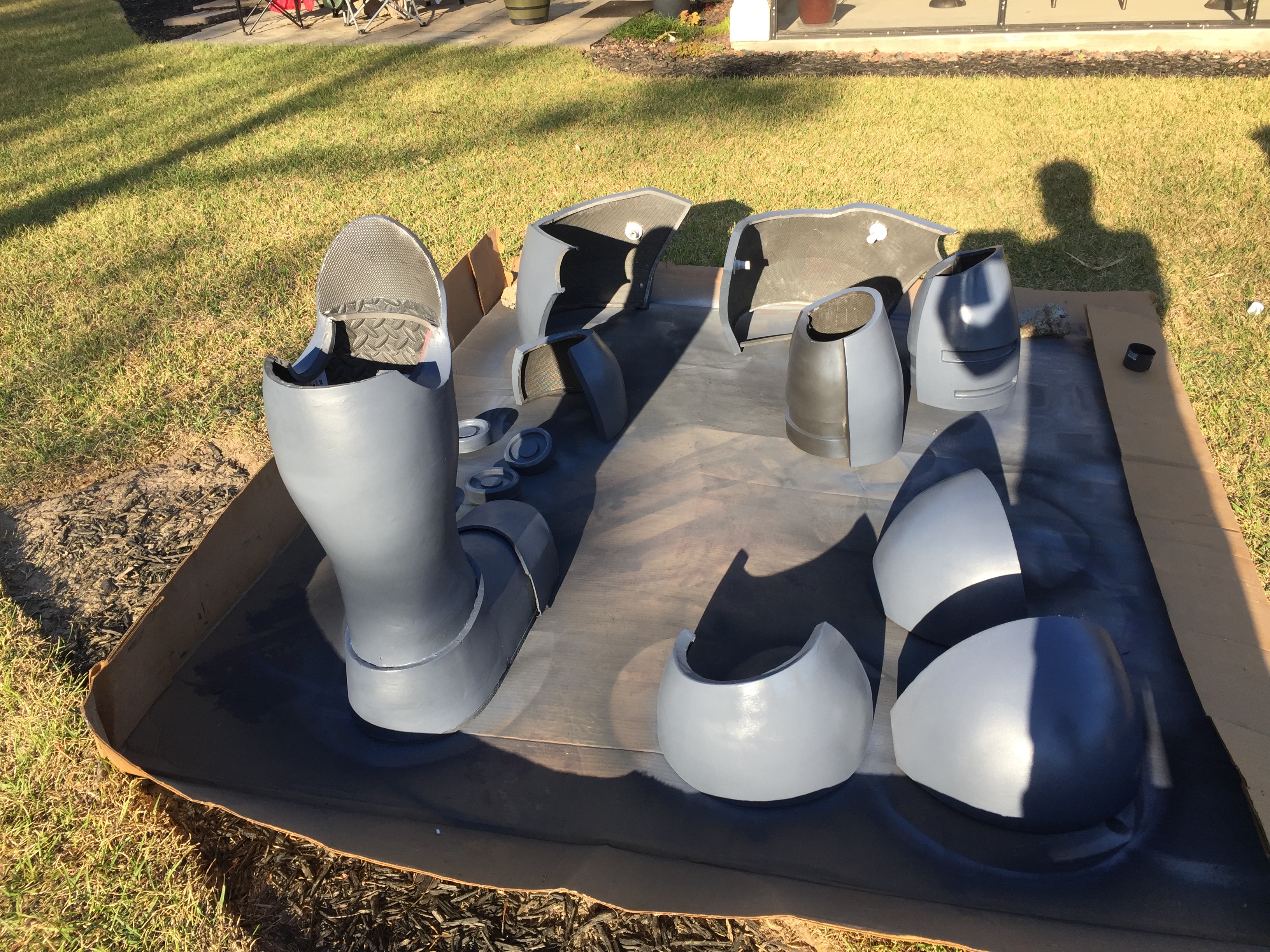

And started painting the body color pieces.
There was a few pieces we had to tape off and paint in waves, like the gauntlets and the helmet and the chest abs that you see up there.

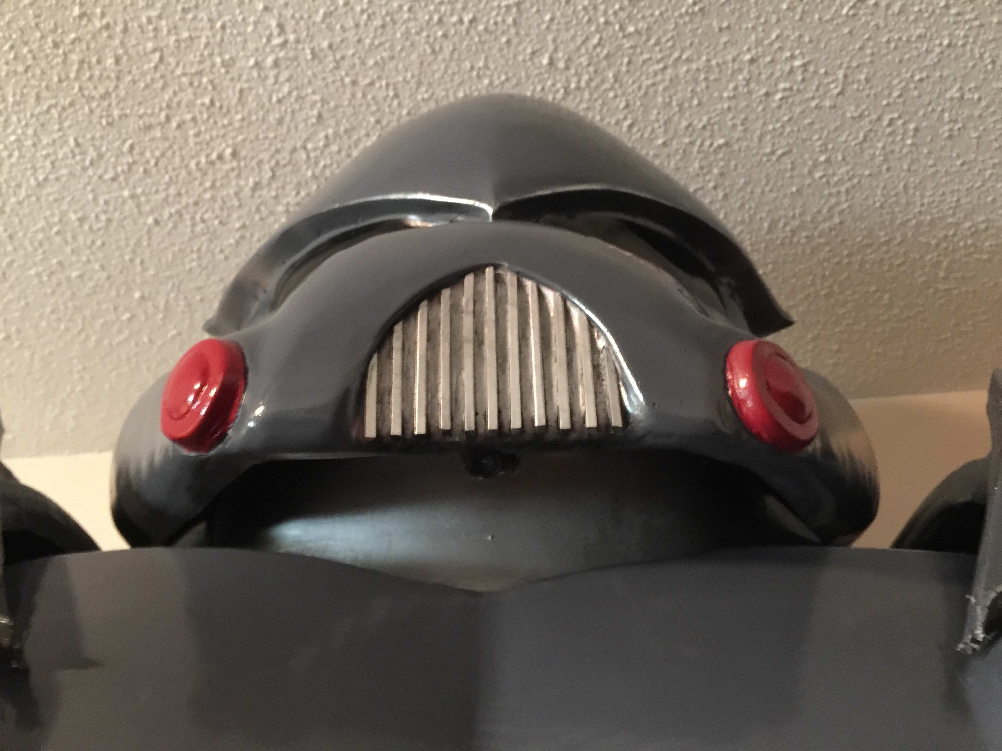

Like so! It's the little tiny black thing in the chin area right under the front "grill". You can also get a good look at the neck piece that we created to cover up my face. That's the resolution to the "floating head" issue I mentioned a few posts back.
