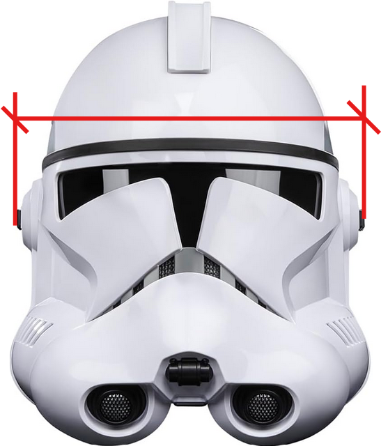

Hi, I need to know the exact size of a Master Replicas clone helmet. Either distance from ear to ear or the width of the eyebrow ring... something like that. Or even the overall width of the helmet if you are able to measure it.
I recently made a 3D model of a wearable clonetrooper helmet, I'm really happy with it and I think it's one of the most accurate out there. But... I don't know the "correct" size. Obviously, when I'm 3D printing it, I would scale it to my own head, but of course I want it to be as close to the original as possible. So if any of you have the Master Replicas or Denuo Novo helmets at home, can you please measure them and post the measurements here? It would help me so much. Thank you.

Hi Woyta94, great 3D model! It's a very good match to the Master Replicas version of the helmet.
I was able to measure the Master Replicas helmet and got these measurements:
Width at the tips of the ear cap detail: 26.8cm
Width at the lower widest part of the helmet: 27.5cm
Black brow width: 22.8cm
Height from the top of the mohawk down to the very bottom of the helmet under the chin: 33.5cm

Thank you so much, finally someone able to share the information. Looks like I actually pretty much nailed the size, my model is 27.7cm wide at the widest point and the brow is 22.9cm, I'll make it just a smidge smaller then. Thank you for this valuable information. If anyone has the Anovos/Denuo Novo version, that would be even better, multiple sources are always good.
