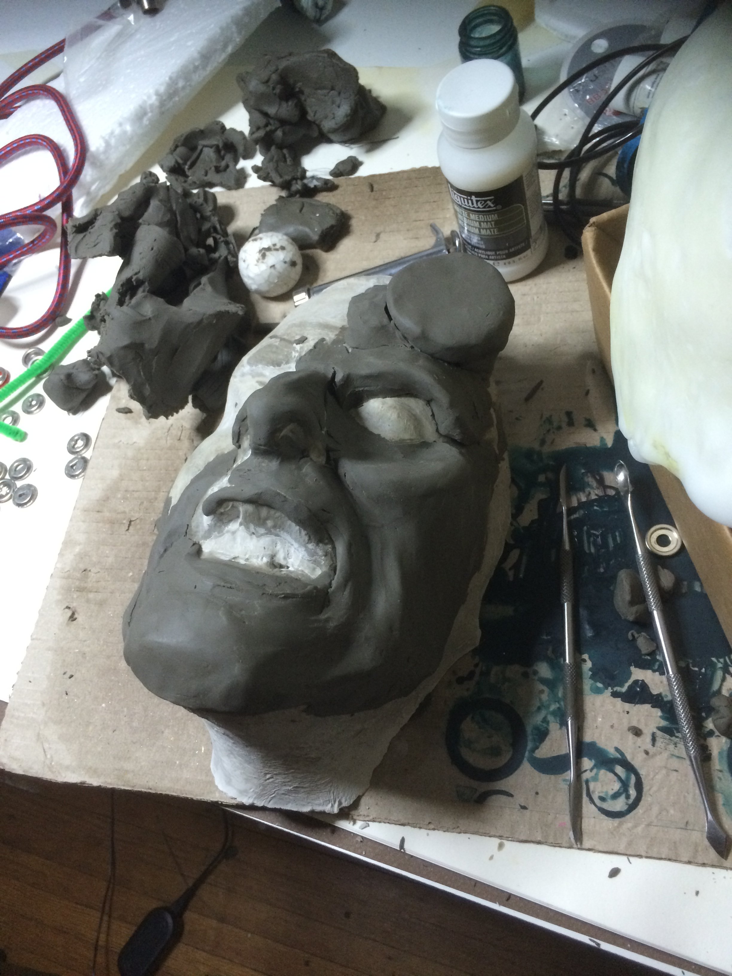

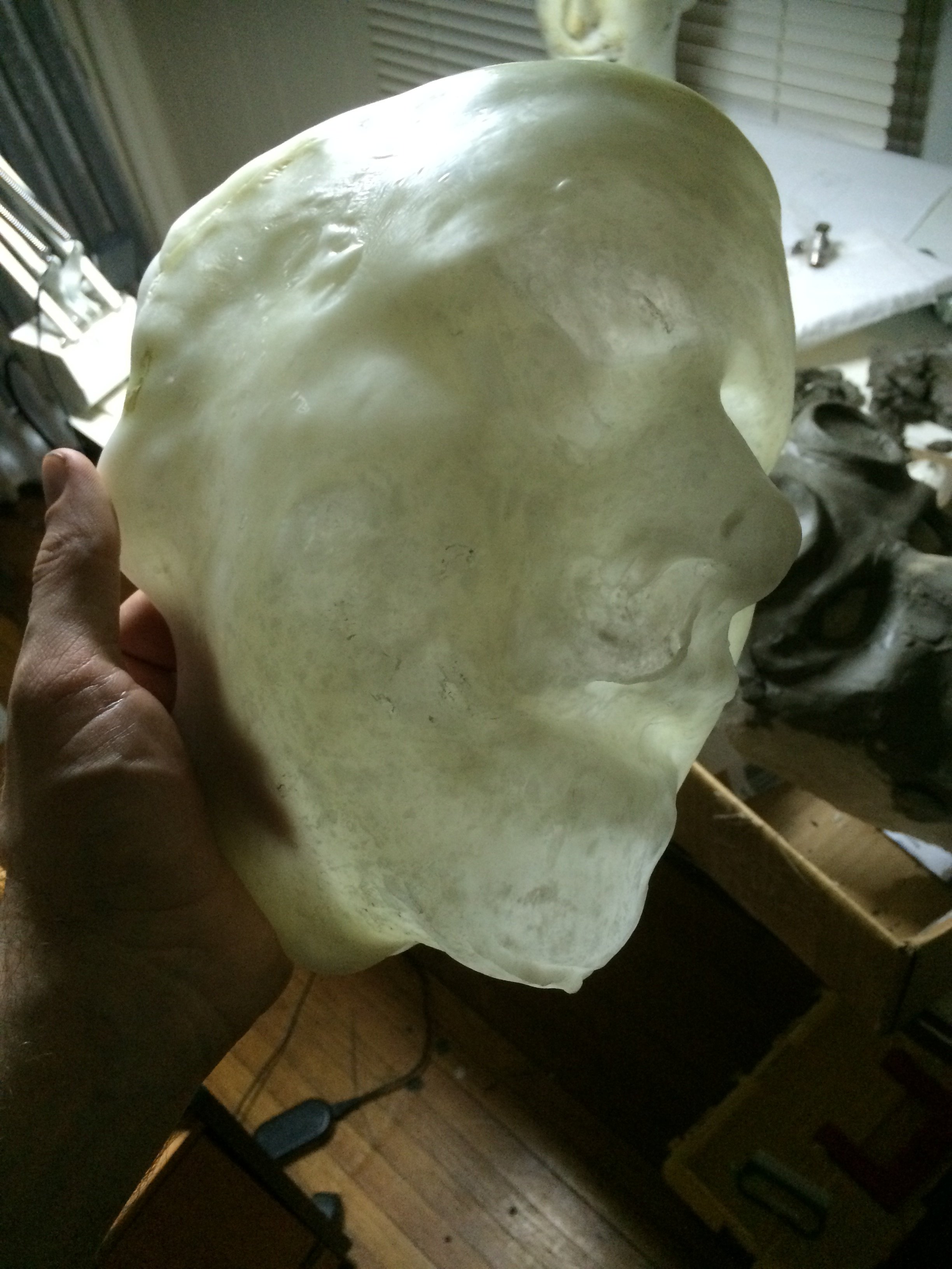

im using moldable "fun-plactic".
its nontoxic, reusable and has he the capacity to capture hair and wrinkles.
the problems with using moldable plastic are:
its hot while workable so don't burn yourself,
while soft it bonds you other plastics,
it gets plastic hard when it sets so you could easily lock you head it,
it doesn't cut or puncture easily so your air holes need to preconceived and practiced,
it heat sensitive so compounds that get hot and especially scolding with warp or soften the negative.
nonporous surface means you'll need to spread the casting material around until the casting material sets
