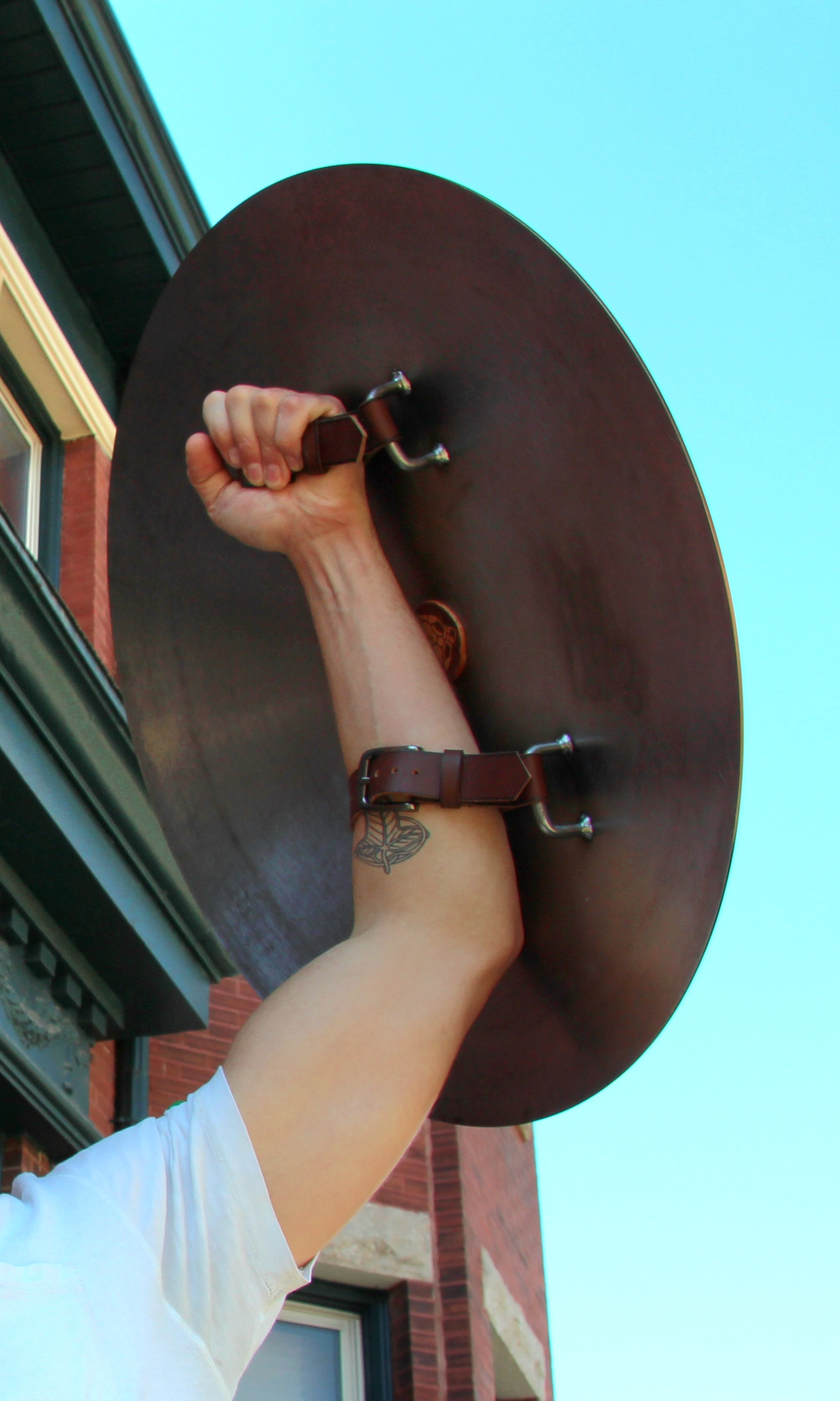

Final shots! Went over everything with a clear enamel to prevent rust and another round of steel wool. Didn't do much with the back of the shield as this ended up being a wedding present and there was a deadline closing in (also forgot to take pictures of the back before giving away). Welded the brackets on earlier in the build and finished up come leather belts for straps.
Very pleased with how it turned out. Lines are clean, colors are great, but it is VERY heavy. Would love to try again with a thinner stainless steel disc, may be able to get ahold of a vessel head fabricator in my line of work, but that will be costly.
