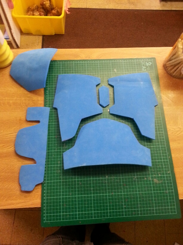

I've made a start on this as I had a roll of foam left over from my trooper build, waiting on more foam until I can progress now.
20131213_111727_resized.jpg20131213_111740_resized.jpg20131213_143201_resized.jpg20131213_155509_resized.jpg20131213_155552_resized.jpg

I expect boba armour to be really easy, other than the jetpack, gauntlets and cod the rest should be simple print and cut with no gluing required. I'm not planning on using pep files for the rest of the armour just basic templates.

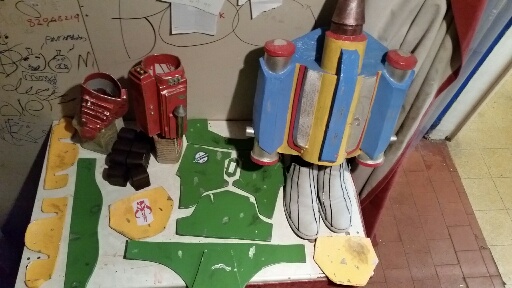

Basically when I started this almost 2 years ago I got as far as cutting out all the flat armour pieces and painting the jet pack. I also bought almost all the parts I needed for the soft parts of the costume.... then I put it all in a box threw it up into the roof storage in my shop and left it there until last week.

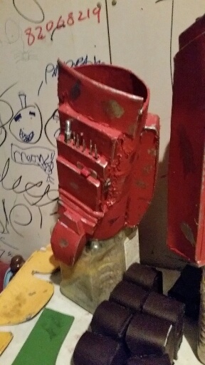

I went to work Tuesday found the box had a look what was inside laid it all out and worked out exactly what I still needed which was green paint, glue sticks and the ammo belt, and the gauntlets, I had to come up with a quick way of scratch building some semi decent looking gauntlets.

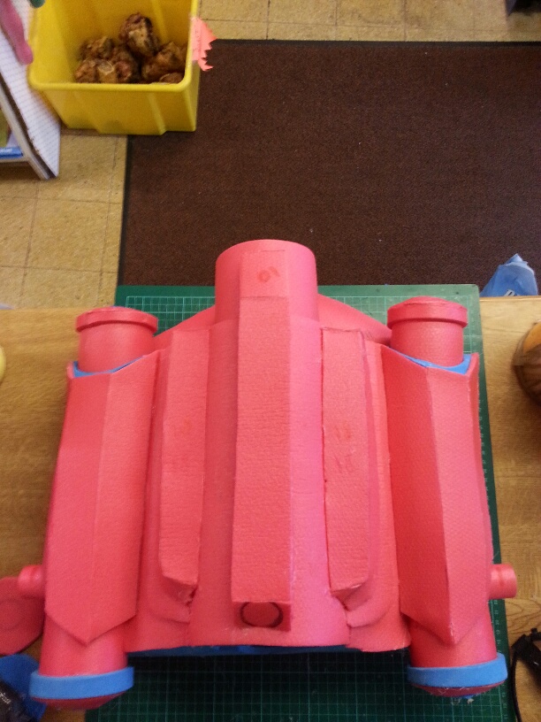

So Wednesday I get out the paint and start painting everything, I managed to dry 3 coats in which turned out to be enough. I didn't go to the trouble of sealing the foam with PVA just went straight on with paint.

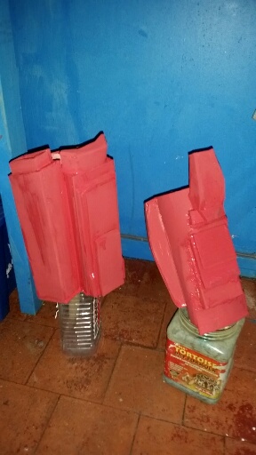

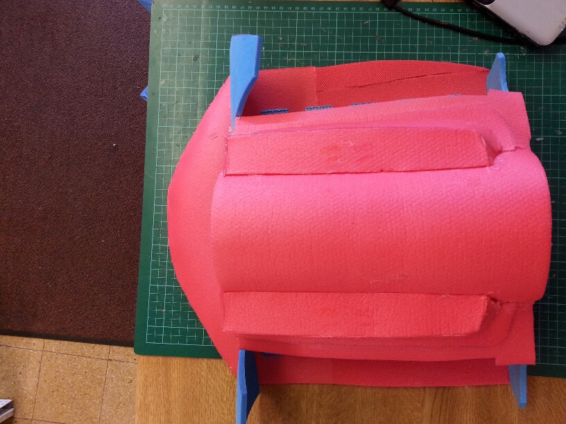

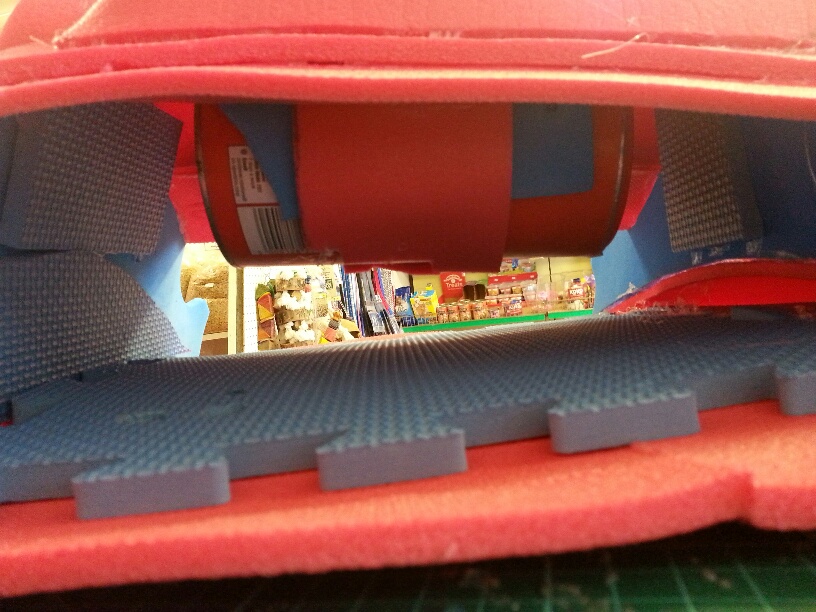

Once this was done I decided to start scratch building the gauntlets inbetween waiting for paint to dry I started with two of these animal play chubes which were for sale in my shop, they just happened to be pretty much the exact right length and fit on my forearms just right.
I messed around with pieces of foam and card until I got what I was going for, they're in no way accurate but they're good enough for this, I managed to build them in enough time to get two coats of paint on them

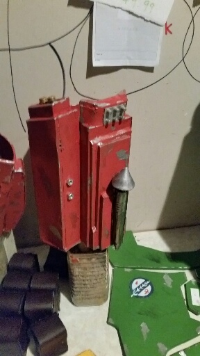

Friday day was weathering and greebles for the gauntlets (just using anything I had lying around, an old remote control, pens bolts, screws and some copper pipe).

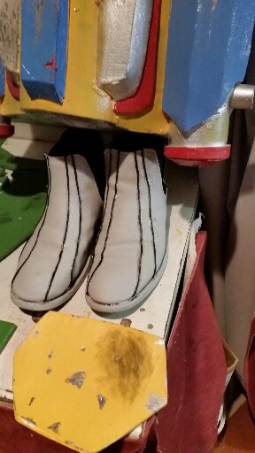

I also brought some old Chelsea style boots I had at home which the sole was coming off of, I decided to fix the sole, paint the boots grey and then glue black shoe laces onto them.

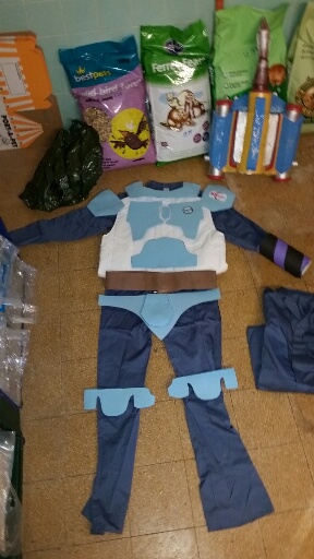

The flight suit I havent really taken a good photo of right now, in all honesty the colour is way too dark of a grey but I figure I can correct this in the future if I wanted and then use this one for a Jango costume or something.
The the suit I had two pairs of regular grey mens overalls, Cut these up to make one accurate(ish) flight suit.

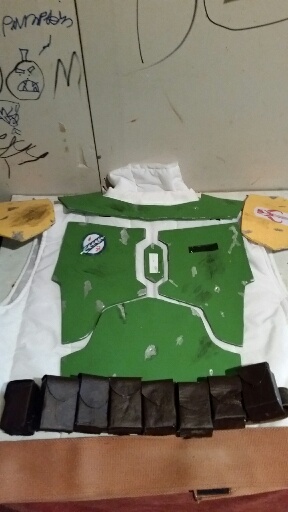

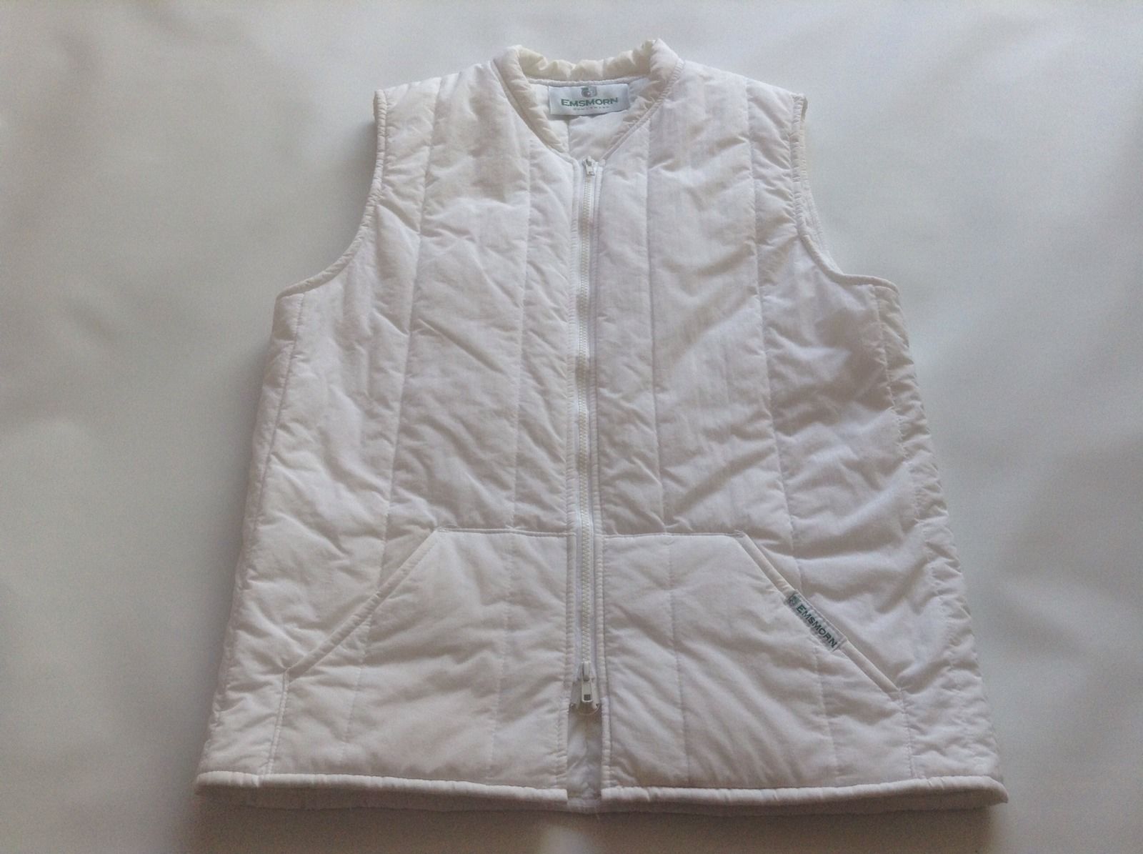

For the flak vest back in 2013 I bought a white Body warmer vest jacket I cut the bottom off of this so it was the right length and used the excess material for the neck seal and shoulders
And that was basically the build complete other than gluing velcro onto all the armour and vest and some sewing some clips on the back of the vest for the jet pack.
I had built cut out the back armour in foam but because I was using the jetpack I decided to leave it off. The jet pack is super light, don't even noticed its attached.

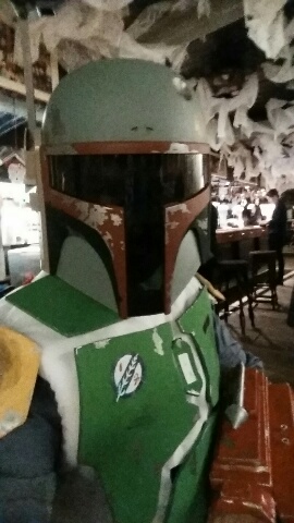

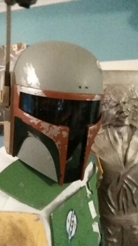

I didn't build a helmet as since I originally started the build my wife bought one of the toy ones as a gift so I was pretty happy using that as it looks much better than anything I could make from foam.

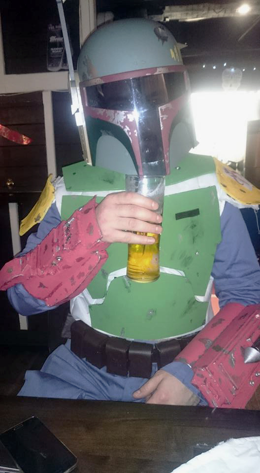

I haven't really work the suit properly so don't have many photos of the completed suit I wore it briefly at a Halloween pub quiz Monday in order to win some free drinks for the weekend in the fancy dress competition but that's all, I'll put some pictures on after the weekend.
I do have this picture but flash photography really makes the colours of the suit look odd, as they look nothing like this as you can see from all the other pictures.
