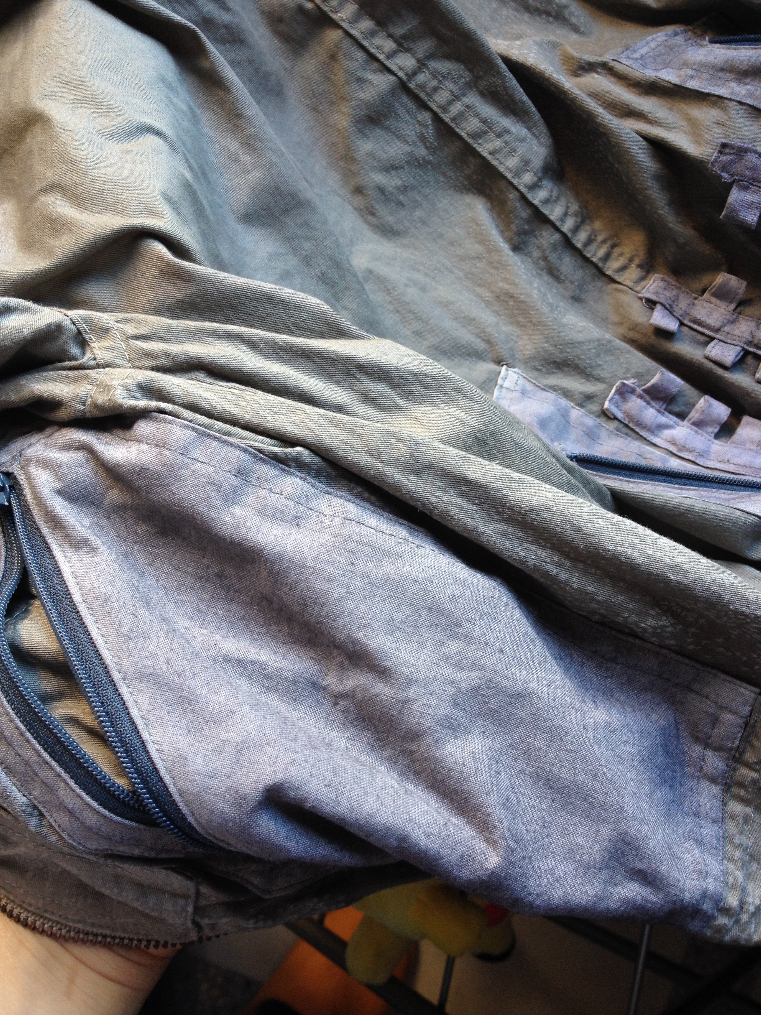

SECOND DYE ATTEMPT ​ (8/08/2015)
SUCCESS (to some extent).
I followed Rit Dye’s instructions for the colour "Country Blue”:
1/4 tsp Pearl Grey
1 tsp Teal
1 tsp Royal Blue
I bought powder dyes for all of these colours as it was cheaper at my local Art Store (£3.99 each, totally £11.97). Apparently these are the Liquid Dye measurements but I think it still works well with powder.
I then dissolved all of that in 0.9 Litres/1 Quart Water. After, I filled a basin with about 11litres of hot tap water (roughly 140F/60C). I actually ended up tipping some out because my basin wasn’t big enough and I was yet to add the dissolved dye mixture, as well as the suit. Following this, I dissolved 1 US cup of salt in 2 cups of hot water (again, 60C); added this to the basin of water too. I gradually added about 60% of the dye mixture into the basin because I was wary about adding too much and turning it too dark again. Tested it on some scrap fabric and kitchen towels. Seemed too light so I added more dye mixture. Once I added about 85% of the dye mix, I then submerged the wet suit in the dye bath and with rubber gloves on, continually mixed it and moved it for about 11mins. Then rinsed it out with warm water before hanging to dry.
Definitely close enough to the colour I’m aiming for. It's a lighter version of what you see in this photo:
Although more teal than blue, I’m pleased with it as is, considering the amount of trouble I went through to get it to this point and what the original colour of the suit actually was. Plus, it's sort of in the middle between khaki green (which is supposed to be the original colour of the G-4B or the piece in the film) and the blue that's been heavily debated so that's a good half and half. I probably could have done with leaving it in the bath for longer though, maybe another 5-10 mins for it to go a little darker but I really didn't want to risk it. Anyway, the lighter look makes it look a little worn, and I could always mix up some dark dye to create 'stains':
Again, pockets are still light but not too painfully bright, more of a lighter, bluer hue than the rest of the suit. I may go over it with some grey-teal dye as I have some dye mix left over and quite a lot of powder left (good for the money!) but to be honest, it won’t need too much work. I’m pretty certain I can have the patches on and the suit distressed and ready by Tuesday. Hooray!!

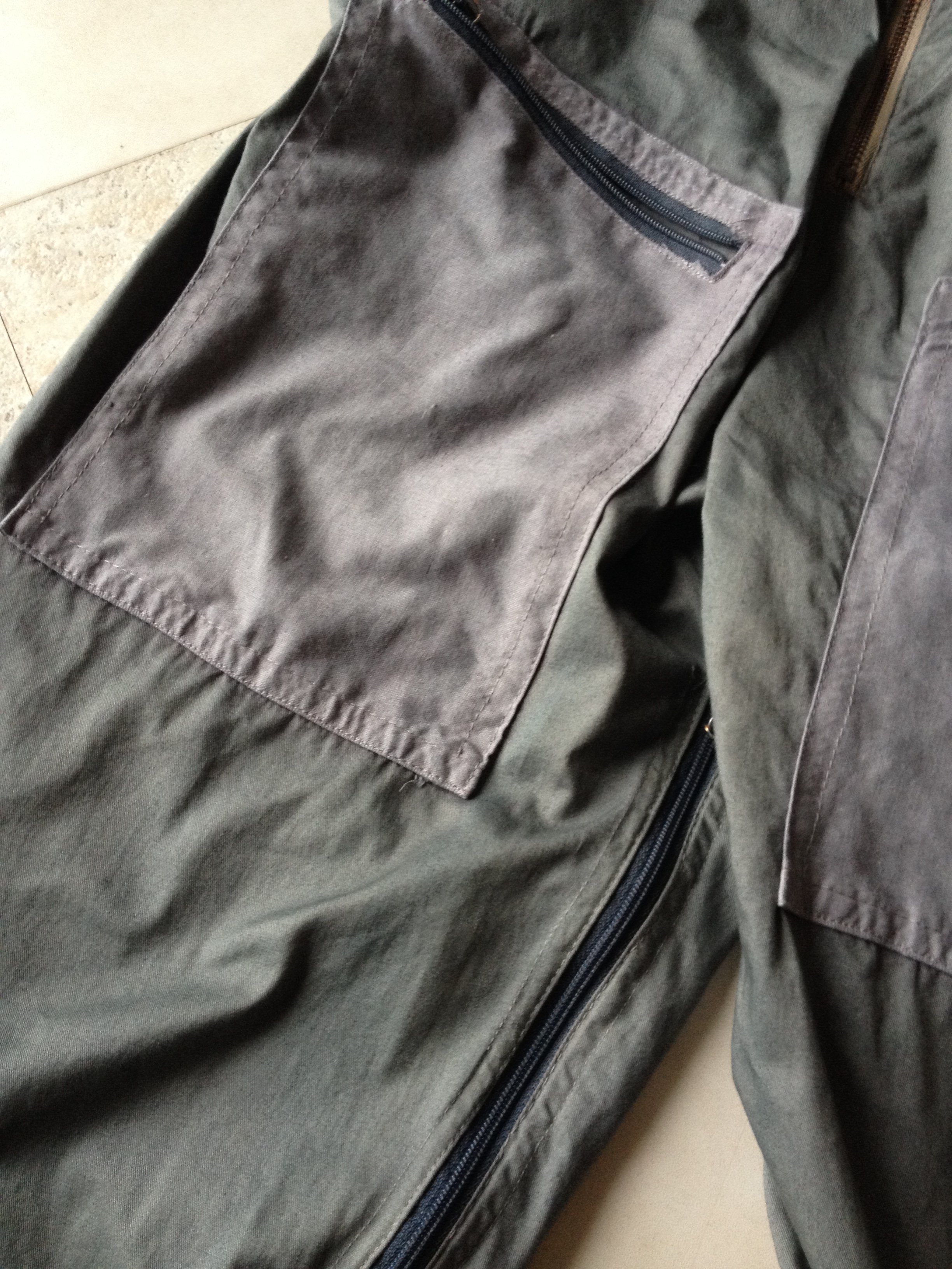

FINAL WASH (9/08/2015)
Here are some photographs of the final wash being applied, having done one already after the full dye. You can see the difference between the dry fabric with one wash and the fabric wet with a second wash.
Pocket wet with second wash, noticeably more teal. Here's hoping it gets as close to the suit as possible.
Once that's dry, I'm ready to lace up the back and sew on the patches!
