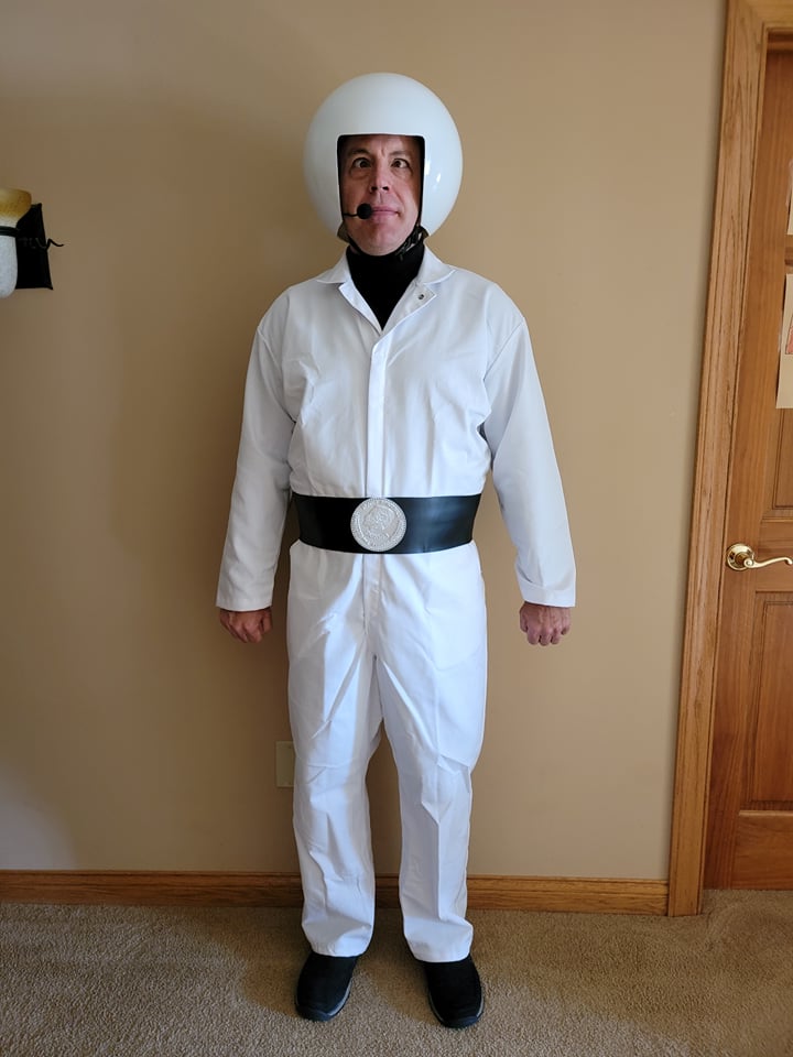

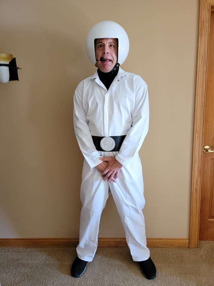

much better improved version...thanks for the tips!!!
Looks good!
The crack comments are on point. But I wanted to mention that if you look at the reference photo posted at the beginning of the thread, you notice the corners are not square, but have a fairly large radius to them. Quite possibly for the same reason, but either way, a detail worth mentioning.
But otherwise, it looks awesome! I just watched this again the other night (hard to believe it’s from 1987!!) and I still enjoy it. Mel is a genius.
