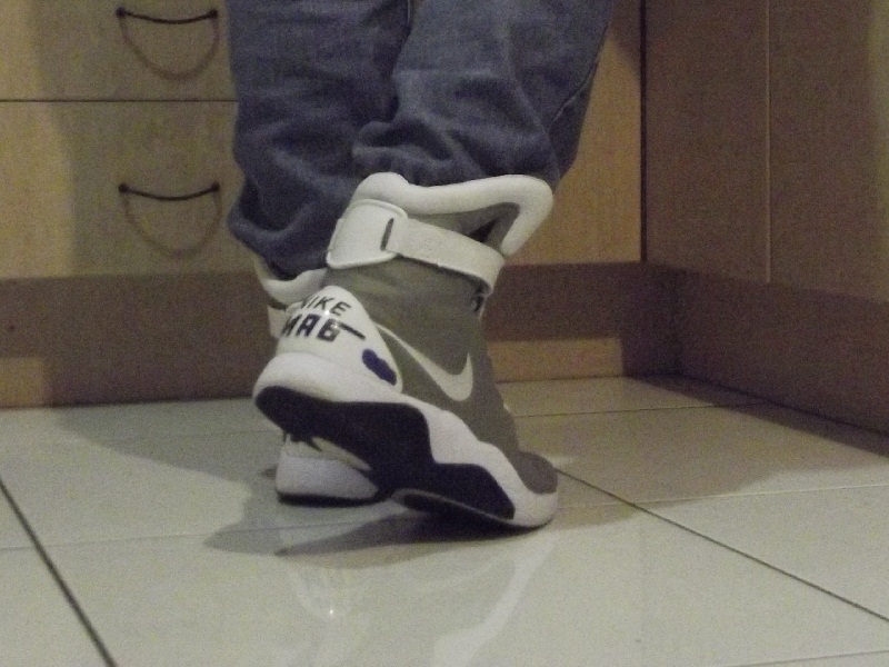

Paint is dry and the tape has been removed :) Like the size 8s I did yesterday, there was some bleeding that needed cleaning up. Overall I am pleased with the result. I am wanting to darken the soles slightly. I think that they are too bold in white against the darker grey. If the grey was a few shades lighter, this would not be an issue.
The MAG shoes and BTTF II inspired tube bag
attachment.php
Adding some flash to show off the bling [reflective tape]
attachment.php
And my first wear
attachment.php
