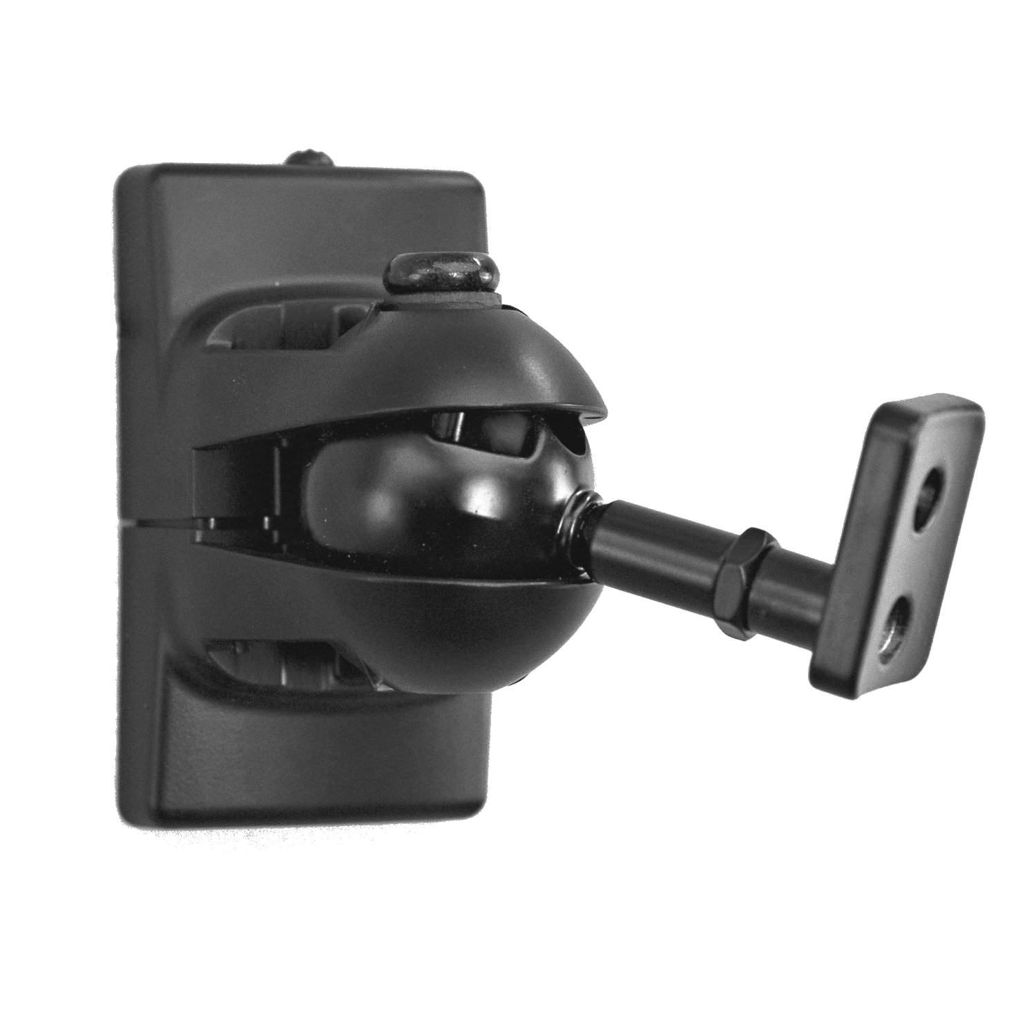

The plan is to use a pair of these
which will be mounted to the chest's rigid shoulder straps. The large side will hide inside the shoulder itself. Those are wall mounts for speakers which, by the way, I am very proud of myself for finding if I do say so myself. ;D
I chose these because they have angle restrictions. Vertically it can only rotate between the two "cups" which hold the ball joint (what is that, like 30 degrees?), but it can rotate 180 degrees horizontally. This allows me lots of movement forward and back with my arms, but with less risk of smacking my helmet with the shoulders when I lift my arms. It also means that when I put my arms down the weight of the shoulders should rest on the joint and not my arms. Bonus: the big fat side has a slide on the back which means I can easily lift the individual shoulders off their mounts to detach them, versus having them permanently mounted to the chest armor.
Amazon.com: Pinpoint Mounts AM30-Black Universal Wall Mount for Home Theater Speaker: Electronics
That looks like a solid idea. I may need to expand the shoulder straps on my chestplate just a bit to provide adequate clearance inside the pauldrons, but I'll give it a shot. Thanks!

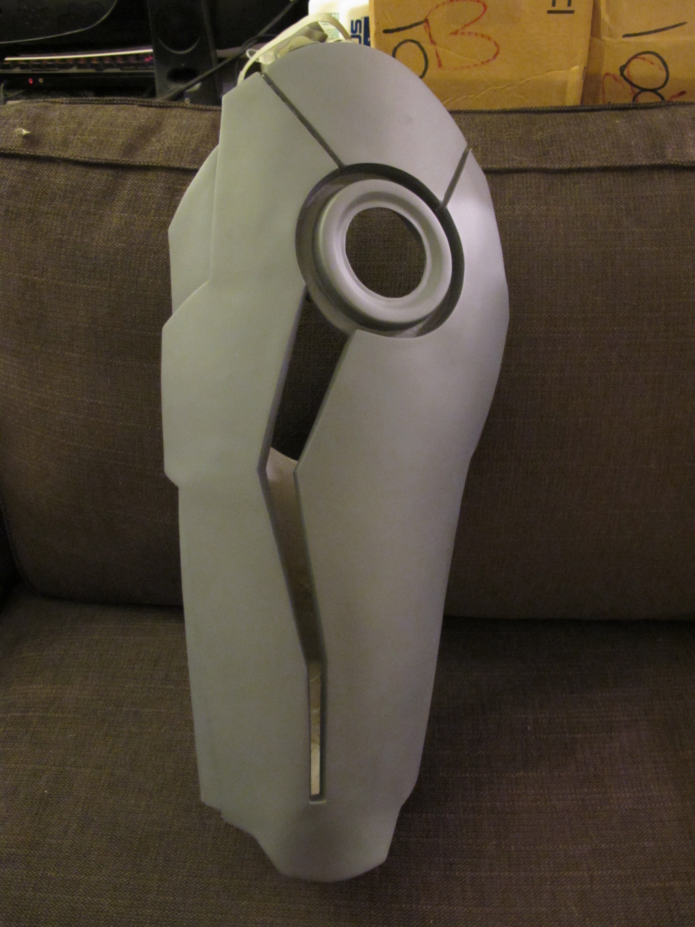

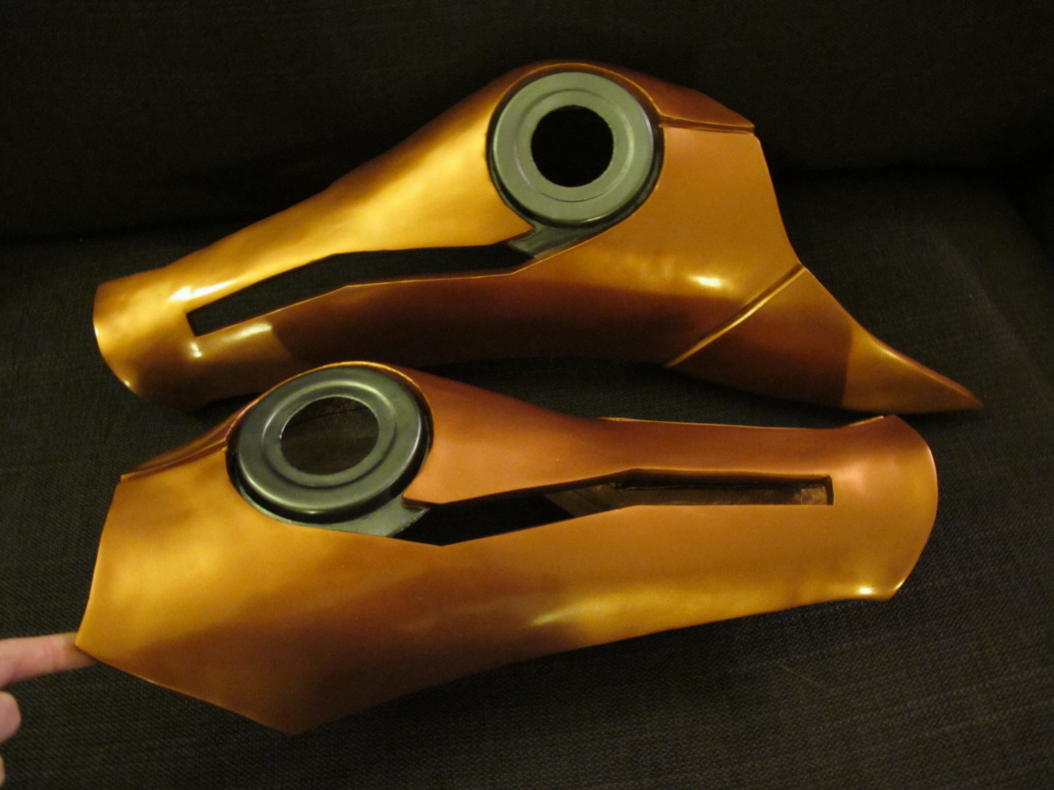

I finished epoxying the first shin and sanded it and I'm almost done with the second one.
The first shin:
The second shin:

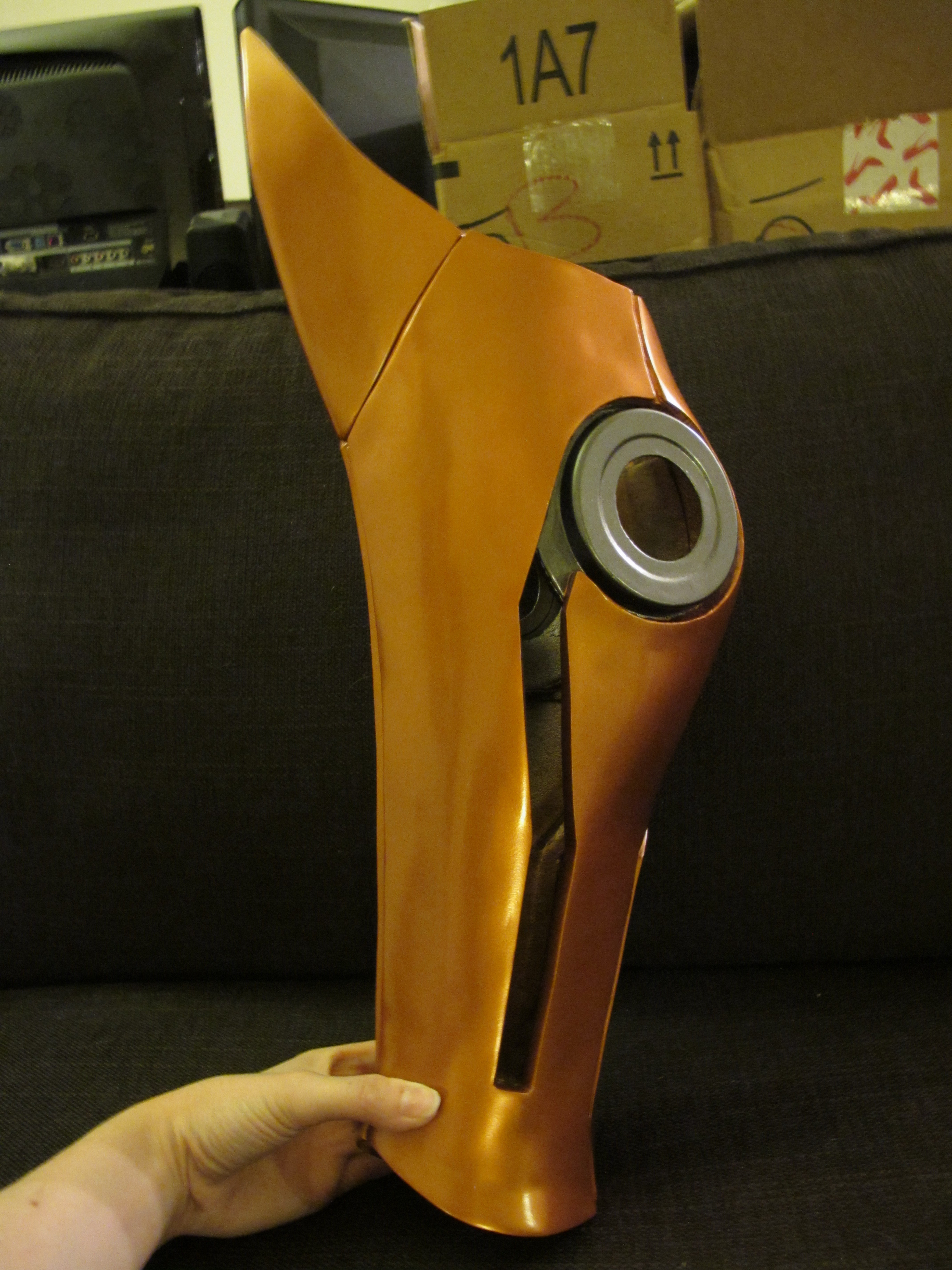

The first one has also now been painted! Sooooo prettyyyyyy...
And of course I just had to put my sample piece of EL tape in it just to see, even though it's the wrong width. :3
It's not quite as smooth overall as I wanted (there are slight wiggles across the surface which are more visible in photos than in person) but I'm fine with it at least for now. It's totally acceptable but maybe after this whole project is done I'll go back and even it out a bit. If I had the time I could have made it look even better but it wasn't worth it.
It's also obviously missing the dark gray paint on the circles and the detail paint.
Those Dupli-Color touch up spray paint nozzles suck so much... I had to sand, wet sand, and repaint parts of these so many times to fix bubbles and splatter and crap. I don't get it. The tall enamel Dupli-Color cans spray great but not these. :/

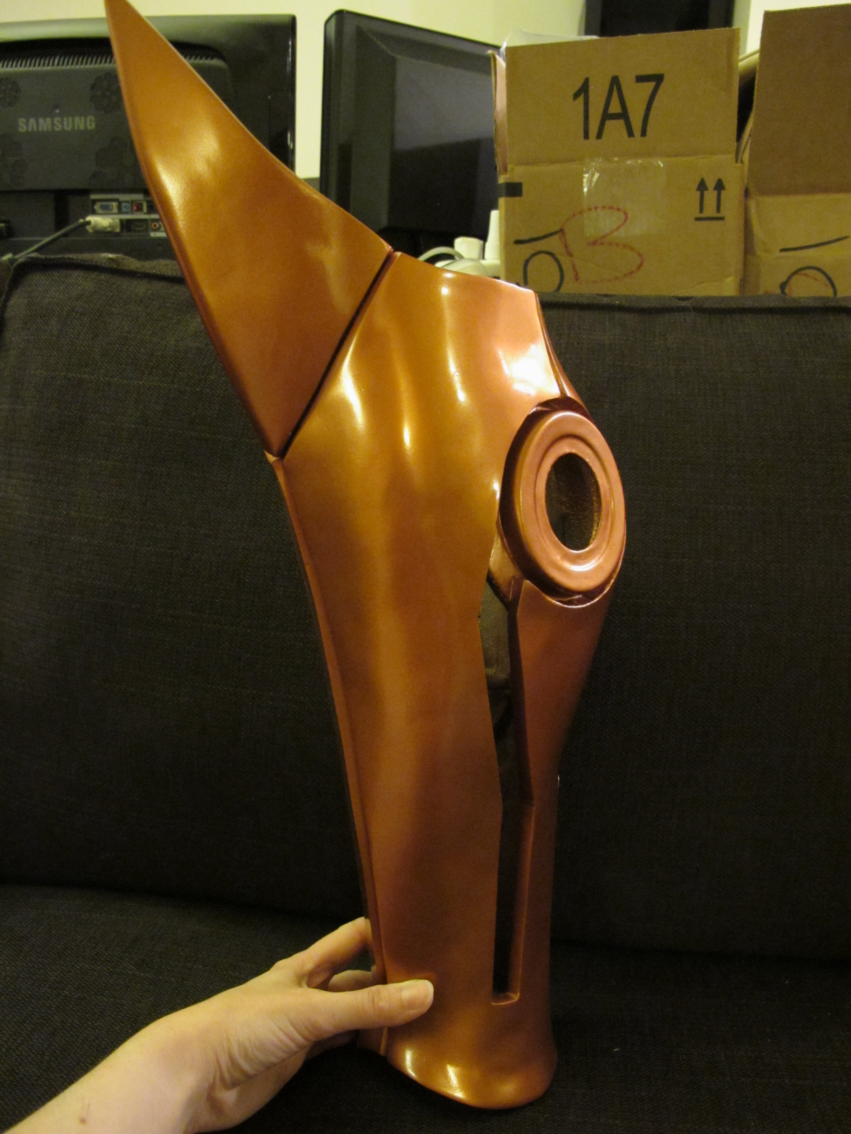

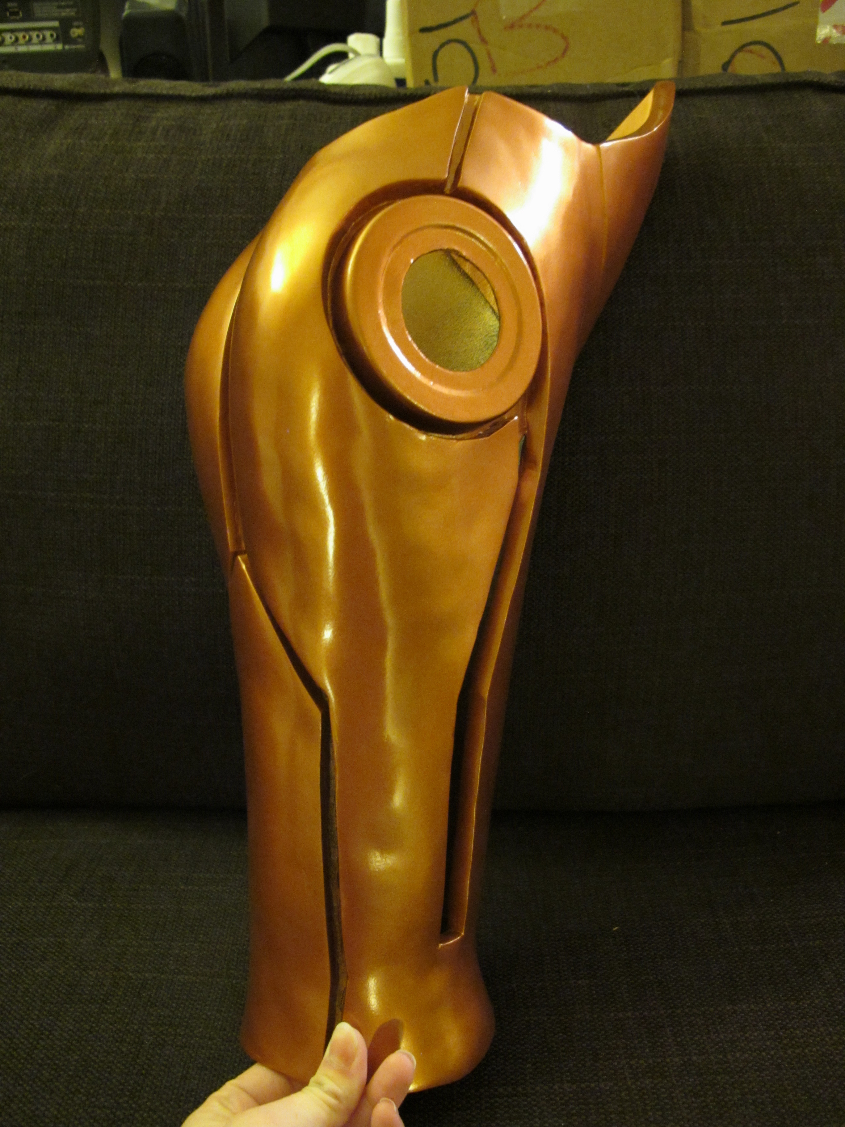

Yesterday, along with painting the circles on the shin, I spent a while trying to figure out how I'm going to get the two halves to stay together. Velcro lets things flop around too much - it needs to be rigid. I bought some clips but getting all four of them to line up while putting the pieces together is impossible because of the unusual shape of the shin and the way you have to angle them together to fit. My next idea is snaps. Normally this wouldn't work; the snaps would make a gap between the two pieces since they'd be pretty thick. My idea though is to cut a hole in the flange that overlaps inside where the two pieces meet and mount it in the hole. Hopefully hot glue or something holds it in place well enough.
Tonight I did almost all of the rest of the Apoxie on the second shin, and primed the first thigh.
Now THAT'S smooth! I wish I had more time to make the shins match.

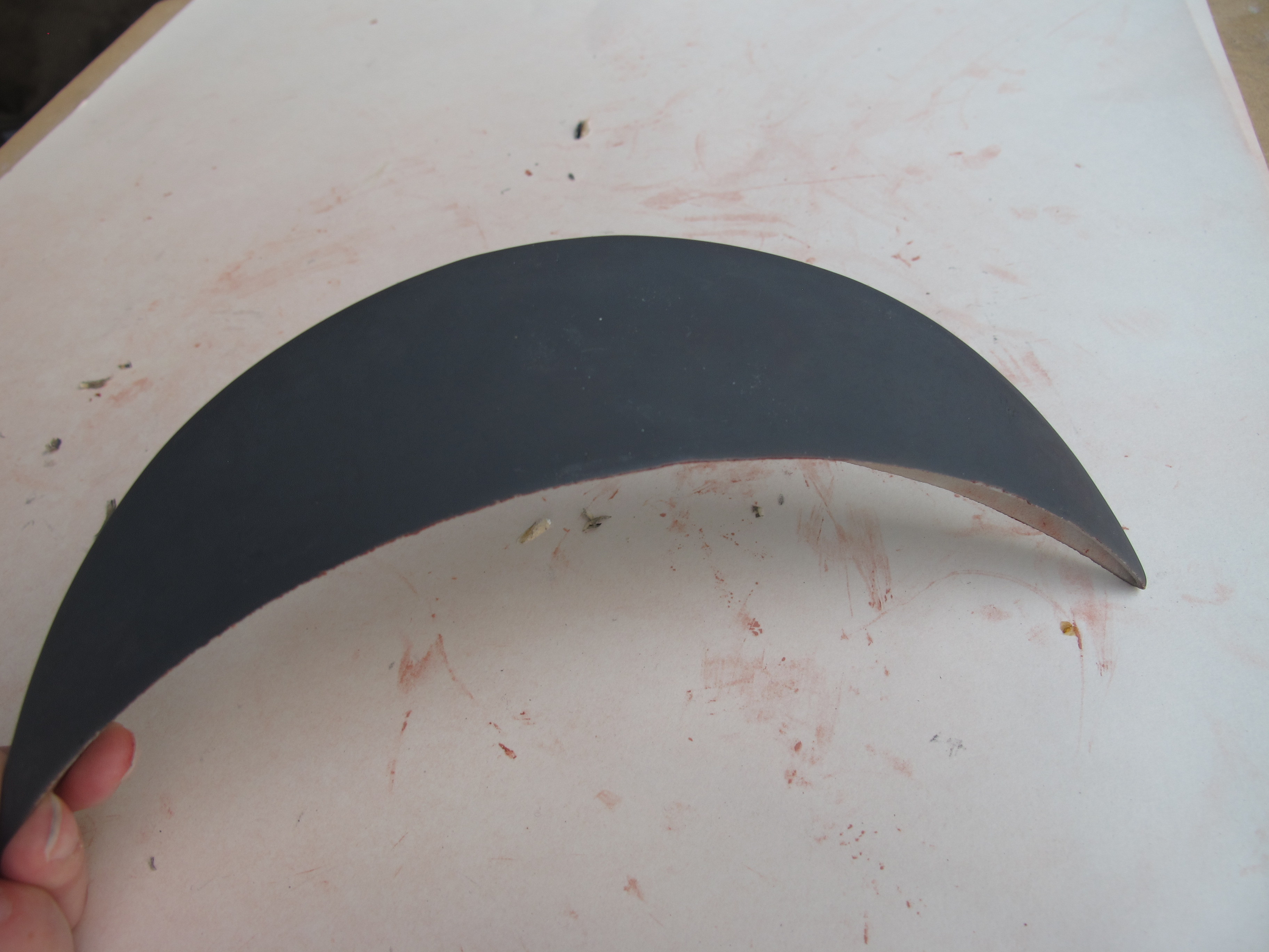

A friend of mine cut my new visor acrylic. Previously I had scored and snapped it myself but the shape wasn't accurate enough and the way I was bending it wasn't working. Before the 3D printer went away I managed to print a buck (an exact negative of the inside of the helmet where the visor sits) for the visor to be shaped into, which allows me to bend it at exactly the right angle and get a perfect curve. My first attempt at the bend left the bend slightly wiggly since I pressed it into the buck with my fingers (normally this wouldn't be a problem but the reflective film I'm applying doesn't stretch and as a result can't contact the visor where it's wiggly). Next time I'll use a dowel. It also got a couple spots that are ever so slightly bubbly since I was using a heat gun. You can barely see them but I have another visor I can bend so I'll only use the bubbly one as a last resort.

The first one has all magnets installed and stays together very well! The second is ready for paint and then magnets.
