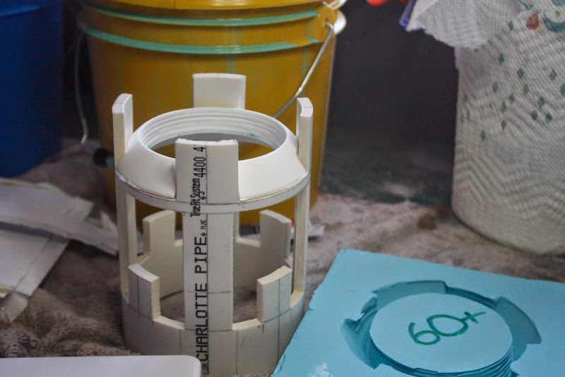

Cleaned up the engine top piece some more
Started adding some small panels
Trimmed the top edge
Both ready for filler
"Offered up" as my Grandfather would of said

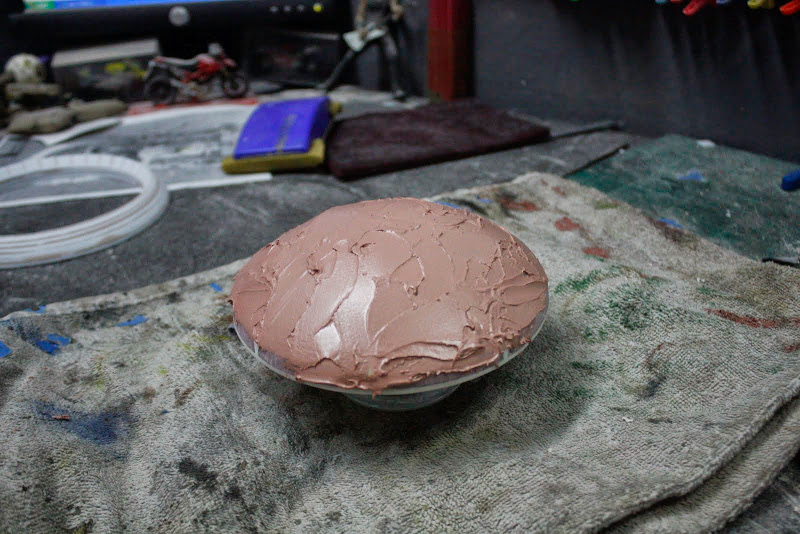

Dome epoxied.......

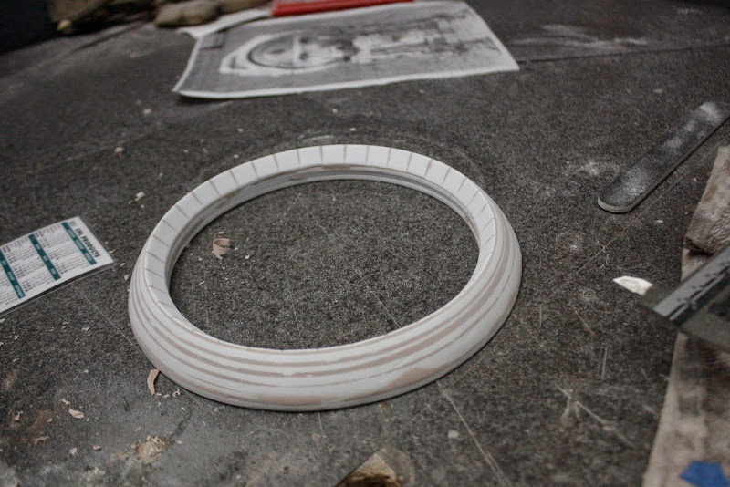

Roughed out the ring
Finished sanded
Dome sanded
Filled
Rough sanded, using the ribs for a guide
Finished ring and dome together
