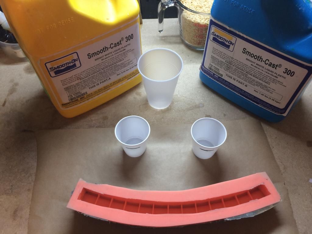

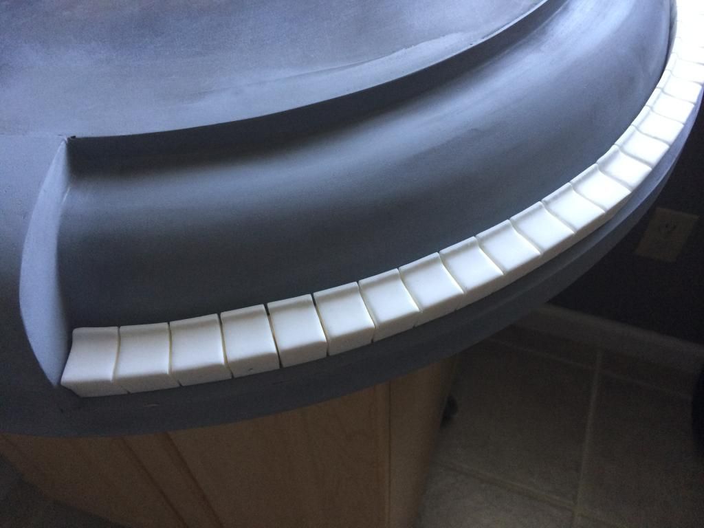

Final Keys Cast:
After I created a set of "junk" keys with my first mold, I was able to create the final mold to cast a row of 13. This was good for two reason TIME and PERFECTION (even though it's far from it, it helped them look similar).

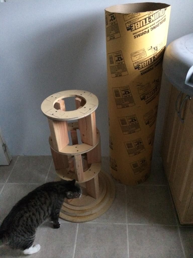

Table Leg:
So I ended up going with a Concrete Form and a wood "shell". I'll paint the base and have a wrap printed for the tube. I tried a styrene skin but it just never looked right. This route was my first gut design. Seems to be the best route for me.
I ended up straying a little from the "real/original" movie version of the base. But I thought a stepped and tapper look would be cool.

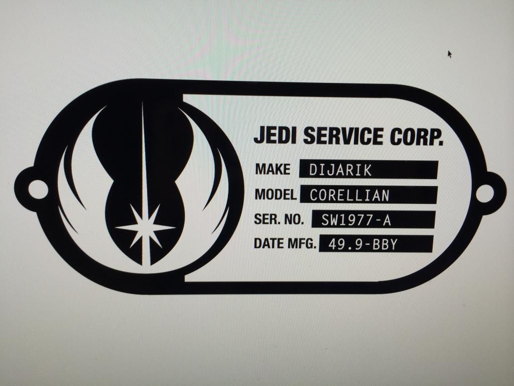

A Builders Mark:
I've been noticing how popular these sort of little additions are in props. I thought...why not! I'll laser and engrave this one. No idea where I'll put it but probably not on the bottom. Maybe down around the bottom of the leg. I'd like it to be seen...a least a little. :)
