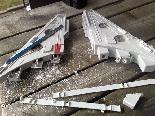

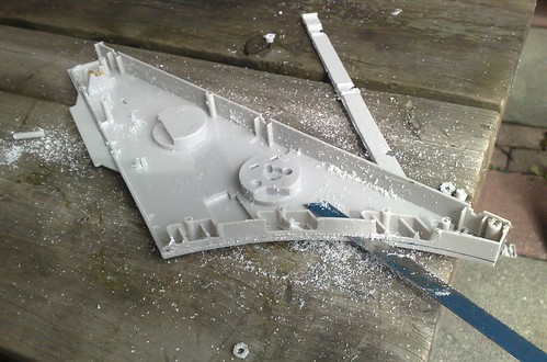

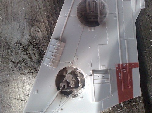

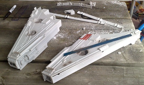

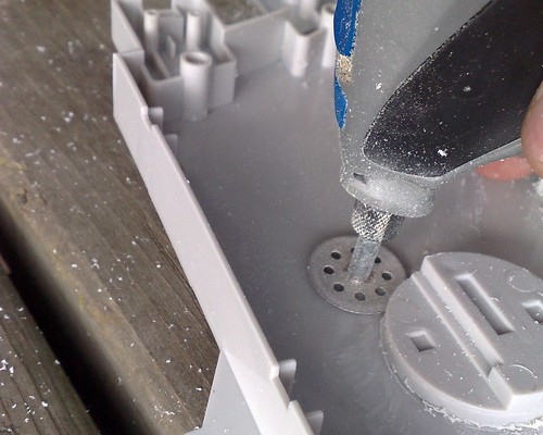

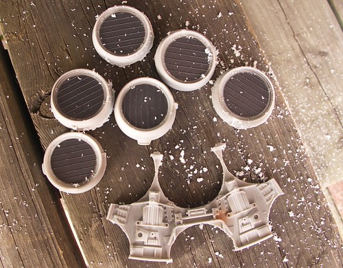

Here is where I'm at on my pathetically-slow conversion: I've cut out the rear discs, which according to the Chronicles are solar sensors but which I've read elsewhere are heat vents (thus the impeller-like things inside the 5-footer's discs. In another book they said that the lights (were they halogen :) on the 5-footer pro become hot so they required exhaust fans. Or maybe the design came first with the solar discs and then they thought they might as well use them for the exhaust fans. Whatever the truth is, these discs are a unique addition to the Falcon's design. And they attract hyper-detailists to giving them fans and real grilles. I'm happy with the current detailing so far - not the height, though, as they remind me of nuclear power plants.

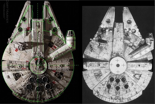

Some modifications need to be done on the dimensions of the mandibles. Radwulfpino's contour comparison is very interesting. This is from his Photobucket album (Image hosting, free photo sharing & video sharing at Photobucket). Radwulfpino seems to have been comparing the 32-inch to Cory Harvey's (Mensaboy) Fine Molds Falcon. The green lines are the 32-inch's I believe. No doubt about those Finemolds mandibles needing a good cutting. Anyway, my mod is still based on the 5-footer (the one on the right), but I just found the comparisons interesting.

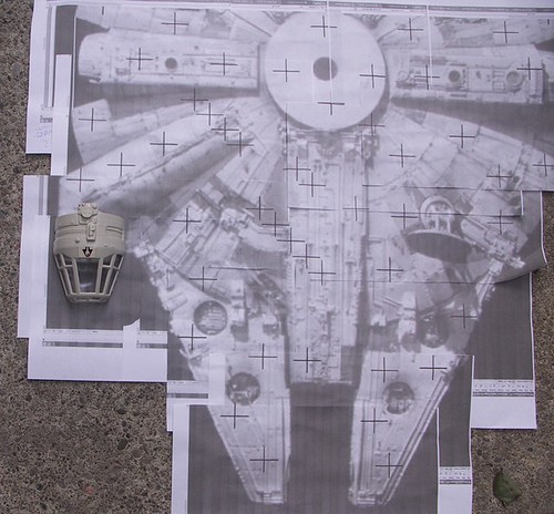

Using the Chronicles photo (blown upto Legacy Hasbro size), I thought about how to go about building a scratch cockpit. There's a thread here -
couldn't seem to find it - where someone mentioned why not slap on a cockpit of the old Kenner toy to the new Legacy Hasbro and that should do the trick. If you recall, Hasbro likes blowing up the size of the cockpit on its Falcons to fit play figures. Well, I drew out the old Kenner toy and compared it's cockpit to the plan - It does fit - surprise, surprise. With minor surgery this should make one swell cockpit.

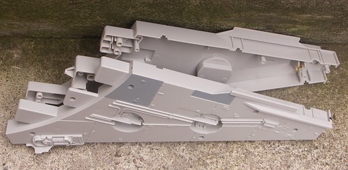

Cut the cockpit tunnel:
Fixed the detachable panels in place with some gorilla glue. The glue expands
so I'll need to chisel the excess away:
The donor cockpit:
On the left is the donor cockpit. On the right is the Legacy Hasbro's
that I've cut off. Notice how big it is.

Not much done, except fixing the detachable panels in place. The upper crab-shell's taking shape.
Rectenna dish area will need to be redone. It's oversized on the toy.
Another beauty about the older toy cockpit is that it looks better, porportionally.
I can't quite put my finger as to why but that's true - it does look better proportionally. And it's got more of that B-25 bomber cockpit feel that, I read somewhere, influenced the Falcon's cockpit design. It "moves" while staying put, while that bigger cockpit is just like a stationary slab, for some reason or another.

How's working on this type of plastic? Is it pretty close to "model grade" styrene? Or softer?
I noticed you're working with what looks like a really fine jeweler's saw and wondered how easy/difficult it is to cut and clean up.
I did a couple of SW toy mods years ago and remember the plastic being pretty difficult to sand smooth because of its softness. It was a pain!
