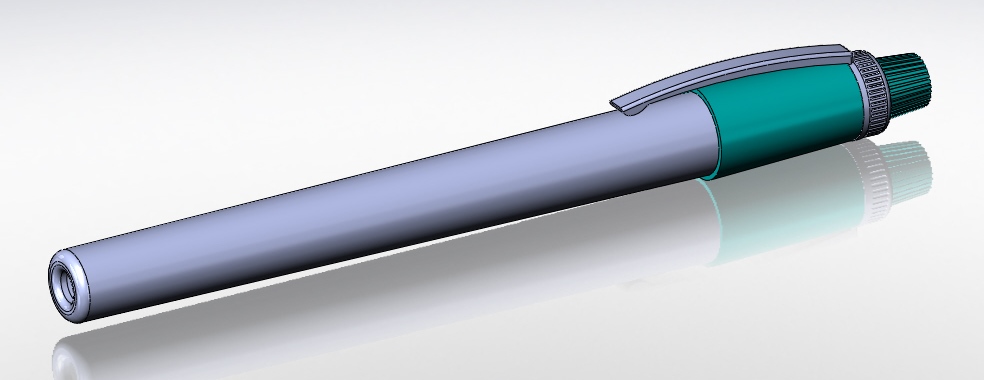

Don't laugh!!! I modelled this in SolidWorks last night. It's accurate to the numbers given in this thread. I'm pretty happy with it, but the clip is going to need some messing with. The clip has a lot of intersecting curves that are tricky, but it's a start.
At this point it's all one peice for a "stunt" version, but I am considering breaking it into peices. The stunt version could be printed in Stainless Steel at Shapeways. With a little paint it would be passable, but I really wont to break it in peices to put an LED in it (I know it was a conventional bulb, but LEDs are more rugged, last longer, and require less power).
Take a look and let me know wht you think. And a special thanks to BreadleyBear for generously providing the dimensions!!!!
Very very nice. :)
Thought about uploading the CAD-files? :D

Well done, very nice work! Looks amazingly identical to the real thing!

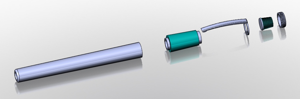

Here is my model broken down into peices. Now the blue/green button and "grip can be printed in reasonably priced plastic and spray painted, and only the parts that appear metal can be printed stainless.
It still needs some modifications to accomodate a light. The peices would need to be threaded and mounting for the real switch under the button would need to be developed. I probably won't model the threads, I'll probably make the material the right size to be hand threaded with a tap and die. I would love to put the electronics from a Character Options 10th Doctor sonic screwdriver in it so that it had the sound... I need to take some measurements on that to see if it could be made to fit.
Anyway, here are some pictures!!!!
All the parts pluged together
The exploded view

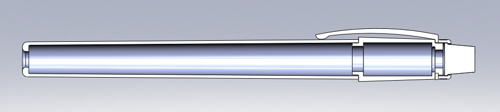

And a cross-section view

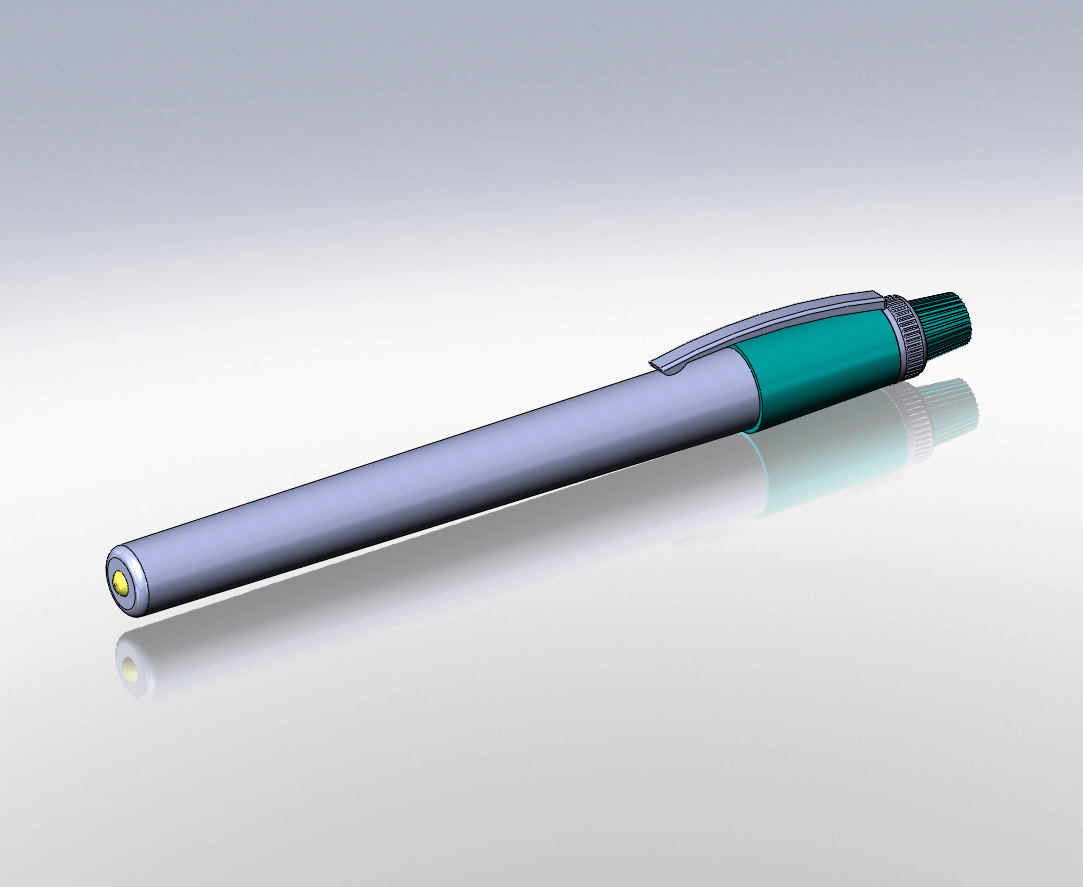

The exploded view
