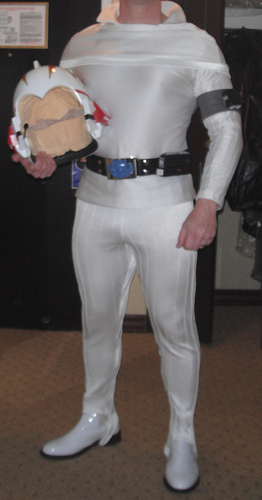

Sucess!!!
I'll post a couple pics. this evening from Alb. Comic Con, but for now, know that I think we've got it figured and a big thanks to Kezler for words of wisdom.
The final product was put together like this;
-8.5 yds of white jumbo spandex
-The tunic has a rolled lower hem, the "caplet" on the shoulders is hemmed with a rolled facing and is not double layered (none of the costume is) and tacked on the shoulders, sides of the chest and sides of the back. The inside of the tunic neckline also has a facing.
-The sleeves lines are tucked seams at 1" and a very, very tight seam (and yes you do get a nice set of lines on your arms for a while after you wear it :lol
-The pants seams were the same but sewn on the outside (good side) of the fabric at 1.25" apart.
Gil and Erin loved it, especially Erin. Her reaction as I handed her my helmet to sign, "Oh my god!" :eek They both talked about the show and really liked the helmet, Gil talked about his being special fit from a Bell. Very neat folks!
BRsuit
That sounds 100% awesome -
I cannot wait to see the pics and so glad you nailed it to the point you impressed the stars. I've seen them a couple of times myself and they always seem pleasant and love the fans -
Congrats..!
Totally, totally awesome!!! It looks like you've just walked off the original set of the show. I bet you couldn't stop grinning :) Really great to see this project completed for you.....I really would love to own a replica suit one day.
