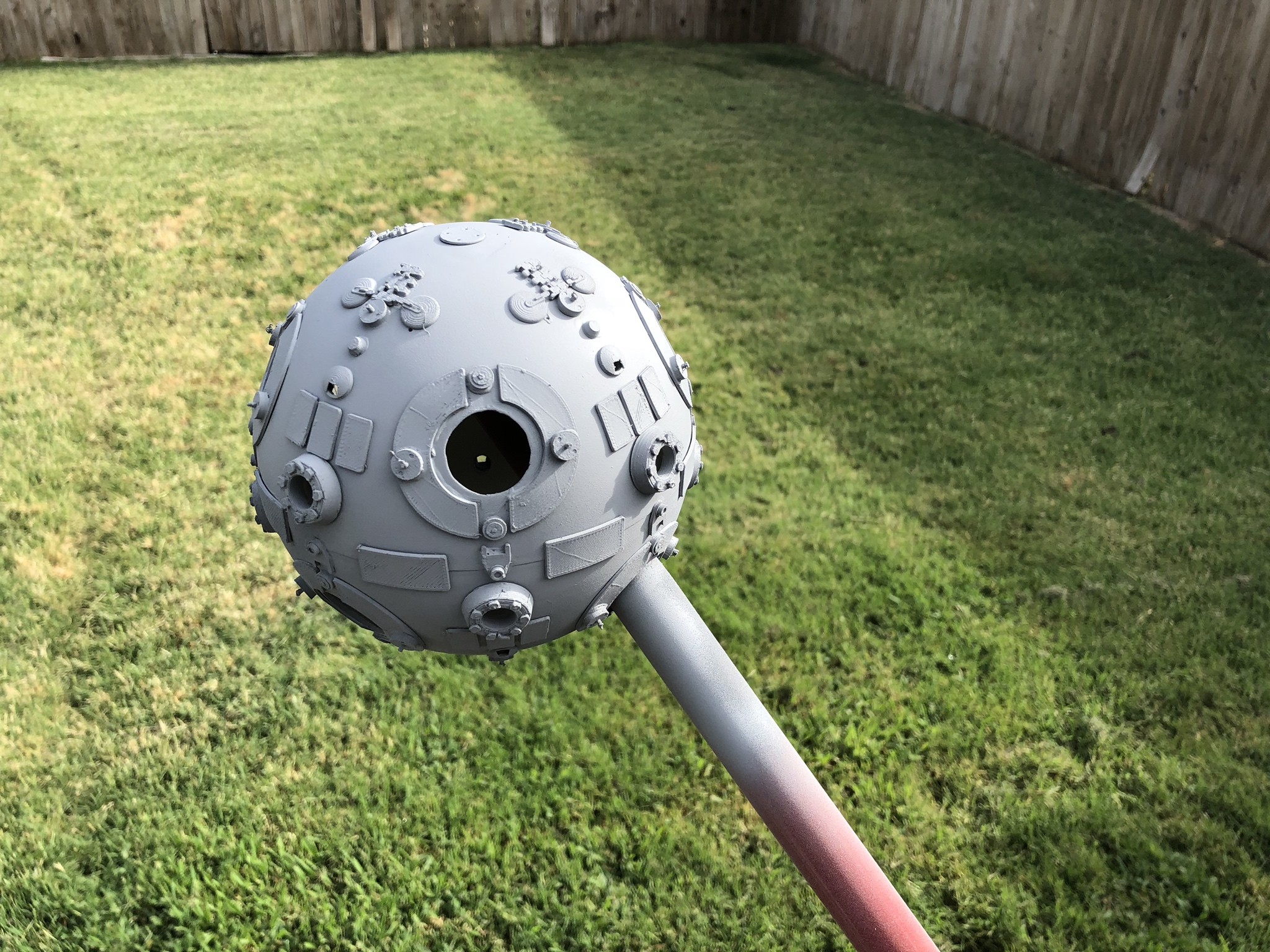

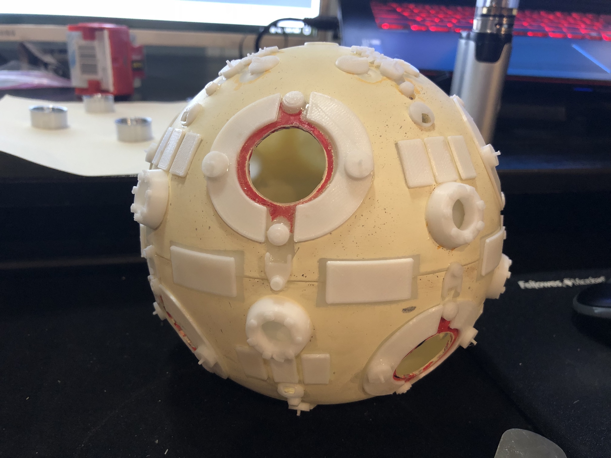

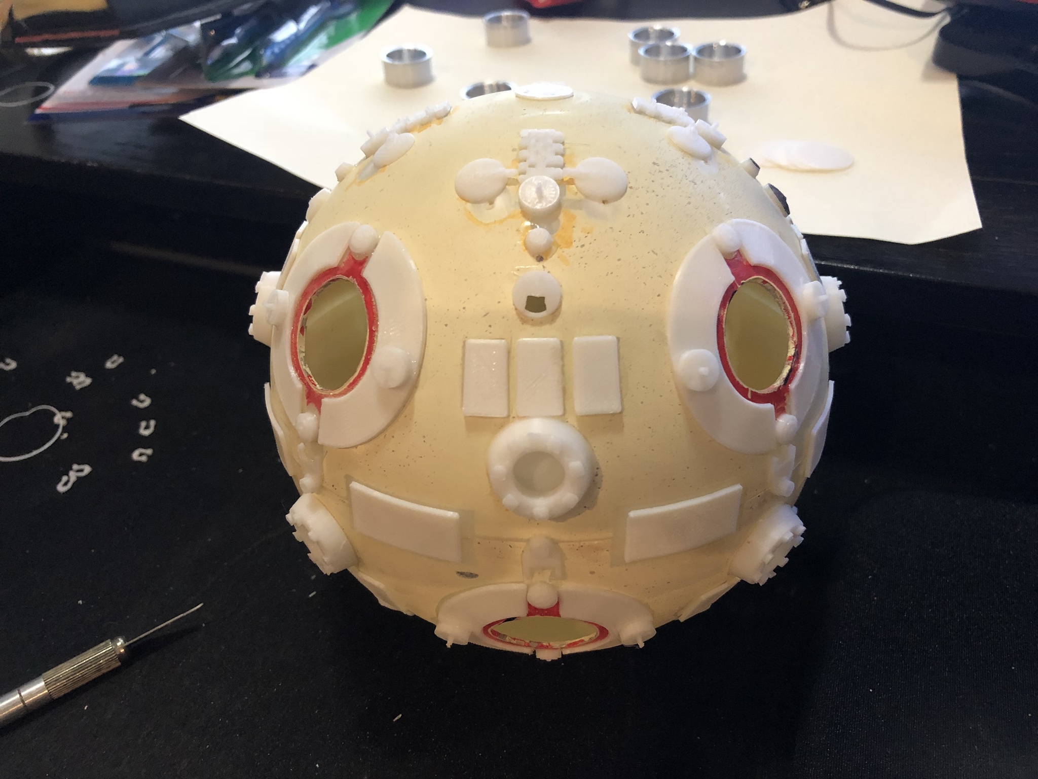

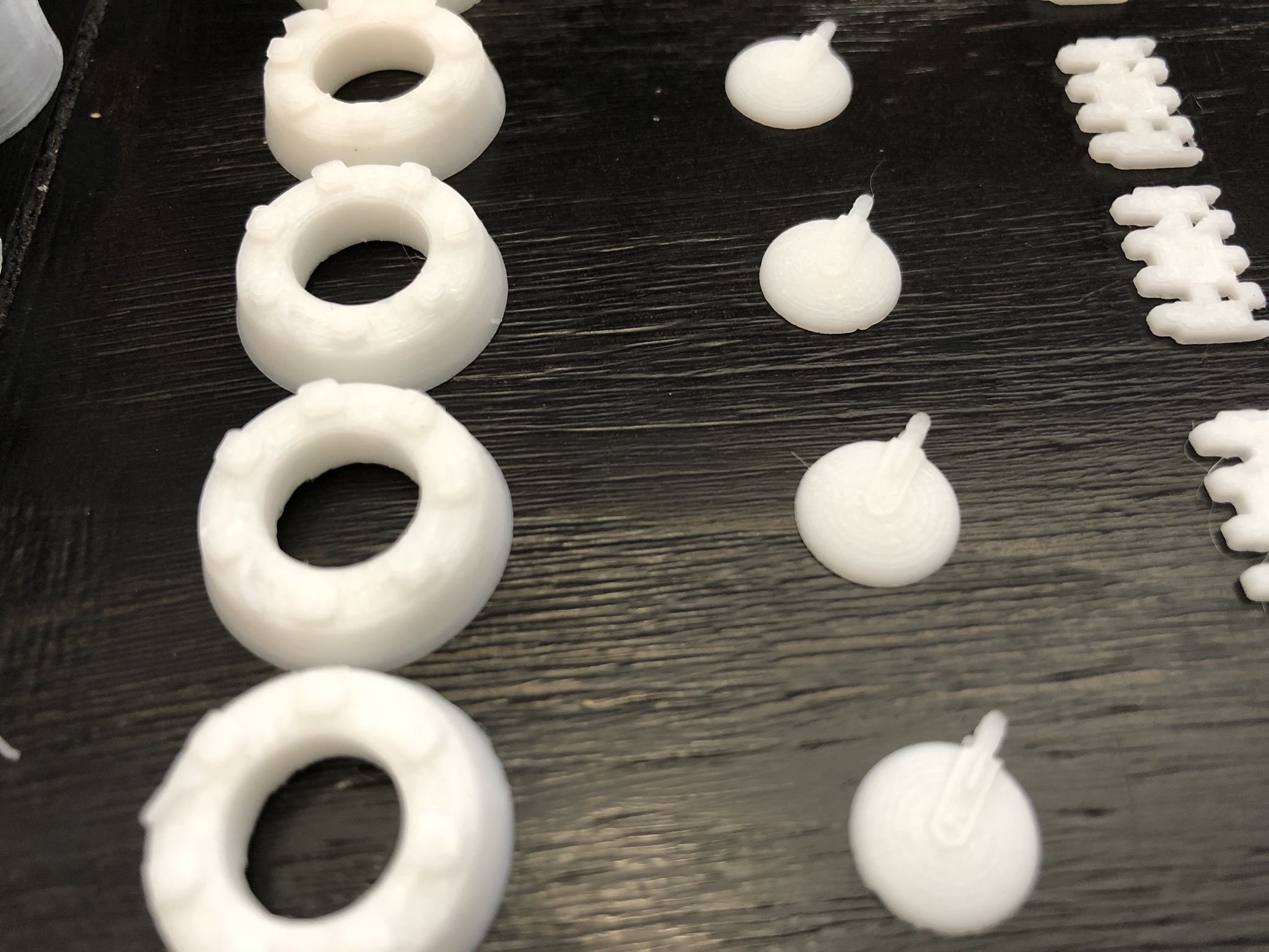

First I 3D printed all of the parts and greeblies. I had to make very slight modifications to some of the models for them to print the way I wanted for sizing, print quality, and structural integrity.

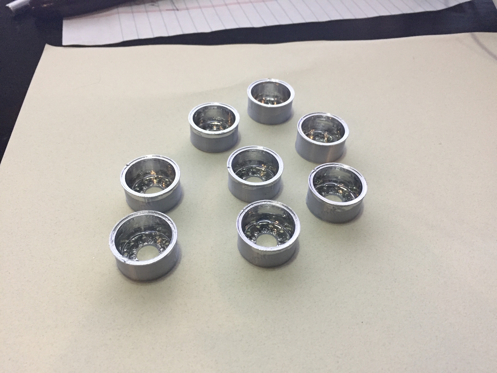

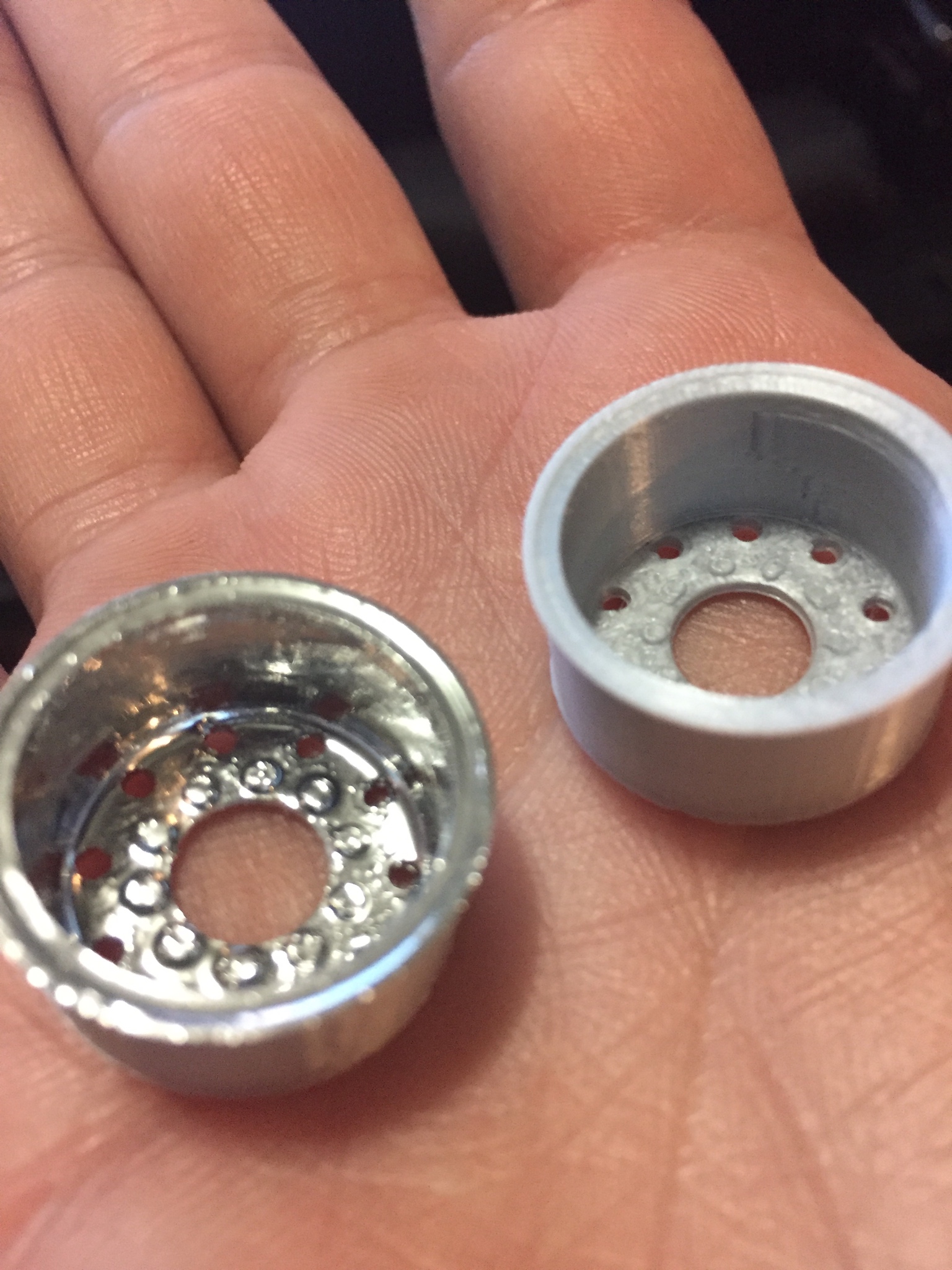

I printed most parts in white, except for the rims which I printed in silver and then made them shiny.

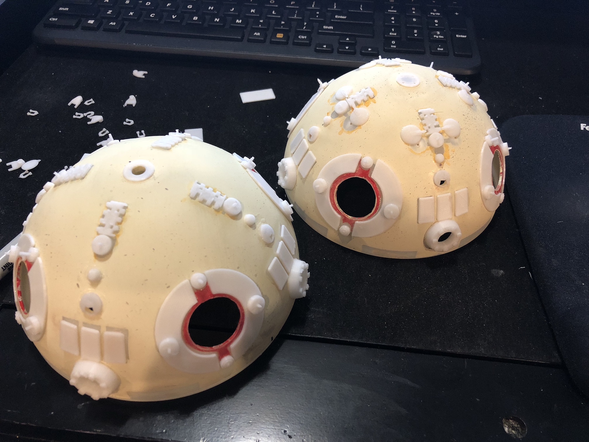

Next I stripped off and removed all of the old foam pieces, chapstick caps, thumbtacks, etc. and started gluing on the new 3D printed parts.
Then it was time to hit the whole thing with a few light coats of filler primer
And now to put the rims in to see if it still worked.
Fingers Crossed!
It WORKS!!

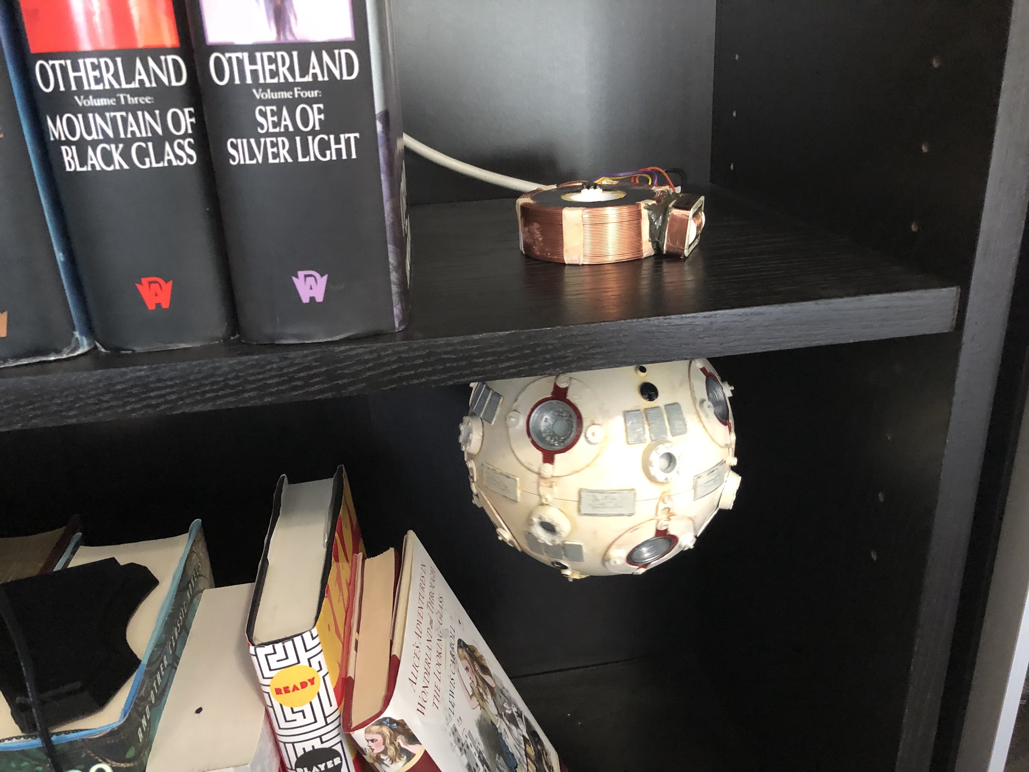

Ever since stripping the original globe graphic off and adding the foam parts all those years ago, it was always quite difficult to get it to float. I had always assumed I had made it too heavy and that it was just barely on that threshold of still being able to float. But it turns out I was very wrong and it was too LIGHT this whole time. Being too light meant I had to pull it farther away from the magnet to prevent it from being sucked up against gravity, but that placed the ball outside of that sweet spot where it can be held up really well.
Now rebuilding it has given it some extra weight where it can now sit right in that sweet spot every time. Setting it to float is so simple now and requires 0 skill or patience. You just hold it up on the spacer and it instantly floats every time.
So now that I know it's going to work, it's time to finish painting it.
First is to hit it with a coat of off white
Then grey on the panels followed by a thin line of chrome around the edges to mimic the scratches on the original prop
Next, another misting of the off white on top of the gray to wash them out and give them the multi toned look of the prop. I also hit the rest of it with random brushes of the chrome marker to simulate metal showing under the paint
After the base coats I started applying the red around the rims.
and now it's time for the weathering. I did a yellow and a brown/orange wash over the top and bottom bits.
then hit the entire thing with a couple of washes. First was a yellowish brown then a darker brown around the rims.
After some final weathering, coloring in the black hatches and baffle pieces, a clear coat was applied and then one final test to make sure all is well.

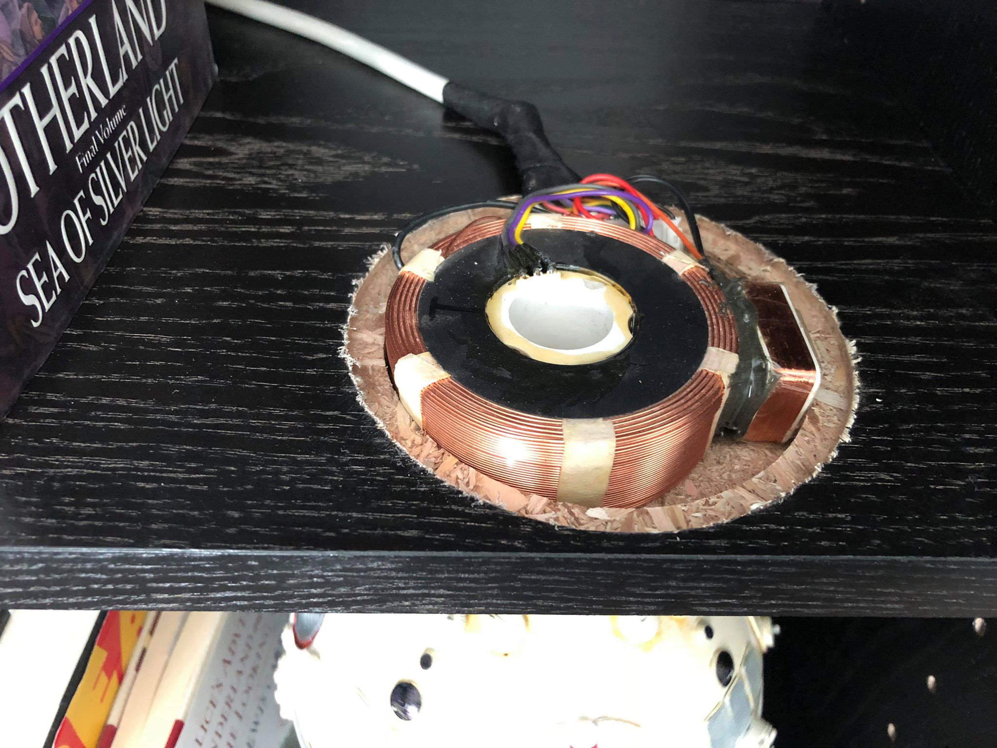

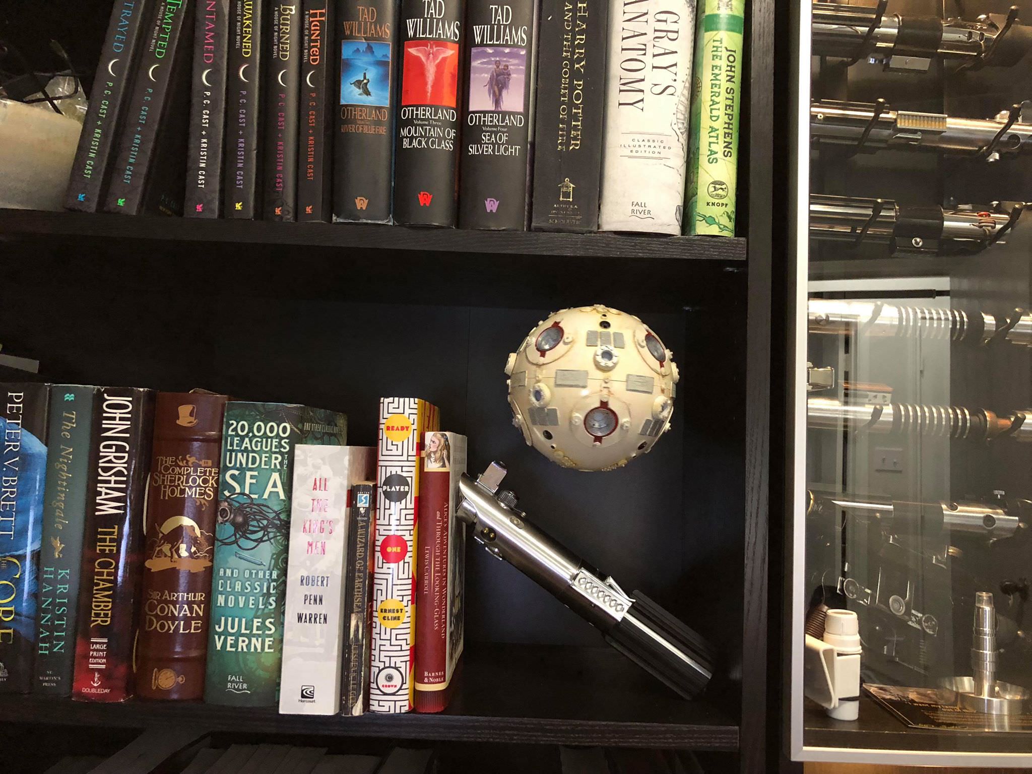

I really wanted to find some way of completely hiding the base so that the remote would float without any means of support.
I carefully disassembled the base to see how it was constructed and was able to modify it in a way that I could remove the electronics completely and actually hide the electromagnet INSIDE my bookshelf!
I played around with the positioning of the electromagnet until I was happy with the placement
Then took the shelf to my brother's where we milled a recessed pocket into the shelf. the magnet fits down inside leaving a 1.5 mm thickness of the shelf material under it.

And here's the final result! I still need to 3d print a cap to cover the top of the magnet, and I'll need to destroy a couple of books by carving out the bottoms of them so they completely cover the magnet, but the resulting illusion is pretty effective in my opinion. I'm super happy with how it turned out.
Speechless:eek!! You Sir are incredible! TFS your techniques to achieve that neat trick and a very good model:thumbsup

Here's the recessed pocket with the magnet in it. We milled a lip around the hole to accept the cap I would make

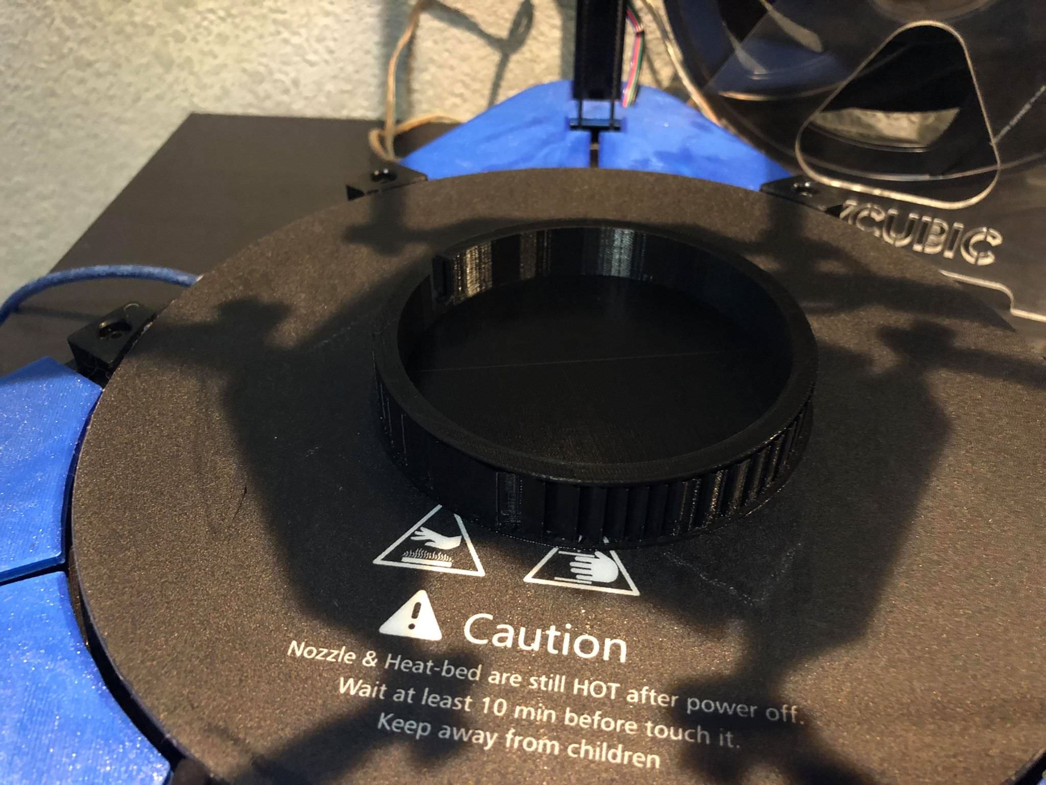

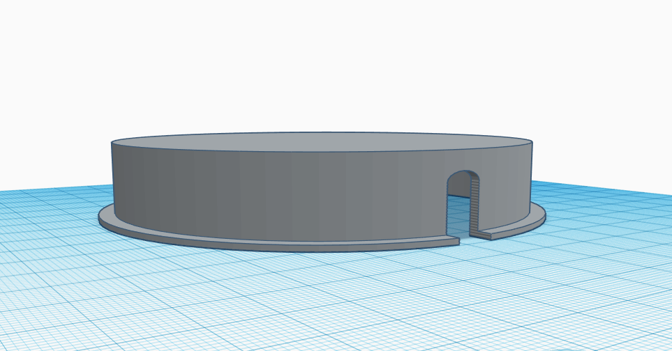

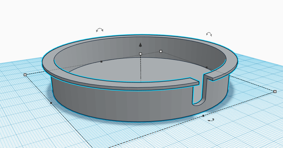

I 3D modeled a cap to go over the magnet to protect the wires and prevent any damage. I have tested it thoroughly and it never even gets the slightest bit warm, so there is no danger of the exposed magnets or wires starting a fire or anything.

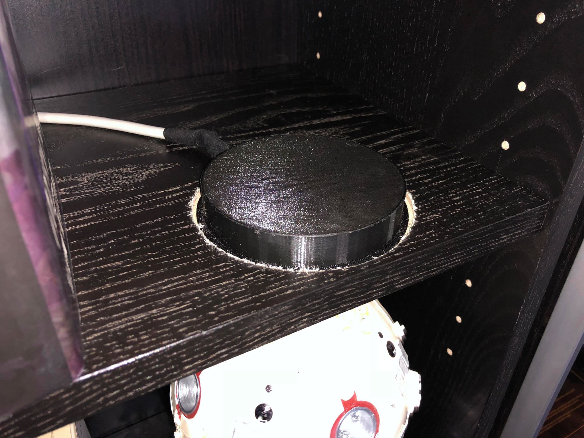

Here's the cap fitted over the magnet
And then Finally I carved out a hollow section in the bottom of a couple of old books (I'm never going to read Gray's Anatomy lol)
