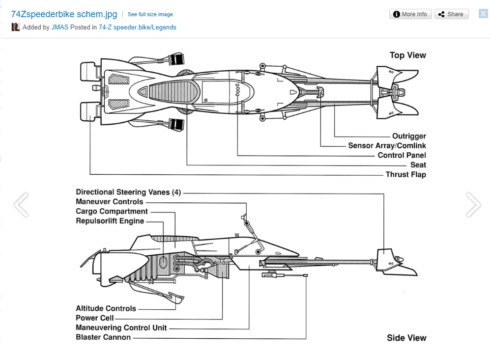

http://starwars.wikia.com/wiki/74-Z_speeder_bike/Legends
Post #2. I started tearing into this thing. Pretty much all of the original plastic fairings have to be removed to do any kind of maintenance to this thing. The previous owner said it idled fine but bogged down when giving it gas. The tear down revealed years of neglect that I'm hoping a carb rebuild and tune up will rectify.
While waiting for parts I began to sketch up the bottom portion of the platform...or the foundation on which the speeder body will be built. I "vector-ized" a rough schematic I found on the legends page.
And took some rough measurements of the scooter frame in order to resize the "foundation" before I being cutting it out from 1/2 plywood.

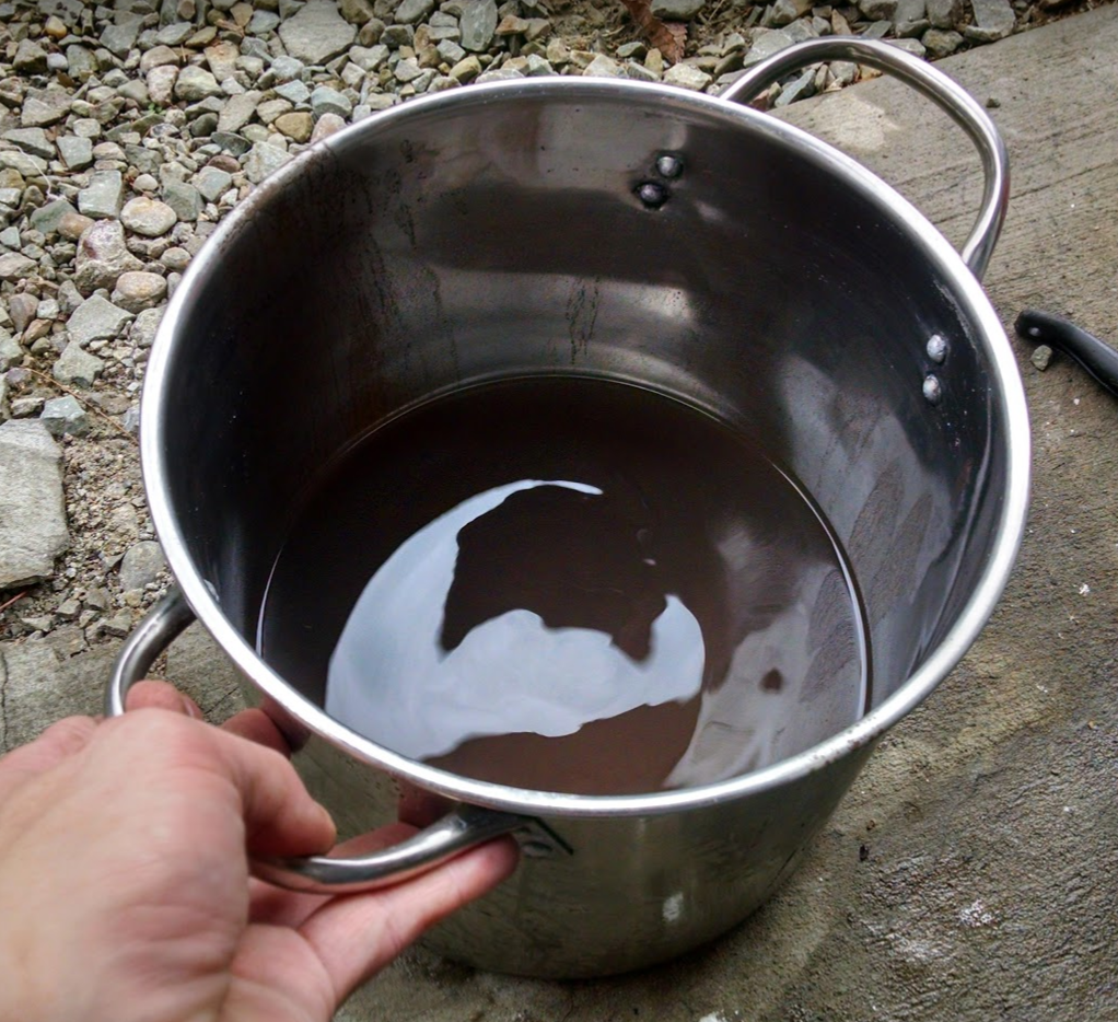

I'm pretty sure gasoline is not supposed to be this color. A tank cleaning will need performed too. Anxiously trying to get this thing to run before starting fabrication of the speeder body.
