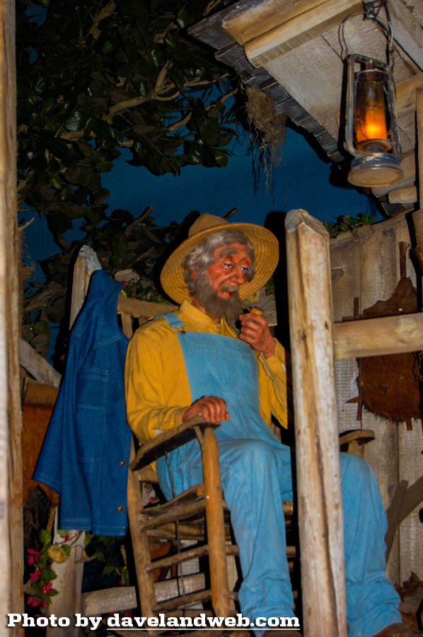

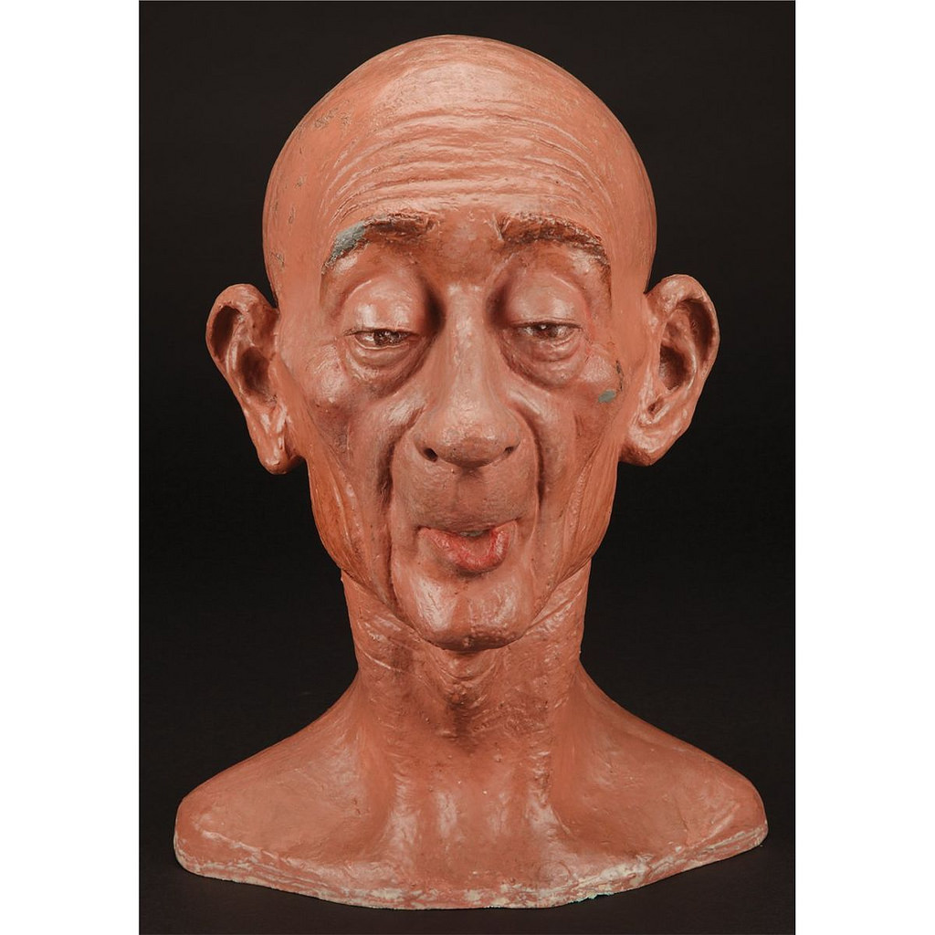

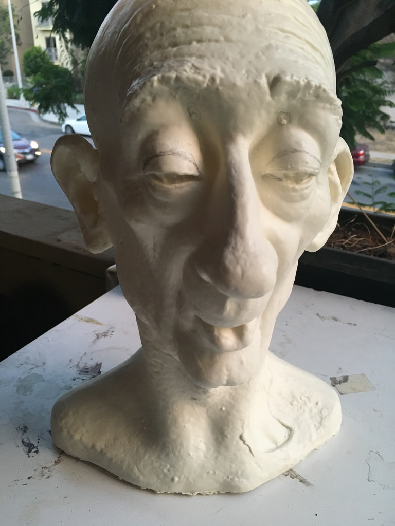

The original source of the copy I have seems to have been this head, or one just like it. This was from an auction some years ago. It matches up with the old man in the bayou scene at the top of the ride. Notice the angled hole in the mouth to accept a pipe, and the partially closed eyes. This is the only example I've been able to find of a different version of the same sculpt.
All other appearances of the head in Pirates and Haunted Mansion have more opened eyes, and a more neutral mouth position. And that's kind of weird. They were doing all these different sculptures for Pirates, and reusing many, but here's this one that was reused, yet modified. I have to assume they made a copy of the first sculpt, altered it, and remolded it. But which version is the original sculpt? Going back to the auction picture, I spy a line in the reflection across the upper eyelids that roughly corresponds to the shape of the open eye version. That's good enough for me. Looks like the open eye version came first, and additional eyelid was added in clay over a hard casting to be remolded as the bayou guy. The lower lip was probably tweaked the same way.

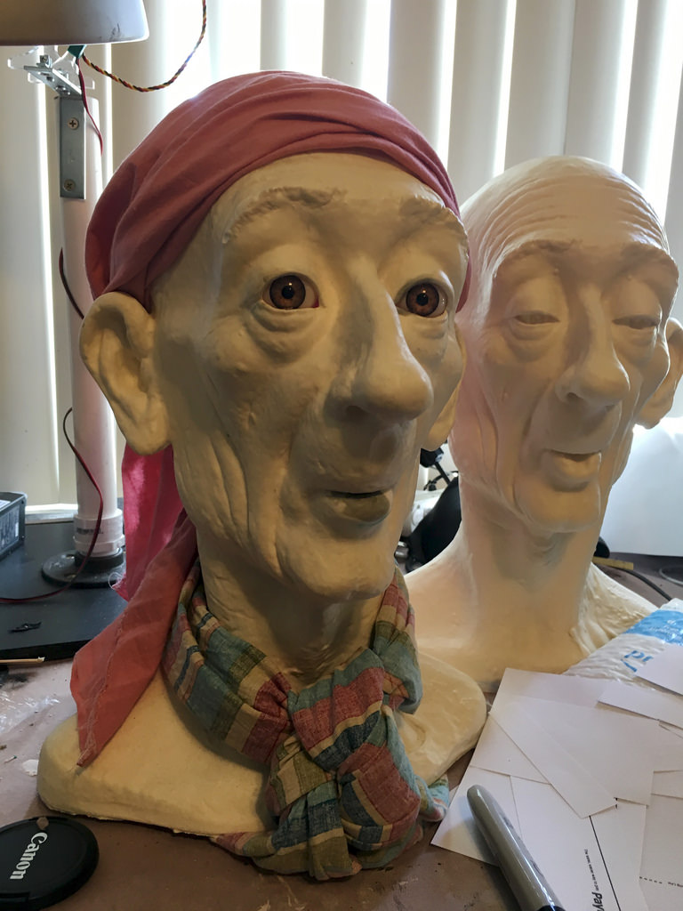

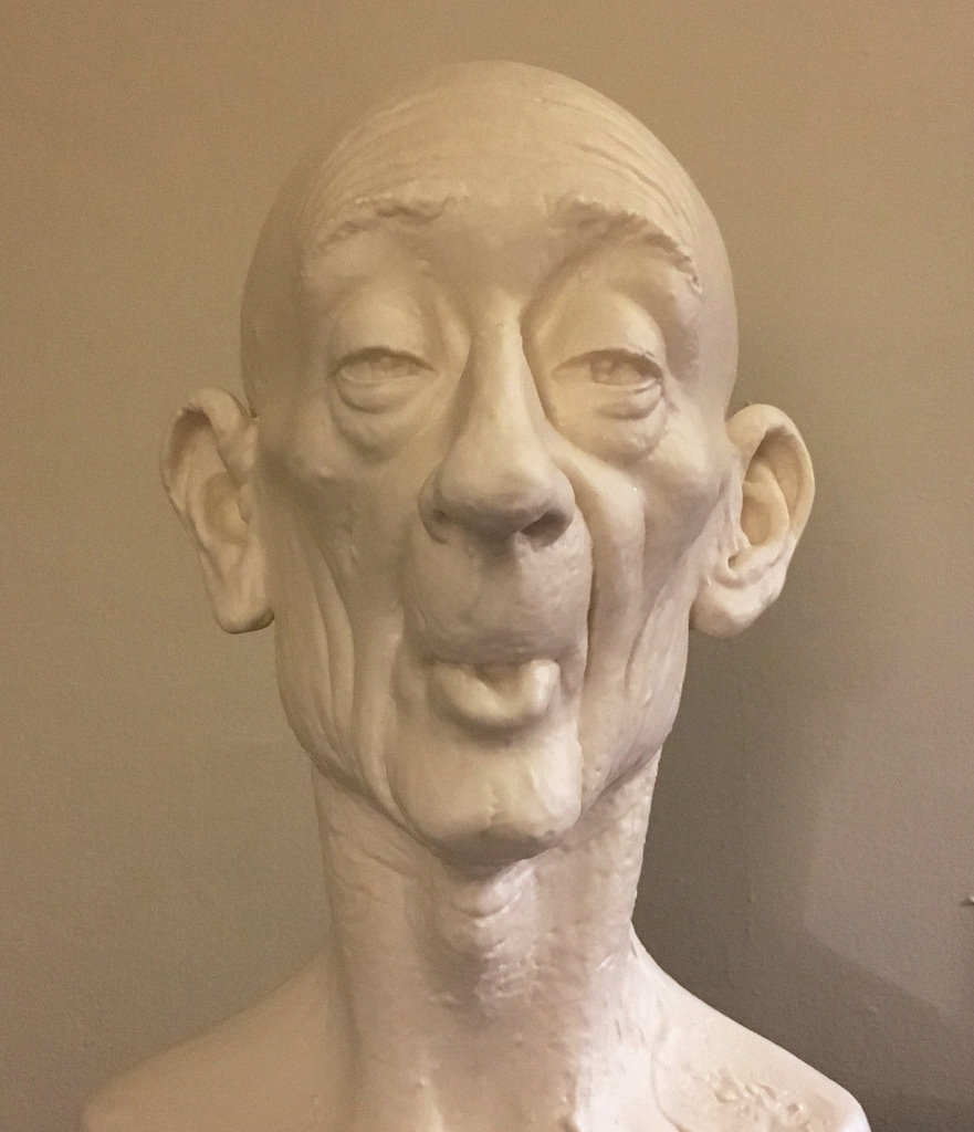

Now, I'll be turning this head into a replica of the jailed pirate seen above. So, the aim of the game is to open the eyes back up, see what we can do with the mouth, and go from there. I'm going to be inserting premade eyes, so I can just carve away at the cast eye until it's the right size and shape.
Measure twice, cut many more times in gradual increments.

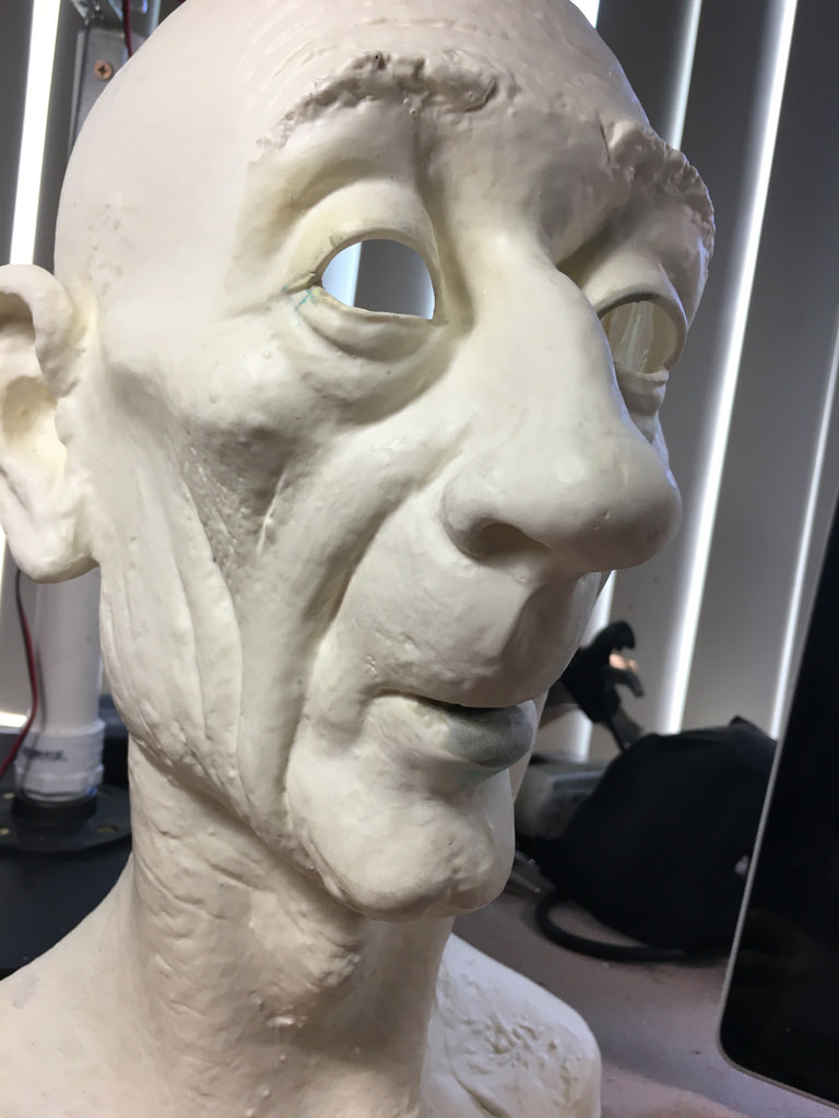

I filled in the hole in the lip with epoxy clay, and shaped it back to a closed position with a dremel. I cut a door in the back of the head to be able to access the eyes from behind. It took lots of careful carving to shape the backs of the eyelids to properly fit the plastic eyeballs I had. Side by side with the original, you can see how much is changed before we even get to the finishing work.

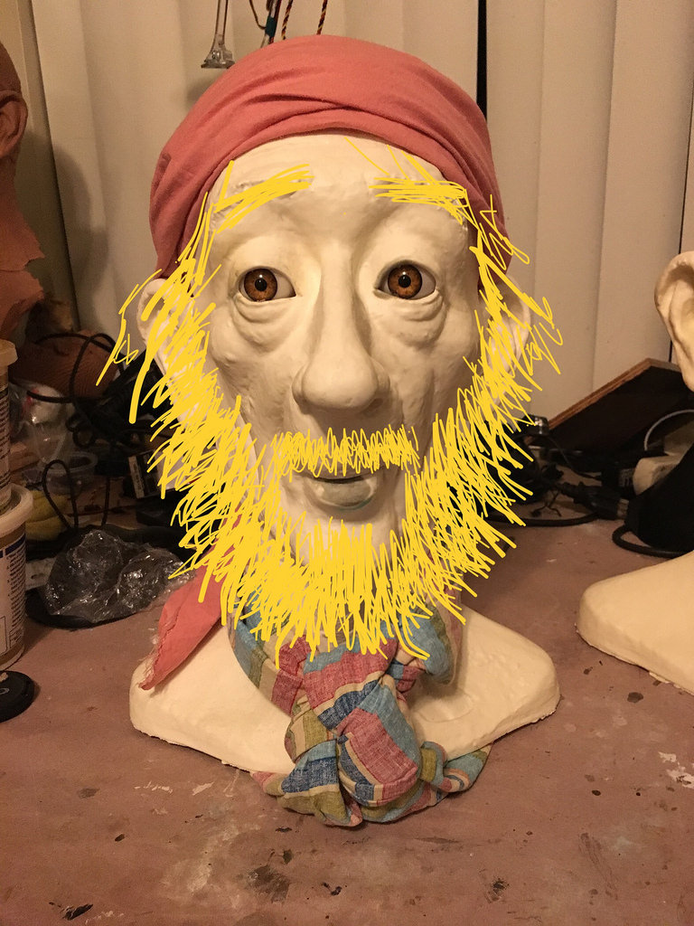

I find it's helpful to visualize where things are going to doodle important features on photos. Will his face look right when the beard goes on?

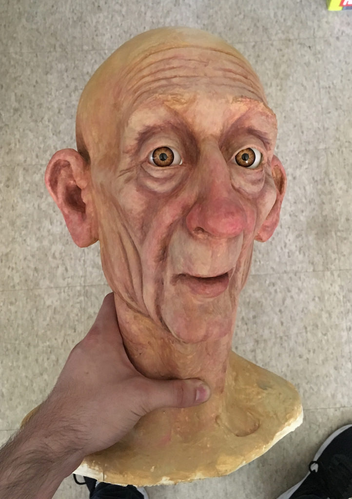

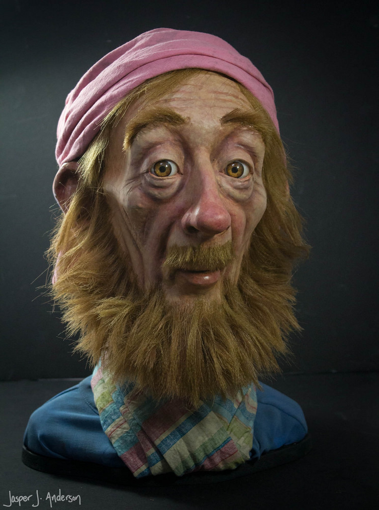

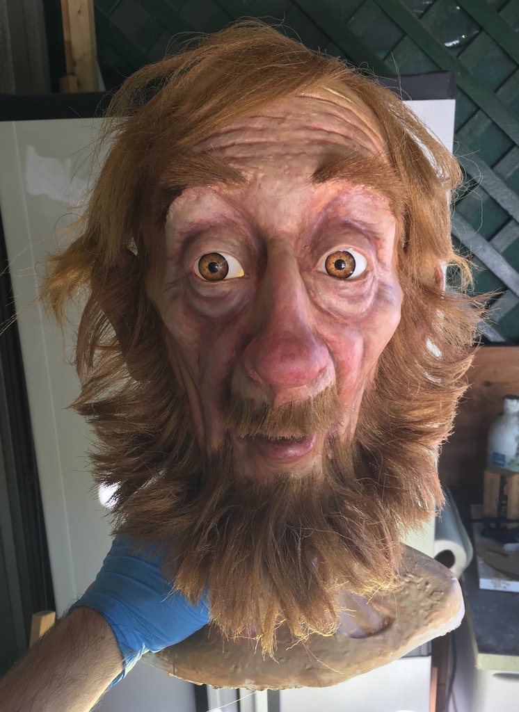

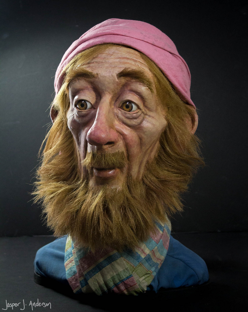

So, I painted the face. A little more cartoony than not, but with a little more realism than slapping down one or two colors.
Hair and beard coming up next. Stay tuned.
