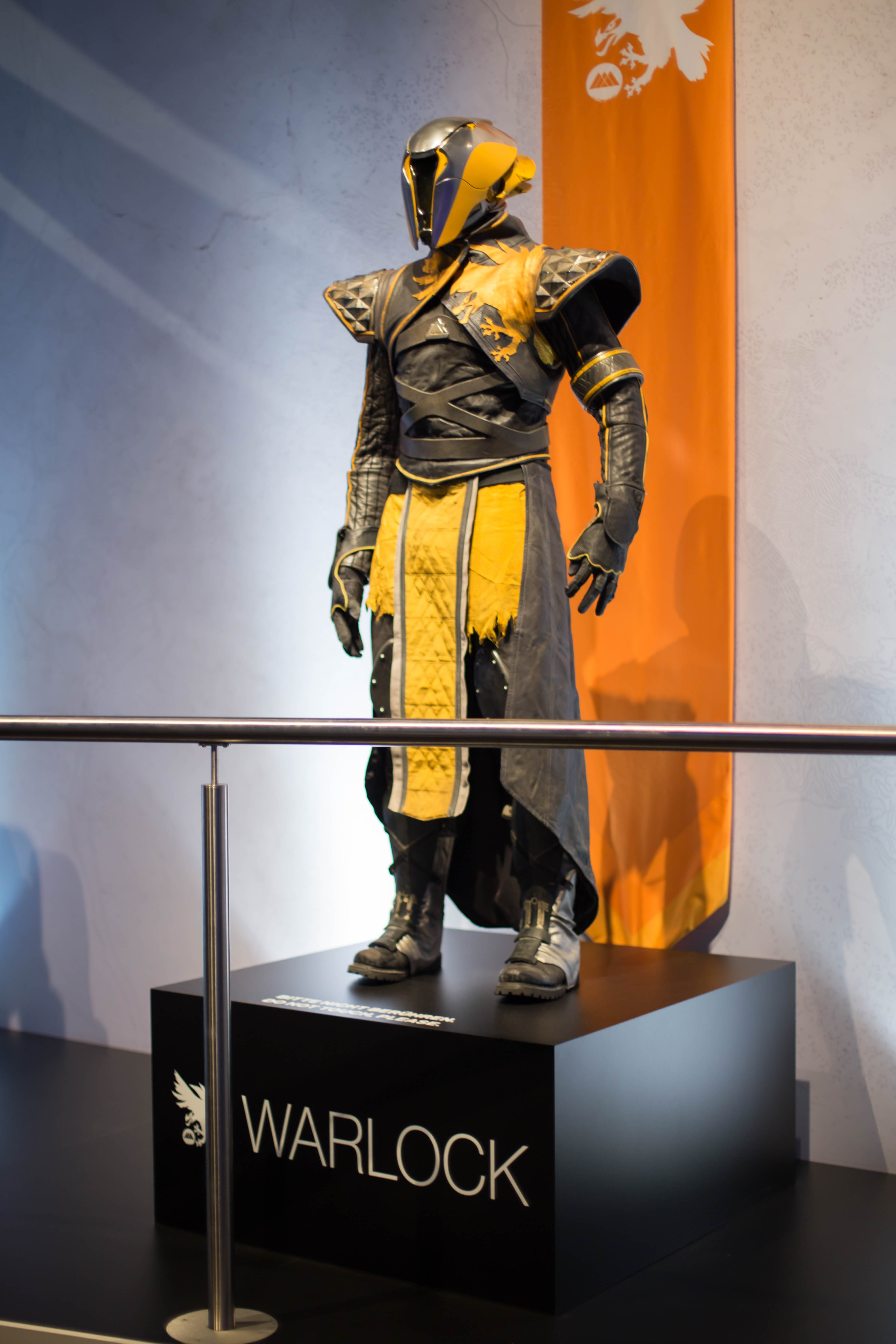

After getting DEEP into Destiny 2 over the past couple of months I've decided that this year's Halloween costume will be the "Wise Warlock" outfit, AKA the Ego Talon IV armor set, AKA the default Warlock that's featured in all the promo materials. Bungie even made an amazing full-size replica costume that was displayed at some pre-release events (although I can't find ANY information about who created it--only a handful of photos from journalists at the events).

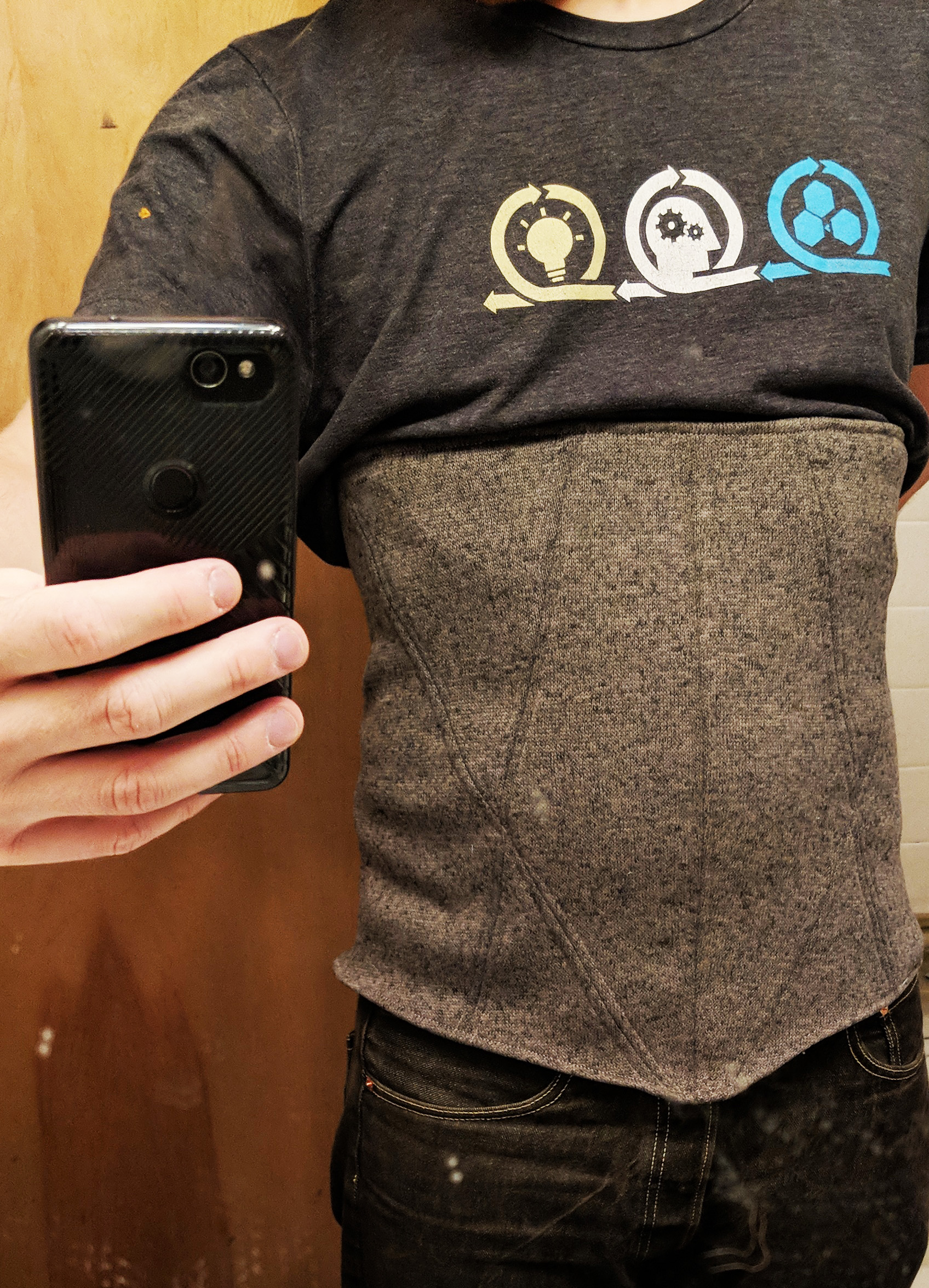

My first progress on the textile portion of the costume: I've completed the "corset" portion, for which I had no pattern and completely improvised from scratch. I'm pretty pleased with the way it came out! Just have to add the gold piping and the weird strappy X-shaped thing on top of it. Please excuse the dirty bathroom mirror. :p
