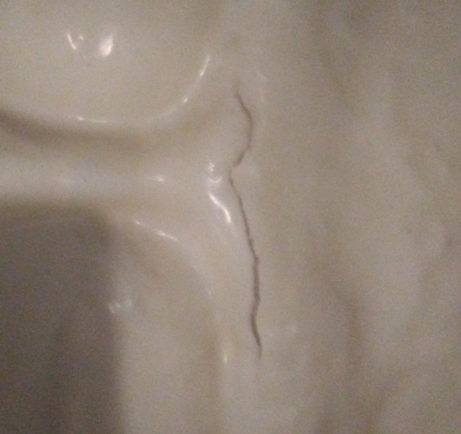

Hi, I've been learning how to make latex masks and I'm always running into new problems. This time my latex is cracking and ripping apart when drying in the mold. I assume it's because the latex is thicker in some spots so the difference in drying time is pulling it away from itself, but i don't know how to avoid that. I fill-dwelled the mold and let it drain for at least 10-20 minutes. What more can i do to make sure its evenly coated?

Hi there. Looking at the pic you posted, I'm going to guess the crack didn't go all the way through the pull, correct? If it didn't, I have seen this before and I believe I can explain what's happening... From the pic, it appears that the crack appeared in an area where the latex pooled. What's happening here is the outer layer of latex that is exposed to the air is curing faster than the rest of that pool. As latex cures, it shrinks slightly, so while it's still soft, it splits, not unlike the top of a loaf of bread as it bakes. this will happen on occasion in areas where the latex pools up thicker than the rest of the piece. It's should be only superficial, and since it's on the inside, won't affect the appearance or structural stability of the piece at all.
the more uniform the thickness of your piece is, the less often you will encounter this.

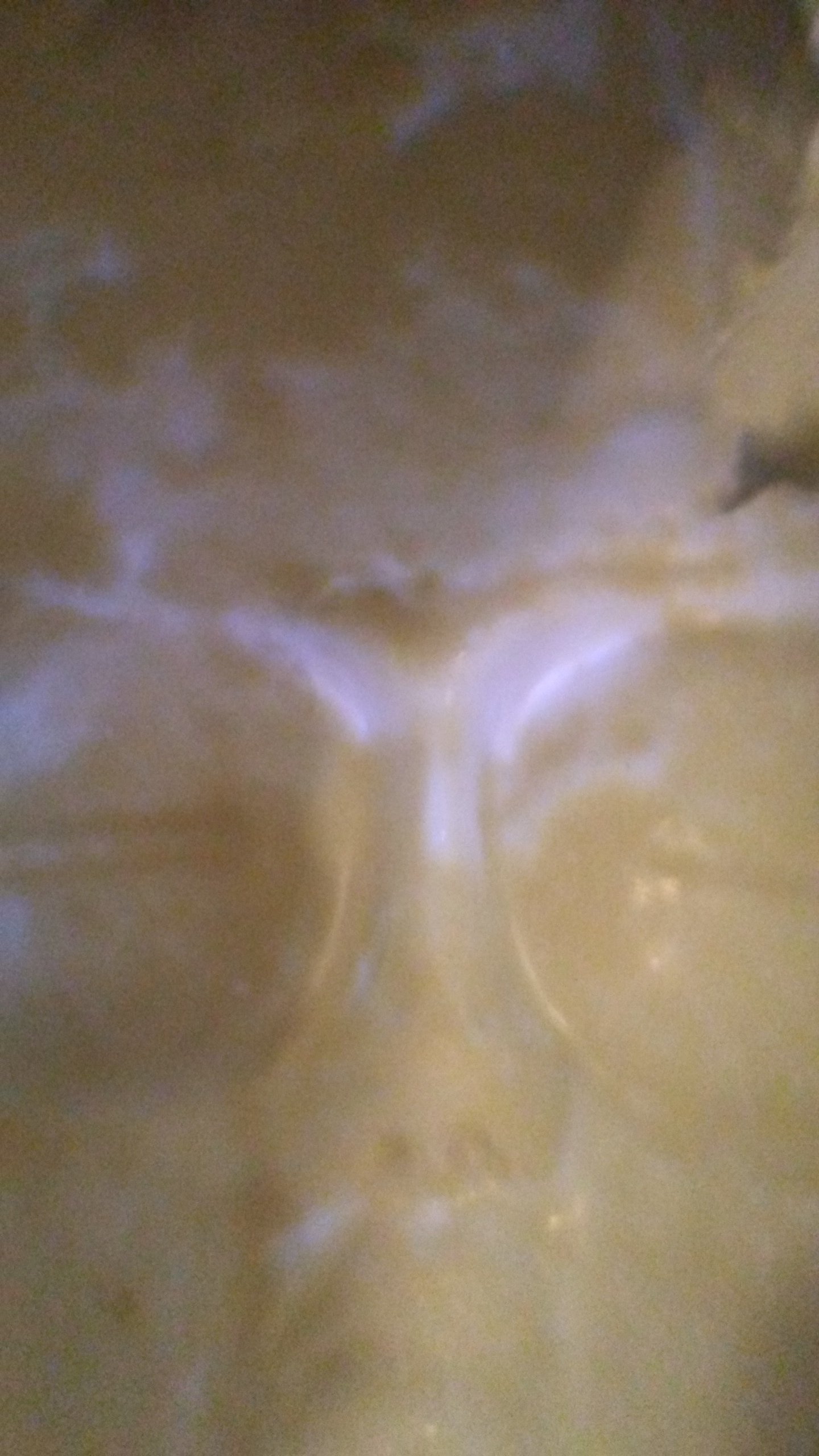

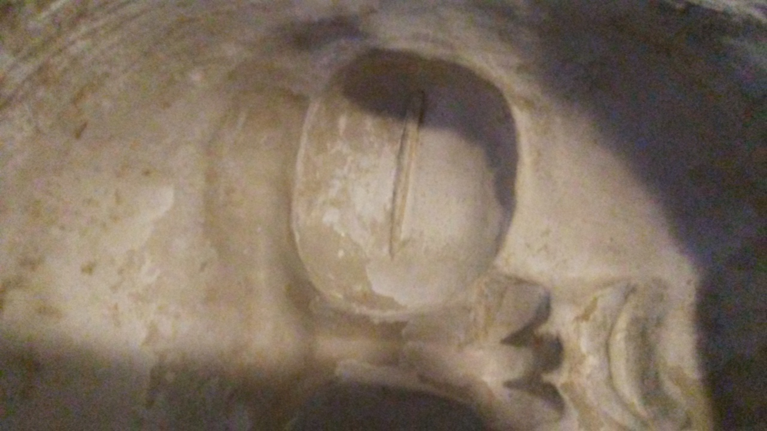

No it feels the same but you can see in the light where it was really thin in some areas especially around where the cracks were. What kind of solvent do you use to clean the mold? I can see some splotchy-ness in the same ares where it came out thin, it's got to be why it's not coating evenly.
The mold for comparison a couple days after I cleaned it.

No it went all the way through, it didn't really pool like i thought it just didn't thicken enough in some areas because of the mold probably isn't evenly dry yet.
wow, ok. I totally misread that pic then.... I'm with these other guys, then. I've never seen this particular issue. The best I can guess is what you suspect, that the mold wasn't completely dry. apart from that, I'd go over the materials you are using... What type of plaster are you using, are you using a mold release, and if so, what type, are you mixing up the latex before pouring or just pouring it straight, are you noticing separation in the latex inside it's container, what's the weather like.... man, the list of variables are large, but if you continue having this problem, it'll pay to start checking off that list...
