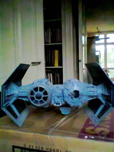

here an old picture of my bomberFoto0268.jpgwhen i look at it now the square should be a tiny bit wider ,.but this could be due to photo perspective,..i'll have to check on the real model to be sure about that
