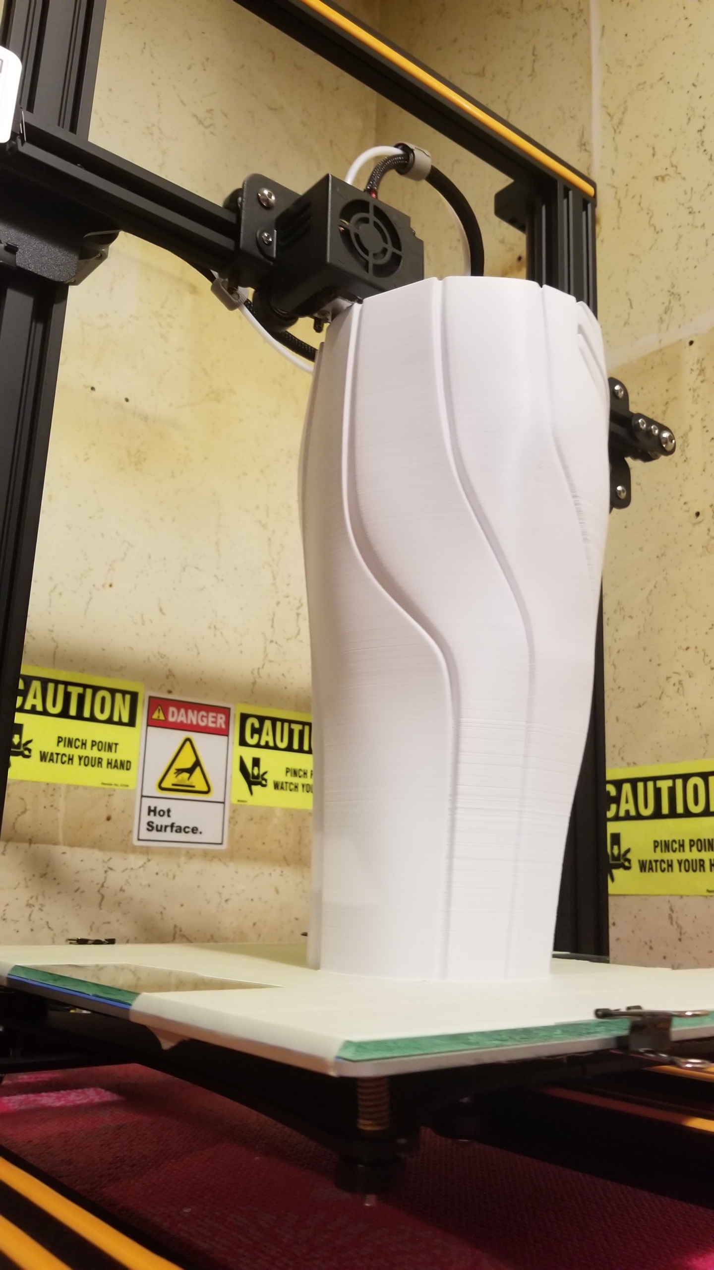

20180701_215052.jpg 20180701_221335.jpg20180705_193543.jpg First print is the chest, super glue and then filament weld with that 3d pen.

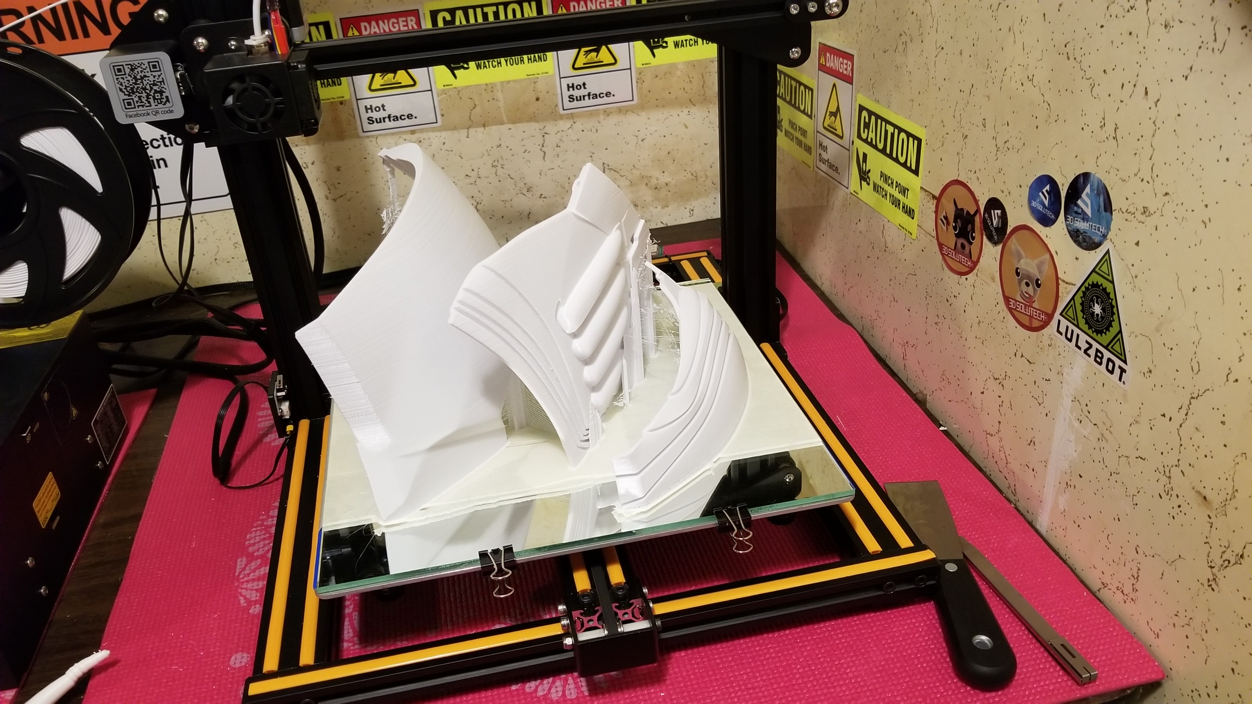

20180705_193402.jpg 20180705_193410.jpg Layer shift on a 10hr part, one of the downside to 3d printing, *sigh
20180701_184436.jpg reconfig printer and back to printing again

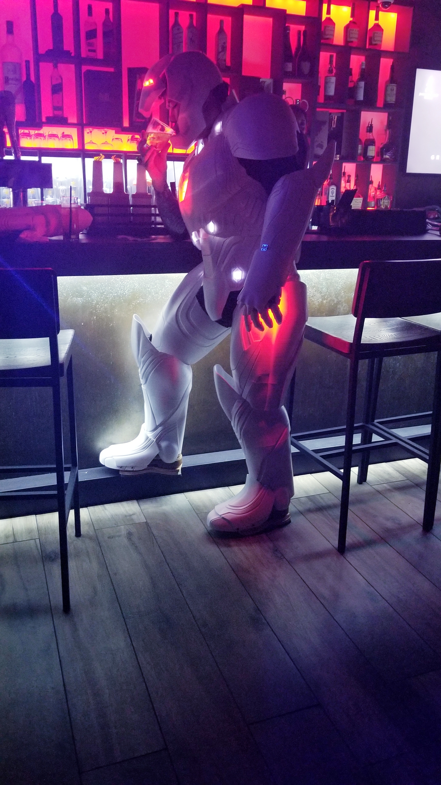

Didn't get the suit fully printed in time for Halloween 2018 so i just assemble what was done and suited up

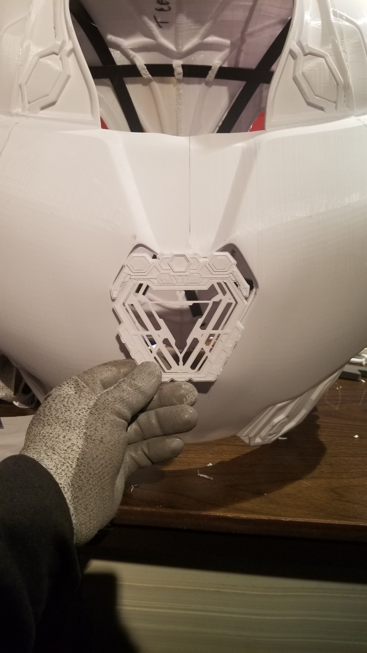

20181113_194026.jpg 20181113_204044.jpg 20181113_205230.jpg removable arc reactor
20181113_210839.jpg 20181114_081001.jpg Testing the arc for everyday wearable
20181025_215937.jpg 20181025_215942.jpg 20181025_222418.jpg Affixing reactor in its proper location, and chest piece assembled

Is there some trick of the light going on with the Reactor? In the first two pictures it looks blue, but in the rest it looks red.
DrCyanide, it was actually a newbie mistake, i totally forgot that i scaled the chest armor 5% larger and the original blue reactor printed normal thus was too darn small. A second reactor was printed in the nick of time scaled to match the 5% and with my luck, i ran out of blue led diodes and scrap thru my junk drawer and salvage red leds, it was less cumbersome to redo the wiring brand new than unsoldering the blue setup, just learn how to solder and it wasn't pretty haha.
