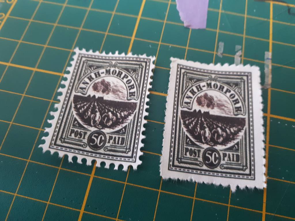

Did a quick test using the transfer wheel. I printed a quick sheet of discworld 50p cabbage field stamps on 80gr paper using an inktjet printer. The design isn't mine but are an official discworld stamp from 2016 which I'm only using as a test. I'll have my final designs printed at the printshop using a laserprinter for better results.

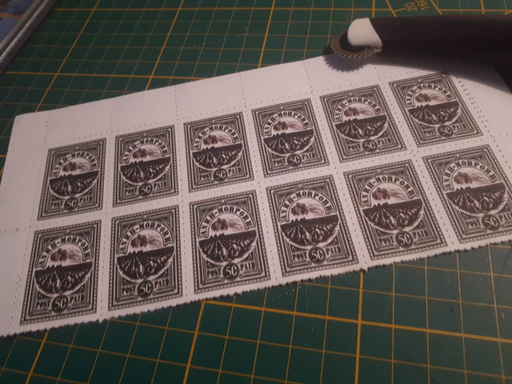

I have had great success with the brass tube.
In Illustrator I formatted my stamps out (spacing, etc) and made a very light row of dots where the holes should be. I don't have a sewing machine, so it was one hole at a time but I was VERY happy with the results.

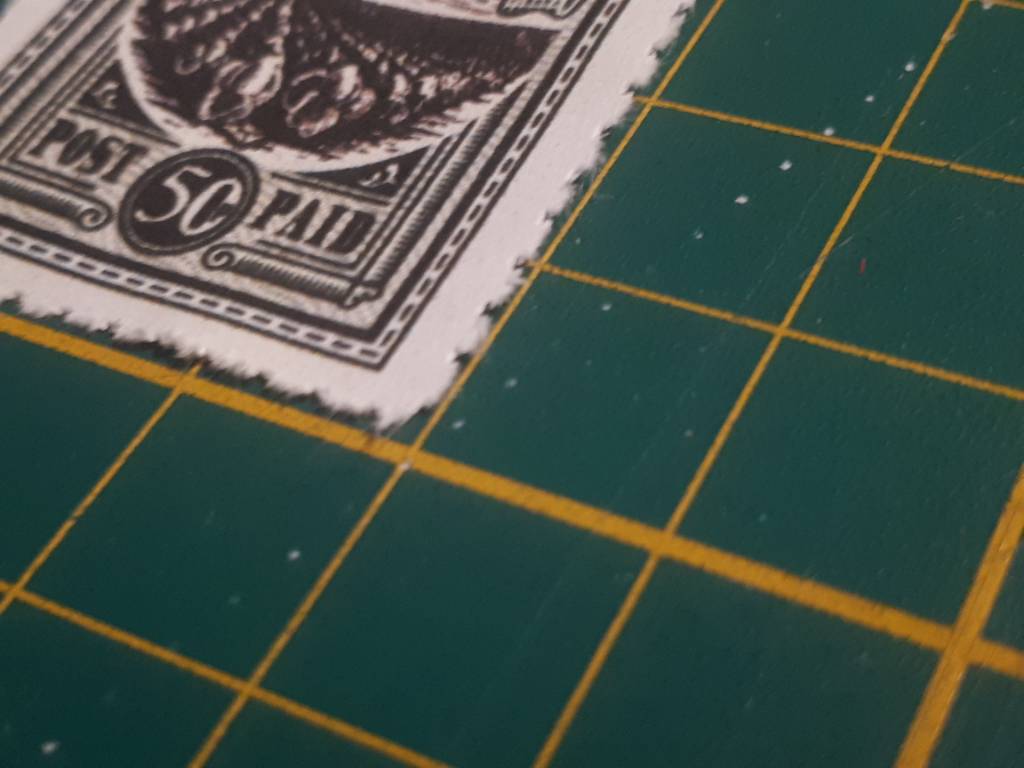

I used this tiny bottle opener/hammer thing haha and just lined it up, did one little bop and punched each hole out...one at a time...by hand.
The tube lasts though and you will need to clear out all the little punched dots that clog the tube. You will also want to sand the end slightly and make a sharper angled point for punching.
Again, it's the best result I've gotten for cheap. The transfer wheel is kind of a "dash" shape rather than a "dot" and any sort of pro stuff gets pricey.

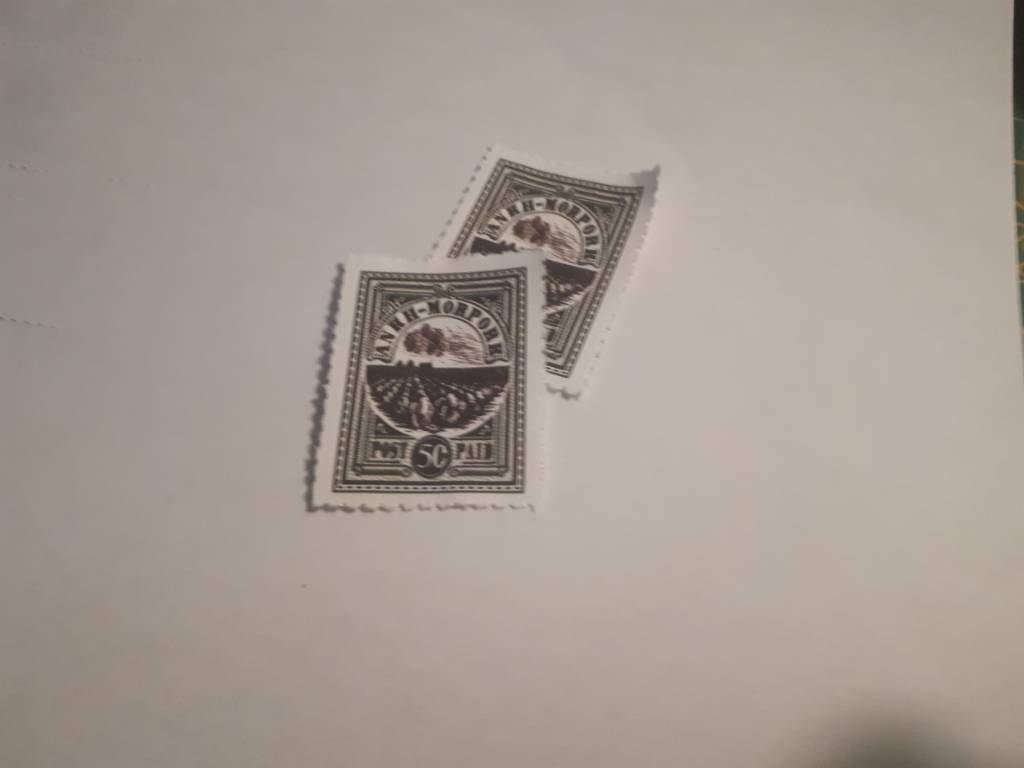

As part of a pulp RPG campaign I ran several years ago, I created period handouts, specific for each player. The setting was rural England, around 1932. In the process, I created several letters, with envelopes and stamps.
The stamps (and just about every other graphical element) I made through Photoshop and a simple all-in-one inkjet printer. For the stamp edges, I also used a transfer wheel. But mine is an old one, previously owned and used by my mother, back when she made a lot of our clothes when I was a kid.
At first glance, the results were more convincing than those with the new wheel. Probably because of its construction; the wheel is made of thicker metal, and it has a wooden handle. I think it was made somewhere in the early seventies.
So maybe getting yourself a vintage wheel might also be an option?

Did a quick and dirty test yesterday using the brass rod by hand and it works but takes forever :). Next stap the sewing machine methode
