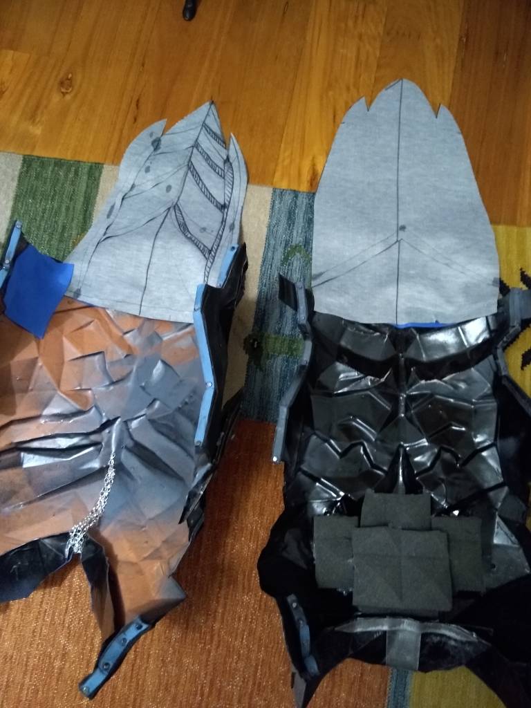

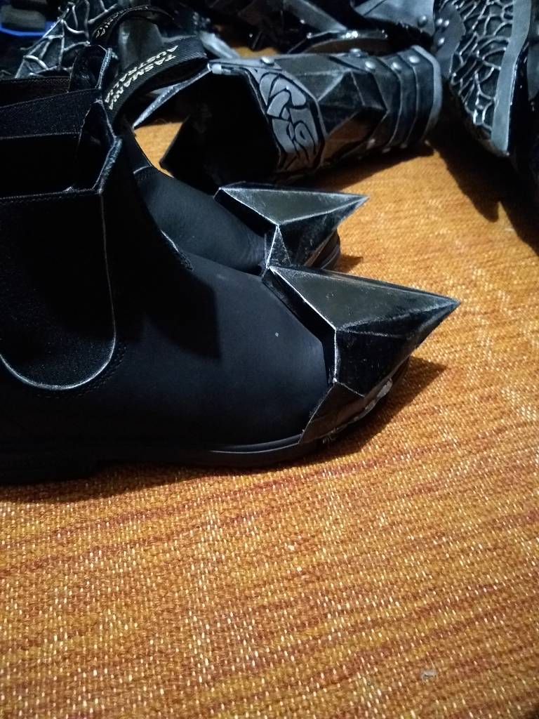

And I do have photos, just of the toe/boot I will be wearing, and the insides of the chest (soundproofing foam as padding on the back piece)

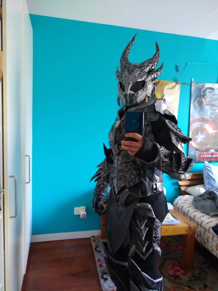

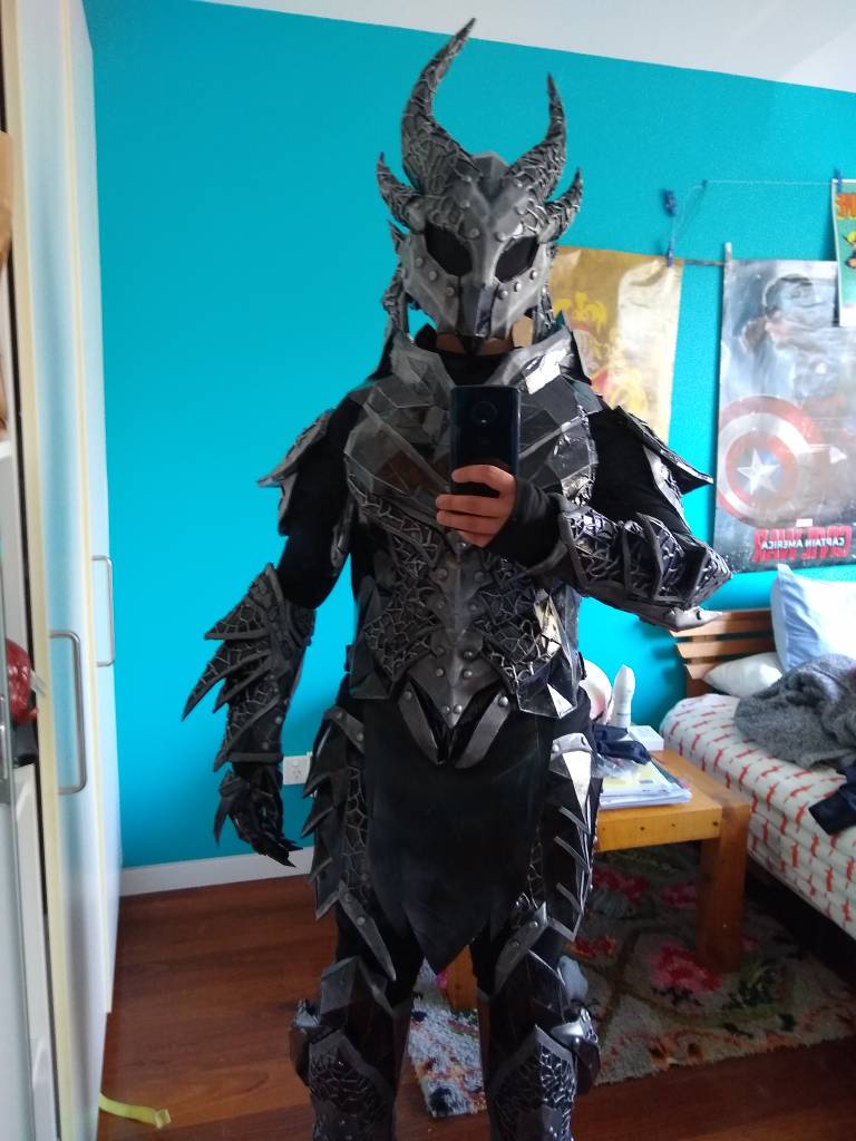

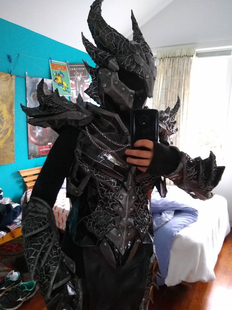

I couldn't resist and decided to do an almost full test fit. I'm missing the shoulders, neck, and a glove (but that was just so I could take the photo). I'll be doing a proper suit up/360 view/range of movement video either on the day or once I get it fully finished and have a friend around to help me out.

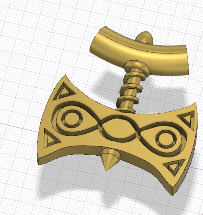

I just realised I never posted a picture of the Amulet of Talos that I 3D modelled! I did this weeks ago, and I will be getting it 3D printed soonish. If anyone wants the file just let me know. The macaroni shaped bit up the top is hollow, so I will be able to put a chain or leather cord through.
In the future I might mould it so I can make copies.

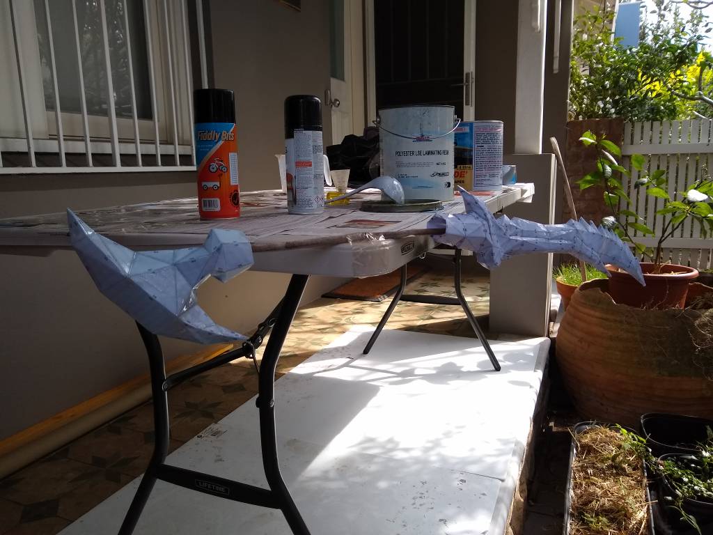

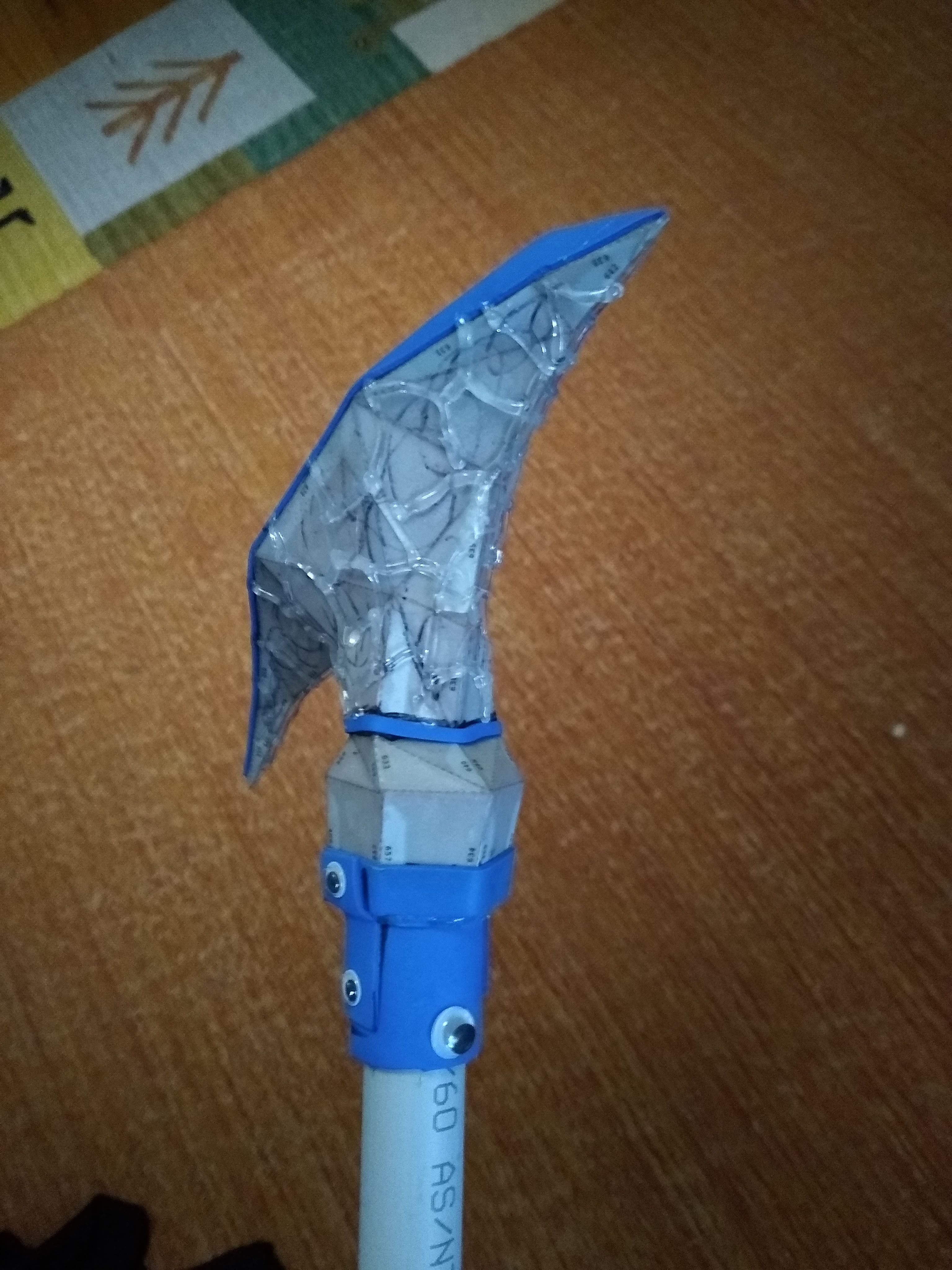

Wow ok, it's getting closer and I'm starting to stress slightly. The first spear tip that I pep'd was waaaay too big, so I did another one. I'm going to be doing the resin today, as well as hopefully attaching the pauldrons and cloak. Expect some more progress over the next few days. It was dark outside when I finished the pep, so the photo isn't too good. Sorry bout that. Not super related, but I've been looking into my next project, the Praetorian Guards from The Last Jedi. I want to get started on at least working out the templates pretty soon after Oz Comic Con, so expect to see a new thread about that sometime in October/November.

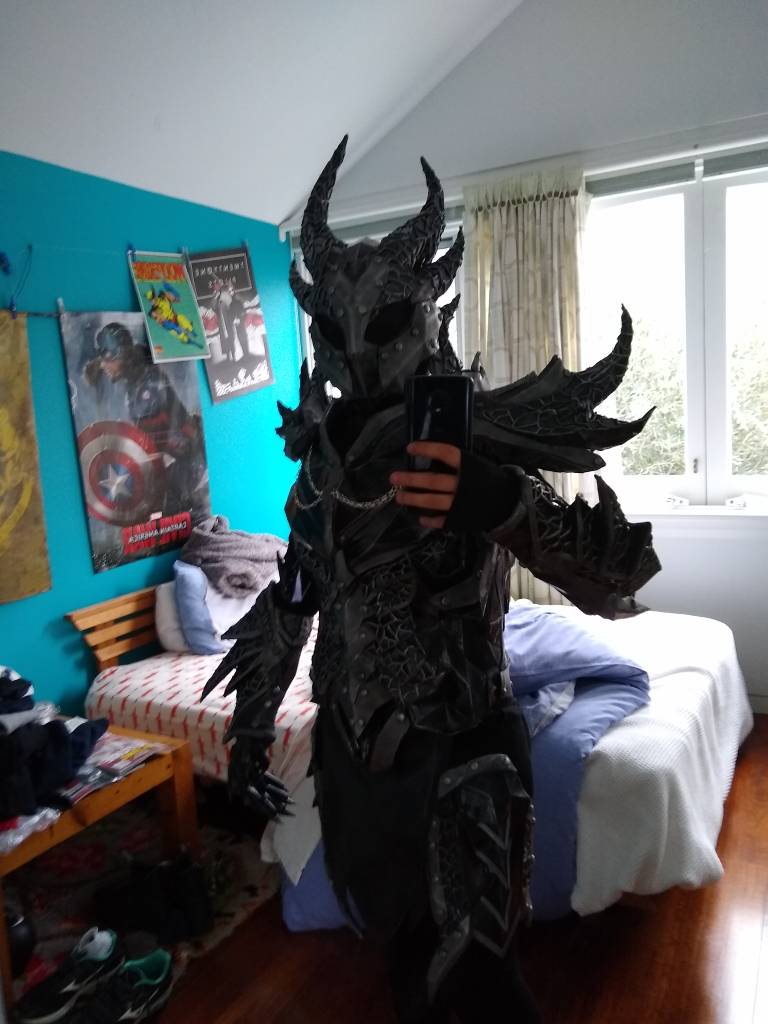

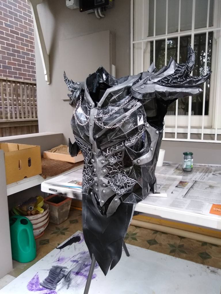

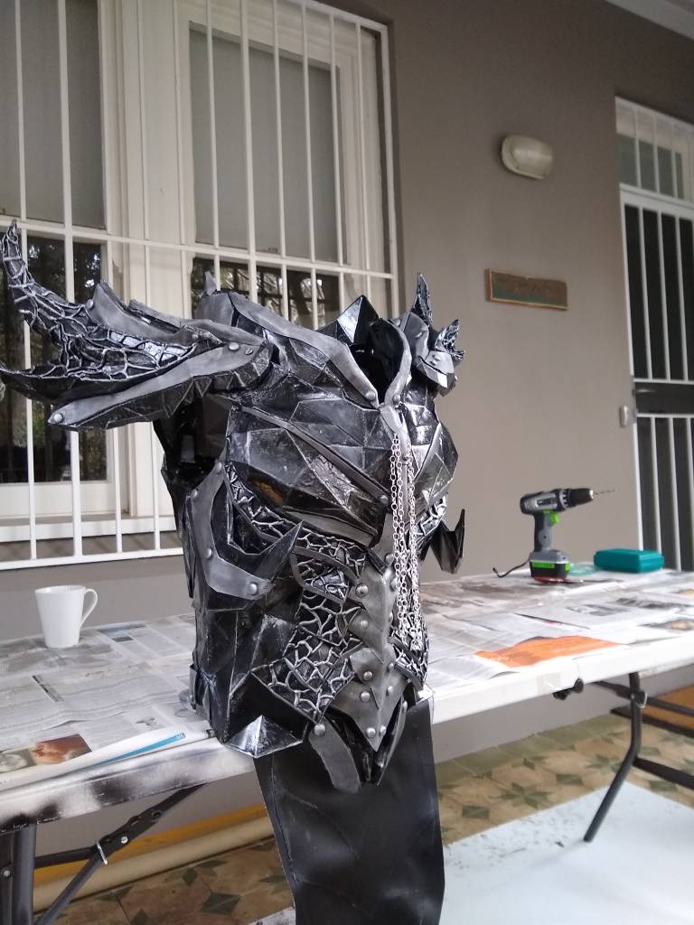

So I've been working non-stop for the past 4 hours (and listened to 2 episodes of We've Got Ward) and I've made quite a bit of progress again. First off, I've done all the resin for the spear parts. I made sure to do my inner later extra thick, I will either be accidentally banging it into things or dropping it and I don't want anything to break.
I'll be continuing with detail and paint for that throughout the week. On the subject of paint, I touched up some areas that I missed before, normally just around edges. No pics cause it wasn't that noticable, but it was bugging me.

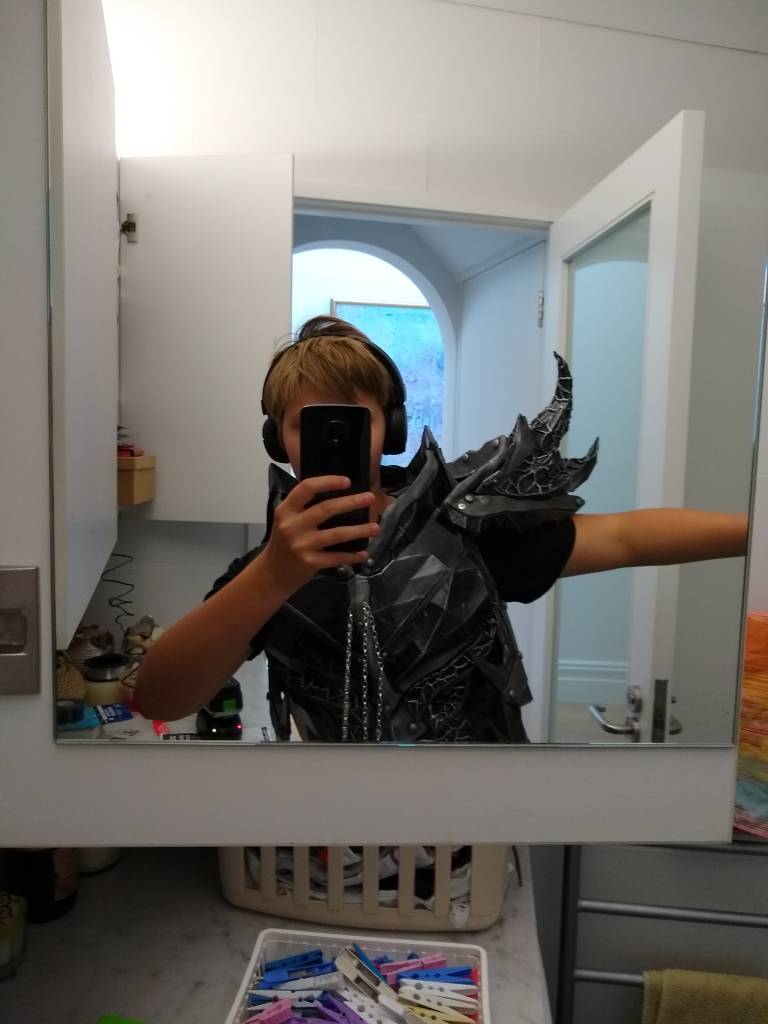

I also (finally) got the pauldrons rigged up and attached to the torso. I can in fact get them on myself with a bit of stretching, but I stupidly forgot to put on the upper arm pieces for when I took the photo, so you get to see my skinny little nerd arms.
They sit in roughly the right place, and have a small degree of movement up and down, enough that I can swing a (prop) weapon and get my helmet on and off.
The cloak I'll hopefully finish up tomorrow, all I really need to do it cut some holes to attach it over the Chicago screws. I'm going to attach at least the screws on the back permanently to the armor, but probably leave the front ones loose for ease of access. I'll just see what works I guess.

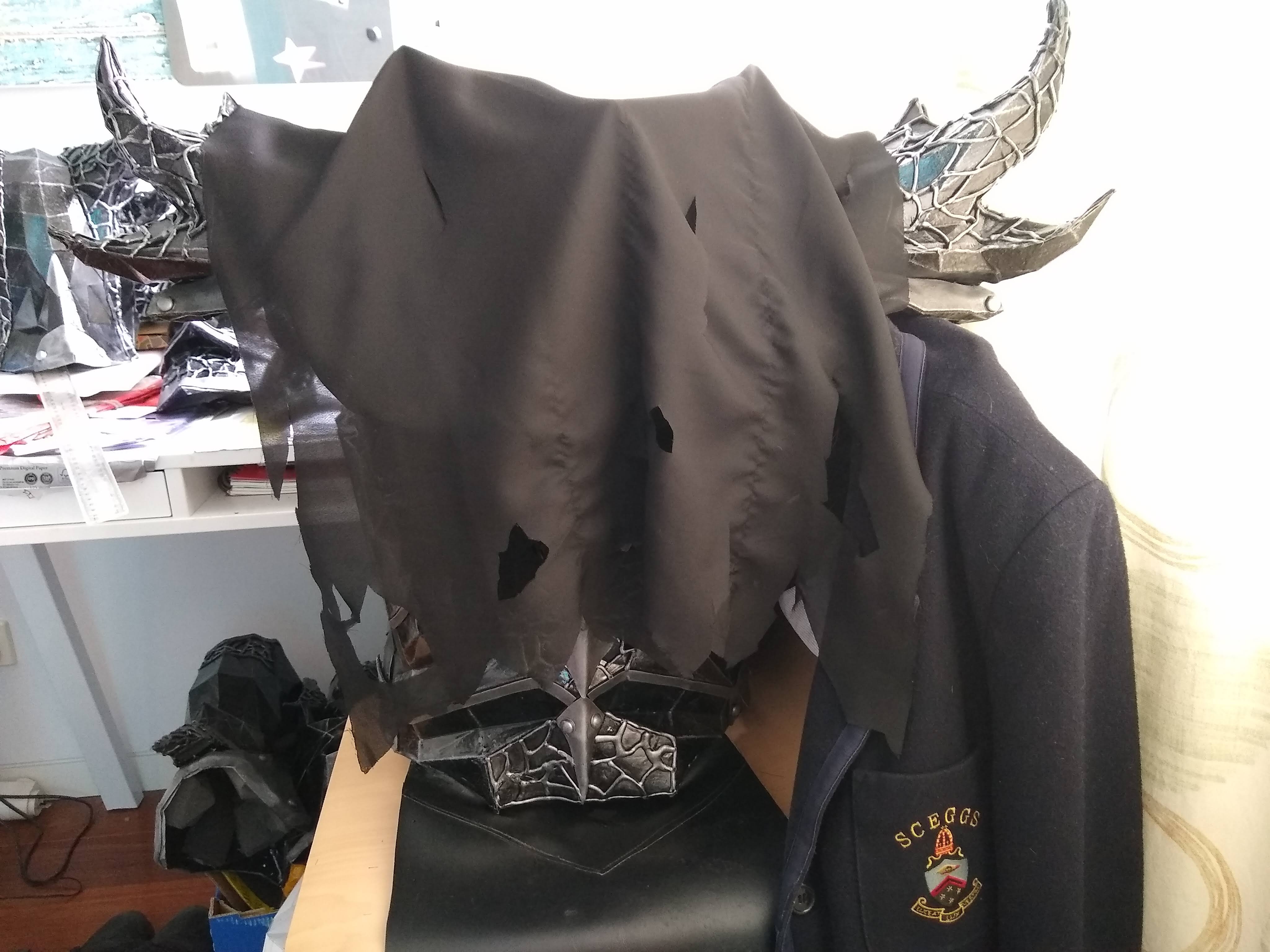

Damn, just over a month. I'm both excited and nervous, I've signed up for the Cosplay Active comp and will probably just do some poses/talk about the costume but I'm still kind of scared haha. Anyone got some tips for my about being up on stage?

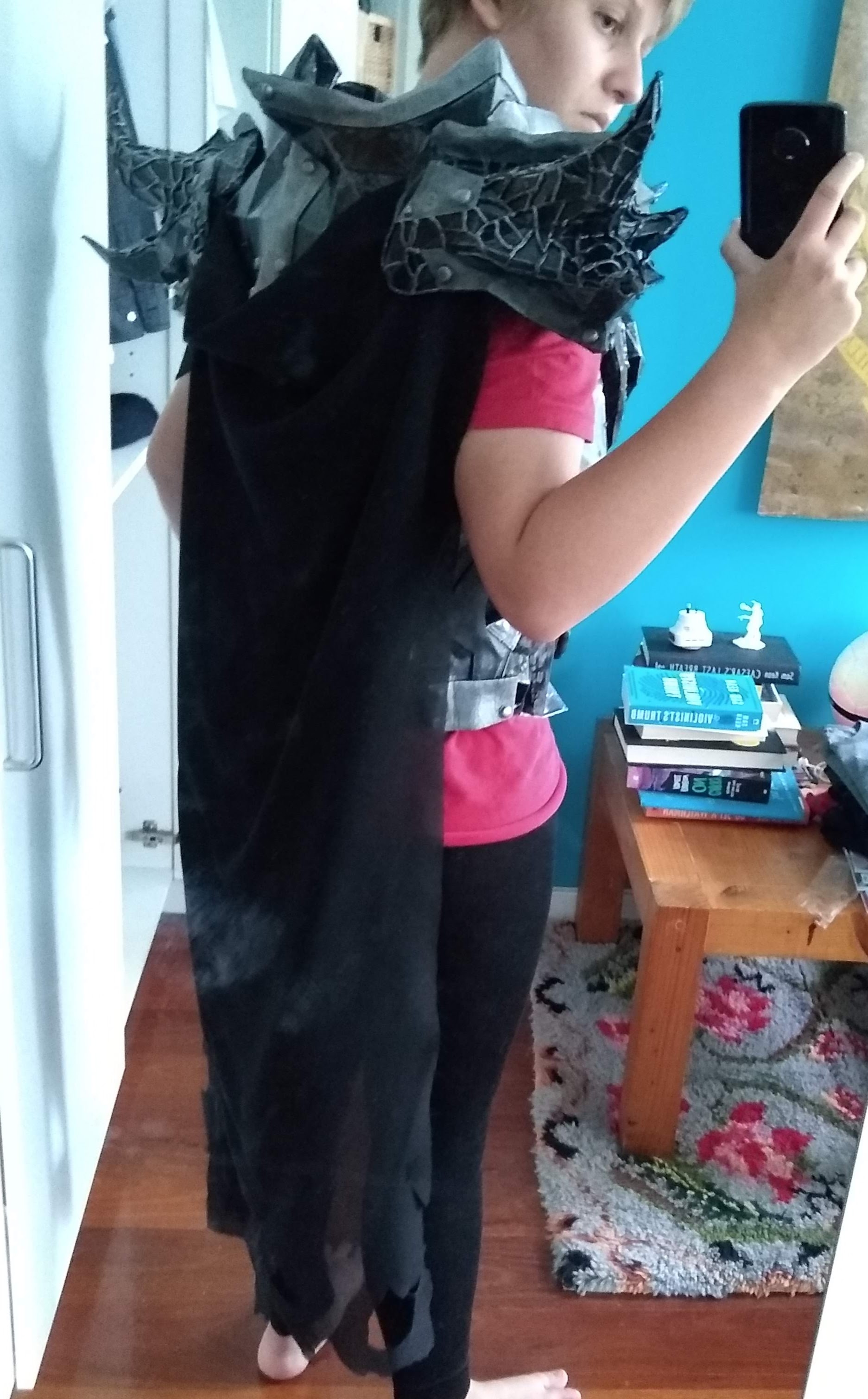

Anyway, I've done the cloak. The fabric is a little transparent, and I've added some rips and made the end kind of scraggly, and the fabric will probably fray a bit more before the con, which I want. The photos aren't particularly good, shockingly enough, it's hard to take a photo of your own back. The second pic is just showing the end as you can't see it in the first one.

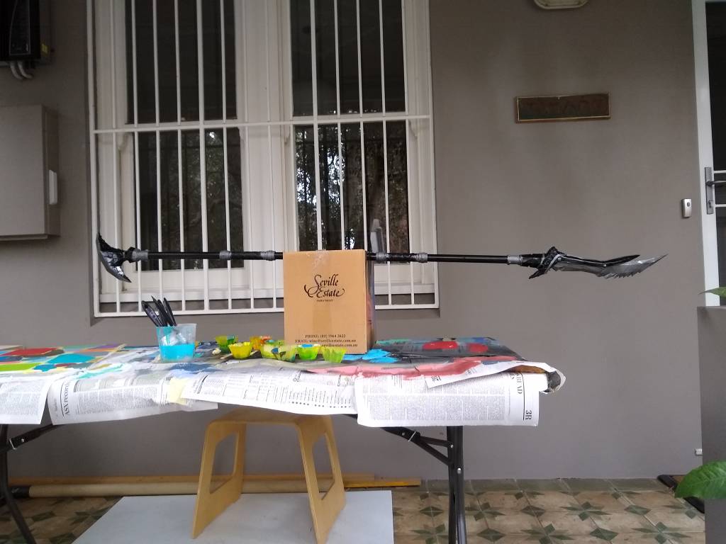

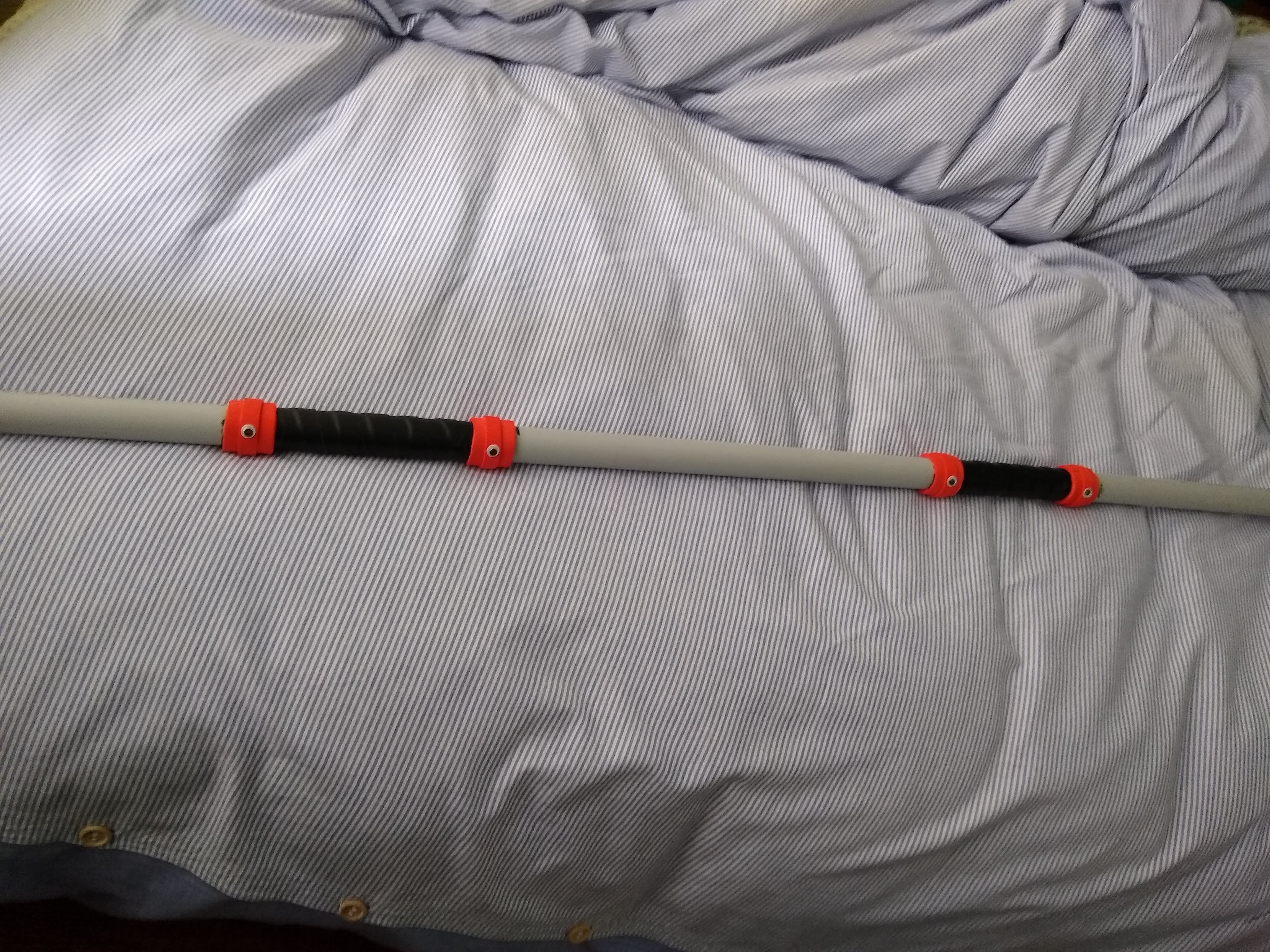

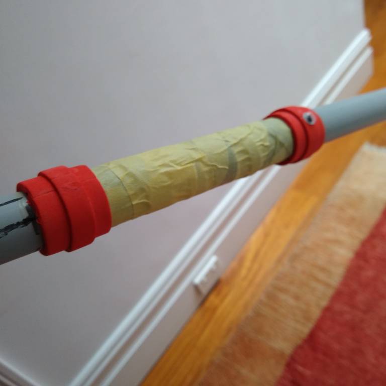

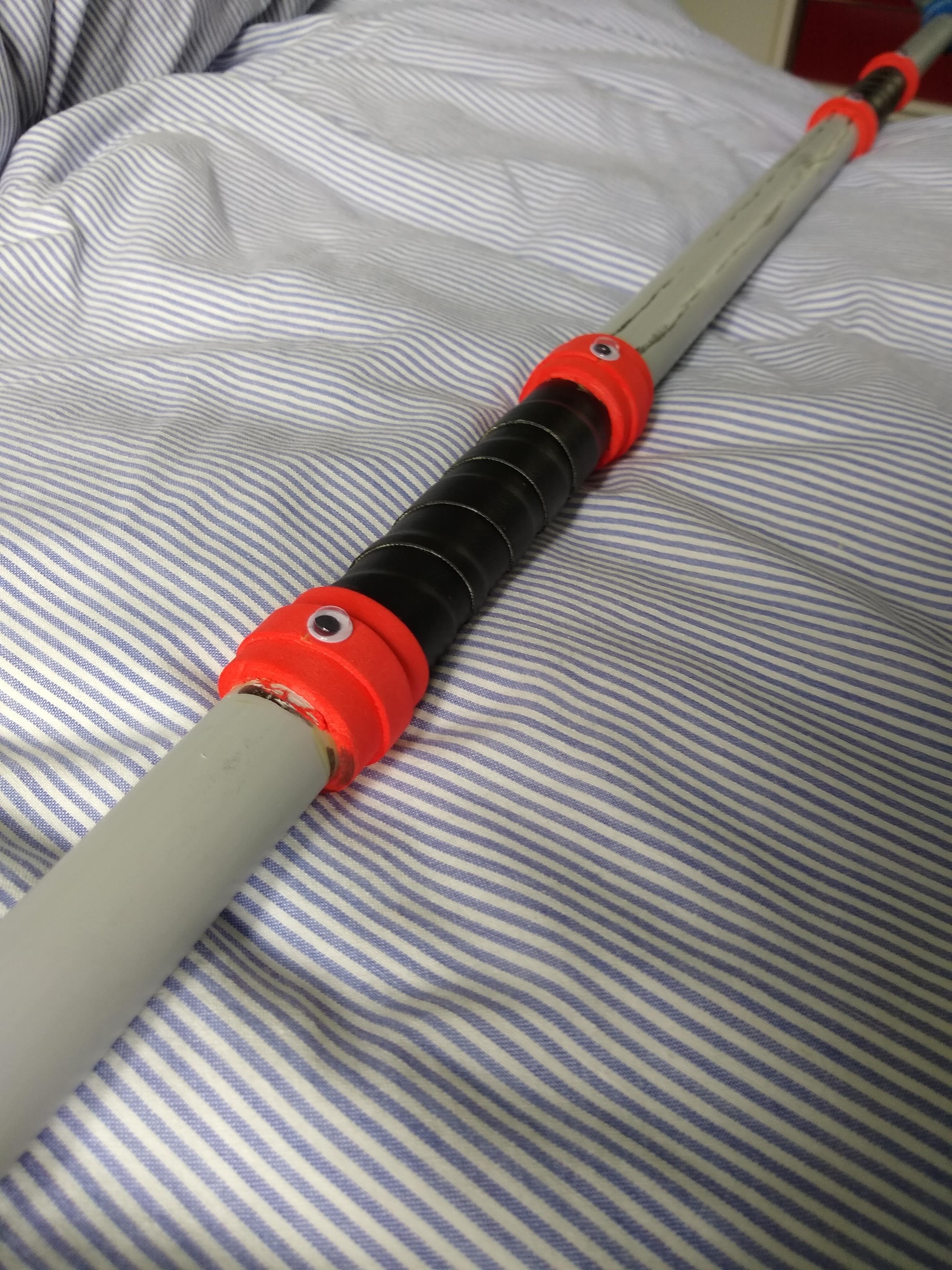

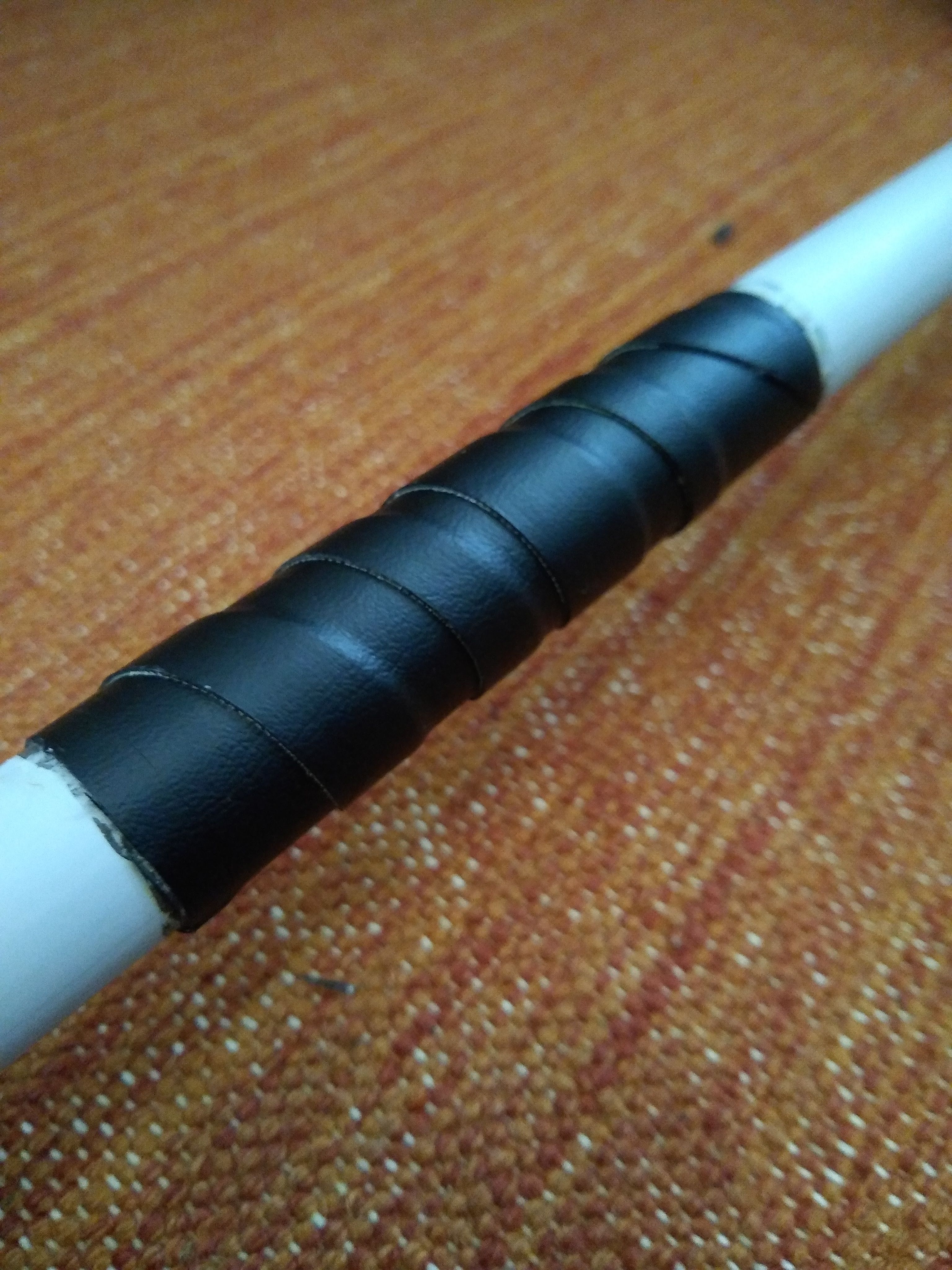

I've gotten the construction and detailing on the spear all finished up, and I will hopefully do the painting over the weekend. The black stuff is fake leather that I wrapped around and stuck down using contact cement. I'll mask it off when I paint, but I wanted to do it before I added the foam bits as they help to hold the ends down.
First step, the fake leather wraps. These were spaced 39cm in from each side (1/3 of the remaining length of the haft), and each one is 14cm wide, the perfect width for when I have the gloves on.
The foam was 2 layers of craft foam, so 4mm total. I just sandwiched them together with contact cement and trimmed the overlap slightly, and it ends up without even a visible seam as long as you glue it right. Each strip was 3cm wide (these parts were possibly the only time I did actually measurements haha)
Finished it off with one layer of craft foam, 1cm wide, plus some googly eyes. I ended up removing the ones in the middle, I was worried they would fall off as I slid my hands around, plus I think it looks better. I was also going to add some more detail with the foam + some runes in that middle section but I didn't want it to be too busy.
Both handles done.
The finished bottom part. I sealed the foam on this part as well as on the blade with just a thin layer of contact cement (which works surprisingly well, though I wouldn't use it for a fully foam build) as it provides a slightly different look, and the silver parts on the weapons do look different to those on the armor.
The blade. I just realised I hadn't posted a pic of the fully detailed blade, so here you go!

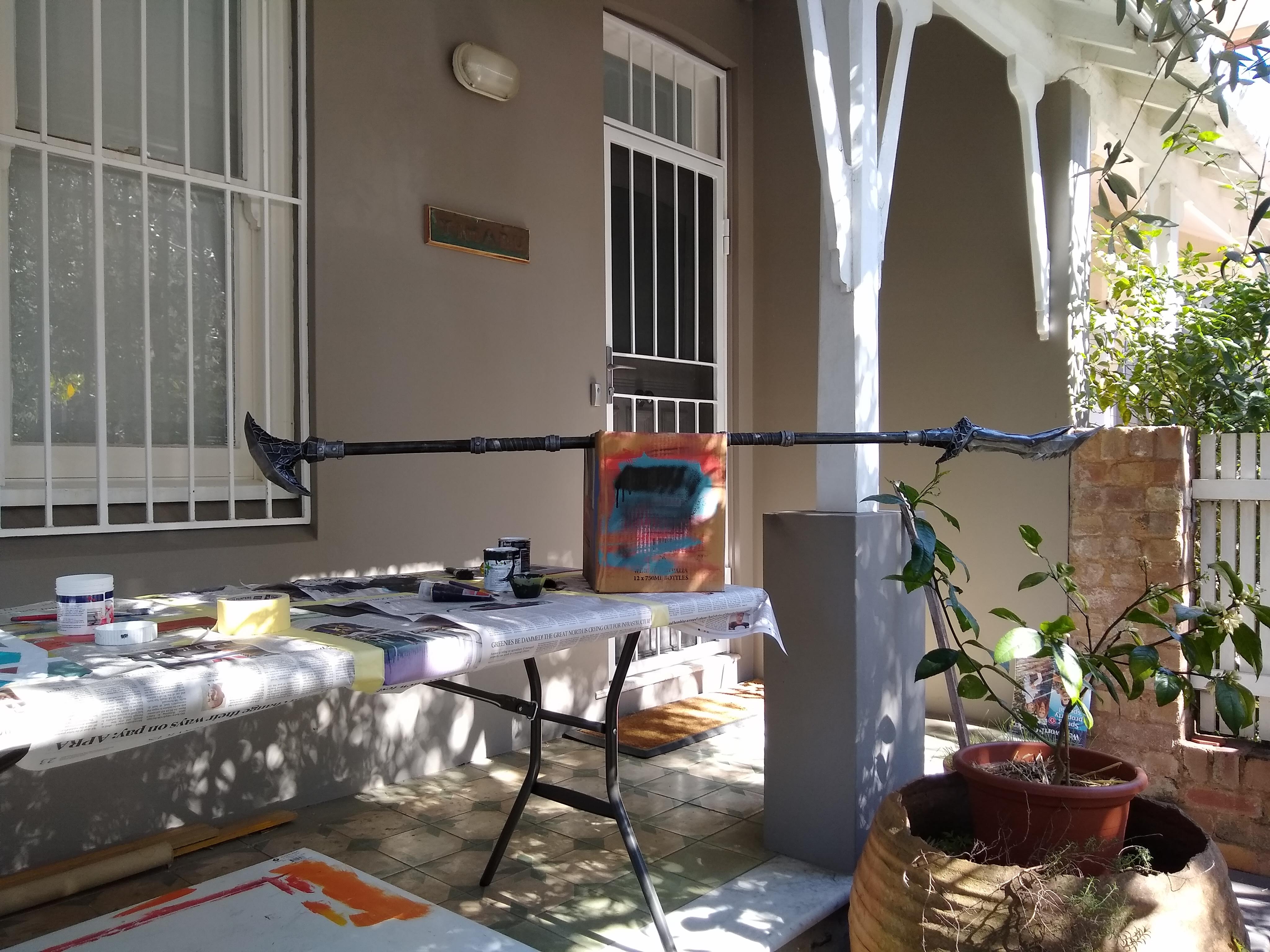

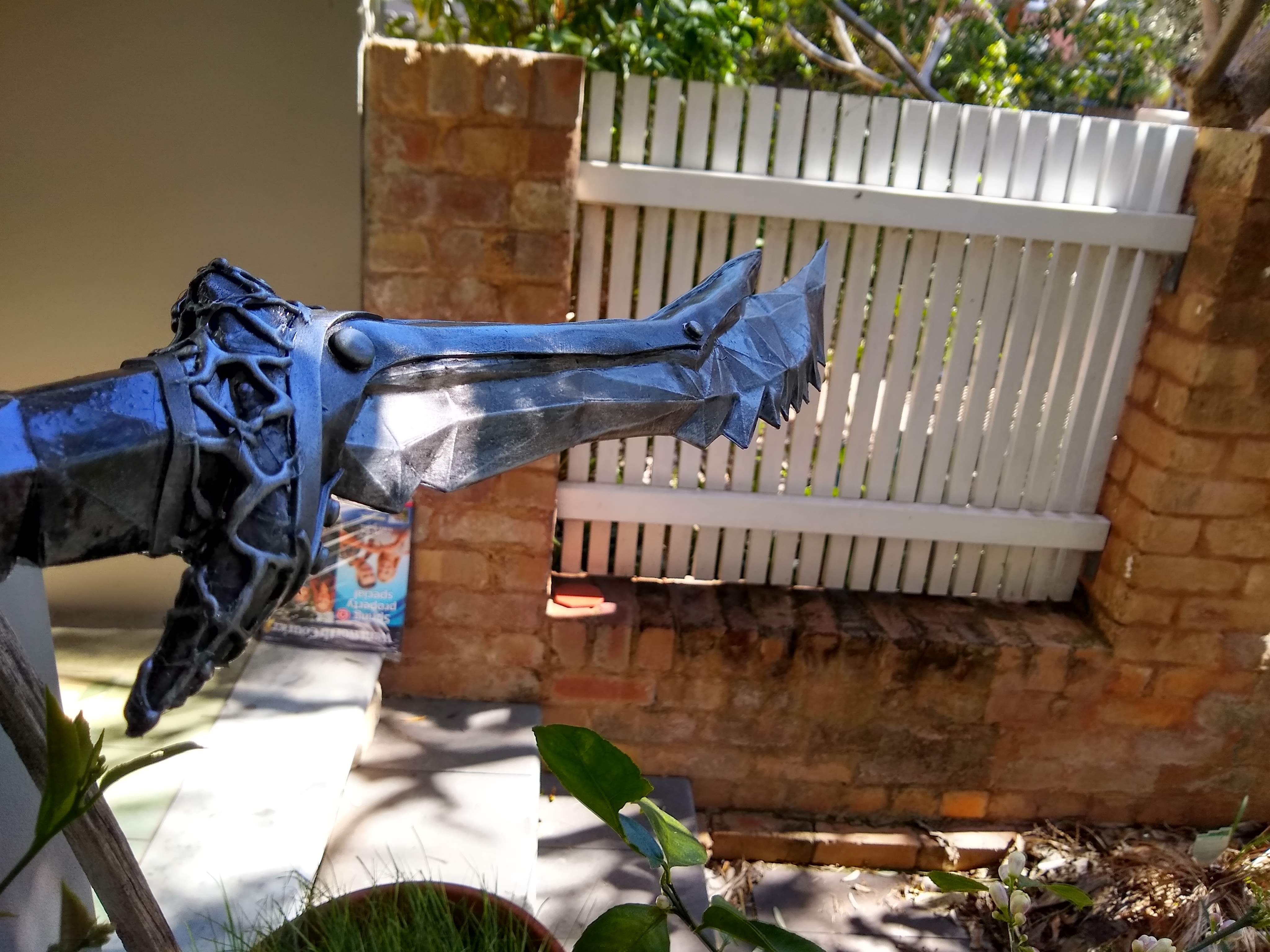

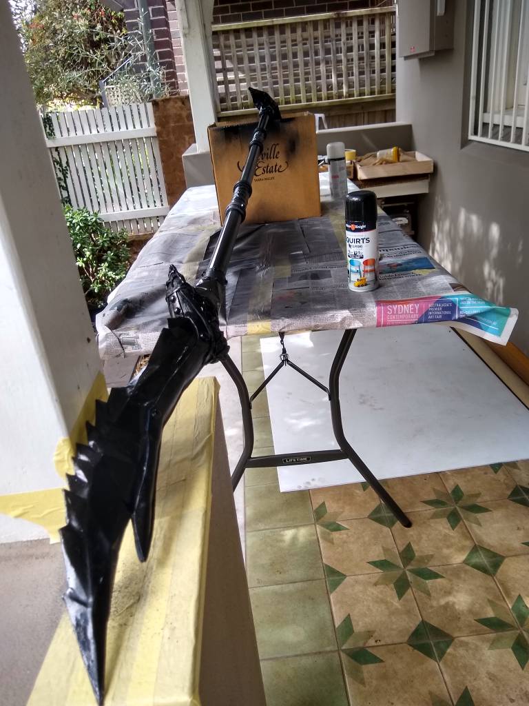

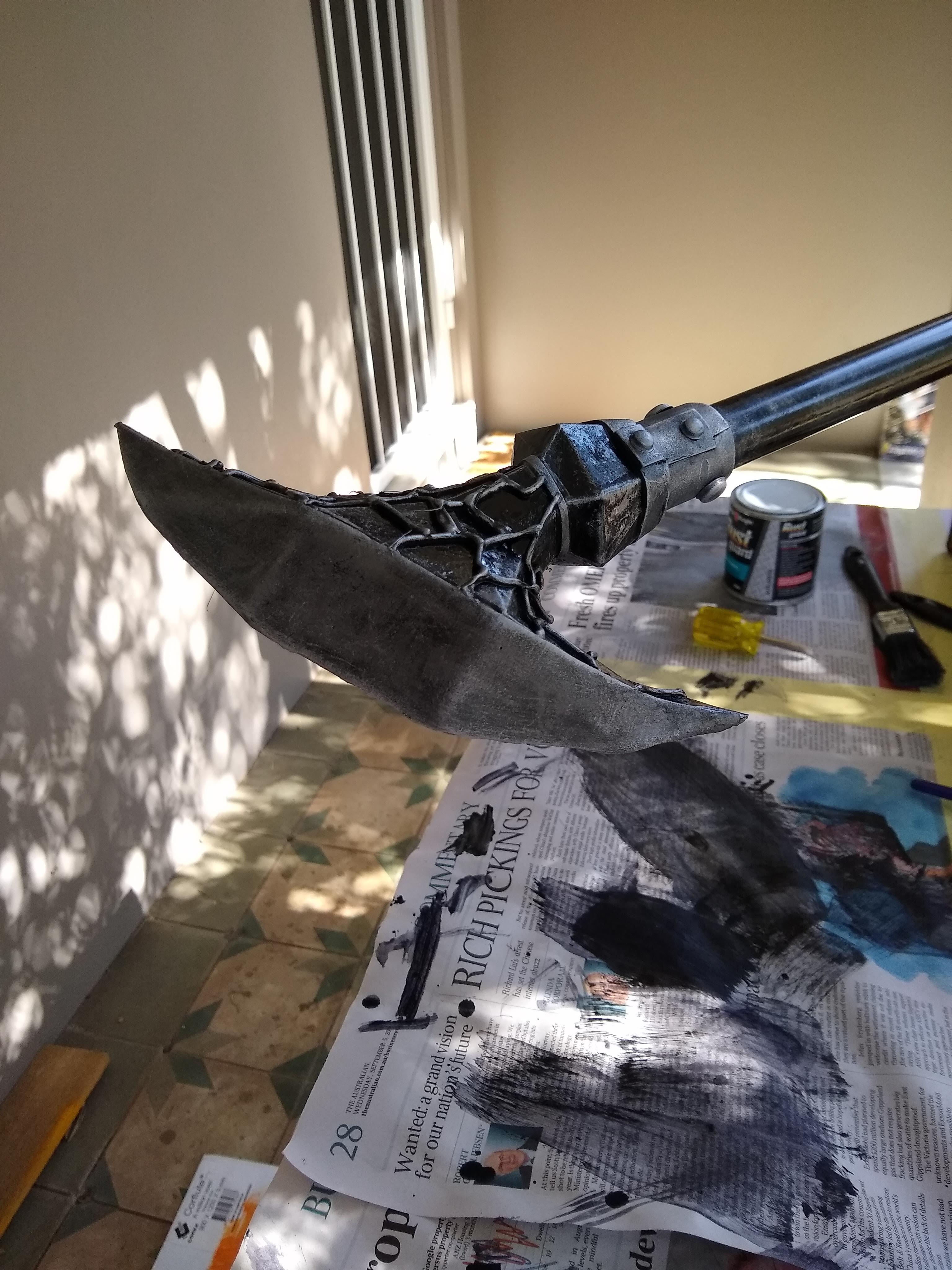

I got most of the painting for the spear done today, I'm letting the enamel paint dry overnight before I do the weathering tomorrow though. It's been kinda rainy lately, otherwise I probably would have managed to get it all done today.
I masked off the handles, then sprayed a later of black, then the dark silver enamel. Nothing really different to the armor, except for the fact that the blade is painted silver rather than some of the details.

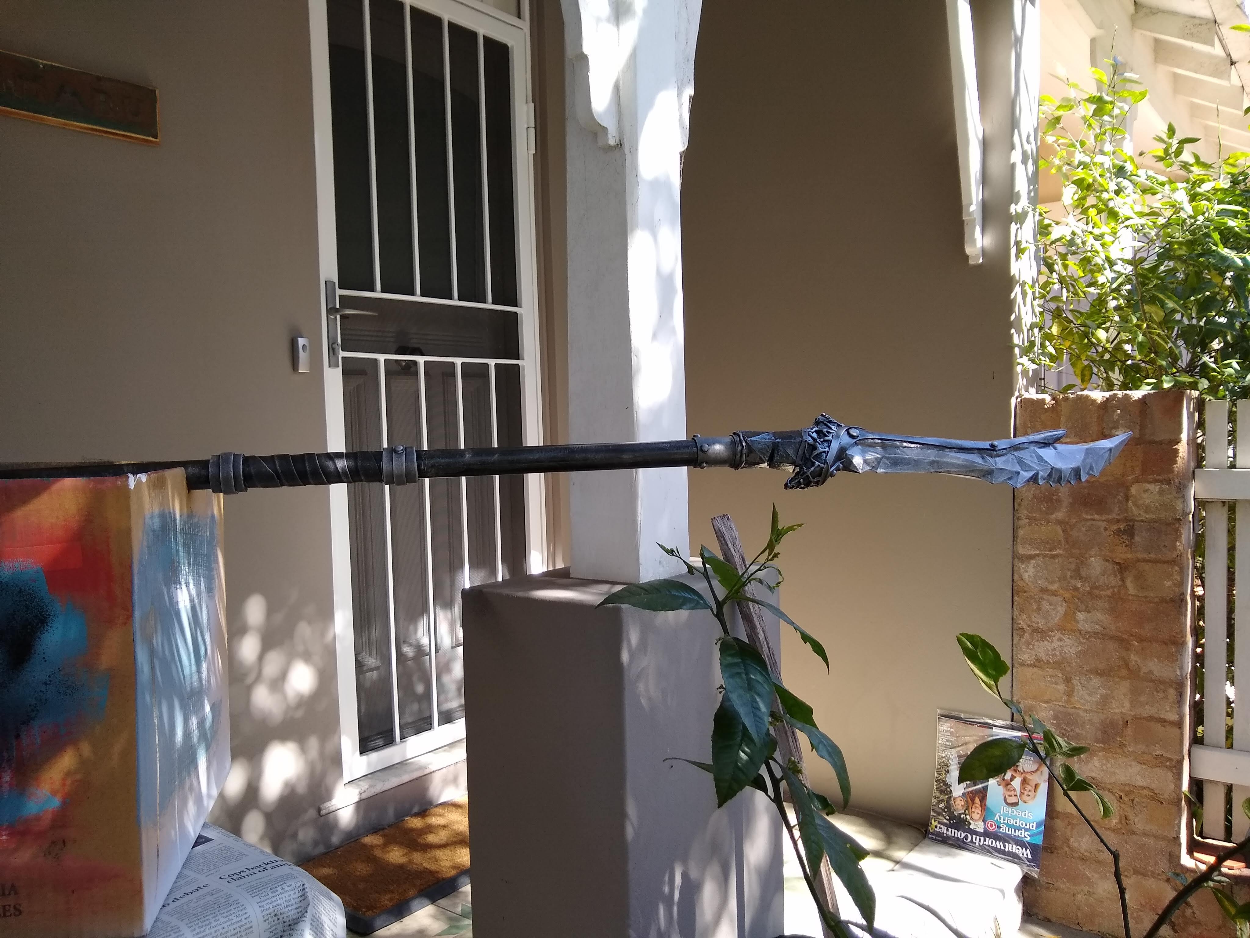

So it's all finished! I got the spear done yesterday, and so it is officially done. I can't really suit up on my own, much less take good photos of the full thing, so I will do so on the day of the con. Anyone else going to be at OZCC Sydney on the Saturday?
Here is a few pics of the spear:
