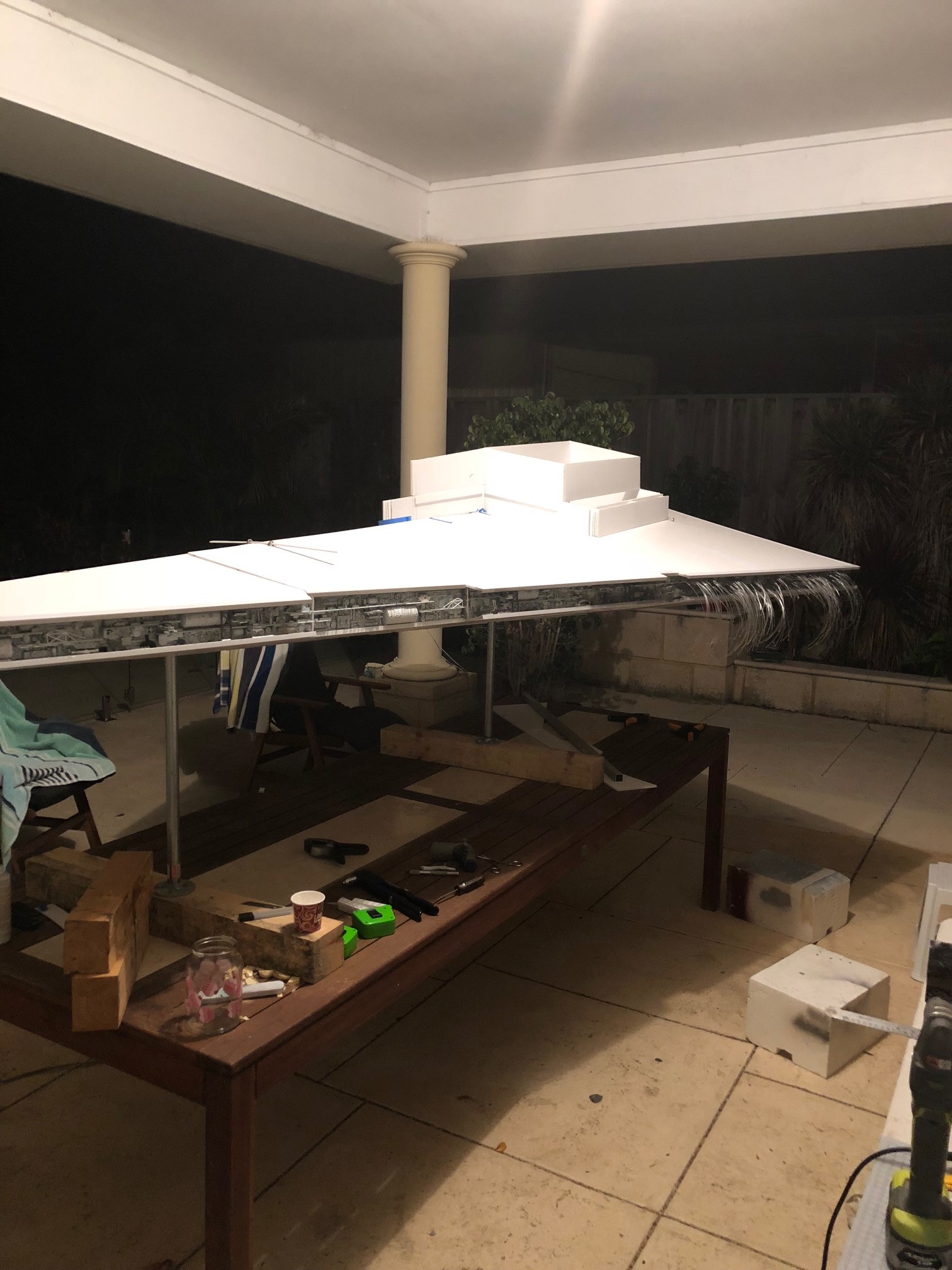

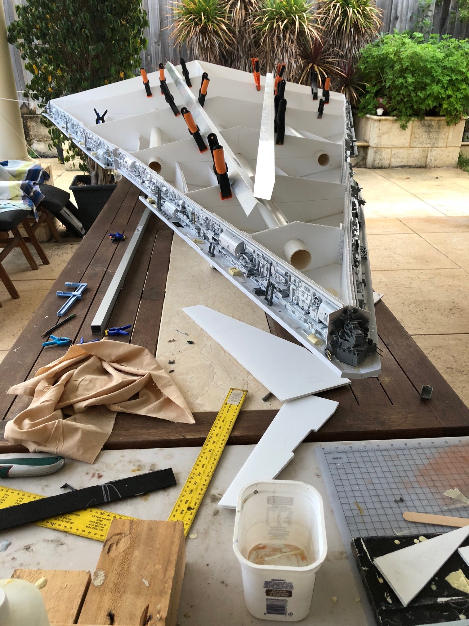

Just one of our local plastic dealers is in 6mm core flute. the whole structure cost is Just over $100.
The next one will be made of foam board. I found this material later in the build and it works very well if model making.
if your location is in Perth WA I can let you know the company and address.

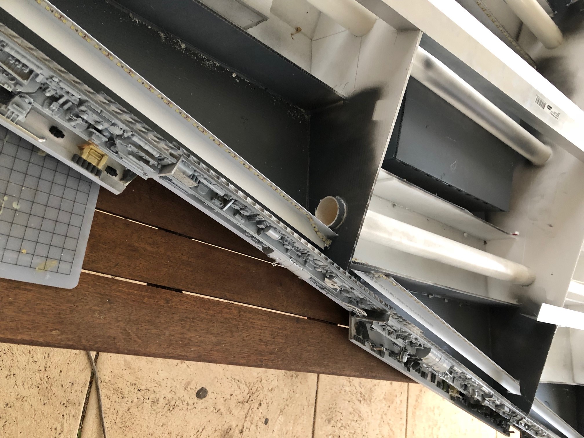

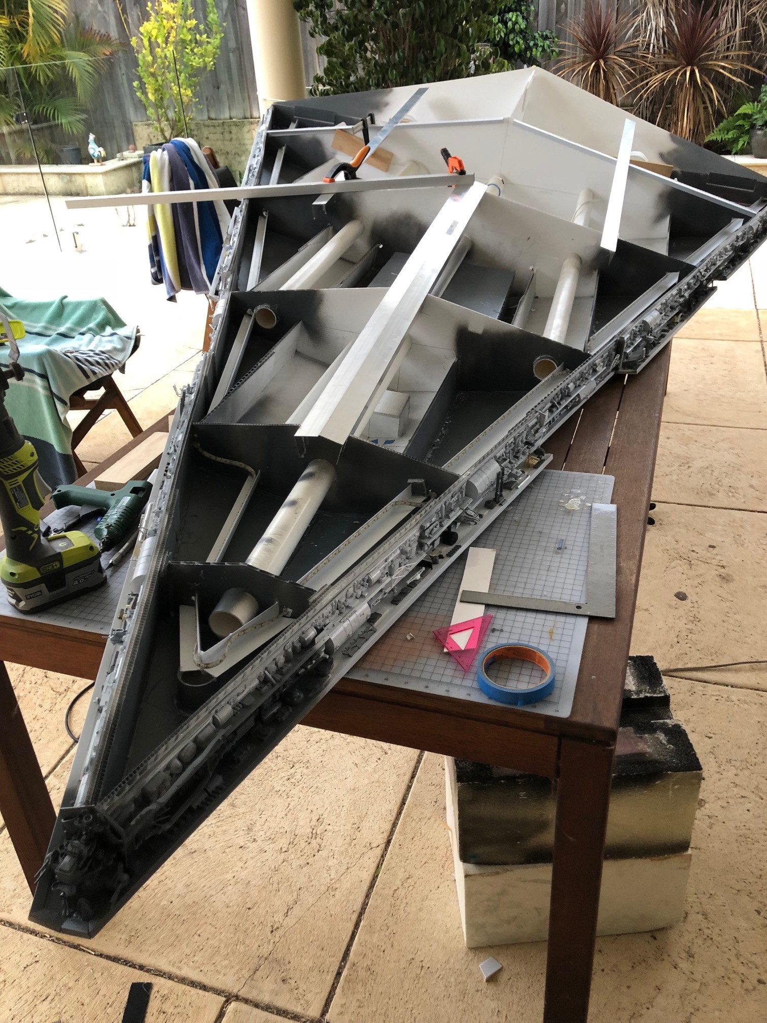

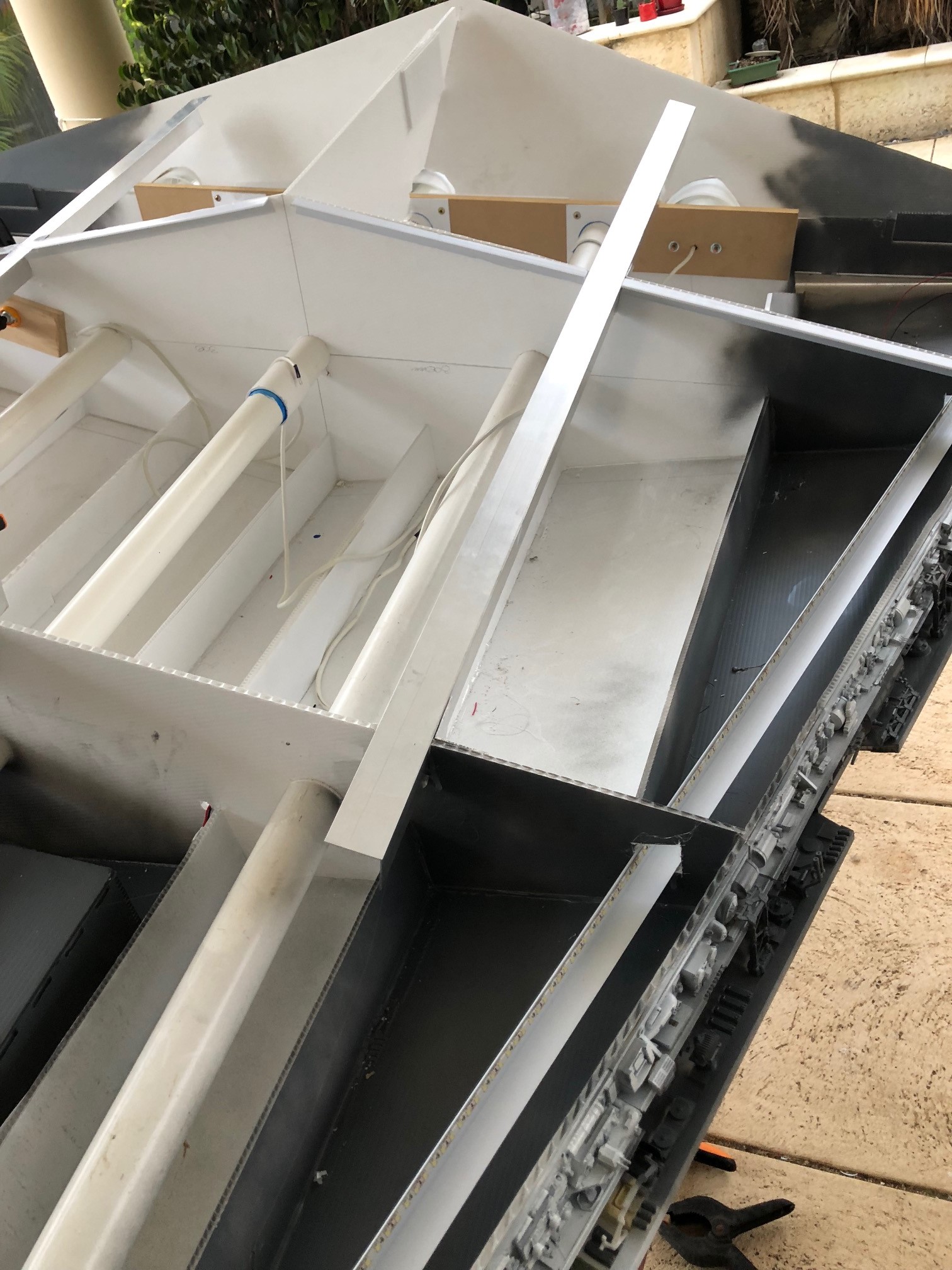

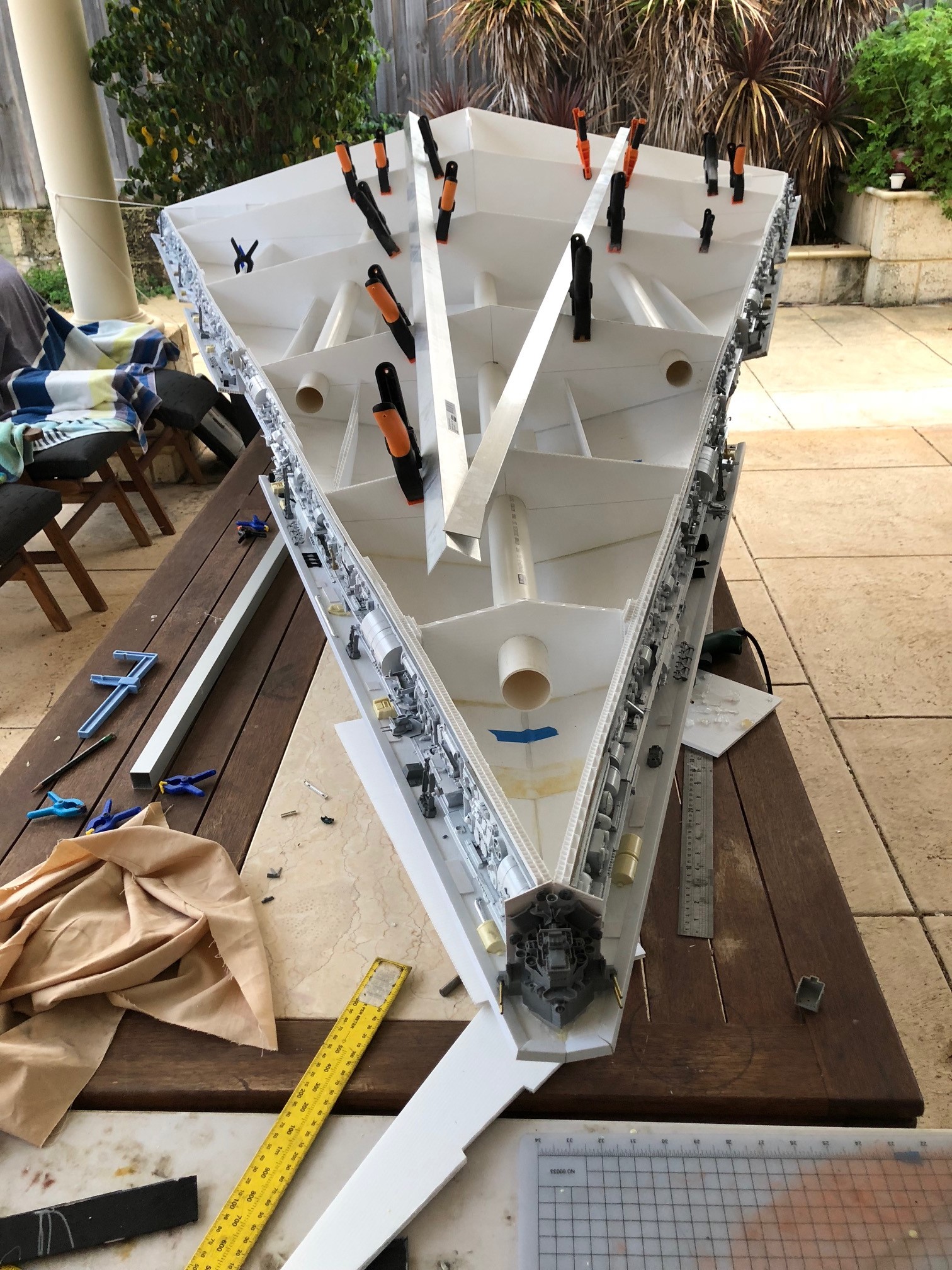

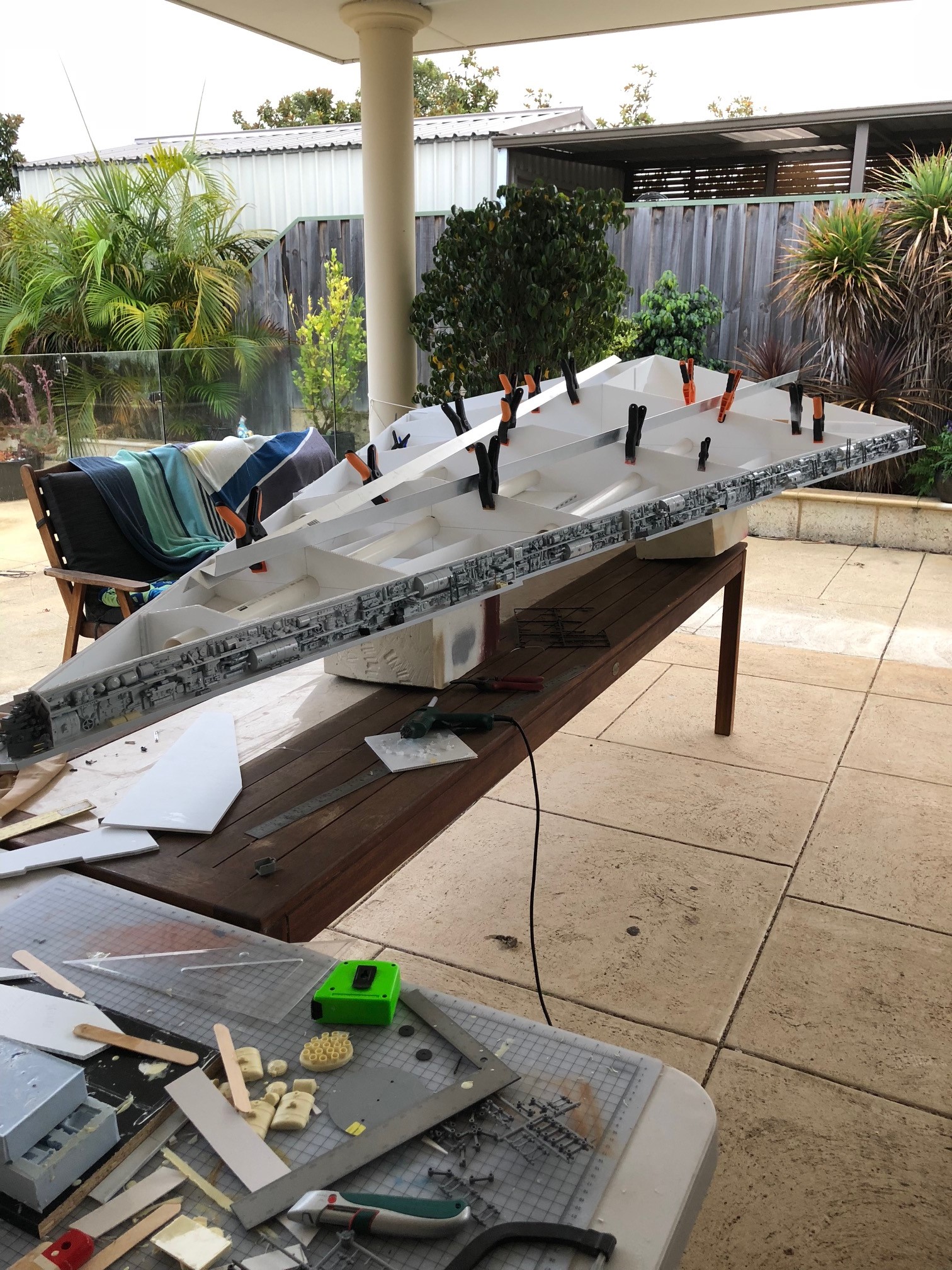

Once all the side panels have been glued to the ship we started adding greeblies to the inner flat edge, here I made a mold of some parts and duplicated them .

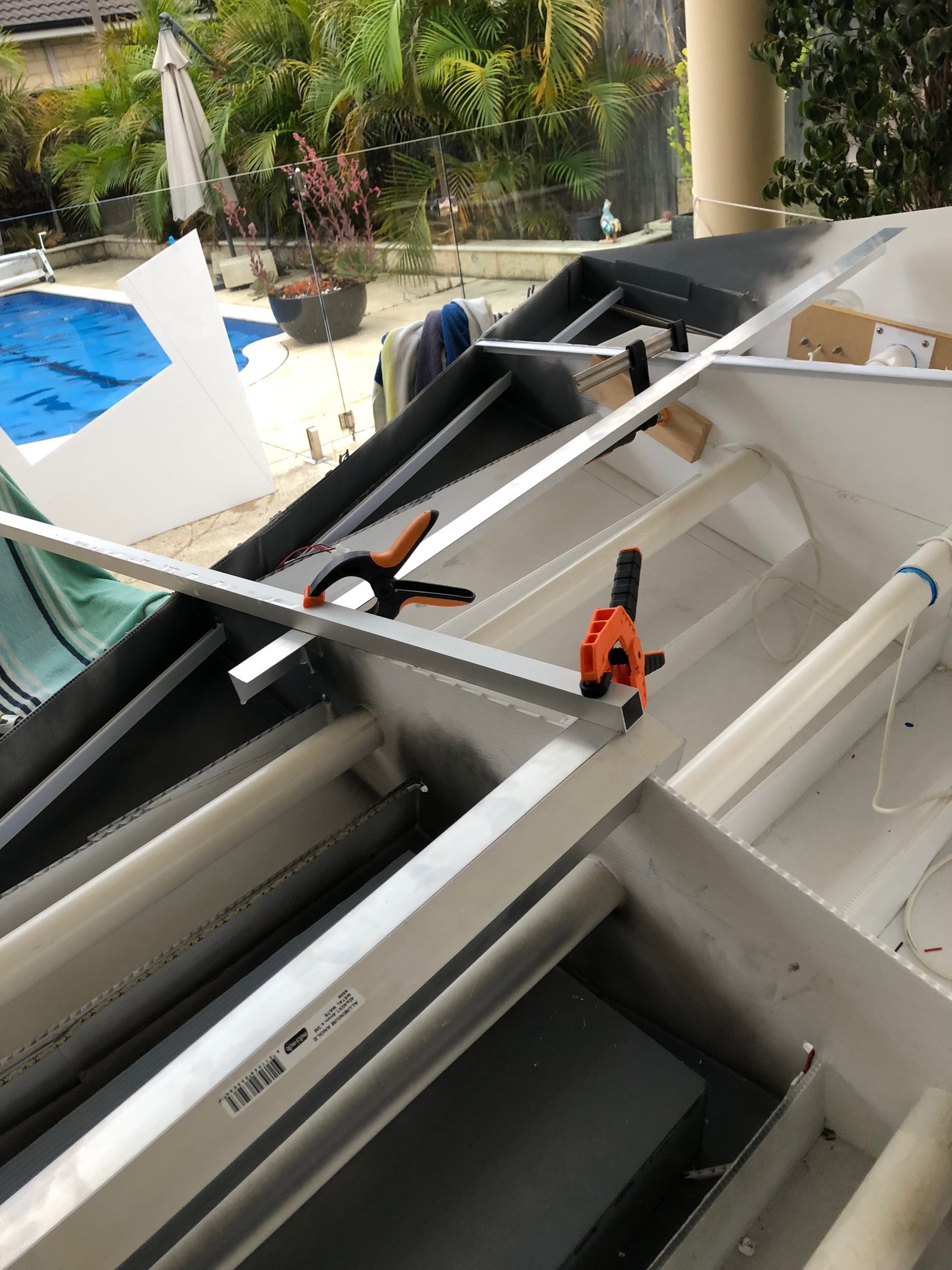

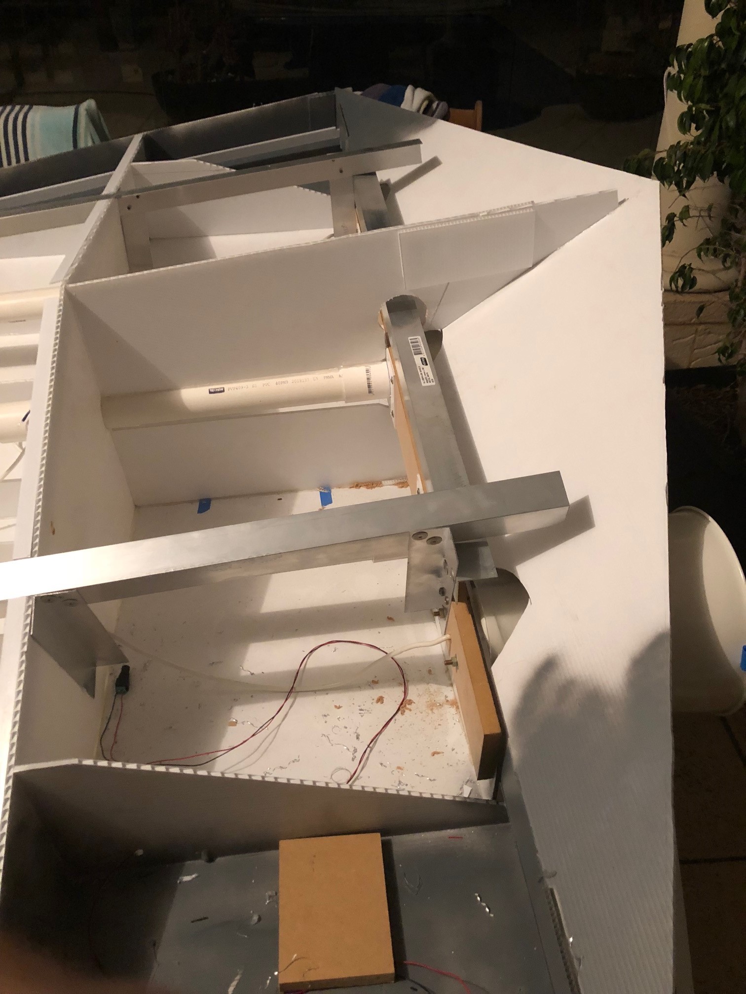

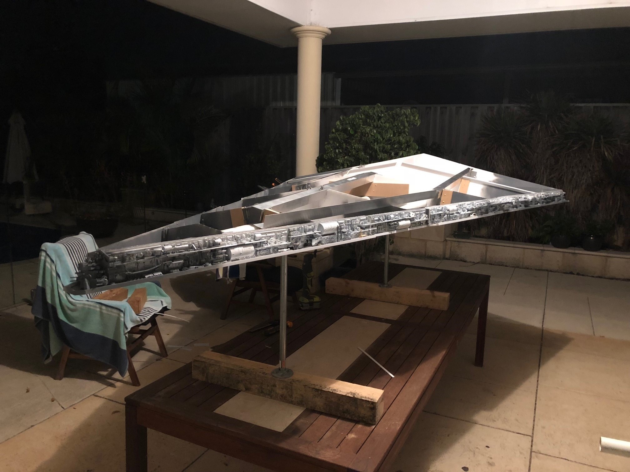

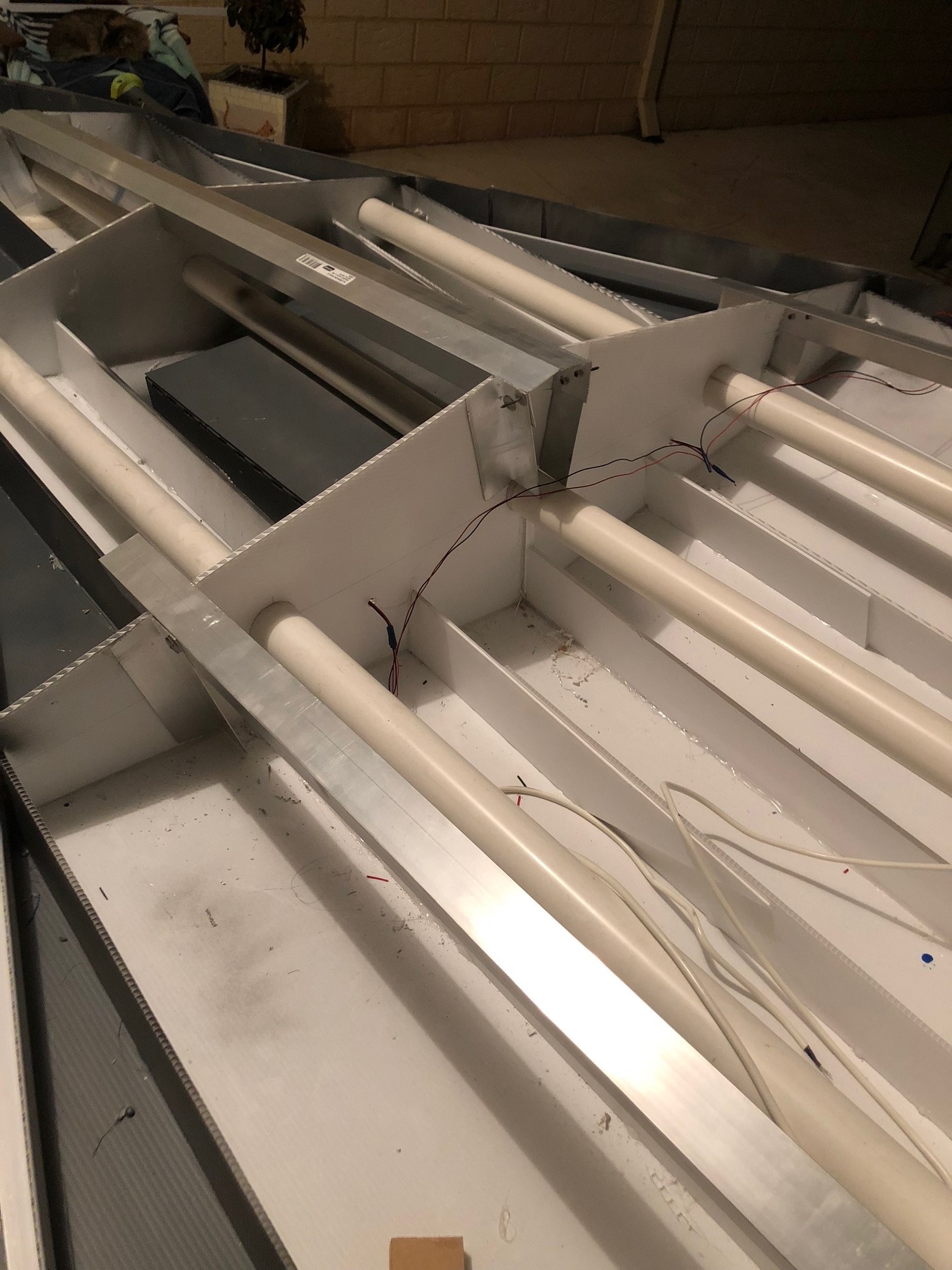

We also started to add the aluminium for the bracing to the top of the SD so it can be hung in the house.

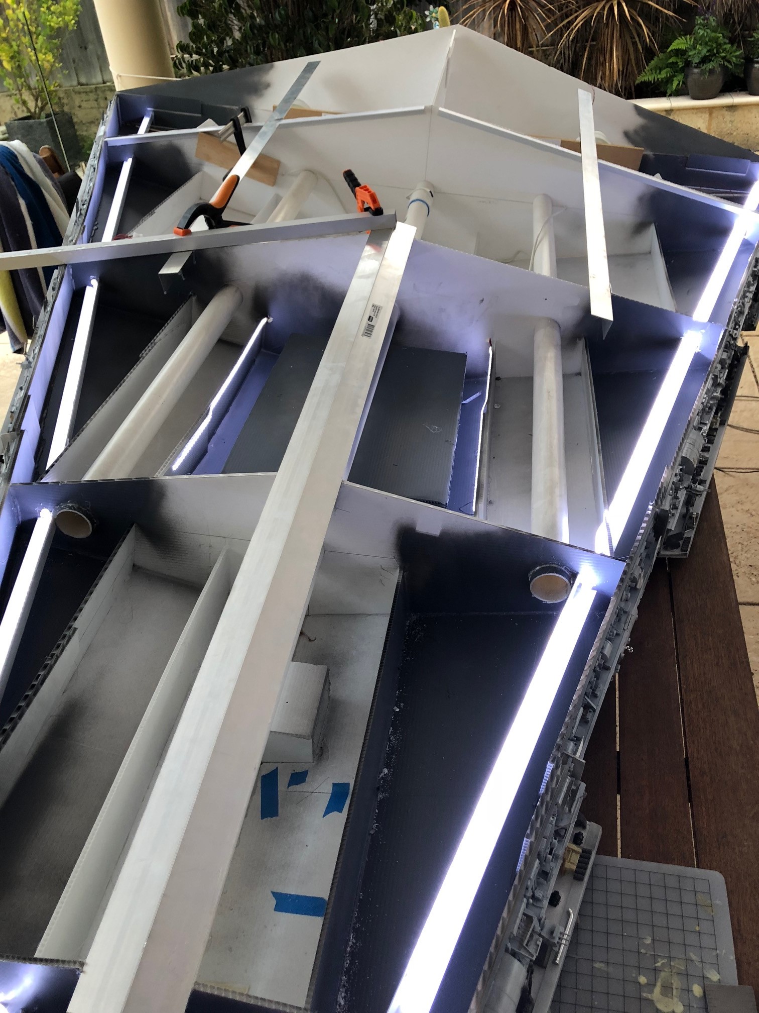

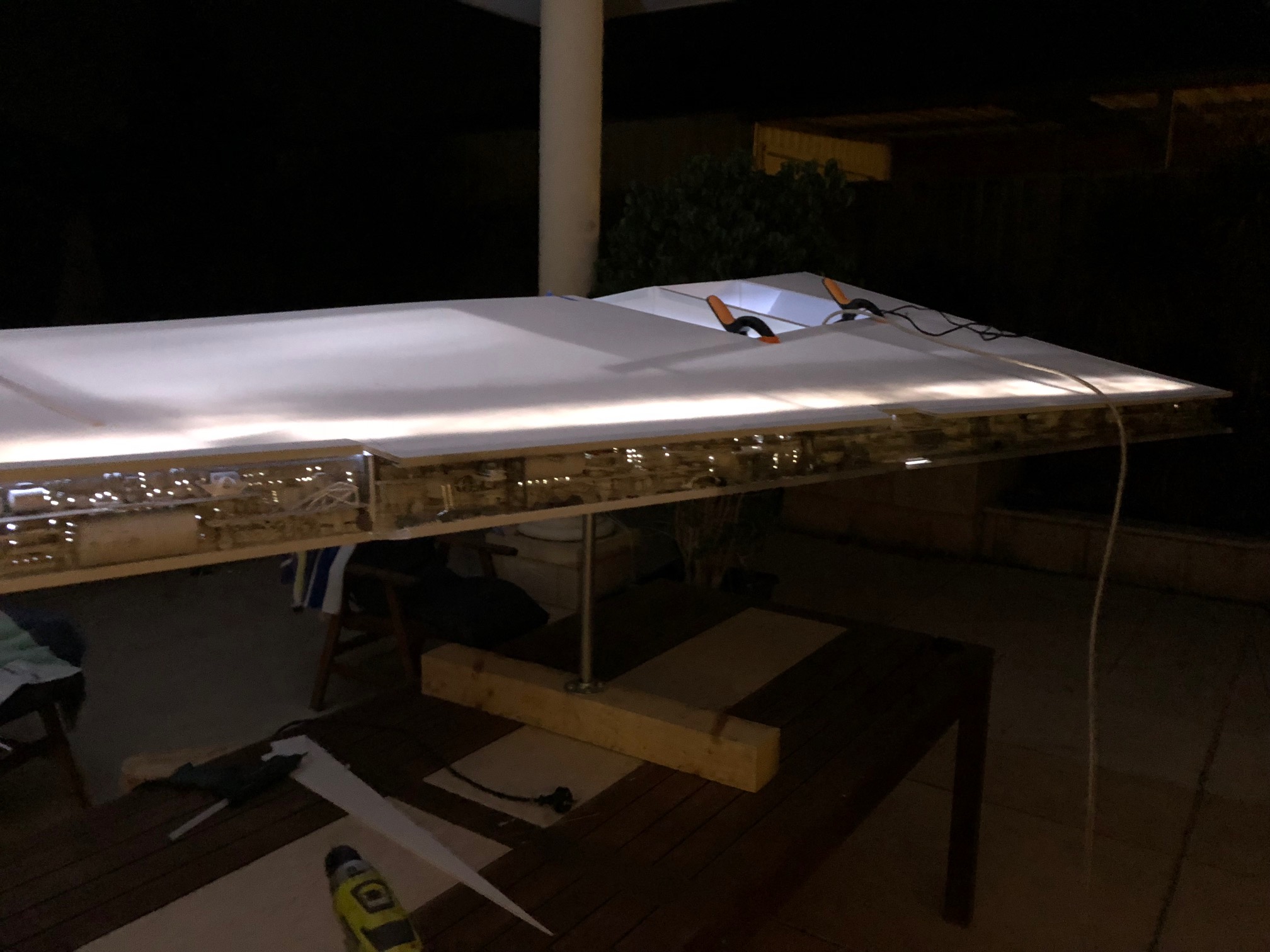

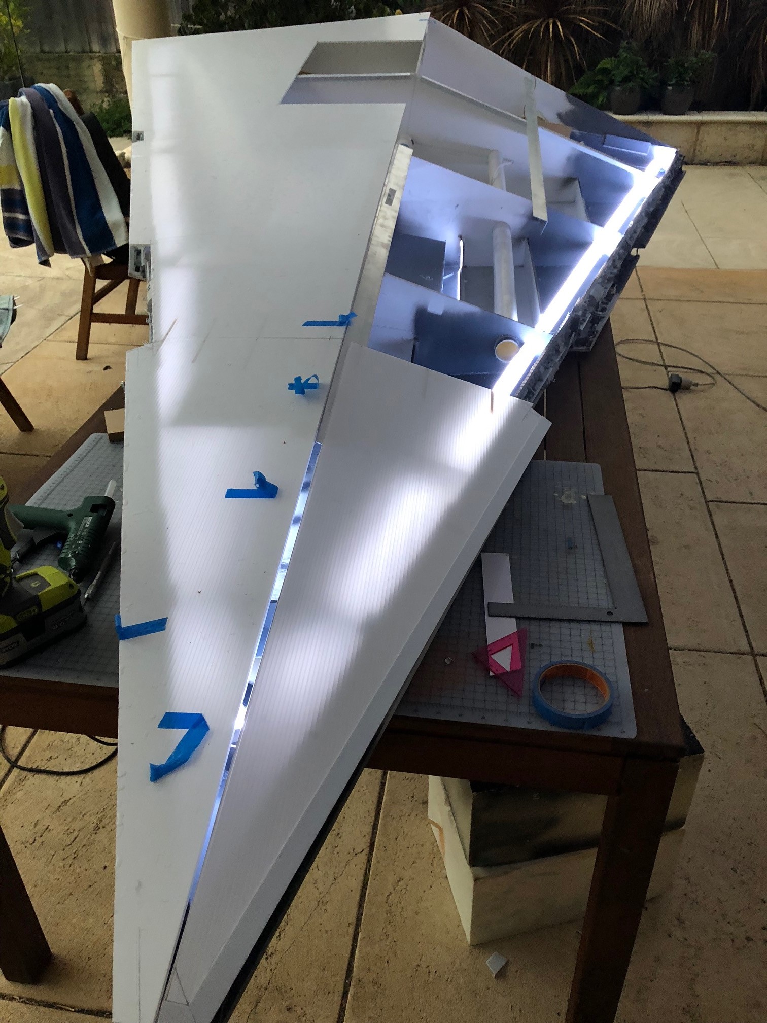

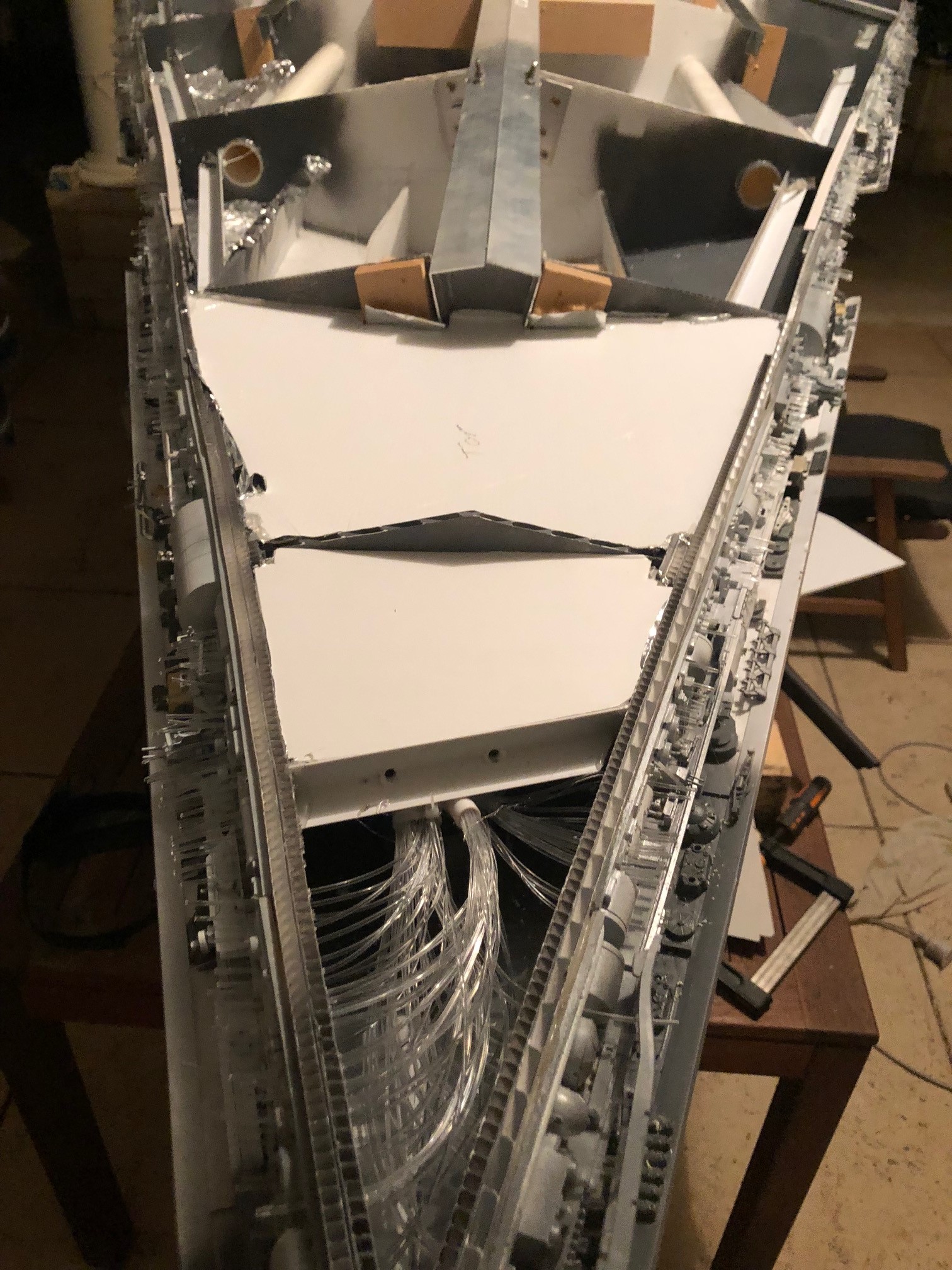

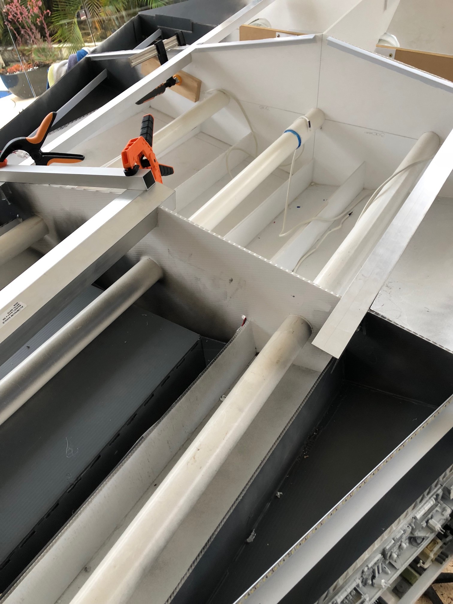

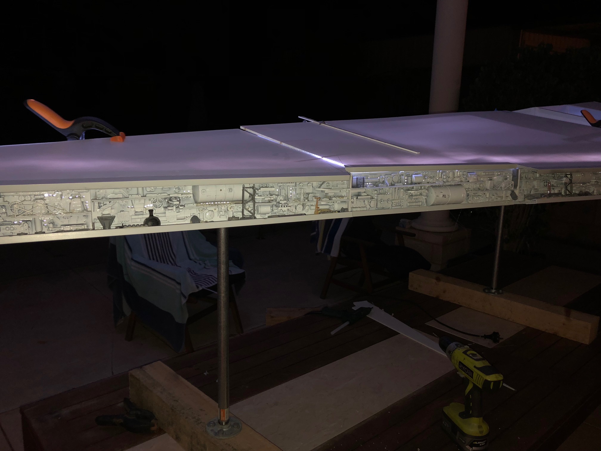

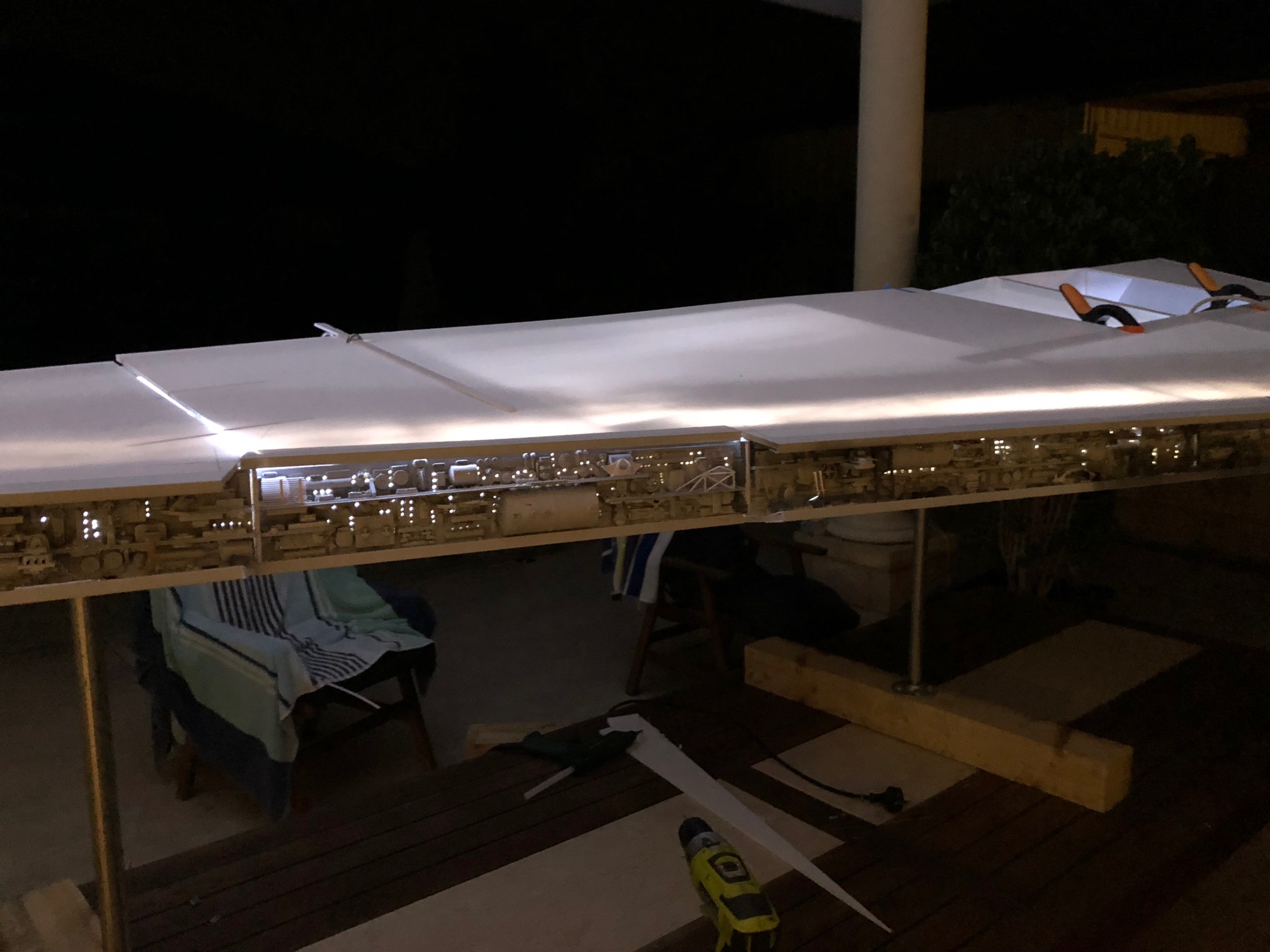

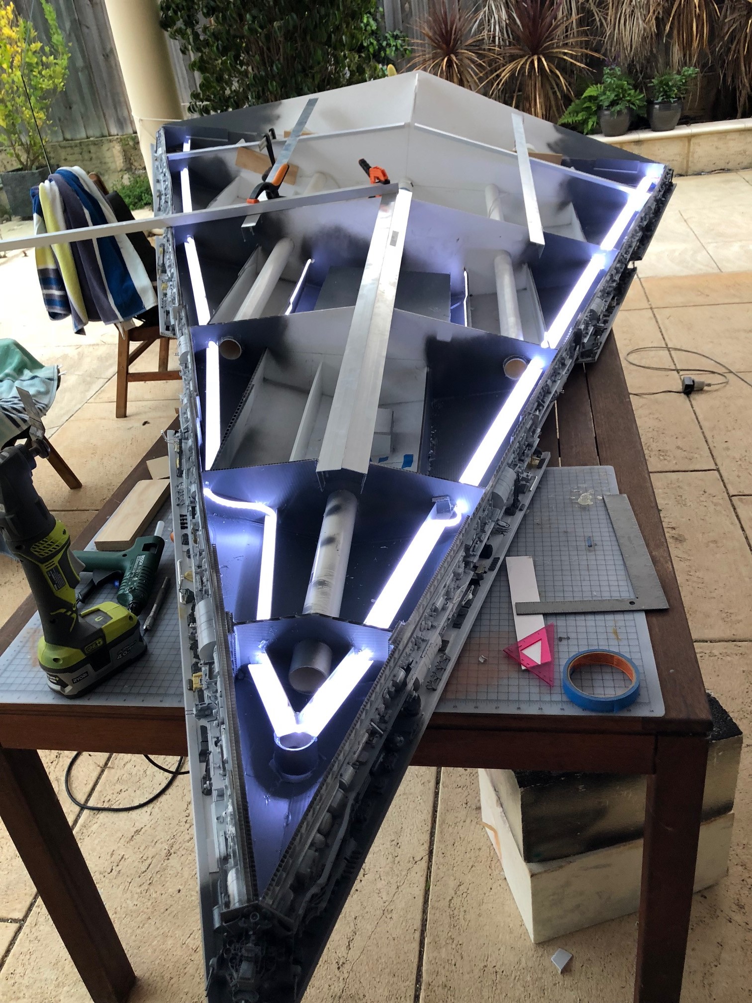

Lighting time, I have used a 12V LED lighting strip and run it all around the inside edge of the SD.

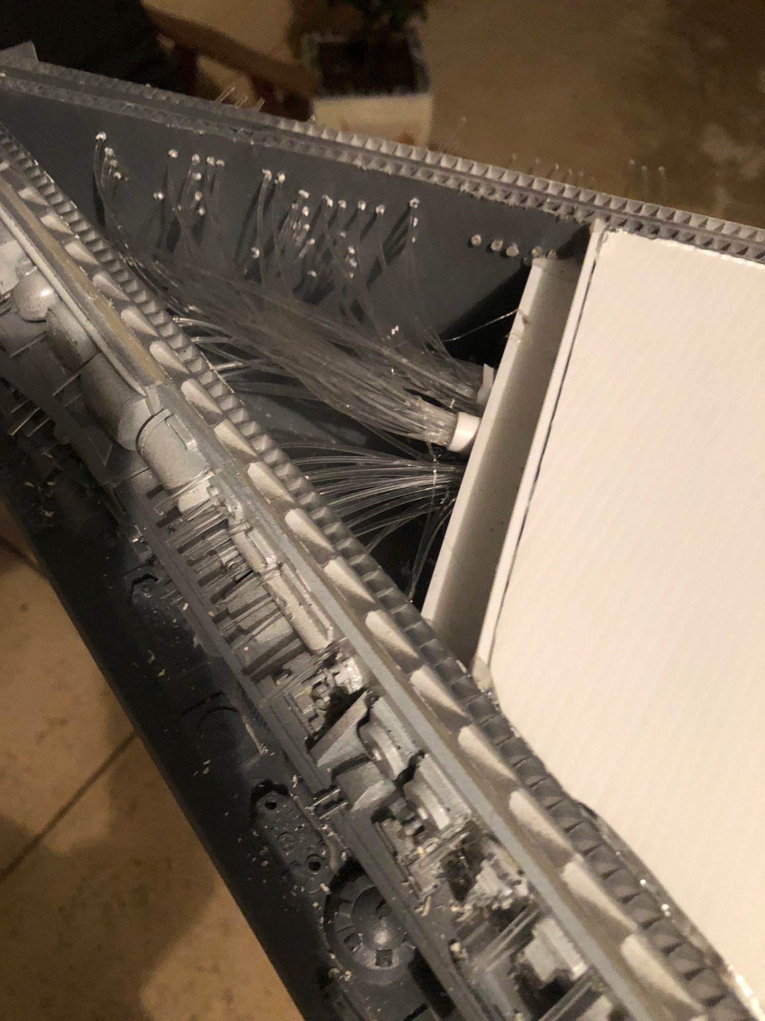

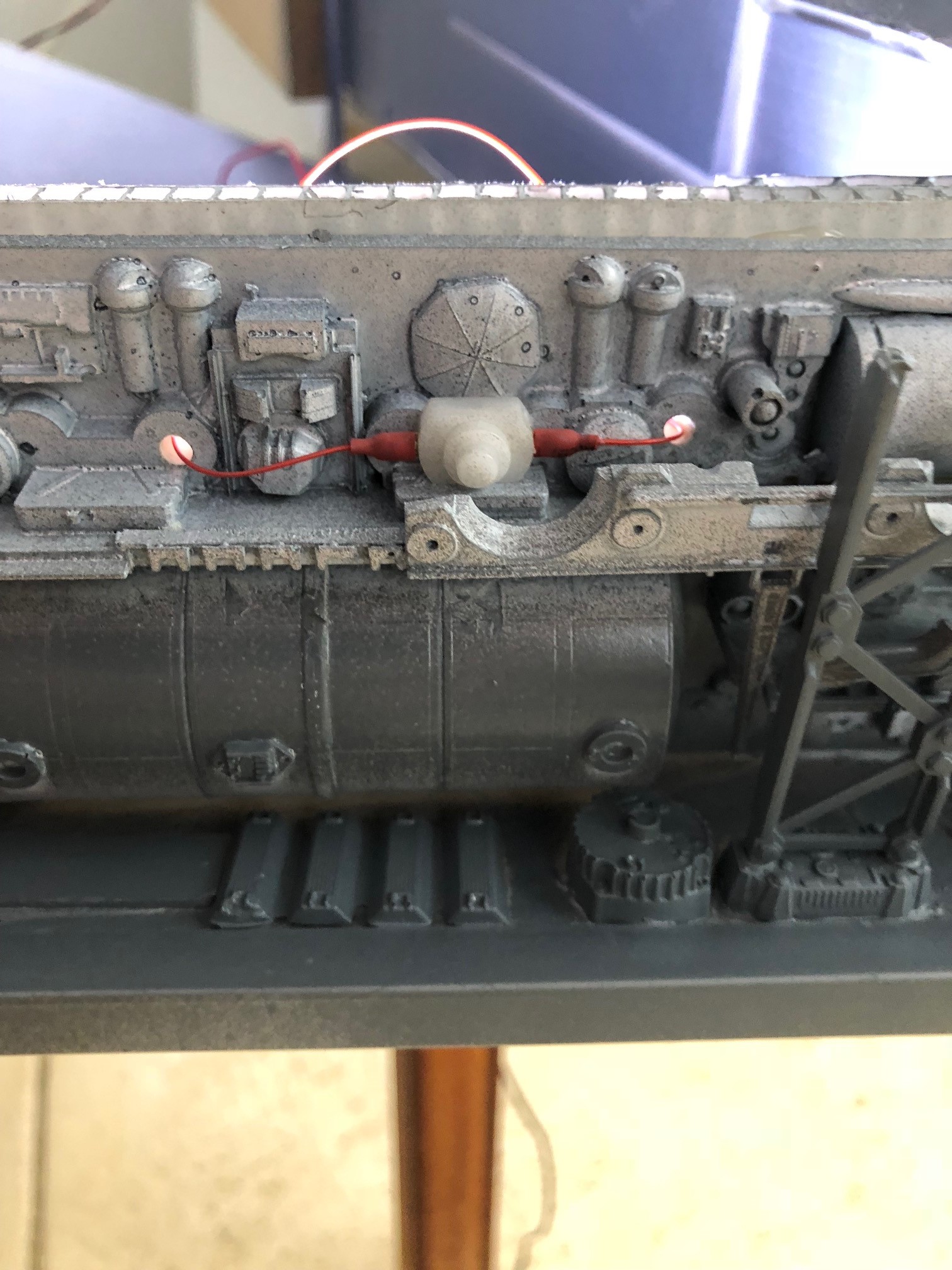

I will have to use optic fiber to extend the light through the thickness of the side wall, as drilling the hole through will only give light if you look at it side on.

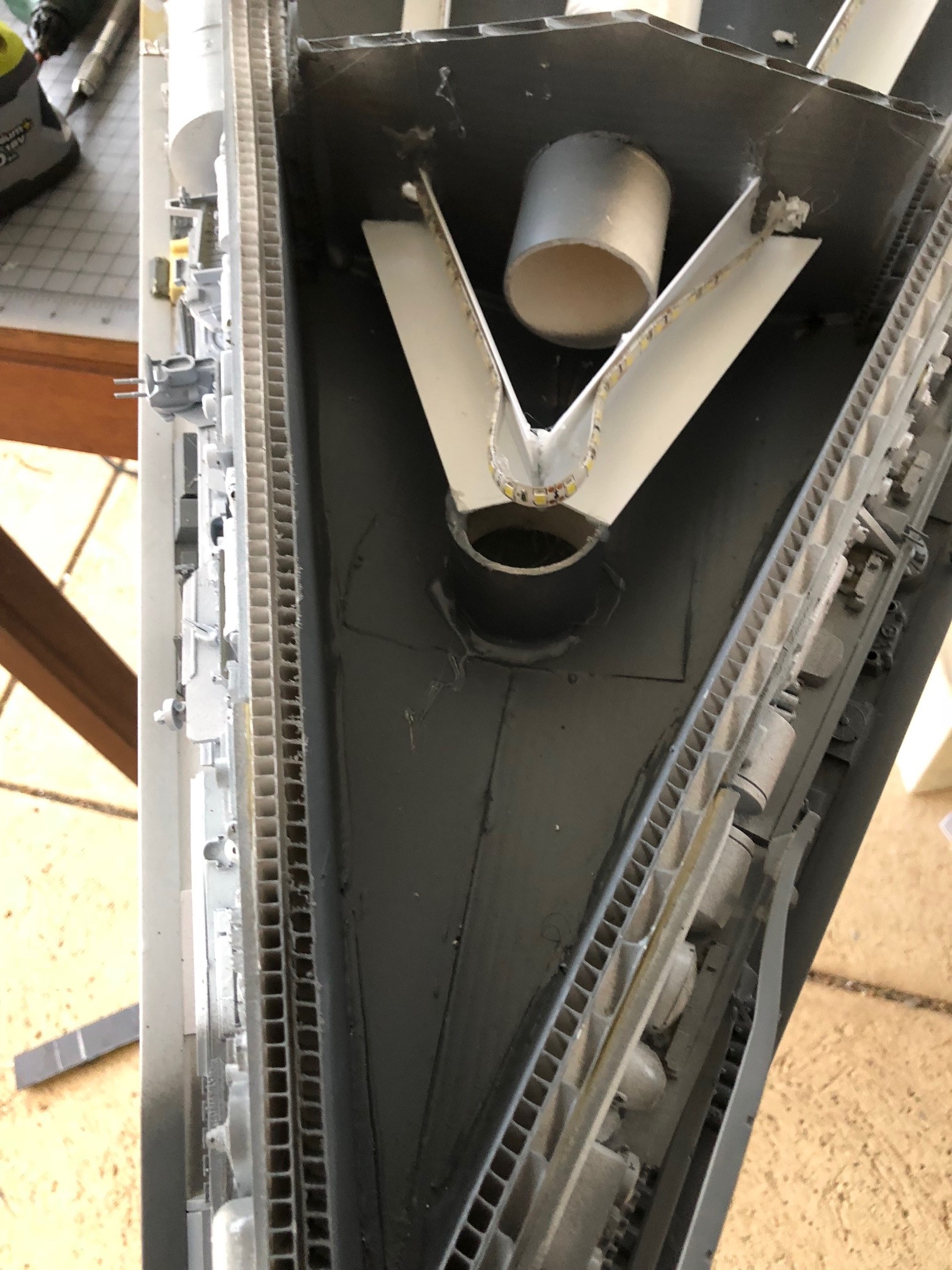

At the front of the SD I had to do the optic fiber to the LED trick to as the area in that section was very tight.

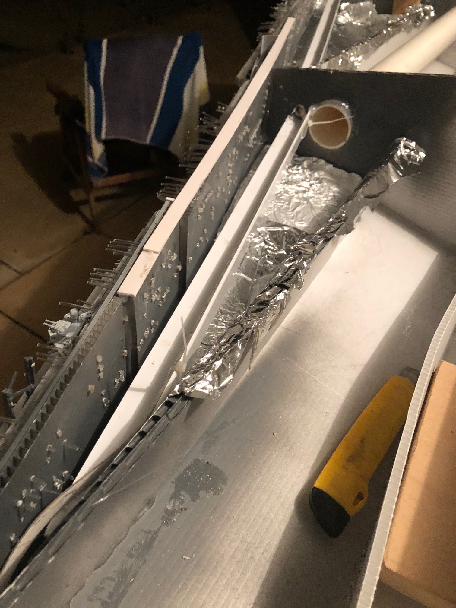

I also light blocked the bottom and to with aluminium foil glued to the Inside and some Core flute panels with some PVA glue.
View attachment 833352View attachment 833353View attachment 833354View attachment 833355View attachment 833356View attachment 833357View attachment 833358View attachment 833359

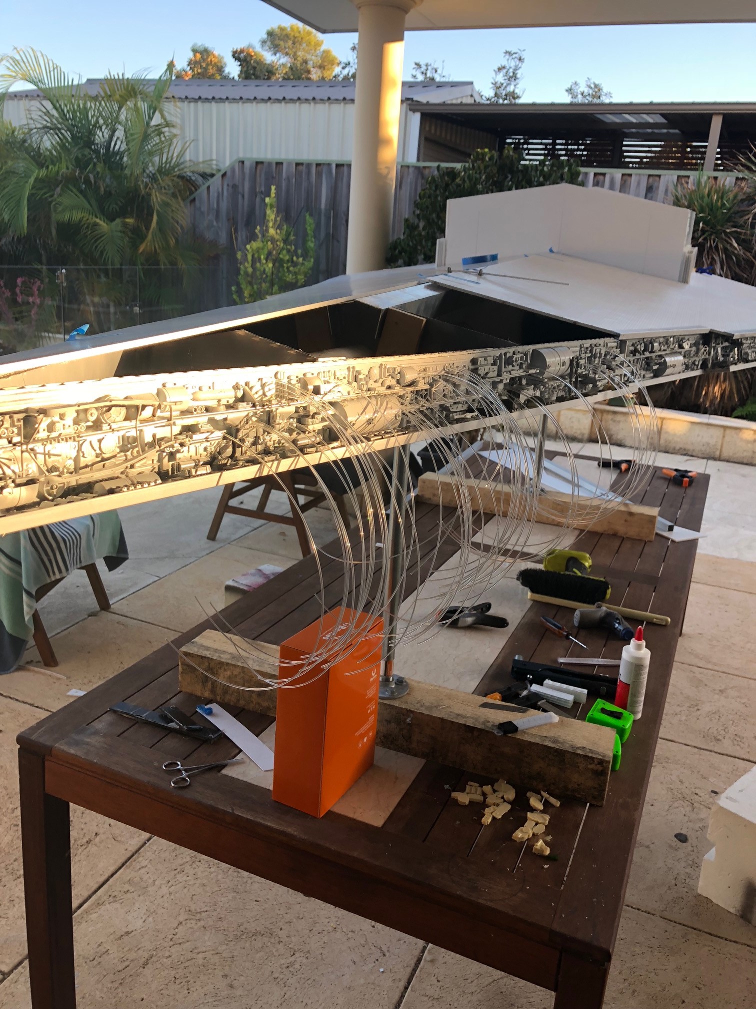

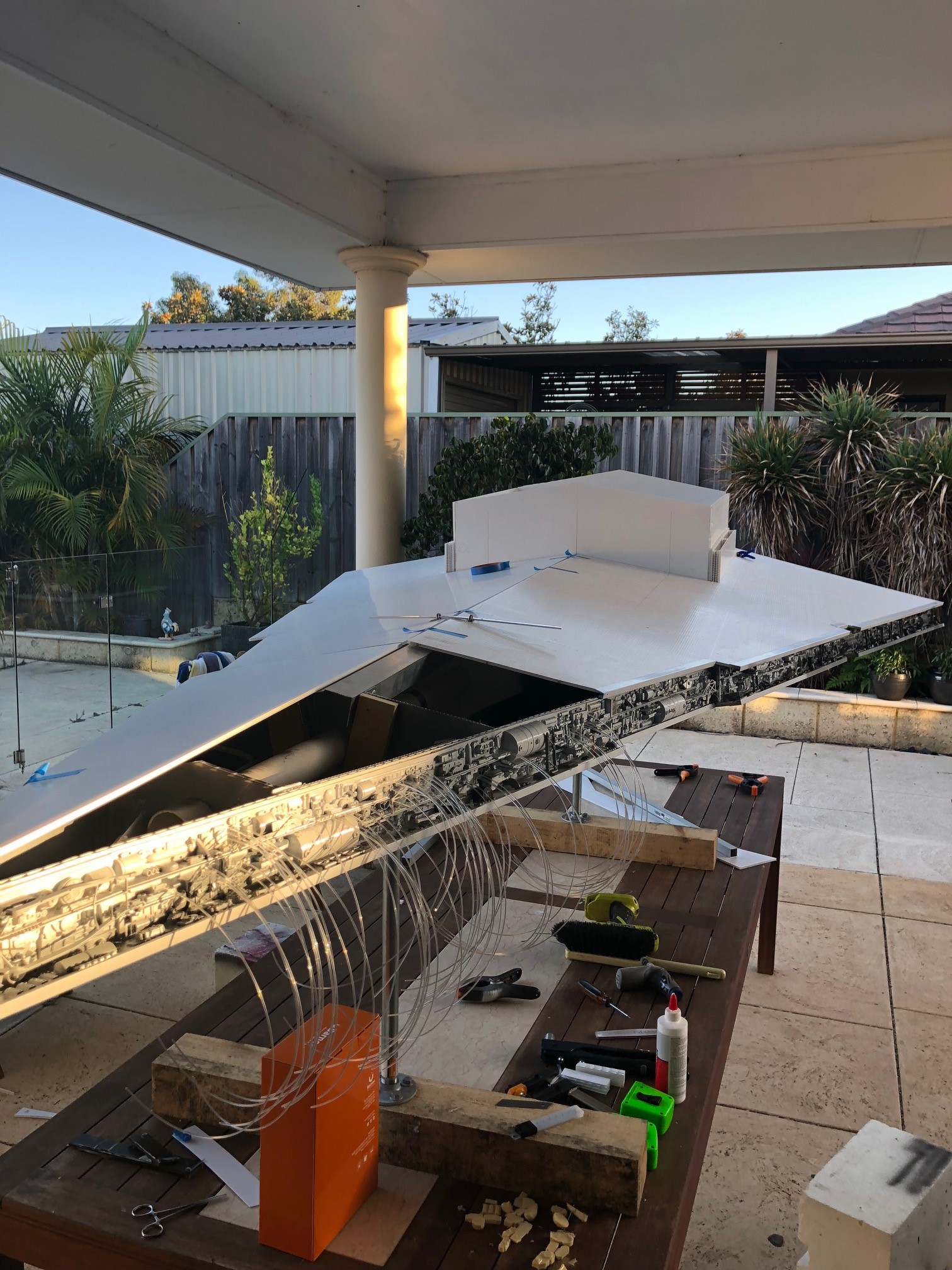

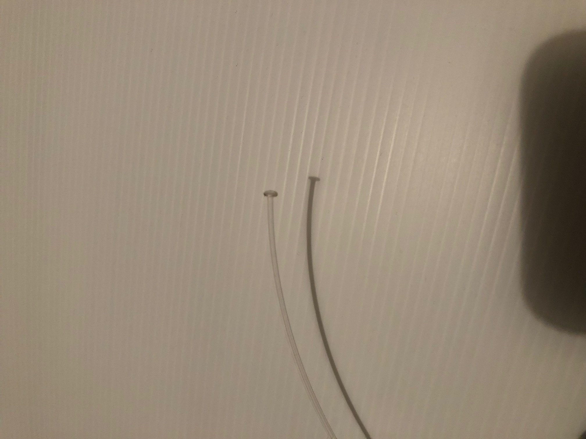

Thousands of holes where drilled along the SD side panels and I used 1.5mm optic fiber. Each fiber was heated making a mushroom end to allow more light to be absorbed plus it helps when gluing the fiber in there is a stop when you thread it through from the inside.
Thousands of holes where drilled along the SD side panels and I used 1.5mm optic fiber. Each fiber was heated making a mush room end to allow more light to be absorbed plus it helps when gluing the fiber in there is a stop when you thread it through from the inside.
