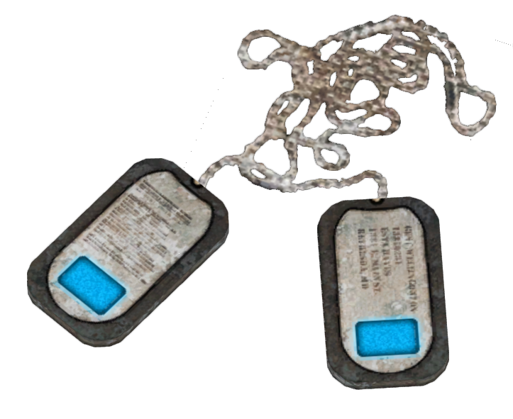

So my sister, and her two kids are really into Cosplay, including Fallout. She is looking to start building her own props and has asked me to help her design some Brotherhood of Steel holotags. Both for her use, and to eventually sell. This thread is to help me perfect the design based on fan input, before working on anything else. This is not an interest thread, that would come later.
In Fallout 4 these are only ever seen as the above prop. In-game they are single sided. However, since they are supposed to be electronic "dog tags" then they should be double sided in real-life, with the prop showing one of each sides to save on rendering.
Trying to decipher the text on them has been very tough. The above images are as high res as the textures get on these props. But since they are dog tags, we can assume there is some personal information printed on them. Using photoshop to enlarge and sharpen the images, this is the best I can come up with. Although I am not sure about the top two lines, and the word "Discovery"
N.O. Identification:
(Serial number)
Blood Type - O
Discovery
Level
1
2
3
Clearance
Confirm
Y
Y
N
Name: Jeb Dutchnill Joe Baker
Signature:
The 2nd side is impossible to make out the top text. I am assuming name, company and number.
For the barcodes, you can put 8 numbers into the top code, and four numbers into each of the bottom codes and keep the same look.
The bottom text seems to be:
You think you can take me? You go ahead and try.
If anyone has any better reference for these please post it. I know the fans here are more versed in the Fallout lore than I am.
