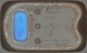

they make a glow in the dark blue powder, just mix with clear resin very close to the color you posted blue.jpg

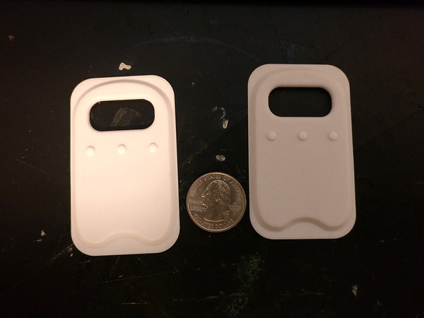

I haven't done a 3D print yet, I am waiting on my sister to tell me how complex she wants to make these.
I've got some Mold Max 60 to try a pewter cast. I'll let you know how it turns out.
Pewter is viable but pressing them would be easier.

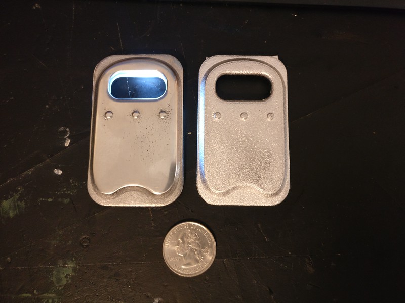

Pitched them in the tumbler this evening. I like the gun metal grey better than the polished look.
The casting defects will work for the aging and the weight of the pewter feels very substantial. Zap I'll try a rubber pad "hydro-form" with a solid pewter cast and shim stock. Tell me if you want me to take this to another thread.

I think this says Joe Don Baker - which if so, is a funny easter egg. I really want the nickname to say Walking Tall because that's the movie he played Buford T Pusser but I can't squint my way to it. The brotherhood certainly walk tall. Maybe (Walking Tall) - its a stretch. https://en.wikipedia.org/wiki/Joe_Don_Baker
I've been looking at the connector for the chain. I'm almost convinced the tags are upside down. A hole through the "bottom" makes more sense instead of a connector. The Fallout 3 tags are connected on the other end as are most other dog tags IRL.

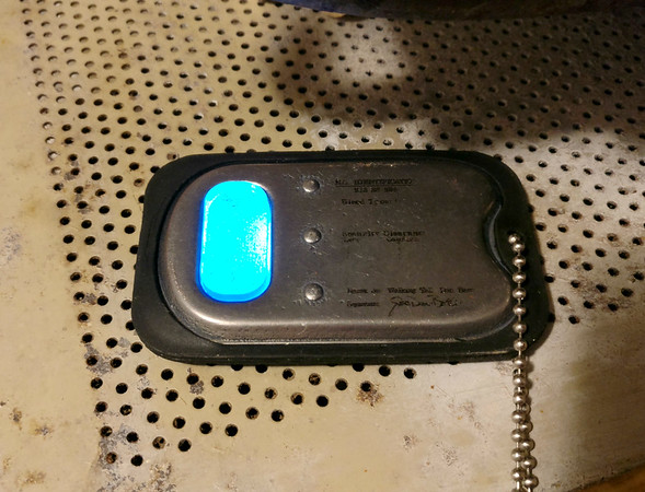

Laser cut a lens insert and etched it with a fingerprint on both sides. The acrylic is fluorescent blue 1/8". Two CR2016 batteries fit nicely but one would be fine.
If two CR2016’s fit then put in a CR2032. The overall look is pretty close. I am not sure my sister is interested in making these anymore. If she does bow out I’ll release the files I have so you can make a more accurate version.

I wound up laser cutting an acrylic "layer cake" mold. I'm experimenting with Sugru right now but pouring them may wind up easier. I've got a roll of ninja flex as a last resort. I took the artistic license on the mounting point too. I also spent time with LaserBond 100. It worked out ok for the aged look but I'd want to test it more for a pristine tag. That's two caps right there. Remaining to be done rust effect, silencer, and lenses for the window.

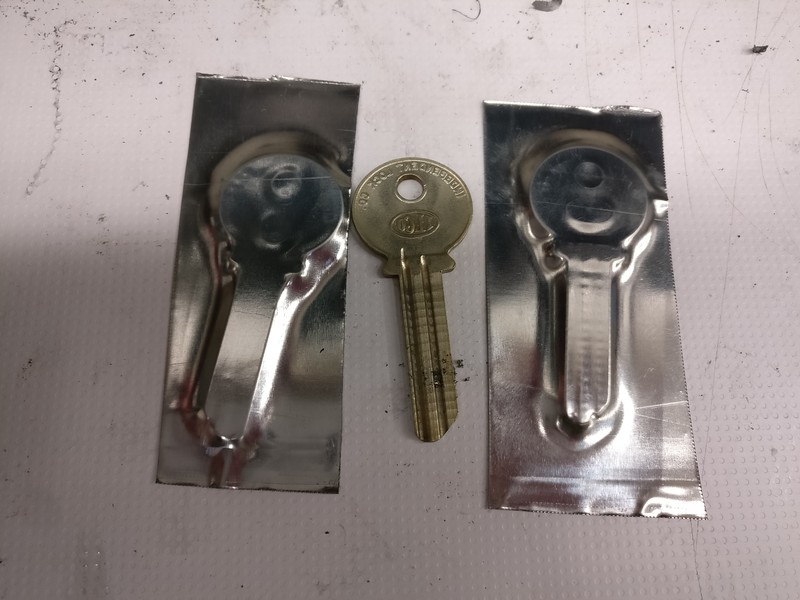

I will be ordering a bunch of items from McMaster soon, I may go ahead and try ordering a few types of thin steel. I figure the metal can be extremely thin, if it has a cast or 3D printed backing.
Hmm, you're thinking about 1/8" thick or thinner? I was going to bandsaw a blank out of carbon steel but figured I'd test it first. The one on the left was moderate amount of pressure using a urethane block - the one on the right was really cranked down on. Note the grooves in the key starting to show. I'm using a HF twenty ton press. The material is a piece of a paint can. My digital calipers says 0.01" thickness.
The silencer came out just ok. A misalignment in the mold keys shifted it slightly on one side. The color is decent too. I see that Form Labs has a flexible resin now. Has anyone tried it?
