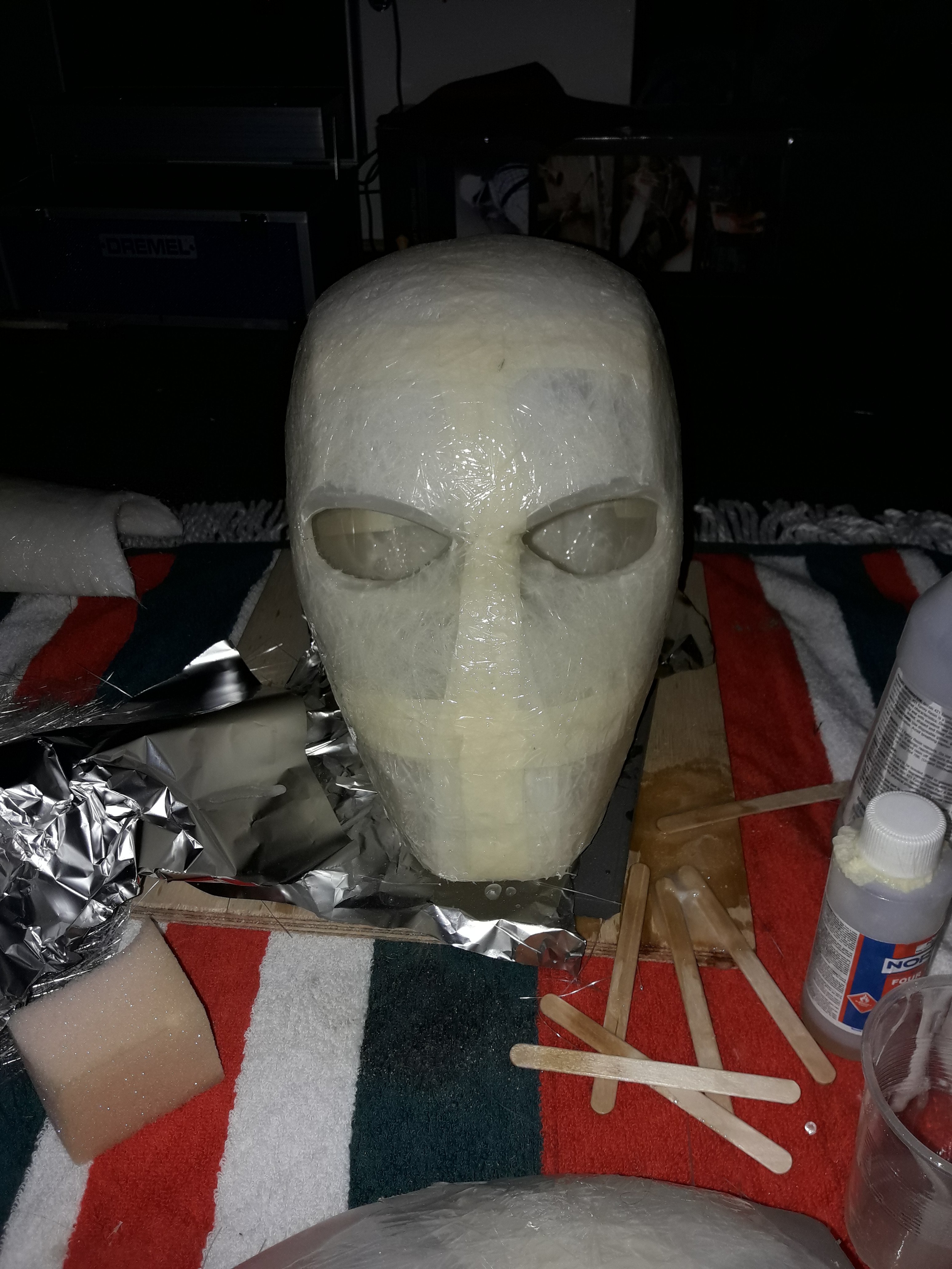

Freshly fibreglassed helmet

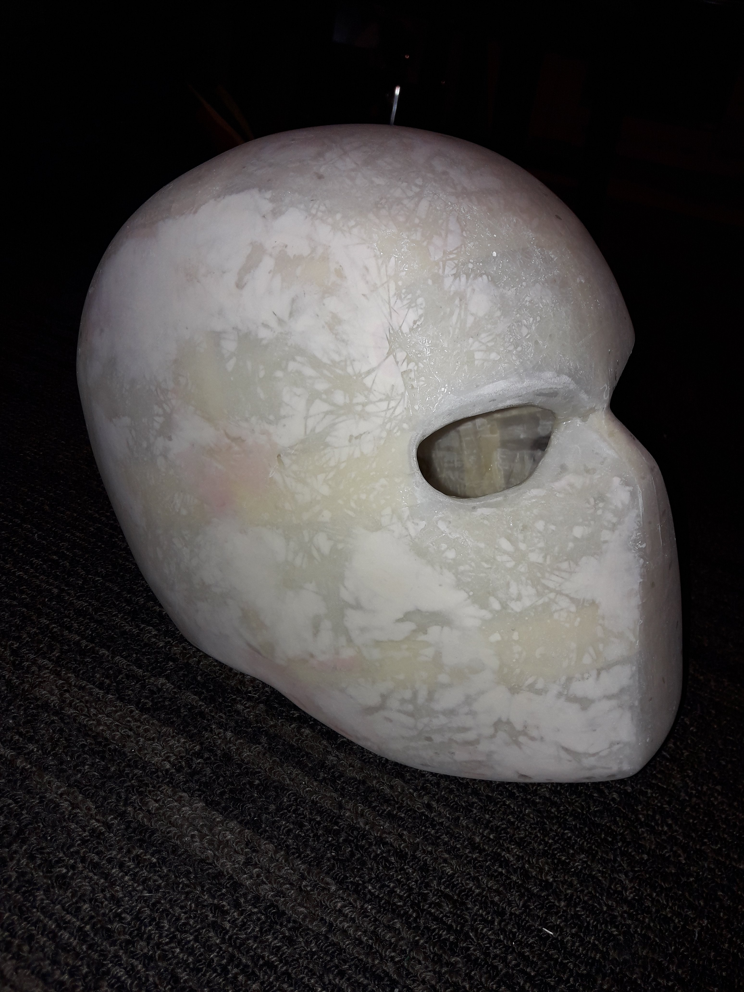

Did a first pass sanding with some nice high 40 Grit sand paper to remove the worst of the roughness. Then attacked it with some builders bog to fill in any particularly bad inconsistencies or holes. Followed up with some more sanding. First 80 grit, then 150, then 400.
Finished sanding

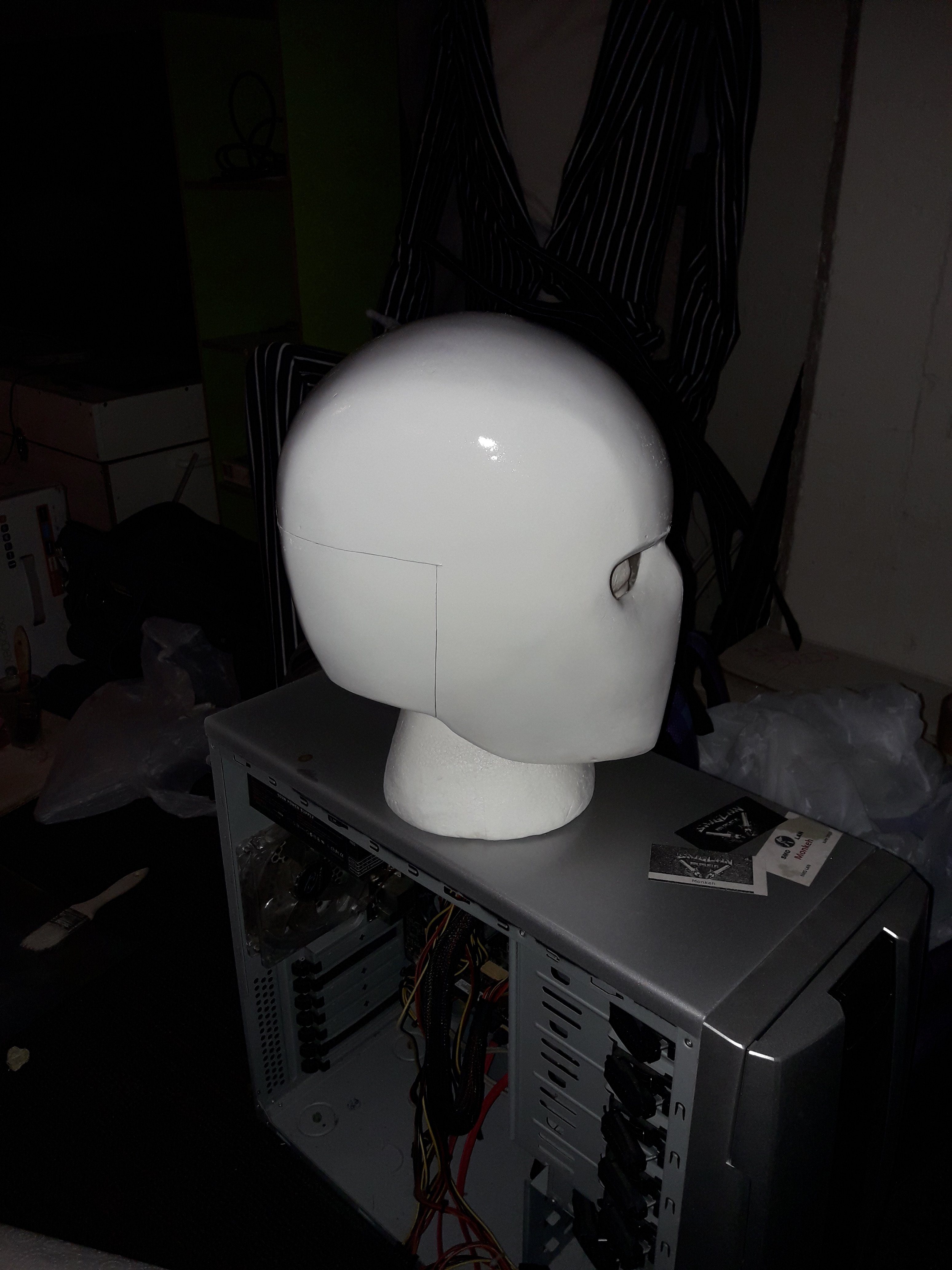

Next was time to cut a section off the back so I could actually get it on my head. Wanted to do this before I painted so I didn't damage the paint. Once I cut the back section off I hit the whole thing with a white base coat.
White base coat (sitting on top of a dead PC). You can see the cut section in the back.

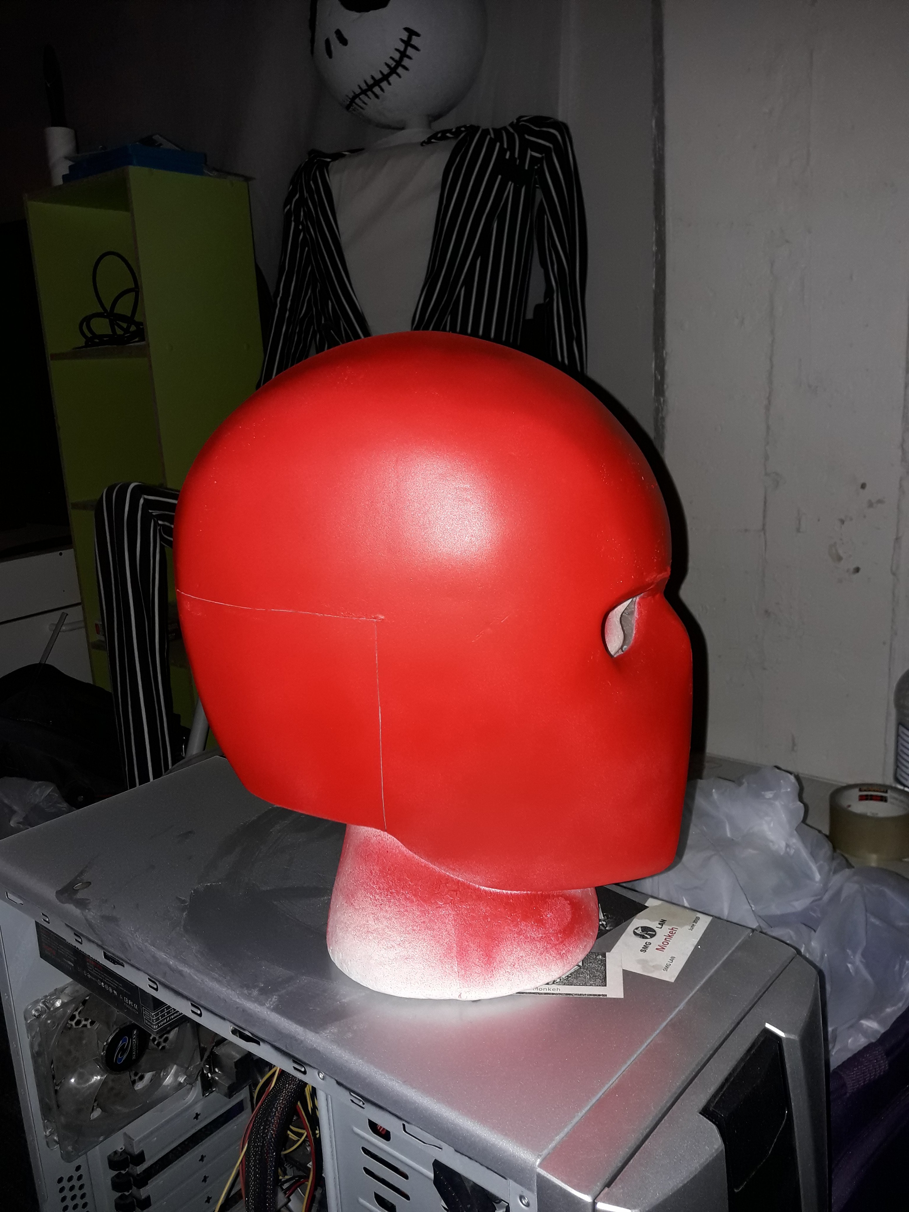

After that I hit it with a couple of coats of red. I just happened to have a mostly full can of a shade of red I liked.
It's Red. Like a Red Hood or something.

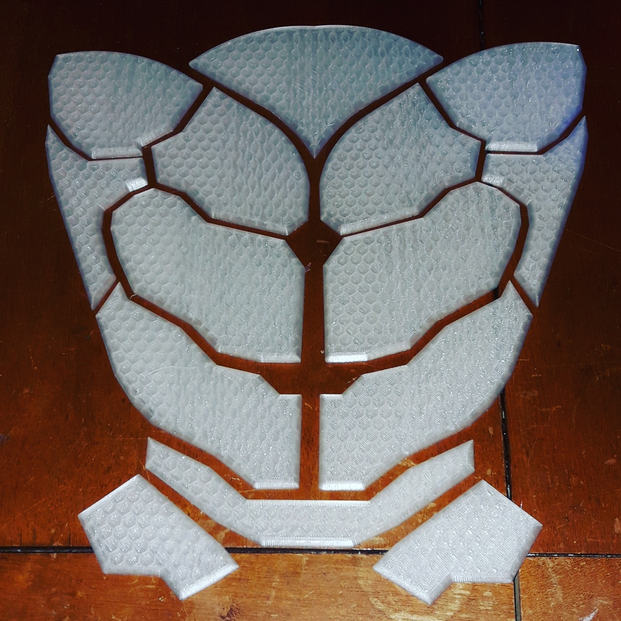

While I was making the helmet I decided I wanted armour for him as well. Threw together some quick designs in Fusion360 for different pieces and started printing and fibreglassing those as well.

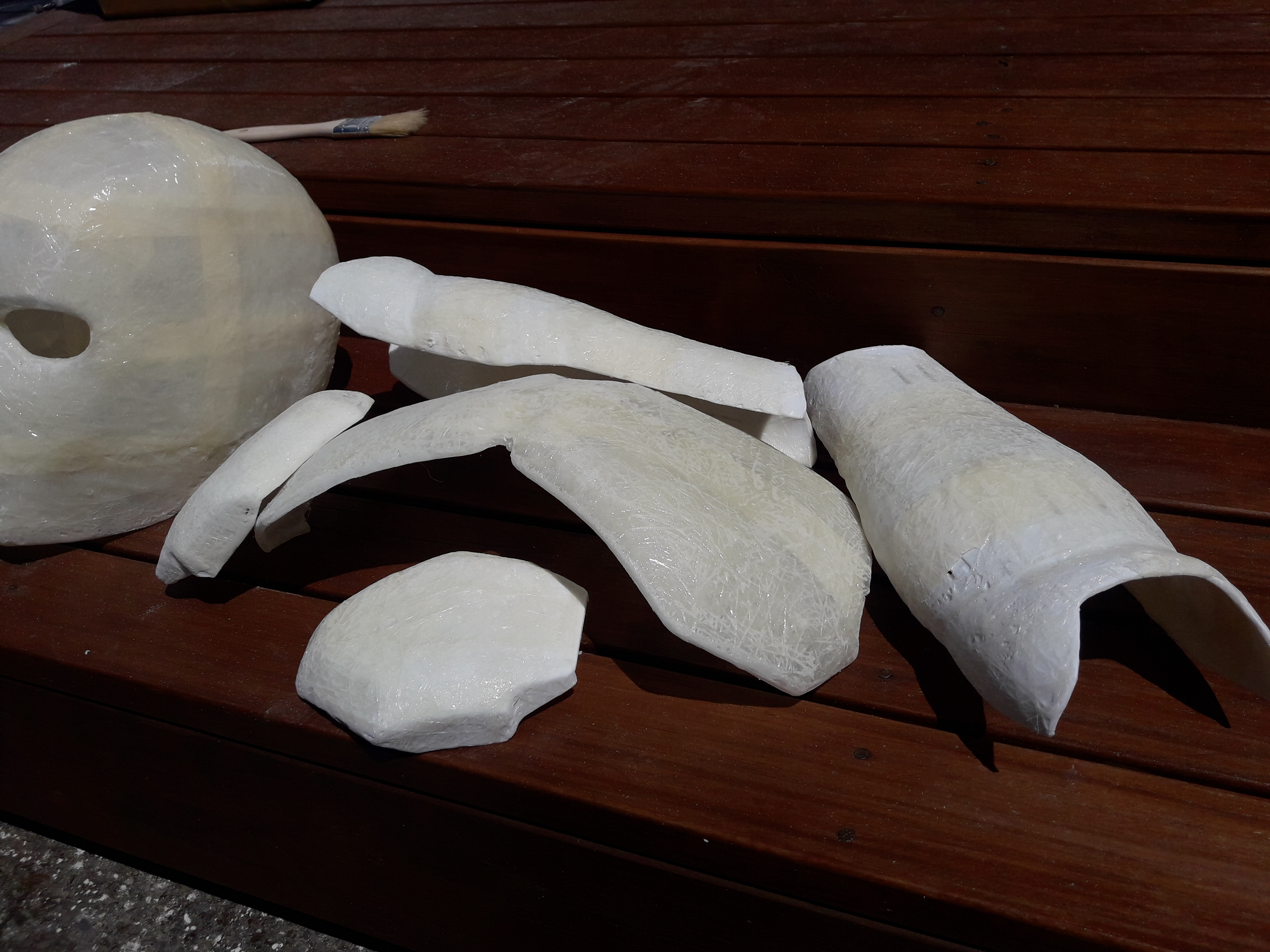

Some of the pieces before and after fibreglass, waiting to be sanded.
The body armour ended up being finished during con crunch time, so some of it didn't get finished, and some of it I want to come up with a new way to assemble it. The ab sections are currently held together with craft foam, and then black webbing is holding that to the pectoral section of the armour. The straps holding the front of the armour in place also need a redesign as I am not happy with how they sit. Legs I am happy with. The back and the different sections I was printing for the arms are the pieces I scrapped due to time since I would be wearing a jacket so not totally necessary.
