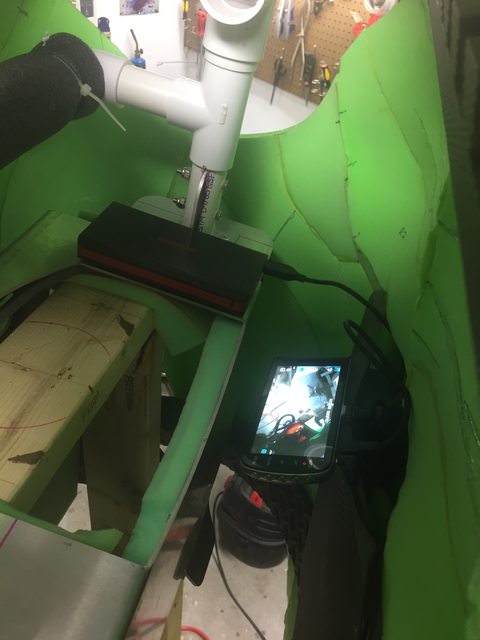

Just and update for others interested
So I got a DASH cam set up that came with individual Cameras -
4" Screen mounted about where you would hold a phone if you were looking at it.
$40
for Power I got a KMASHI 15000mah External Battery Power Bank with duel output.
$18
(I may add a second screen cause this one does split screen and I find myself switching back and forth instead of looking at both views at the same time.)
so very affordable - easy set up and I left it running (actually recording myself) while working in the shop for 4 hours and the Power bank was still above 50% so will meet my
1 hour costume time easy.
Also I made the power bank a velcro patch so I can take it in and out easy (or used for other things as well)
