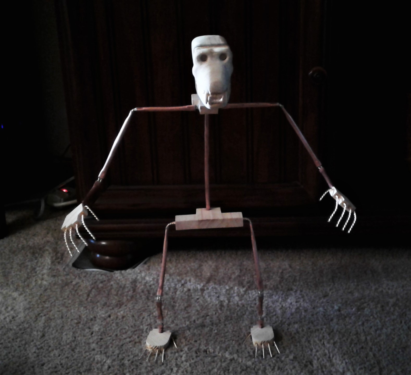

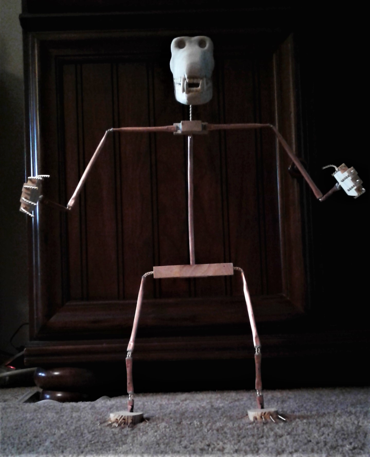

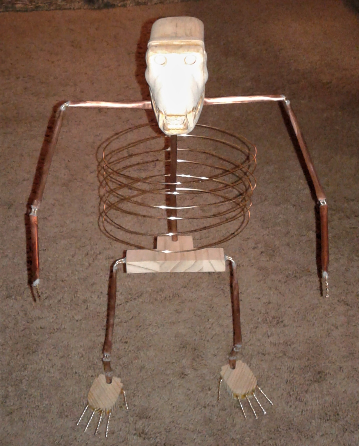

Soldering ended up being a mess and ruined both arms I was working on. Before going back to square one, I wanted to try super gluing his joints together to see if that would hold, but I then decided using epoxy putty would give a better bond for what I was trying to do. And it worked! (for the most part)
His hips are not sturdy enough right now because I just fed the wire directly through his wood waist instead of putting copper pipes filled with putty in them. But that's an easy fix. He can also stand on his own, as demonstrated in the pictures, but I want to make a base where I can screw into his feet so that everything is really solid. I'll be fixing his hips and continuing to refine the skull before I get to building up his muscles, but that's coming pretty soon. Till then, thanks for looking!

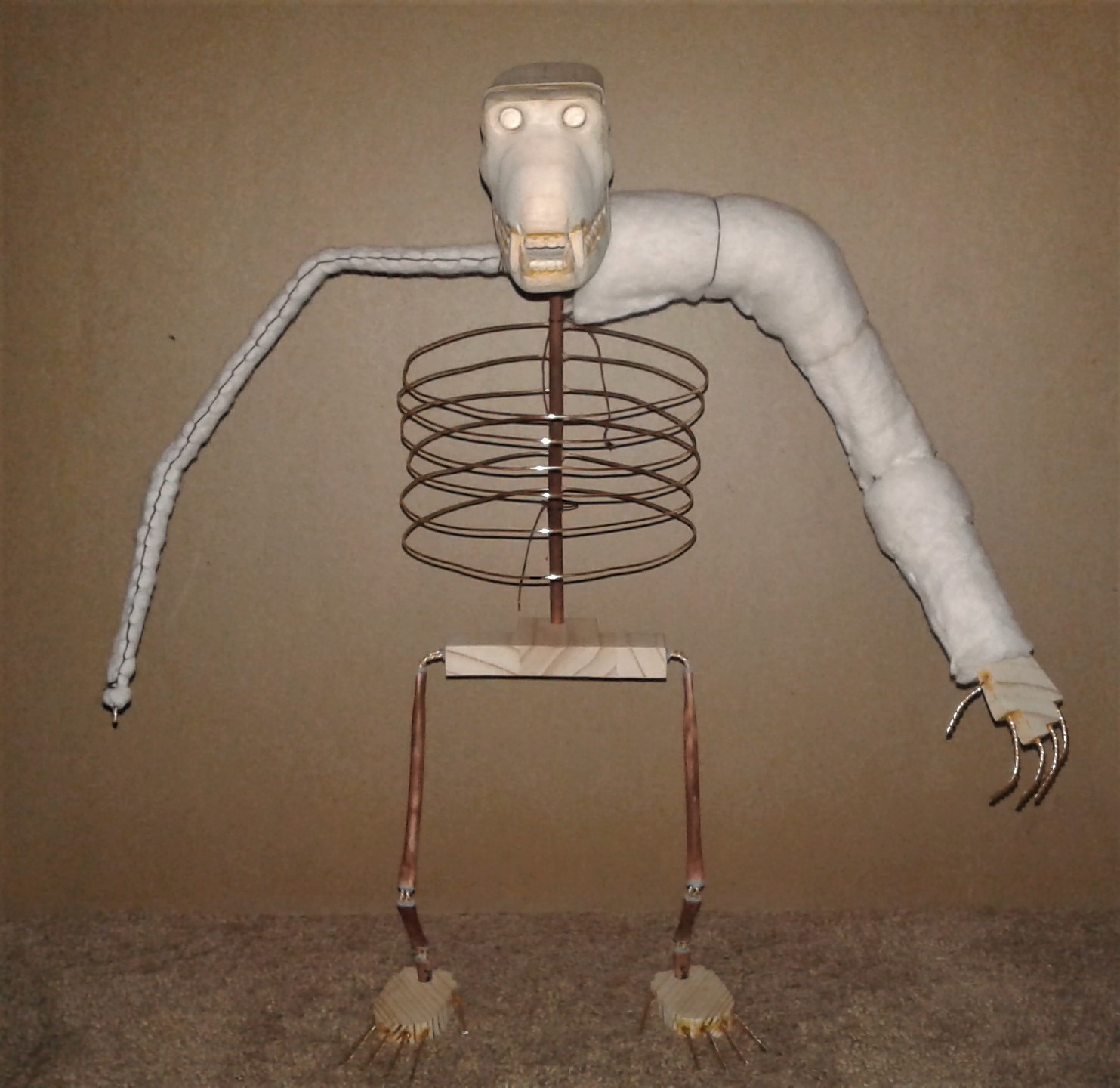

I decided to take a stab at building up his muscles.
I started by sewing on a tight first layer of the cotton batting, you can see this on the left (which is his right arm). I then built up the muscle by adding cotton batting a layer at a time, tying a knot around key places like his shoulder, elbow, and wrist. After the first couple layers, I figured I needed to do more to define the muscles, so I started adding smaller pieces of batting where his shoulder and forearm are, and then the next layer of batting would go over that and the rest of the arm. There was a lot of winging it, but I made sure to write down the dimensions of all of the pieces so I could duplicate the process for the other arm.
I think I will call this arm complete. Throughout the movie, his body changes a lot, so you have to pick and choose what you want your Kong to look like. Some pictures have the more cylindrical arm I have here, and some pictures look like his bicep is a little thicker. Oh well.

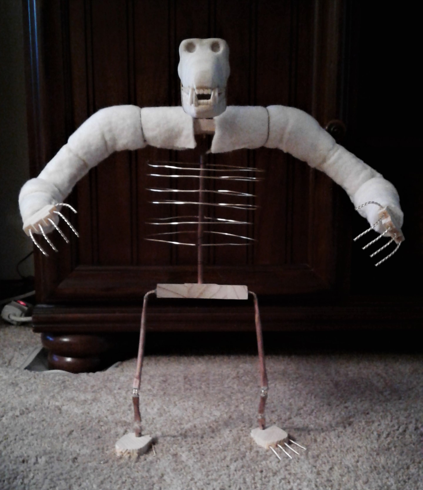

Worked on the other arm.
I take back saying his left arm was complete - I ended up adding some more volume to his bicep, and there still may be some refining work to do on both arms. I'm not sure how well the fur will hide the crimes.

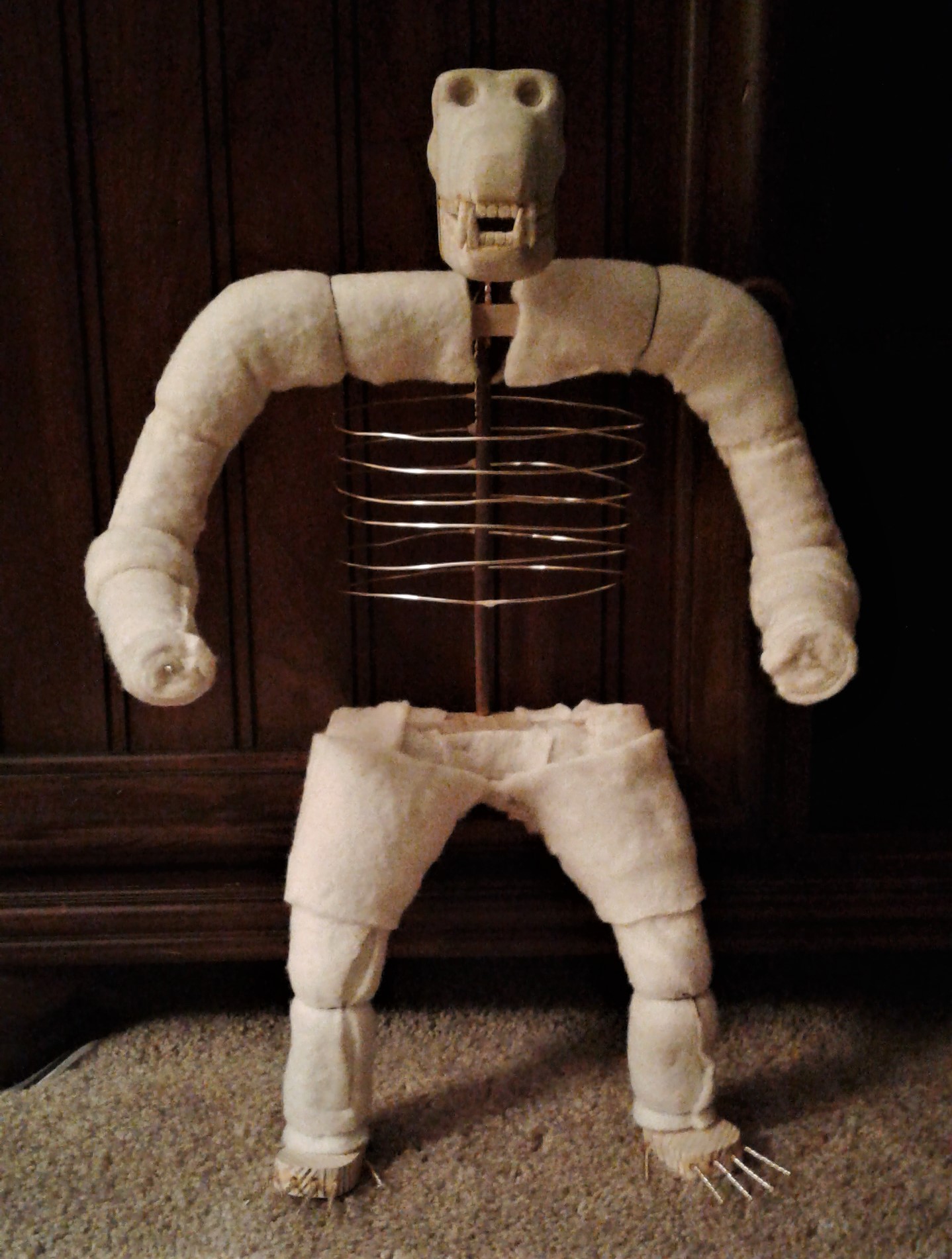

Worked on the legs.
The legs and arms still need some work, but I'm finally able to visualize his overall shape. Before, I had a skeleton that was supposed to look like King Kong, and now I'm getting closer to something that actually looks like the giant ape.

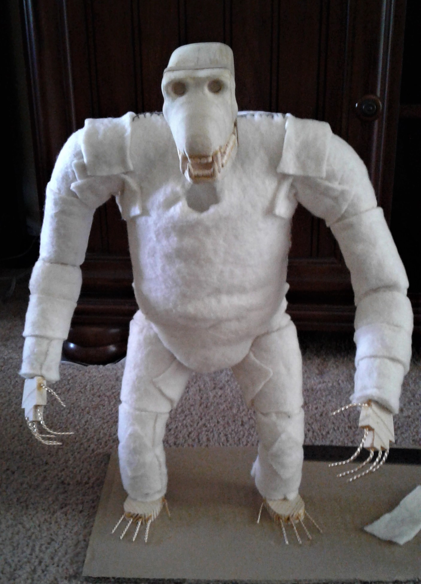

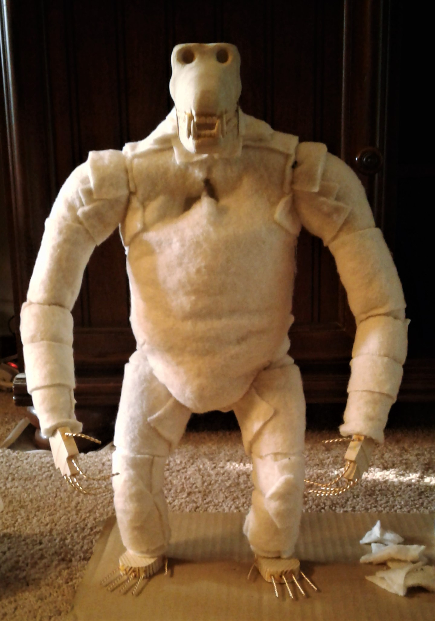

So quite a bit has happened since the last update. To start, I moved his rib cage back about an inch. I then put on the large cotton piece which covers his torso. It was tricky getting it to fit tight around his ribs (in the reference photos, you can see his ribs, and you can also see how his lower stomach to his groin have no rigid structure defining them, similar to how and actual simian rib cage works--so I was trying to recreate all that). After I covered his torso, I was finally able to see the overall shape of his body, which revealed areas that needed more mass. I beefed up his legs a little more and added more mass to his upper arms/armpits because I didn't like how his arms merged into his body. And then today I got some pillow stuffing and filled his stomach and chest cavities (hence the hole in his chest). And this is where I am:
From certain angles, I think he looks perfect, and then from others, not so much. Overall, though, I'm happy how he's turning out. Also, ignore all the pieces of cotton that look slapped on---I'll be smoothing them out later so they transition nicely with the rest of the body.

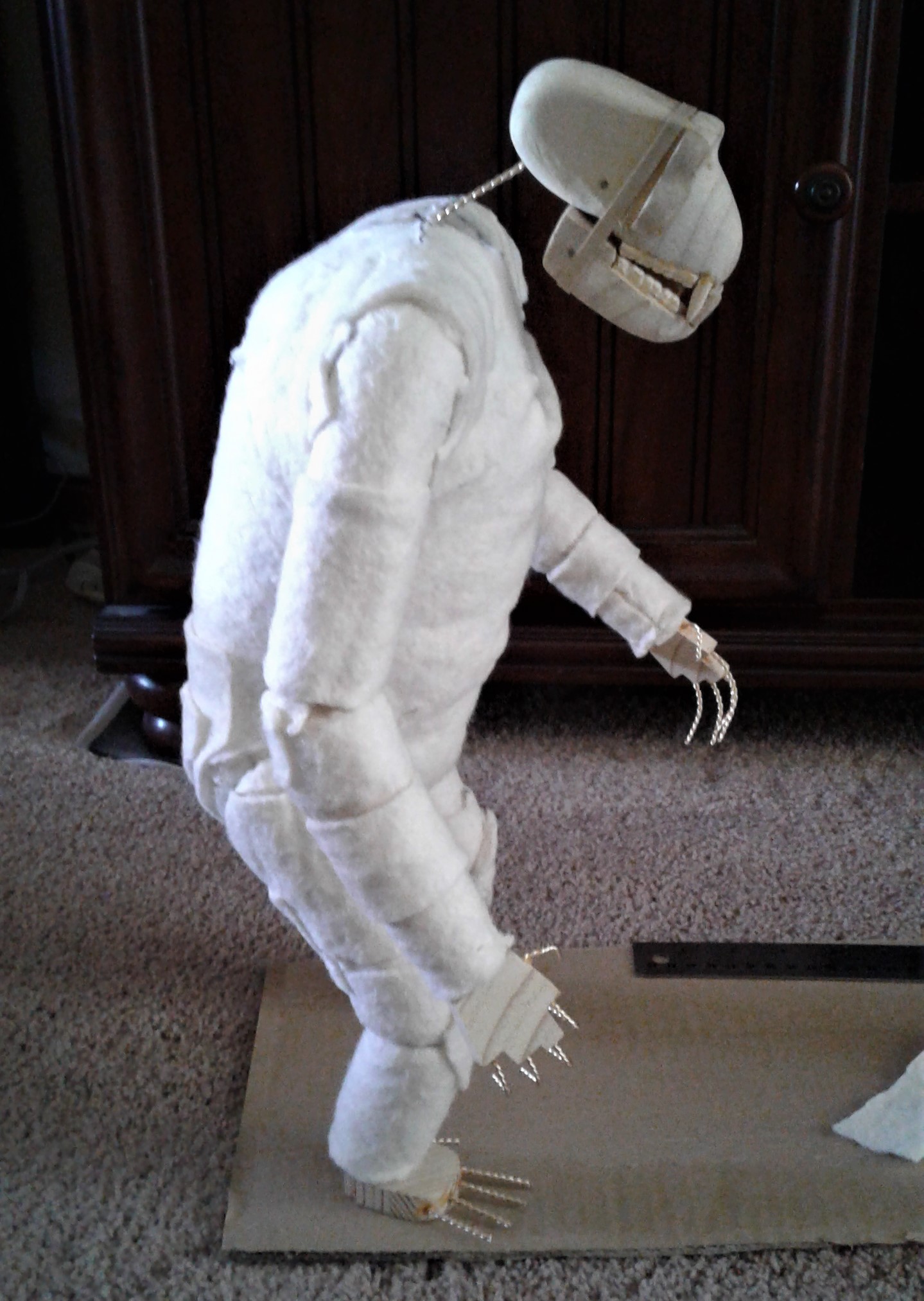

Worked on the neck. I also realized his arms weren't hanging how they should, I made them more human than ape-like. So I twisted them and that seemed to work pretty well. It's always a little terrifying whenever I move his limbs because I have no idea if one of them is about to break. I think he's pretty robust, but I still want to prevent the worst from happening. I also super glued the hands on because I was tired of them falling off (bad engineering coming back to haunt me). If I need to remove them, I can easily break them off without damaging anything.
And I think I have most of a King Kong here. Comparing it with the reference photos, I need to bulk up his inner thighs just a little more, and I need to do some more work on his upper back.
