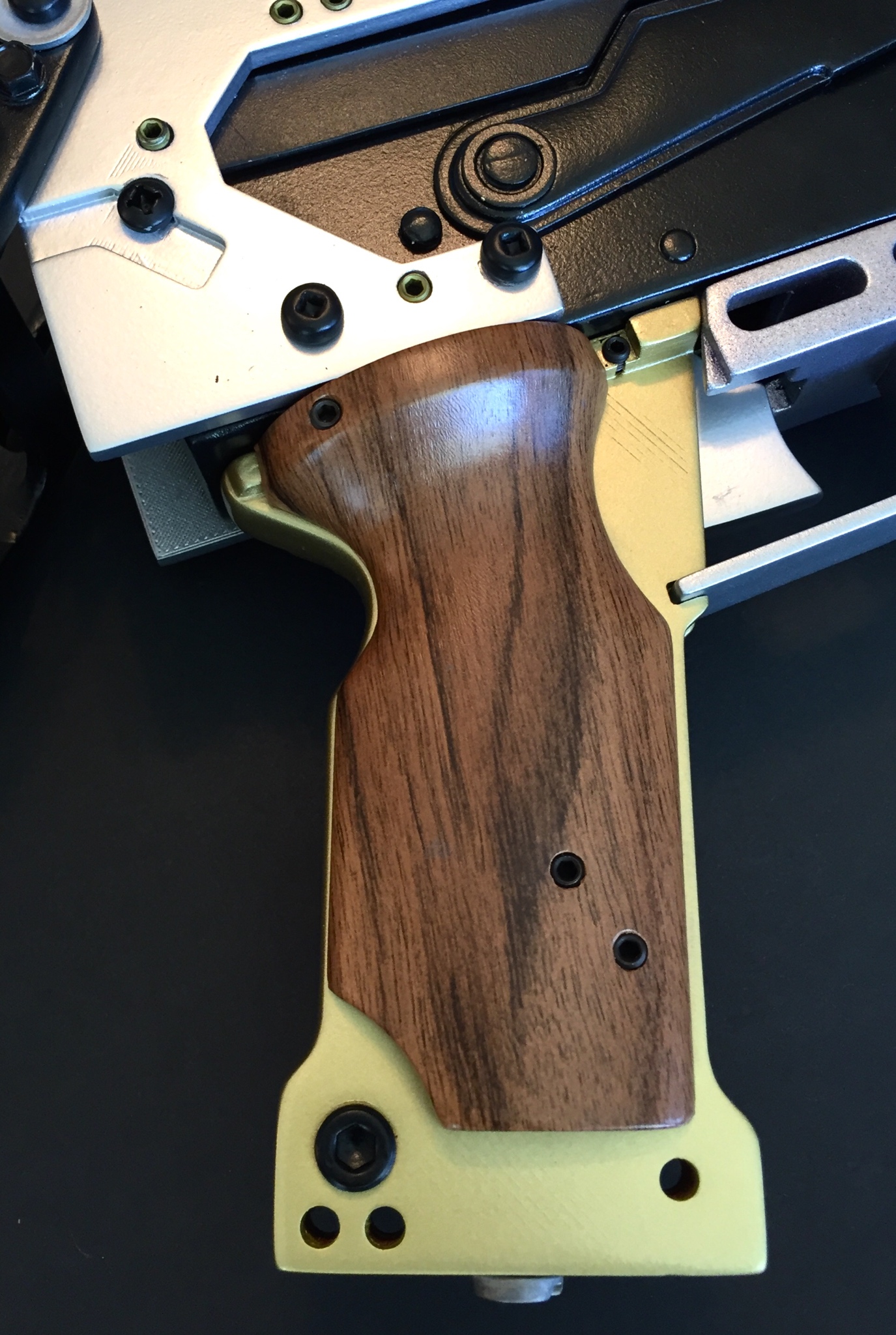

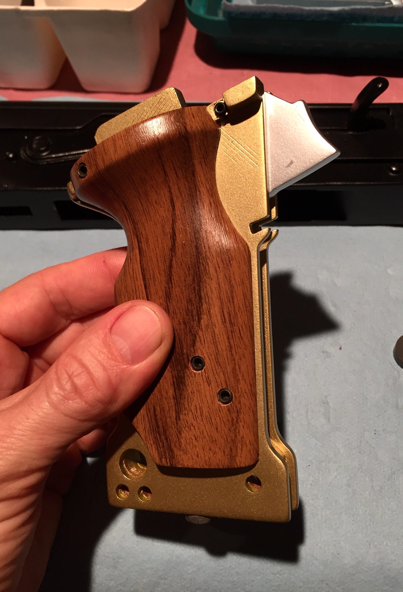

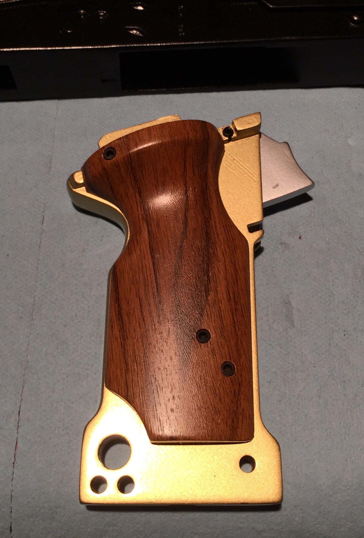

Tell me more about this vinyl, it looks amazing but I've got to know how it holds on. Adhesive, or what? And how sturdy is it for prop handling?
This Vera build's flat out amazing, and I'm SUPER impressed with all the detail work you put into it. Keep on keepin' on!
Sorry, forgot to reply to this... the vinyl is just from the local home hardware store and was pretty cheap ($10 or so). It's adhesive and peels off a backing paper. You get a decent amount to work with, although the pattern does repeat every couple of feet or so. Not an issue for something this small of course. It's pretty tough stuff and has to be heated up to contour to curves. I spent a while with the hairdryer heating it as I went. Obviously I'm dealing with a few curves, so keeping it hot was important. For a flat surface, you wouldn't need heat. It's not perfect stuff to work with. I've used other types of vinyl that mold a lot easier than this stuff, but it still worked well enough.
I'd say it's pretty durable stuff and good for handling. I also tried clear-coating some of it, just to see how it would look glossy and the clear-coat took really well. I opted to keep Vera's grips as they are (no clear-coat) as I prefer the look.

Re: Firefly "Vera" Build - WIP
Glad you're enjoying the build.

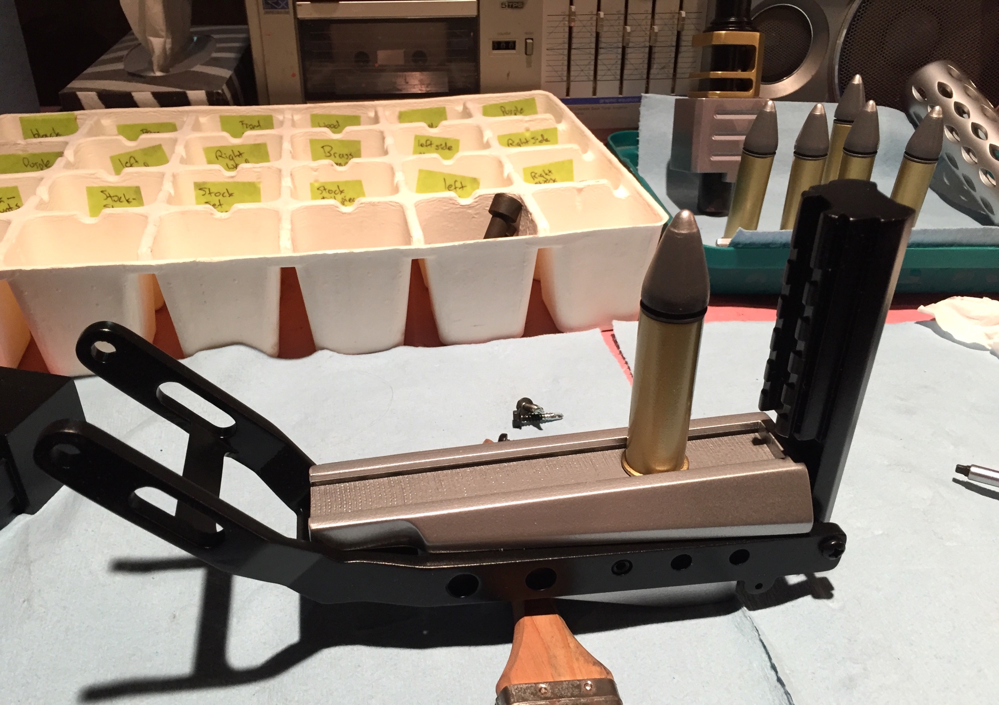

So Vera's ammo are made from 12 gage Magtech brass rounds...
I tried a few places and couldn't find them. One gun shop said they had used brass rounds (a bag of 100 for $10!), but when I picked them up, only the bottoms of them were brass, not the entire shell. I did find a Canadian supplier, but by the time I added shipping, they were going to cost a bomb. So I opted to make my own out of aluminium tubing and washers...
To flatten the ends of the pipe (hard to do by hand) I used a large washer to get an even surface...
They turned out pretty good after a sand...
The darker plastic tubing would be used to widen the gluing surface.
6 shells needed as the 4 rounds in the mag are just tubes...
Ready for paint...
I'd considered grinding back the washer to lessen the bottom protruding edge, but you don't really see them and the size they are is actually perfect for slotting into the track on the bullet holder. So they will stay like this.

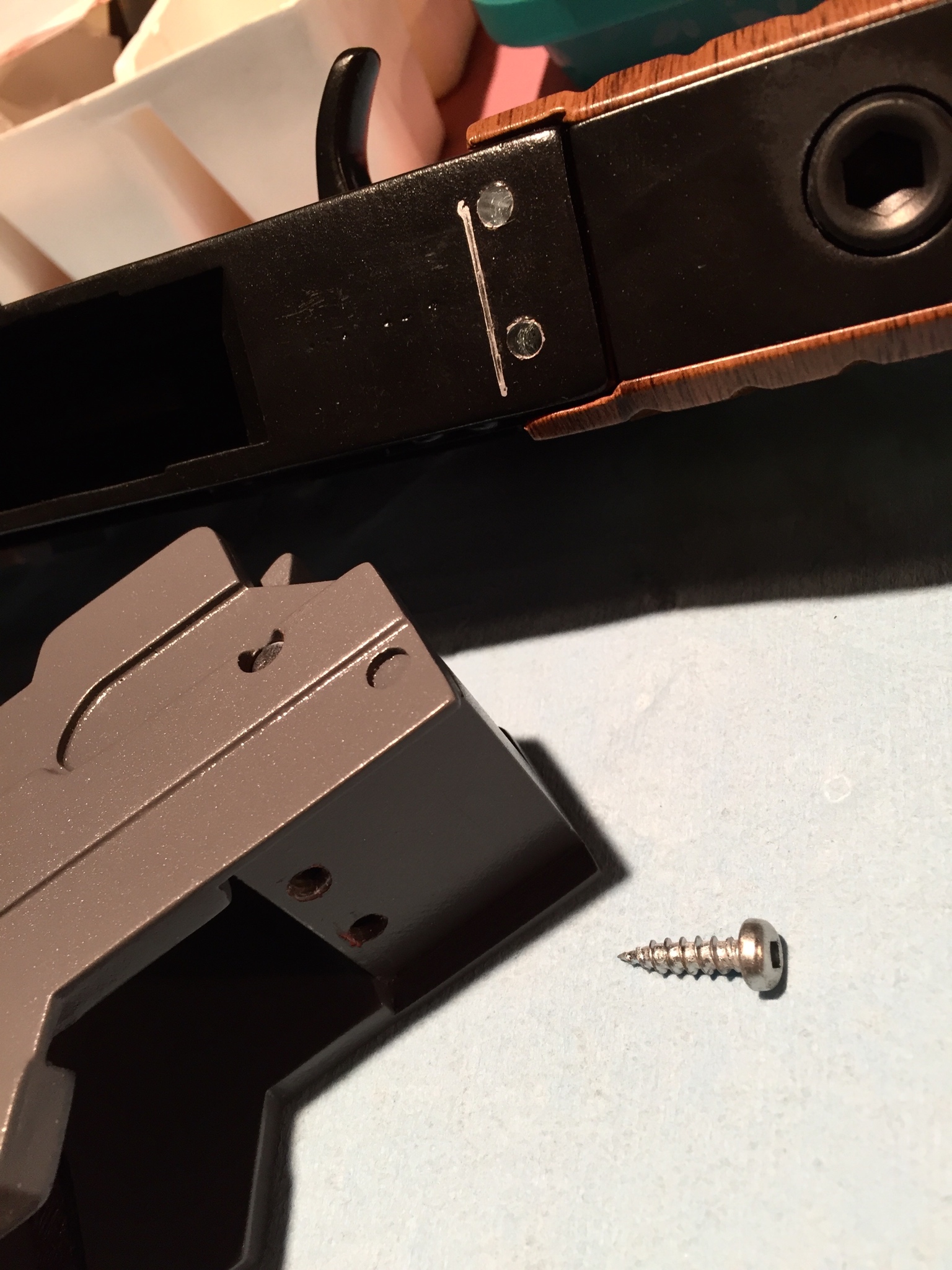

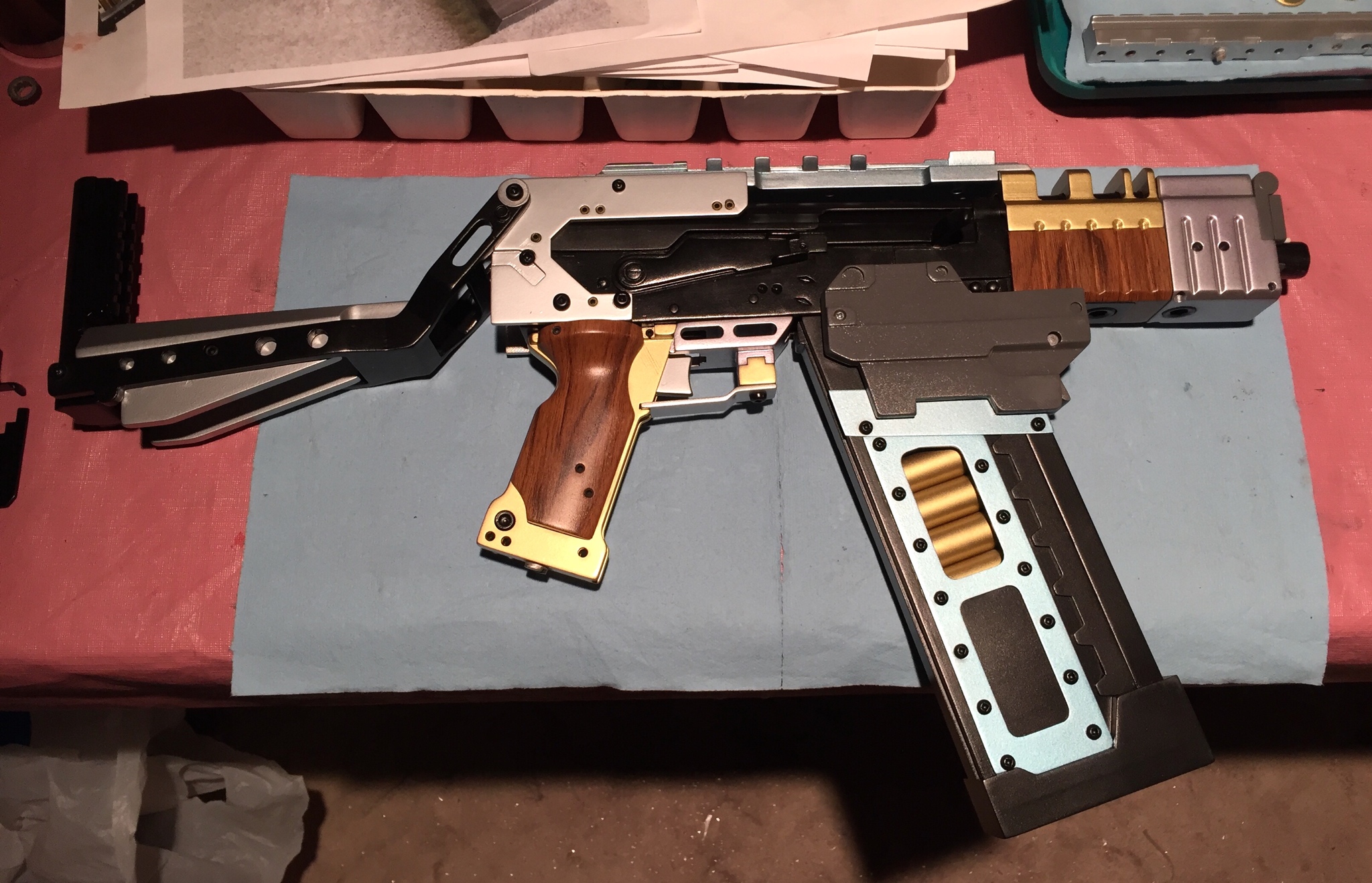

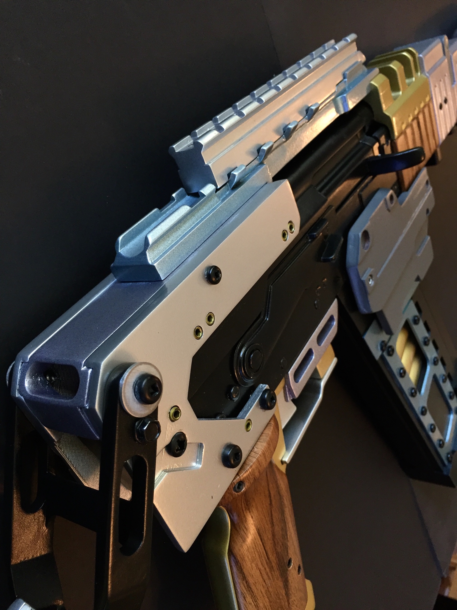

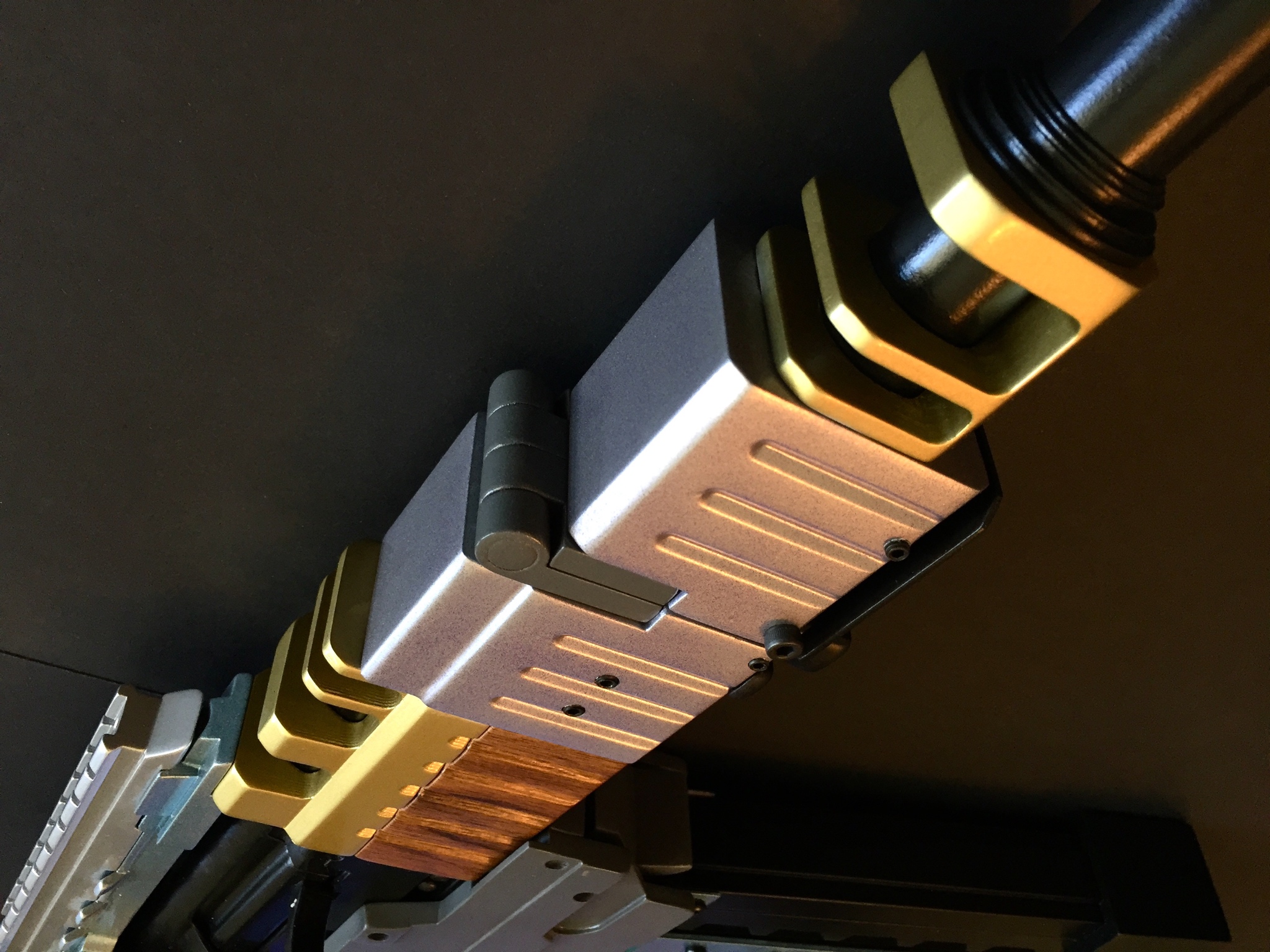

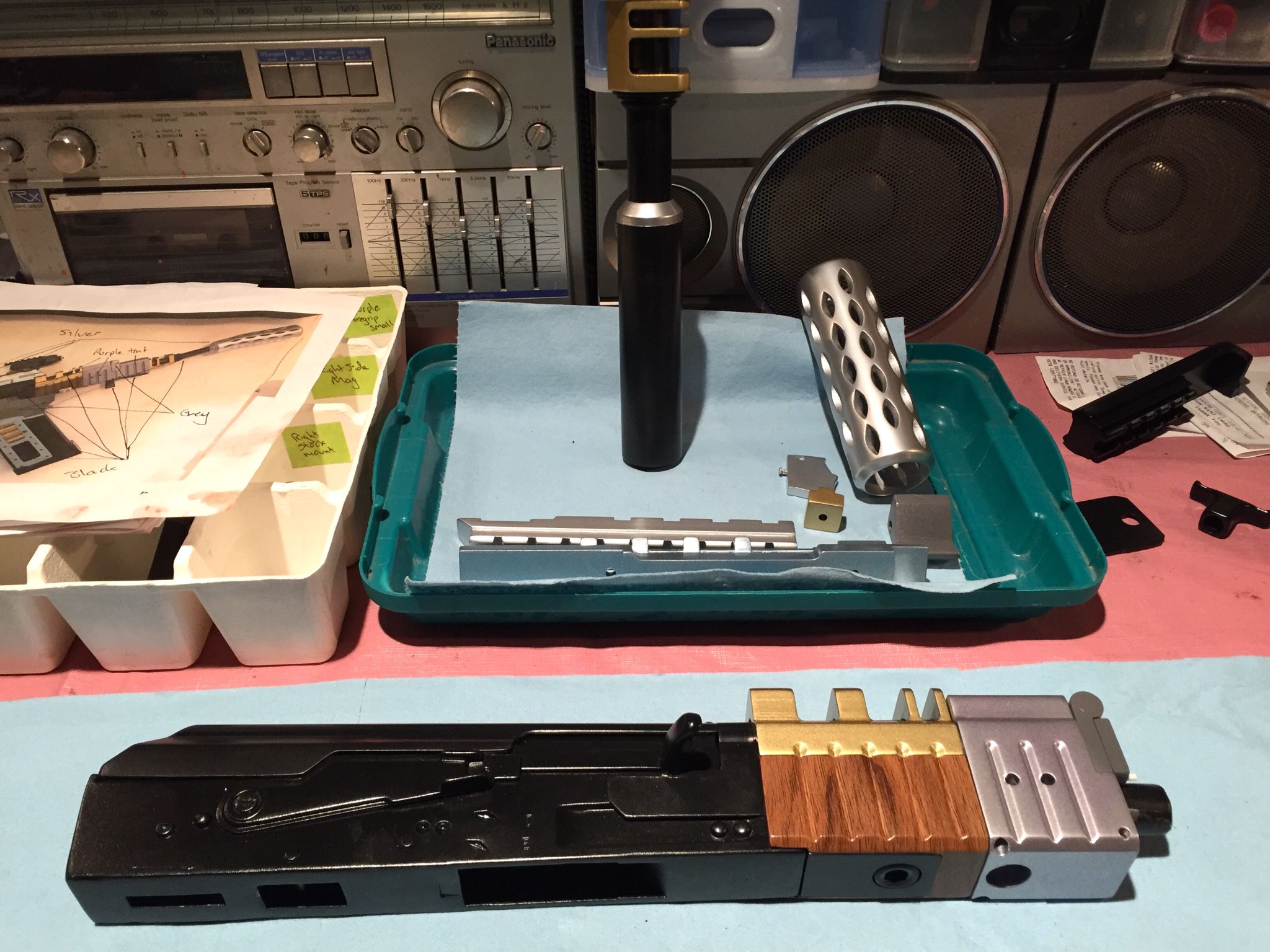

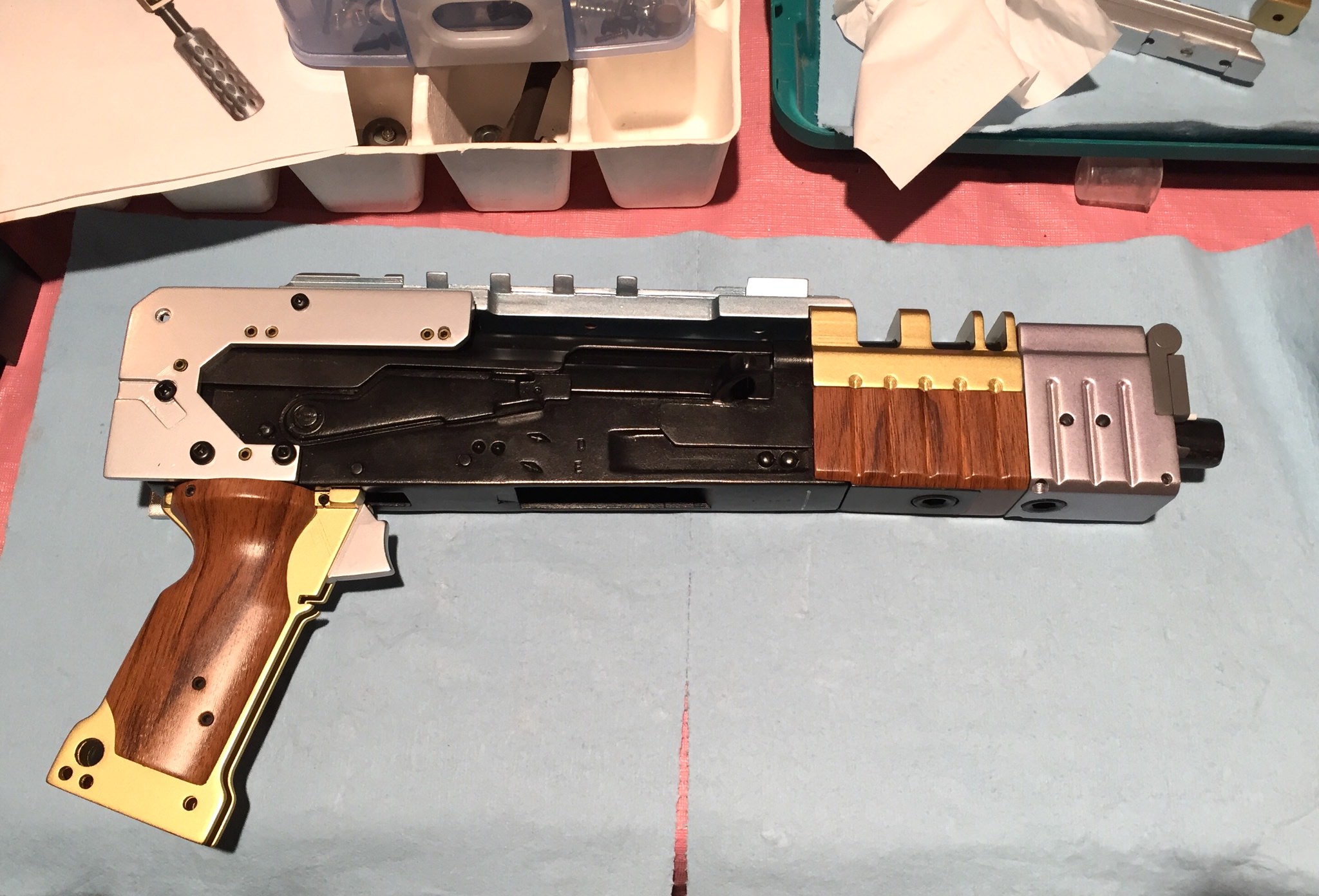

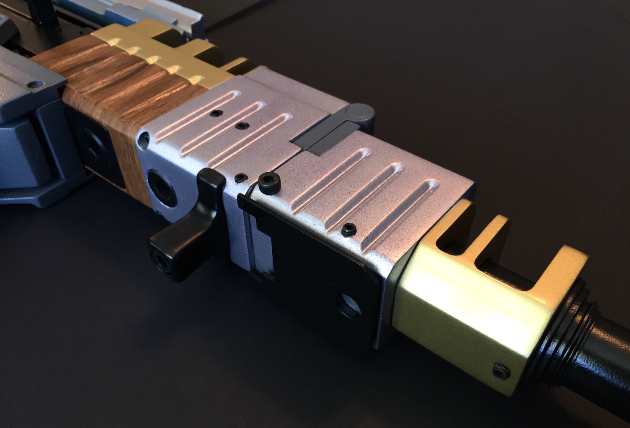

Ok, so the last day and a half have been assembling Vera. She was tricky to put together as tolerances are very small and there are many variables for an accurate fit. Not to mention this kit is specifically designed for an airsoft Saiga, not the Denix AK. Plus, I didn't want to just glue all the pieces on, as it would make her far too fragile. So I added screws where I could, to give her strength.

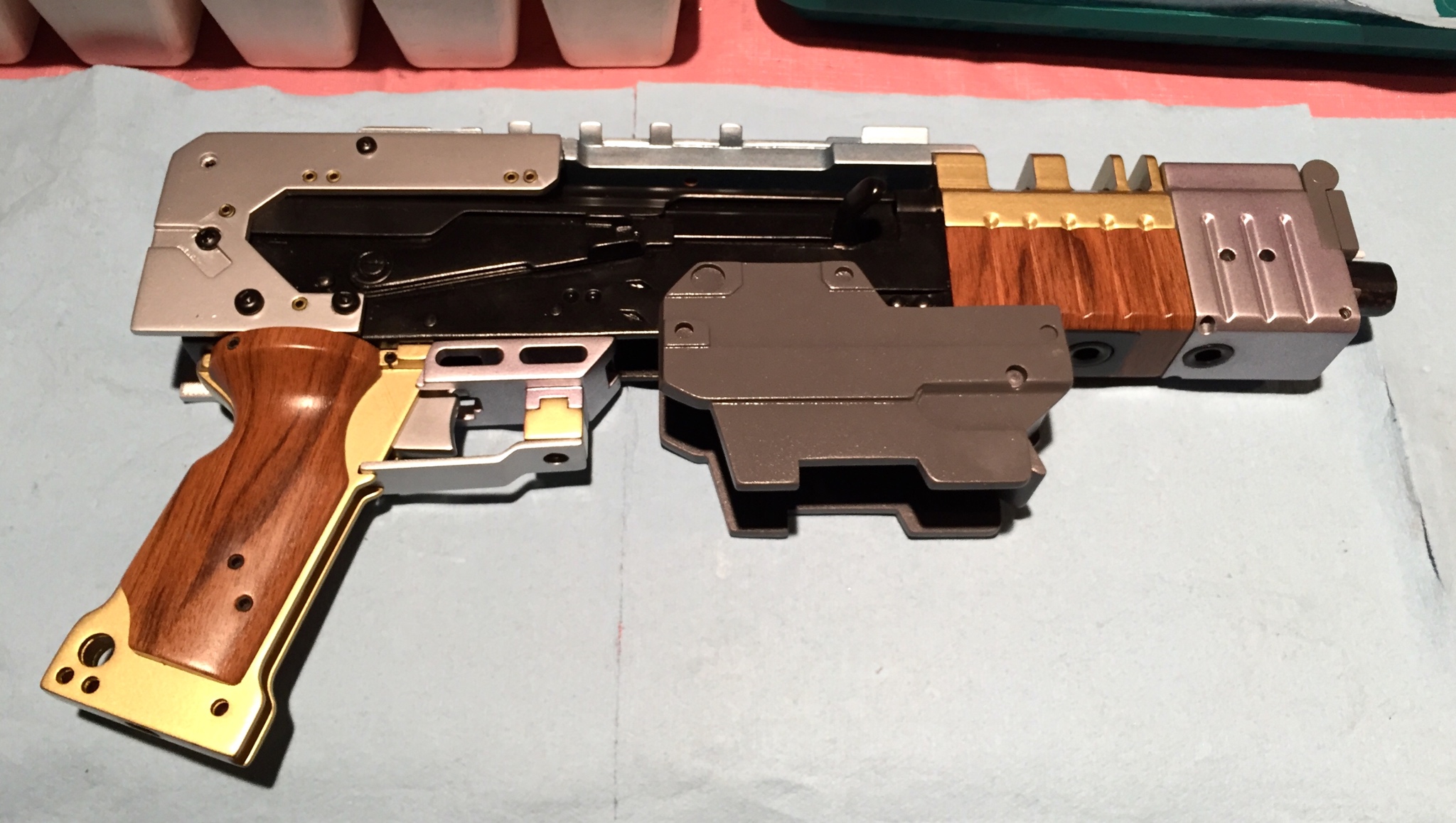

Started with the receiver...
Then added some of the fore-grip pieces as well as assembling some are the barrel parts...

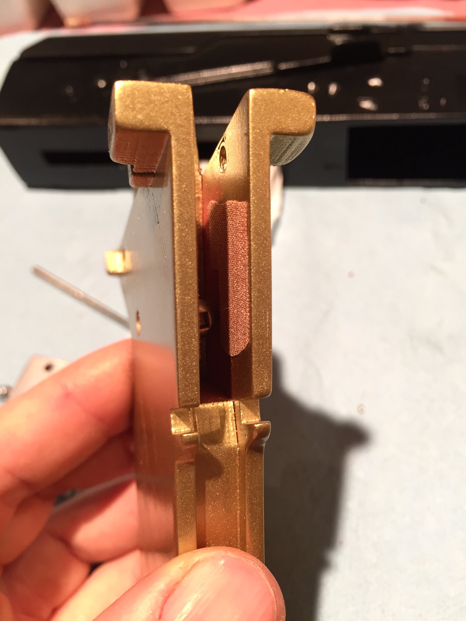

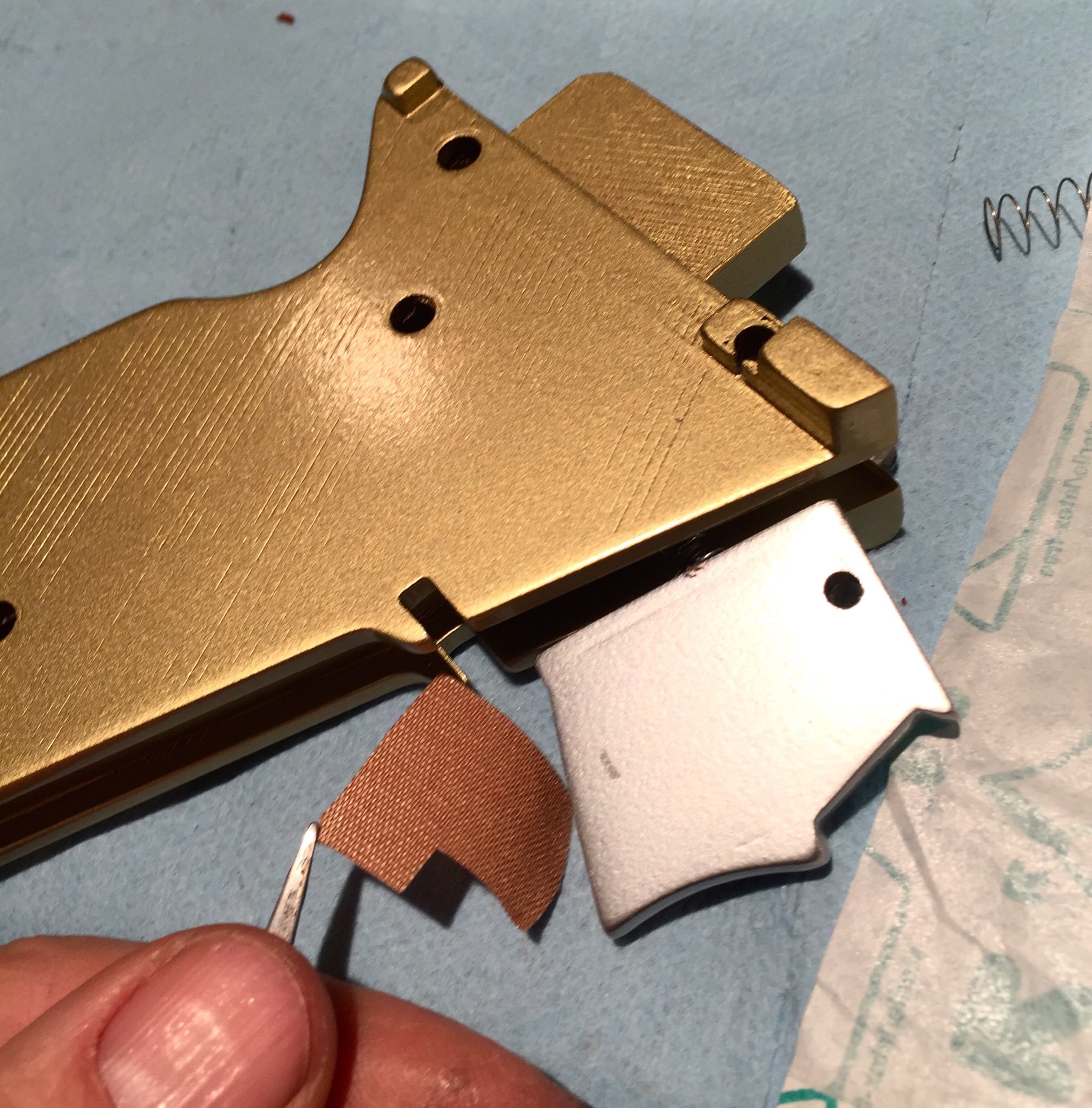

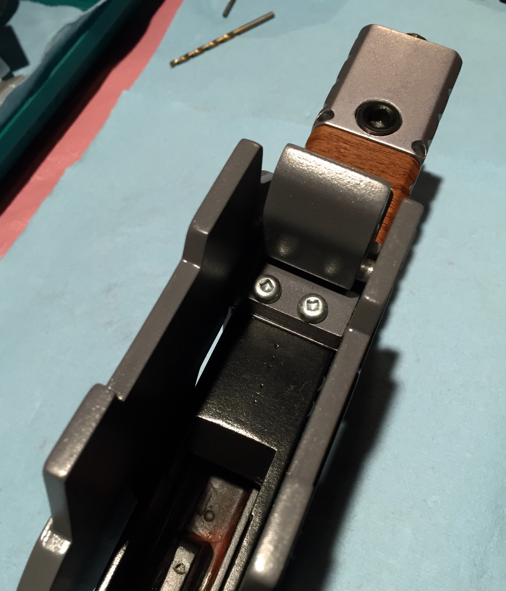

While assembling the grip and trigger I could see the trigger would get scratched easily, so I used a cloth band aid to line the walls of the trigger well...
Added some set screws...

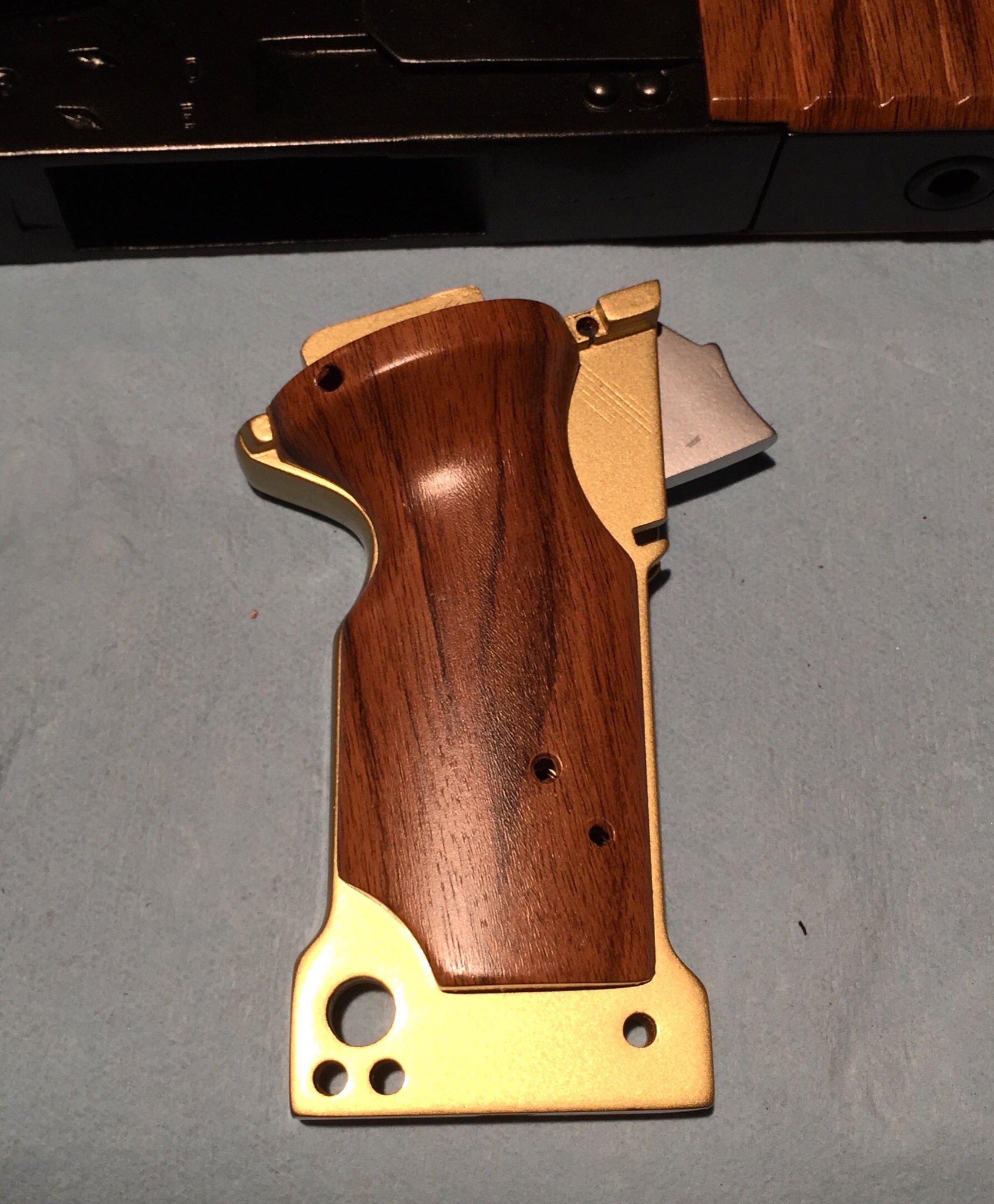

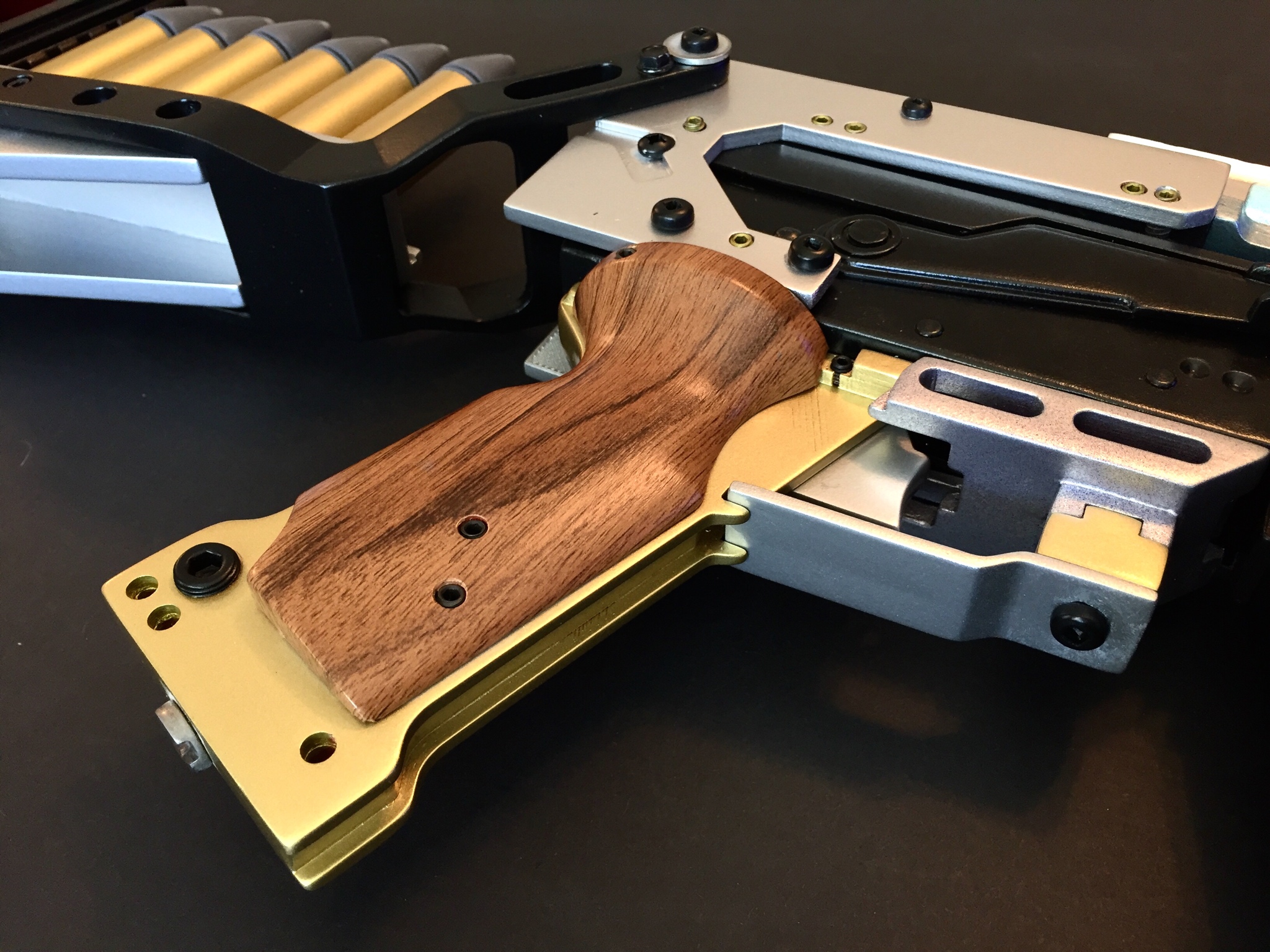

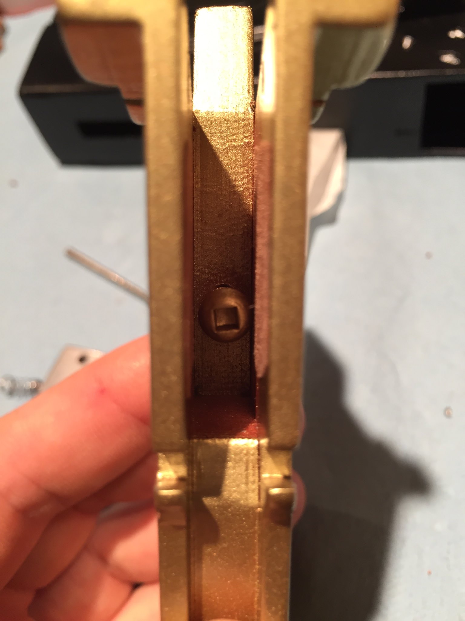

The next part was by far the trickiest, the "stock mounts", which are the large silver parts that go either side of the rear of the receiver. These have to line up with the top of the grips, but also they have to sit level to allow the top rail to secure to a flat surface. As it holds the stock it needs to be strong, so the large screws you see are actually screwed right through into the receiver...
An upside to this was that at least one of the large screws (on each side) also went through the grip mounting point, which would of course give the grip added strength.
The same applied for the mag-well, I added 2 screws (out of sight) for strength...

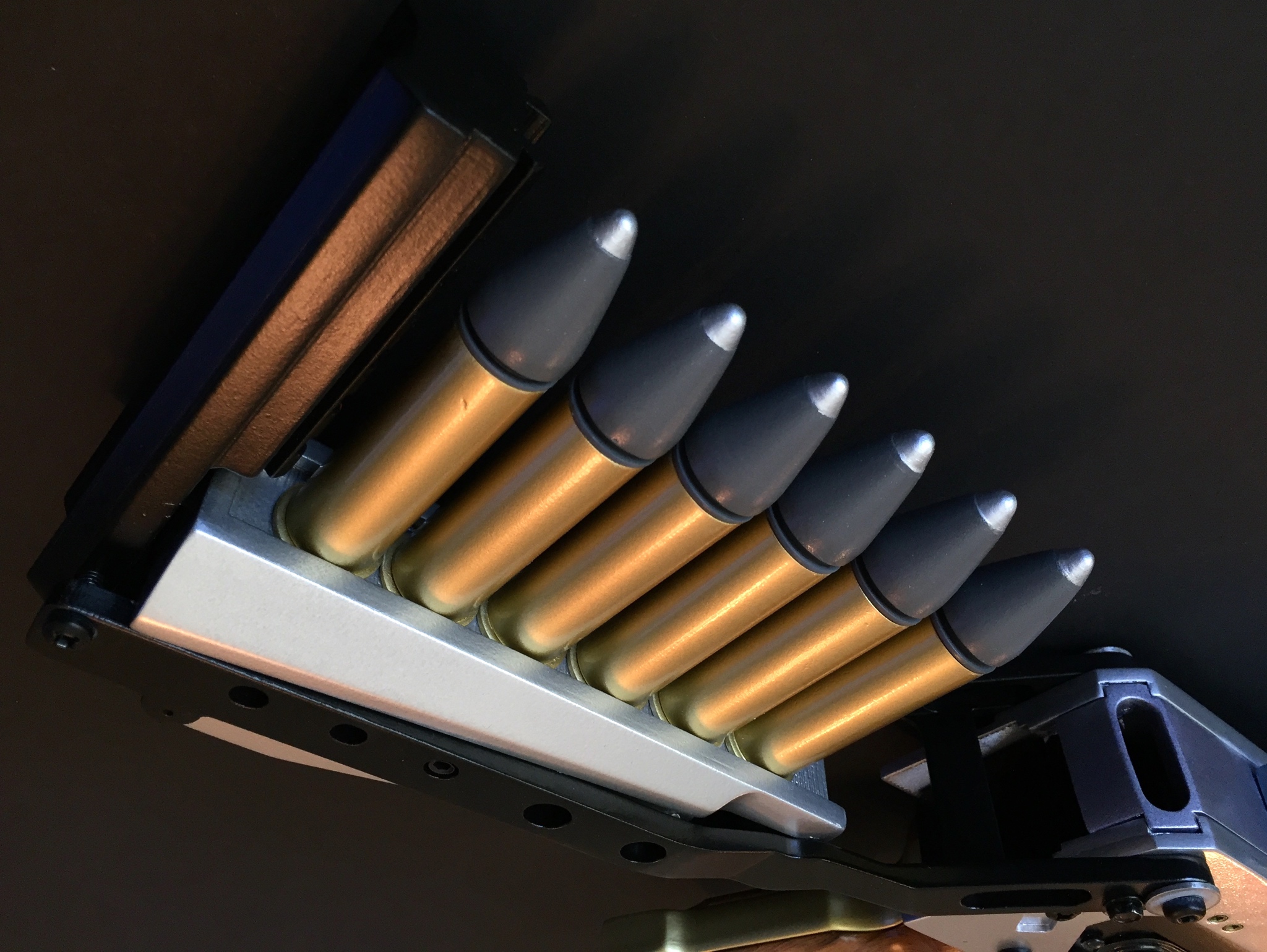

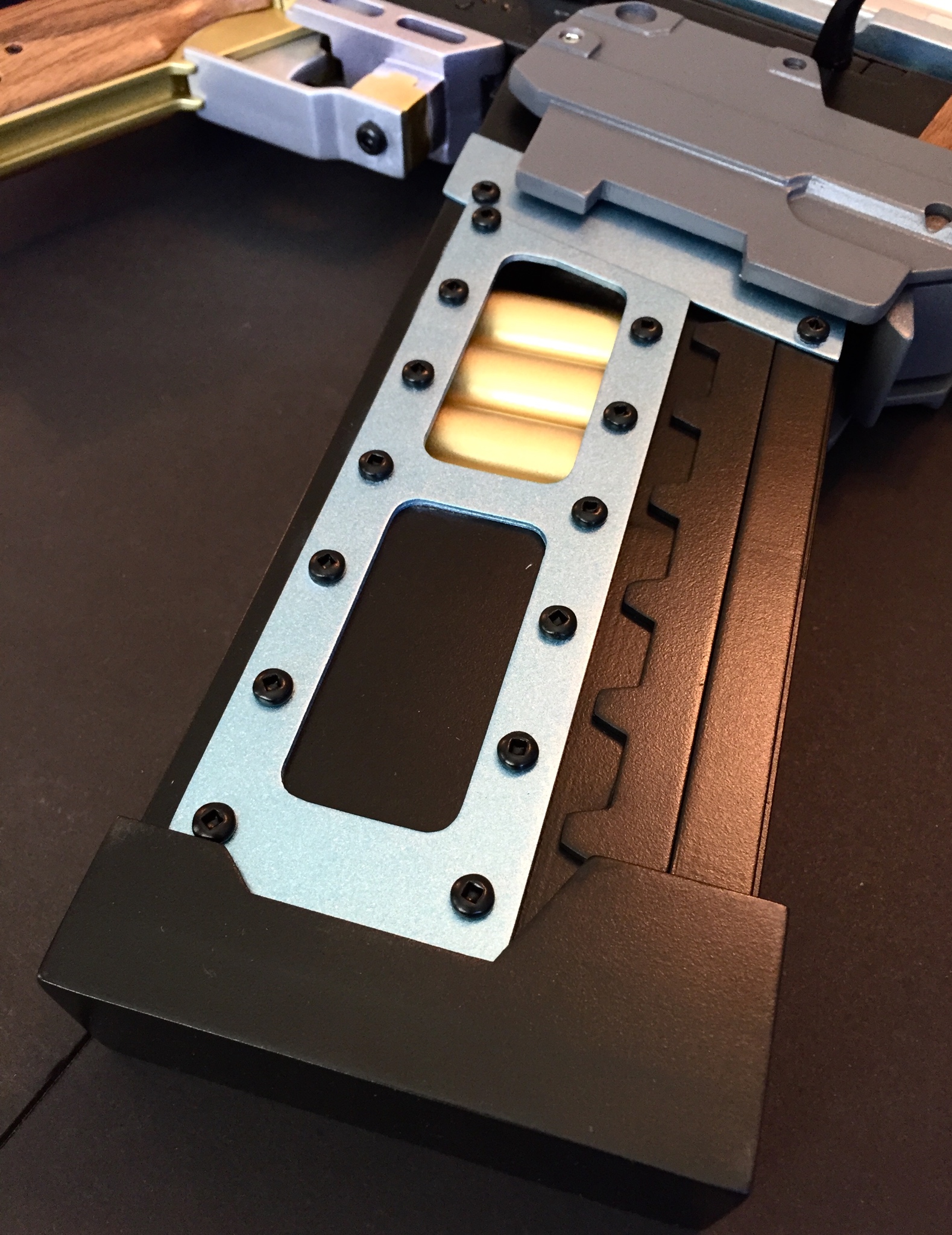

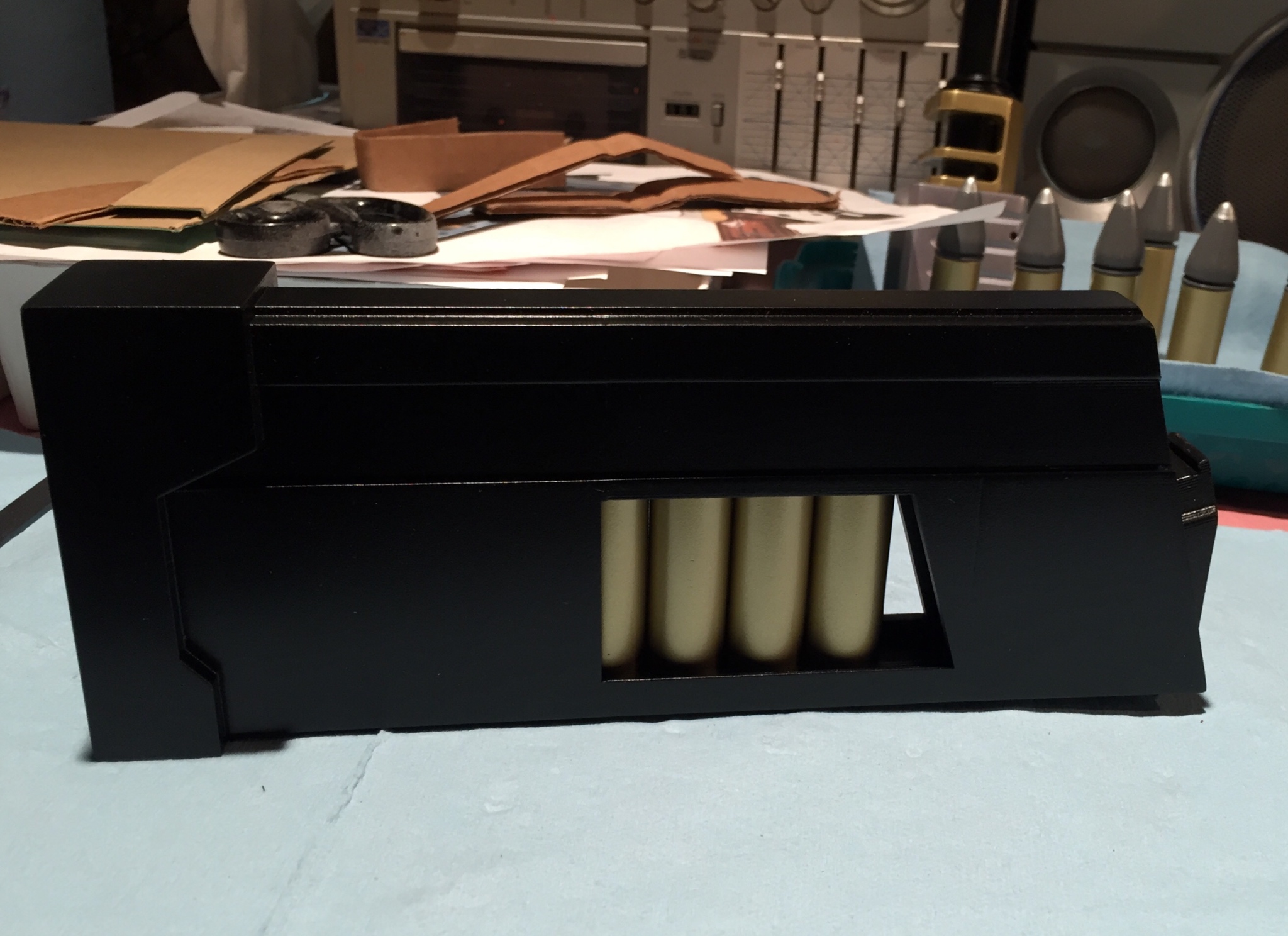

Onto the mag. The dummy rounds are glued into place. I used a piece of folded cardboard to hold them up in the mag where I wanted them.
Attaching the mag to the mag-well was going to be another weak point. So as well as gluing it, I used a hole each side of the mag-well to add a screw that would hold the mag in place. Not canon, but functional.
Another tricky part was the stock. In the end to get it to fit right, I warmed up the arms of the stock with a hairdryer, which worked a treat.
And then after a few more hours...
She sure ain't a perfect Vera. I could list all the imperfections and in-accuracies. But as a classic car owner I've learned that while I may know where every scratch and imperfection is, most people just see a flippin nice car! Same applies here. She ain't perfect, there's a bunch of inaccuracies (mainly screws), but she's a Vera! And she's MY Vera. And I L-O-V-E her! In fact, she may well be "my most favourite gun". :lol

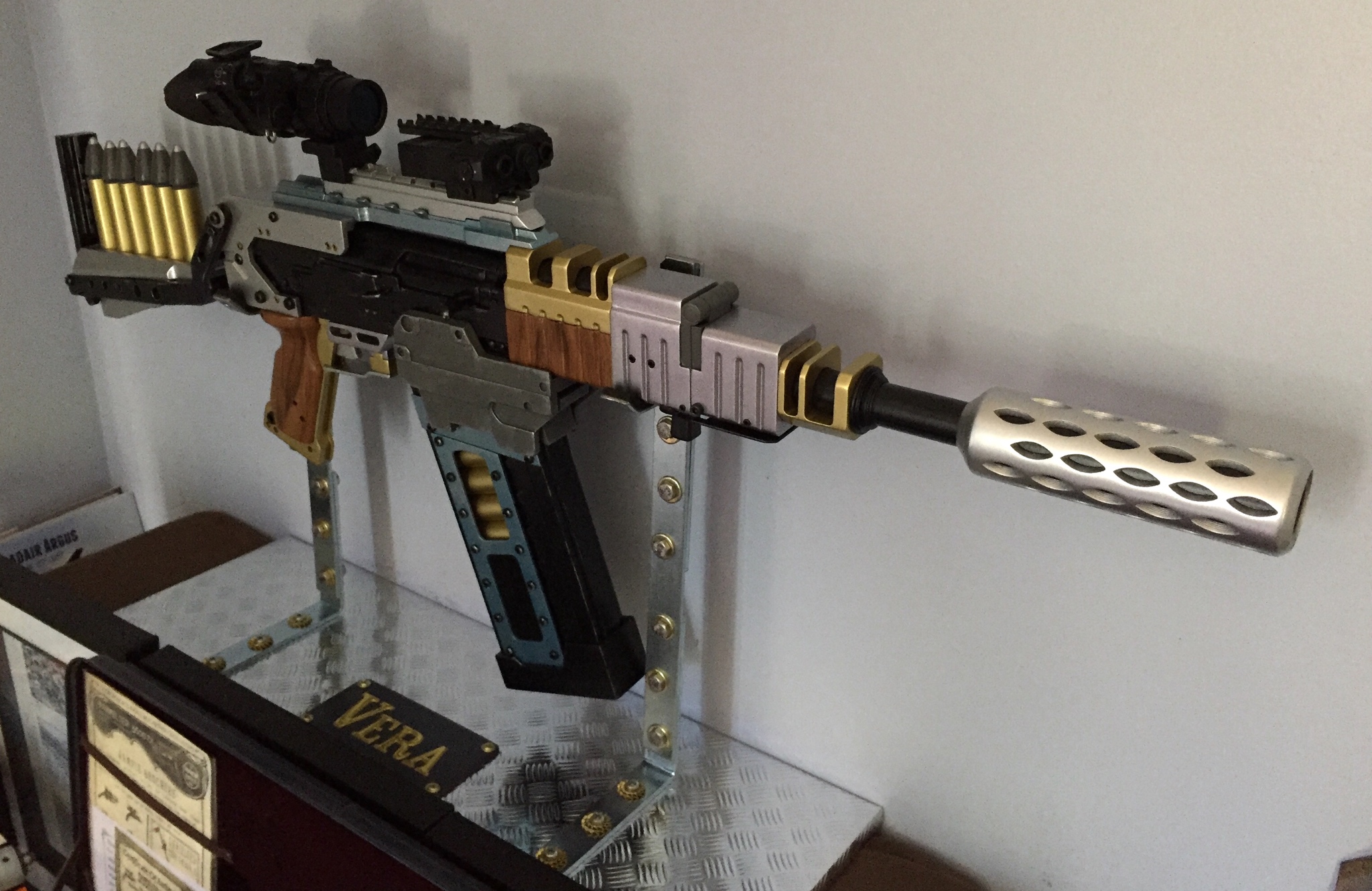

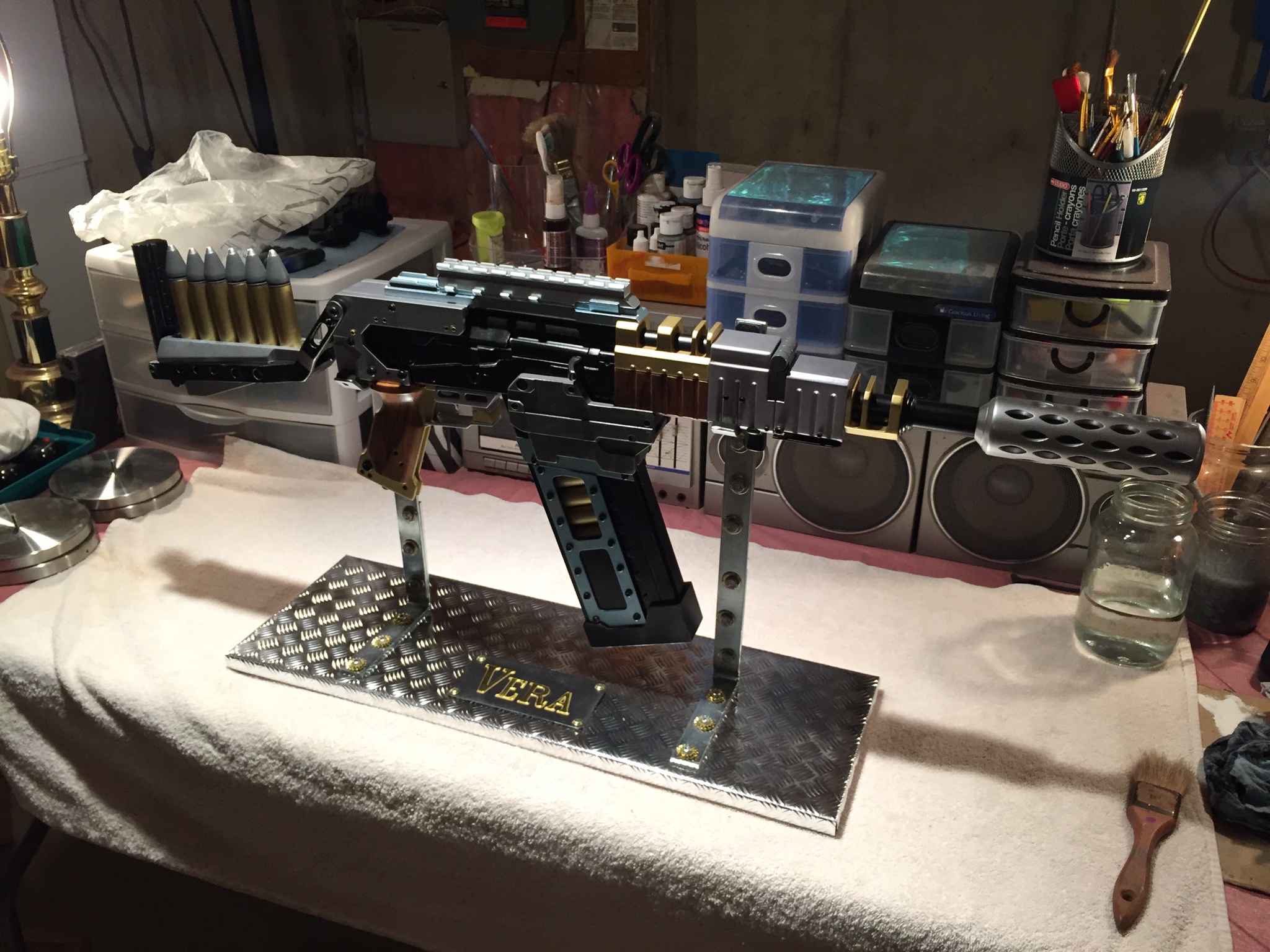

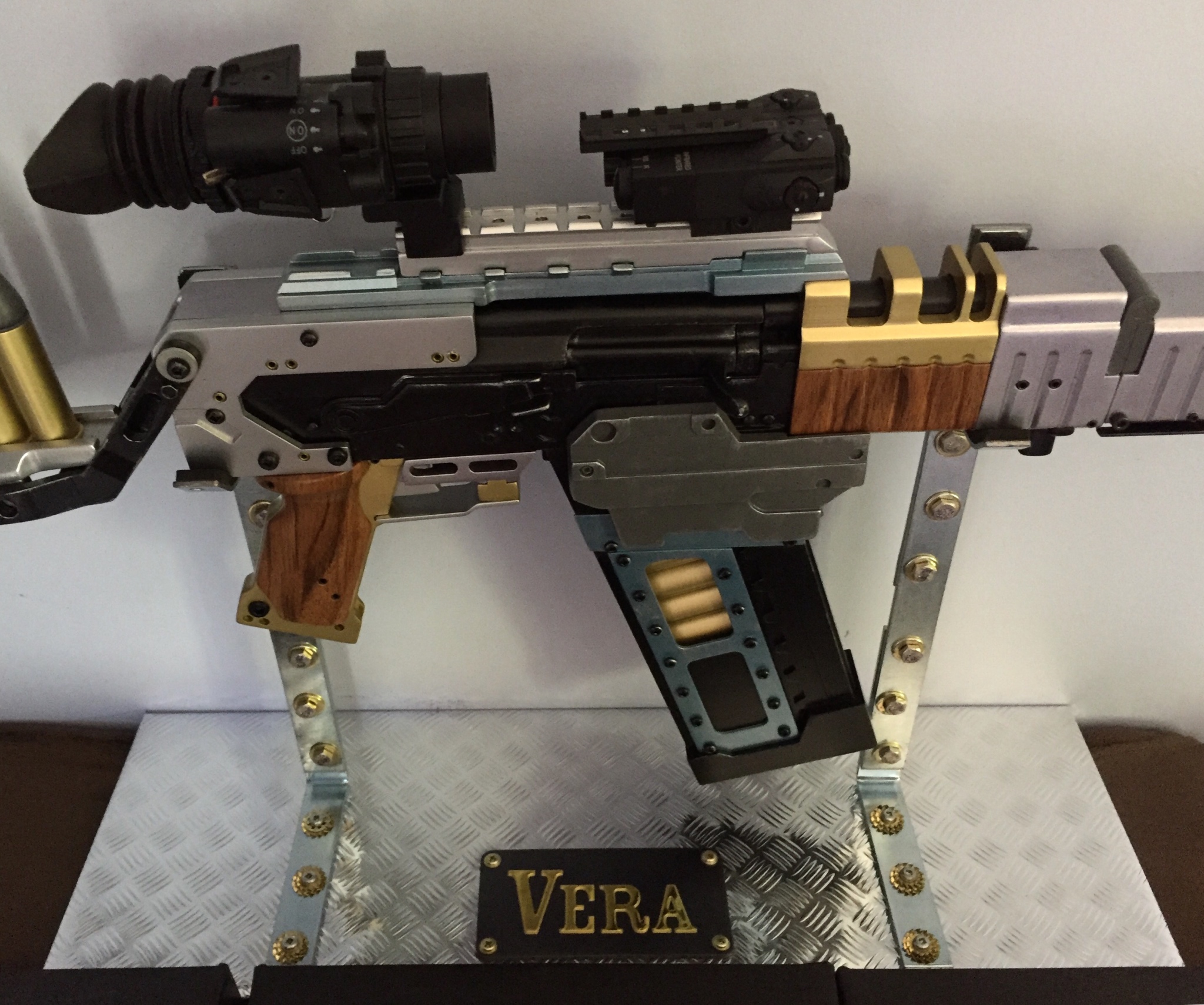

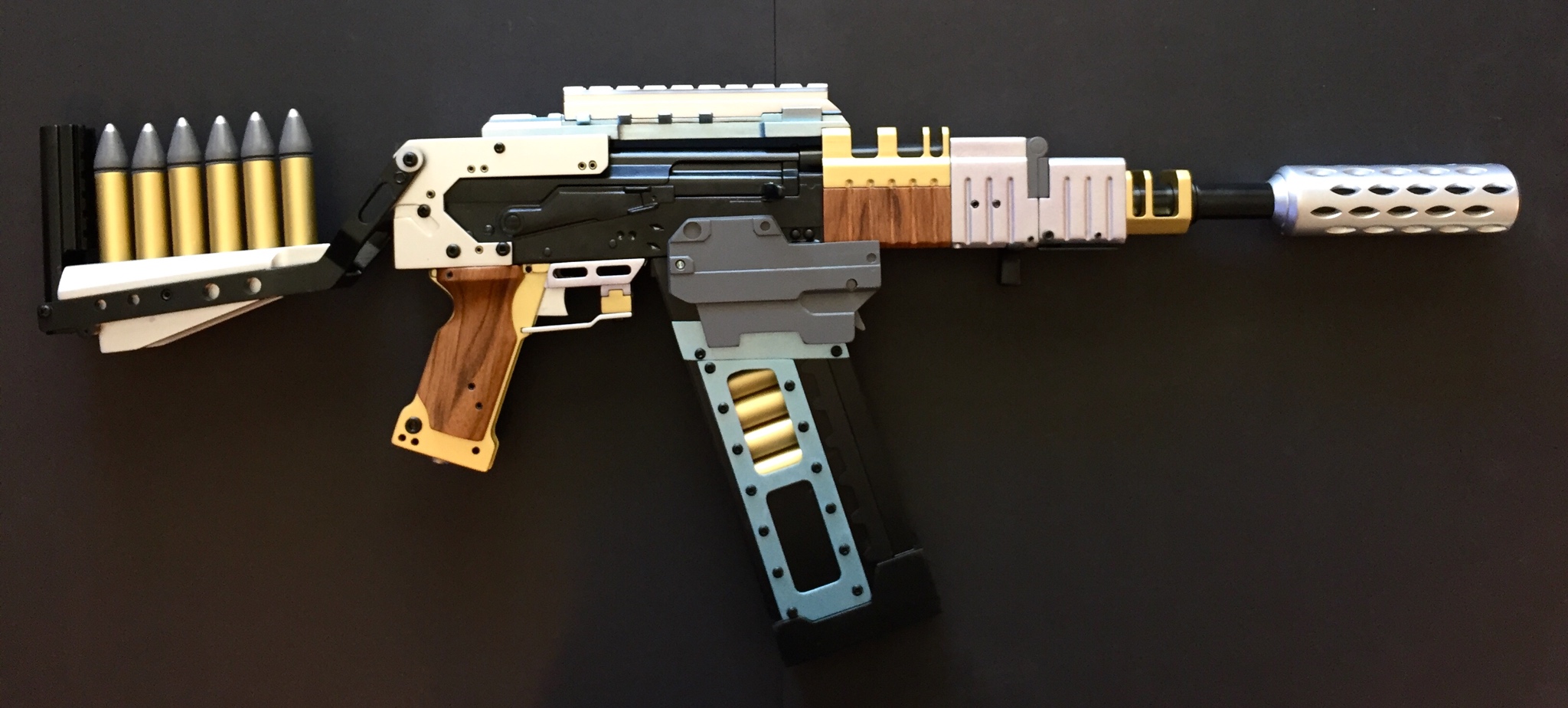

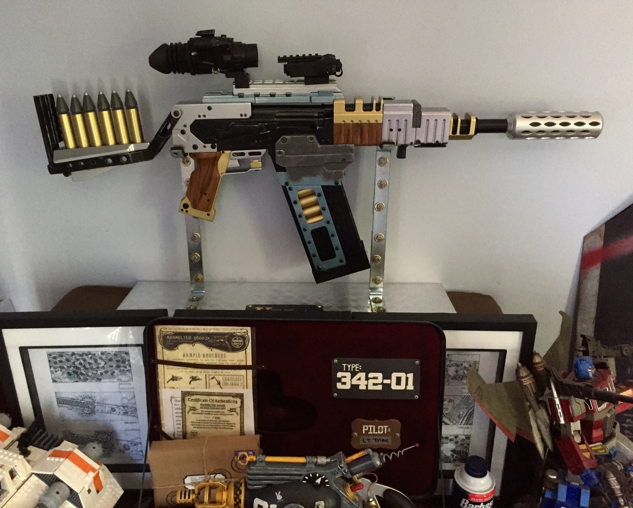

Finally finished this beautiful girl!

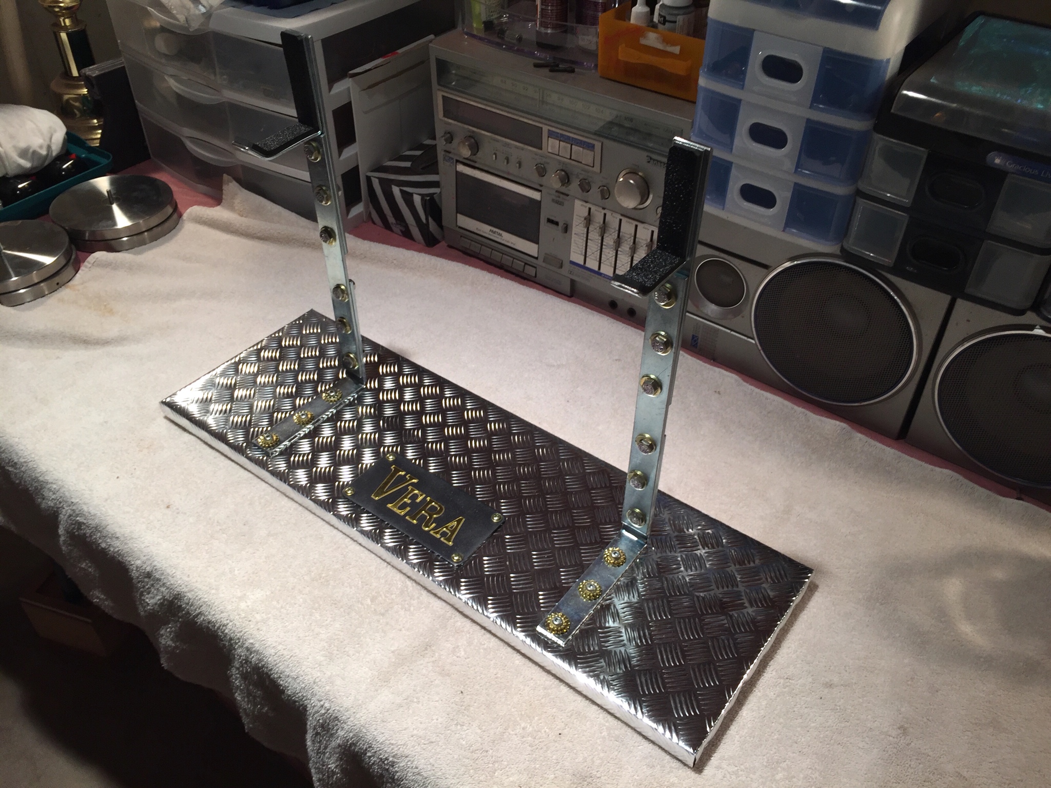

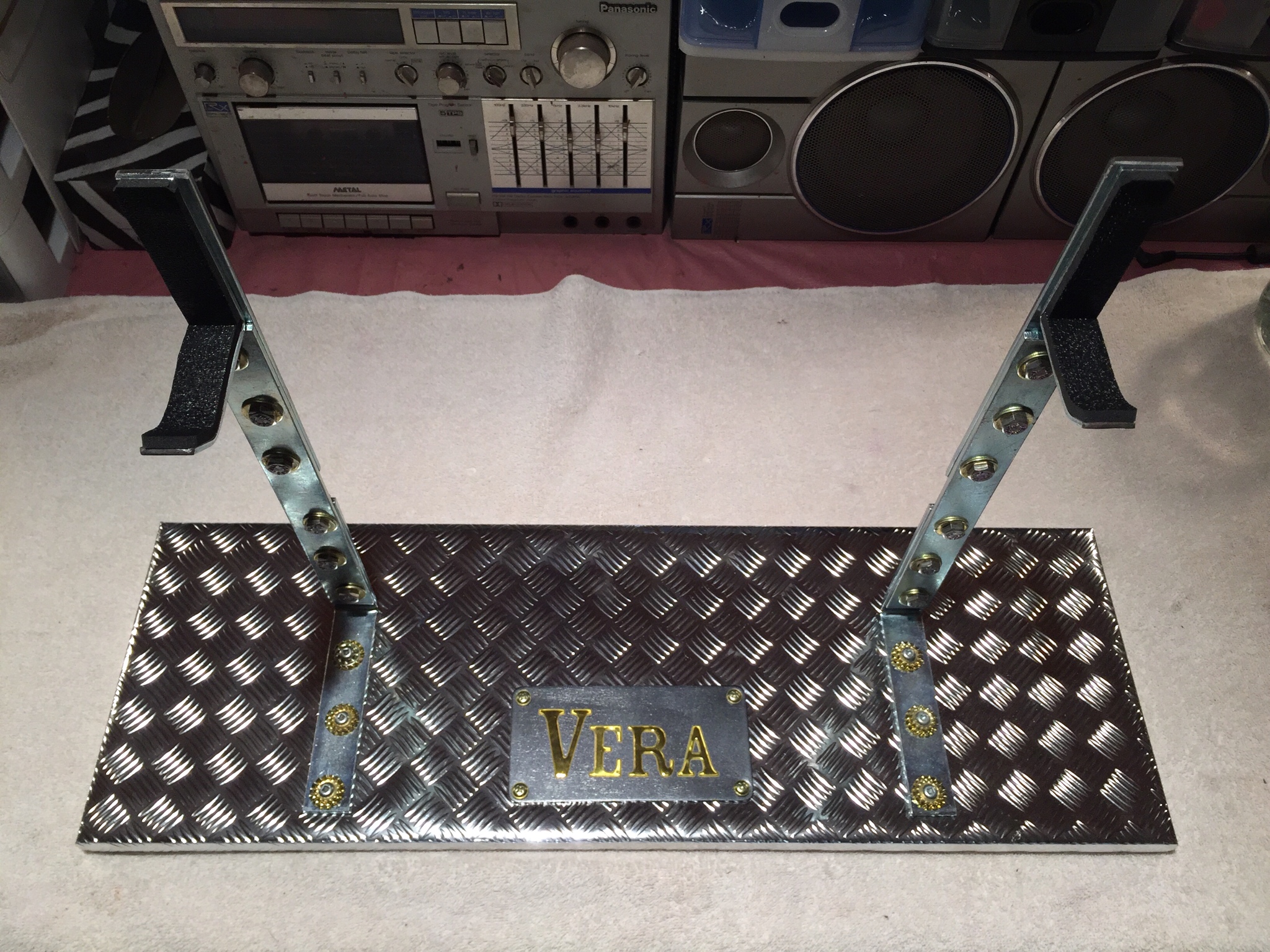

Made a stand for her...
She'll eventually end up on the wall, but this will work for now.
Lightly weathered, scopes added and she's done...
Big thanks to @JOATRASH FX for the night-scope ring! And all the help and advice. Not to mention the kit itself! Lol, basically a Legend all round. :thumbsup
So cool! What a beast that piece is. Masterful work, as usual.
The stand is just as impressive. Both fit very well with each other. Jayne would be proud :thumbsup
