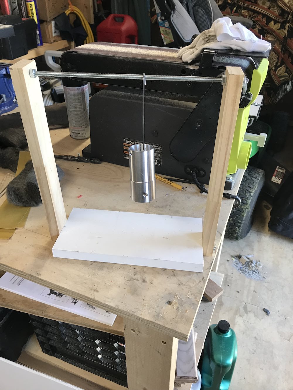

    I made a carbonite dipping camber out of a 2 dollar cup i got a the dollar store, and a swing set out of some scrap pine, and threaded rod. this swing set will allow me to hang the metal while im timing it. (hanging is a MUST)
    I can not stress enough on how bad this stuff is to breath or get on your skin, PLEASE if your going to order this stuff, WEAR PROTECTION!!!!!! .... that sounded great...
    IT IS VERY IMPORTANT TO HANG THE PRODUCT WHILE YOU ARE WAITING THE 5 MINUTES
    THIS IS SERIOUS: You have to hang the pieces because if you place it down on a surface, the acid rolls down, and forms a puddle, this puddle eats the bottom of the aluminum. it pits and destroys it, if left long enough it will literally EAT the aluminum! ask how i know... i've been experimenting with this stuff and learned the hard way. DONT be lazy, and set up all these tools & jigs and you won't have to worry about it.
    this chemical is expensive, and you dont want to spill it, so i screwed this cup to this piece of plywood.
    Now that we got the carbonite dipping chamber and swing set its time to break out the chemicals.

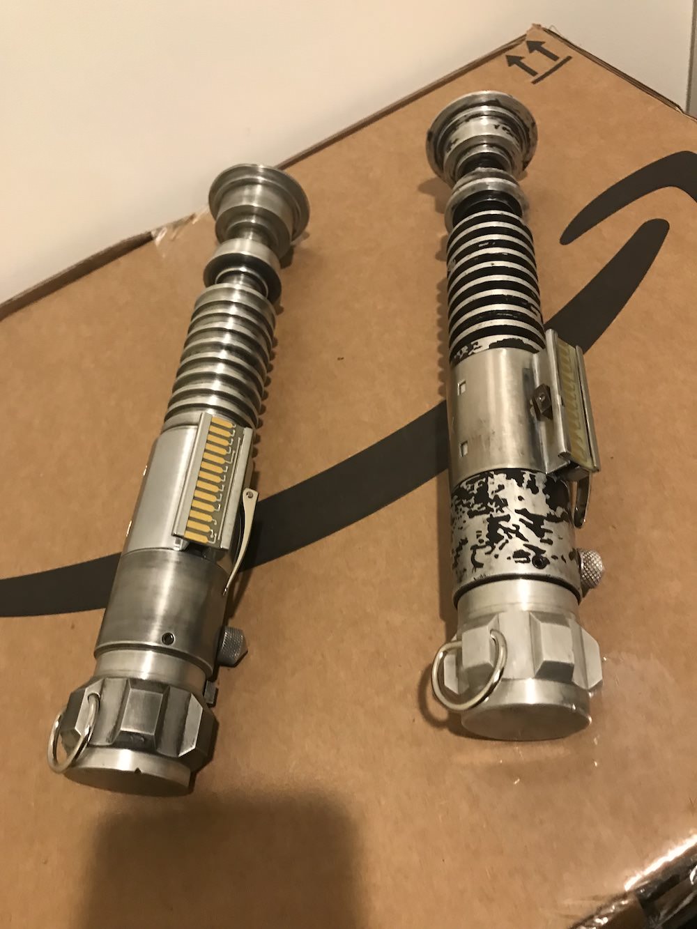

    I have found for me and my friend to get the color of our boosters below, it took us 4 carbonite dips with the A14 mixed at 75% A14 25% water.

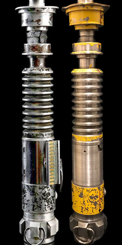

    the pommel is the hardest part to do. only because of all the cubes, my goal is to match the pommel cubes to the booster. I did the same process, clean, heat, soak for 5 minutes, clean with 0000 steel wool. only thing is it takes forever to clean the pommel cubes...

    To get to this level of patina above (left) we did the following
    -Emitter 2 soaks @ 5 minutes
    -Rings 2 soaks @ 5 minutes
    -Booster 4 soaks @ 5 minutes
    -Pommel 4 soaks @ 5 minutes

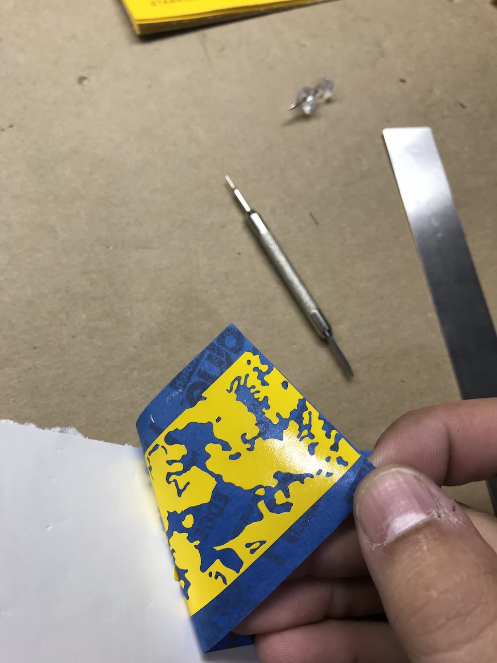

    These stencils are like the first generation, where we "weed" out the brown, apply some blue painters tape. and then apply to the saber, remove the blue tape and the stencil remains on the saber. so trents instructions begins with #1 so we will start there.

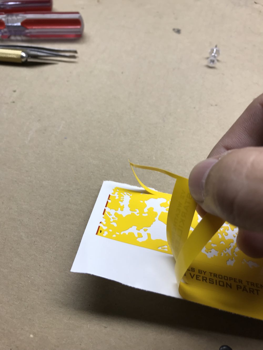

    i cut the section i want out, and begin weeding
    Another cool little easter egg Trent hid in these stencils was this black dot, that orientates where the cone knob is!
    once all the brown is removed, weeding is complete. now i remove the rest of the sticker, revealing the actual weathering pattern.

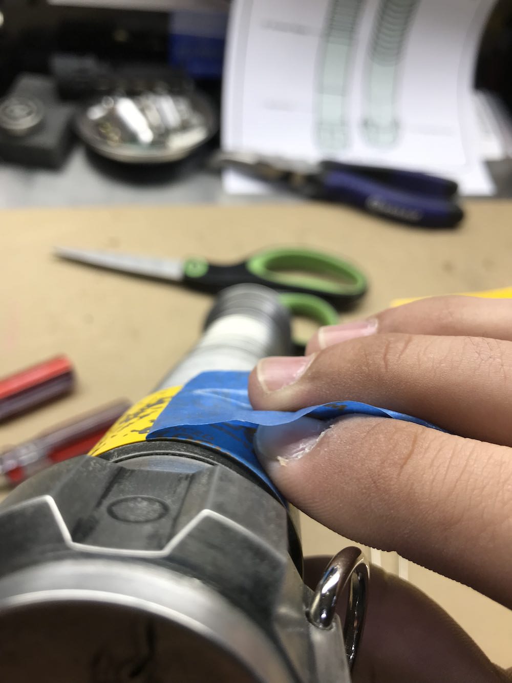

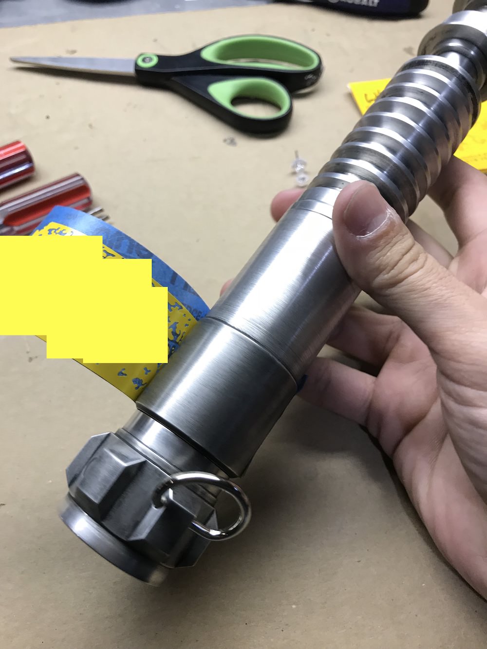

    now with the stencil trimmed, we line the edge of the stencil half way on the set screw. like in trents instructions
    DO NOT PRESS DOWN HARD ON THE STENCILS
    You dont want to press down hard on the stencils right now, there are a lot of small pieces in this stencil. (Islands) if you press down hard now, and you have to re align it, when you peel it back the islands will be tough to keep stuck to the blue tape. lightly apply the stencil, make sure your on track and going where it needs to be.
    now with the straight edge of the red line pervious stuck down, slowly pull that blue tape up, and i mean slowly. making sure the stencil is stuck to the saber. we peel back the blue tape now to help line up the end of the stencil.
    ** Trent Tip: See what i mean? if you saw my video where i was putting the stencils on ethan's V2 i was struggling with pulling the tape back at this point. if i had my extra length (tail) it would have been far easier.
    perfect fit!! GOD bless you Trent!!

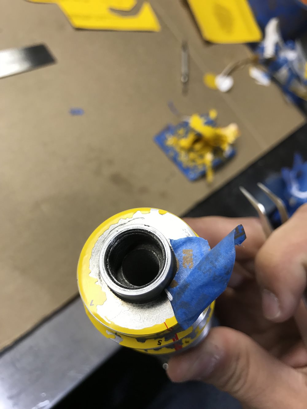

    Now we need to remove the tape, i actually love this part and its my favorite!! ever so slowly pull the tape off, BUT we have to pull it at like a 90* angle, like this
    We pull them very slowly because the islands are so small they tend to stay stuck on the blue tape, this is easy... once you start seeing a piece not sticking, grab that pin, tweezers or sewing needle and pick it down
    and once you slowly remove, and check everything....
    TADA!!!

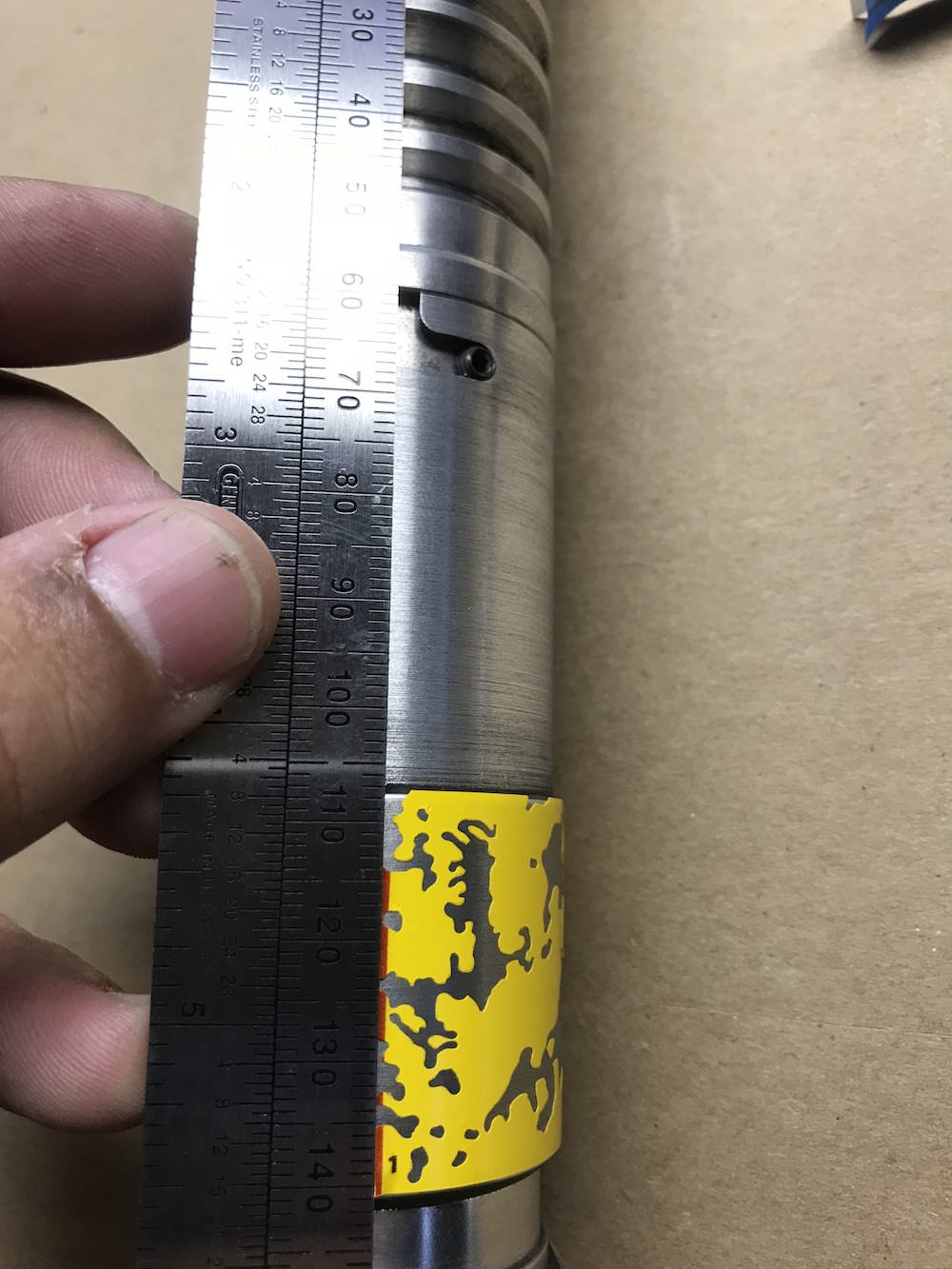

    With #2 we need to align the red lines. so i used a straight edge and made a pencil mark where to start #2.

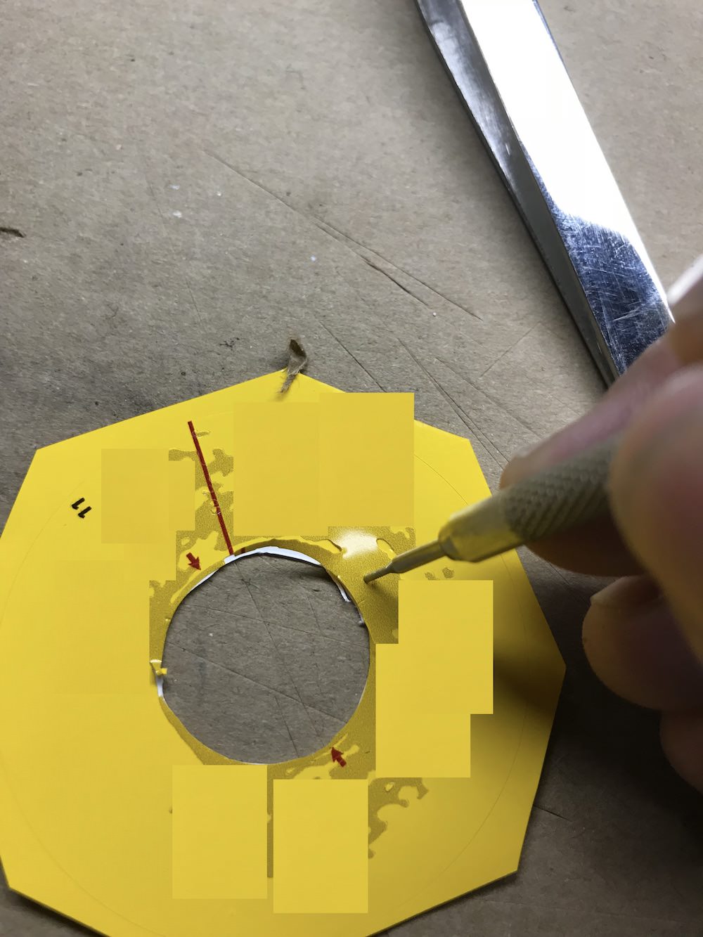

    thats right gang, here comes the emitter!! Number 11 first! this is probably the most critical part because we want this to all be alined when done, so we want to double check EVERYTHING!! so Trent told me a SUPER easy way on applying this stencil.. but we have to follow this to the T.
    we get the number 11 stencils, rough cut it, and weed it... this weed is probably the worst. TAKE YOUR TIME! seriously what the hell is the rush?! if it doesnt get done today, whats the big deal. relax... calm down. breath.. just breath.... reach out... tell me what you weed!?
    One more important thing!!
    again if you have dented your emitter, and used my emitter template, BE SURE to have the large dent in this location!! (5 famous dents, only 1 is real deep, and this is the one ) its easier to notch the nipple plug.. and install it 180 with the set screws like the picture below. notching the nipple plug, also will make lining up the stencil much easier in the future.
    again this is a beautiful stencil, but i edited it to fight against those copycats
    all weeded
    now heres the Trent trick... we are going to cut the red line, cut right down it, this will make it so much easier applying it over the nipple.... you know me, dont want to aggravate that nipple when applying this stencil...
    here is part 2 of the Trent trick, see my blue tape? i have 2 pieces, it makes it less stressful on all those little islands using this 2 piece tape trick. when removing its so much easier.
    You need to line the arrow up with the screw in the nipple... oh boy here we go again... Since Trent supplied 2 of the same exact emitter stencils for the FX plate. Use the extra emitter stencil (stencil 11) to locate the red arrow, and line that up with the nipple screw
    this is also a tricky part to the emitter, but take your time and it will work out..
    we cut the red line on the stencil, this red line in the picture above shows what 2 parts of the stencil need to line back up when applying. so when we are peeling the blue tape back, we are going to go EXTRA slow... and i mean geriatrics slow!! when we get to the red line part we need to make sure they match perfectly
    WHAM BAM! SHA LA LA LA!
    im telling you guys, this isn't overwhelming. and this isn't impossible... when i first saw the emitter i said no way in hell am i going to get these islands to stay... with patience, and time, look theres the proof. you can do this too!
    so now that 11 is done we do #10!
    we are working backwards now, so we will line up 10 with the red line on 11. 10 only has 1 red line, so dont think your missing anything
    and then number 9 and 8, these are fairly easy. just be sure to line up those red lines!!
    thats it! congratulations!! you have successfully completed Trooper Trents Generation 2 Stencil kit!! beautiful aren't they! special shout out to Trent for helping the community out on this one! with out him this wouldn't have happened, and i am eternally grateful! thanks buddy!!
    High rez link
    TRENT'S TIPS AND TRICK VIDEO!!
    This is a must watch!!
