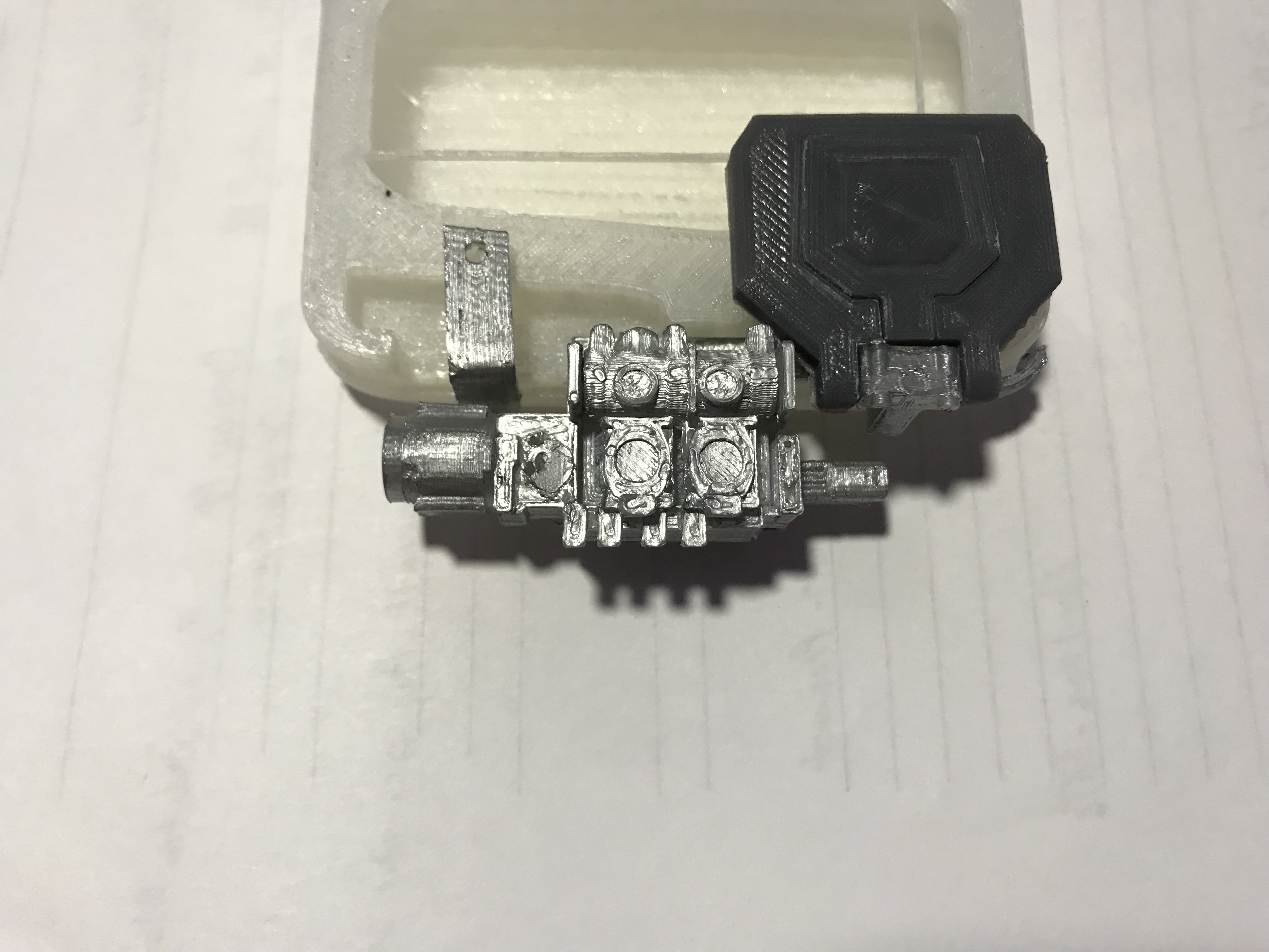

I decided to work on the electronics of the pager instead of coding. I wanted to make sure they would fit inside the model I had made. I left enough room between the screen and the inside of the model to fit the buttons in.
I need to make the model just a little bigger to fit the teensy. If I buy another teensy I think I'll leave a few parts out to make it slimmer. I also plan on taking the SD card reader off the TFT to make more room since it's not needed. The white block in the picture is to fill in space where I plan on putting the battery.
