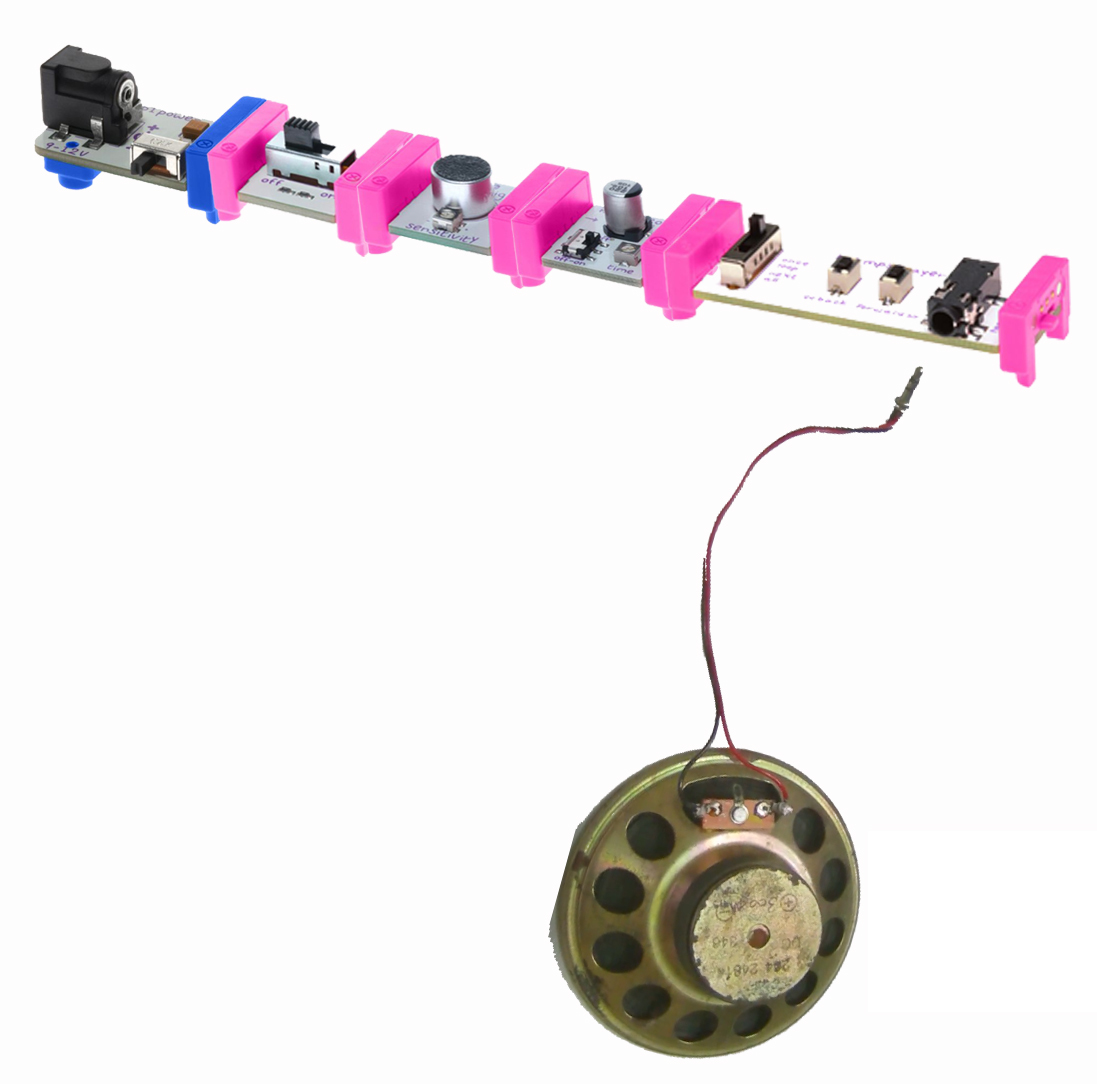

This is how it would look with the LittleBits approach :
You only need to find a speaker with 3.5mm jack, haven't found that yet, but you can make it yourself I have seen.
So from left to right, you have
- the power bit (where you attach a 9v battery to ),
- a slide switch bit ( you could do without it, it's optional to turn the power on/off ),
- the sound trigger bit,
- the timeout bit (for setting a timer, for a time delay, allthough in theory it's possible to do it without that bit, requires editing your sound files to start with a silence or so ),
- The mp3 player bit,
- external speaker with 3.5mm jack
So all this, including the 9v + power cable (not pictured)
costs about 114 euro's total. From the website that I've found it. For example the Mp3 player bit costs 59,99 euro which is the most expensive part of this setup.
You can use whatever works, and you are comfortable with..
I myself, just prefer not to overspend.
This could all be done for under very little money.. (especially if not going the VR route)

I'm probably going with the Littlebits idea, but that's going to be bigger in size than the sound module.
But with the Littlebits I'll have a sound sensor, timeout (time delay), mp3 player and speaker.
And I can set the timeout bit in on/off mode, so that the sound sensor can't trigger the timeout bit again because as long as the timeout bit send a signal it can't be triggered again by the sound sensor. So for example to have a time delay of 5 seconds I will need to edit my sound files to begin with 5 seconds of silence, then if my longest sound file is 6 seconds, I'll set the timeout bit to 11 seconds, so it stays active for 11 seconds and can't be triggered by the sound sensor. That's the only way it can work, that is if you want a delay, which we do want.
