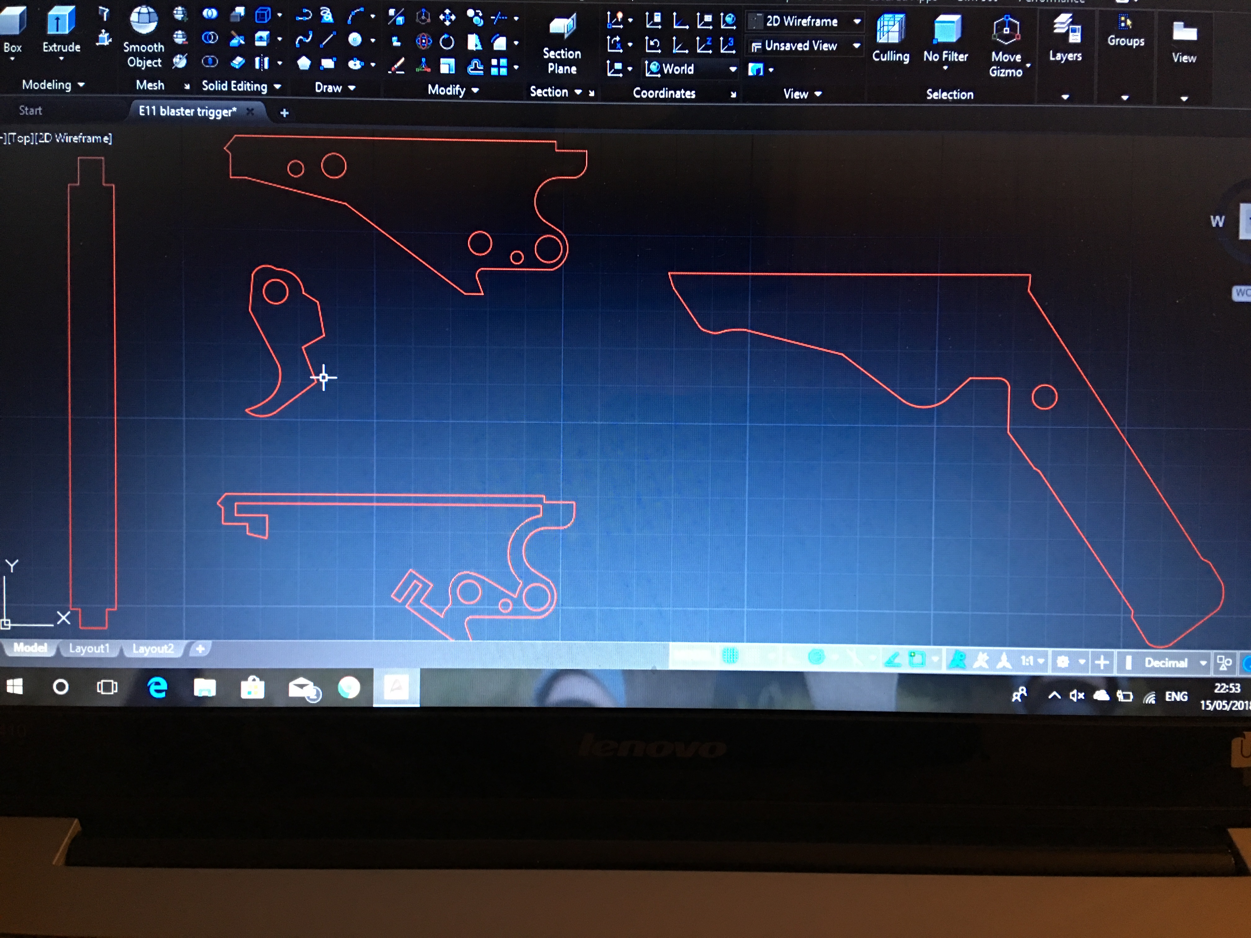

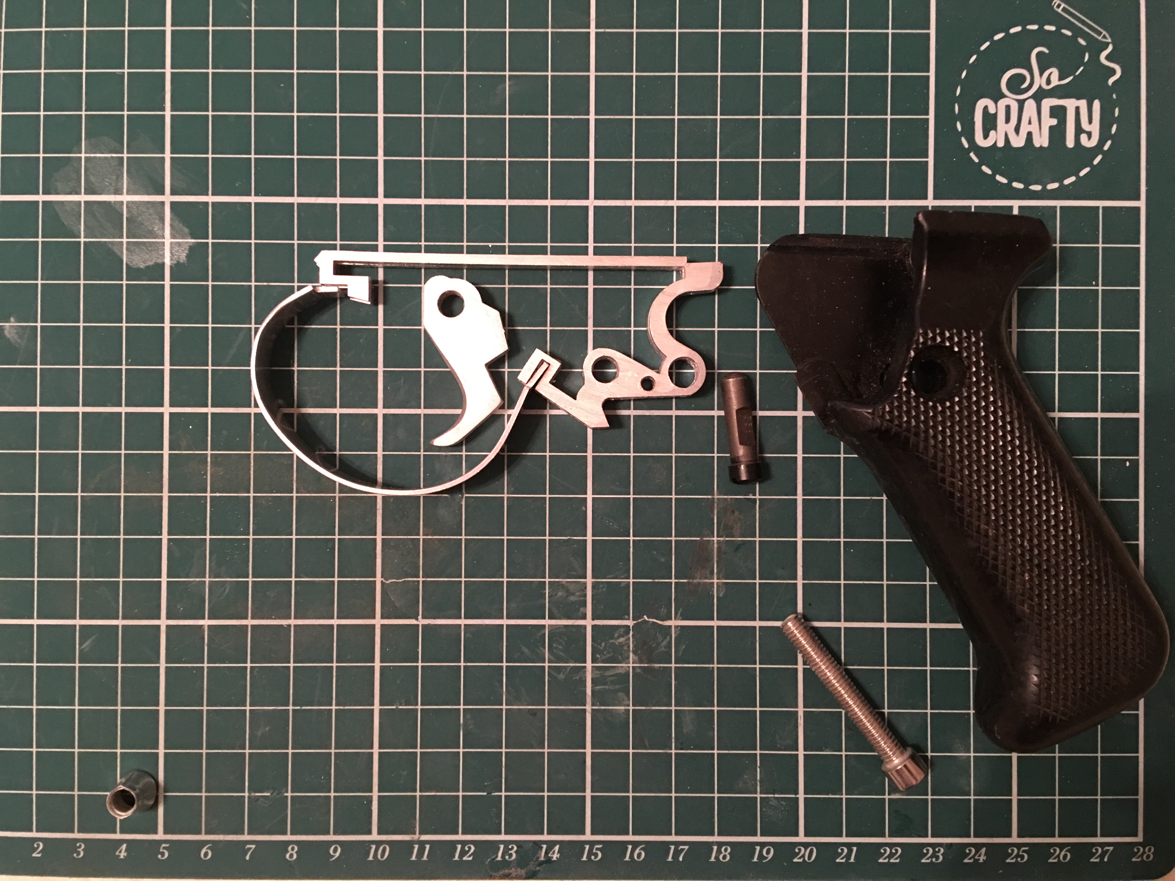

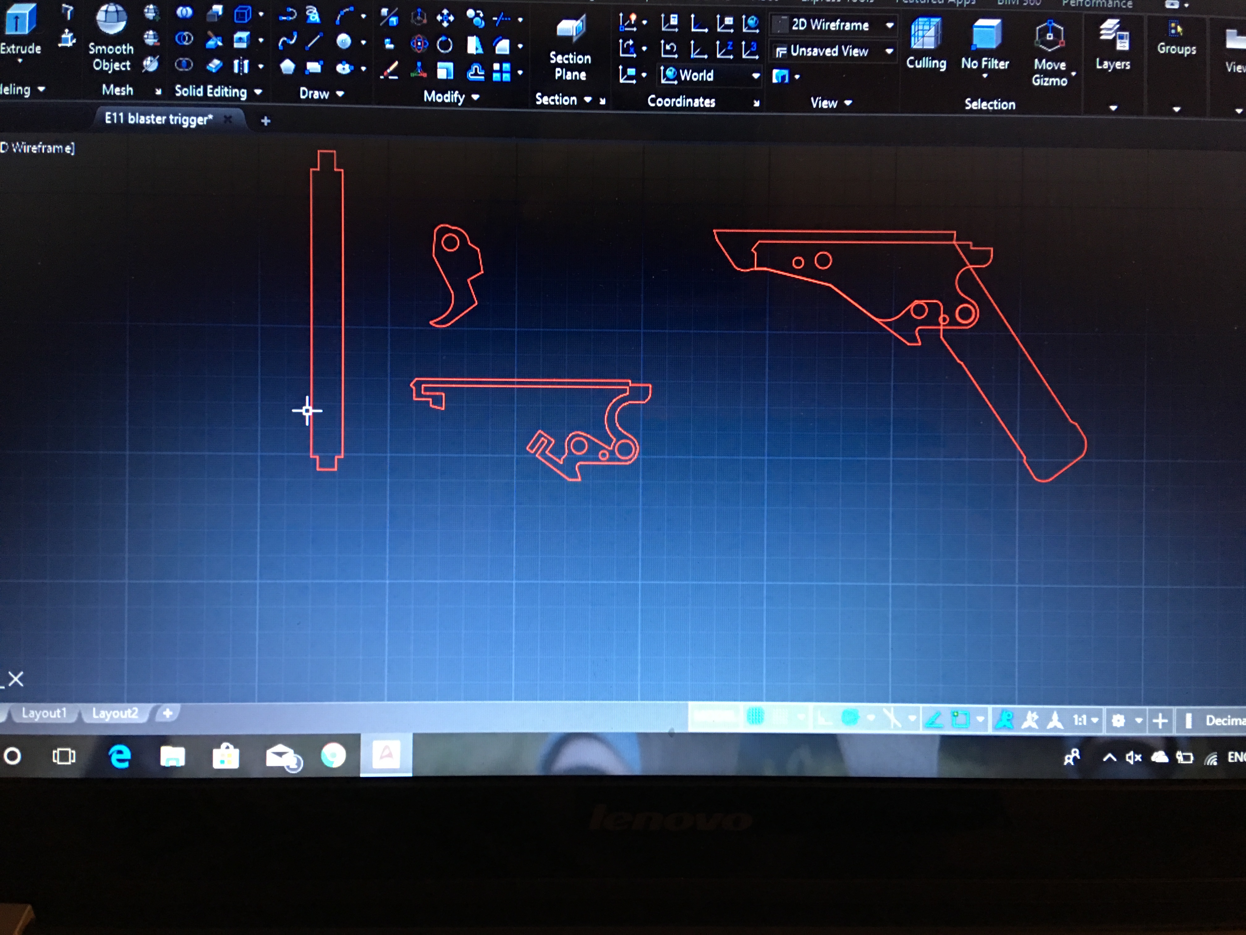

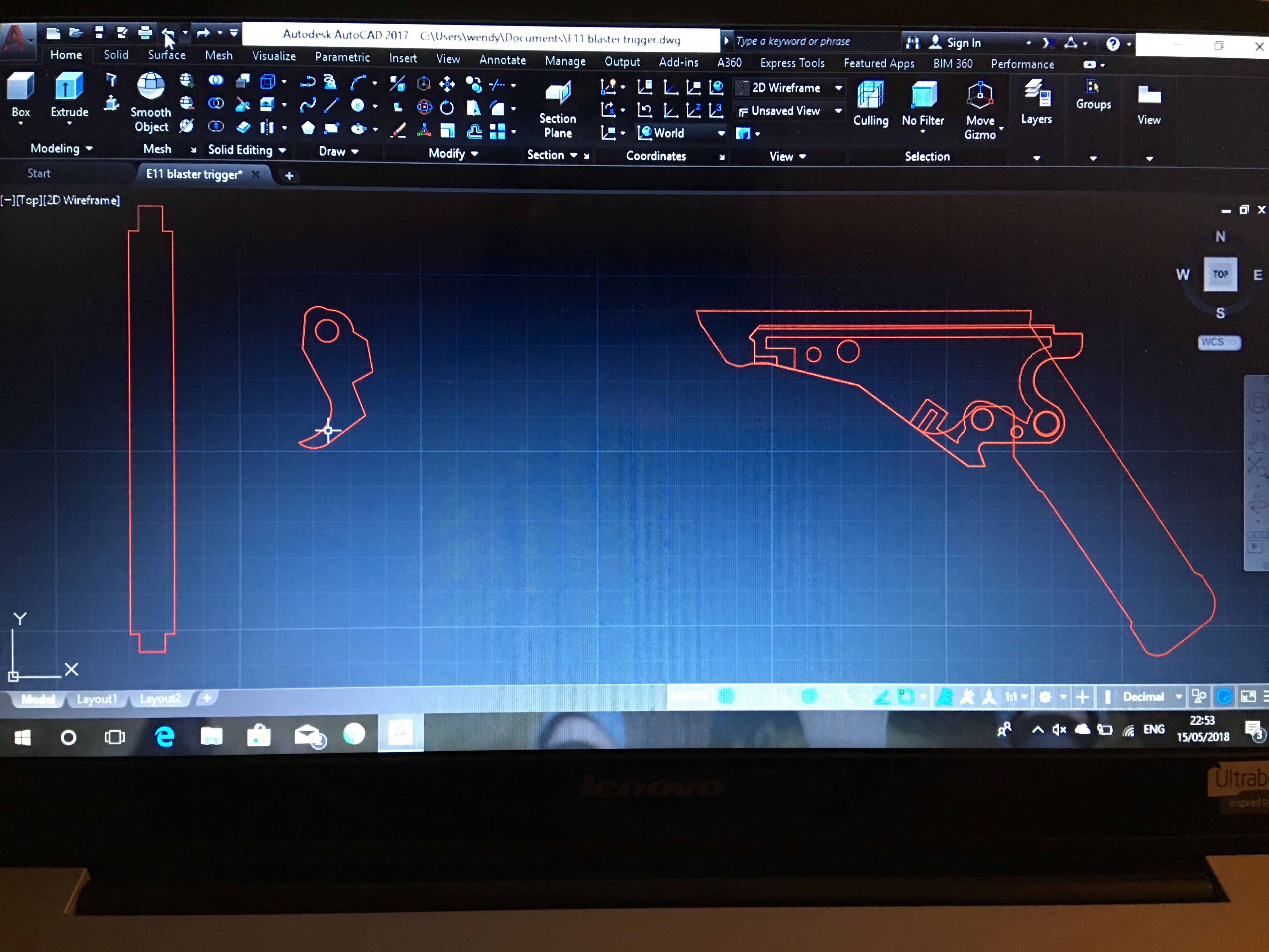

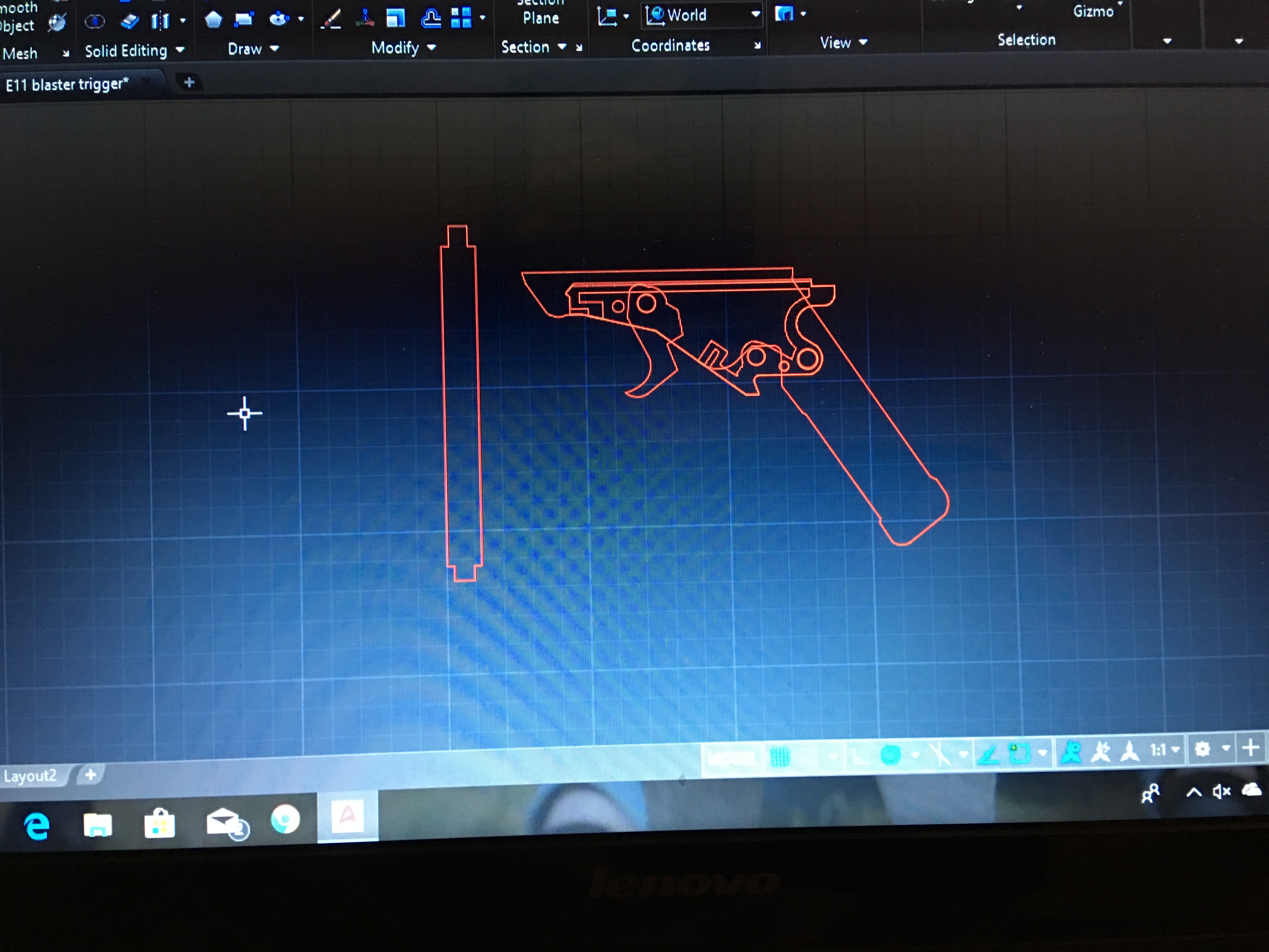

I’ve been drawing up on autocad the grip and trigger section it will be a few days before I get these back from cutting and for test fitting

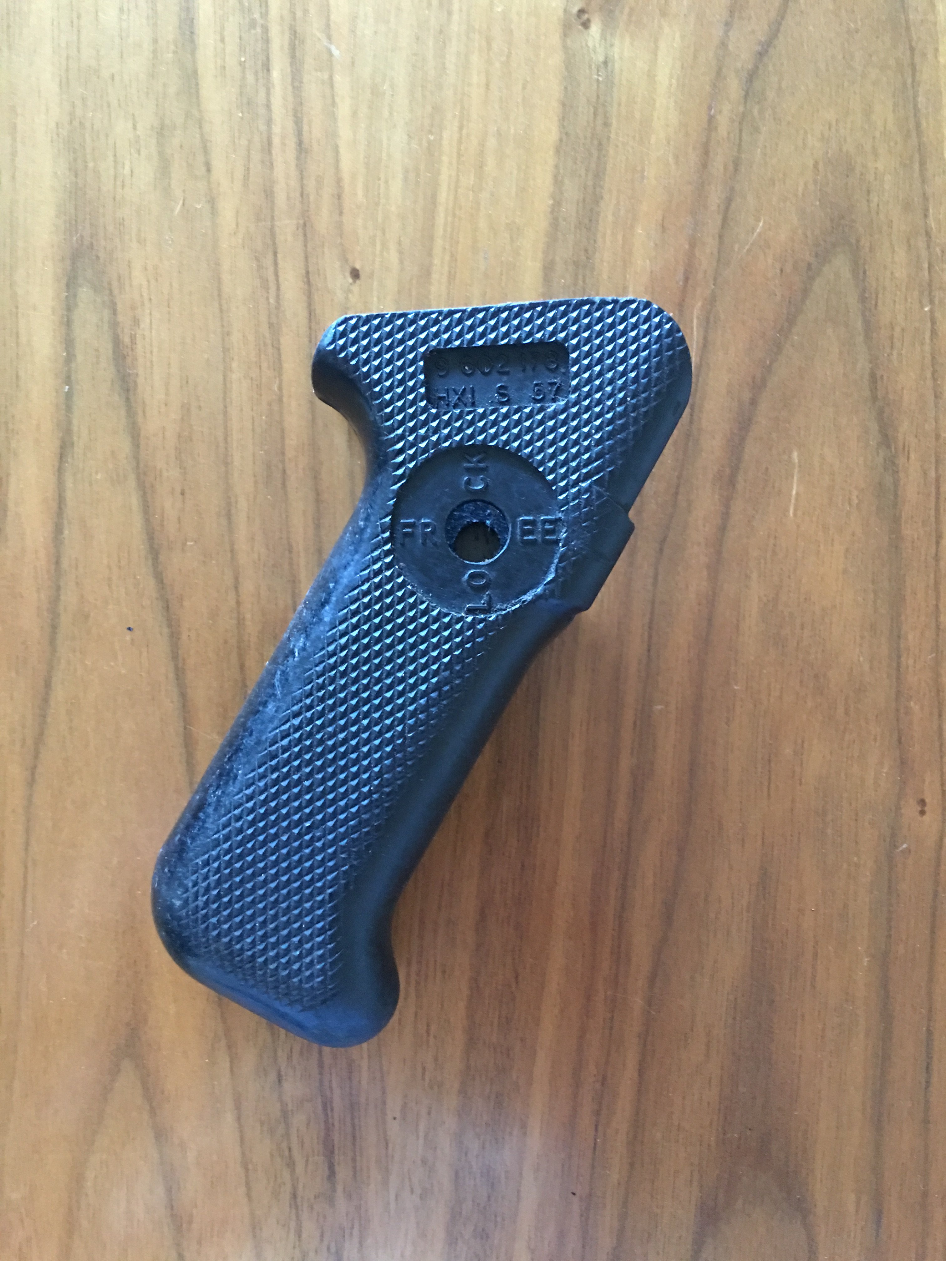

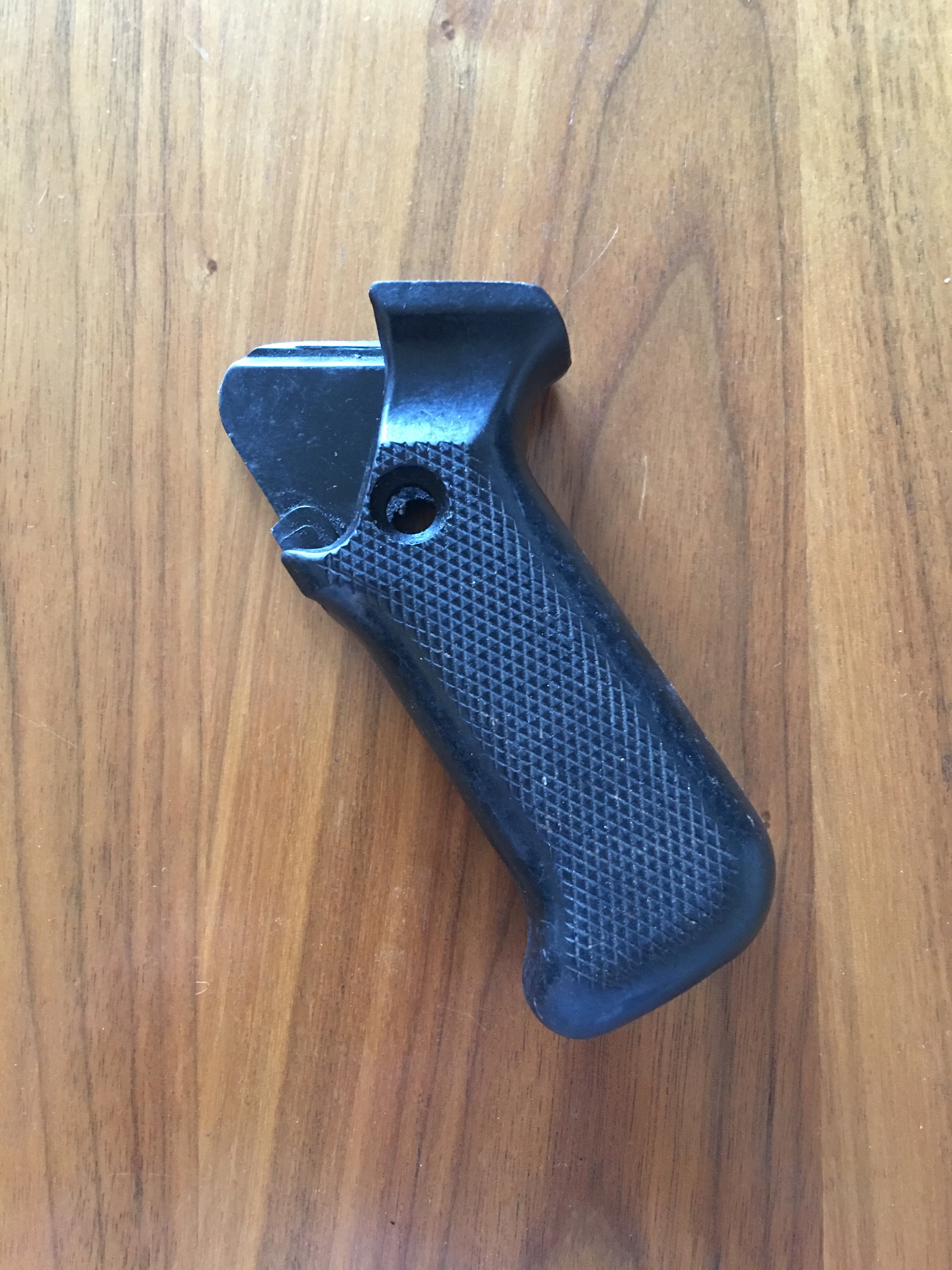

my original sterling grip has arrived, can’t say the same for my metal parts I’m having cut

ive received some metal bits back for my trigger and grip section, very disappointed as I didn’t get everything I needed to do some major work on this, I’m going to have a functional trigger, I’m going to add a switch and spring when I put this together, later down the line I’m going to add a blaster sound card and a LED in the barrel

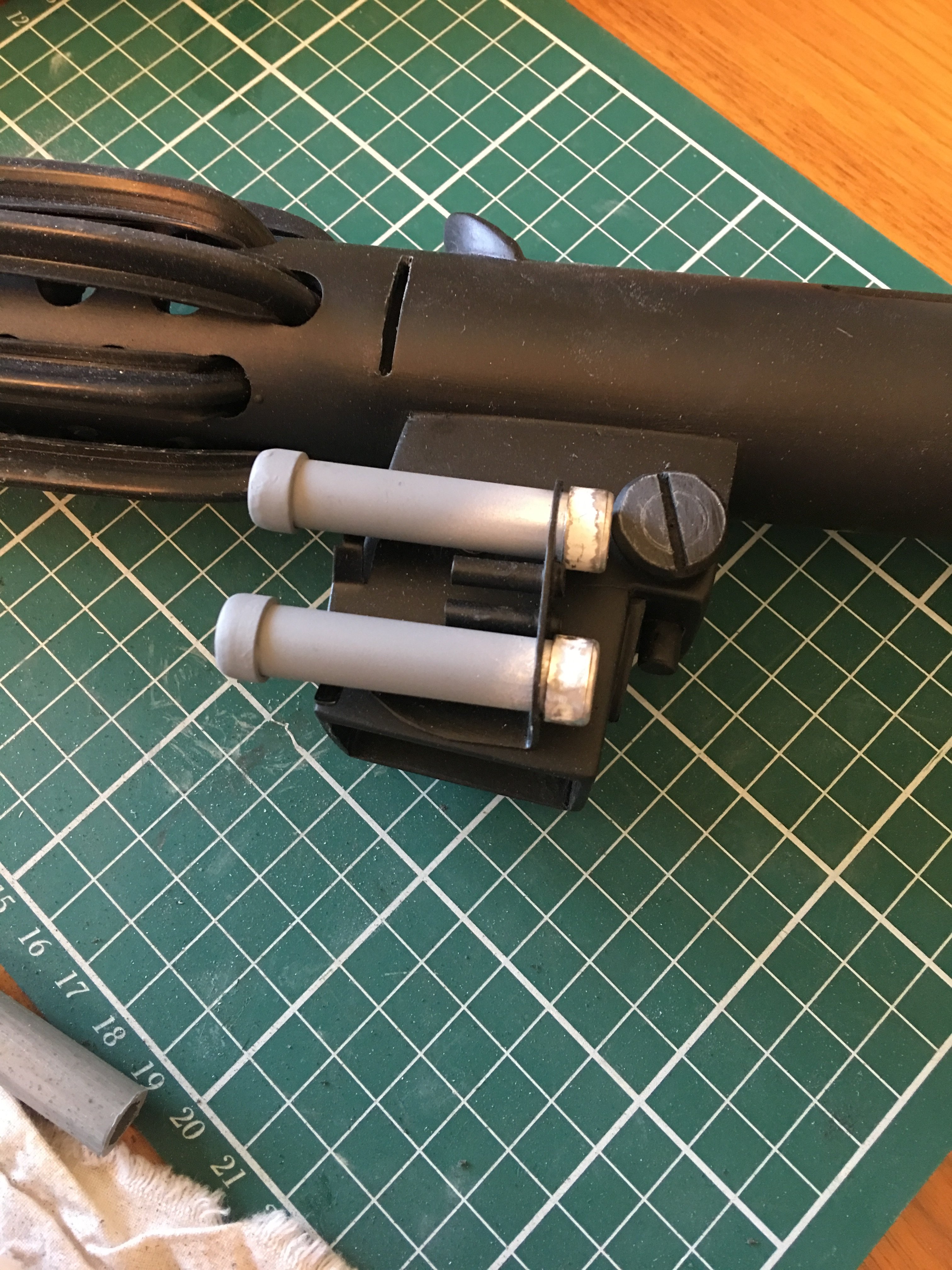

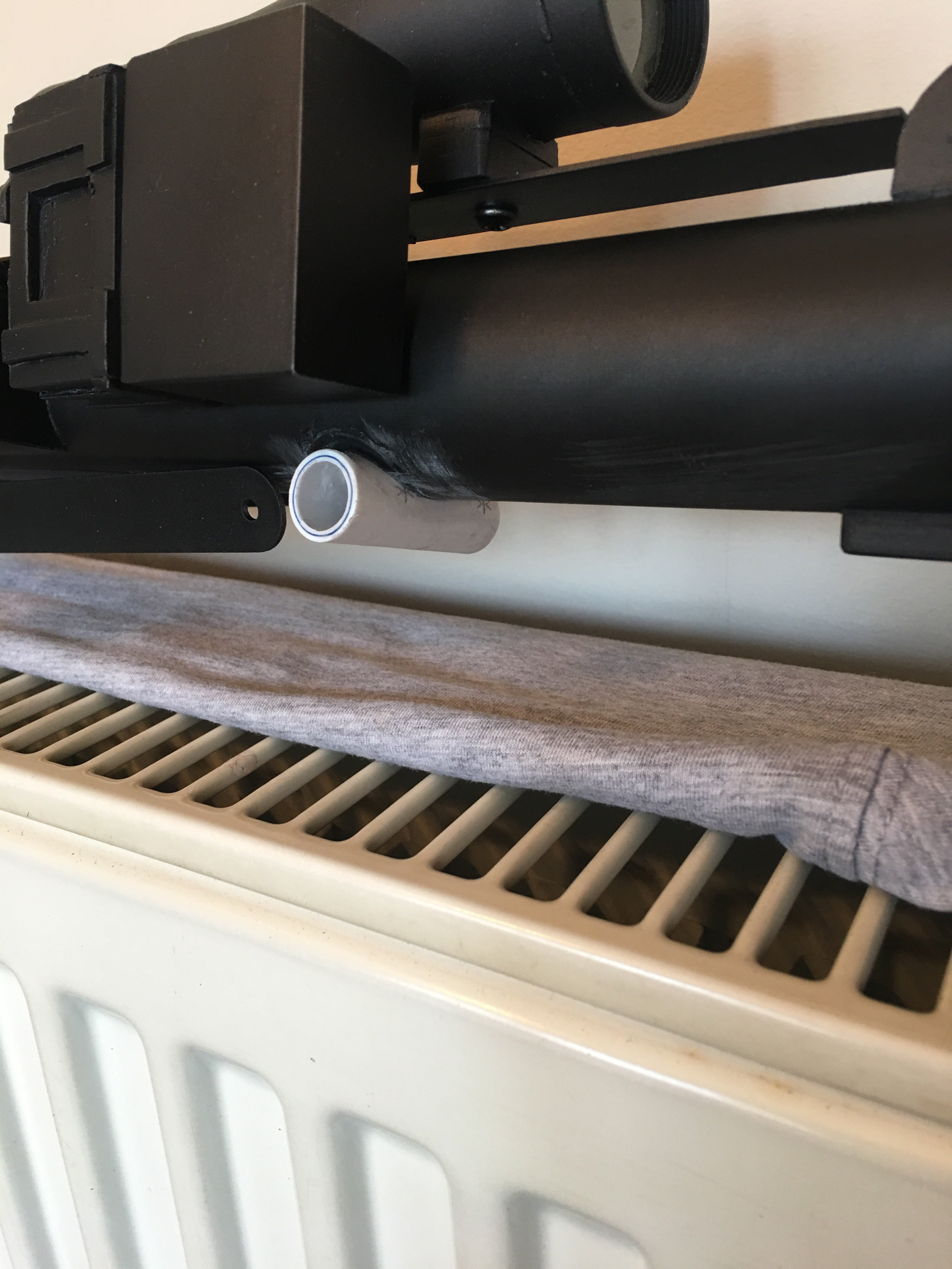

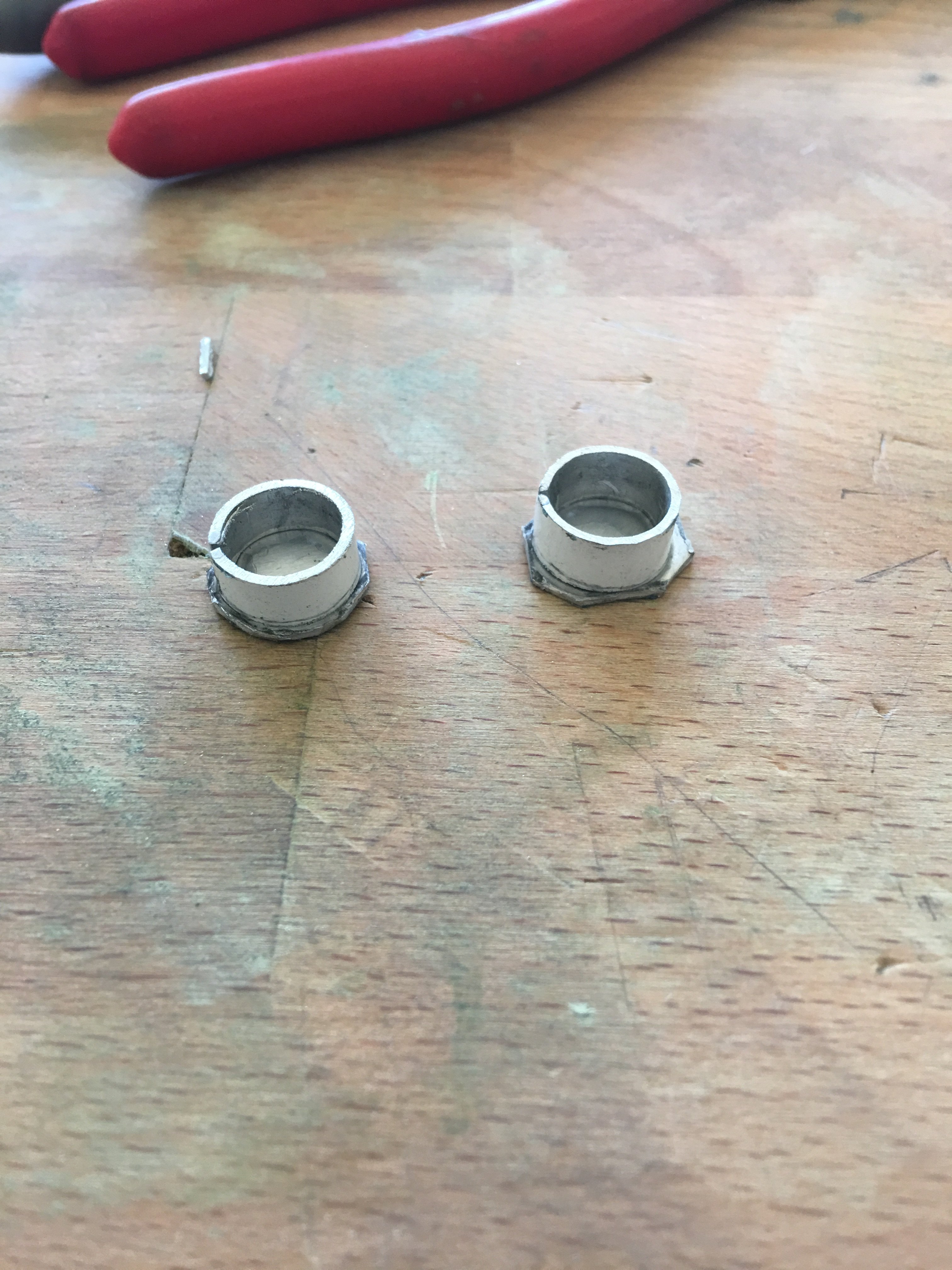

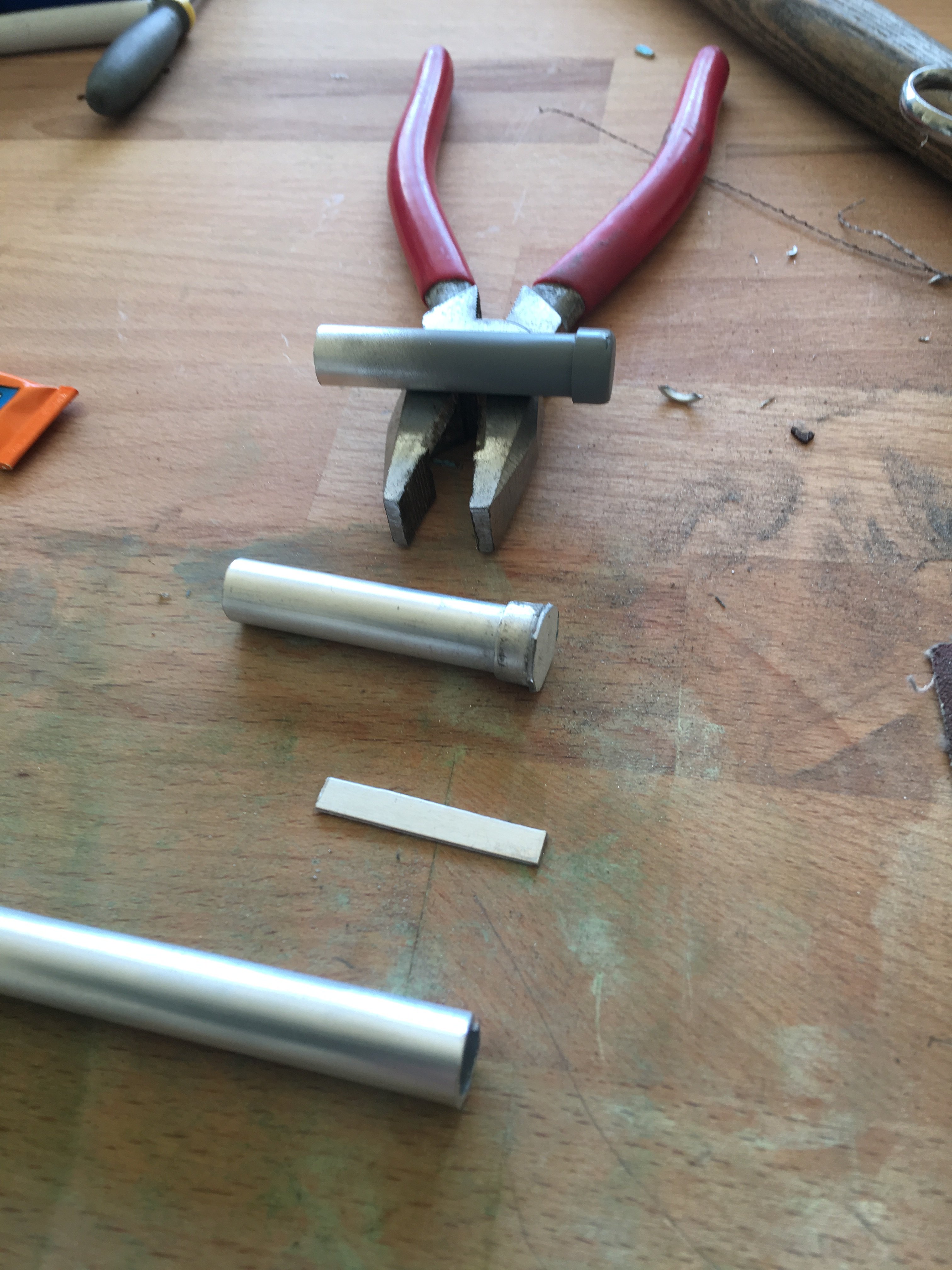

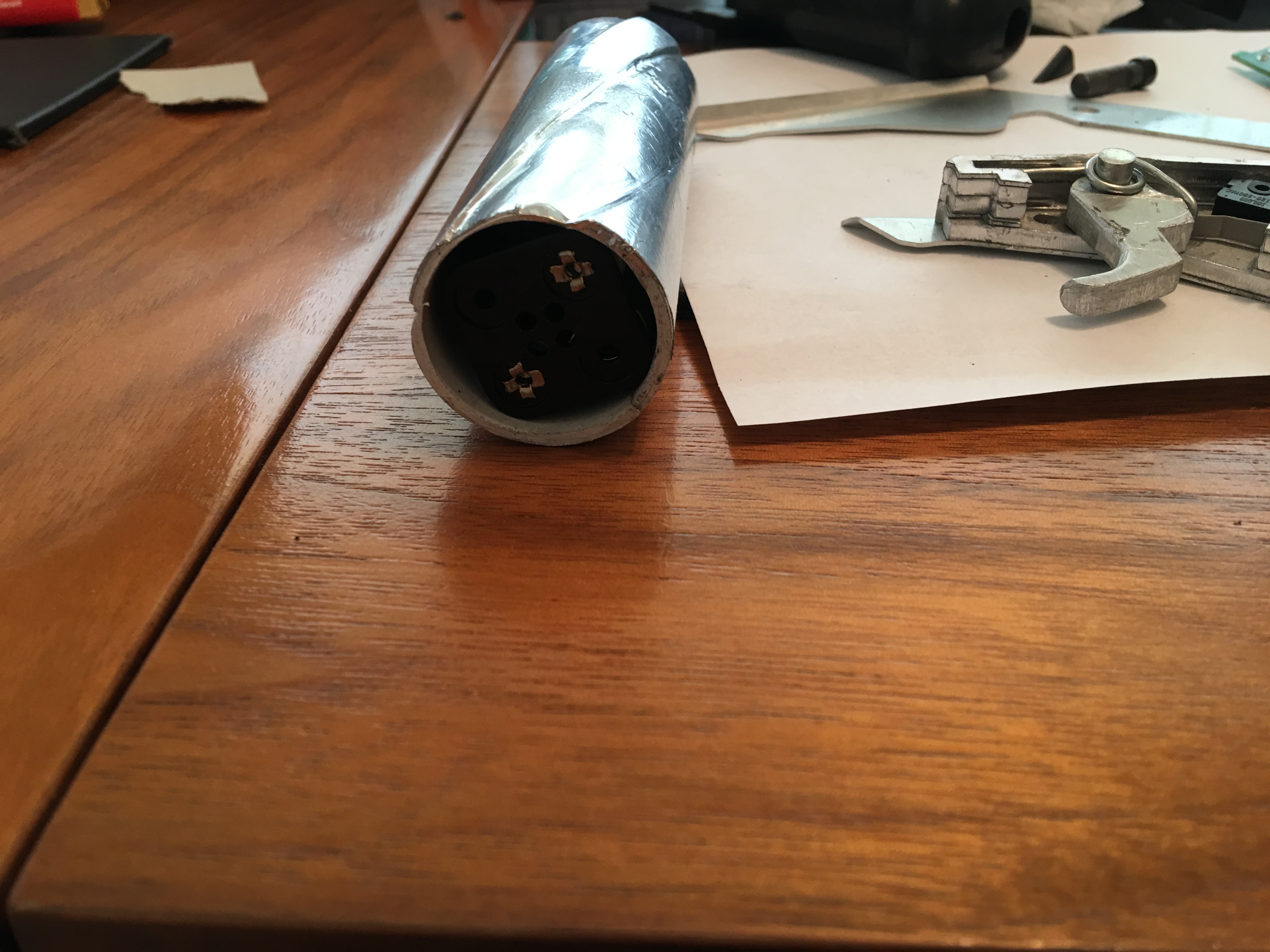

I’ve cut some 10mm ally tube to size and made some end caps, I then filed the end caps to shape
E8AC8B0E-6A45-4FEB-9677-ACAF27D62C8C.jpegBDF0B4C5-C1DA-4E66-8CD0-31EEDBA7CA2C.jpegA7E68E18-9D57-4E93-B51B-F36361655792.jpegCC35869D-C745-4471-9150-B4DDA684E10B.jpeg
When I was happy with the end caps I drilled a 3mm hole in both ends and inserted a piece of 3mm ally tube through the centre, I then primed, painted and fit them to the cylinder holder

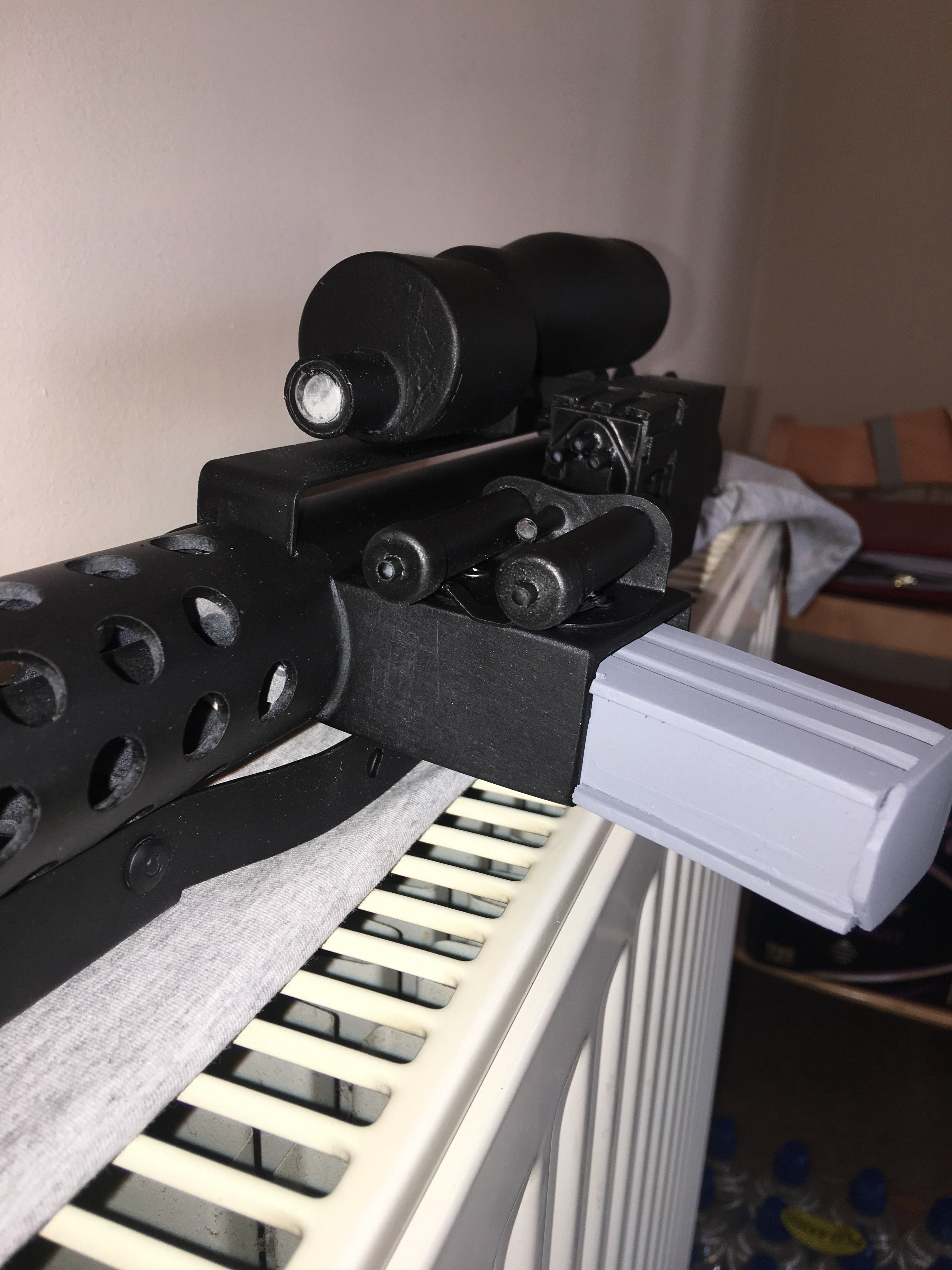

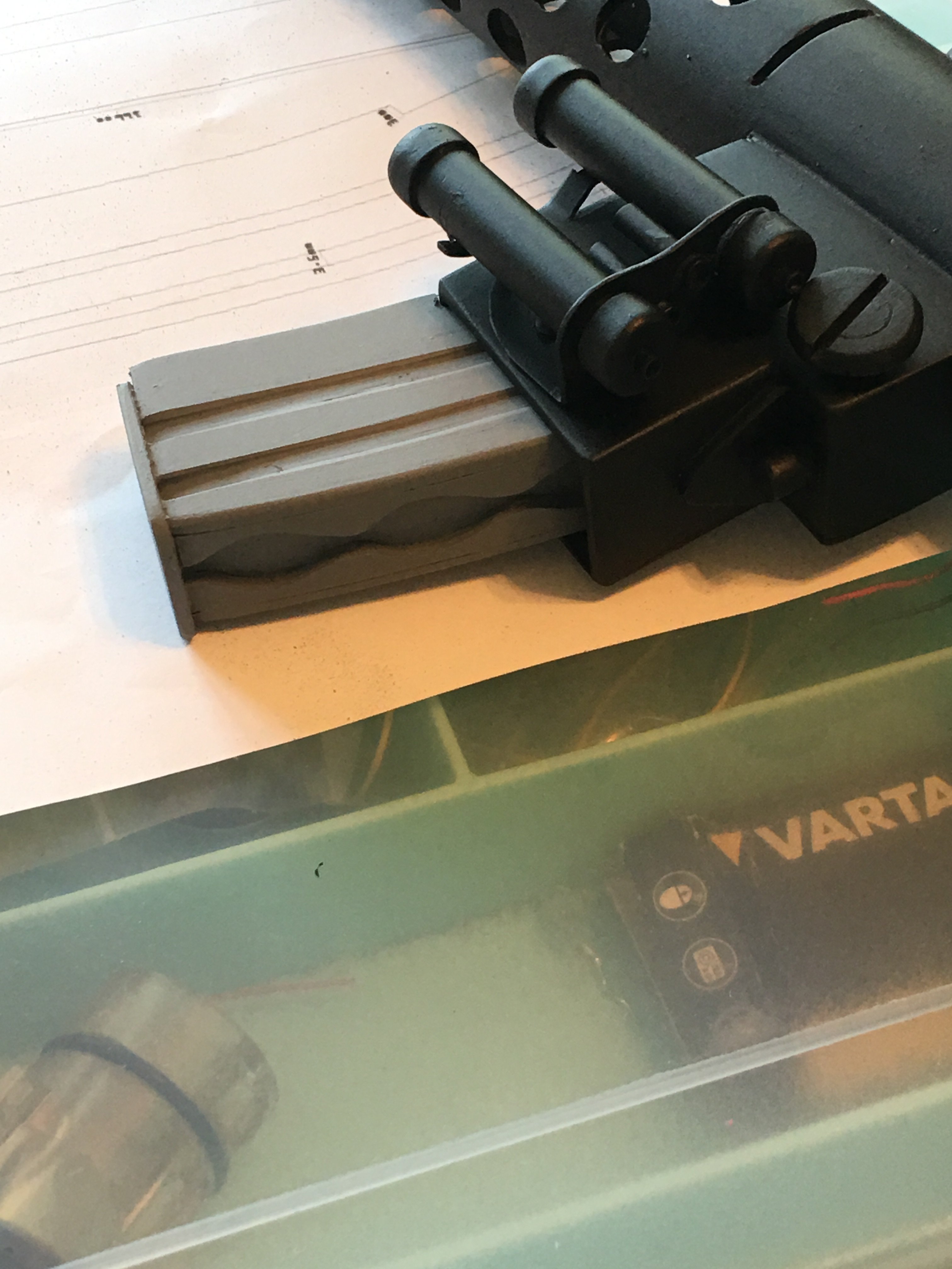

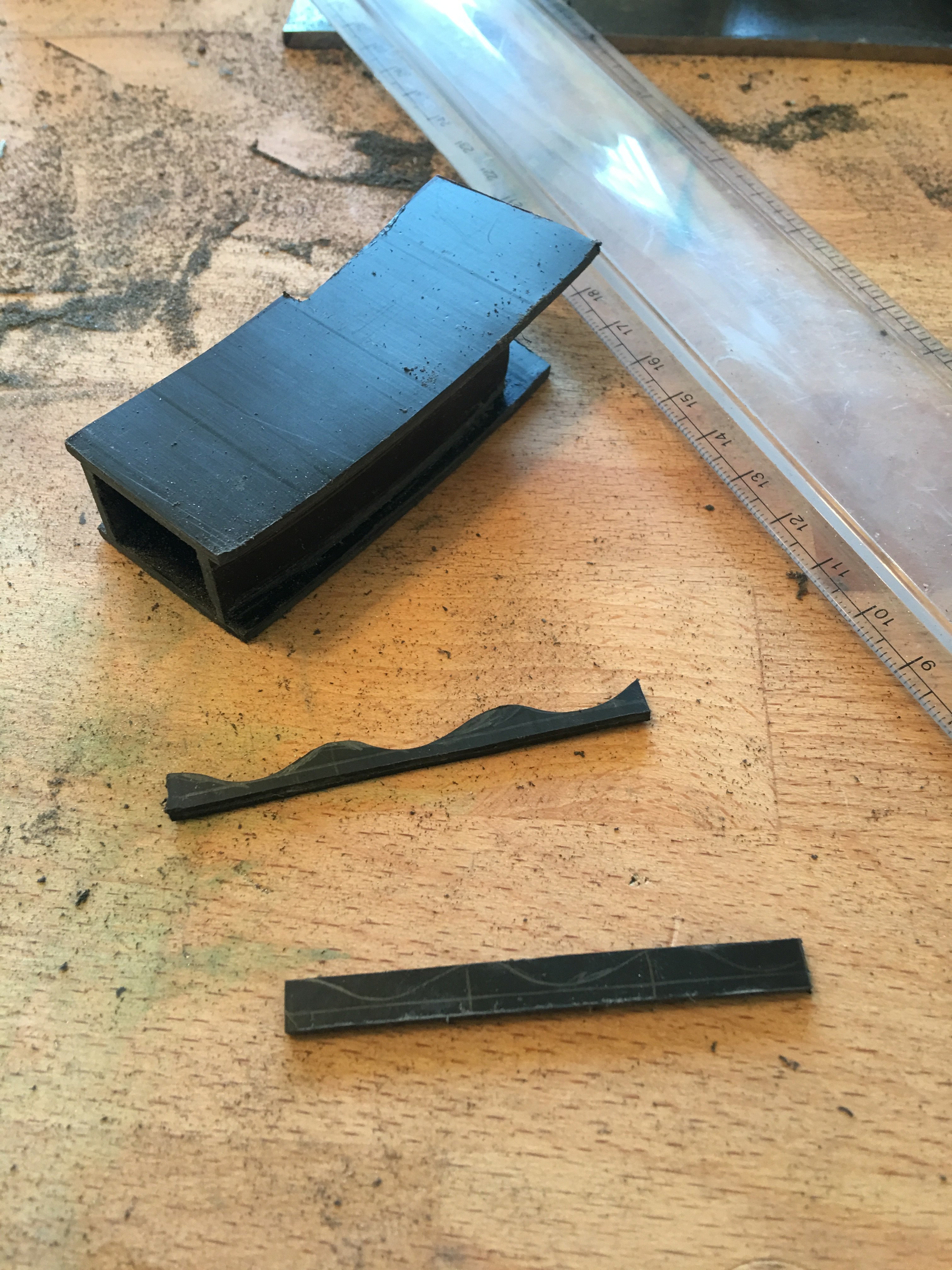

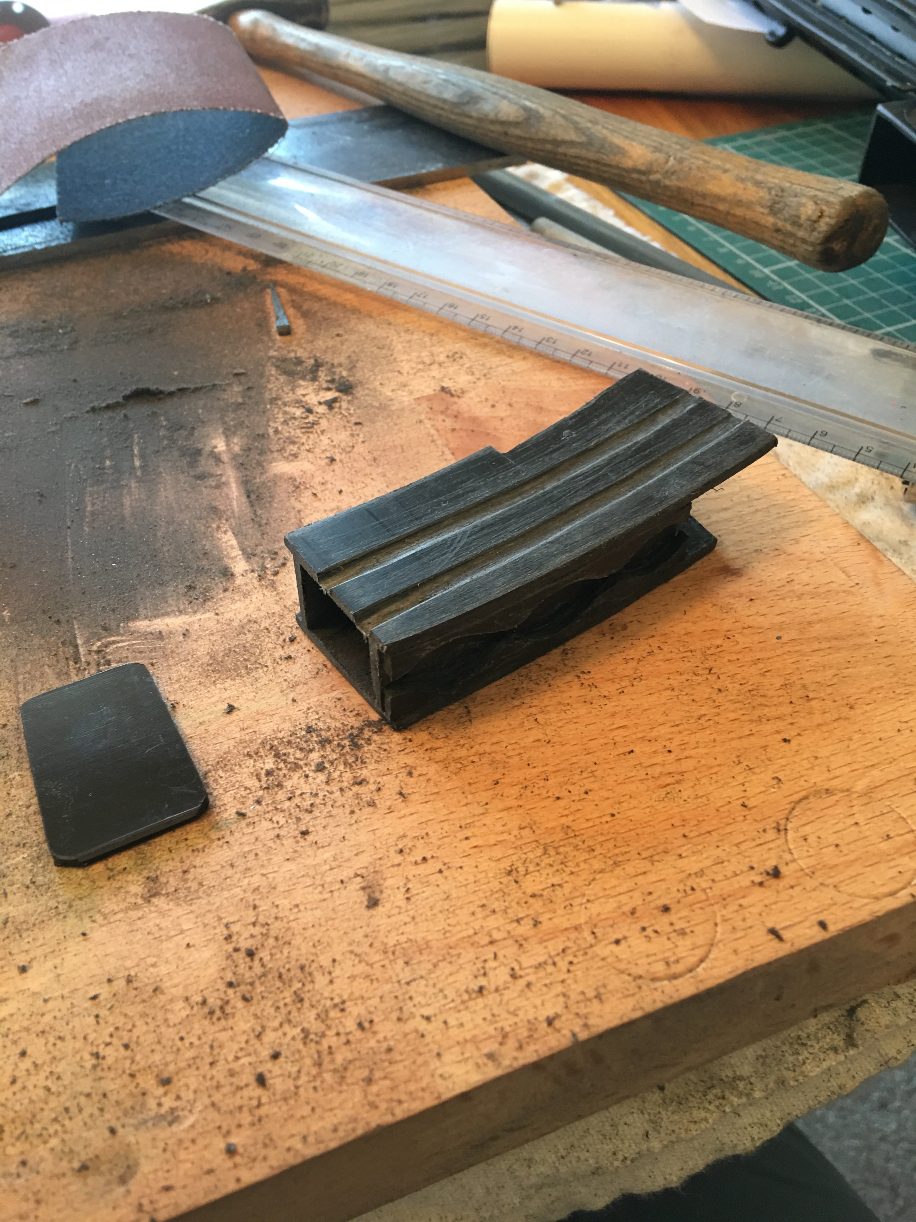

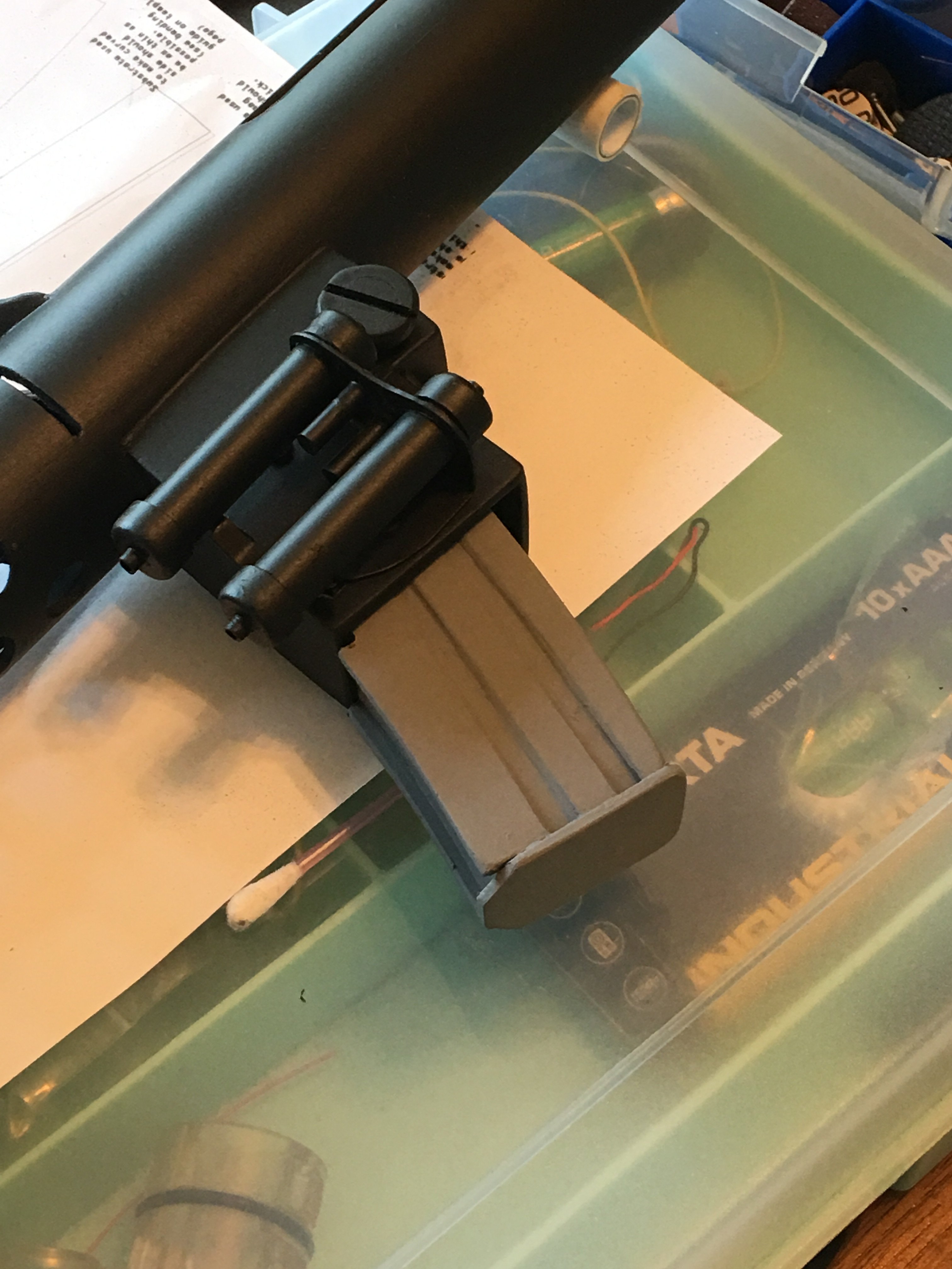

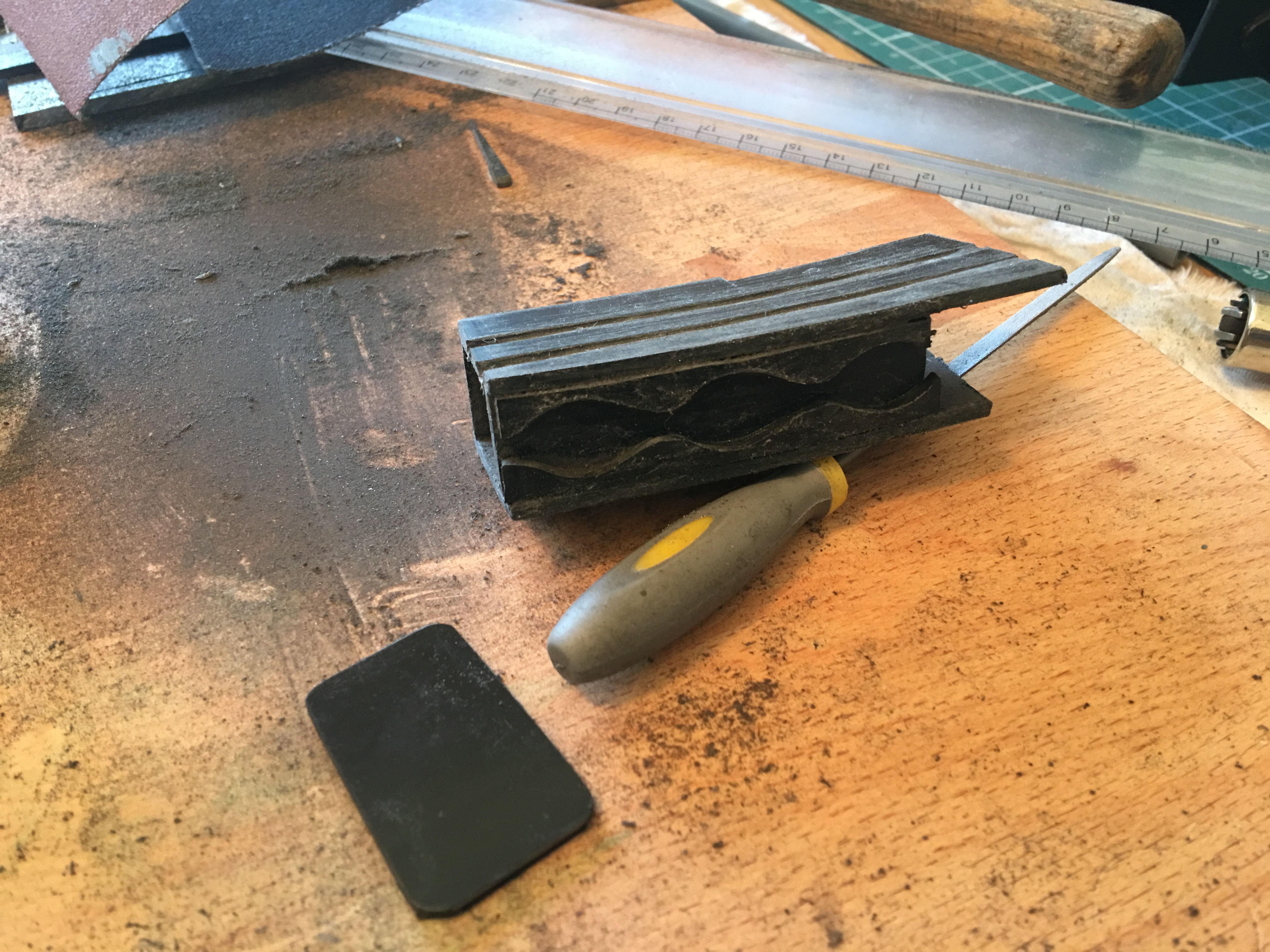

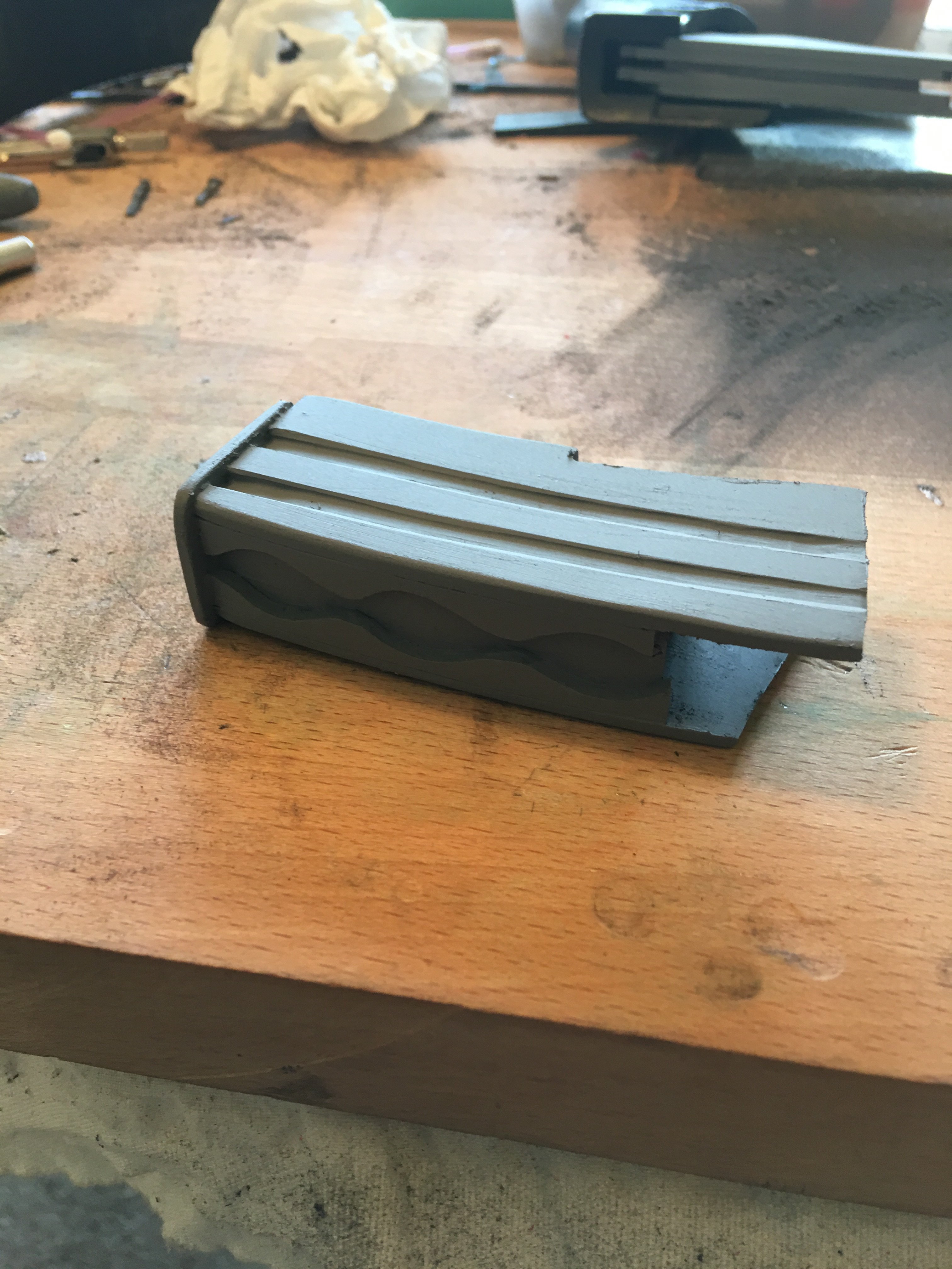

I cut some some plastic pieces for the magazine that I downloaded, I glued them together and dremmeled out the 2 groove’s in the top of the magazine
292B6119-C89E-4E79-8C22-17C9788BC659.jpegD28019CD-262C-40D9-8A5B-A08ABE8F8F23.jpeg0C818ED2-0BF7-43B2-8D23-AD28AD7C3DC5.jpeg
I then primed the magazine to see how it looks, still a little more sanding and filling to do as well as the clip to build

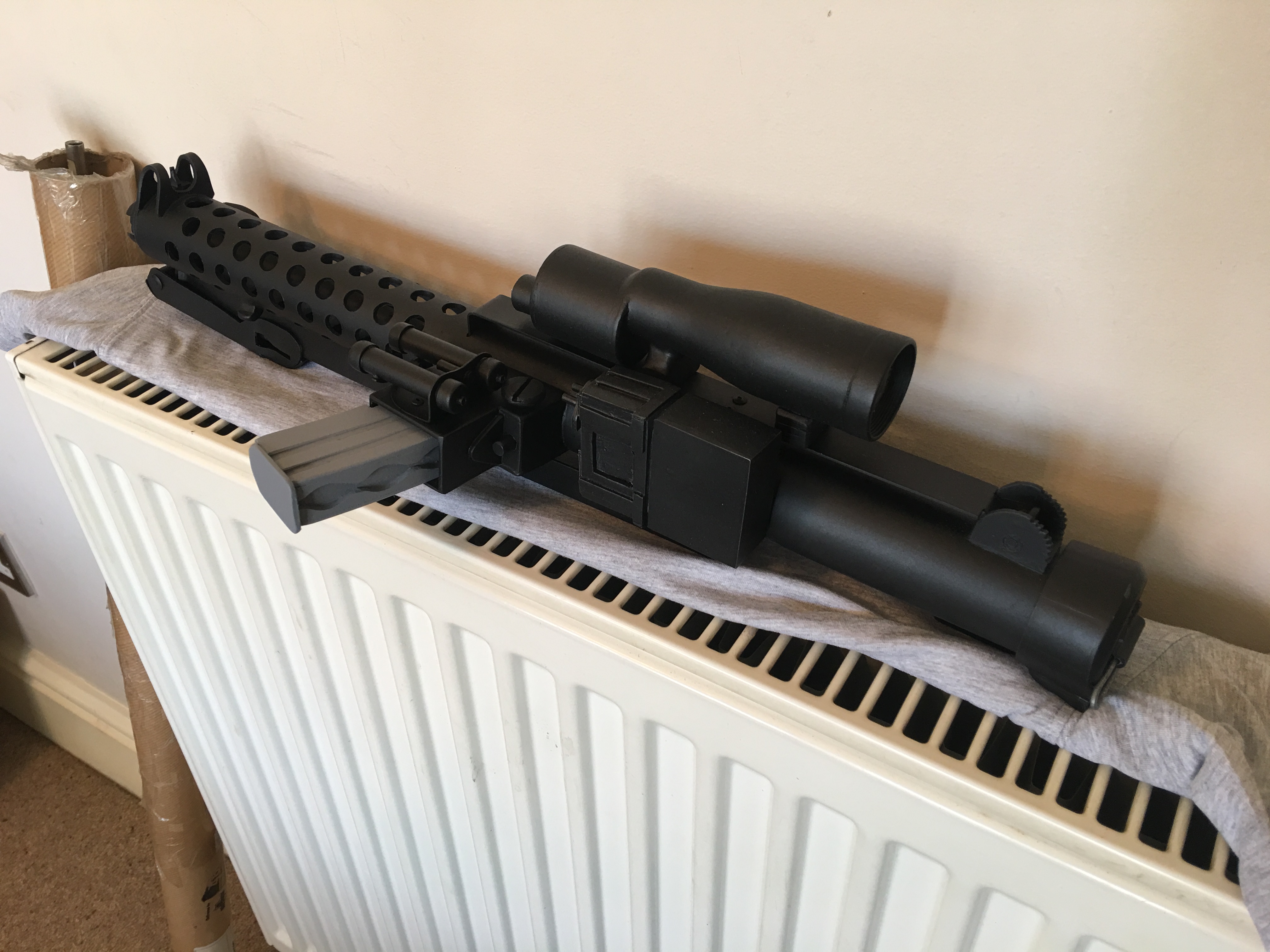

This is where I’m at

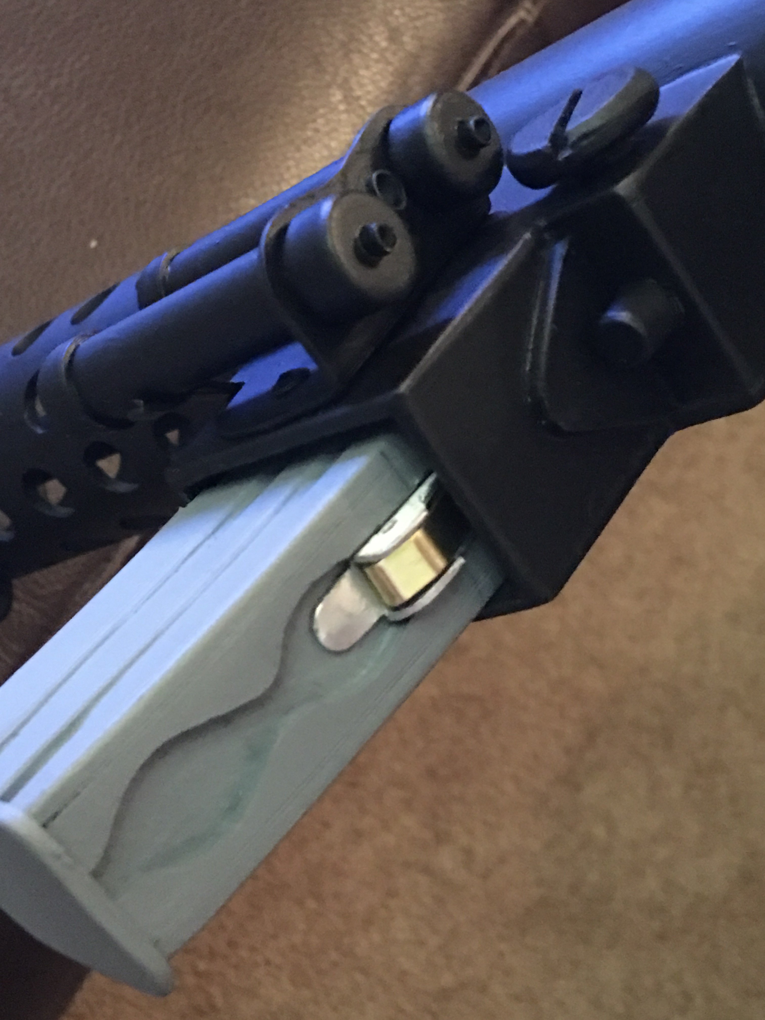

while watching the TV I thought I would make the little clip on the side of the magazine
A little refinement still to do on the magazine, then I will prime and paint it

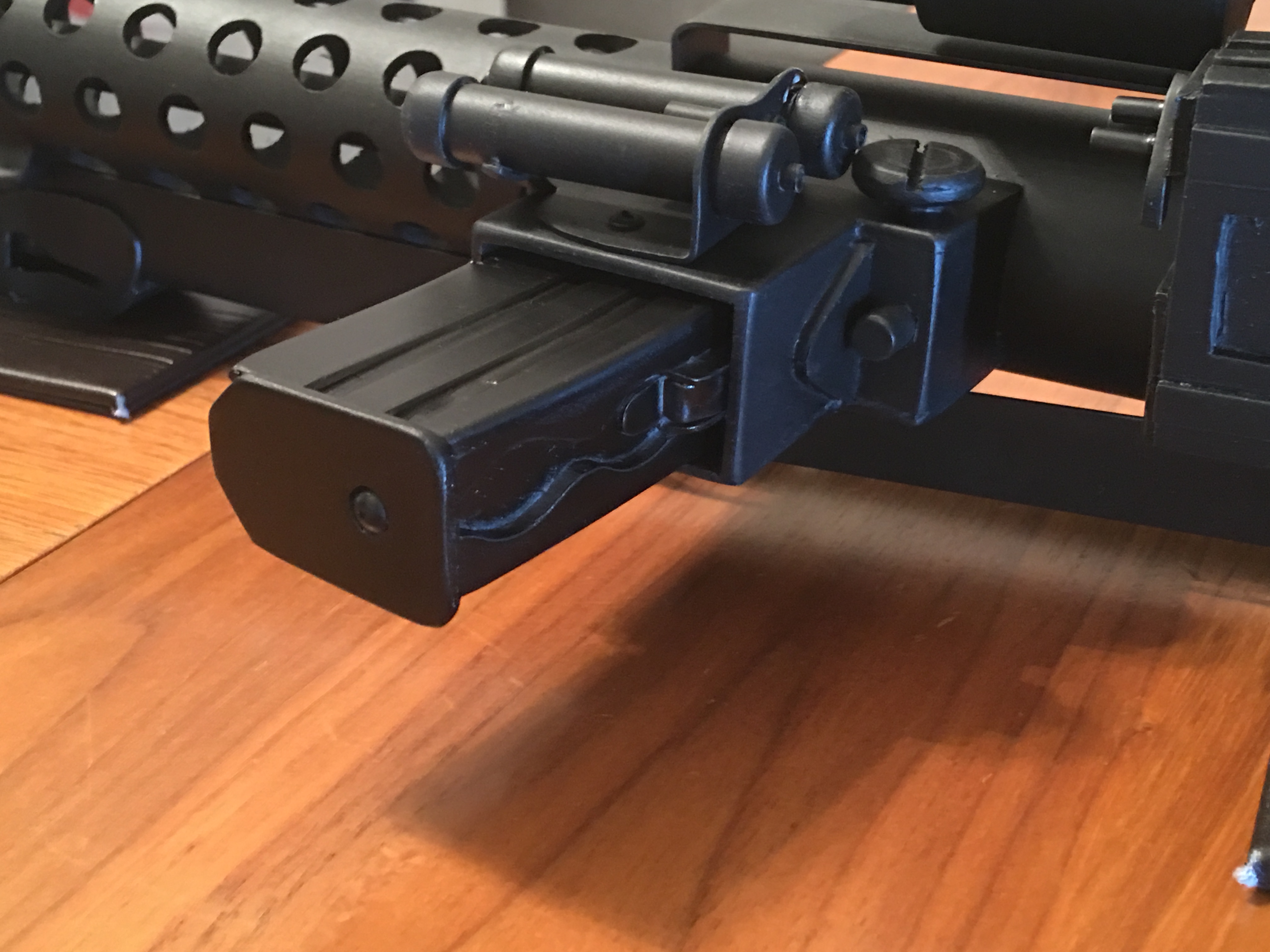

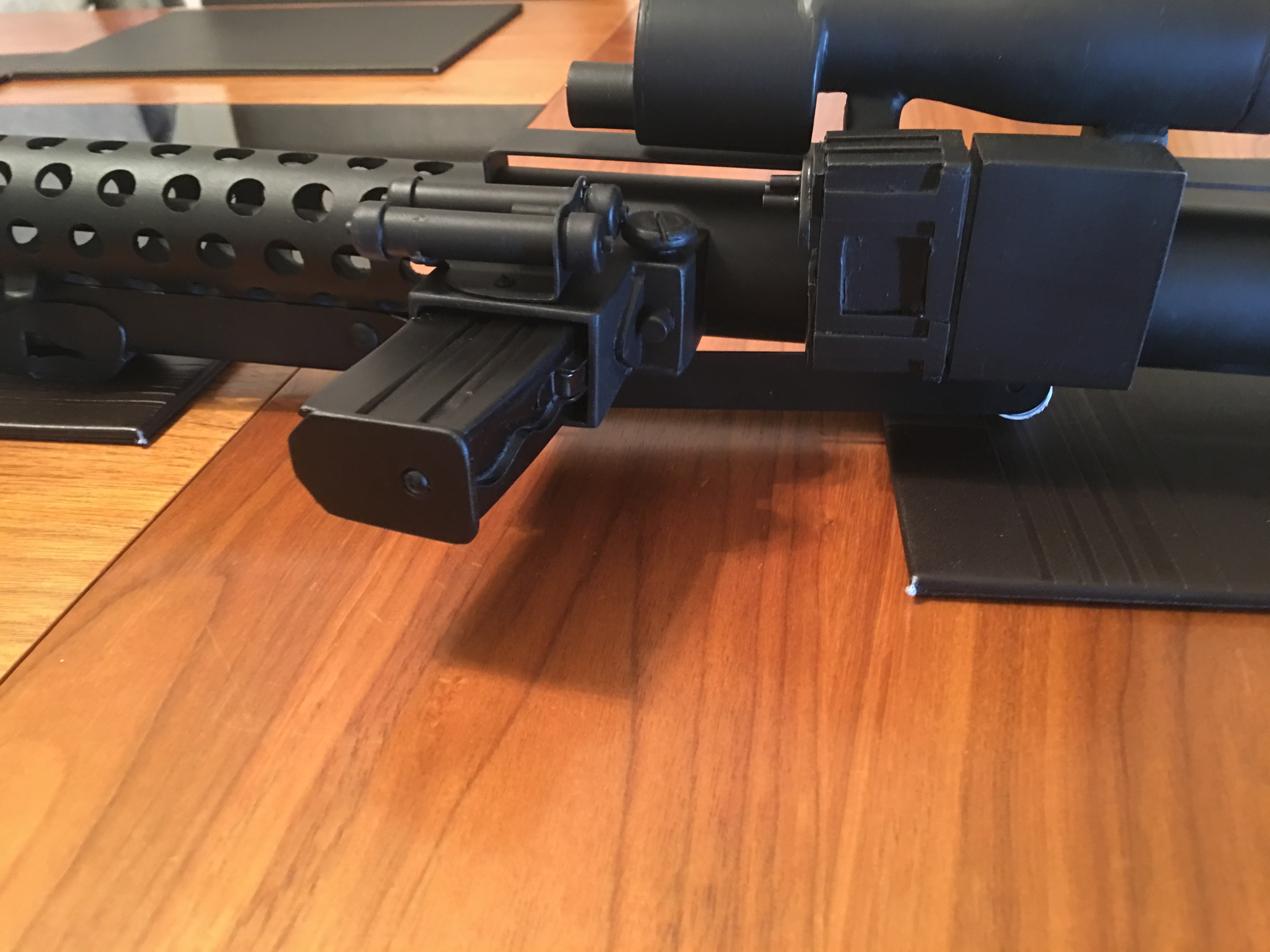

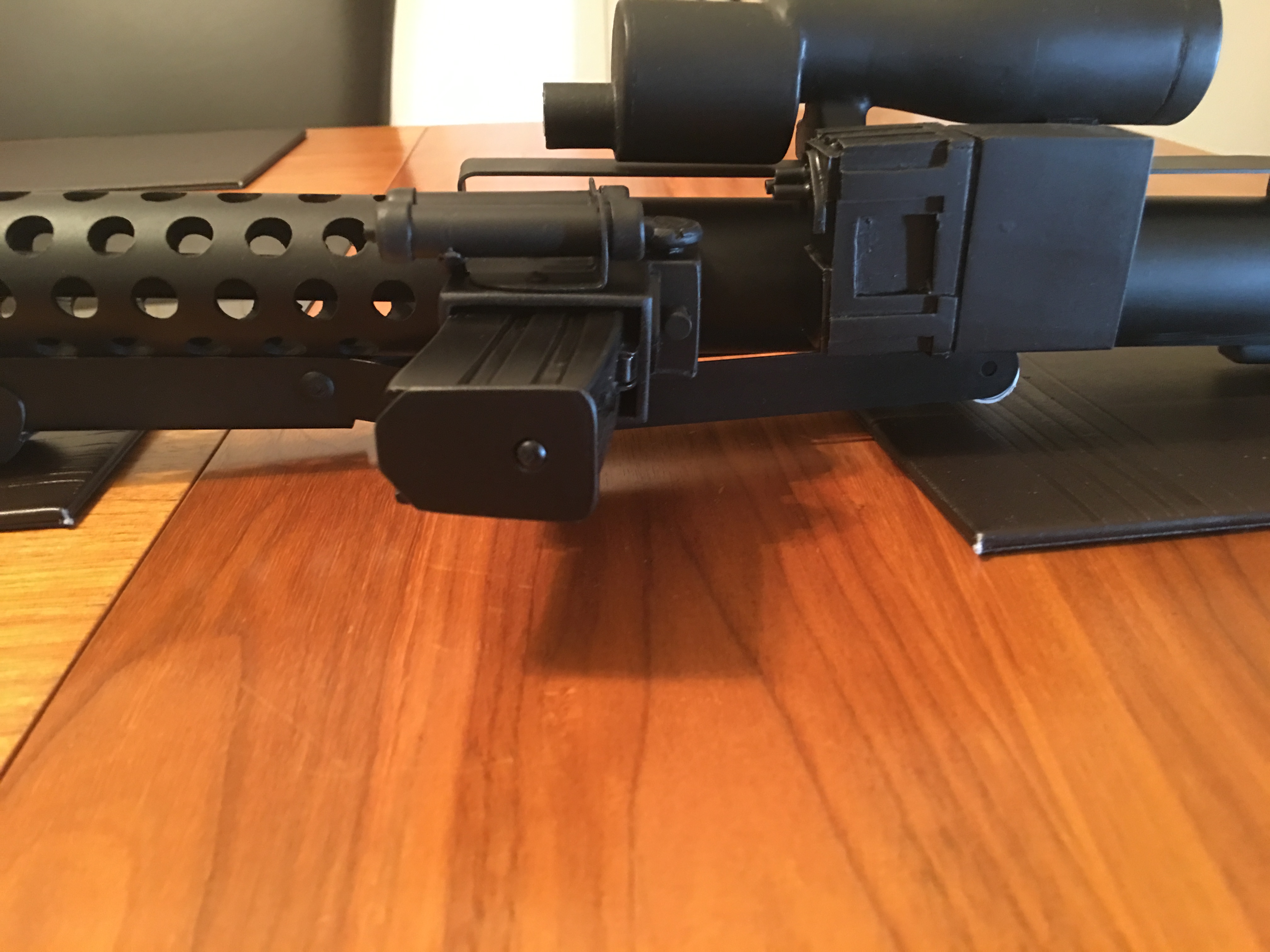

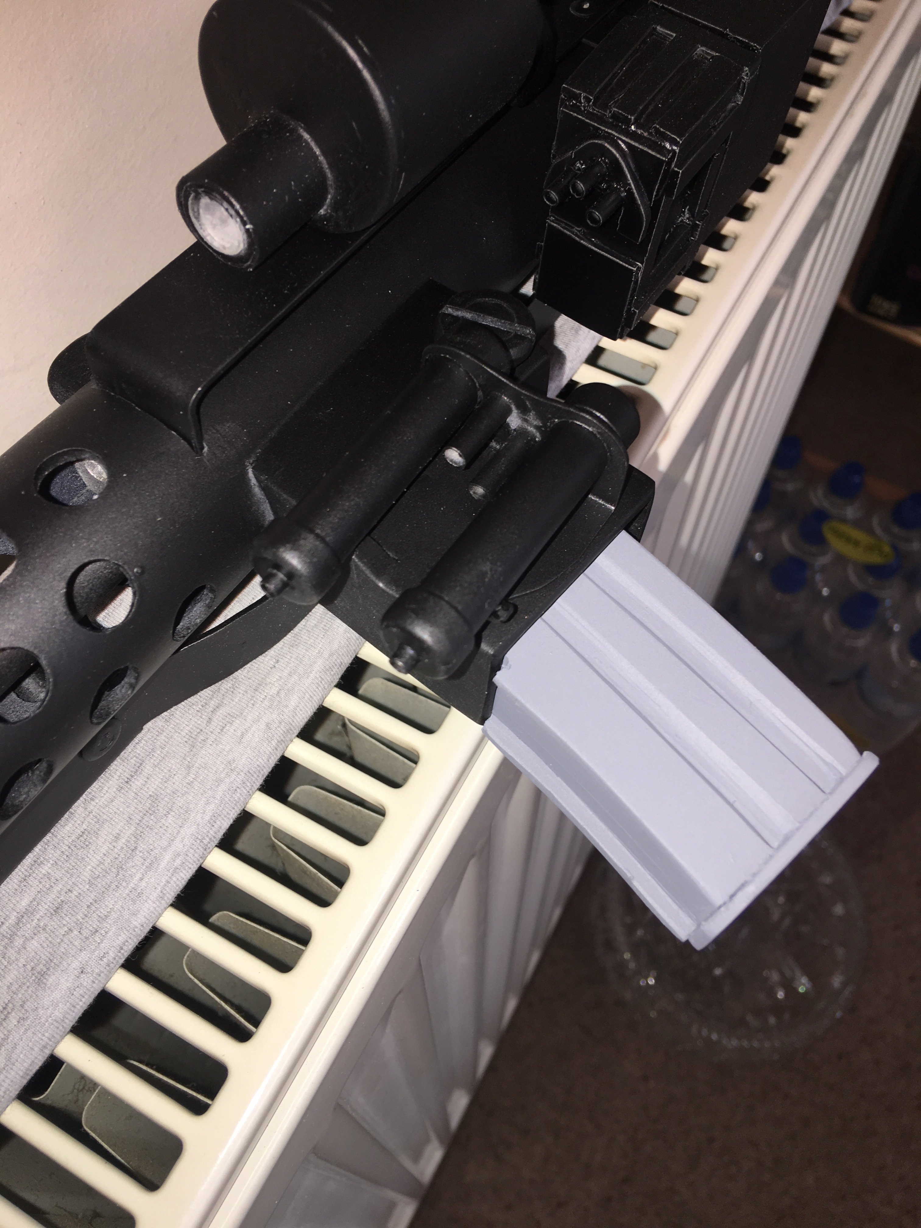

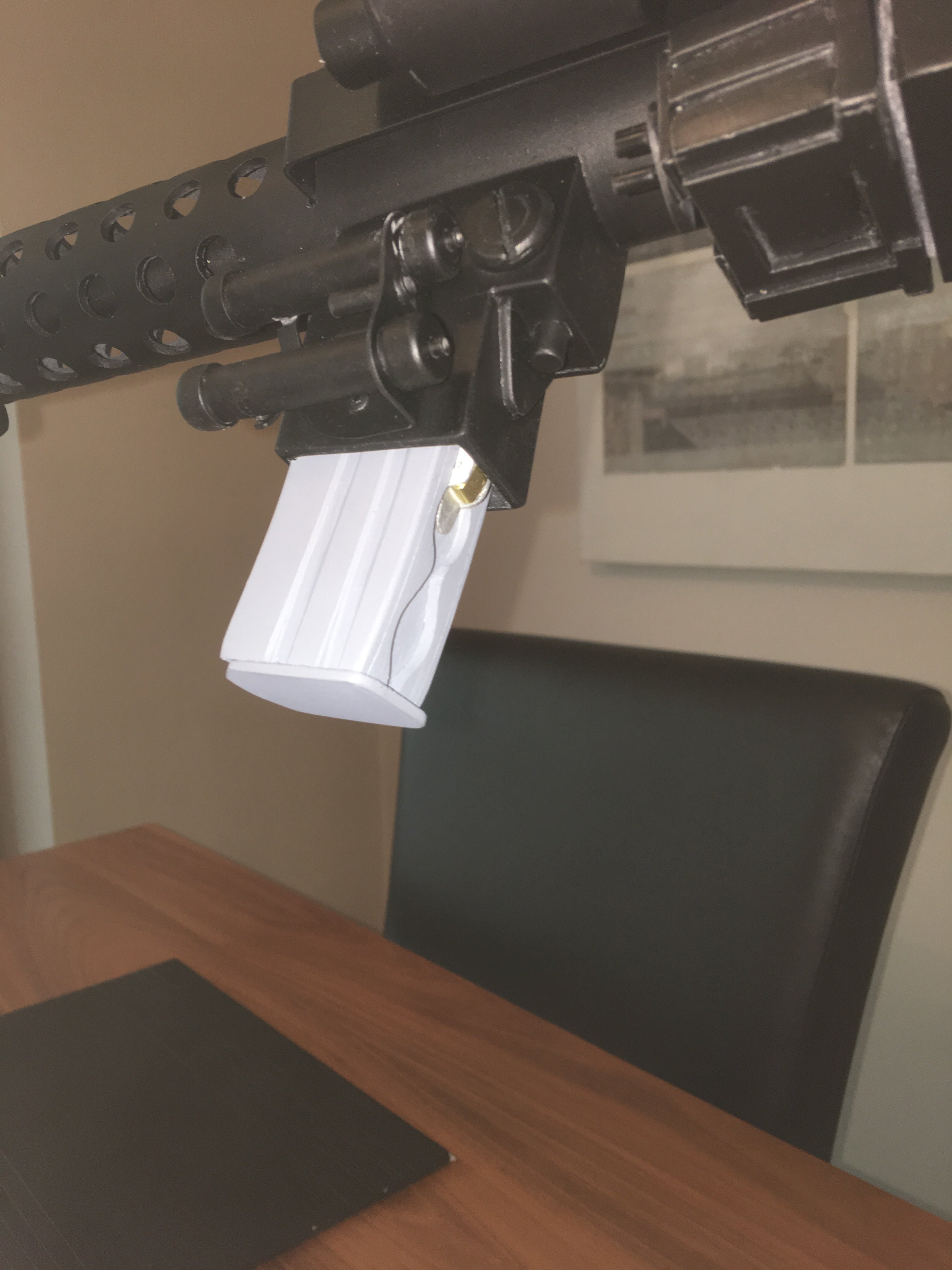

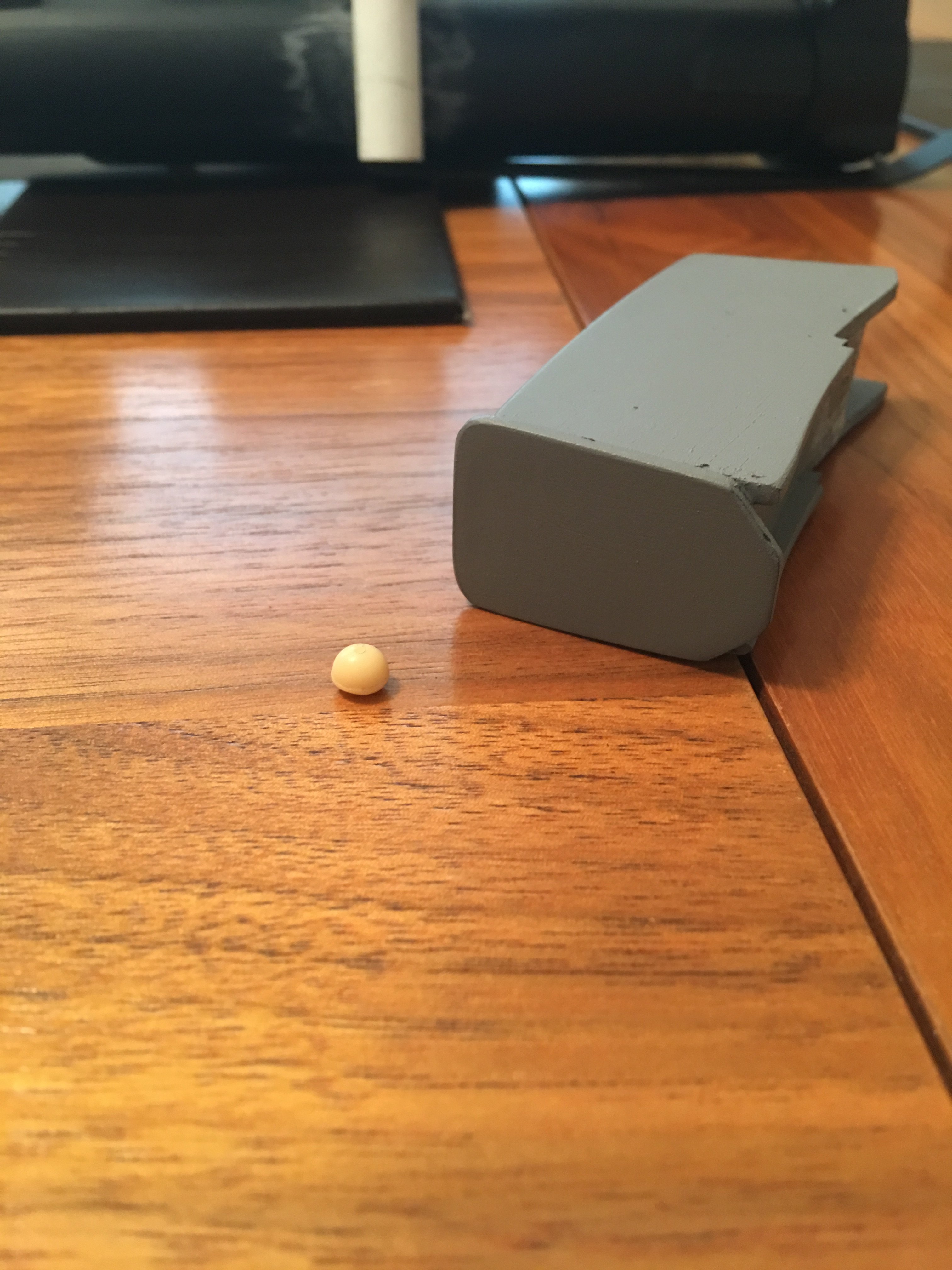

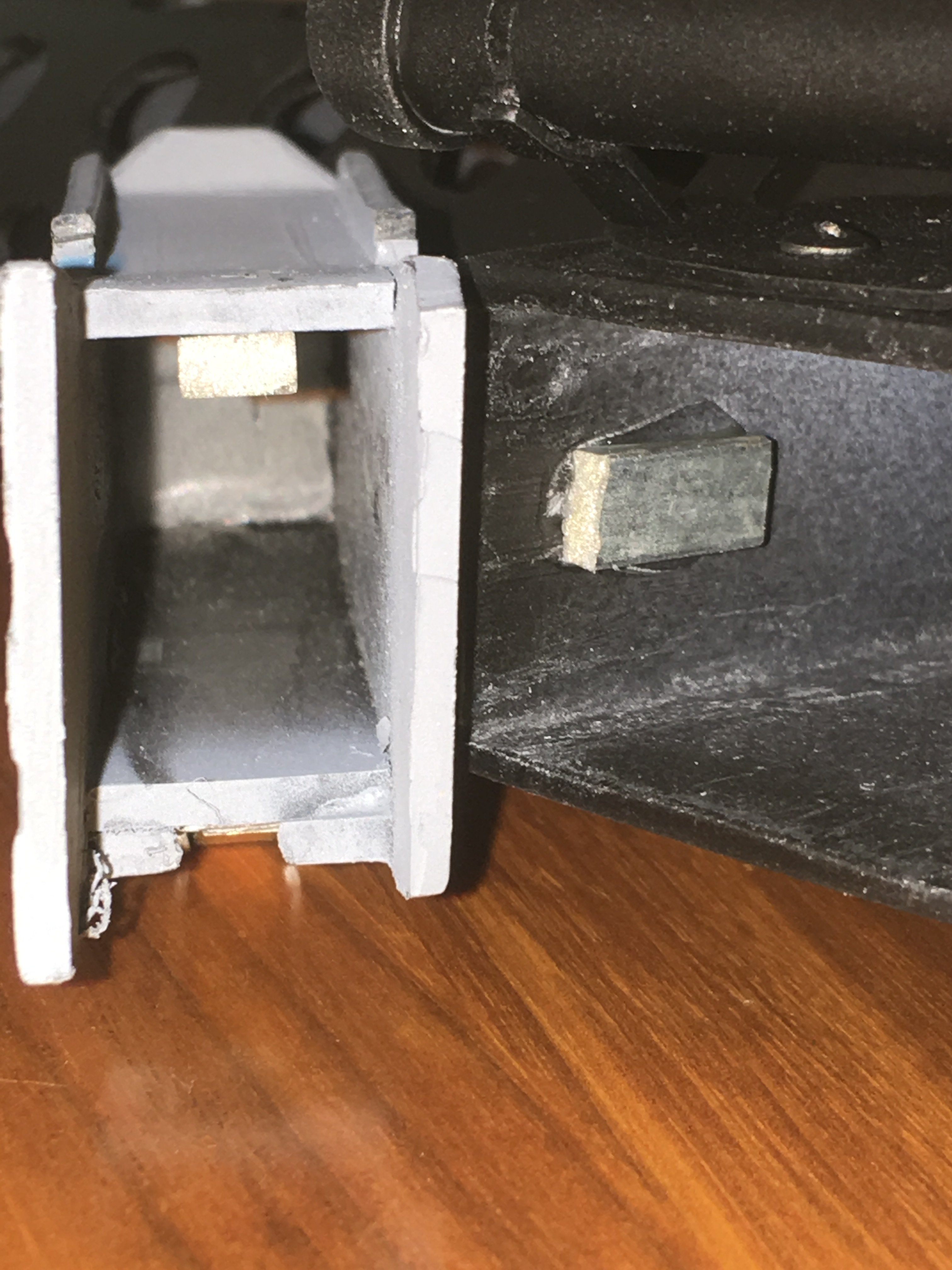

first thing I did was to use 2 strong magnets to hold the magazine in place, the clip for holding the magazine in place was only for show, as you can see I stuck one in the mag and the other in the mag holder, when the E-11 is tilted and shaken it won’t drop out

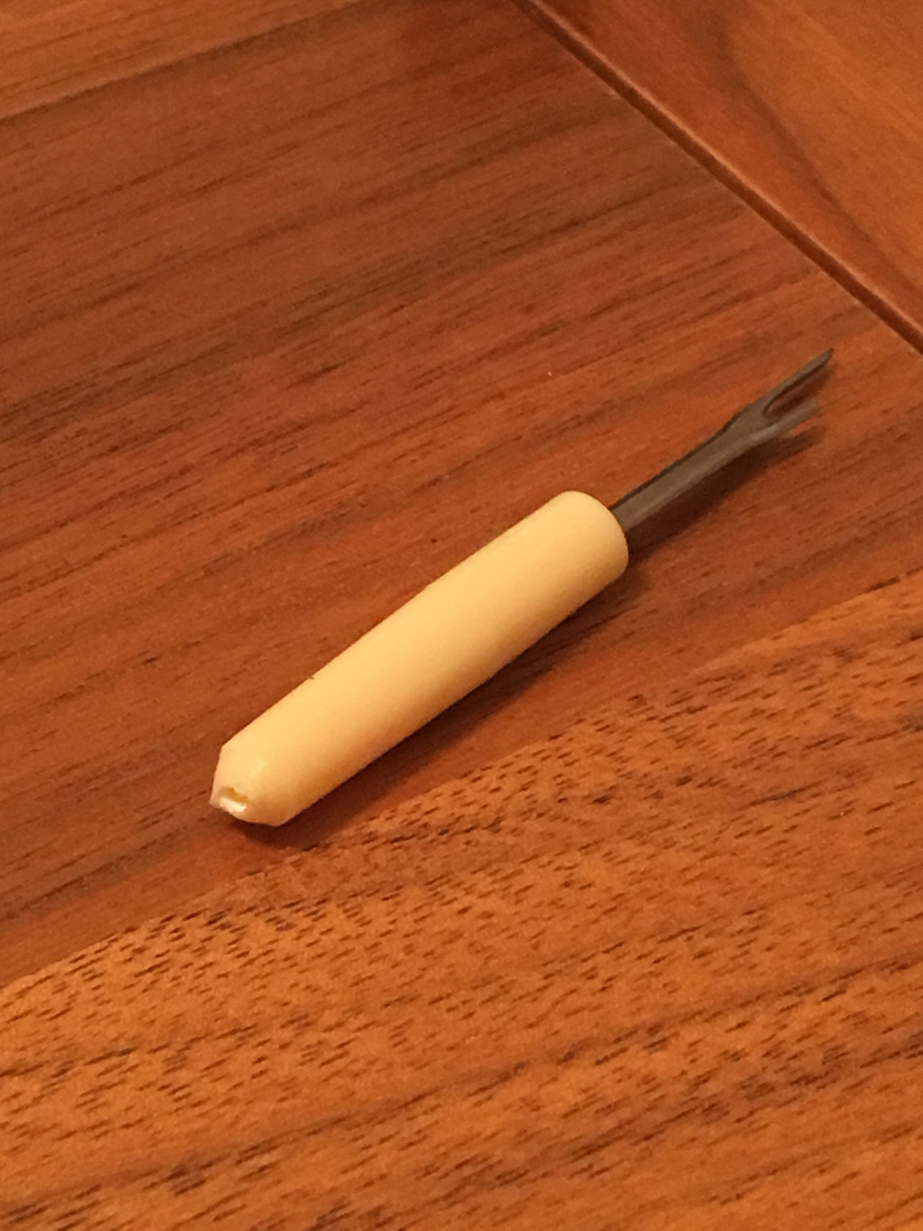

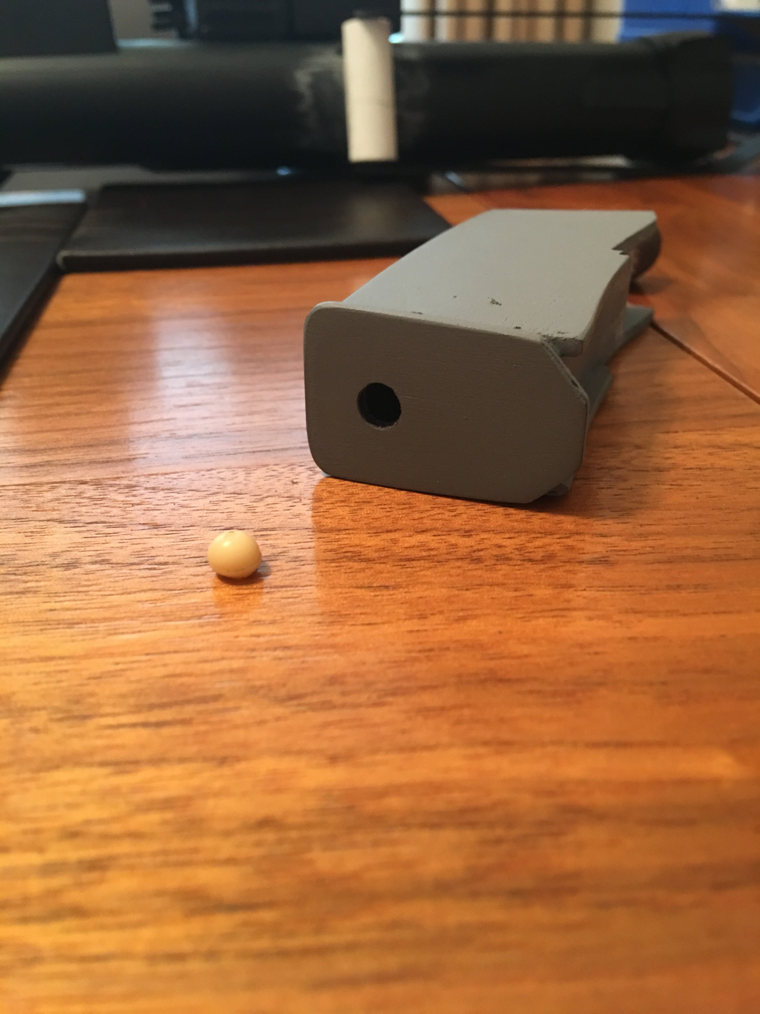

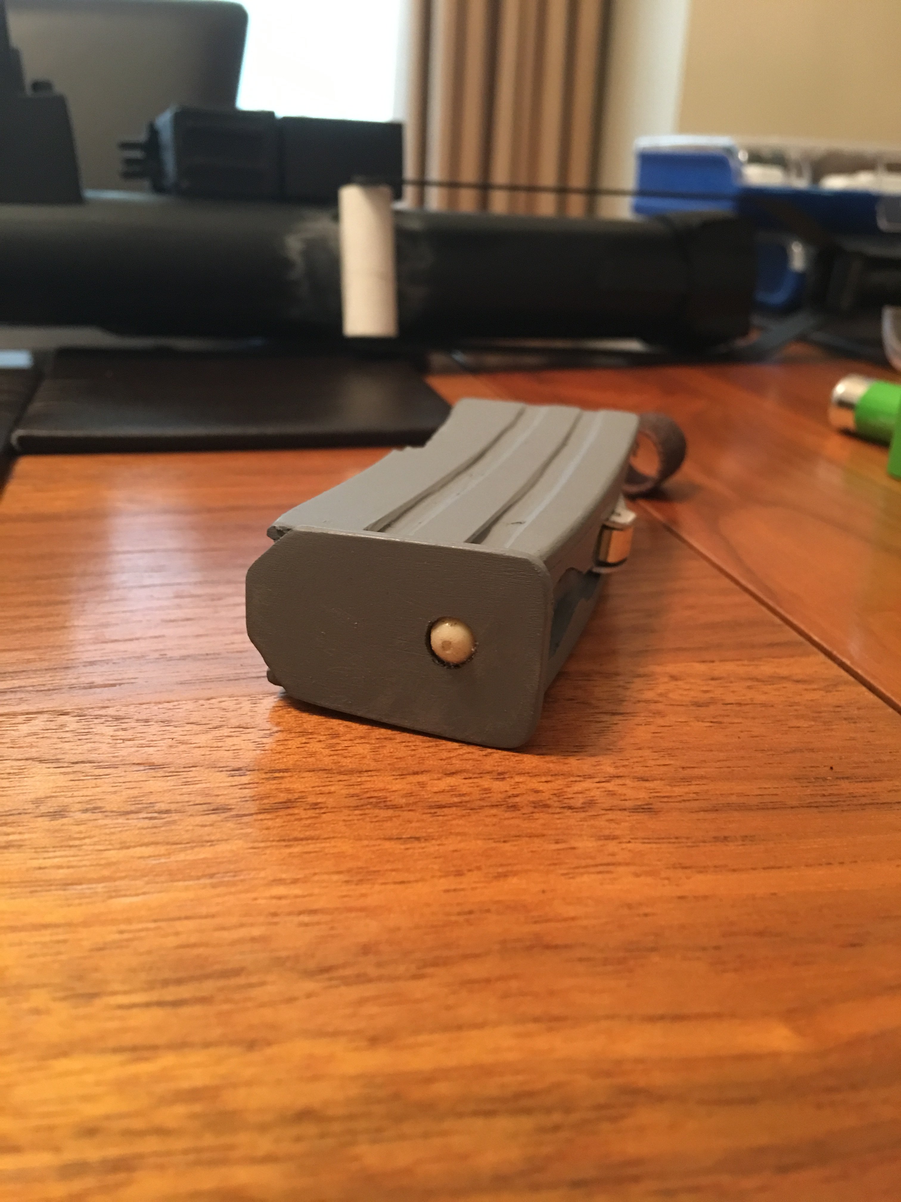

I wanted to add the little detail to the bottom of the magazine, I searched all my junk pile for a small ball bearing but I couldn’t find anything that would work, but I then found this little plastic ball that my wife has donated for the build ( Shhhhh she doesn’t know she has donated this ) I cut a hole in the bottom of the magazine and glued it in place from the inside as I didn’t want it to stick out to far
F396F22C-576F-436B-81A0-0CC3AFBA9C3D.jpeg180230B8-C293-4518-8D54-6CC757A8FB09.jpeg3405A498-D8D2-4FC0-81C0-941F743DC337.jpeg
What she she has unknowingly donated is or was the end of her stitch un-picker from her sewing box ( I will search high and low in anything for my build )
Primed, painted and fitted
98C91CD5-5348-4C14-8BCF-DE156ACDCA98.jpeg3C8A45FE-EE69-4435-AF15-CC8AE919F25F.jpeg6FF3B540-4AE4-40F1-82BF-E0B034618EDE.jpeg

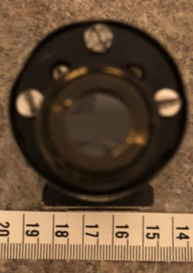

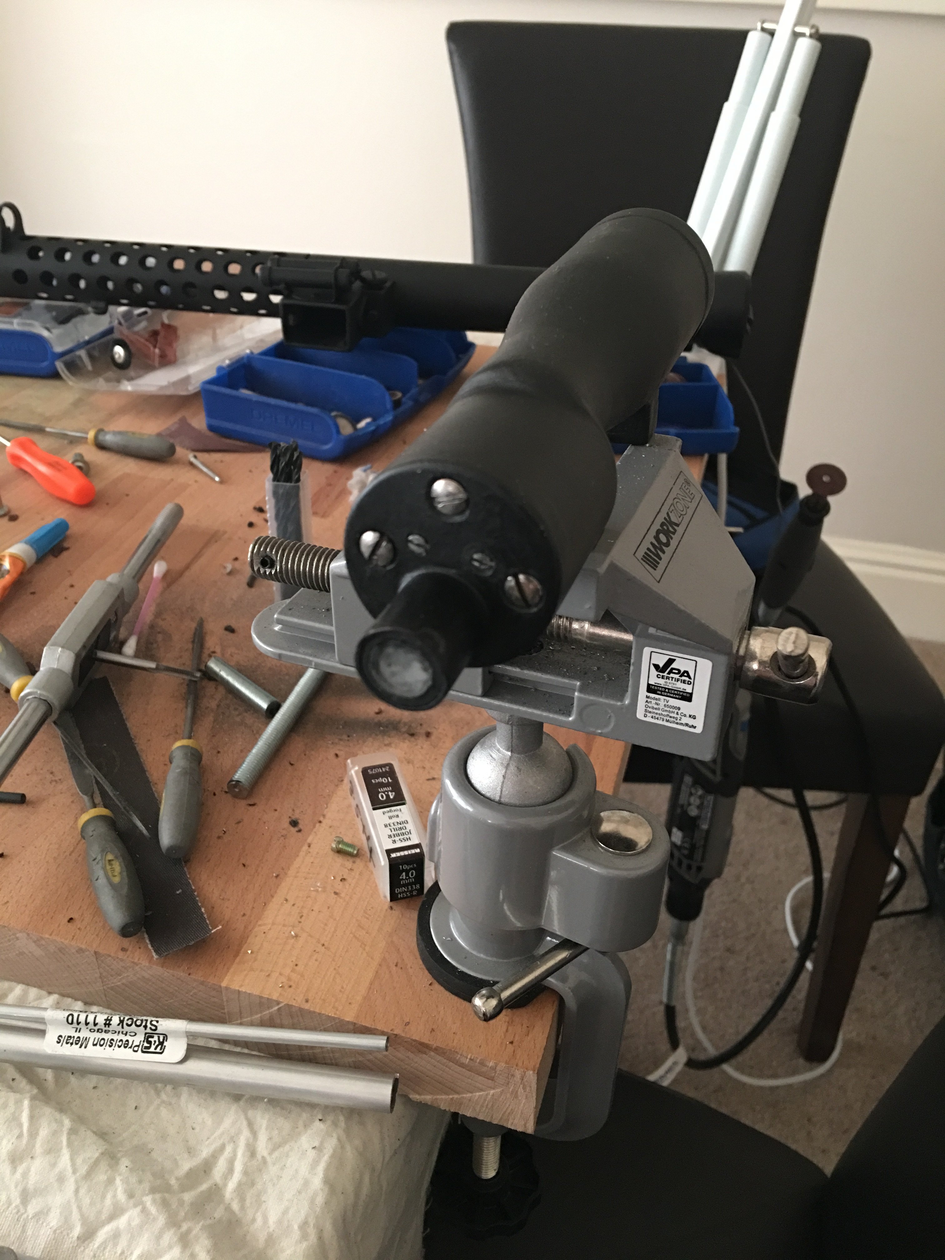

The next job I’m going to do is put little screws in the end of the scope
Like this

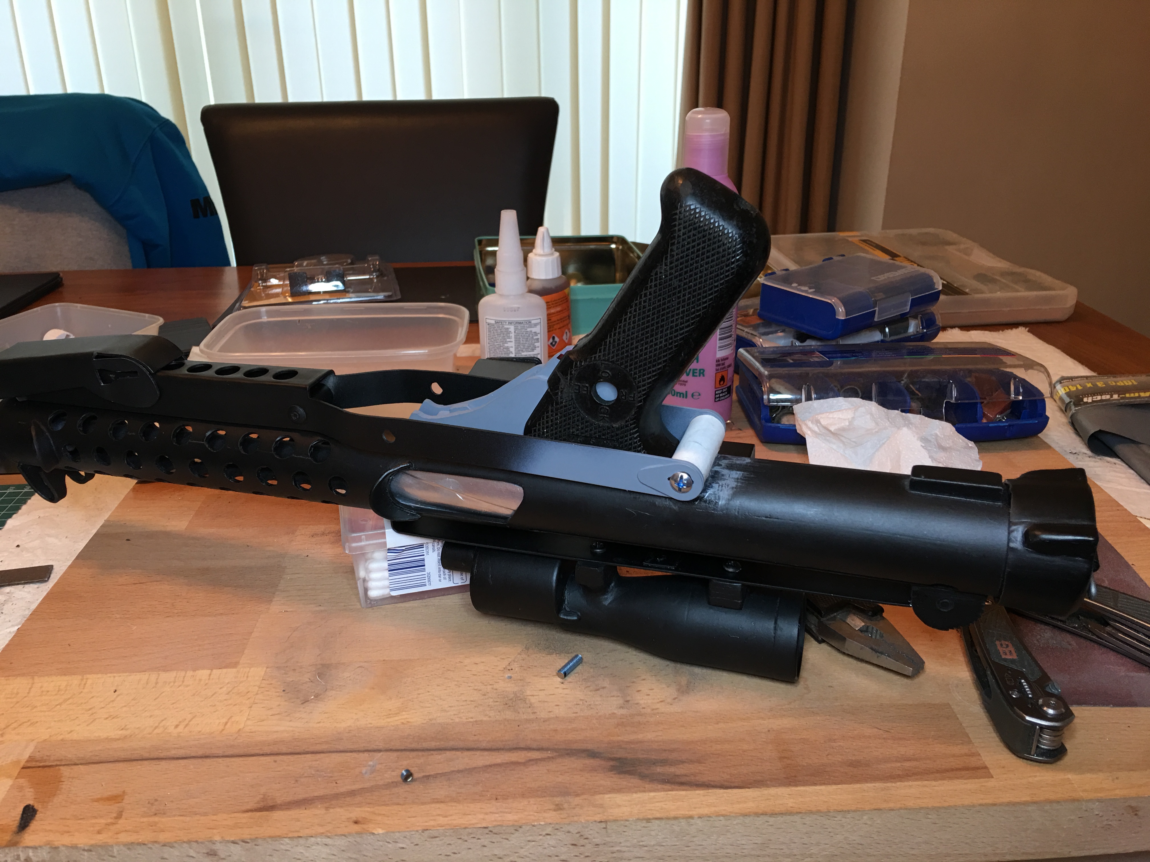

Another little update

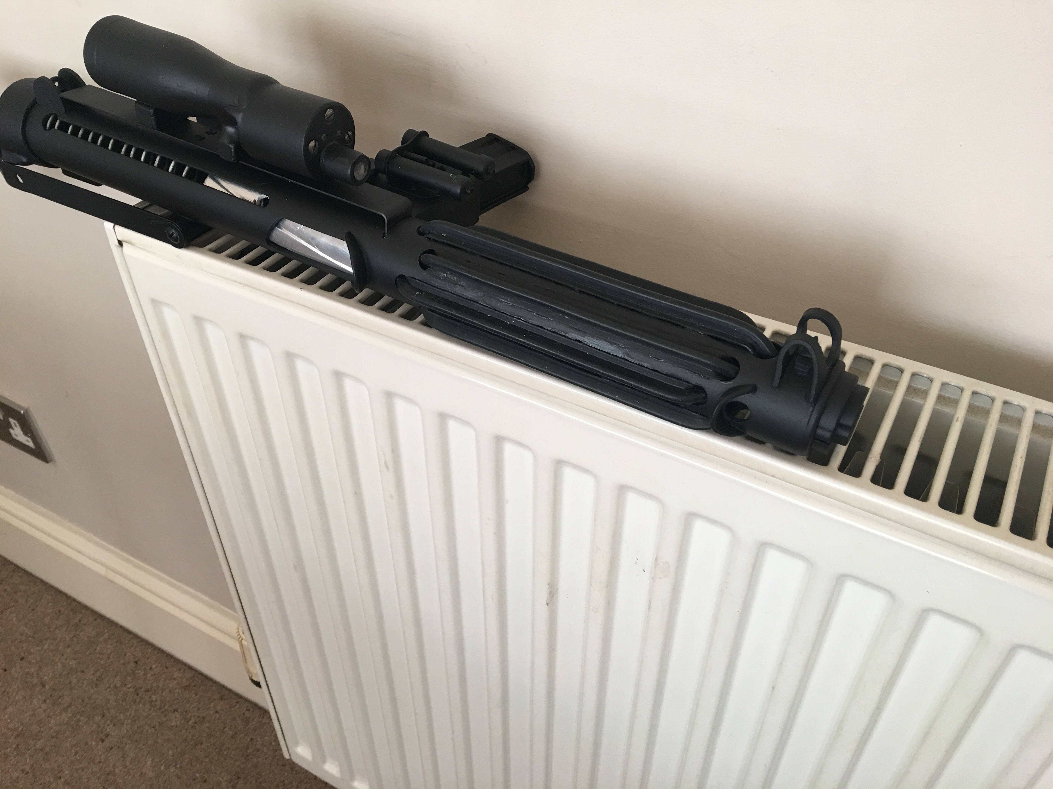

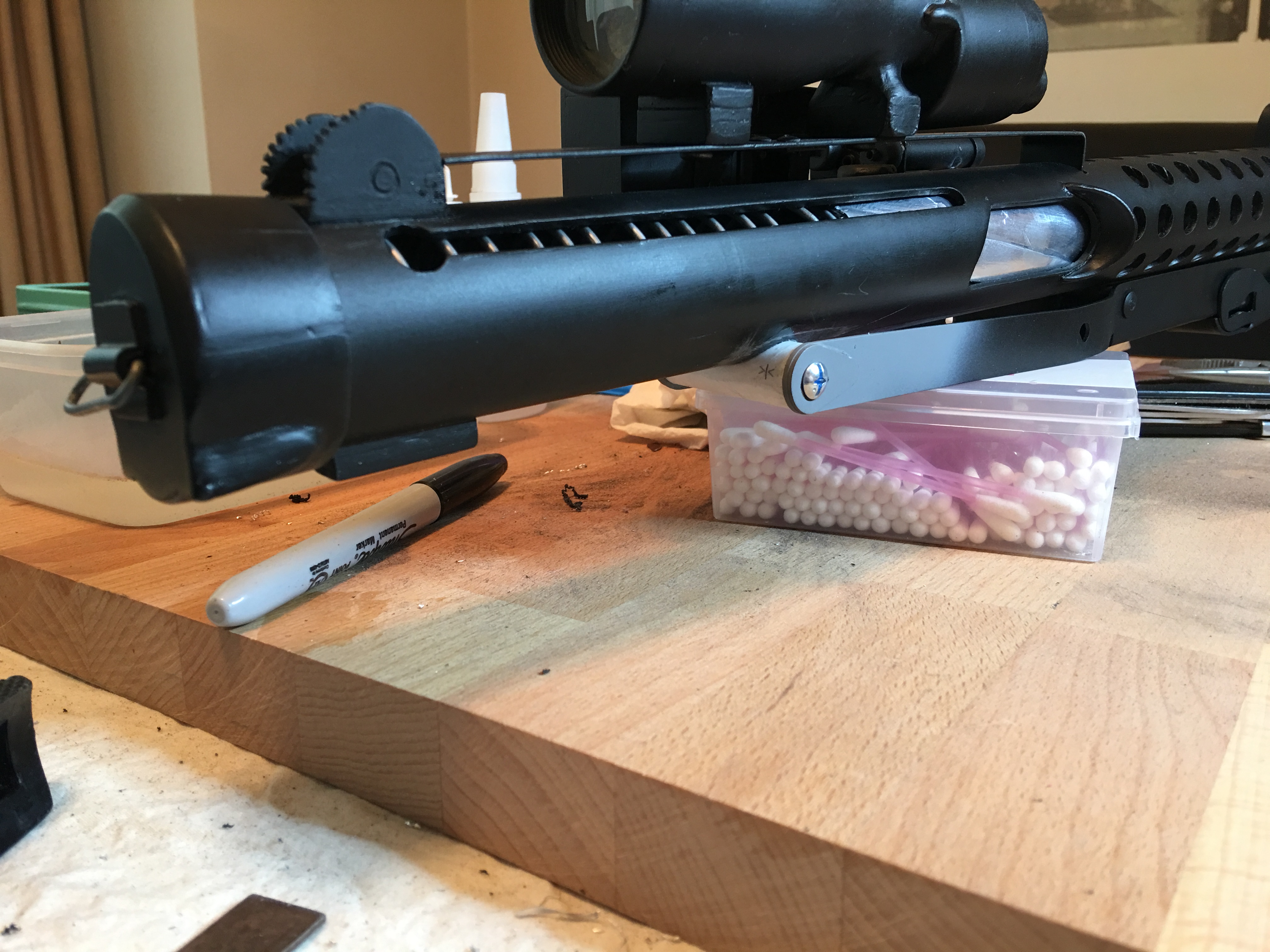

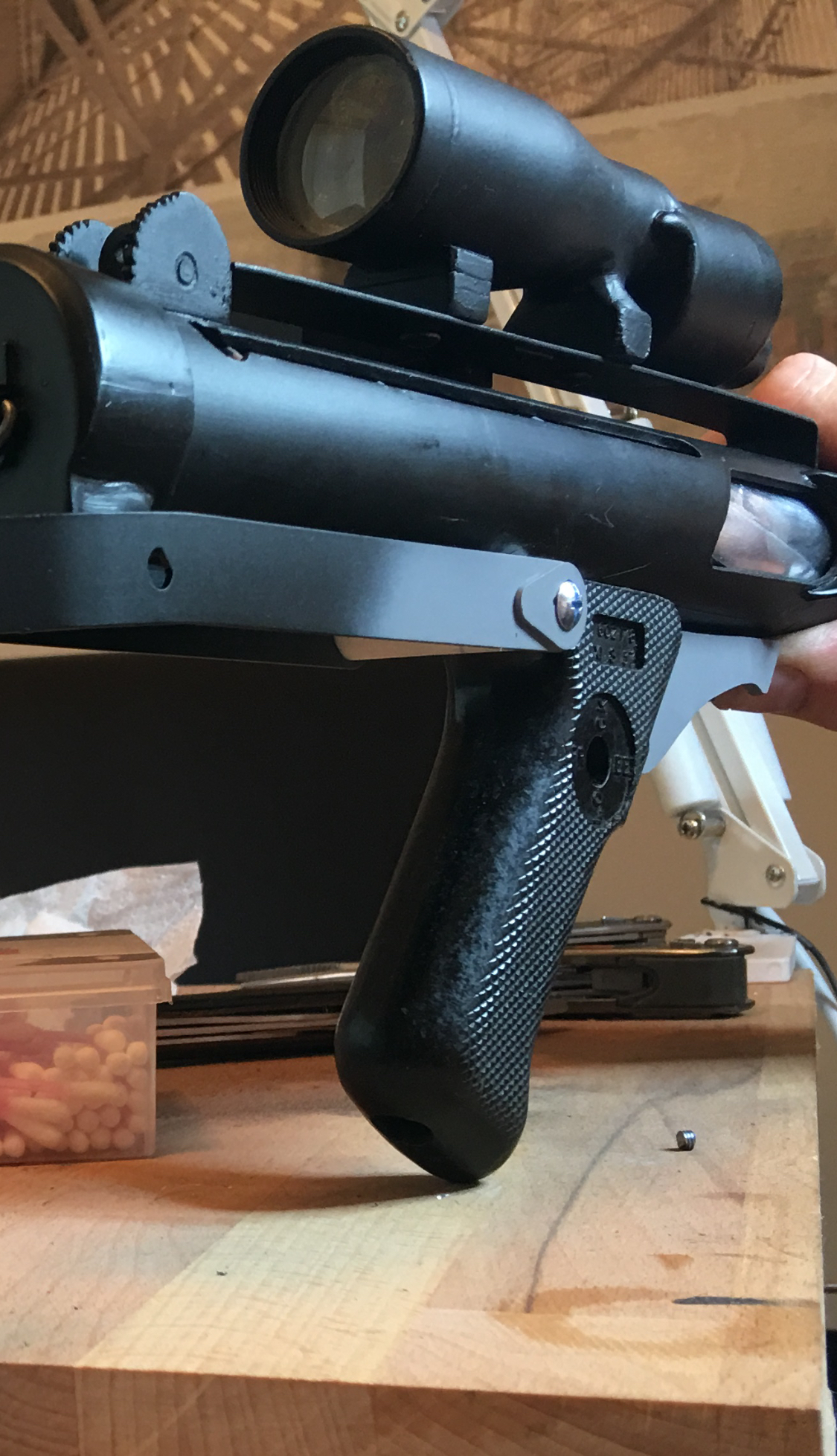

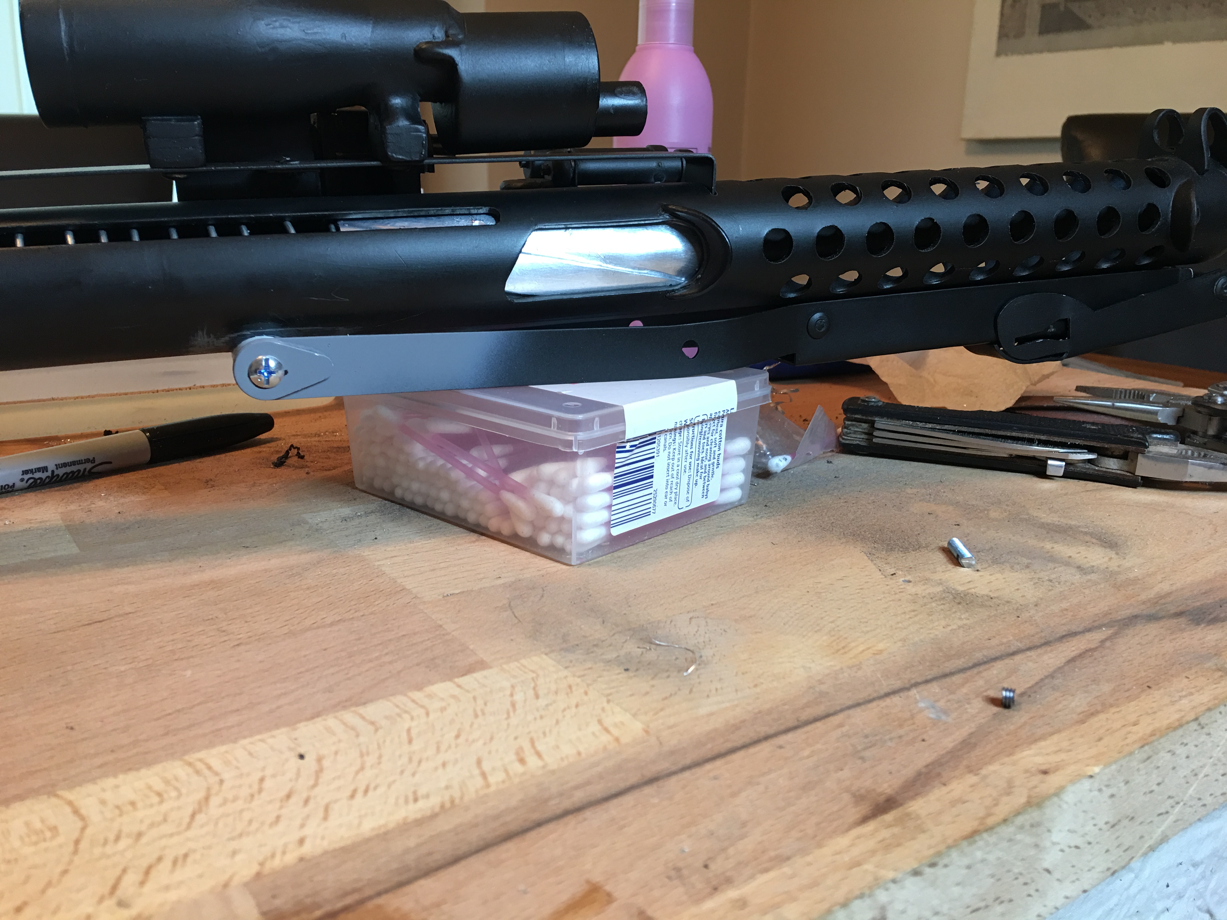

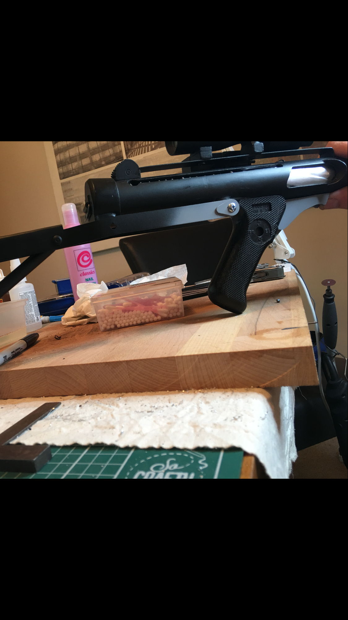

I’ve fixed the folding stock in place, for such a little job it took me a hell of a long time to get the fixings correct
The grip is only temporarily sitting in place as I’m still waiting on parts

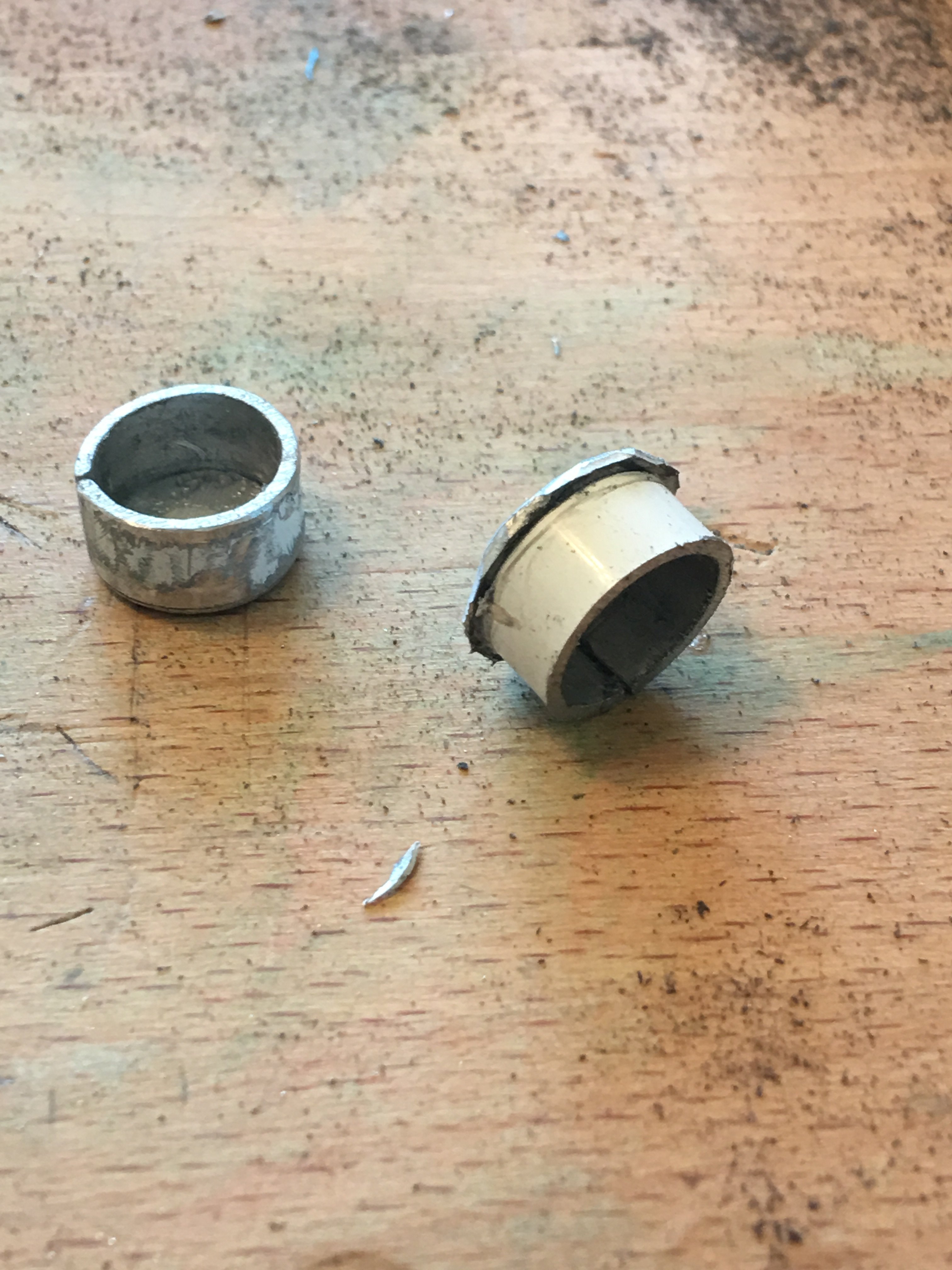

the white plastic pipe that I’ve used for the pivot point has a piece of 10mm aluminium inside it, it has a M4 thread tapped through the center of it for the M4 screws that hold the stock in place from either side
C4D47CEF-7DCC-420F-BF50-6F930313FDD3.jpeg439FCC64-F0E0-4EC7-8D86-CB9BC23D841E.jpeg3EFB0728-C6B7-45DD-A2FC-EA0D64B93245.jpeg
I’m hoping that I get my grip/trigger bits back this week, I’ve also got lots of little refinements to do, the more I work on it the more I see that could be better, as it’s only for my own shelf and family members wouldn’t know how inaccurate it is I won’t be over doing the refining.
If I was charging man hours on this build I could have bought a new one !!

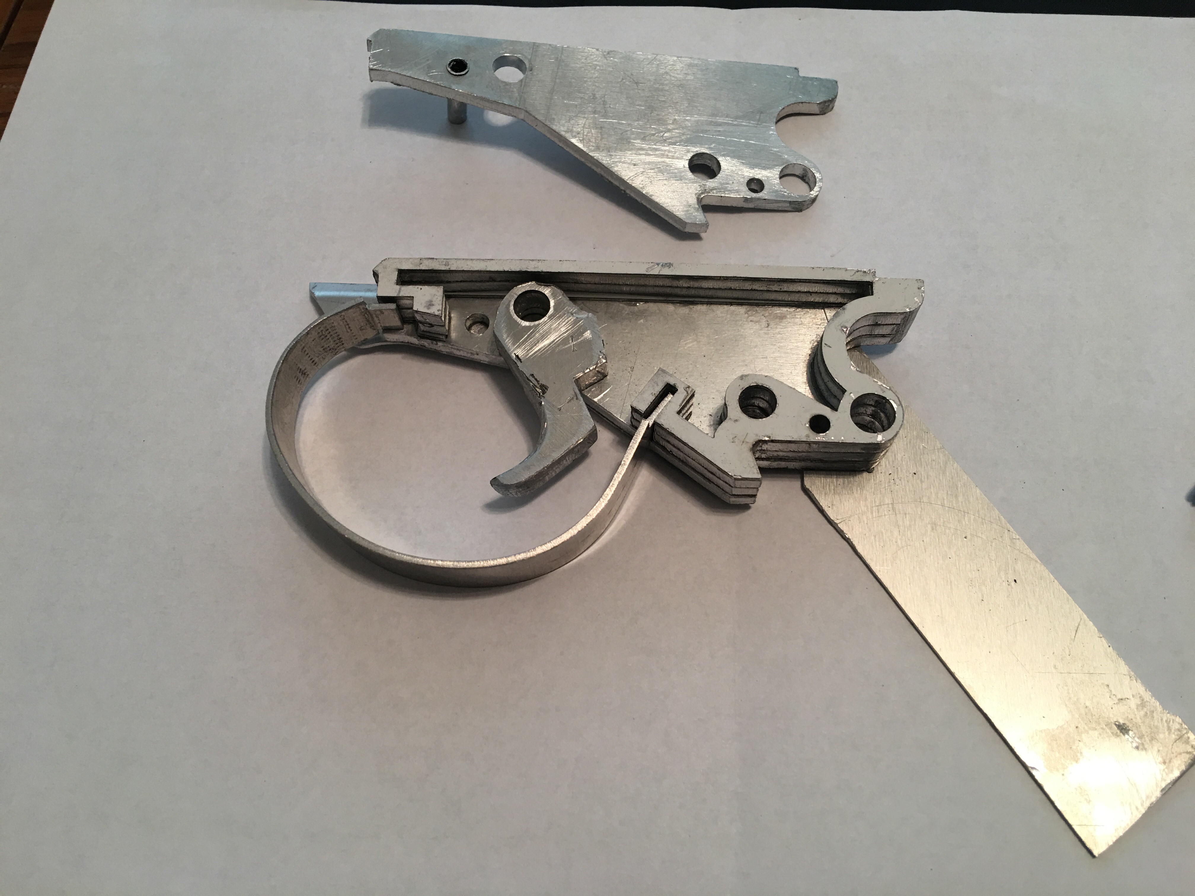

I can’t believe it took this long for my “laser cousin” to get these finally cut, he’s been busy he says !! To busy to reply to my texts or answer my calls !!

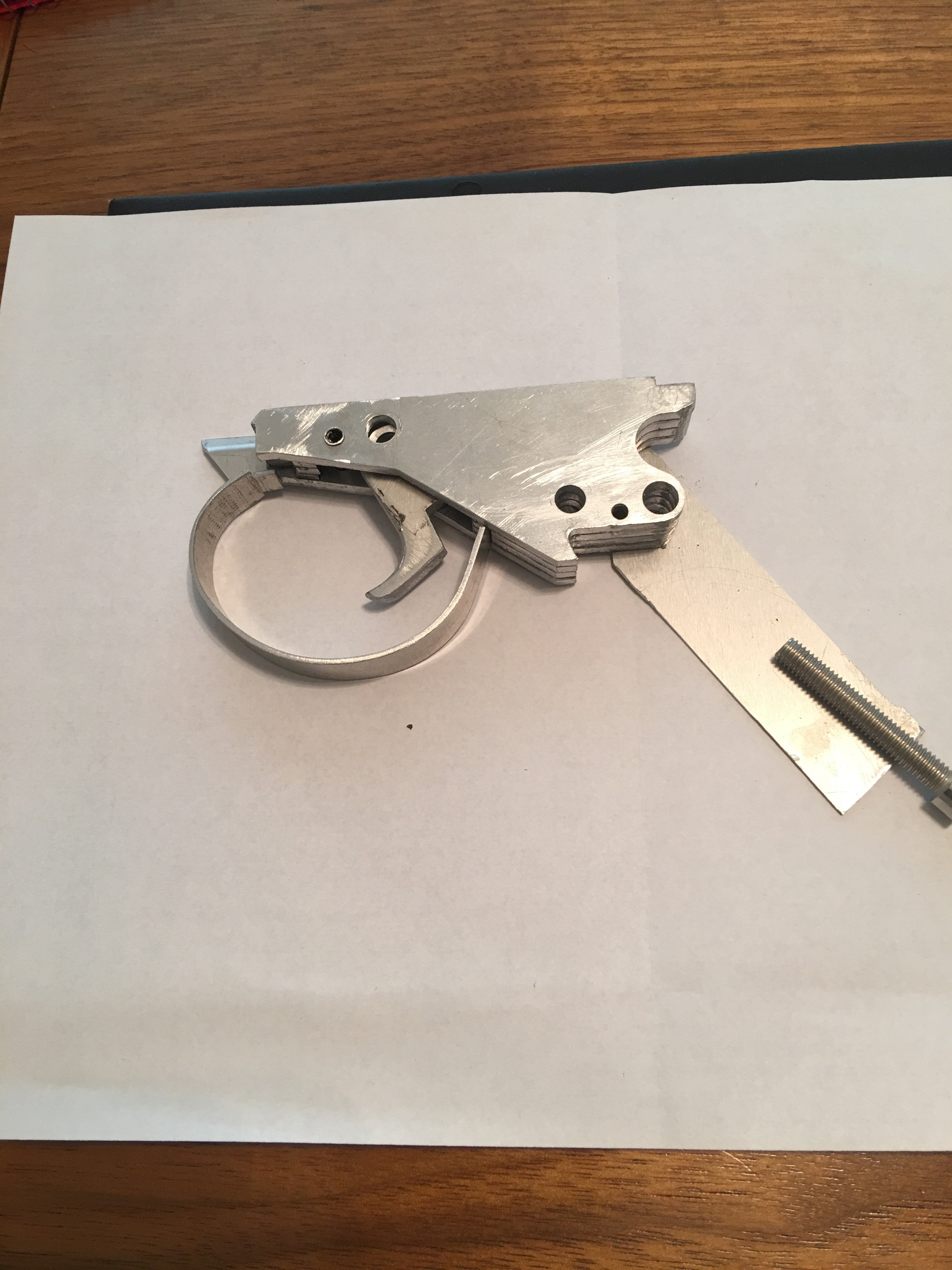

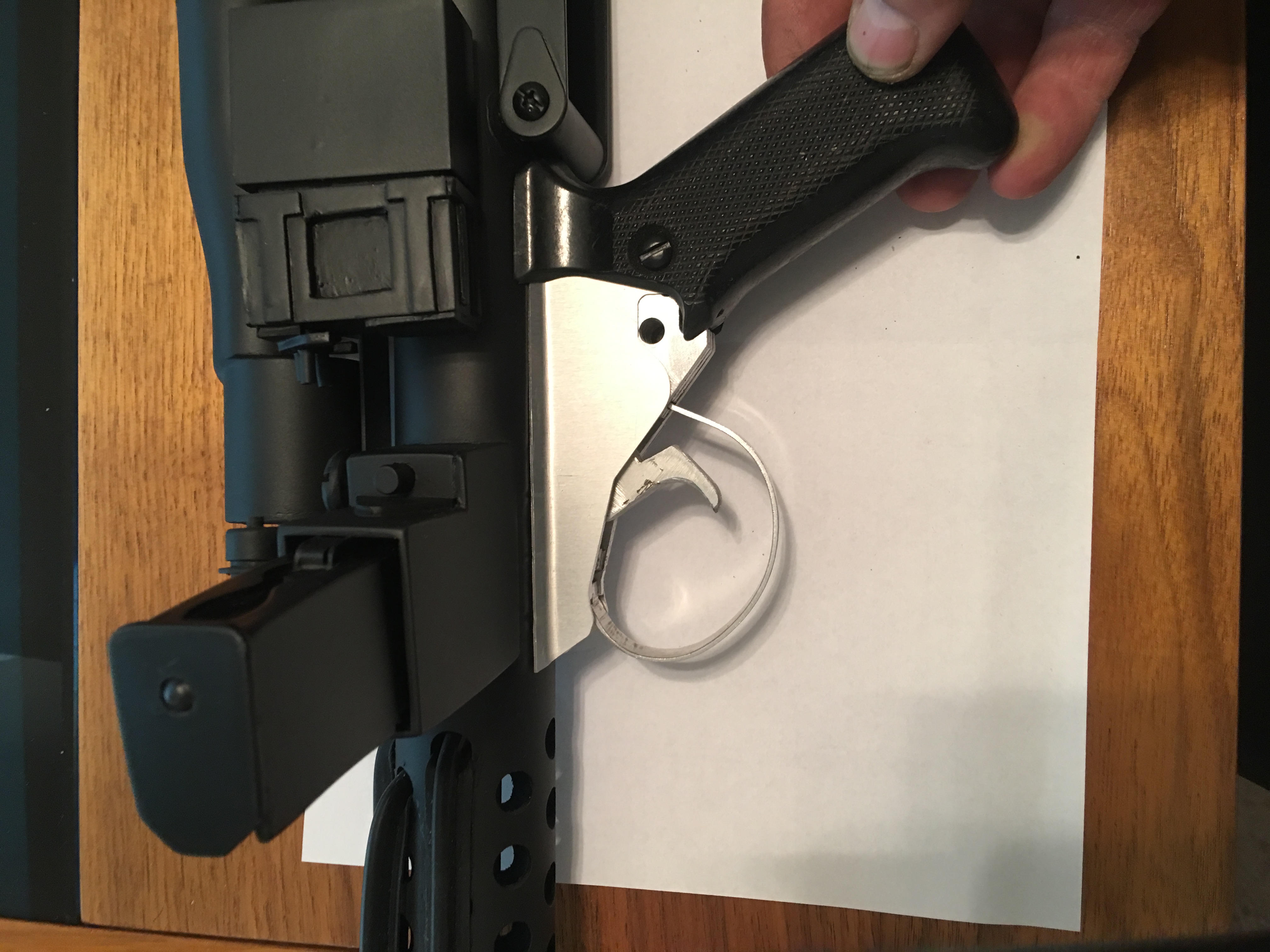

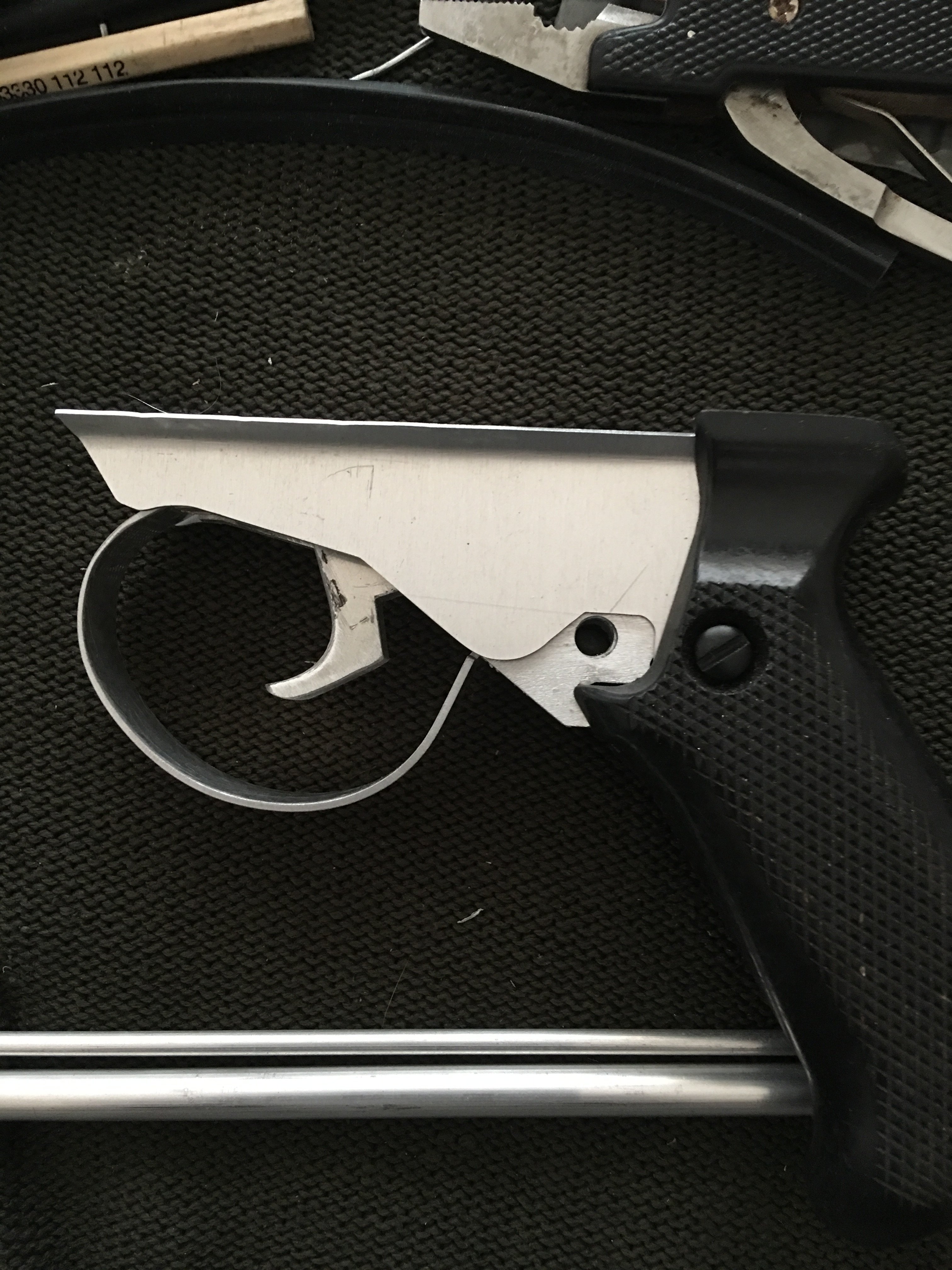

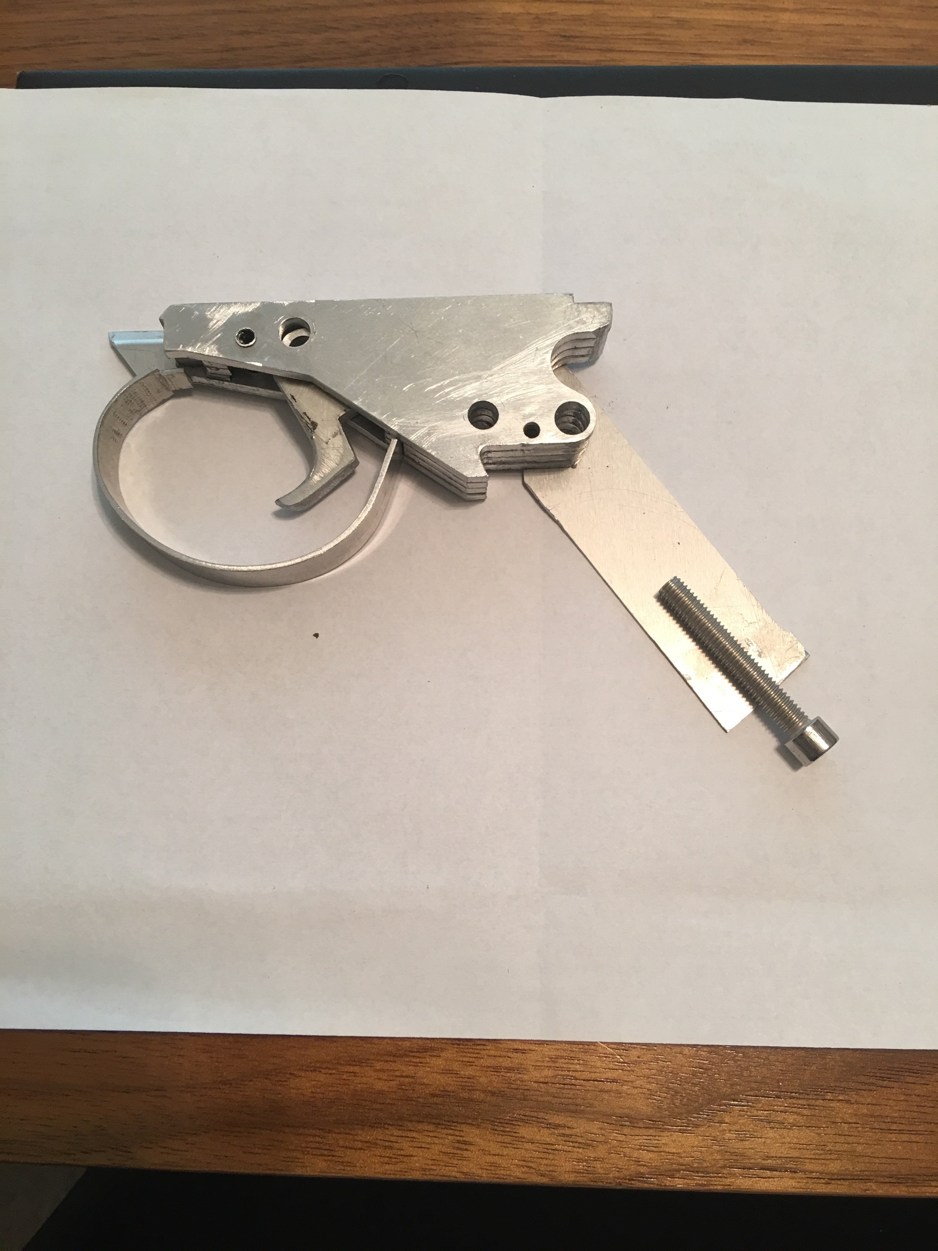

Any how, I’ve finally got back ALL my trigger parts, I will be putting all these parts together over the next couple of days, I want to make it a functional trigger and incorporate a micro switch for future electronics but the switch is a little to big, so until I get a smaller one progress might be a tad slow
But it not to slow !!

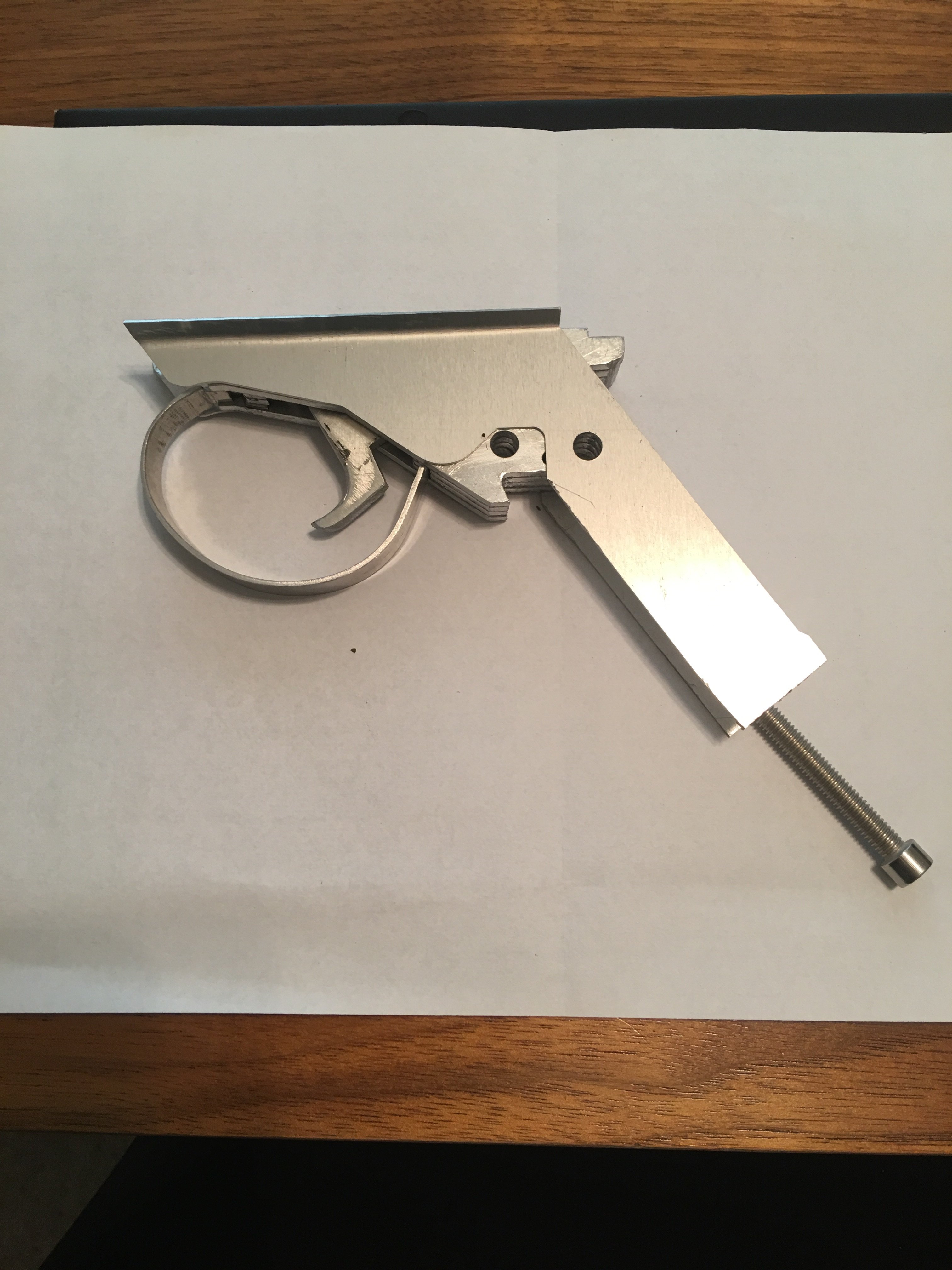

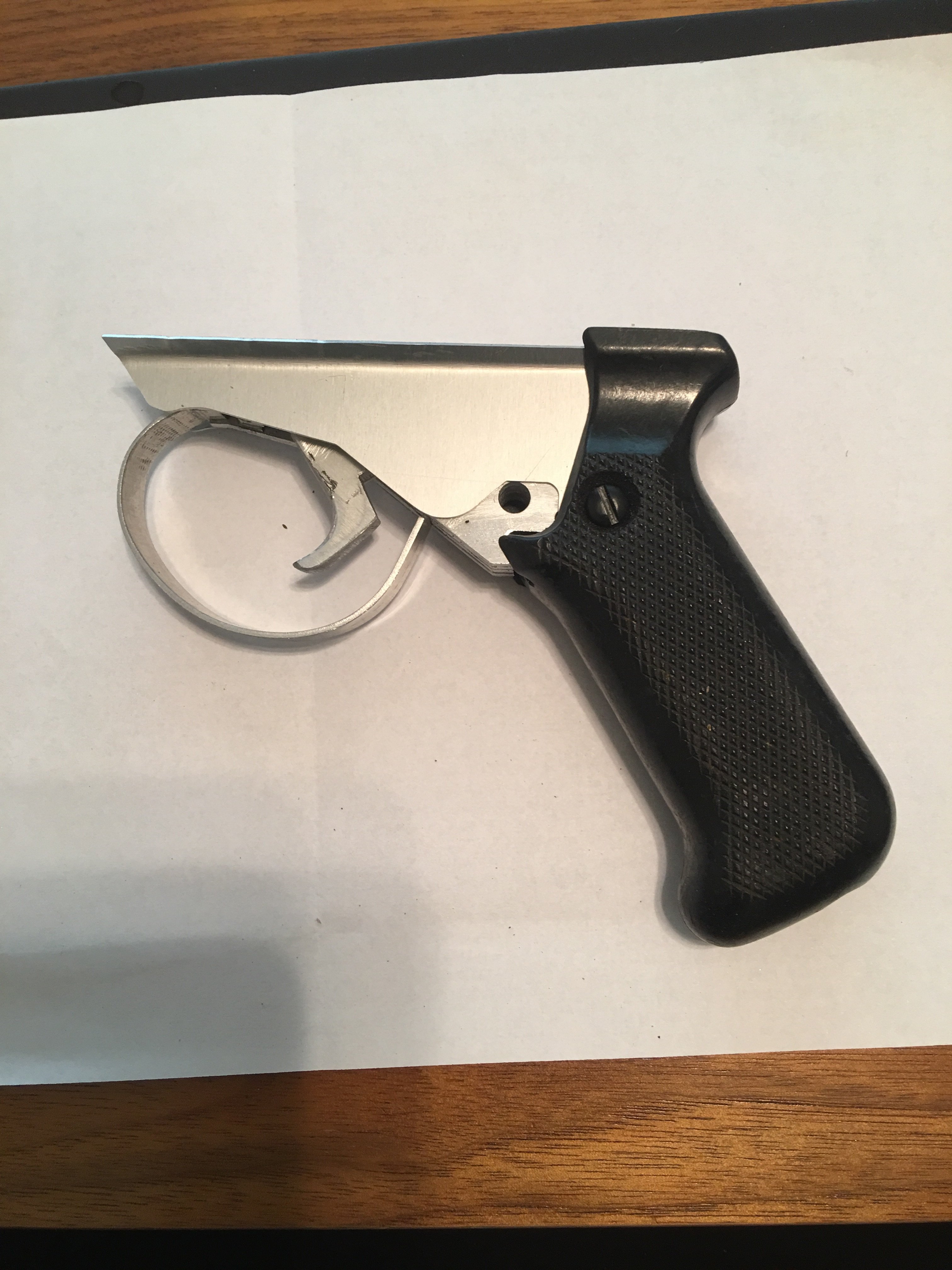

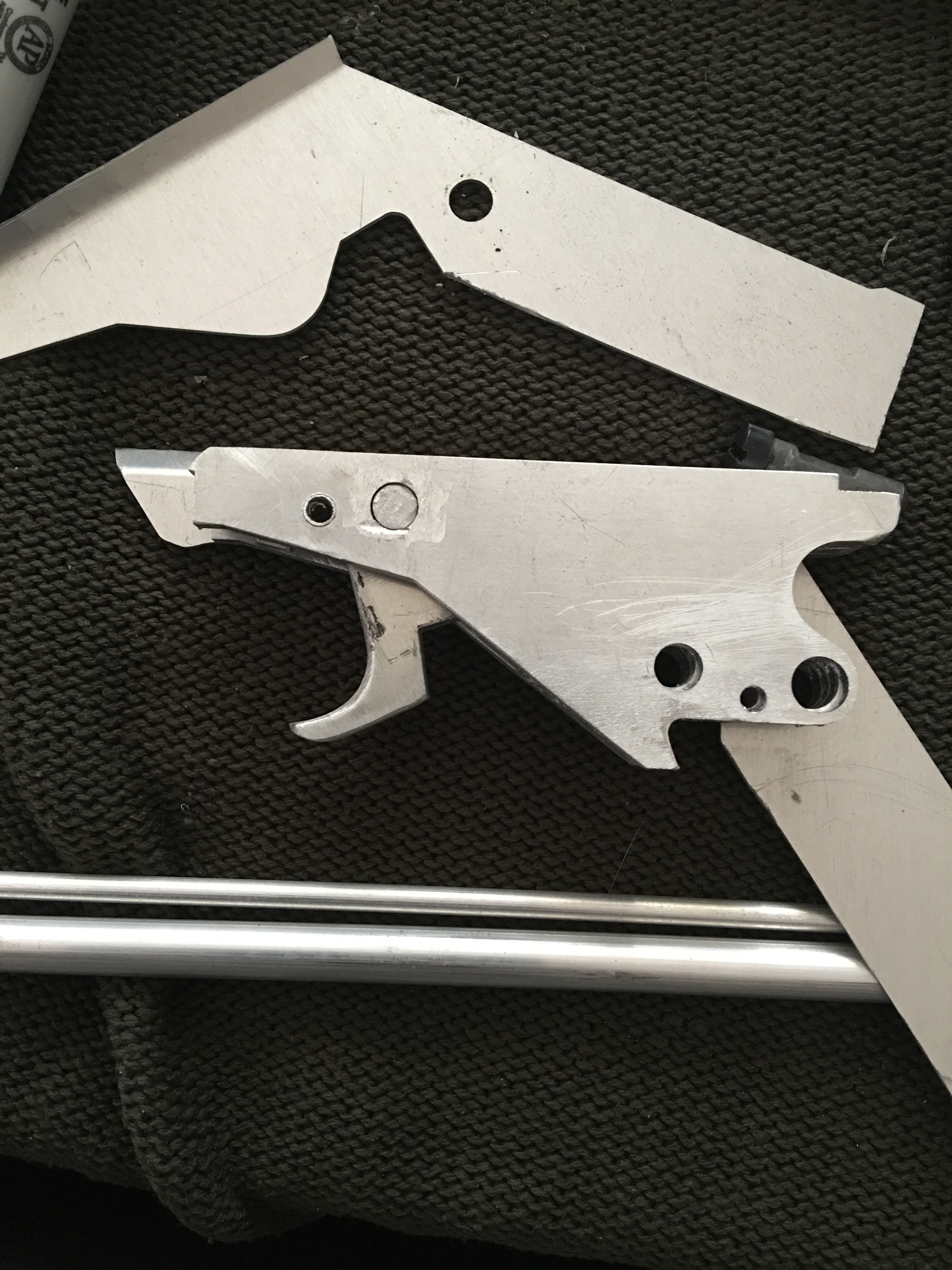

Ive glued the first pieces together, I’ve had to refine the trigger shape as it wouldn’t move when it was all fitted together, as you can see there is a nice gap behind the trigger, room for a switch
Then the cover plate, I also need to fix a nut in the handle section so I am able to fix the grip to the trigger housing
Now the top cover plate

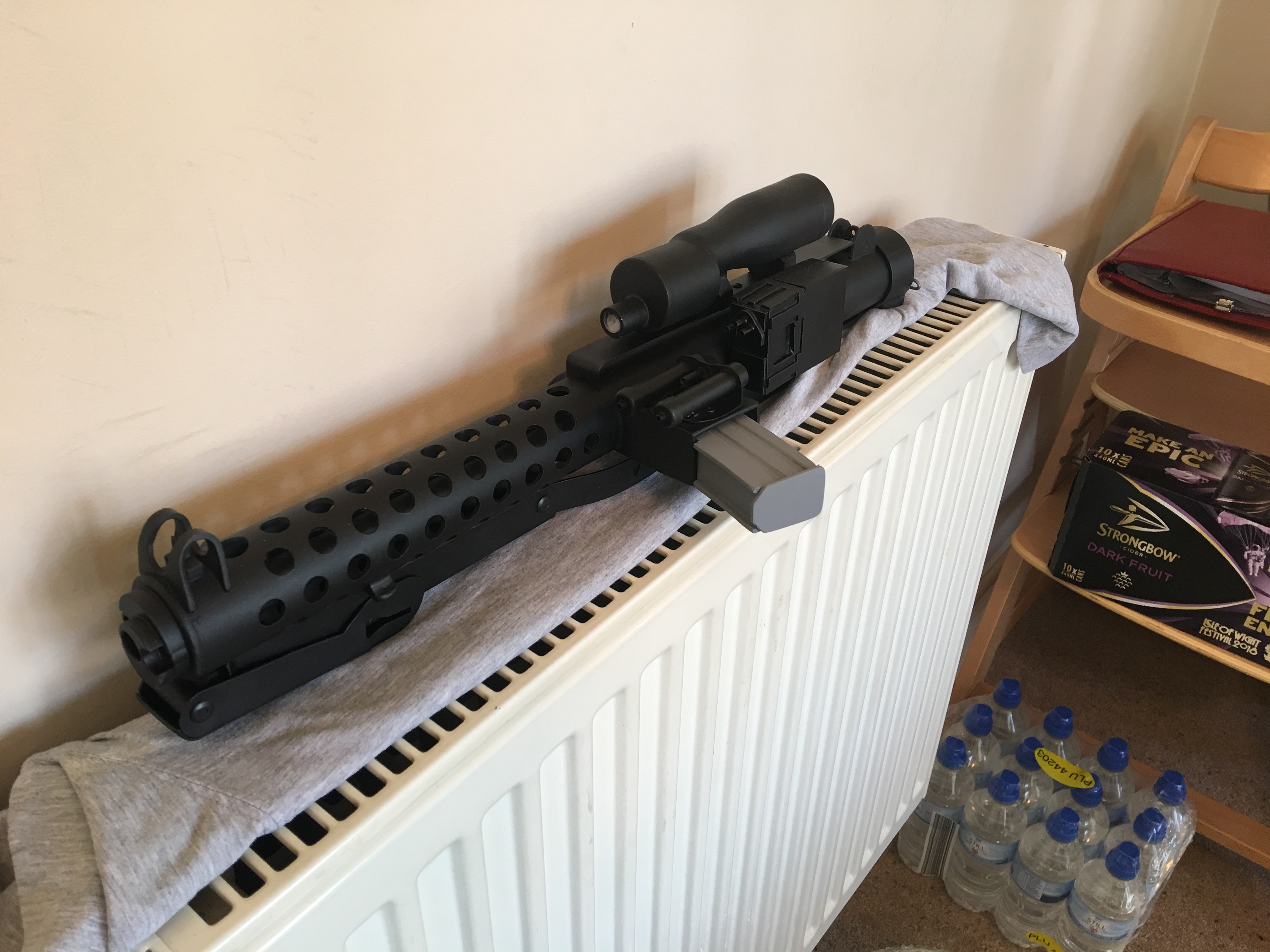

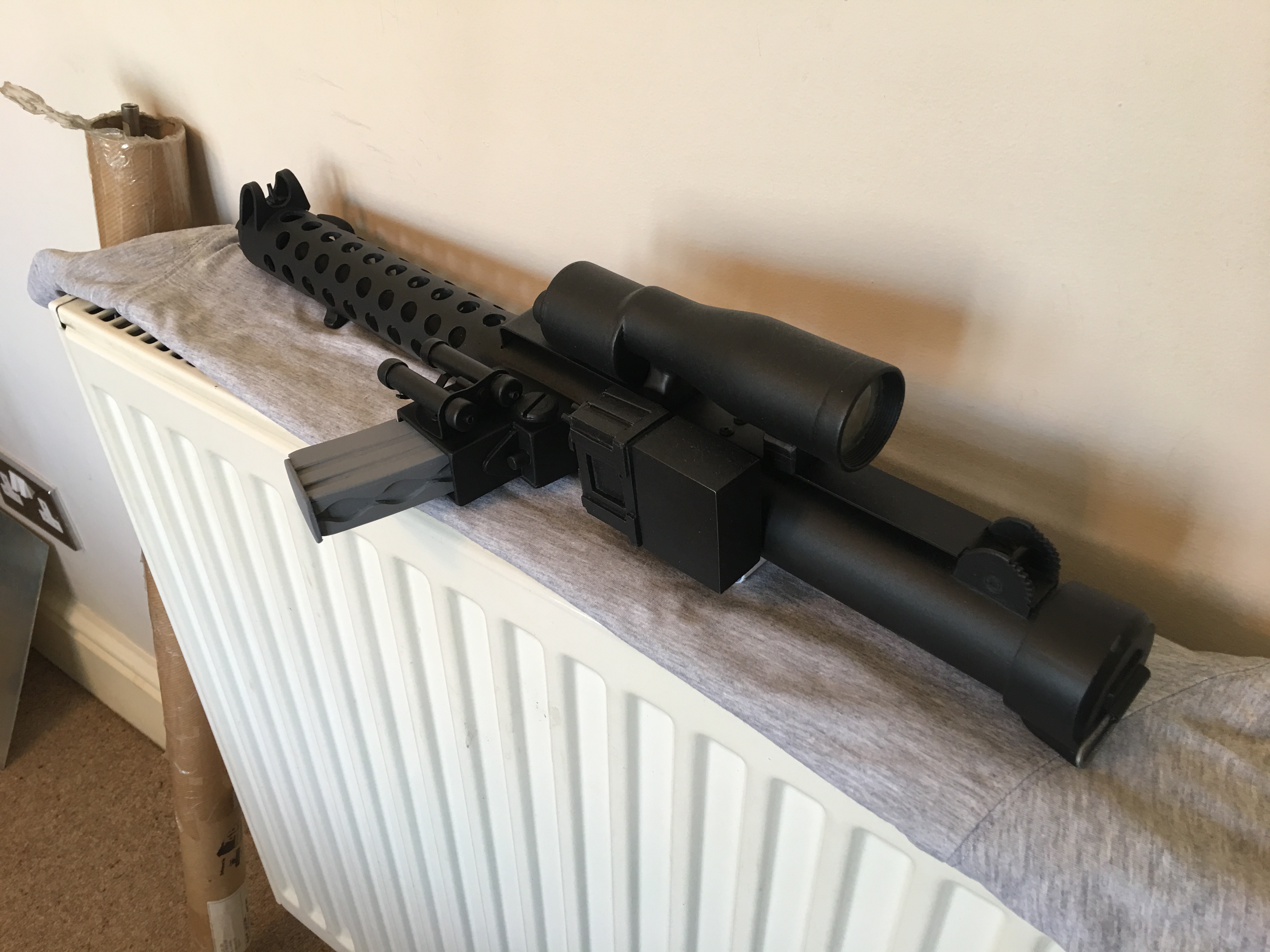

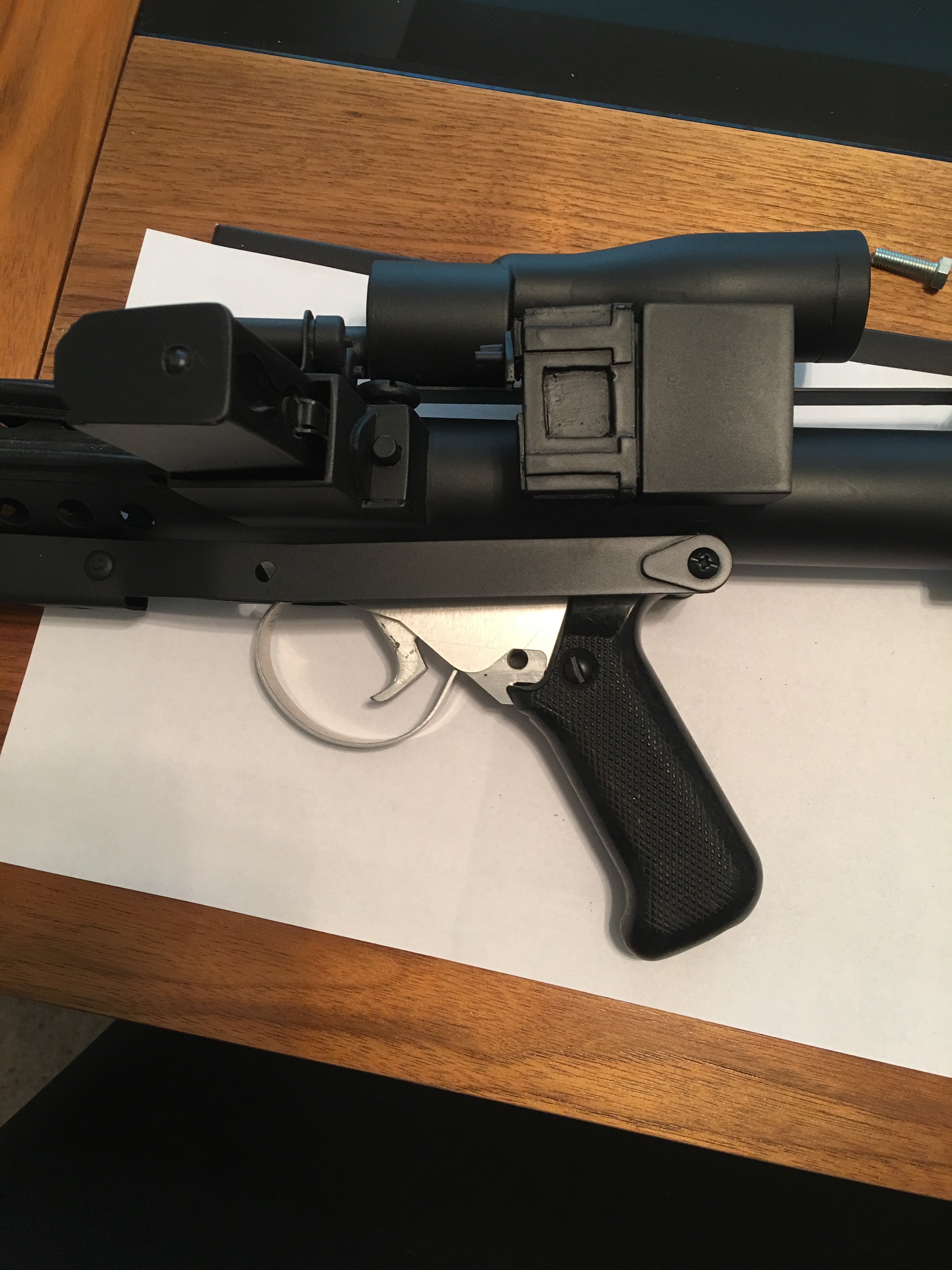

I’ve placed everything together to give you an idea of the overall look
And together with the blaster, not fixed Just held in place

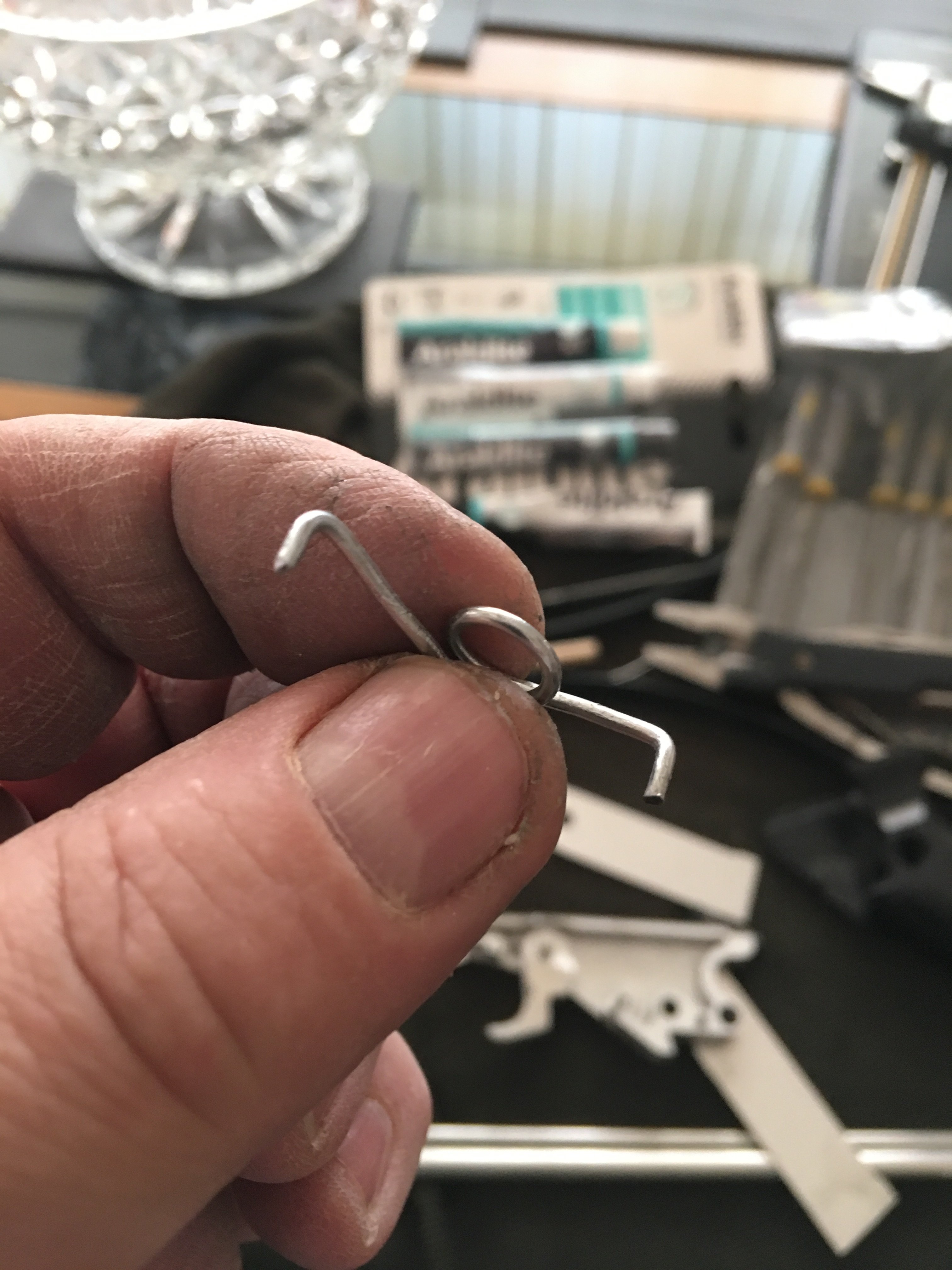

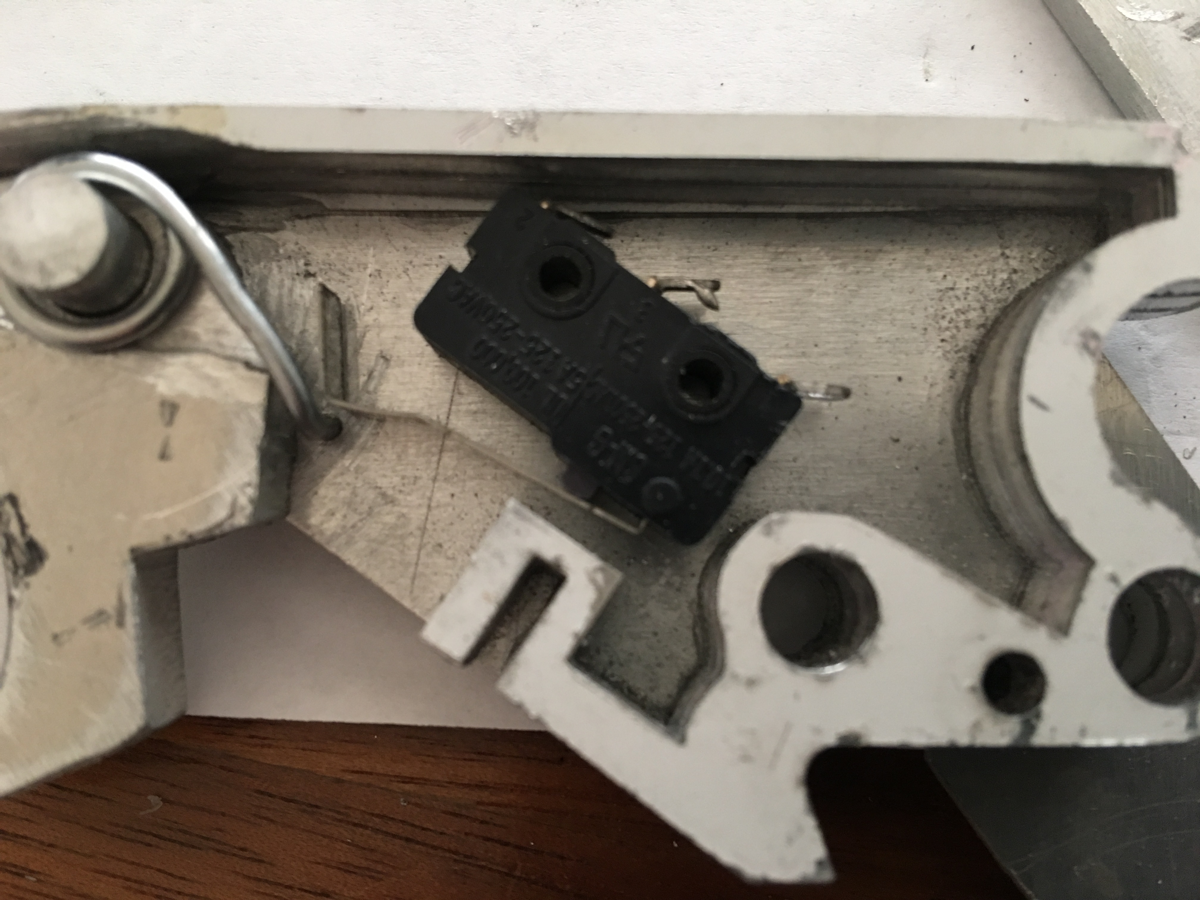

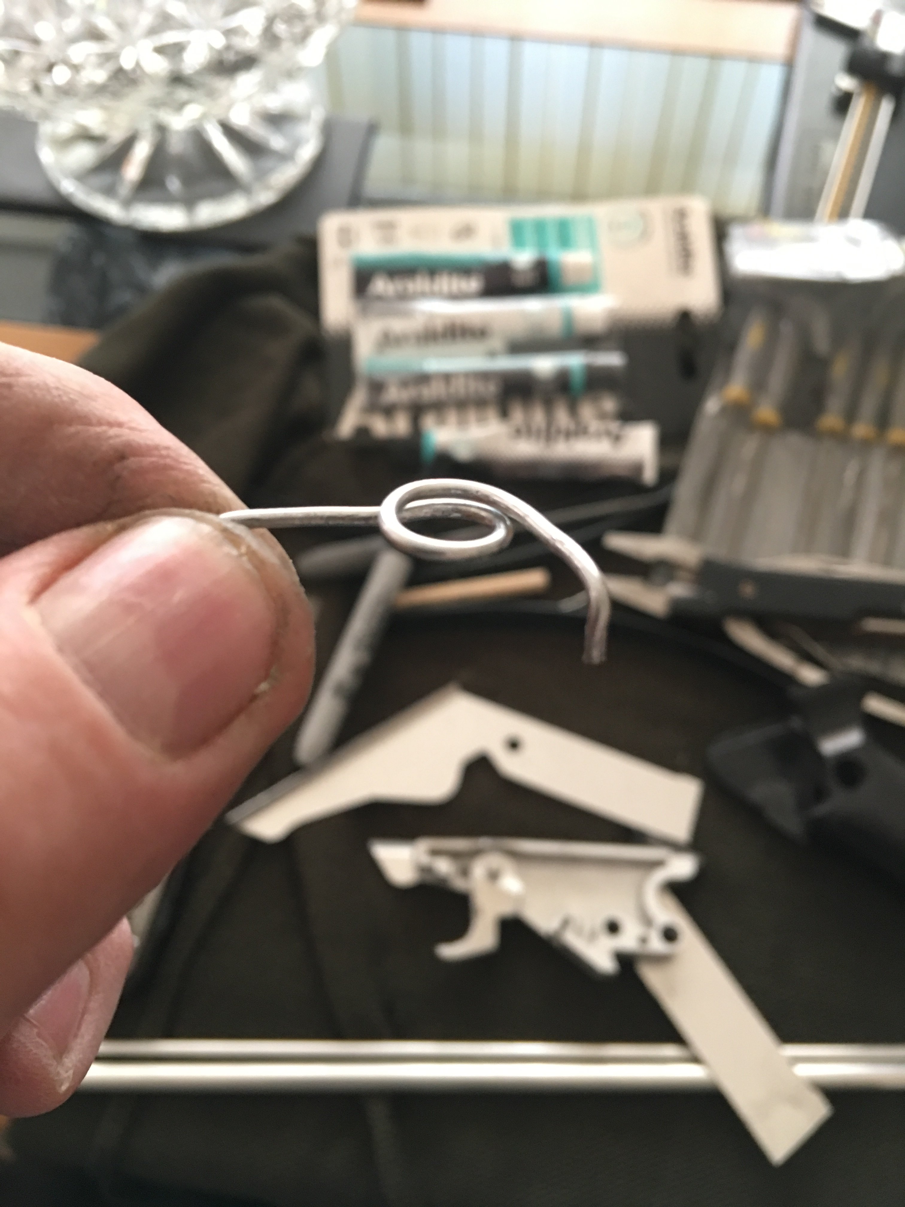

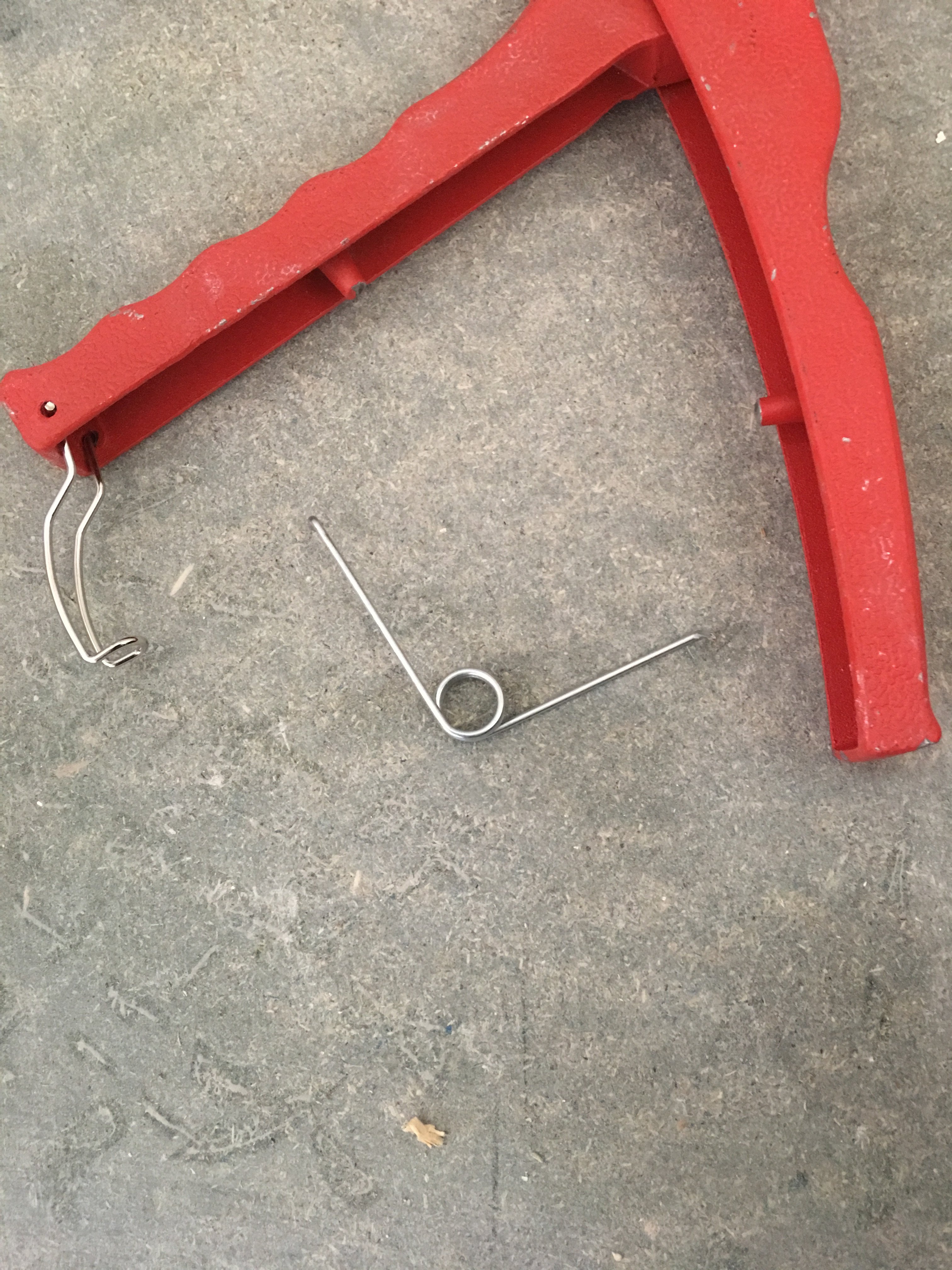

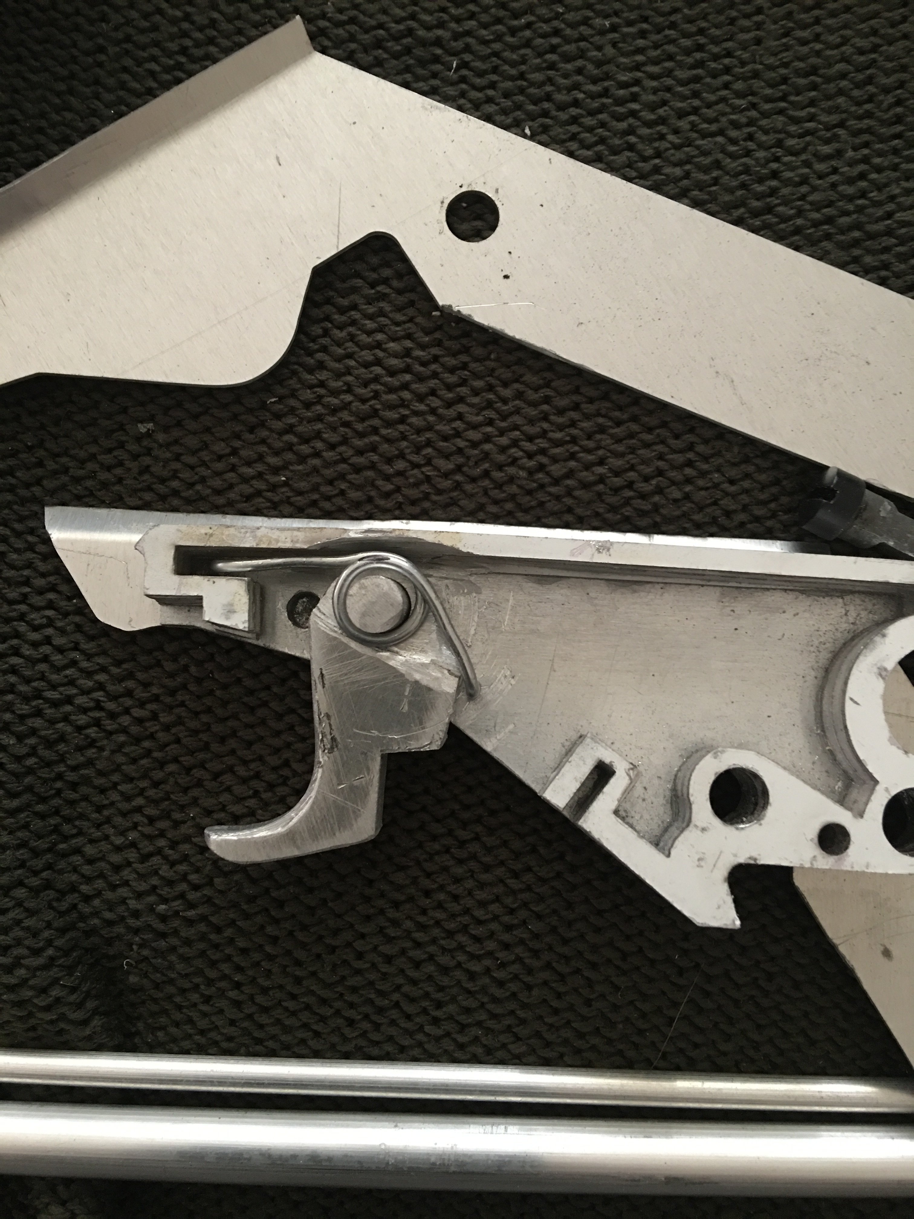

its not not much but I’ve just put a spring on the trigger
while at work today and using my pipe cutters for plastic pipe I noticed a spring I wanted for my trigger
so I removed it
When I got home I cut it up and reshaped it
Had to do a spot of cutting away away for the spring to function properly, when the cover plates are on you don’t see the butchering I had to do to get a functional trigger
CB60FFD5-E6F0-4EF9-B5D9-179EFD06A157.jpegBB49CB37-3A53-43E2-AF4E-7FDC2000E043.jpeg75B26C79-DA0F-4BF6-96ED-7D07664D88F0.jpeg
Just need to find a micro switch to fit behind the trigger

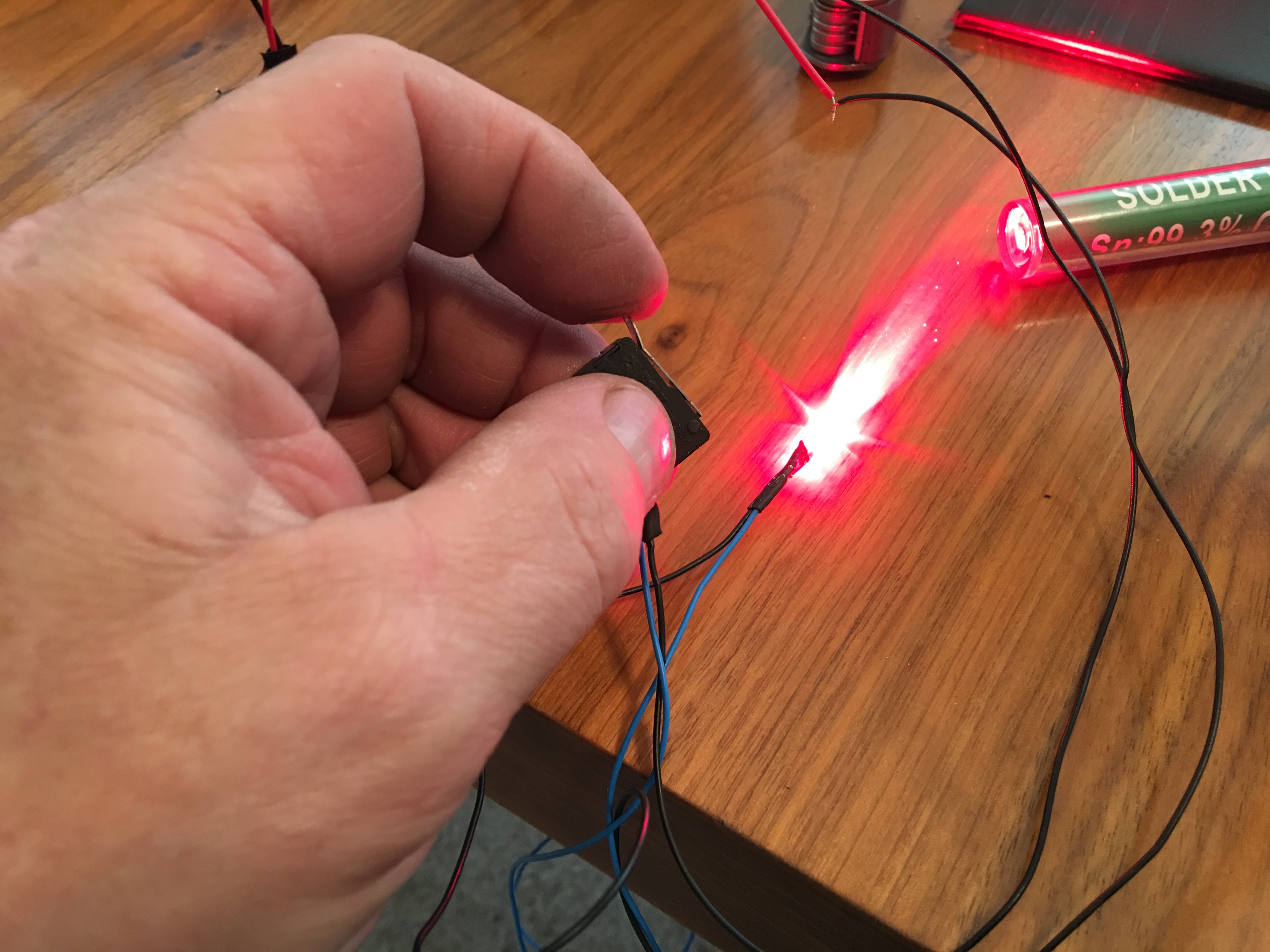

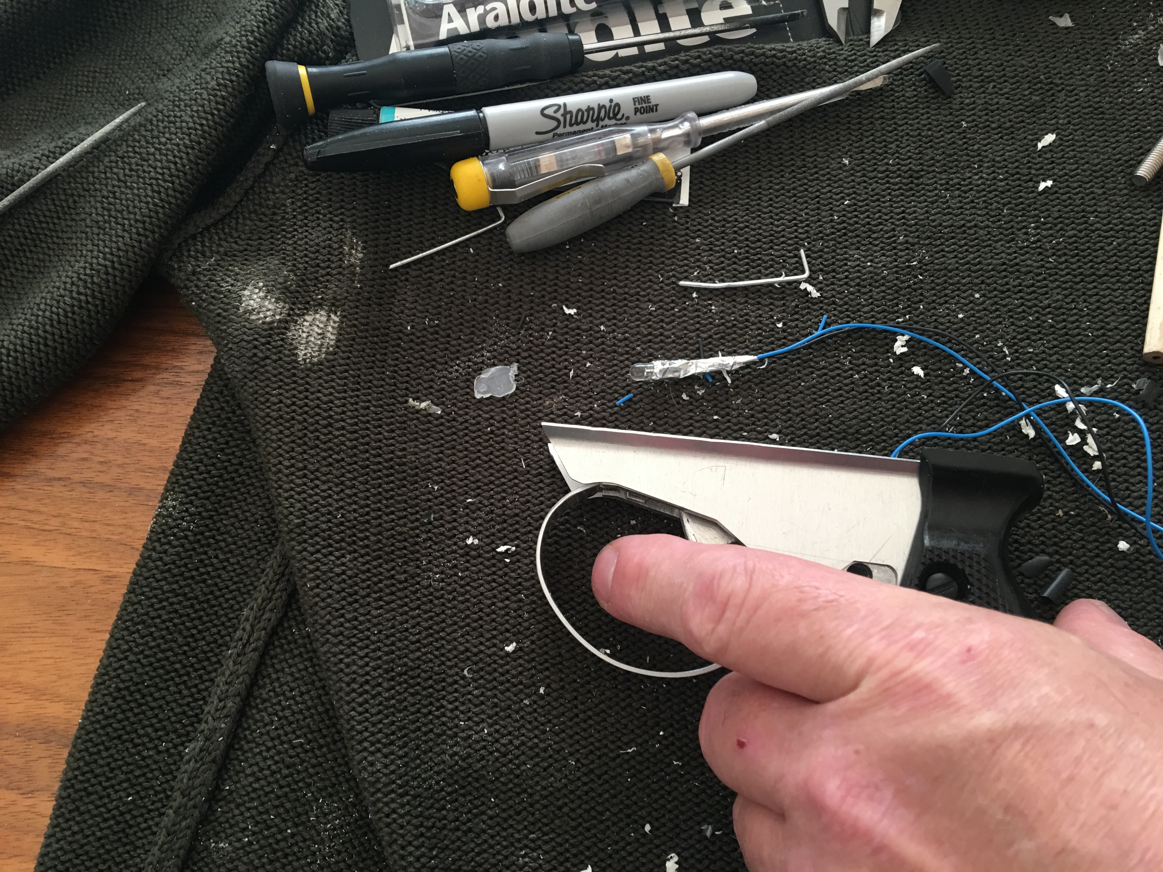

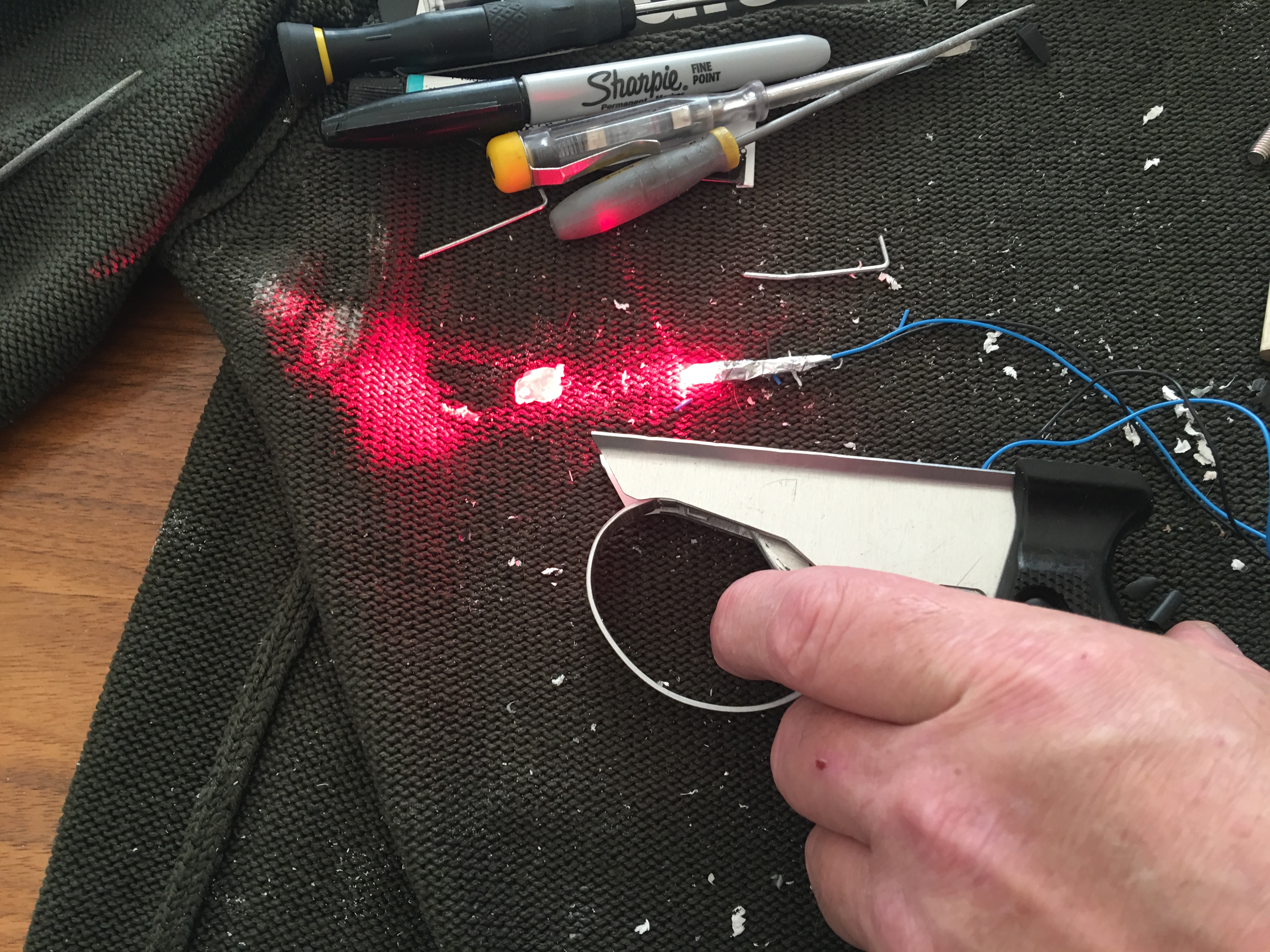

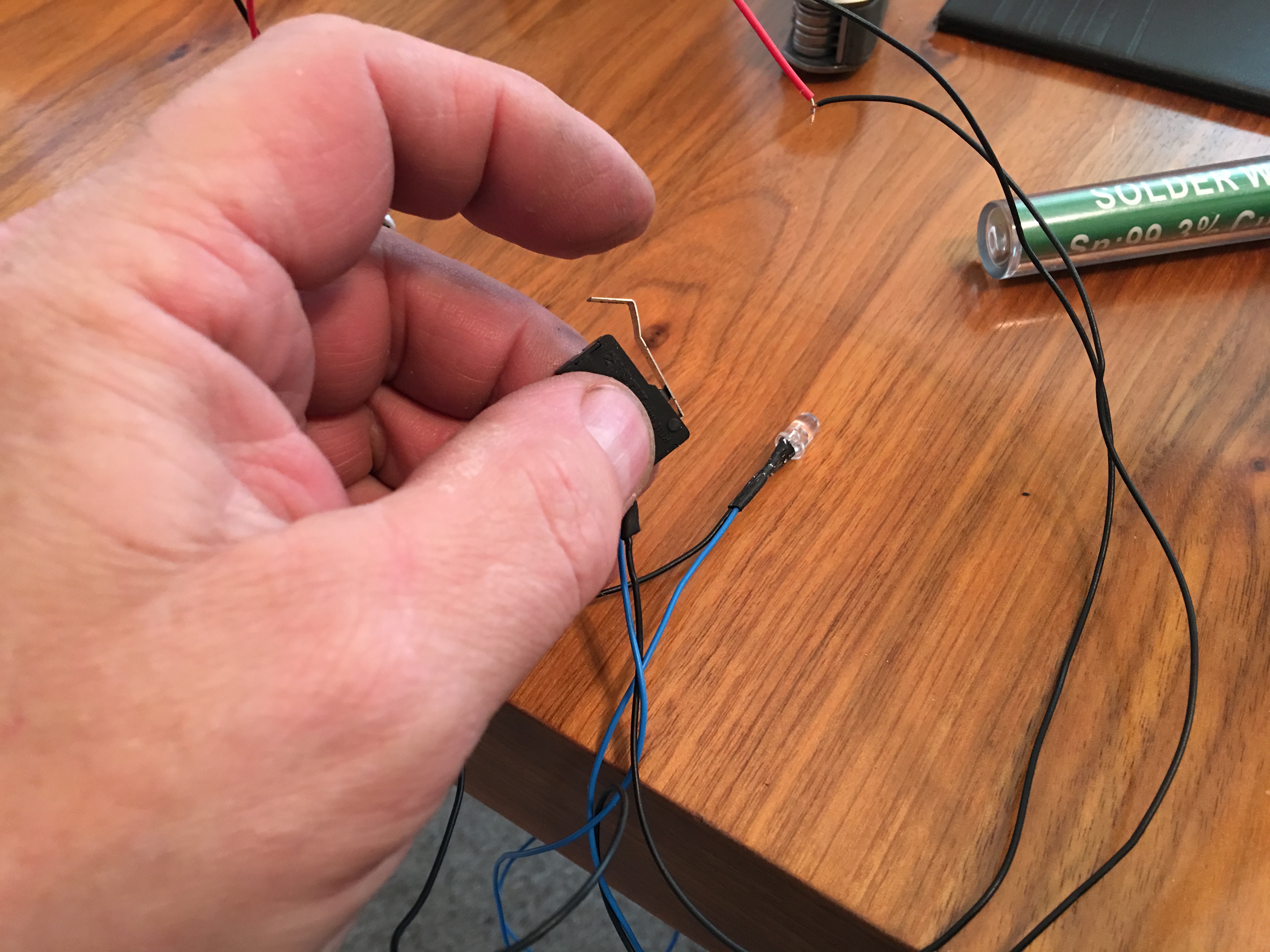

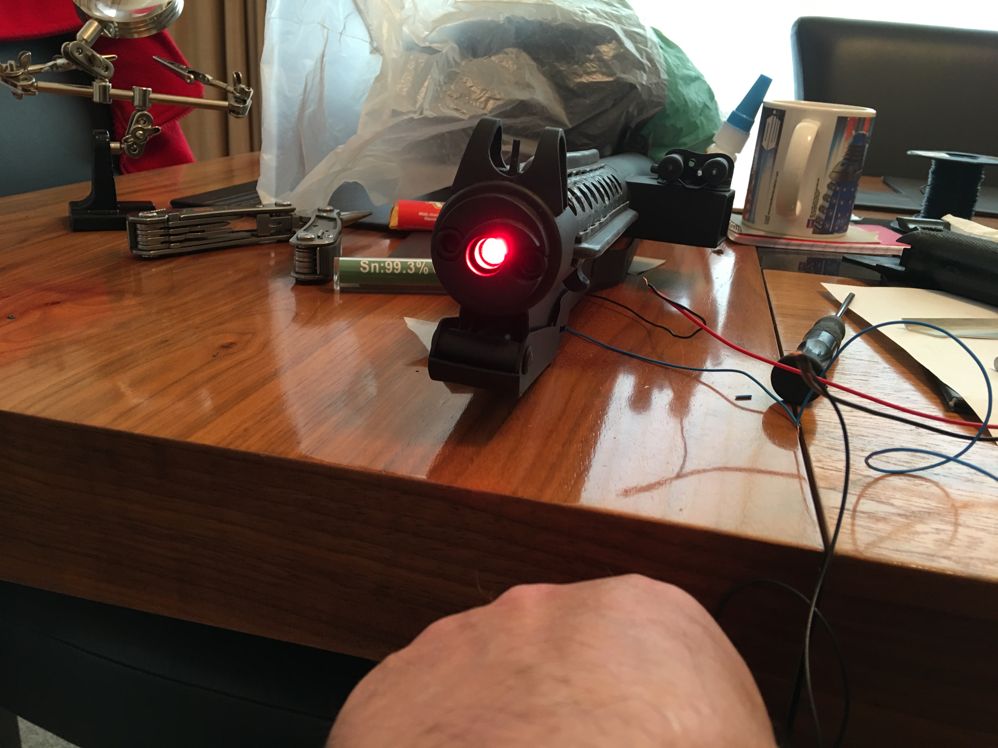

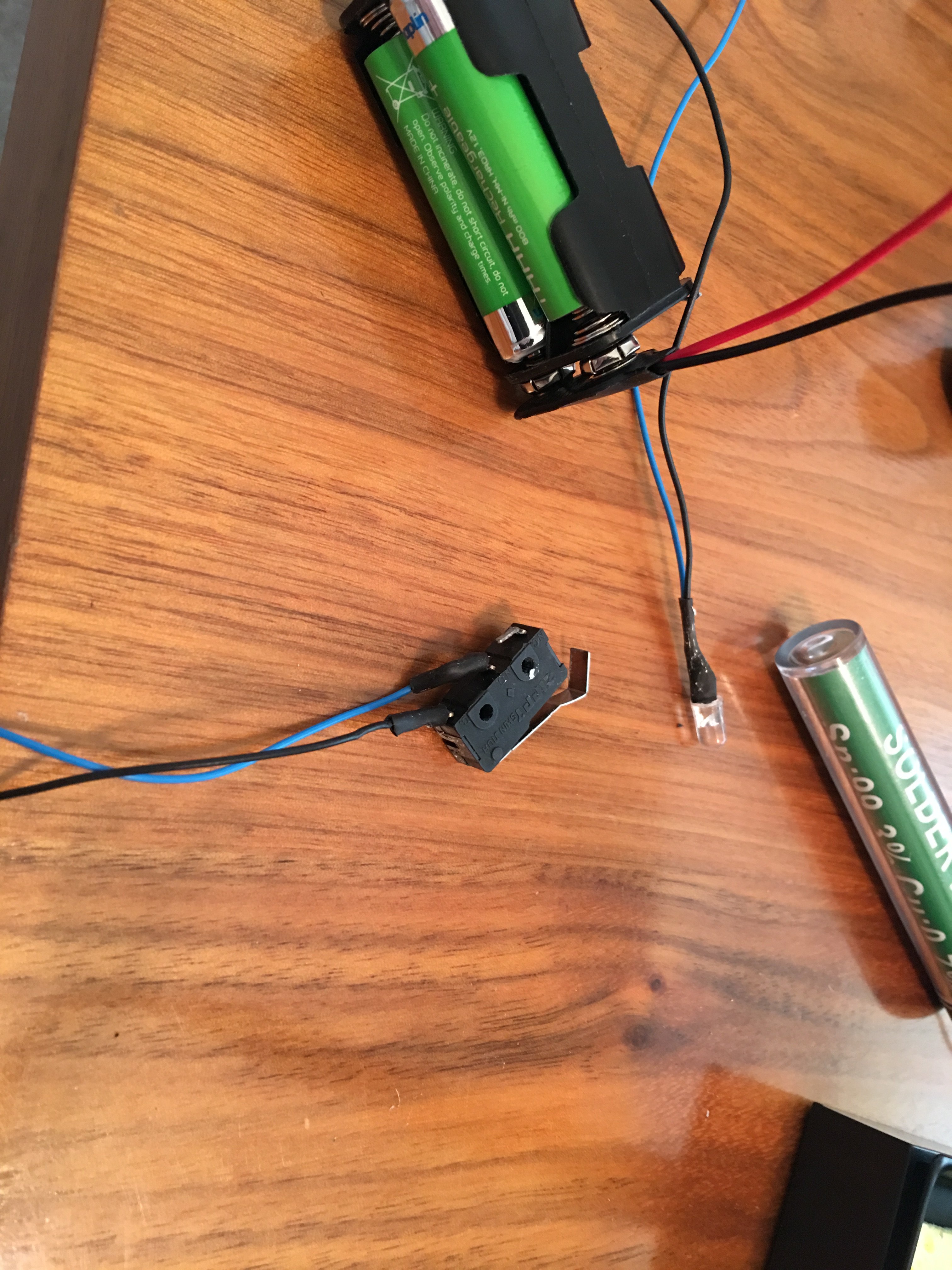

I’ve found a little micro switch, in fact I found 2 built into a motorised valve for a central heating system, it was in my scrap pile, the second switch is going to go in my ANH version E-11
With a new addition to my tools “ helping hands for soldering “ I soldered wires to the micro switch and to a red LED I had from an old project
Wiat for it ...........
FB20CED2-3E28-4807-A1F1-F6DD28478246.jpeg.............................
BOOM it’s on

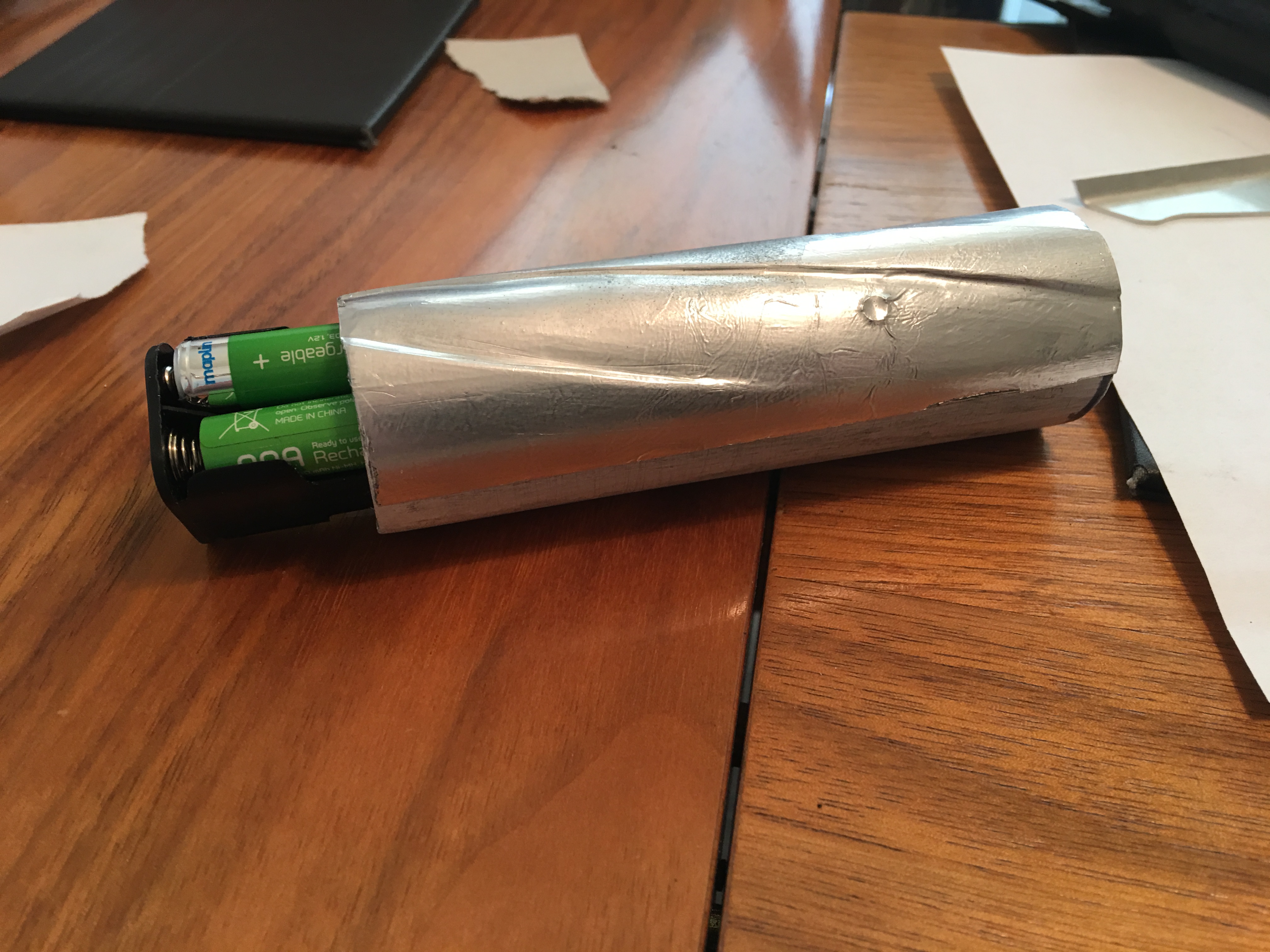

I pushed the wires down the barrel, temporarily re-wired it to see if it was bright enough
Ive also found the perfect place for the battery pack, it fits snugly into the bolt

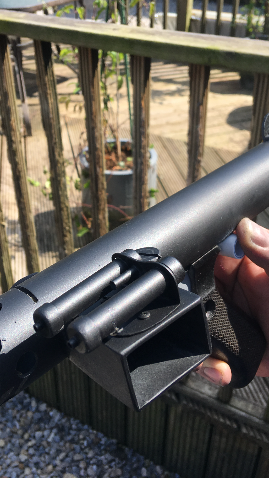

I’ve picked up some 8mm ally pipe today to make the cocking lever
Just need to put it all together now

Just a quickie update

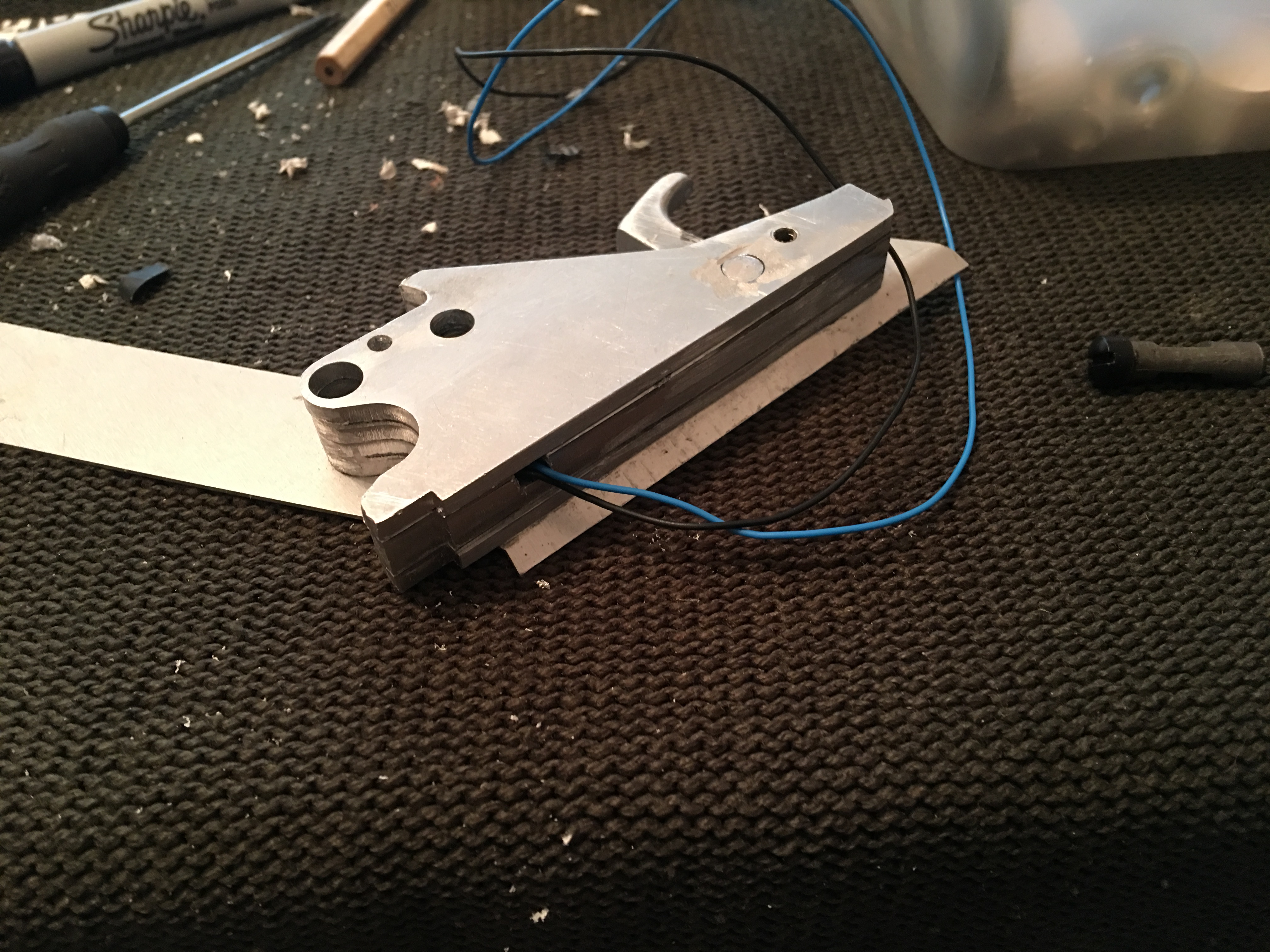

trigger section has now been put together with the micro switch fixed in place
Wait for it .........
Booooooooom !!

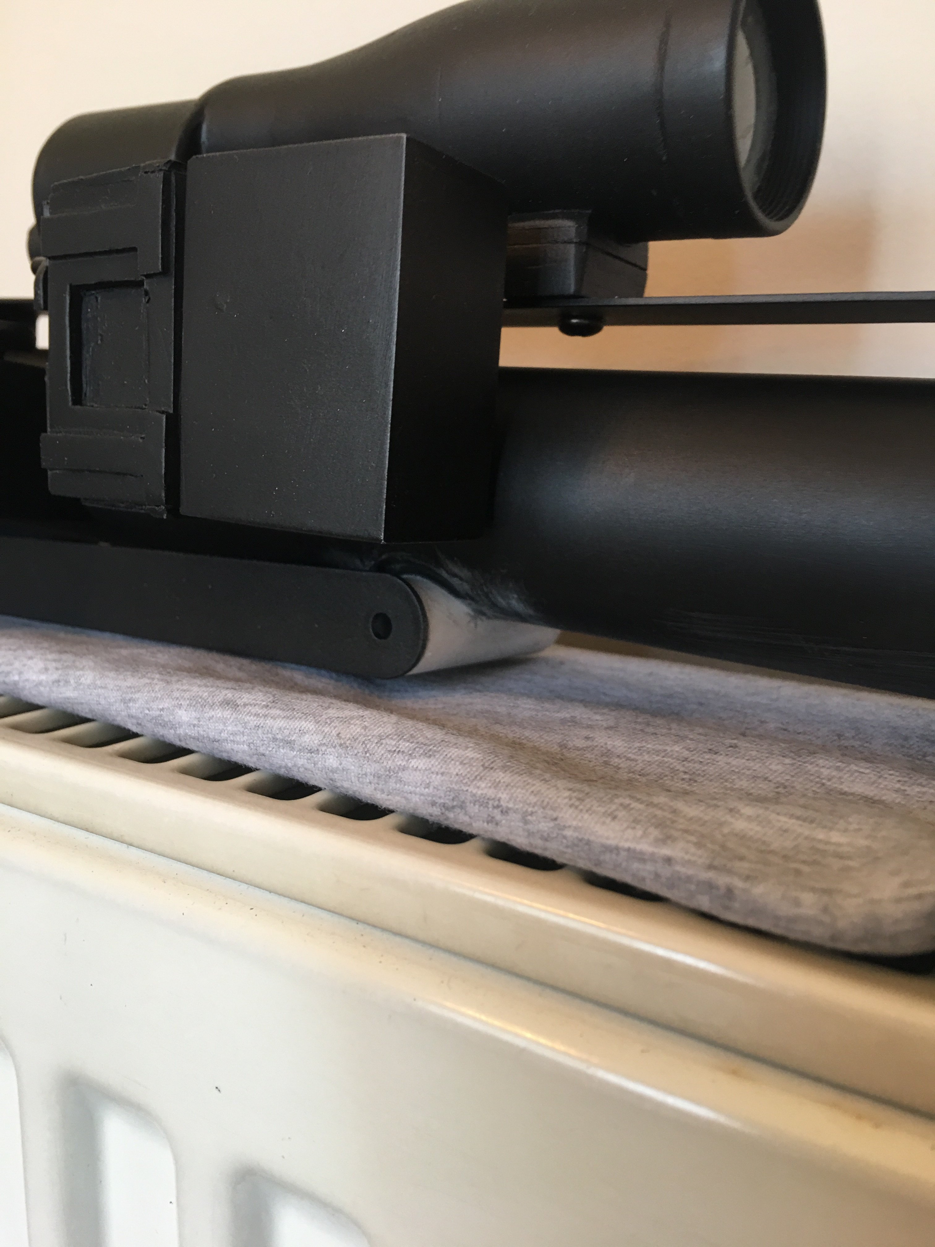

Ive also glued the T tracks in place, needs a little cleaning up, the glue went everywhere
Cocking lever and selector switch next on my list
