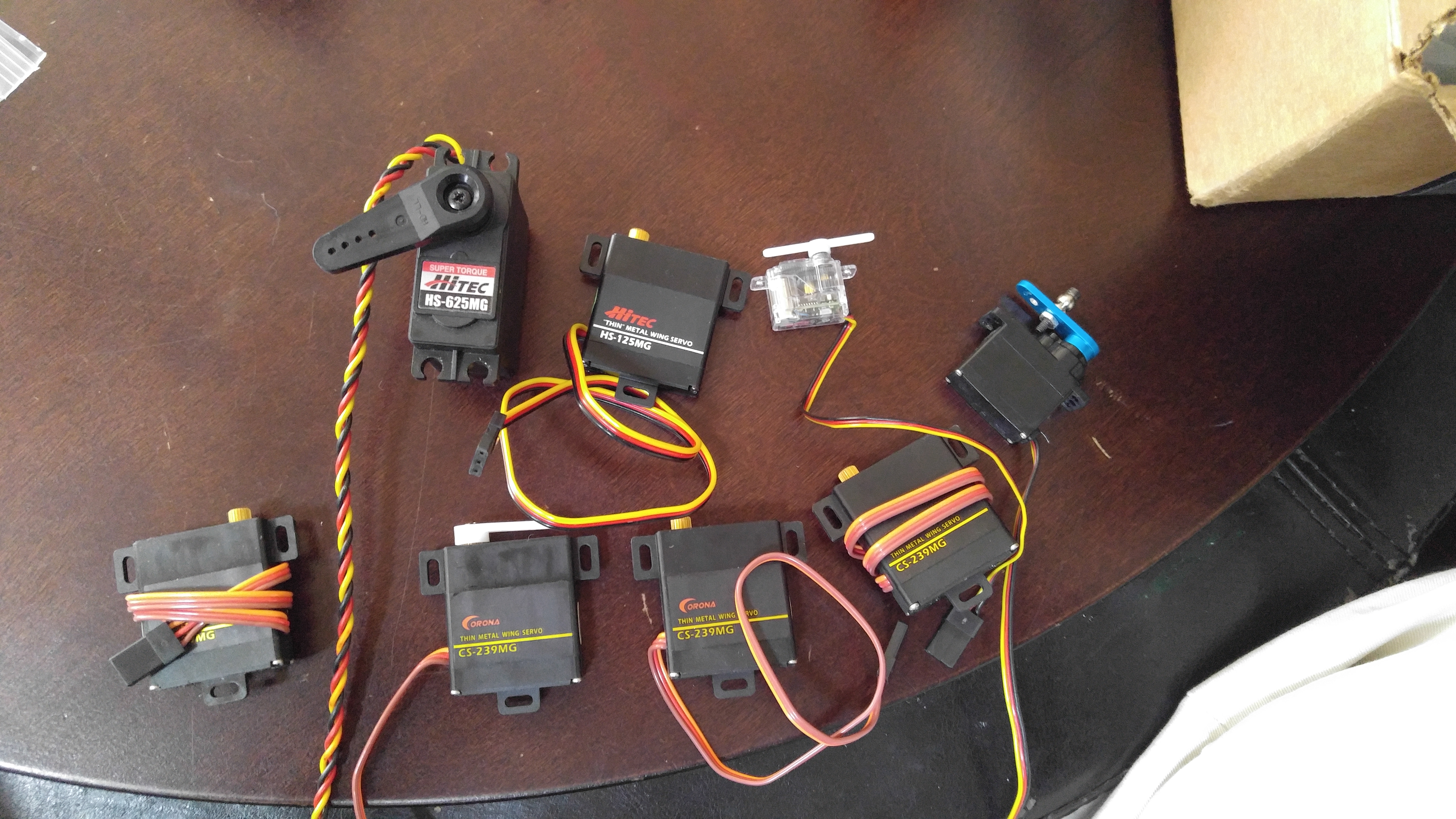

Thats A LOT of servos... just for the helmet... (not even sure why you'd need that many for the helmet alone? most basic helmets only use 2 or even 1! You have 8!!)
I'd also suggest using a dedicated servo driver board (like from Adafruit).. I believe it can control up to 16 servos or something..
I have done helmet kits.. repulsor kits, and eye led kits as well.. (all Arduino based)...
You're going to need a pretty big power supply as well.. as a hobby servo can take up a 1AMP under load. (and you have many)..

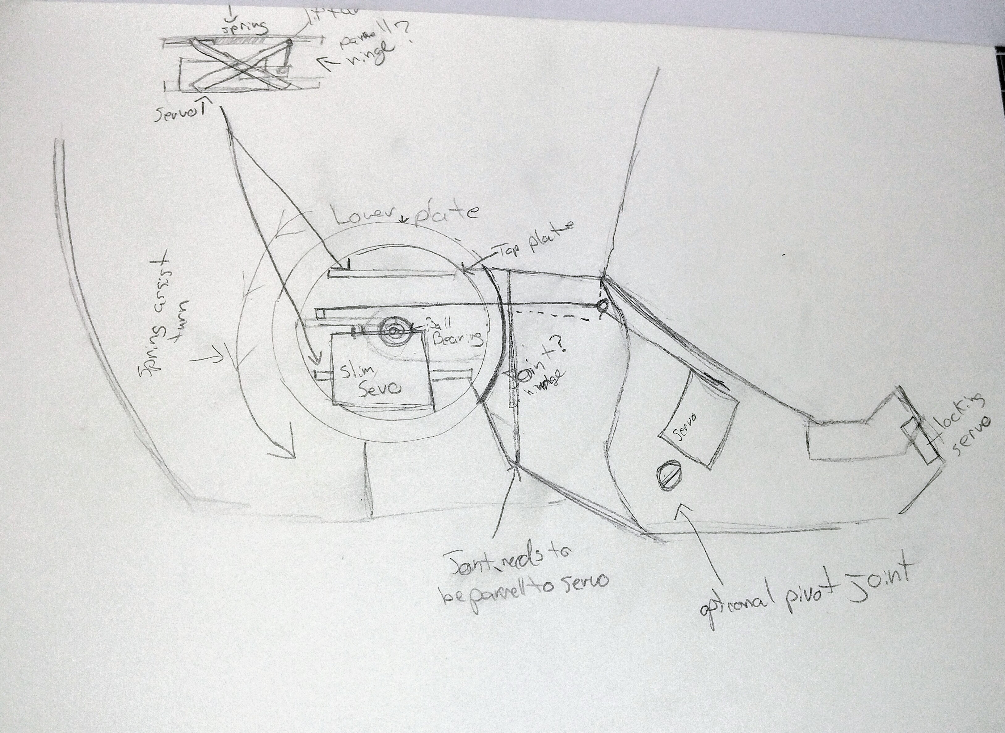

-you'll see why I need so many, as the helmet opens up completely as well as the face plate and jaw opens like most peoples do. I may have 10 servo's in there but will see if some mechanical wizardry can get it down. Every 24 servo will have there own control board that then is master controlled from an arduino. I have usb super packs for the servos, plus a lot of the joints will have tension support so the load is not directly on the servo. This will create a smooth movement and lessen the work load on the motors.

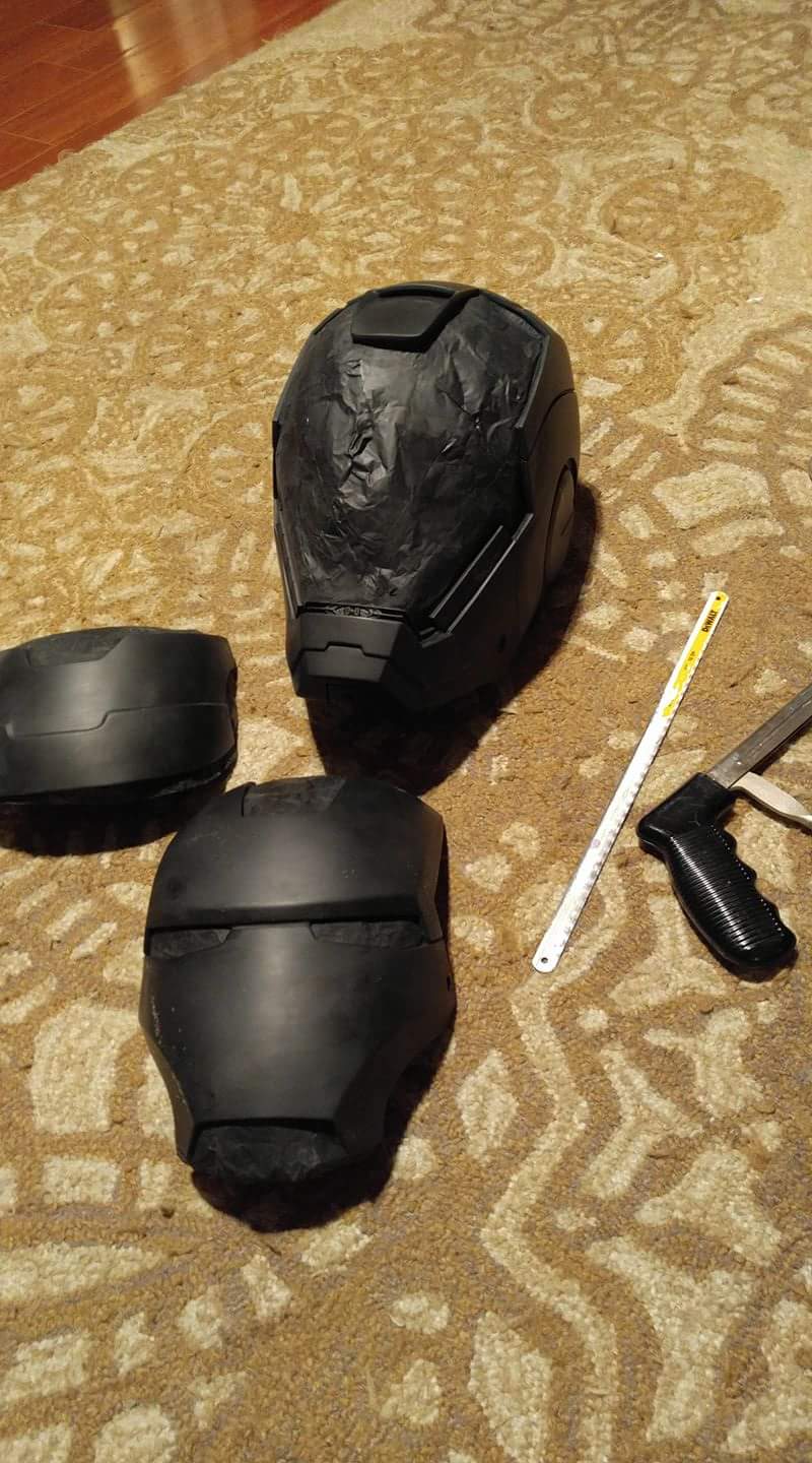

So I thought I'd start a video series on it - well at least so I can share some videos on here, it's from a youtube channel I create years ago when I thought I was going to be a youtube star :facepalm. Spent some time programming the eyes so every time the face plate lowers the light blink then fade on.

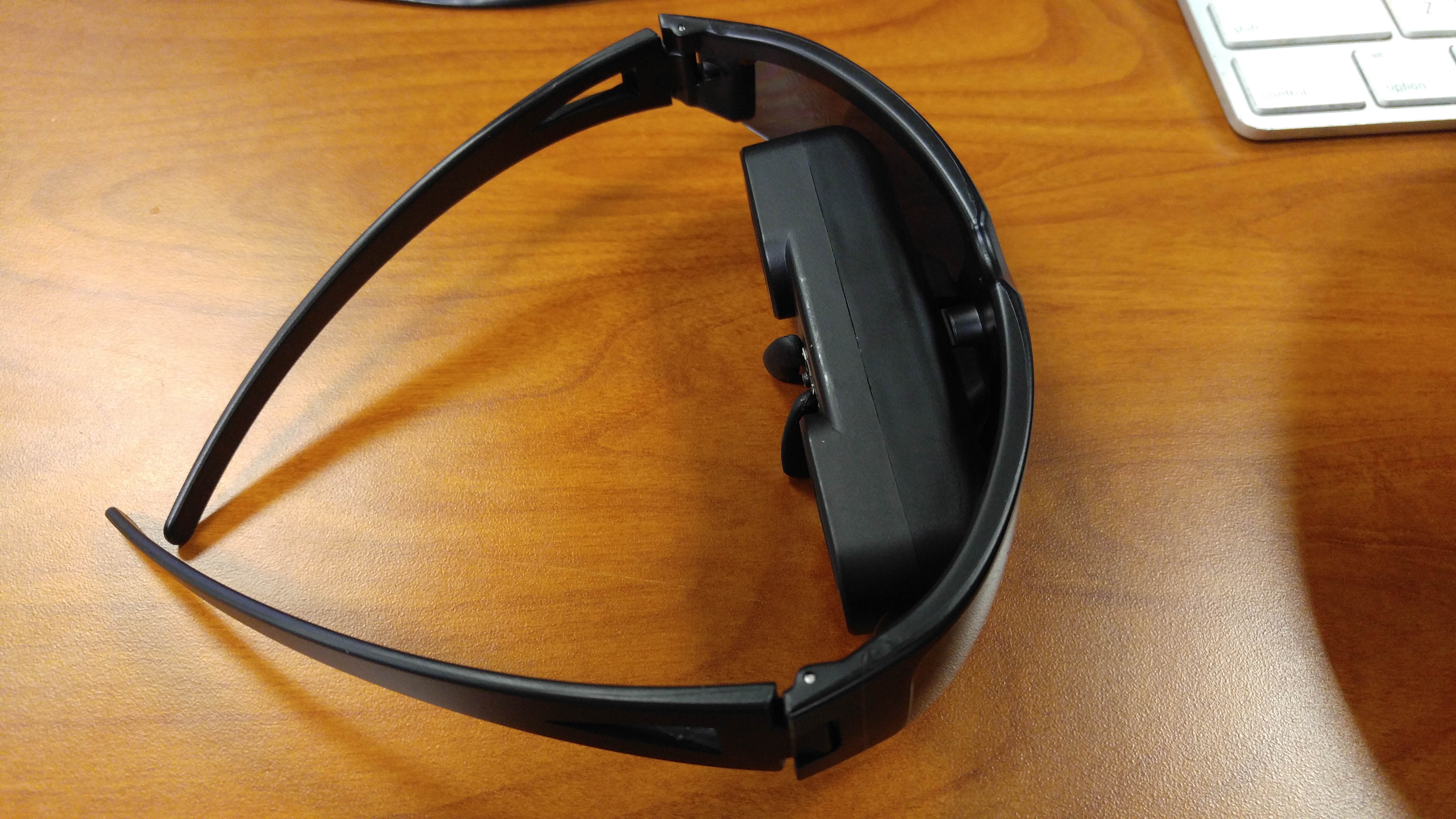

I'll have some cool updates this weekend but in the mean time my cheapy video glass came in. I'll use these with a camera mounted in or on the helmet to view everything. Then down the road I'll upgrade to a oled pair and 4k camera
