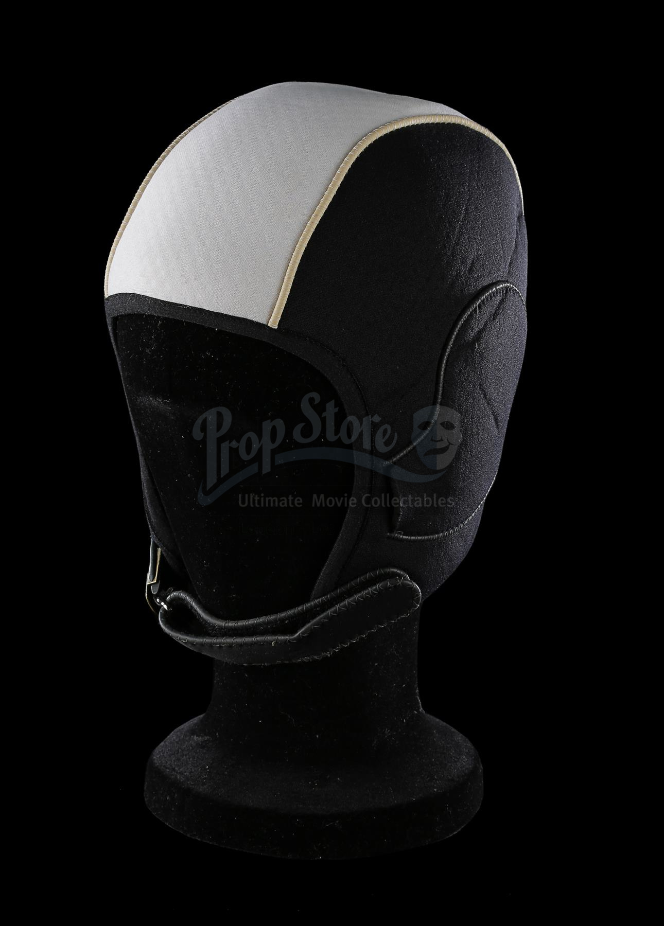

http://images.propstore.com/347623.jpg

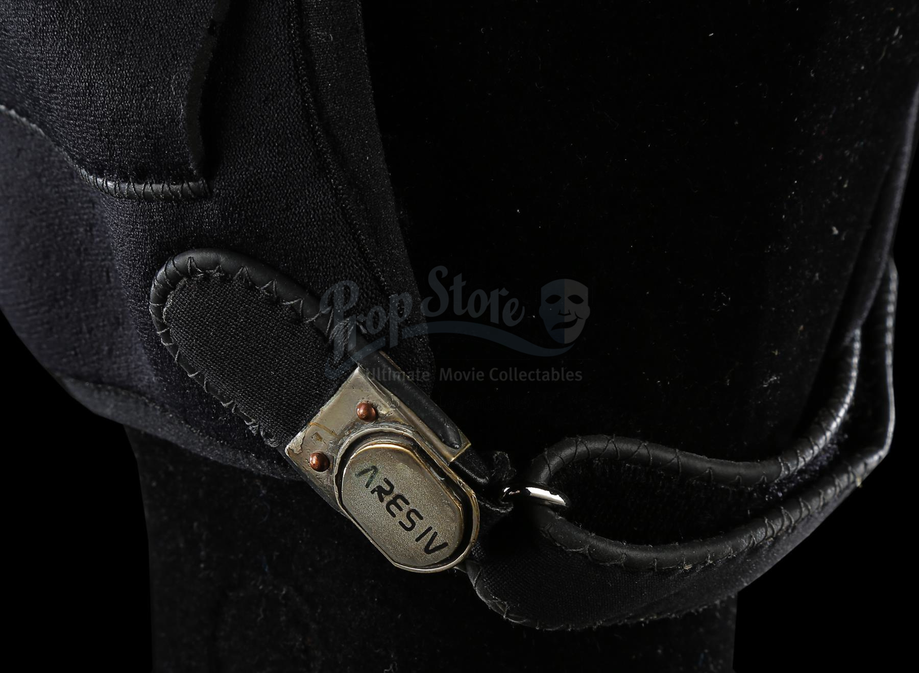

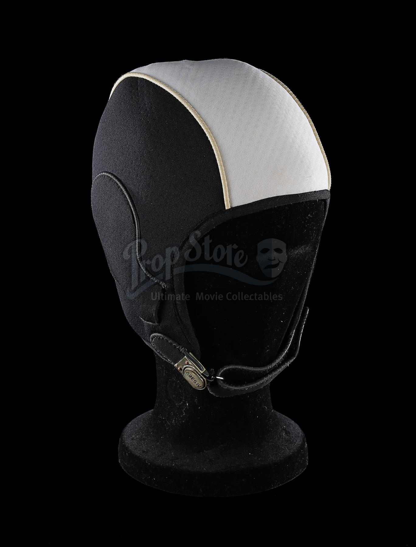

Hi Jim,

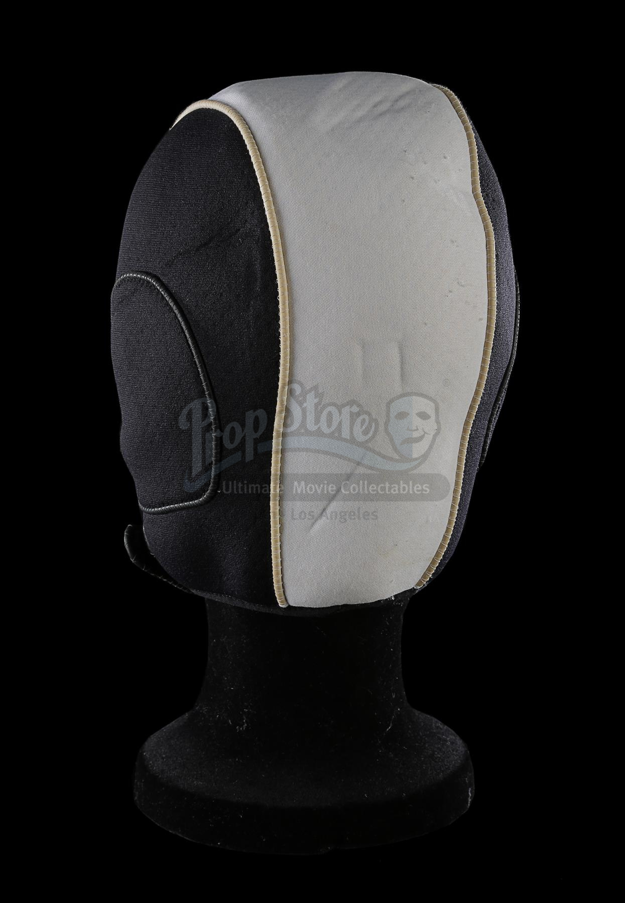

I really appreciate you helping me out here with extra reference material. The Propstore one though I belive is a stunthelmet, or possibly one of those giveaways/prices I've read somewhere about, and I'm aiming more towards the Hero-prop. Still, much appreciated.

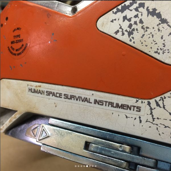

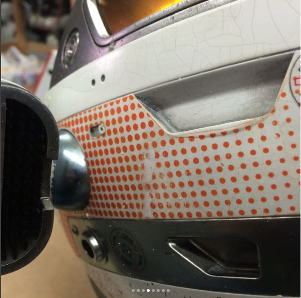

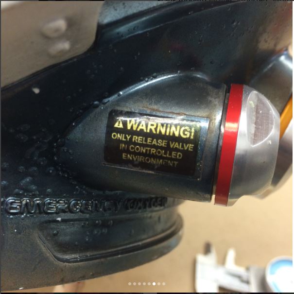

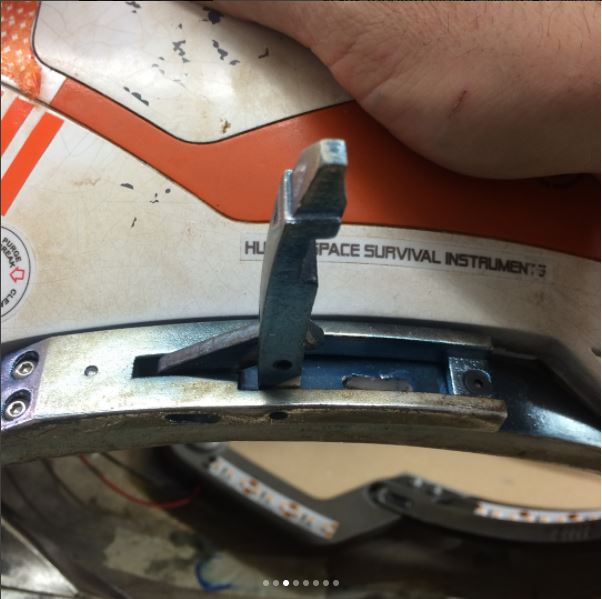

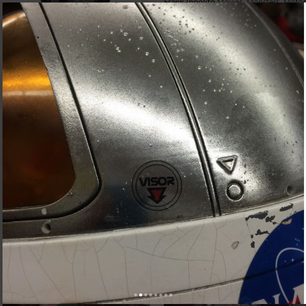

I have a lot of my reference photos from the ones Tested released, and even some that Frank Ippolito put up on Instagram.
FrankI_Insta_1.JPGFrankI_Insta_2.JPGFrankI_Insta_3.JPGFrankI_Insta_4.JPGFrankI_Insta_5.JPGFrankI_Insta_6.JPG
Excellent graphics too!

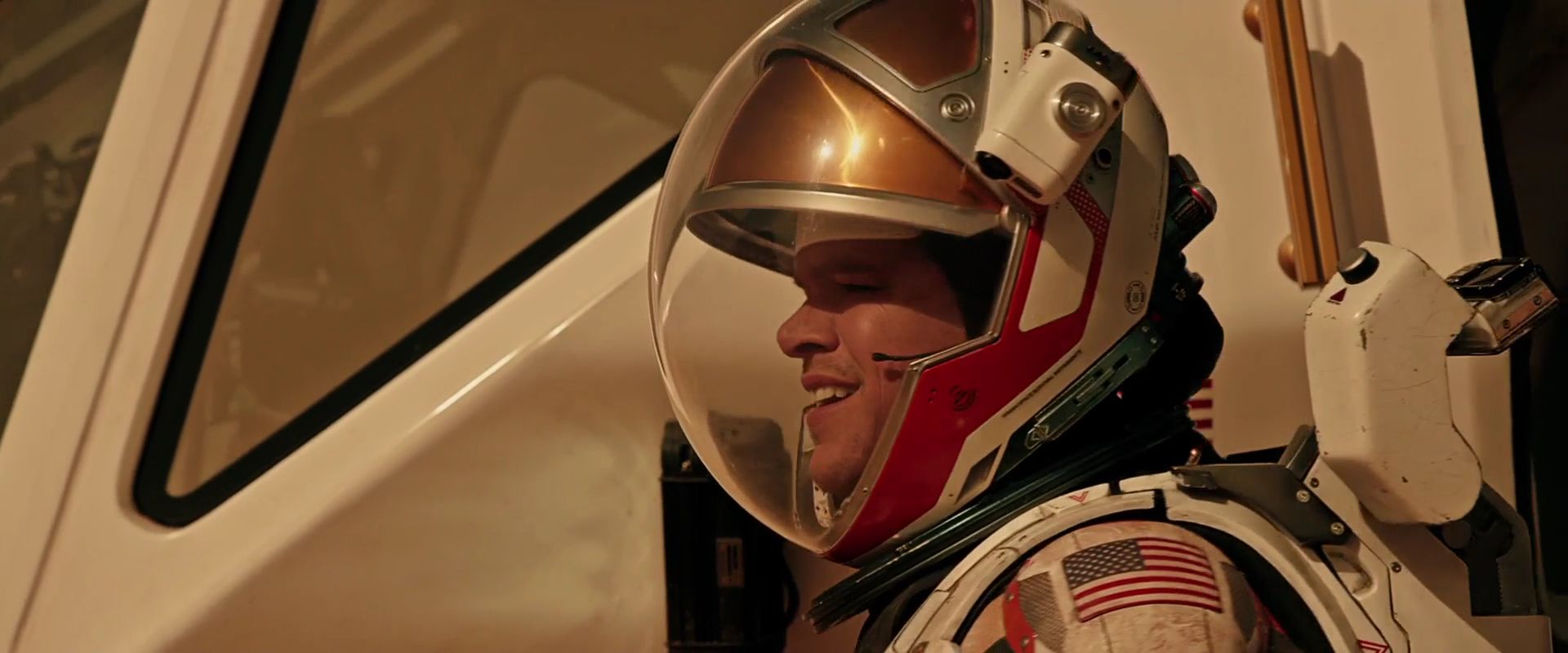

Here's the HD screen caps
http://kissthemgoodbye.net/movie/thumbnails.php?album=470
The wear and tear on your references seems to have happened after filming - Even at the end of the film the helmet is in great shape, the suit shows wear though
Jim
My favourite is pic 1020. Nobody apparantly noticed the the air-seal collar wasn't connected and that should have been the end of Watney.

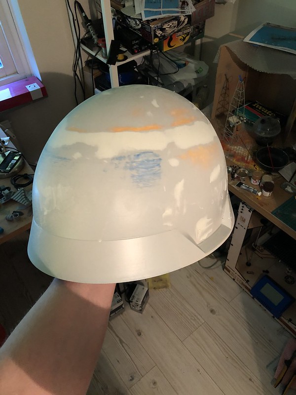

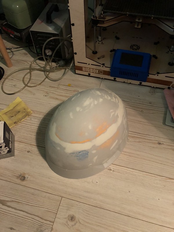

Small progress, I've been sanding some on the dome vacuum form plug:
Lots more sanding needed though....

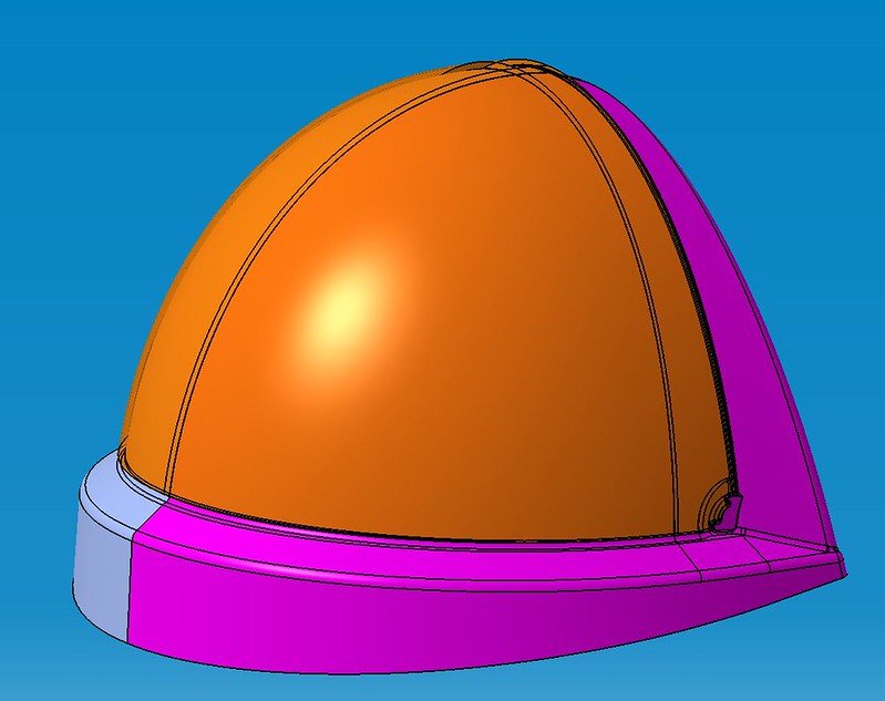

Furthermore, I have been adding some details and modified the connectors and the other details according to the given sizes from Captain Aprils drafts.

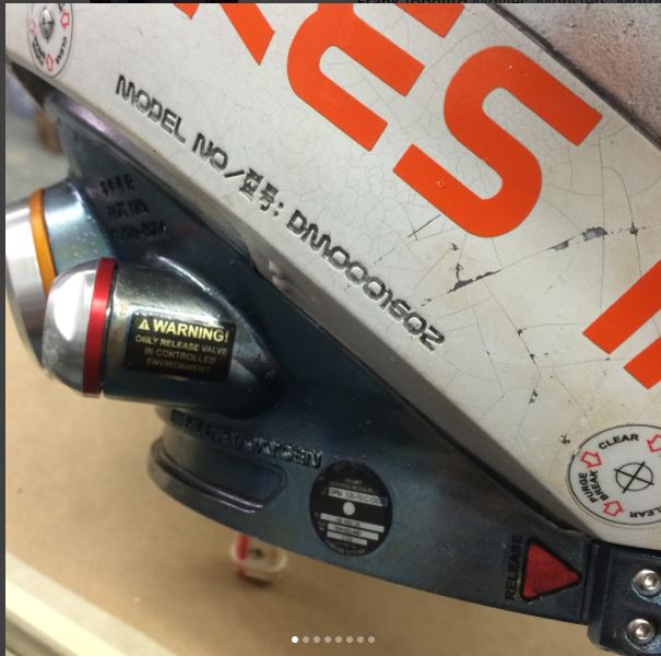

I've started to print the parts and been struggling with a worry of mine concerning the text-part on the rear panel. As I suspected, my printer can not really convey the fine details of chinese symbols so I'm taking another route here. I will order the text as fine detail prints at Shapeways and glue/fill/sand into my main printed part instead. I think that's the only way to make that section look decent. I will keep the Emergency oxygen as is in my print though since that looks good enough and any sanding in the area will be tricky as hell.

Chinese symbols on my print:

All pieces printed, Let the sanding begin!(Whenever there is time that is, I'm doing this between regular work and feeding my kid)
Been doing a lot of sanding of the Vacuum-form plugs(With lots more to go). I'm struggling to find someone to assist me in doing the actual forming though, but I might have a lead in the fair capital of Sweden :) I Won't use these actual parts to do the forming but instead I'll make a cast of them in dental plaster that should be more able to withstand the heat and such of the forming process.
