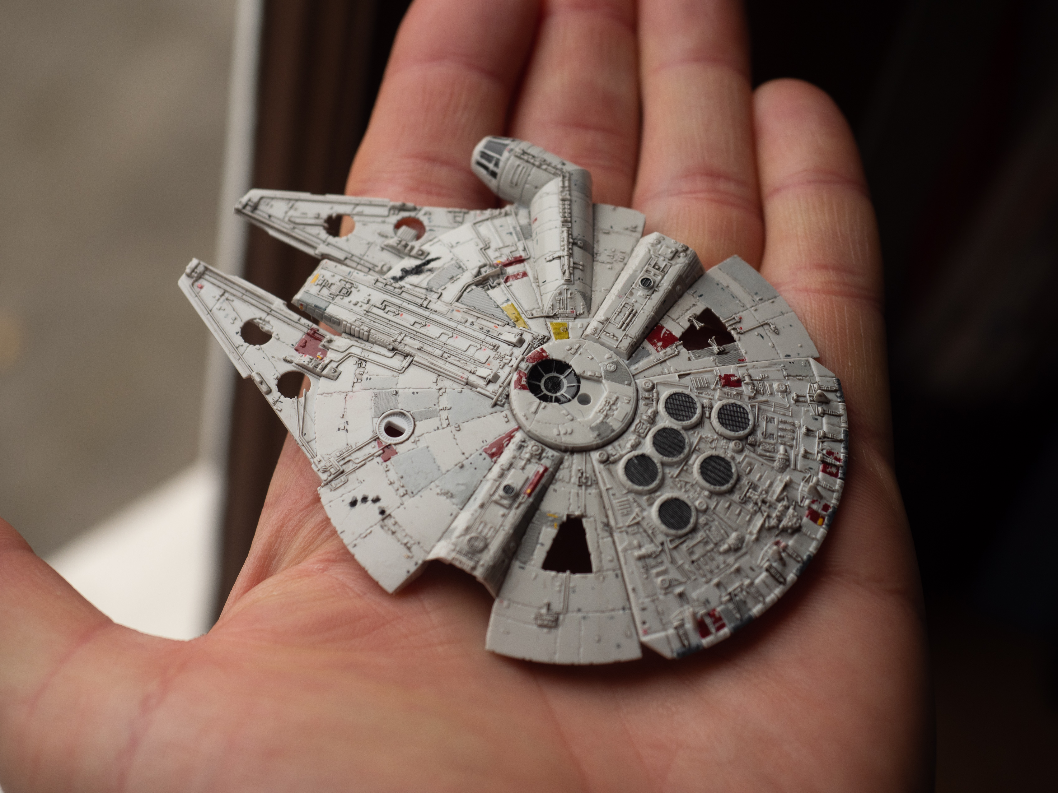

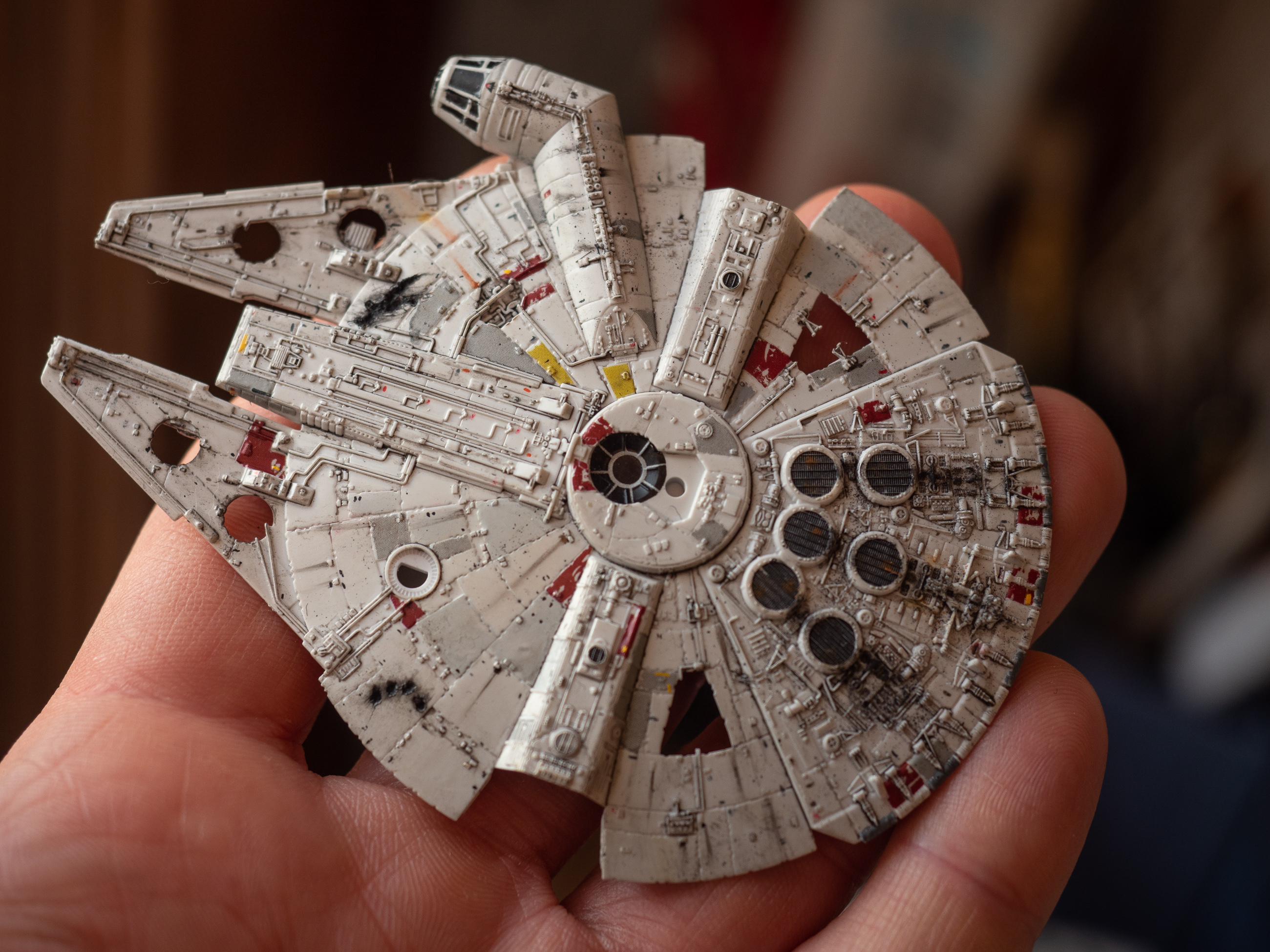

The other day I started another build of the Bandai vehicle model (1:350th scale) Millennium Falcon. I'd already built one, but wanted another that would be a bit more accurate (and reflect everything I've learned since I built the first one).
On this one I'm trying to pack as much detail from the ANH 5-footer model as I can, into this tiny palm-sized model. I'm using archival ink pens (Pigma Micron 0.1mm and Copic Multiliner 0.03mm) for some of the markings, specifically the hash marks that are all over the model.
Here's the current state -- so far I'm going from bare plastic all the way to done on the top half only, to verify everything works to my satisfaction, before doing the underside (and also to avoid getting bored of adding hashmarks for hours :) ).
I've also been taking pics of each stage, to be able to view the whole progress, which is kinda fun.

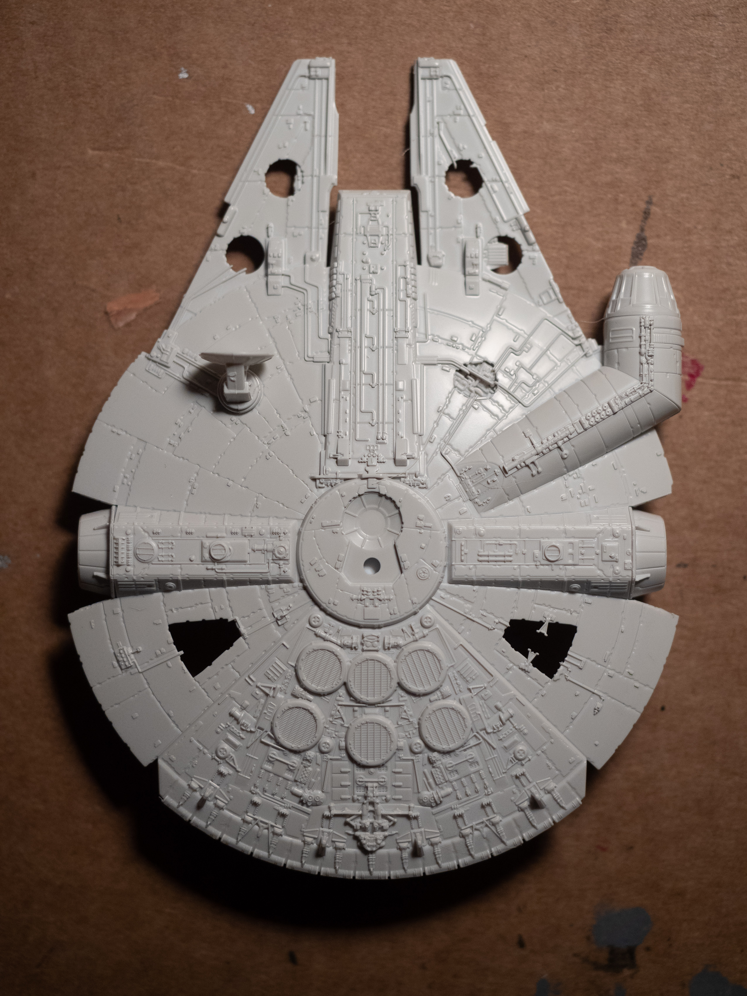

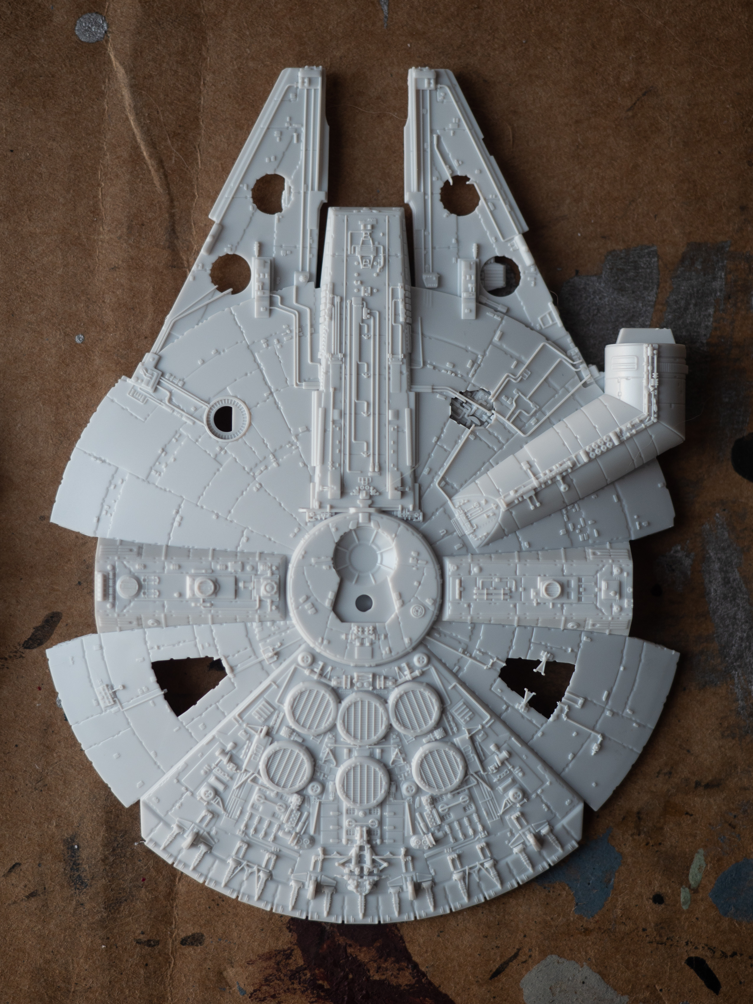

Stage 1 -- bare plastic.

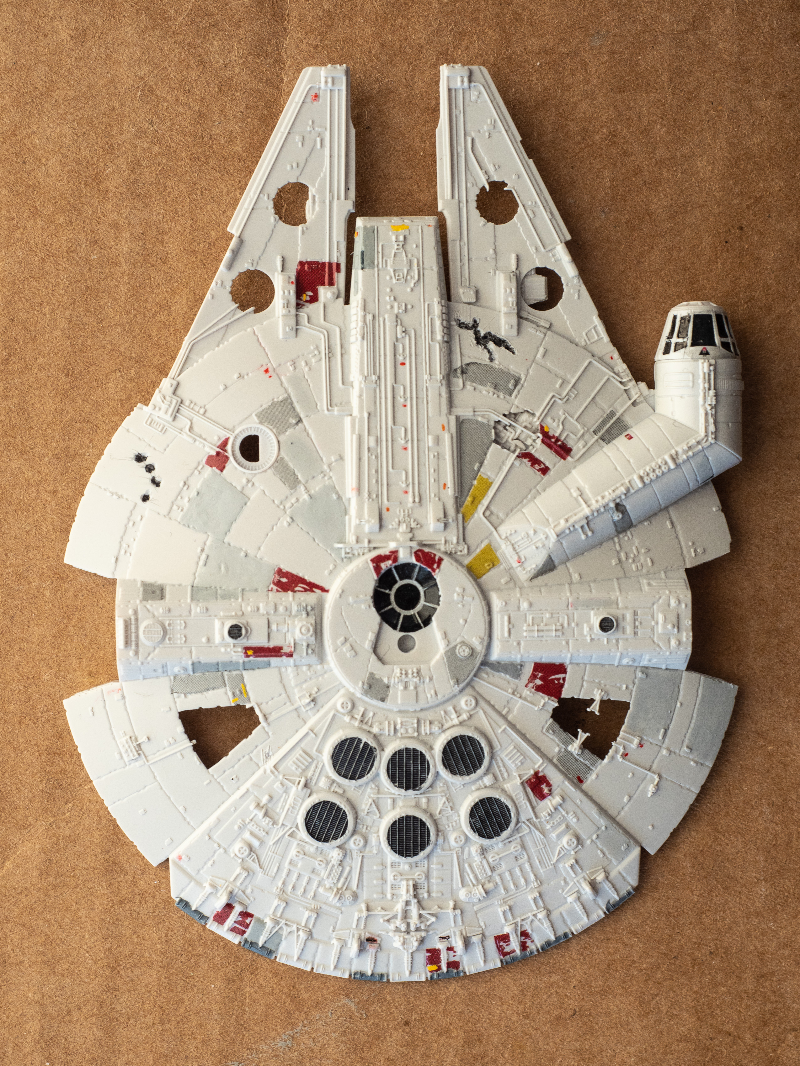

Stage 2 -- base coated with Tamiya AS-20

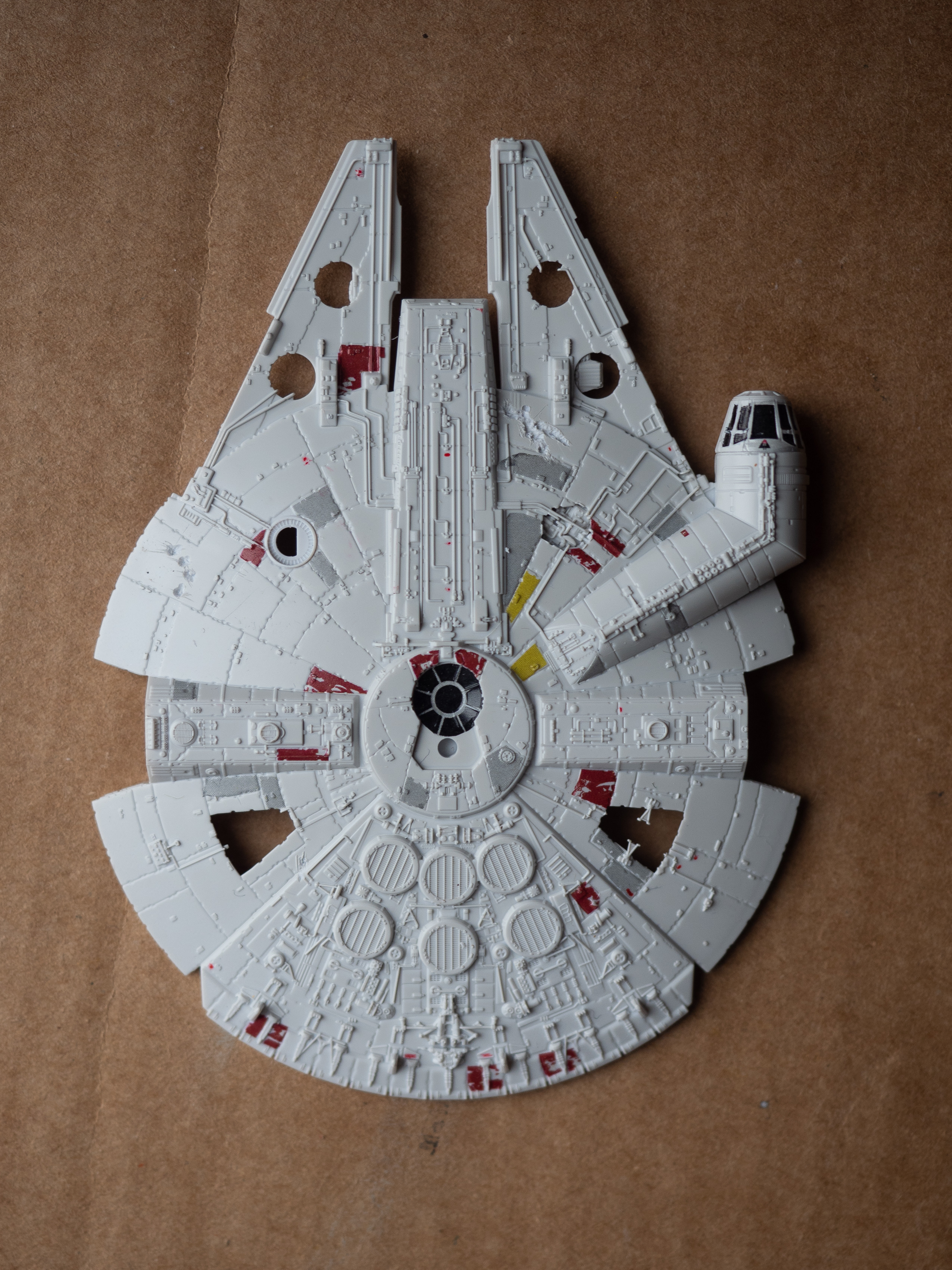

Stage 3 - I've applied the decal set from Otherworld Models, and also added some of the small red hash marks using a Pigma Micron ink pen. I've also carved some of the hull damage using the point of an X-acto knife.
Stage 4 - brush painted more panels and additional details, based on 5-footer reference.
Stage 5 - added hash marks all over, using several different pens with tips ranging from 0.1mm down to 0.03mm.
Stage 6 - added a clear gloss coat to seal everything in and provide a better surface for washes, then pin-washed most of the surface with Citadel Nuln Oil Gloss (I like the Gloss version because it flows a little more quickly than the flat version)
That's where it stands right now - I'm really pleased with it. Adding some more wash detail tonight, and basic pastel weathering for the engine exhaust and around the maintenance pits before sealing it with a flat clear coat, which will be the base for streaking.

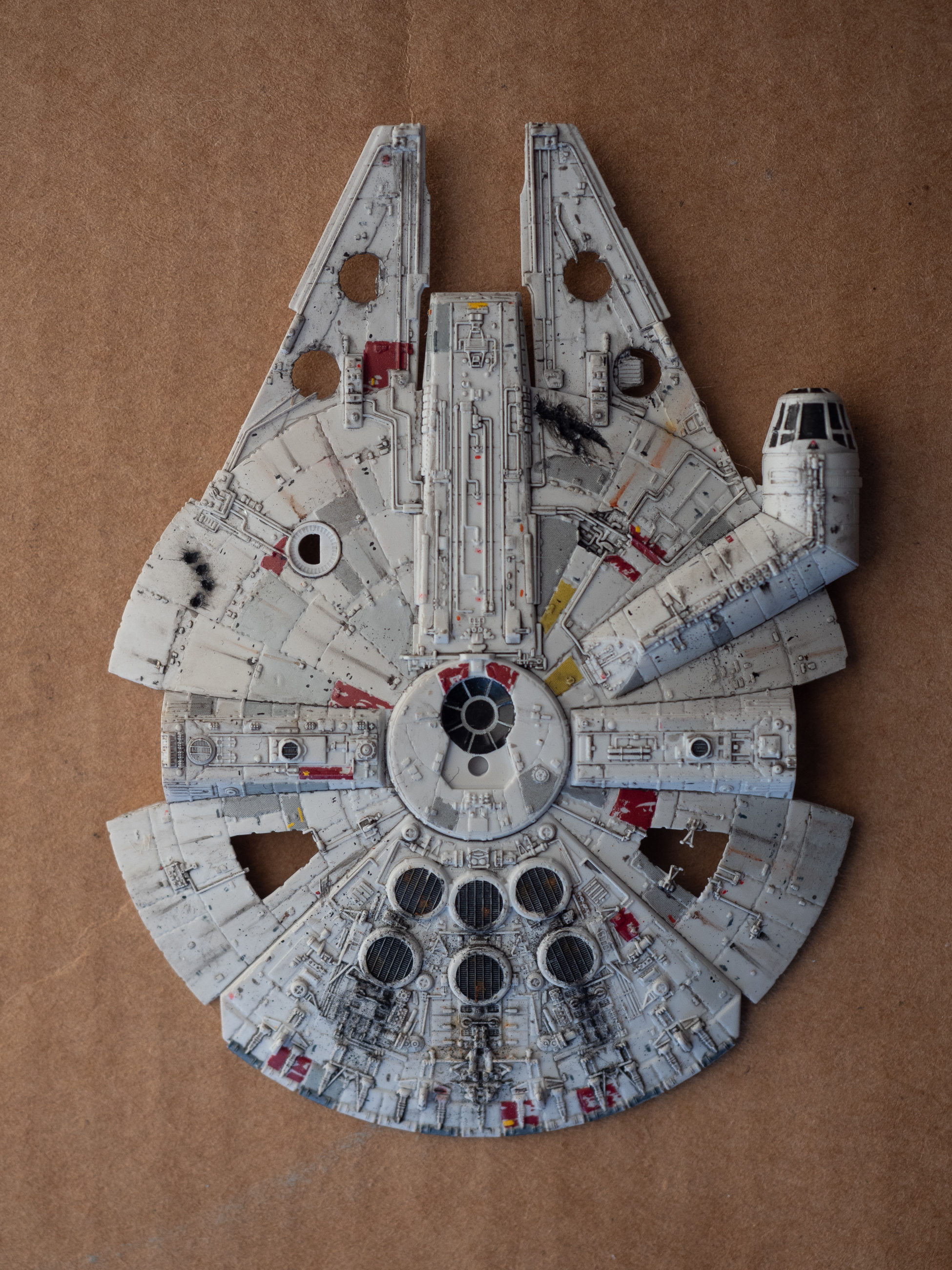

I made my first real mistake on this one - I failed to brush off the pastel sufficiently before clear coating, so there's a scattering of pastel all over the model that's now sealed in under clear coat. Oops! It doesn't look bad at normal viewing distance, but it does make the tiny hash marks a little less distinct.
So here's Stage 7 -- added Soot and Orange Rust Tamiya weathering master pastels, applied with one of those teeny tiny brushes that are meant for superglue application. Then I applied the clearcoat to seal it in (along with the mistakes), and added a few streaks with the Micron pens. I could actually be quite happy to call it done here, but it should get a few more streaks.

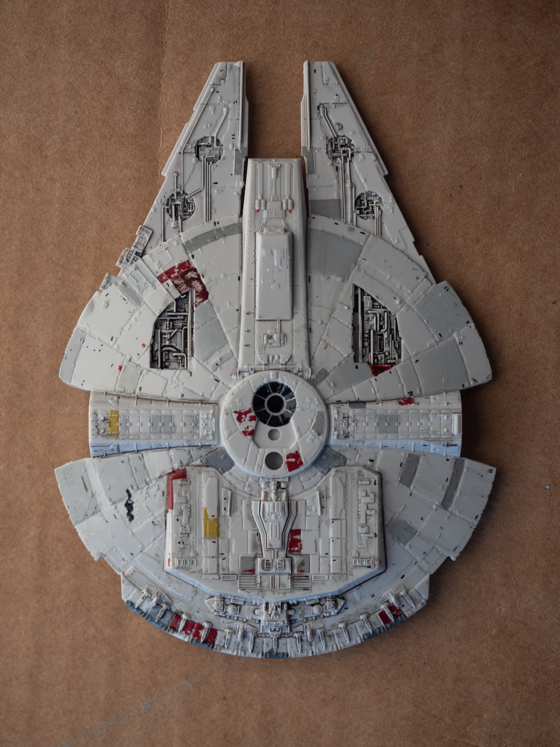

And I started on the lower hull -- here it is with just the decal set applied. Just like the upper, there's quite a few panels to paint, as well as adding the hash marks.

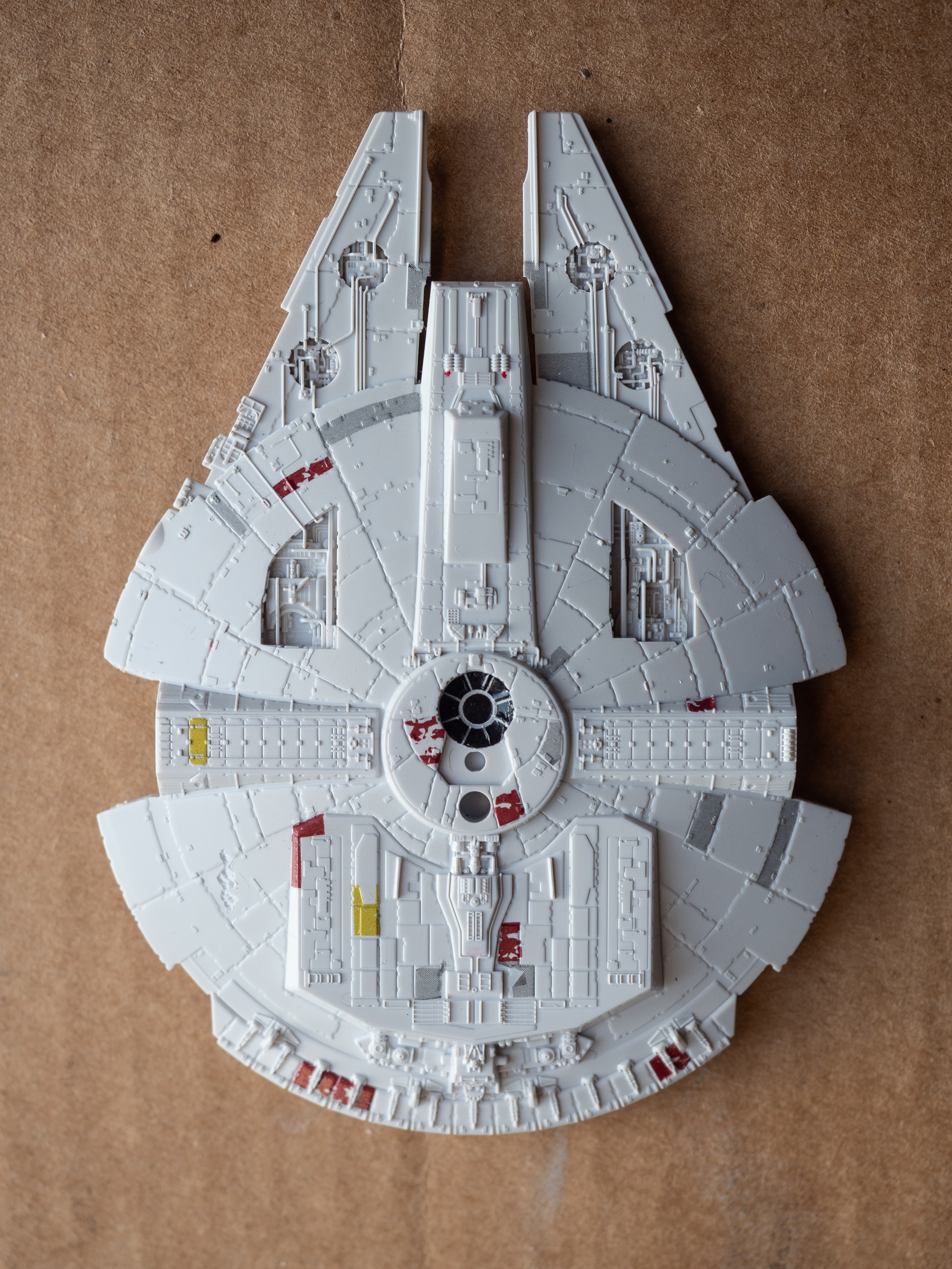

Stage 5 - Nuln oil wash.

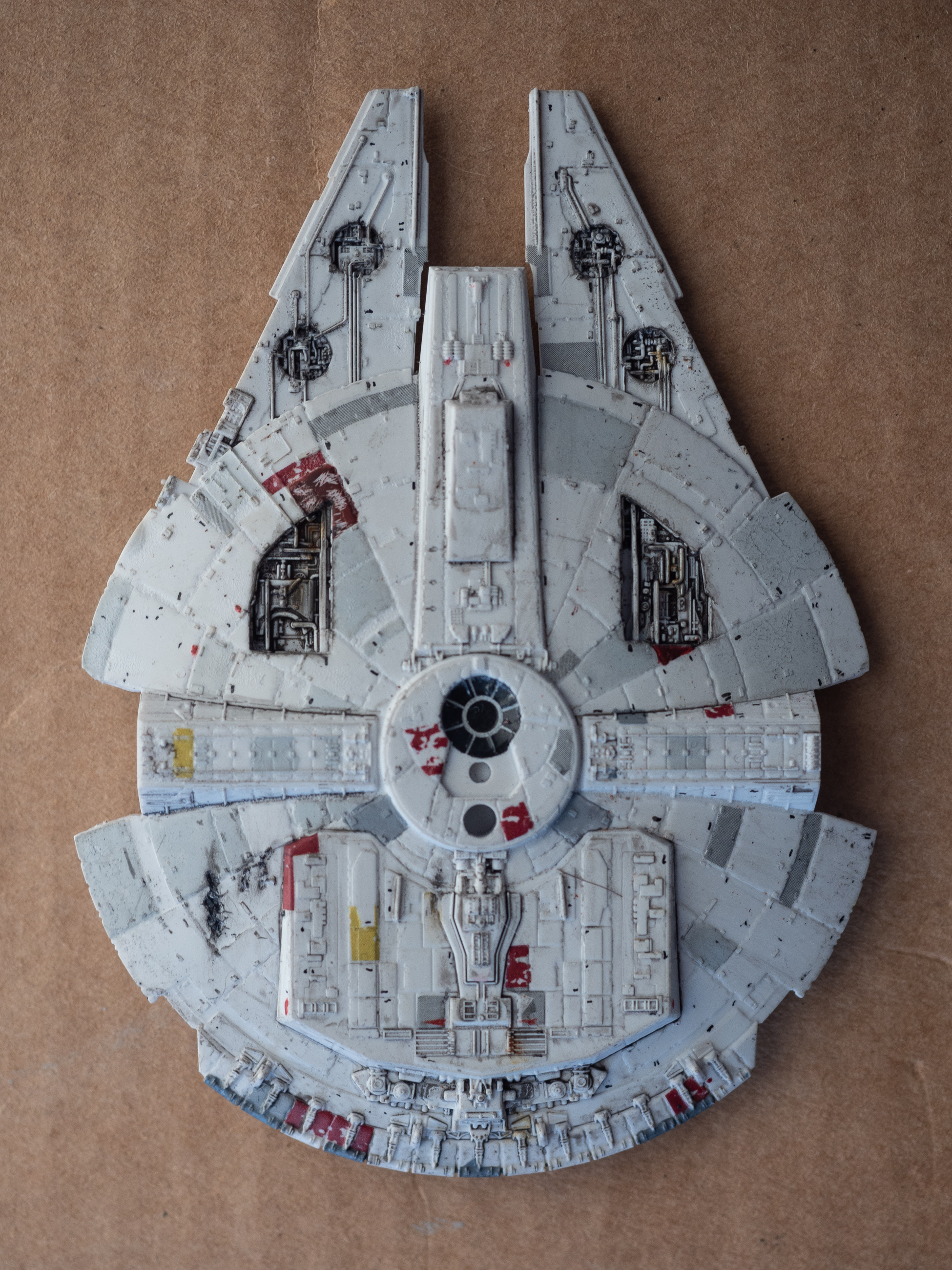

Stage 6 - Soot and Orange Rust again, then a flat clear coat. I kept it fairly subtle, and did a (mostly) better job of cleanup before the clear coat this time.
That's where she stands this morning. I added a few more streaks to the upper hull, and I'm going to move on to the the docking rings and sidewalls before deciding whether I'm going to light this one or not.
