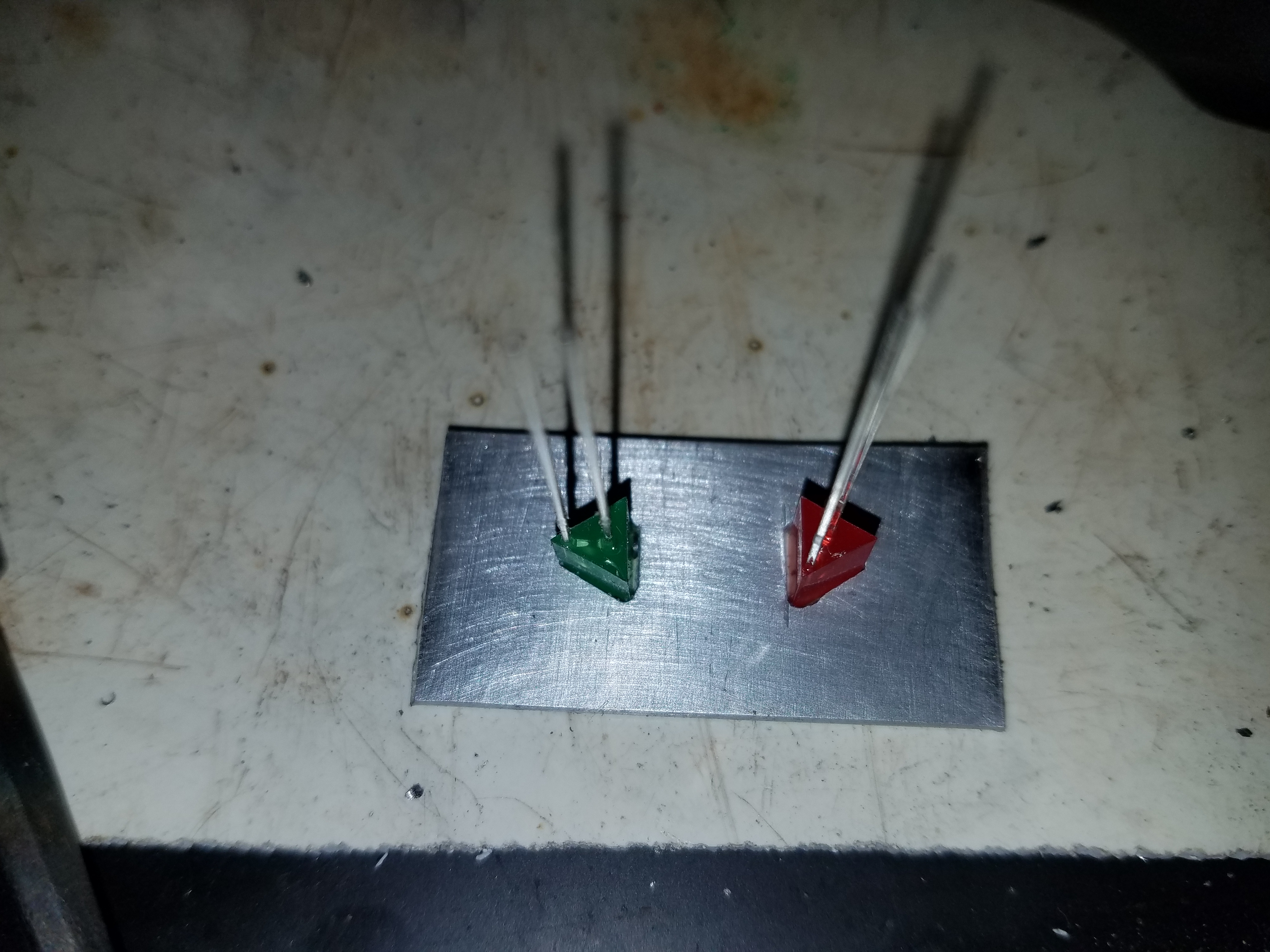

Been working on a jig to help cut the LED section of the side gribblie. It's been a pain in my but now for a while but I think I finally have a solution. More to come soon.
OK, this ended up being way more difficult than it looked. At least to get a consistent and repeatable set of triangles. I wont have a great build video on the jig that I made it ended up being so much trial and error that the video would have maxed out Youtubes 10hr limit and I would have still had to cut it way down. Instead I'll post a small video and review of how I made it.
May be a little while though I haven't shot any footage for it yet. These two pictures are all the media I've made in the last 3 days.
