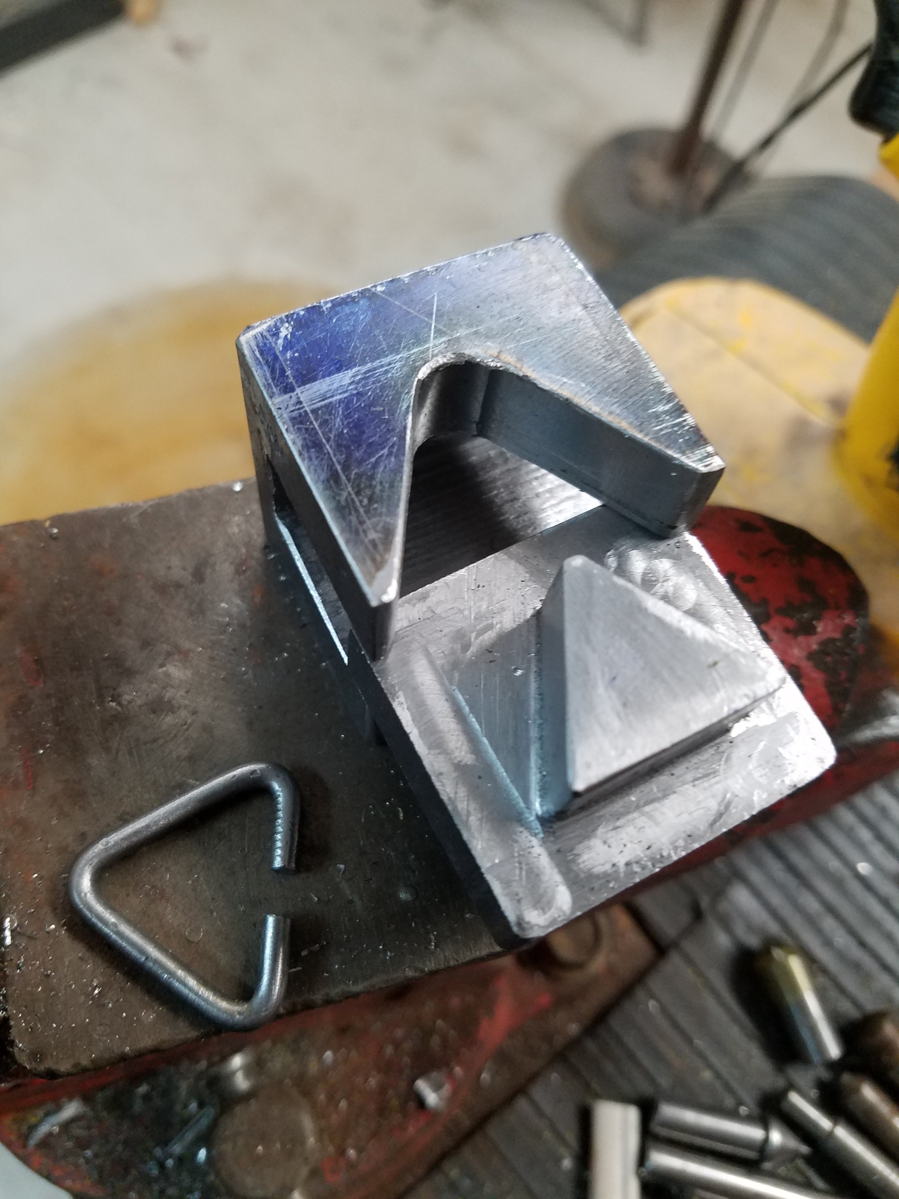

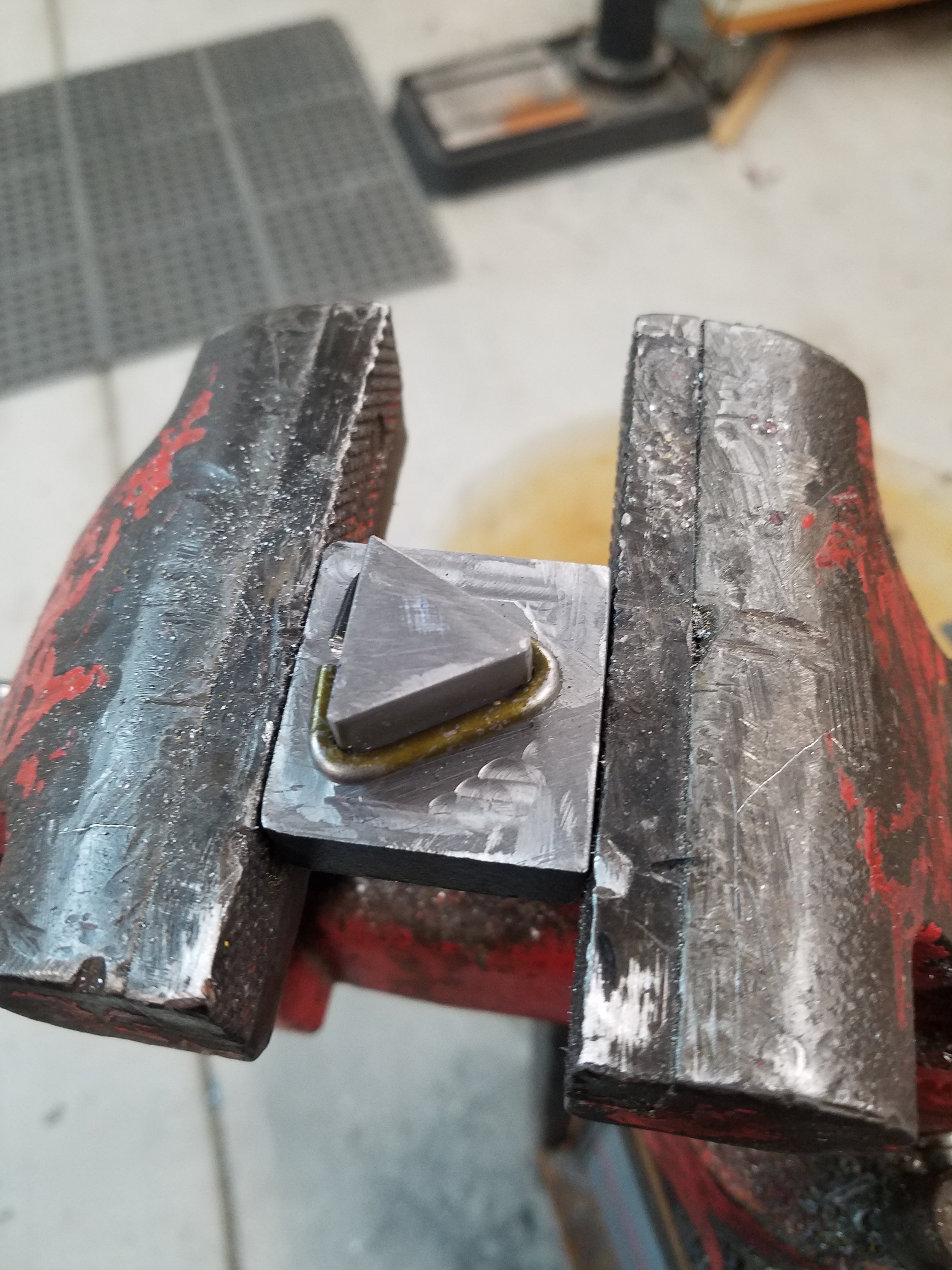

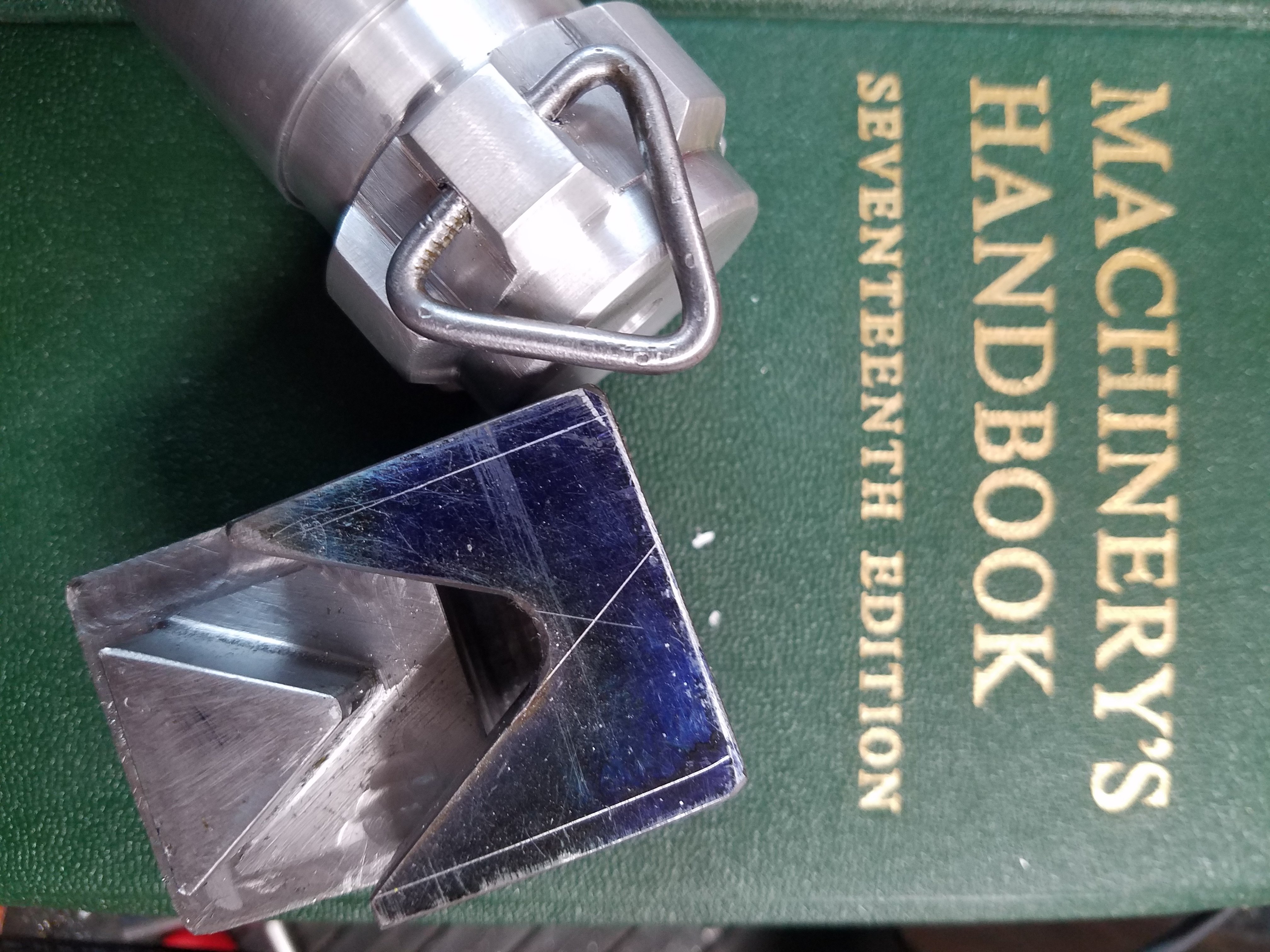

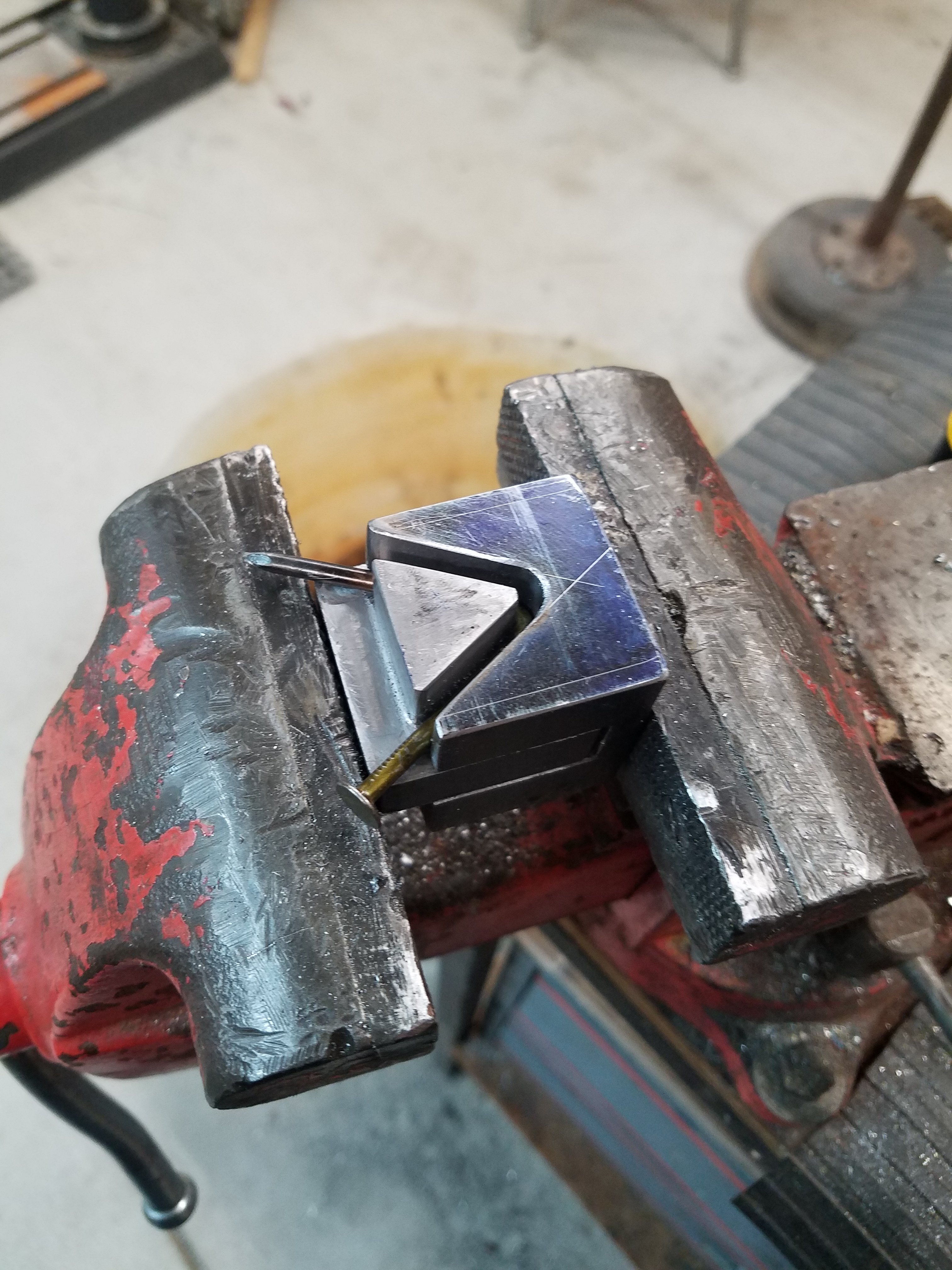

I Couldn't find the exact triangle D-ring so I just needed to make a triangle D-ring bending jig. And it works awesome!!
Down side, was rather excited and didn't pay enough attention when drilling the holes for it and they came out a bit lopsided.

How on earth did you make that?!?!
I’ve been making something like that out of hard wood, I’m on my 5th or 6th version. Now with oak, but would love to make one out of steel lol you did
Absolutely mind blowing!!!
If you see where Adam was cutting the groove in the plastic in his video, like that except it was in steel and I rotated the vice 60 degrees in each direction after cutting a side. I'll try to do a more detailed pic setup and maybe some re-enactments if you're really interested. If I had my camera I would have done some video of it.

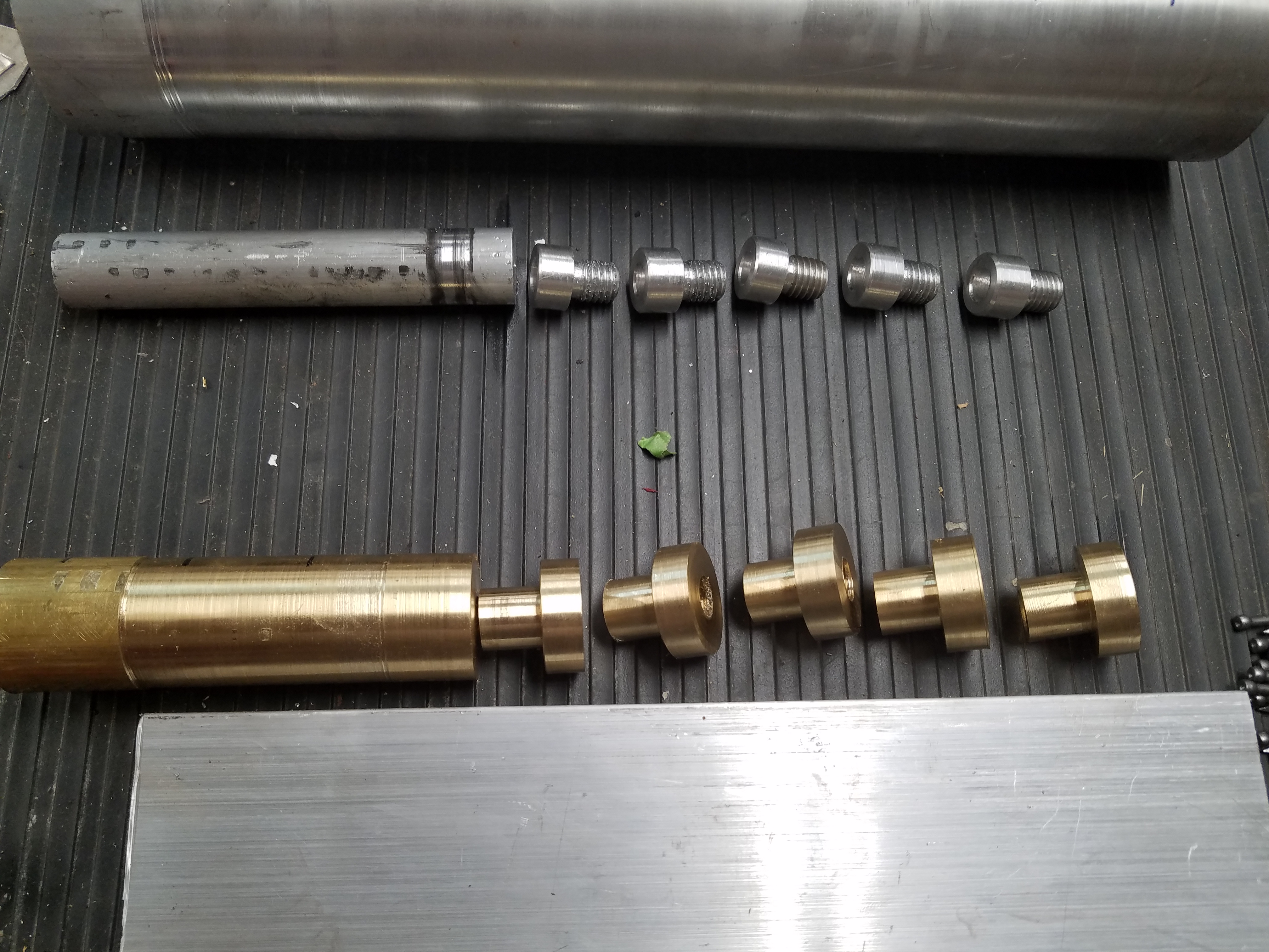

Anyway here are some pics of prototypes I and II.

I’d be interested in a tri ring jig if you make anymore of those!
Not sure I want to make another one of those, the setup for each side is a bit of a pain. Maybe once I've made some of the costs back and don't need to do production work.
started taking some videos with my phone while I wait for my new camera to get here. I was able to complete 5 of the end tips for the emitter tonight. Was kind of fun getting the video. Now I have to get them all stitched and published.
This is what was accomplished last night. Video still to come over the weekend.
