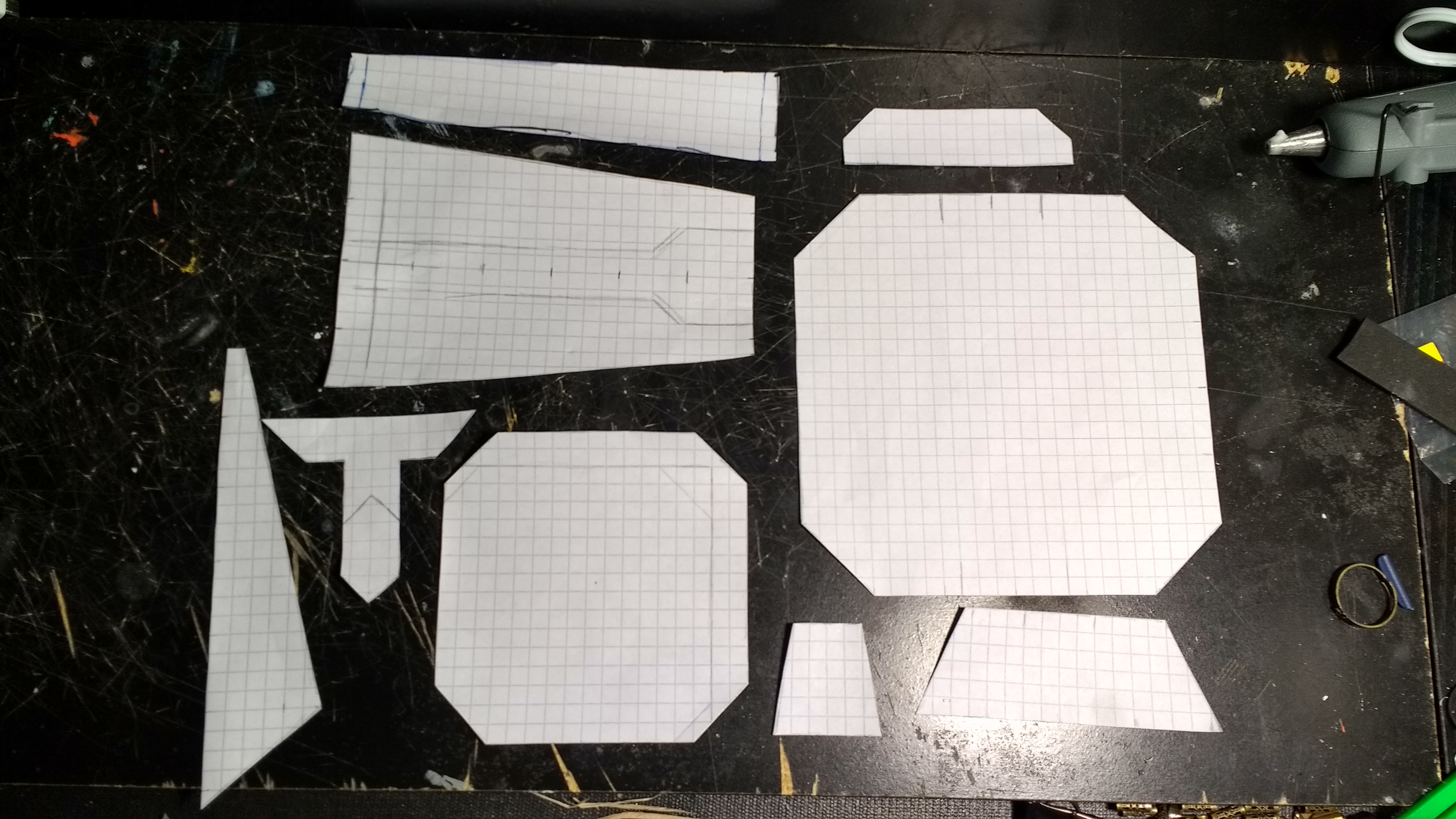

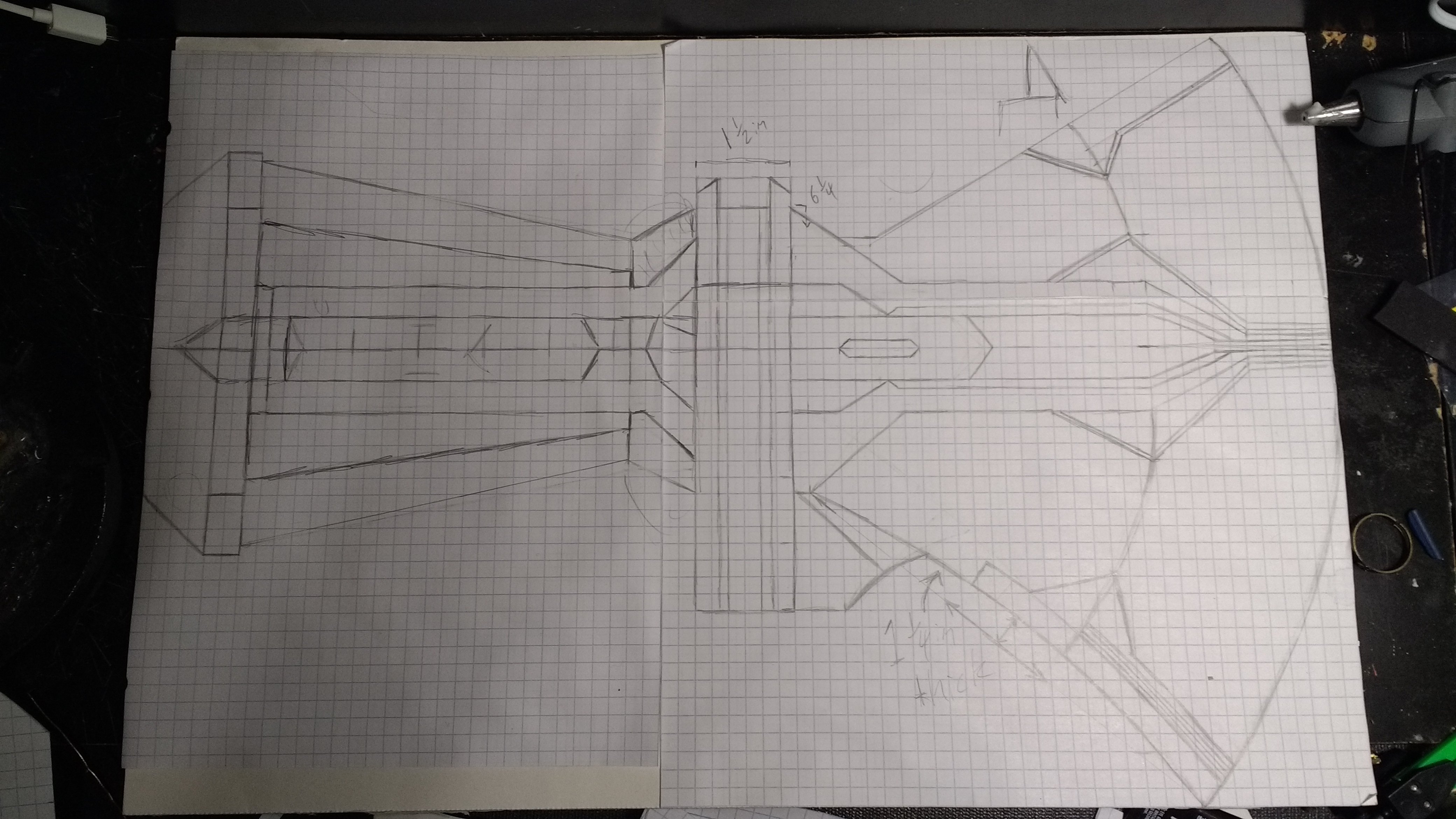

I'm working on this for Denver Comic Con, whose prop policies get stricter every year. So the head will be built out of craft foam, the handle will be a thin dowel covered in pipe insulation, which is flexible enough to twist around the head. I'm using the toy Stormbreaker for reference, essentially doubling all its measurements which will result in a hammer about 18 inches long with a handle about 3 feet long. Here's my pattern so far.

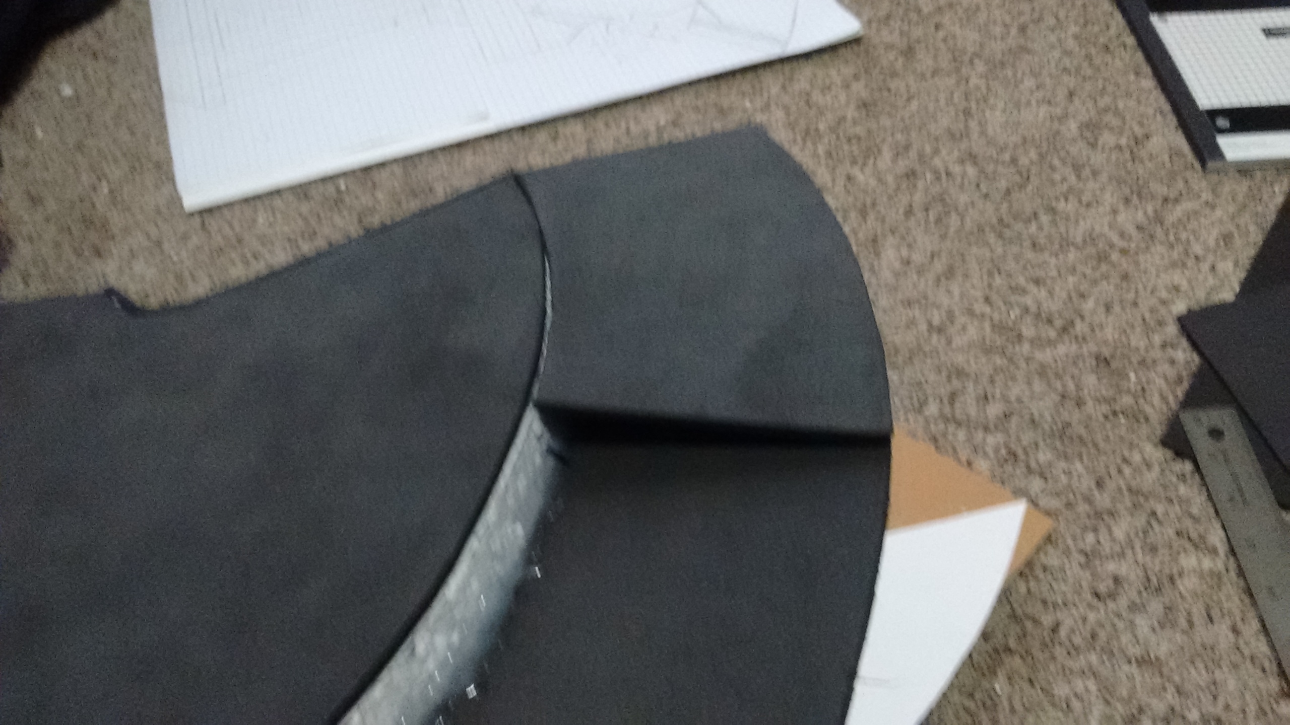

Started thinking to myself, "Man this thing is gonna be huge!" Then I moved on to building the blade of the axe.
At which point I'm thinking "Yep this is definitively big, is it too big? It might be too big." Then I started getting the detail on the blade done.

I decided to proceed with the build sized as it was, however if anyone does try to re-purpose the pattern I used it's on four-squares-to-an-inch graph paper and converting it square by square to five-squares-to-an-inch graph paper would result in a hammerhead 14.4 inches long, much closer to the scale of the hot toys hammer.

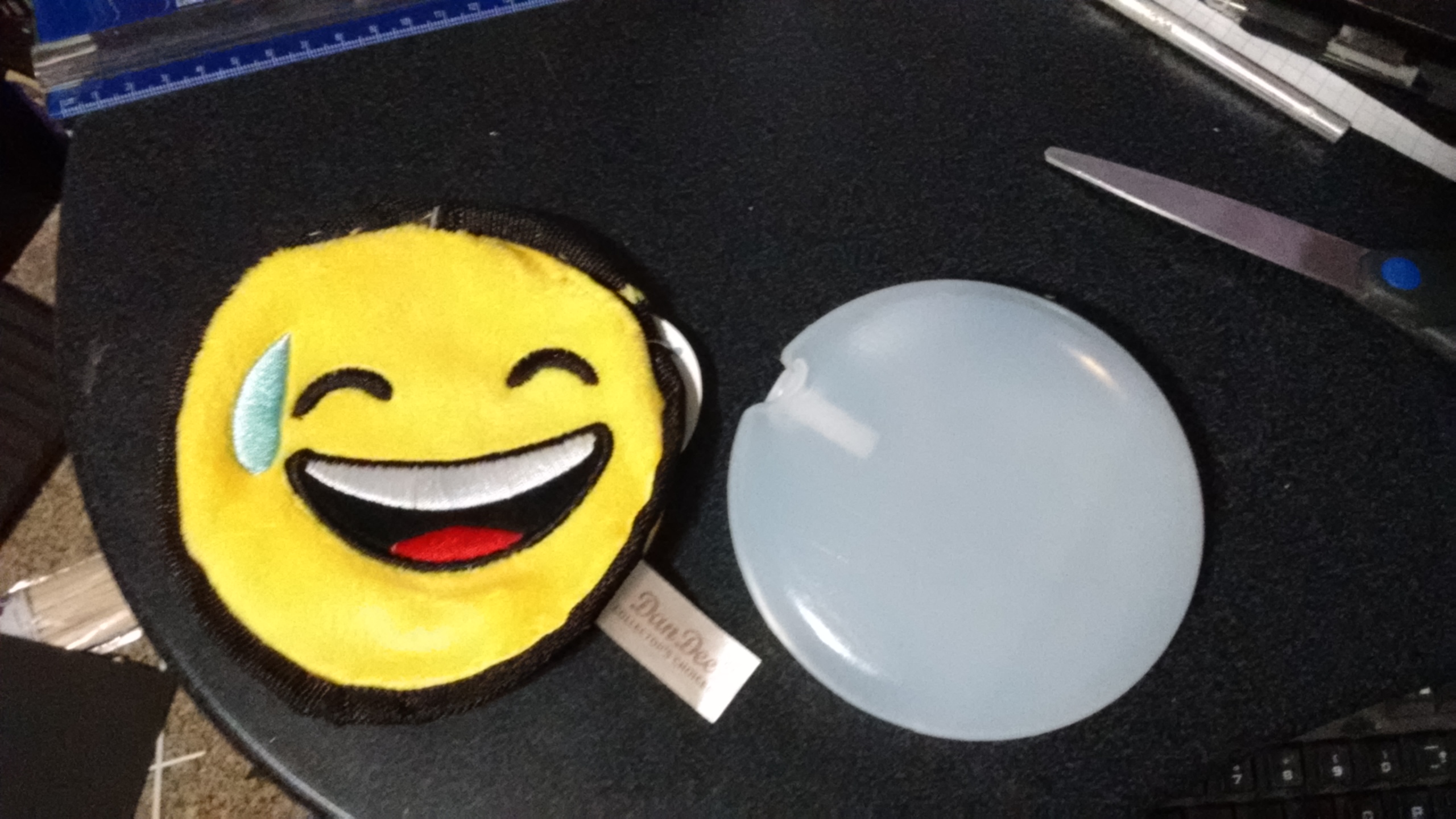

I noticed too late a key difference between this toy and the Hot Toy's hammer, on the Hot Toys version the groove in the side of the hammer head continues all the way through the head. I currently plan on leaving my hammer as-is, I did turn it into a giant squeak-toy after all (for safety) by placing an emoji dog toy in the head of the hammer.

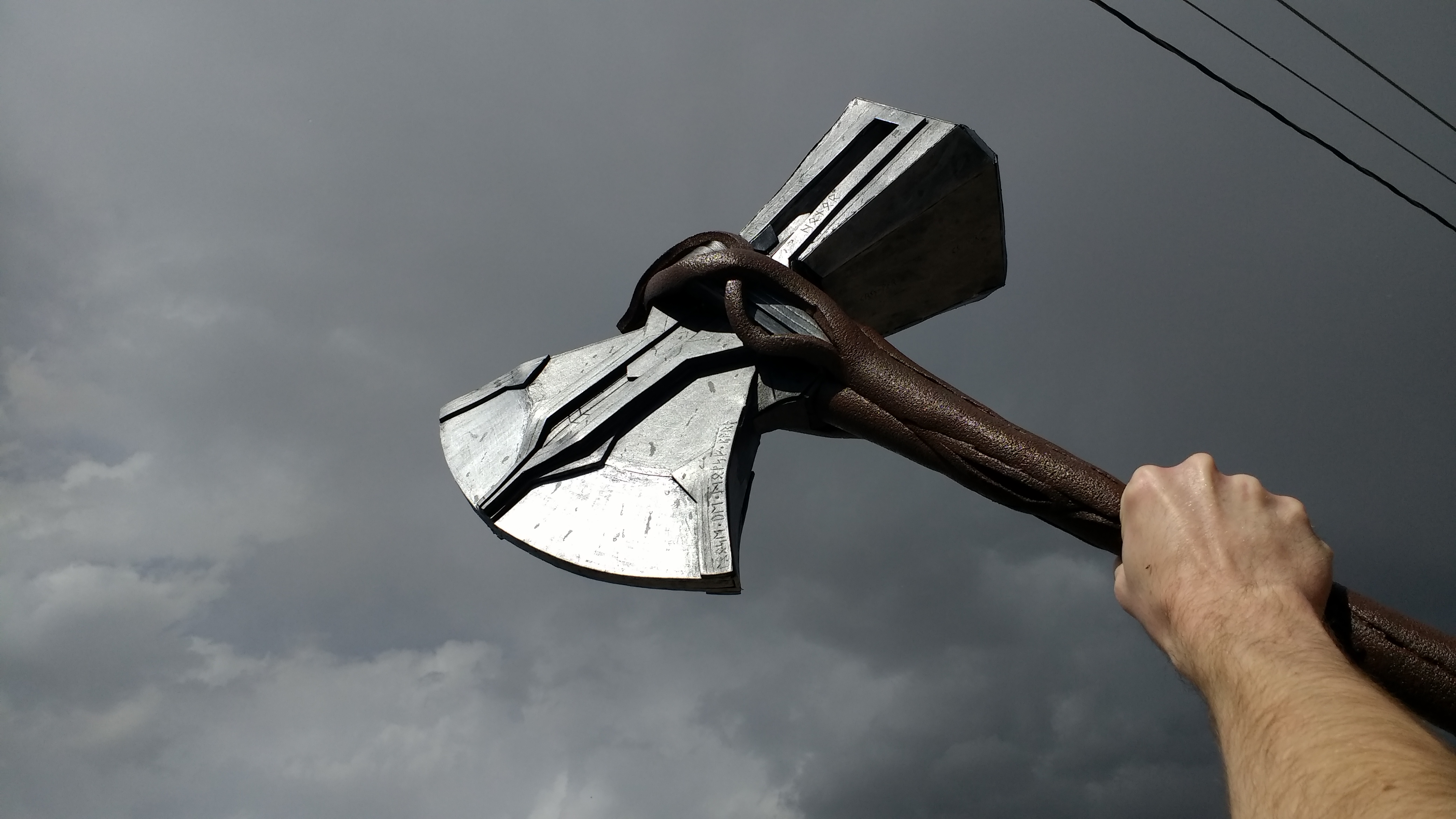

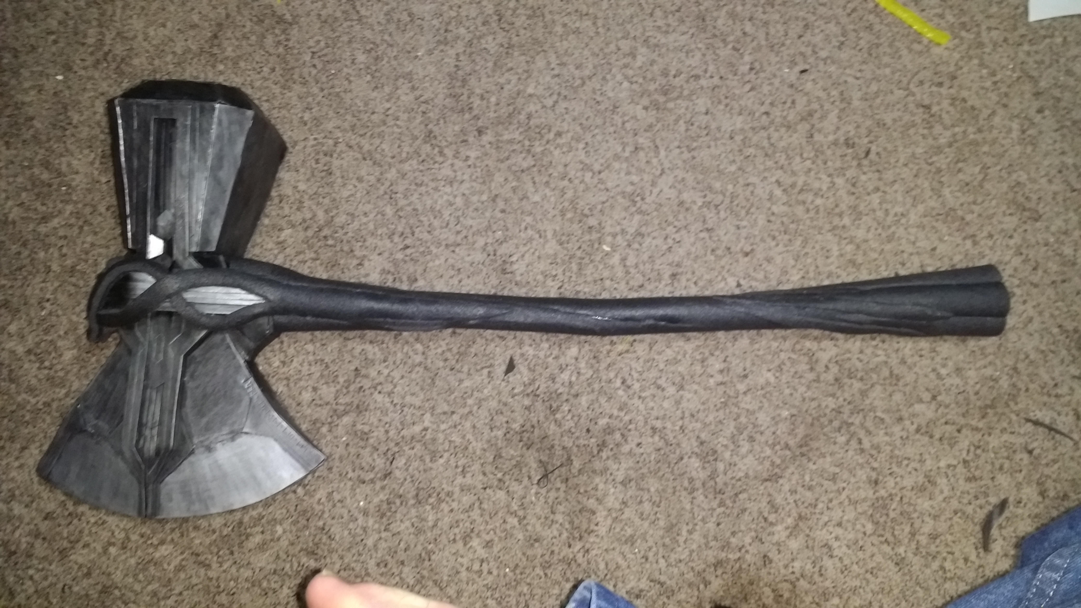

At this point the only thing I have left to do is paint the handle, which I made out of pipe insulation, which let me wrap the 'vines' around the head pretty convincingly.
